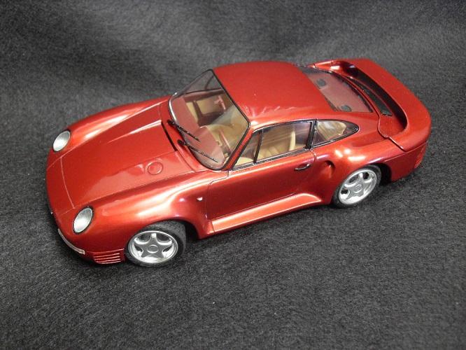

JollySipper Posted June 20, 2022 Posted June 20, 2022 A lot of getting a nice shiny paint job has to do with how smooth your primer is...... It's really mostly in the prep work! That, and spray technique... When I spray anything, I always shoot for close, fast passes. That goes for primer, too. Clear especially gets sprayed "wet" so there's little if any polishing needed. This model wasn't polished, I just shot the coats of everything as wet as I could without getting runs. Again, close fast passes will get you less orange peel than "mist" coats.........
