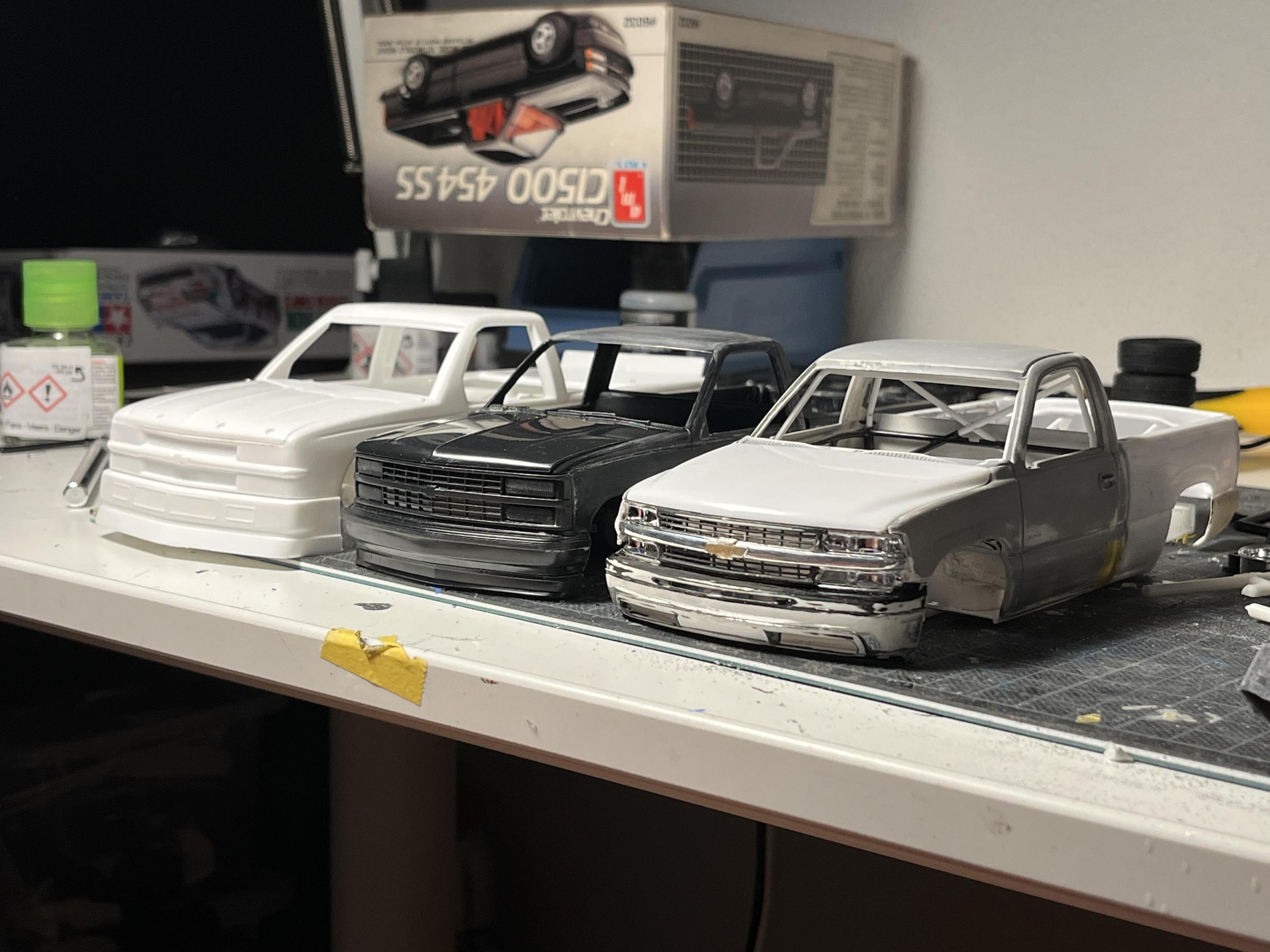

7814F986-B3A8-432D-B430-CBE40524BE58.jpeg.5685af5200588bc7d155b2f2cc711c9b.jpeg63DEB6F2-19A5-434E-8491-7BFA30593EE5.jpeg.824a7700049f3a366364a550474da660.jpeg
a line up of some trucks..FFF3A63A-DC9B-4D77-96A6-DD1133B550EA.thumb.jpeg.e796ea8227f329ef12b05c4676cff580.jpeg

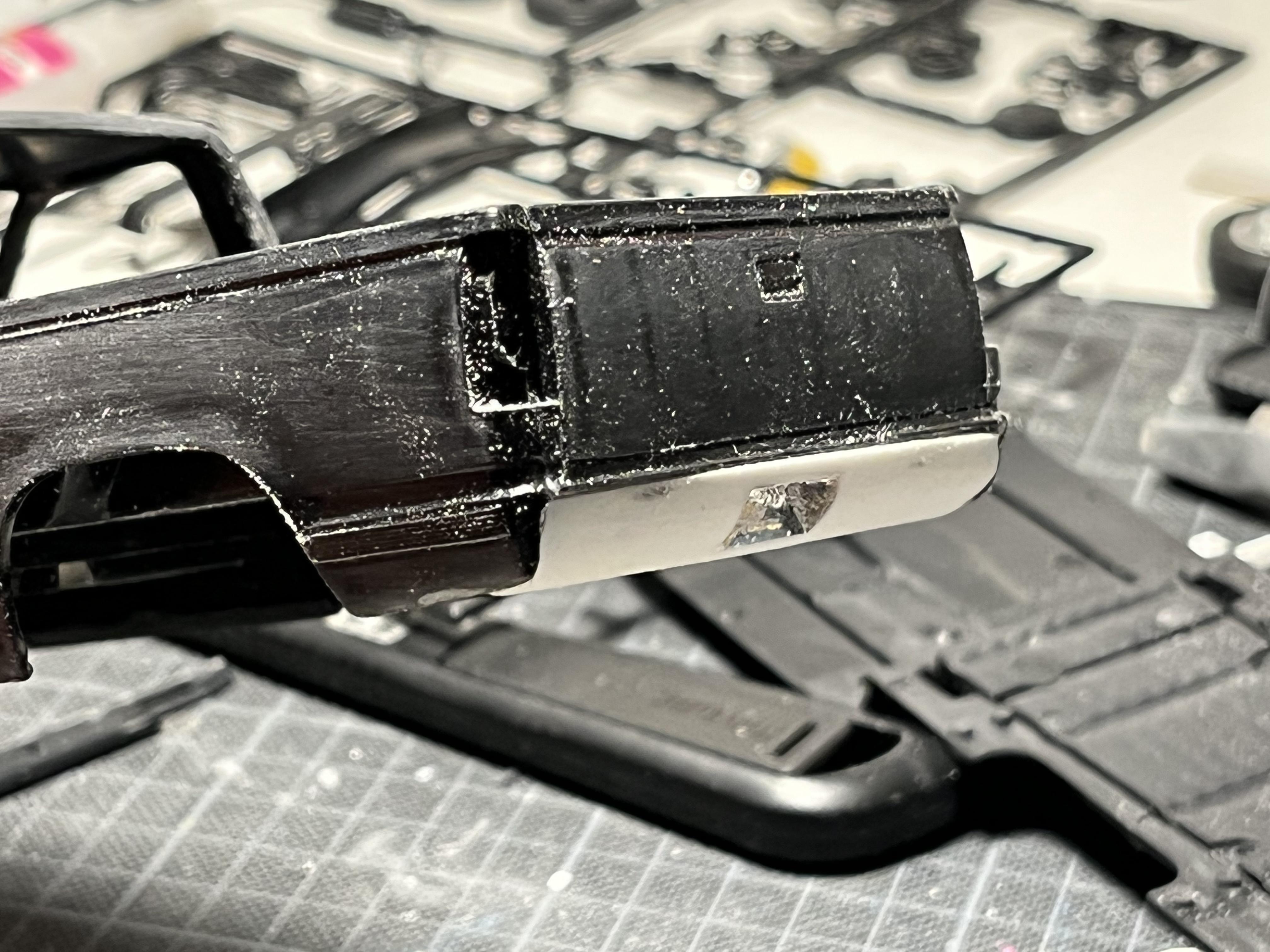

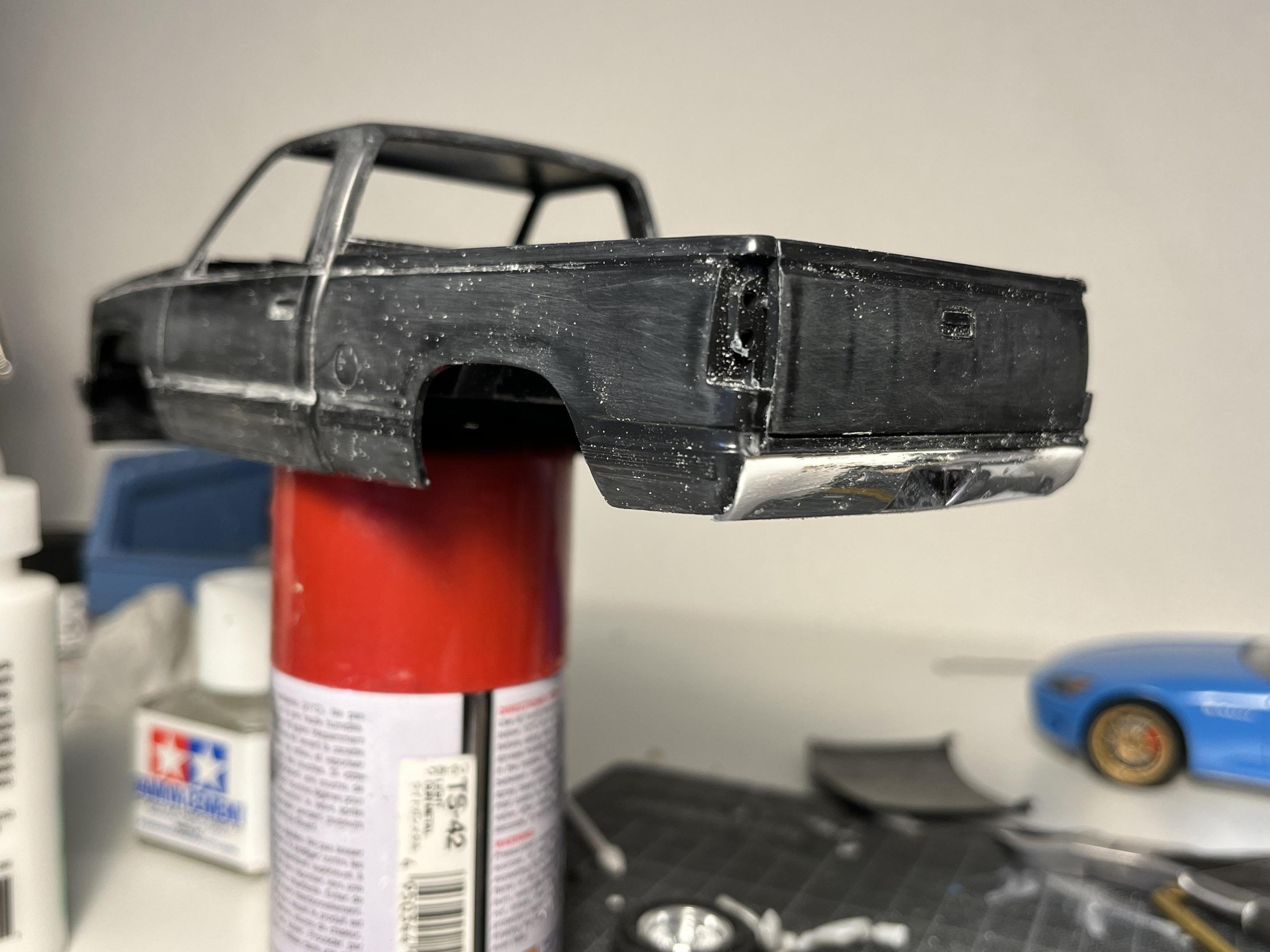

After some time with the sanding sticks this PB bumper, probably  from a GTO or some thing, start to look like a roll pan. Not sure about the angle so I might go in to the PB again and search.
Edited by Mattilacken
  • Mattilacken changed the title to 1988 Chevrolet C1500 , 454SS CBR
Was going through the PB again and found this front bumper from a 1966 Charger. After some minor mods it looks good on there. Much shorter than the other.

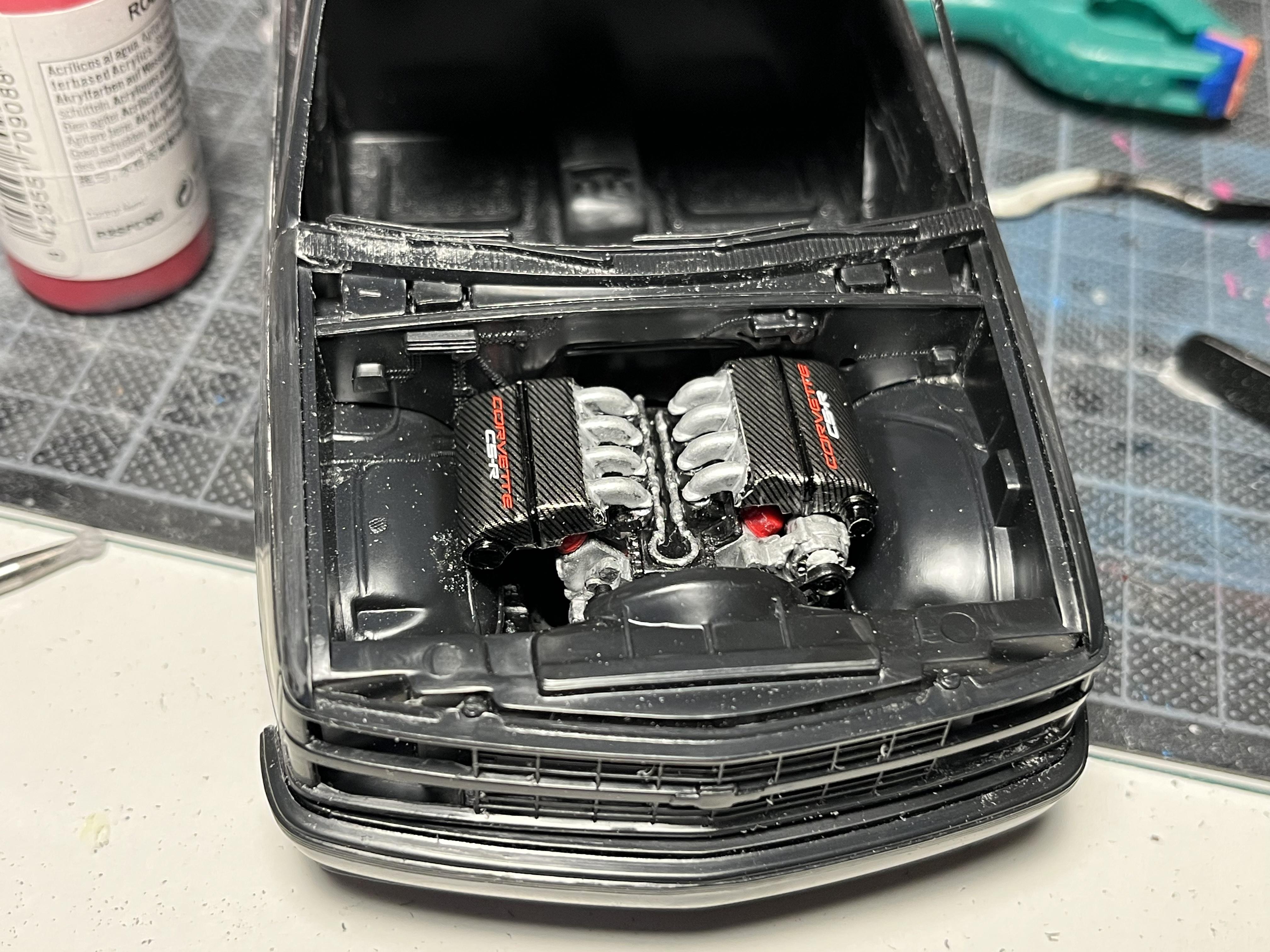

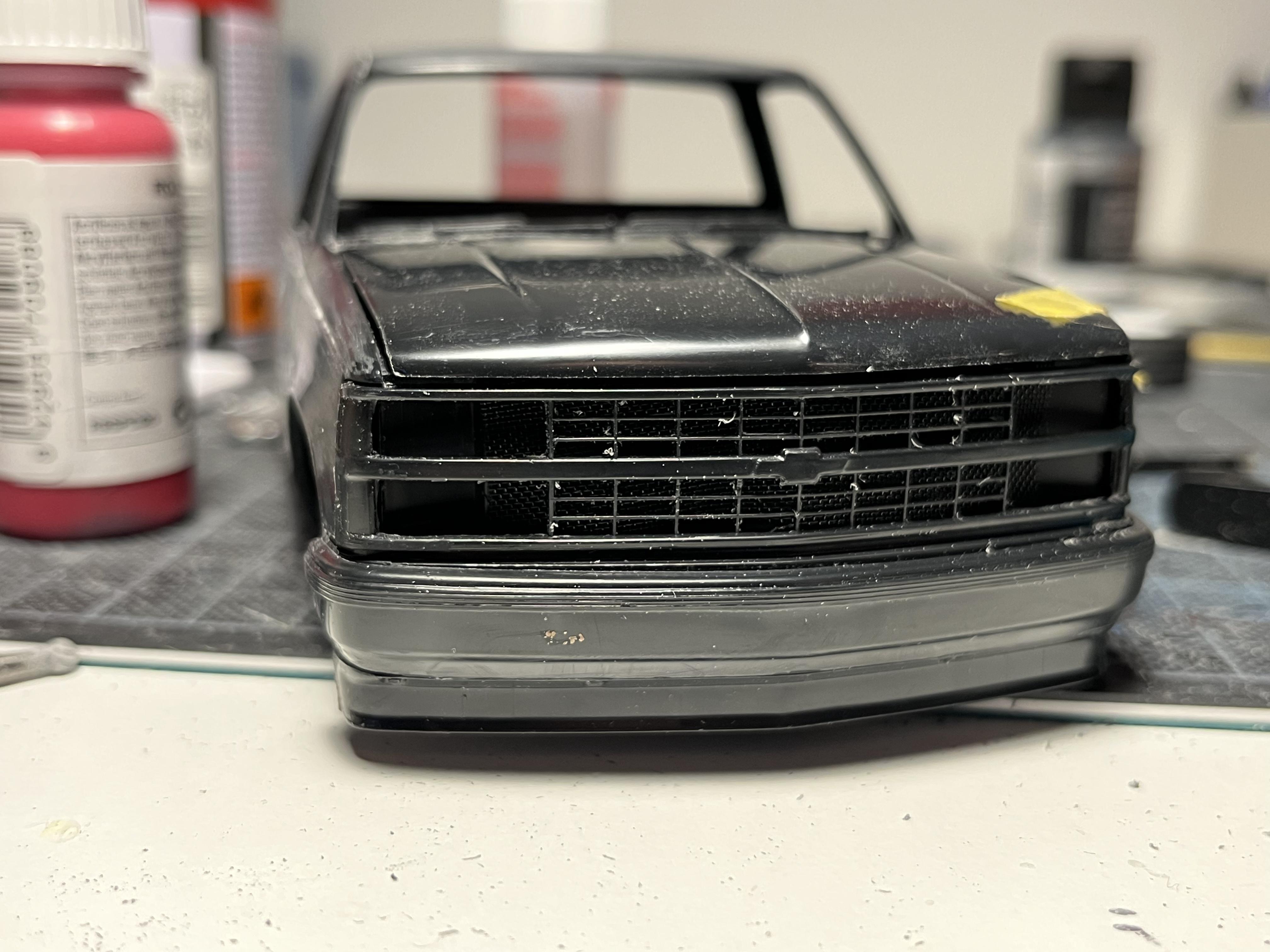

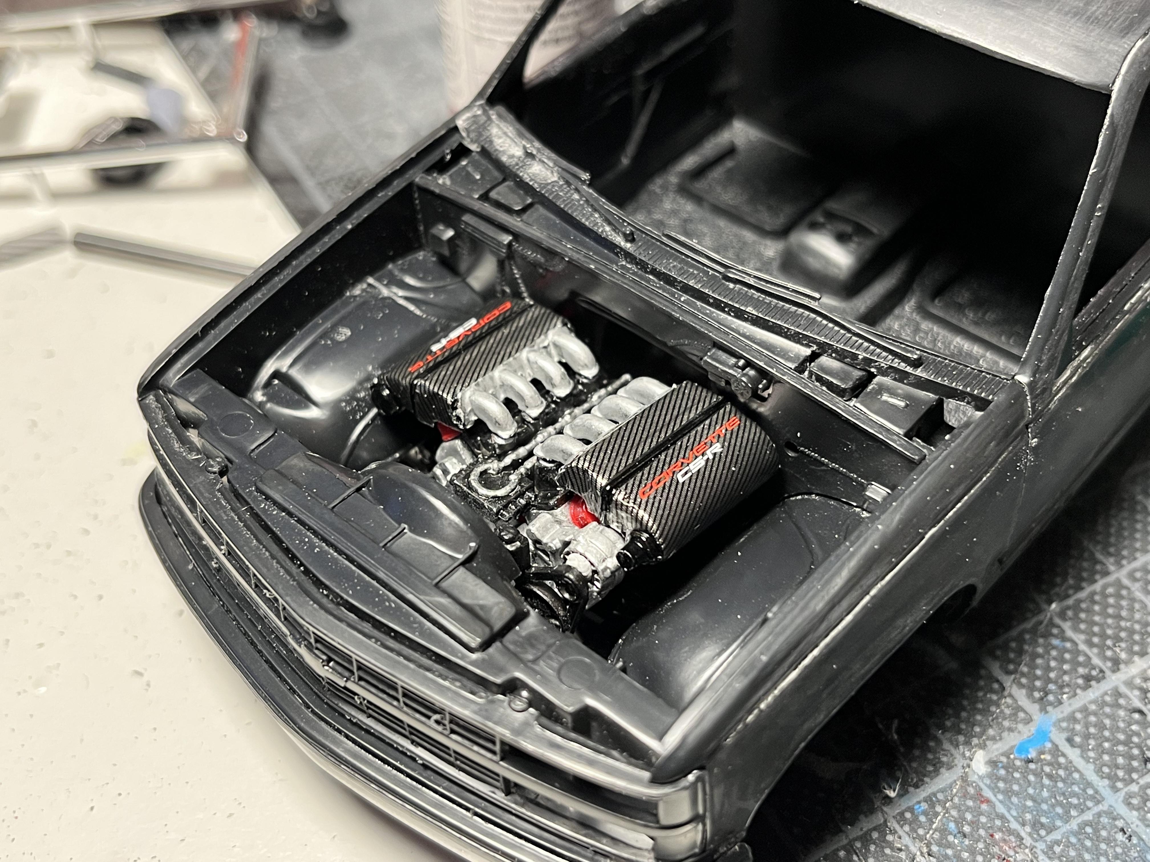

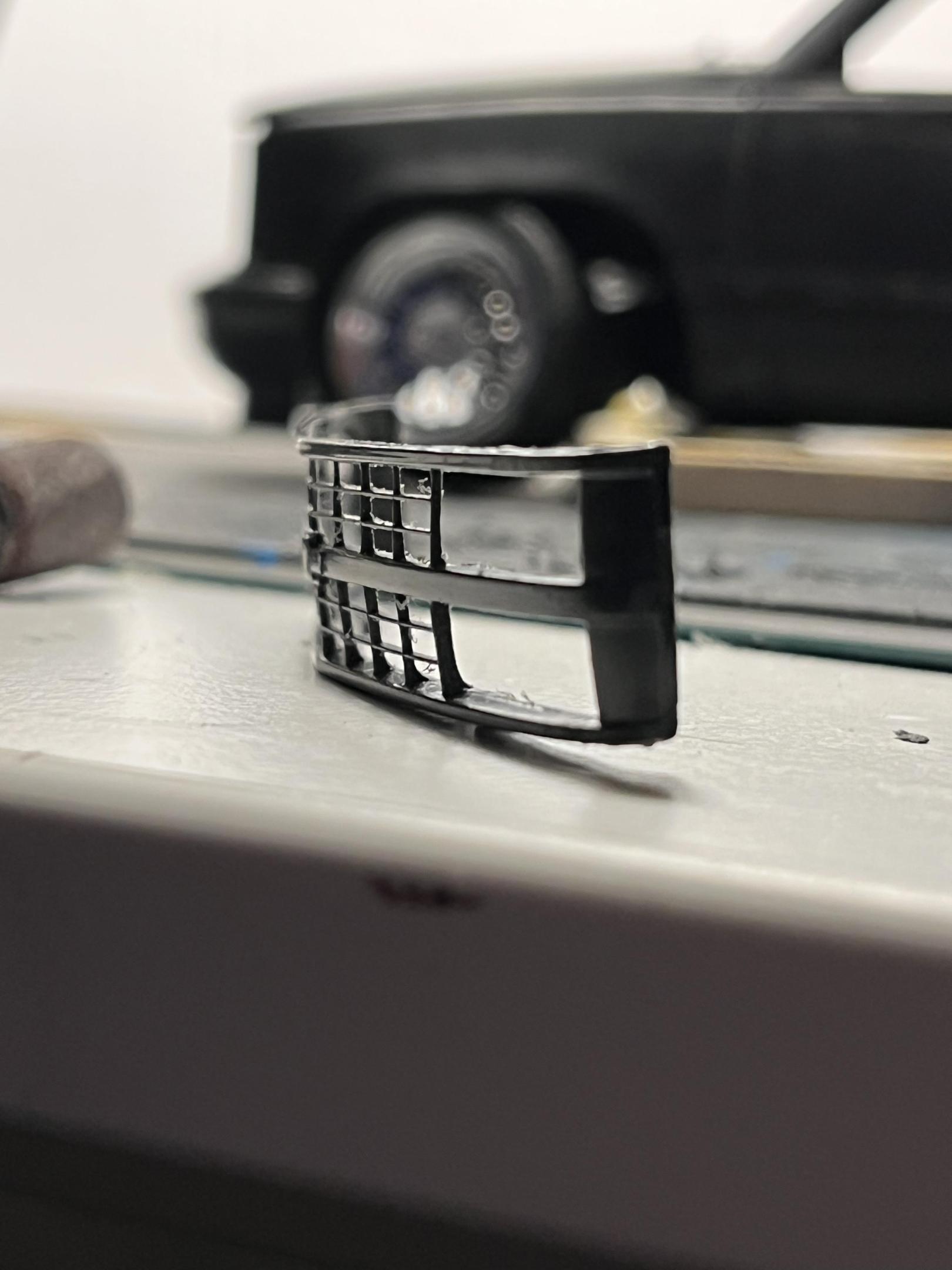

Madde some progress.. i am full of plastic since grinding out that grill! And to not go to crazy I will probably just put a net behind it in stead of making the radiator support and all… or we will see if my add acts up on me ?
And carbon looks ok to me!  A3CE4029-223F-412E-9FBD-51F9330FC5BC.thumb.jpeg.61dbc83d9992f6bf51234935ed8e1eac.jpeg
  • Like 2
23 hours ago, av405 said:
Grill looks nice! Can you walk me though how exactly you did it? And how much thickness was still left?

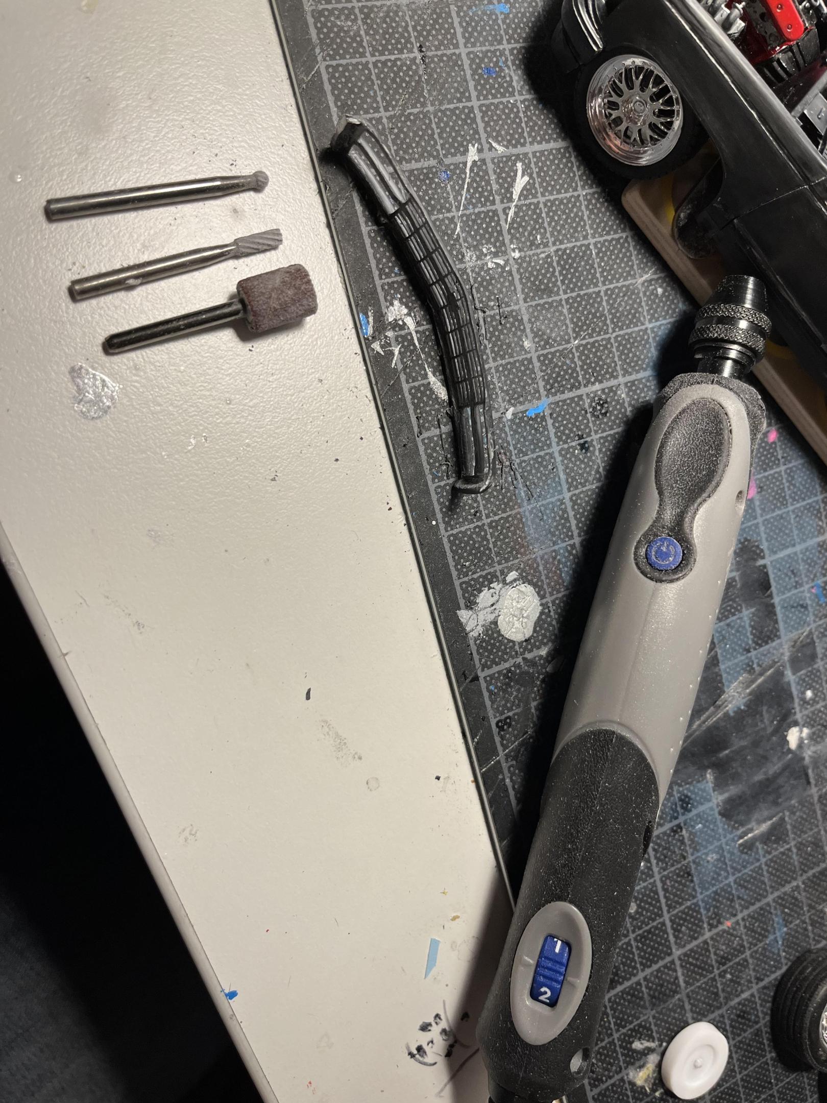

Thanks! I started with the mill bit on the dremel and took out most of the grill and headlights from behind but left the top edge intact. That made the grill to have its integrity and most of its righty left.
When I knew I was close to the front surface I put the dremel on low speed with a sanding paper, and held the grill to the light. That way you easily se if you are even or if you can take out more. And when the grill “inserts” where super thin almost grinded lose I took a fresh 11blade and gently punched them out and when needed I cut.
patience does it! You can see in the pics how thin it is.
  • Like 2

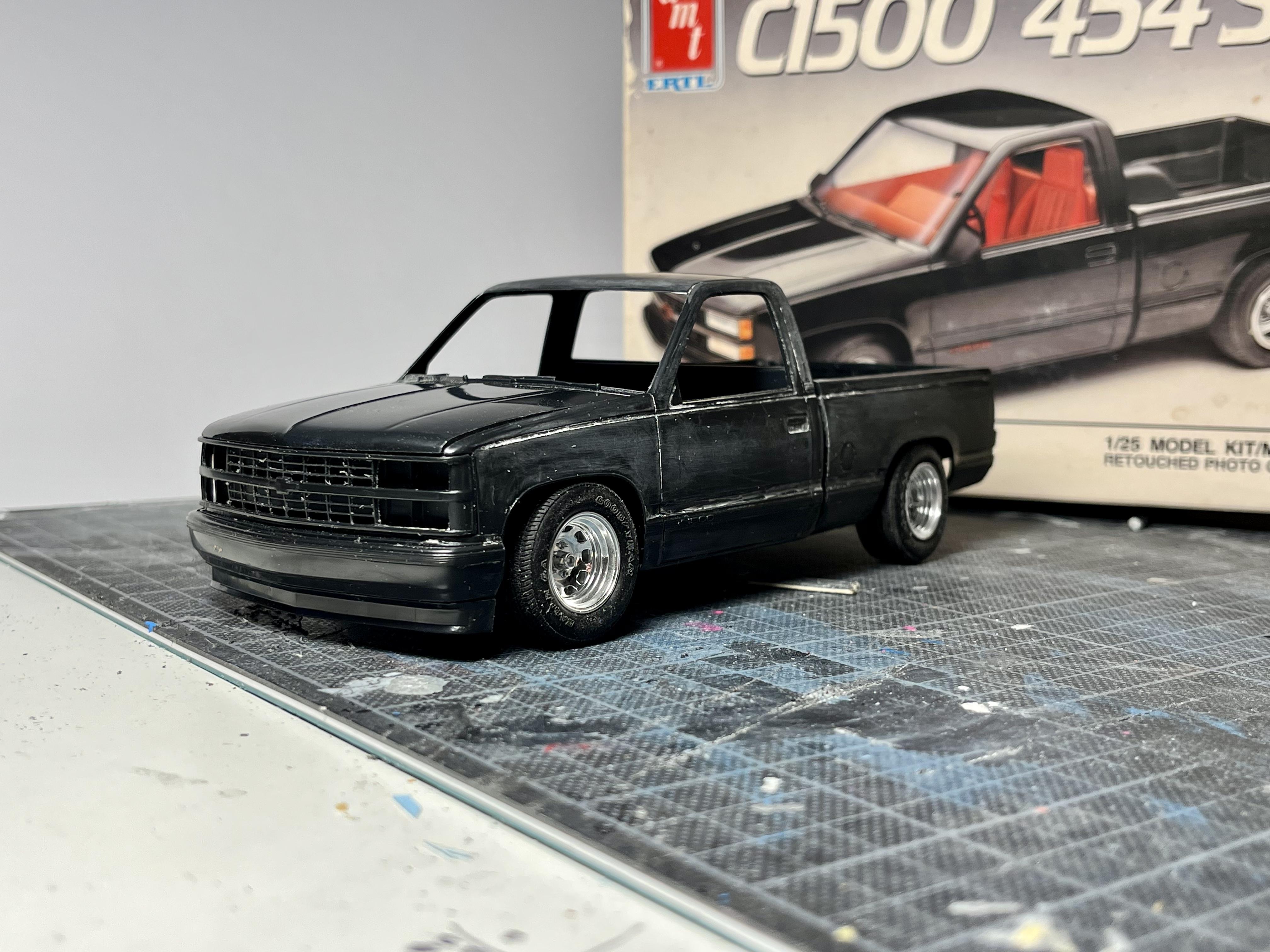

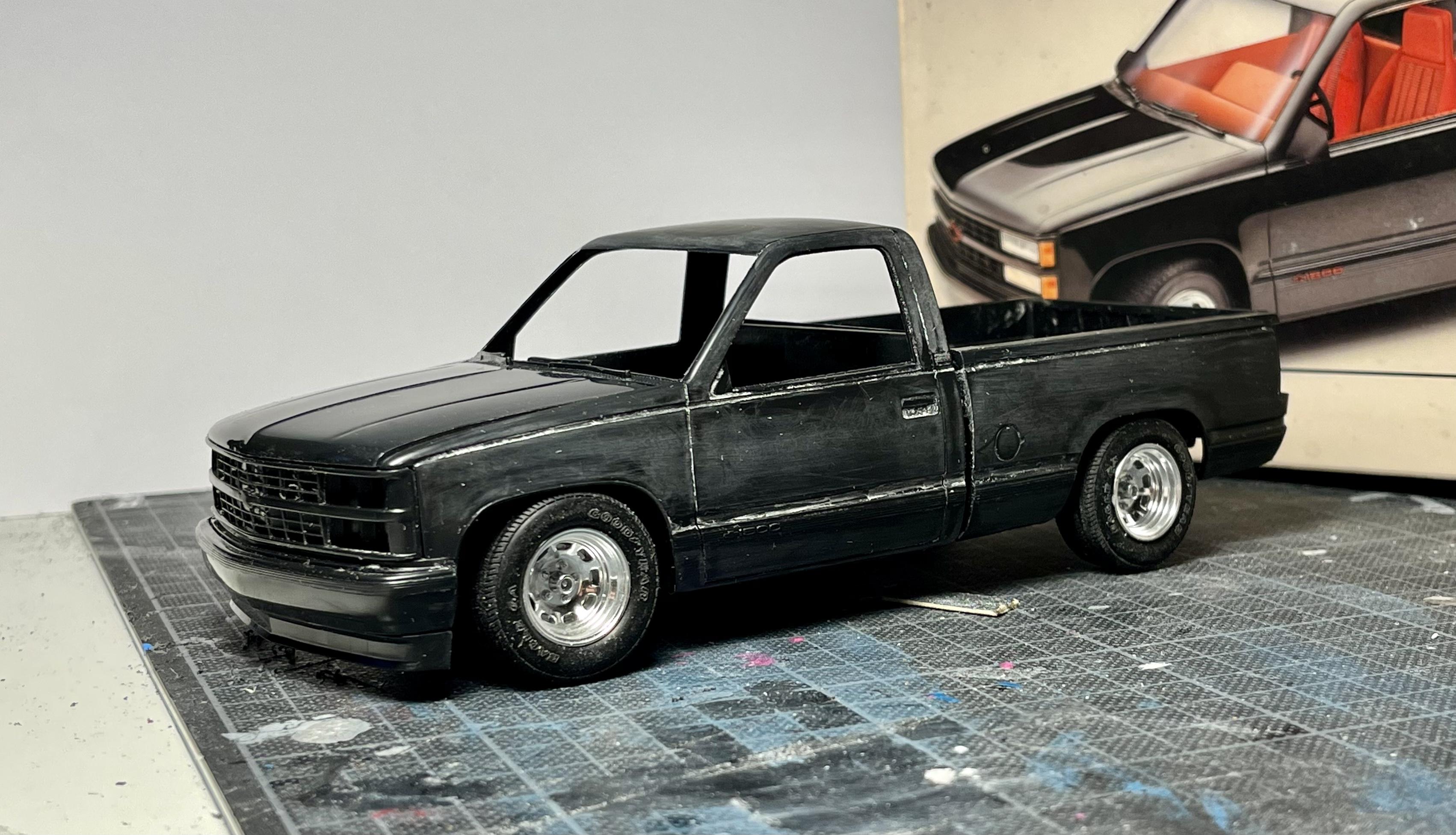

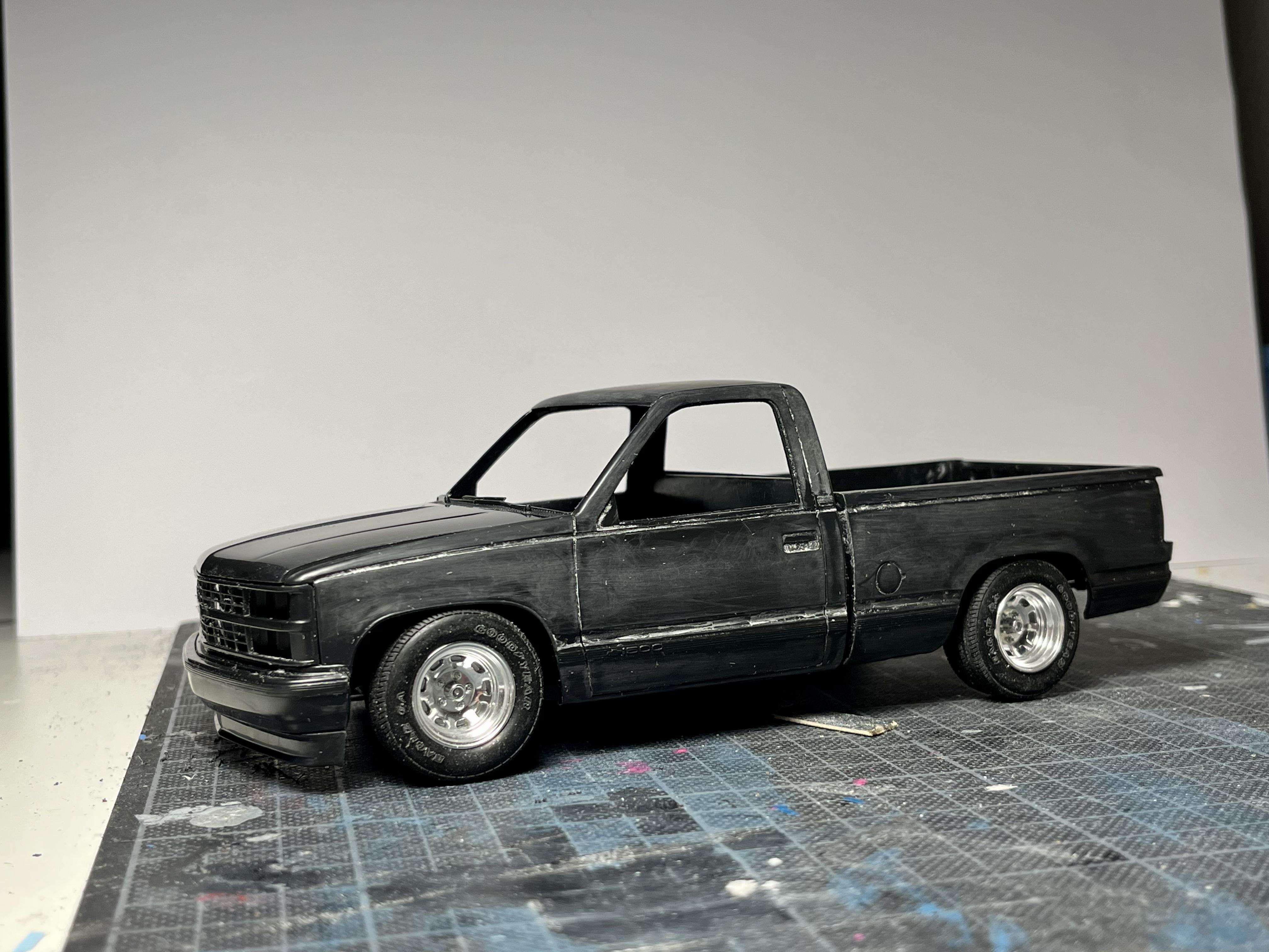

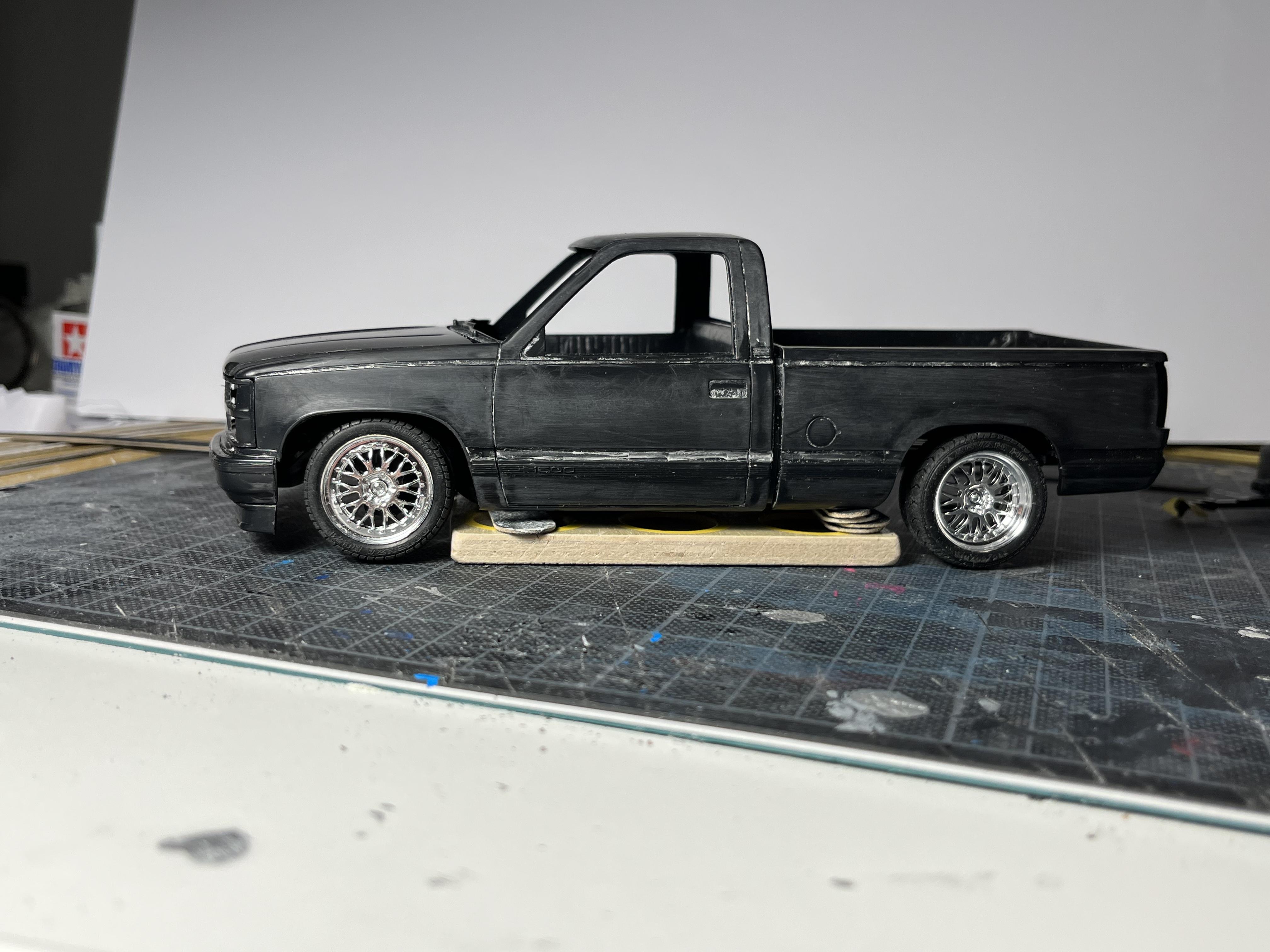

Have been testing some other wheels. Can I please have some inputs on what suits it. Which is best of the ones I have. And maybe some options that would work.
initial thought:
3A489D56-1EC1-4BEC-9006-A088E722B1DB.thumb.jpeg.0d5f2a3a9f573679b0c324890ac6db0b.jpegoption 1:
Option 2 hot rod:
option 3:
Option4, would be dark gray centrum:
And please feel free to comment, and come with ideas or suggestions ? it’s much appreciated!
Anton! How are you my friend?
I like wheel 3 or 4, 4 painted in a titanium colour would look fantastic.  What colour will the body be? Excellent work on the grill, that takes LOTS of patience. Love the carbon fibre on the engine, those decals frustrate the heck out of me! I’ve watched videos and such, but I can never get them to conform to the compound curves. Great looking build sir.
Cheers, Steve
I like your progress so far! Personally I think the initial ones (NASCAR style wheels) look the best, but that's because I'm more of a 15/16" wheel kind of guy! However with the route you're going with your build, I would say the last set suit the theme the best.
Edited by Jordan White
Cheers, Steve
Hi! Thanks i am doing allright! And you? Thanks for the kind words! I am also leaning agains the option 4 at the moment.
I think the body will be Black, since all 454SS that I have seen IRL are black and they do look sinister in Black with the red and silver text. Only option would be a dark gray thats even darker than Tamiya Gun Metal.

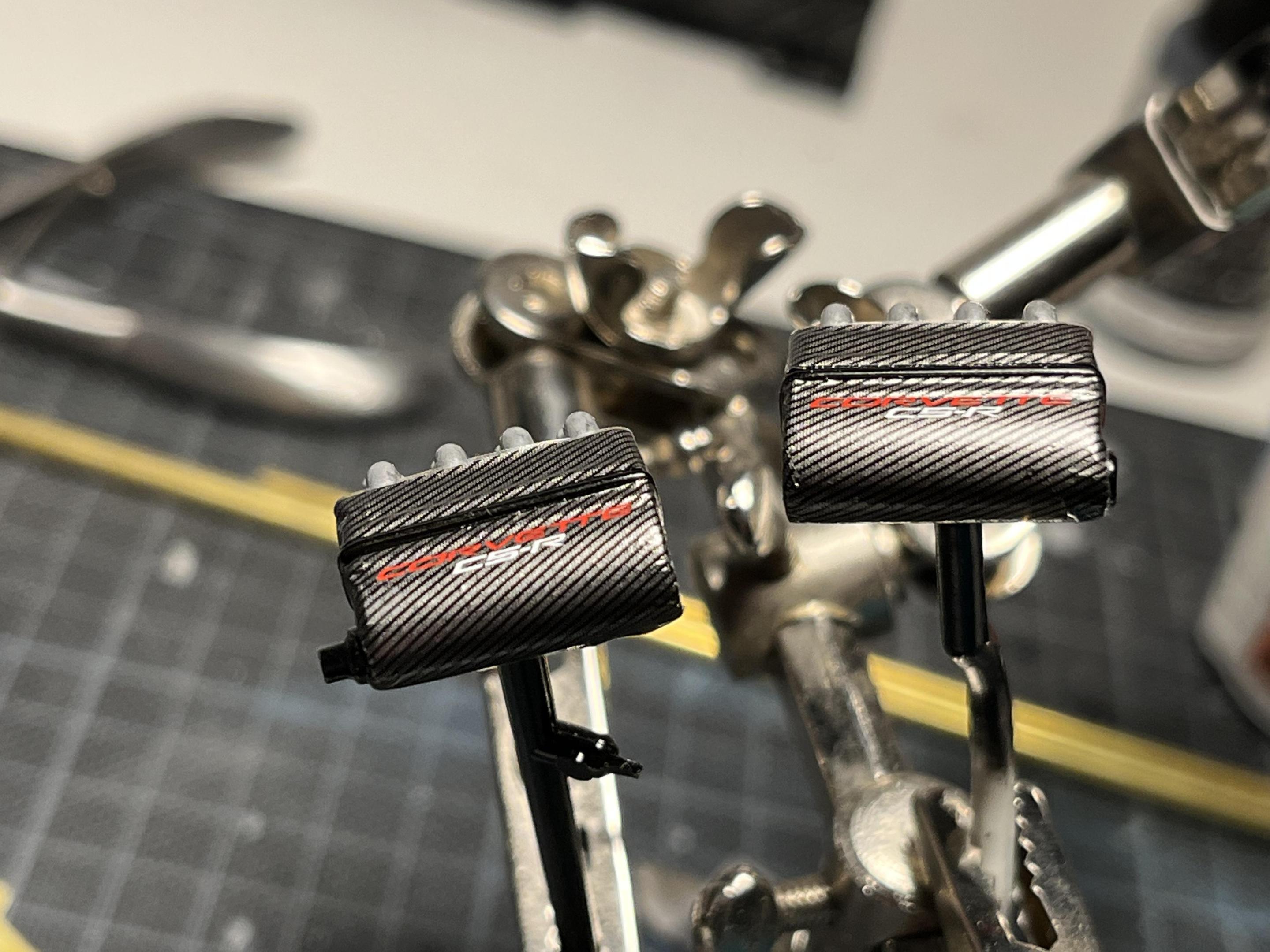

Thanks, it took some patience but it did not take that long when working carfully with the new model of Dremel, absolutley the best tool i bought in a while. Saved me hours of filing the normal way.
Yes the engine will look good! It also took patience more than the grill and many coats of micro sol. And sudently it has formed a bit and when clamping the part with your fingers it sticks. :S
Thanks for your input ? I apriciate it! I can agree that with the motor i put in it the last fits the theme, my plan was to build a more old school build at the start :D

Engine looks great and what a beast!

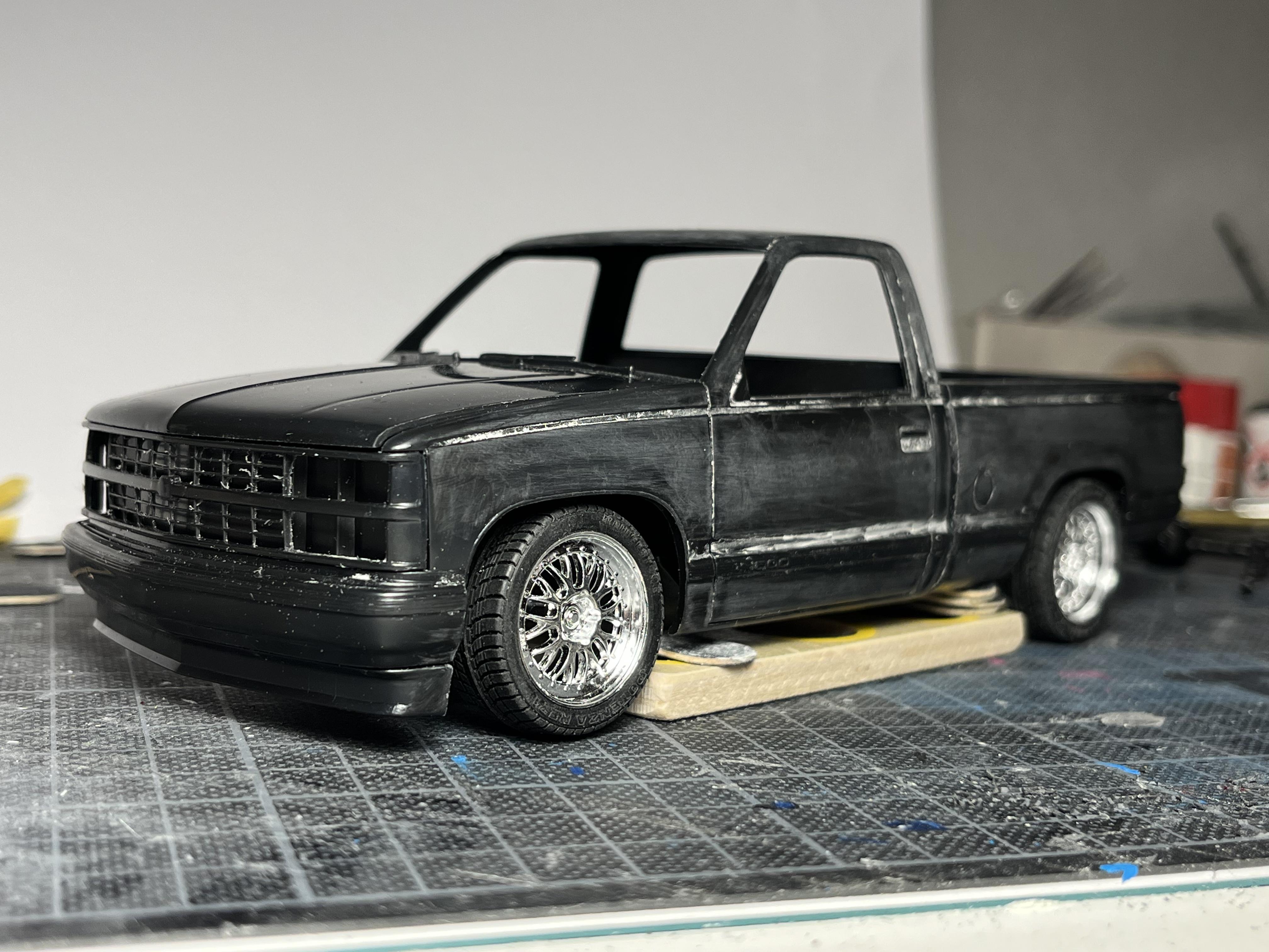

Got an idea the other day if I could use the C5R wheels if I sleeved them.. and they sudently doesn’t look to bad. And I actualy prefere these before option 3 and 4 above.
Option 5:
