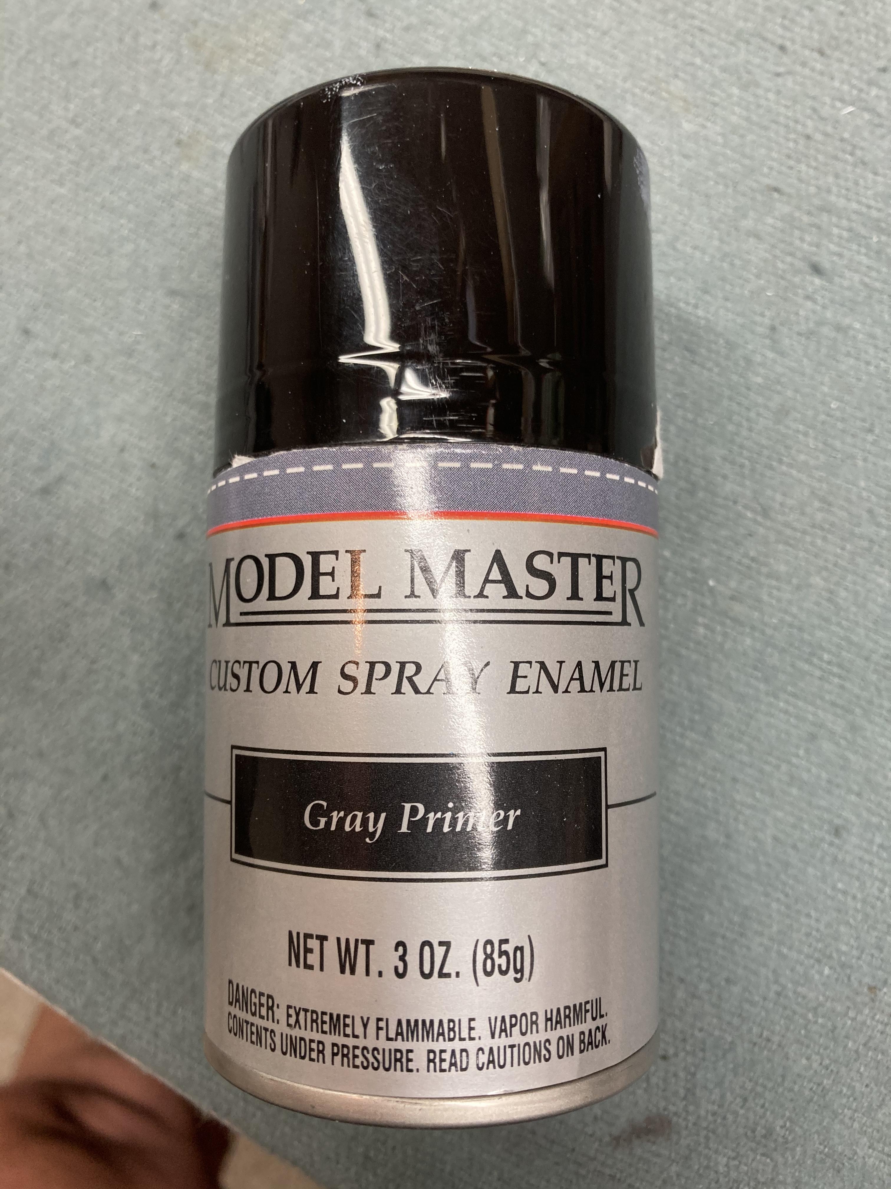

peteski Posted July 13, 2022 Posted July 13, 2022 On 7/13/2022 at 1:42 AM, Mark said: Every so often, someone here or elsewhere discovers an enamel primer, when they try to shoot lacquer on top of it. The cheap store brand primers, and the basic Rust-Oleum (non-automotive) primers are enamel. Expand Now we're getting somewhere. Thanks!
NOBLNG Posted July 13, 2022 Posted July 13, 2022 https://www.rustoleum.com/product-catalog/industrial-brands/industrial-choice/spray-paint/1600-system-multi-purpose-enamel-spray-primers?ls=1680830&lc=Gray Primer
StevenGuthmiller Posted July 13, 2022 Posted July 13, 2022 You don’t have to look too far to find enamel primer. Or, at least you didn’t used to have to. Steve

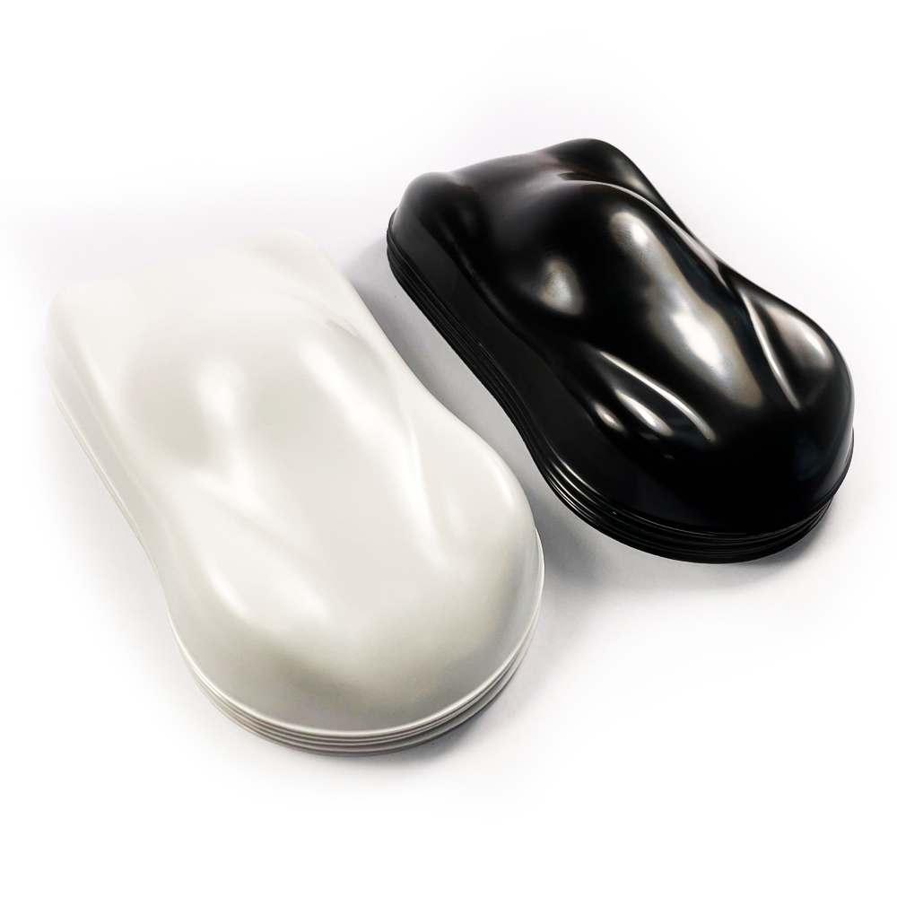

Mike 1017 Posted July 16, 2022 Posted July 16, 2022 I use Speed Shapes when I am experimenting with any sort of paint and primer combo. IMO plastic spoons are too small and not enough surface area. Example the spoon does not craze. Then you paint the car. Parts of the hood crazes and nothing else. The Speed Shapes are only a couple of dollars. They are as a big as a 1:24 body or a little more. Mike

peteski Posted July 19, 2022 Posted July 19, 2022 On 7/16/2022 at 6:12 PM, Mike 1017 said: I use Speed Shapes when I am experimenting with any sort of paint and primer combo. IMO plastic spoons are too small and not enough surface area. Example the spoon does not craze. Then you paint the car. Parts of the hood crazes and nothing else. The Speed Shapes are only a couple of dollars. They are as a big as a 1:24 body or a little more. Expand So you are implying that the speed shapes are made from the same polystyrene plastic as model kits? I have feeling that those speed shapes are not polystyrene, but I'll be happy if I'm wrong. As for plastic spoons, you have to select the correct ones. You need to find the ones made from polystyrene. The recycling symbol is "6". Majority of the inexpensive plastic spoons are polystyrene. They are also fairly brittle. But you can also find spoons that are much more flexible, made from Polypropylene. recycling symbol "5". Those are not affected by most paint solvents. To make things even more muddy, there are multiple formulas of polystyrene out there (just like for model car kits). Some are more resistant to hot solvents than others.

Mike 1017 Posted July 19, 2022 Posted July 19, 2022 On 7/19/2022 at 1:19 AM, peteski said: So you are implying that the speed shapes are made from the same polystyrene plastic as model kits? I have feeling that those speed shapes are not polystyrene, but I'll be happy if I'm wrong. As for plastic spoons, you have to select the correct ones. You need to find the ones made from polystyrene. The recycling symbol is "6". Majority of the inexpensive plastic spoons are polystyrene. They are also fairly brittle. But you can also find spoons that are much more flexible, made from Polypropylene. recycling symbol "5". Those are not affected by most paint solvents. To make things even more muddy, there are multiple formulas of polystyrene out there (just like for model car kits). Some are more resistant to hot solvents than others. Expand My point is that there is not enough surface on a spoon to get an accurate feed back We've developed this massive, high impact Polystyrene Speed Shape to give you the best possible surface for testing and display. The larger surface area and curves, over our original Speed Shapes, will help bring out some of the colors and finish details that could be too subtle to notice on the smaller shapes. Mike
Mike 1017 Posted July 19, 2022 Posted July 19, 2022 On 7/18/2022 at 9:35 PM, martinfan5 said: Where do you get these from? Expand Amazon . They do come in different sizes so pay attention to what you order Mike 1
Mike 1017 Posted July 19, 2022 Posted July 19, 2022 On 7/19/2022 at 3:06 PM, Mike 1017 said: My point is that there is not enough surface on a spoon to get an accurate feed back We've developed this massive, high impact Polystyrene Speed Shape to give you the best possible surface for testing and display. The larger surface area and curves, over our original Speed Shapes, will help bring out some of the colors and finish details that could be too subtle to notice on the smaller shapes. Mike Expand Speed Shapes - Perfect For Testing Plasti Dip® Car Paint | DipYourCar – DipYourCar.com 1
Plowboy Posted July 19, 2022 Posted July 19, 2022 On 7/16/2022 at 6:12 PM, Mike 1017 said: I use Speed Shapes when I am experimenting with any sort of paint and primer combo. IMO plastic spoons are too small and not enough surface area. Example the spoon does not craze. Then you paint the car. Parts of the hood crazes and nothing else. The Speed Shapes are only a couple of dollars. They are as a big as a 1:24 body or a little more. Mike Expand I can see where these would be very beneficial. Especially if one wanted to test color combos. I've seen them before and have meant to get a few to have on hand. But, haven't yet.
