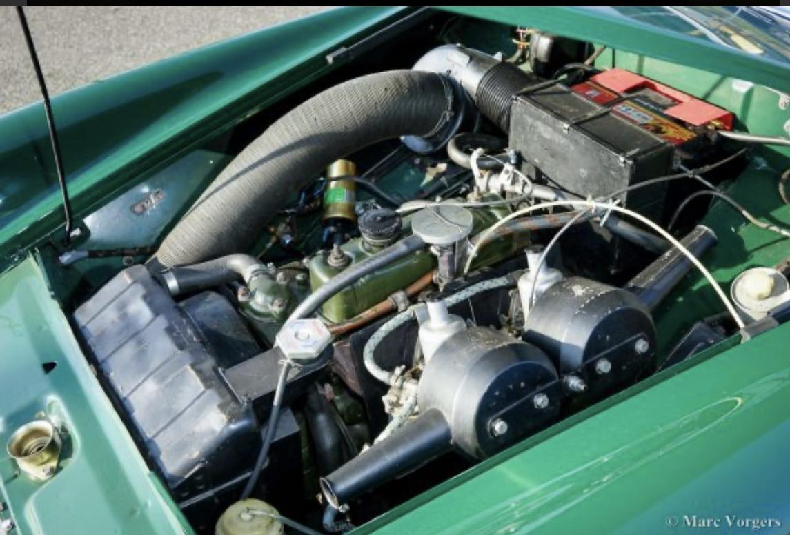

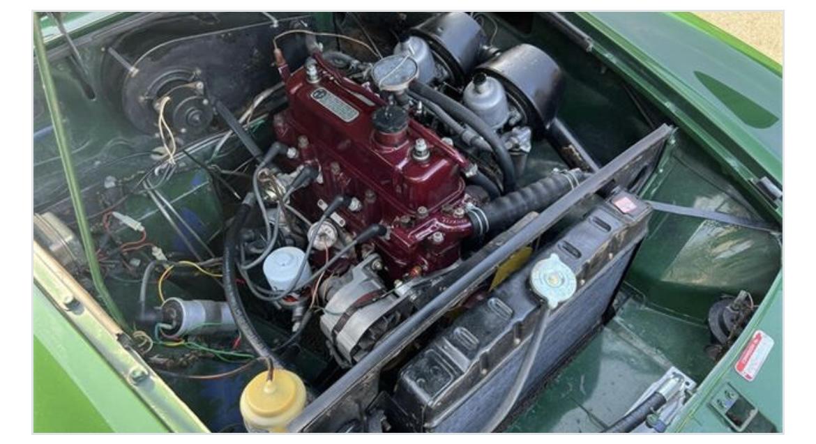

Paint will be Tartan red and the interior is black. The engine was a green and the one change I I’m going to make is adding a heater box… mine didn’t have one and it made winter driving a challenge, that’s the reason I traded it off.

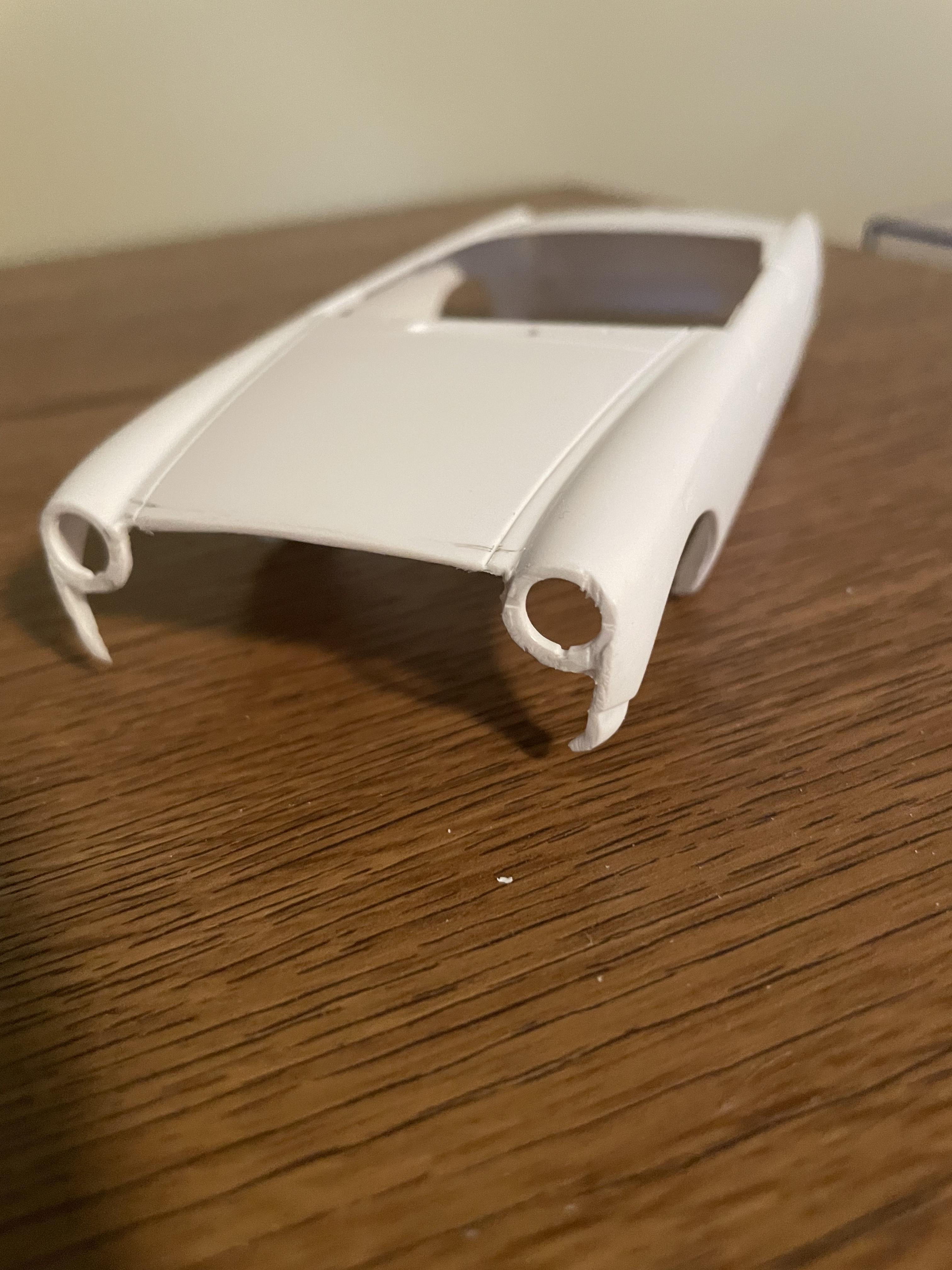

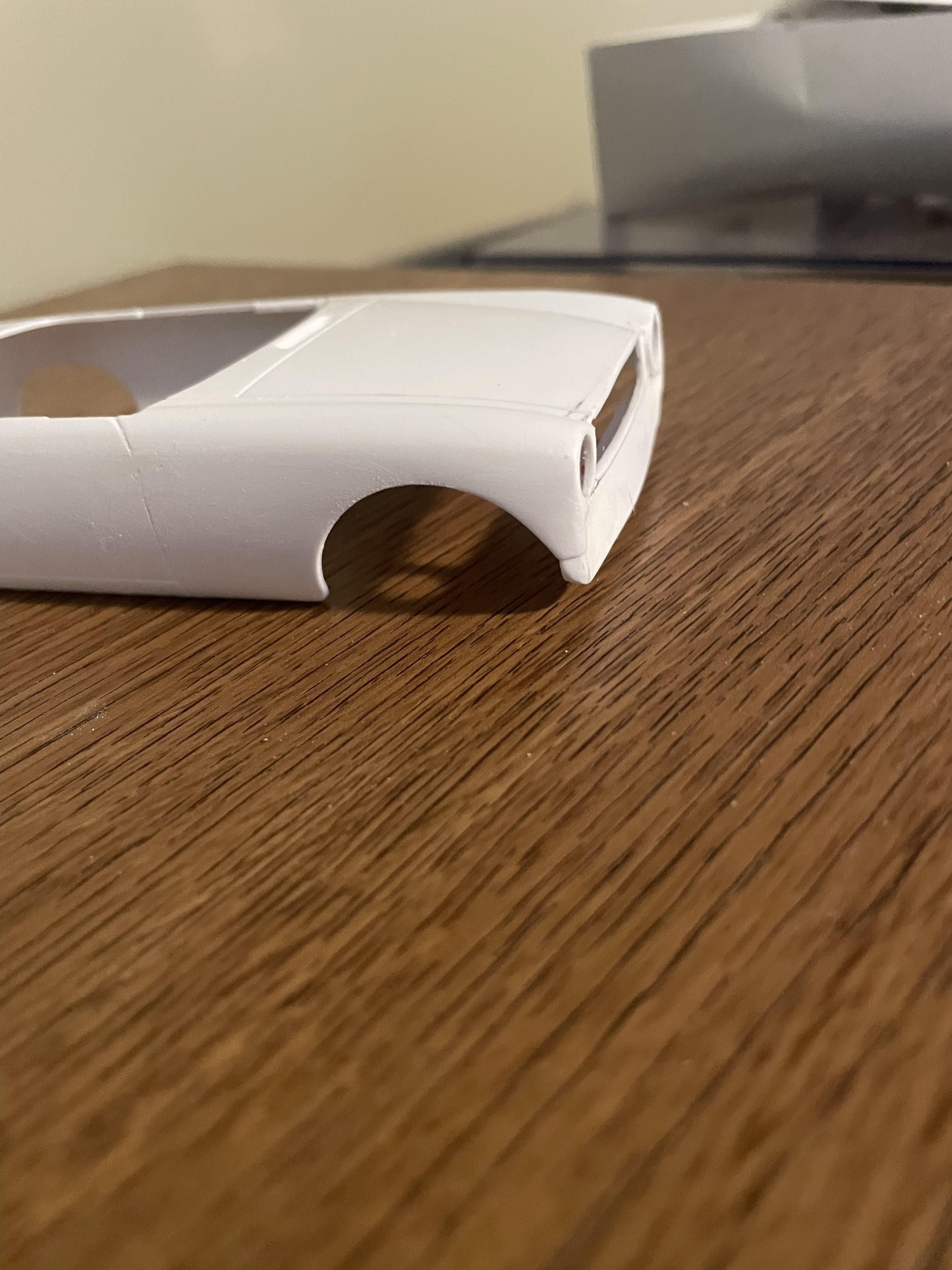

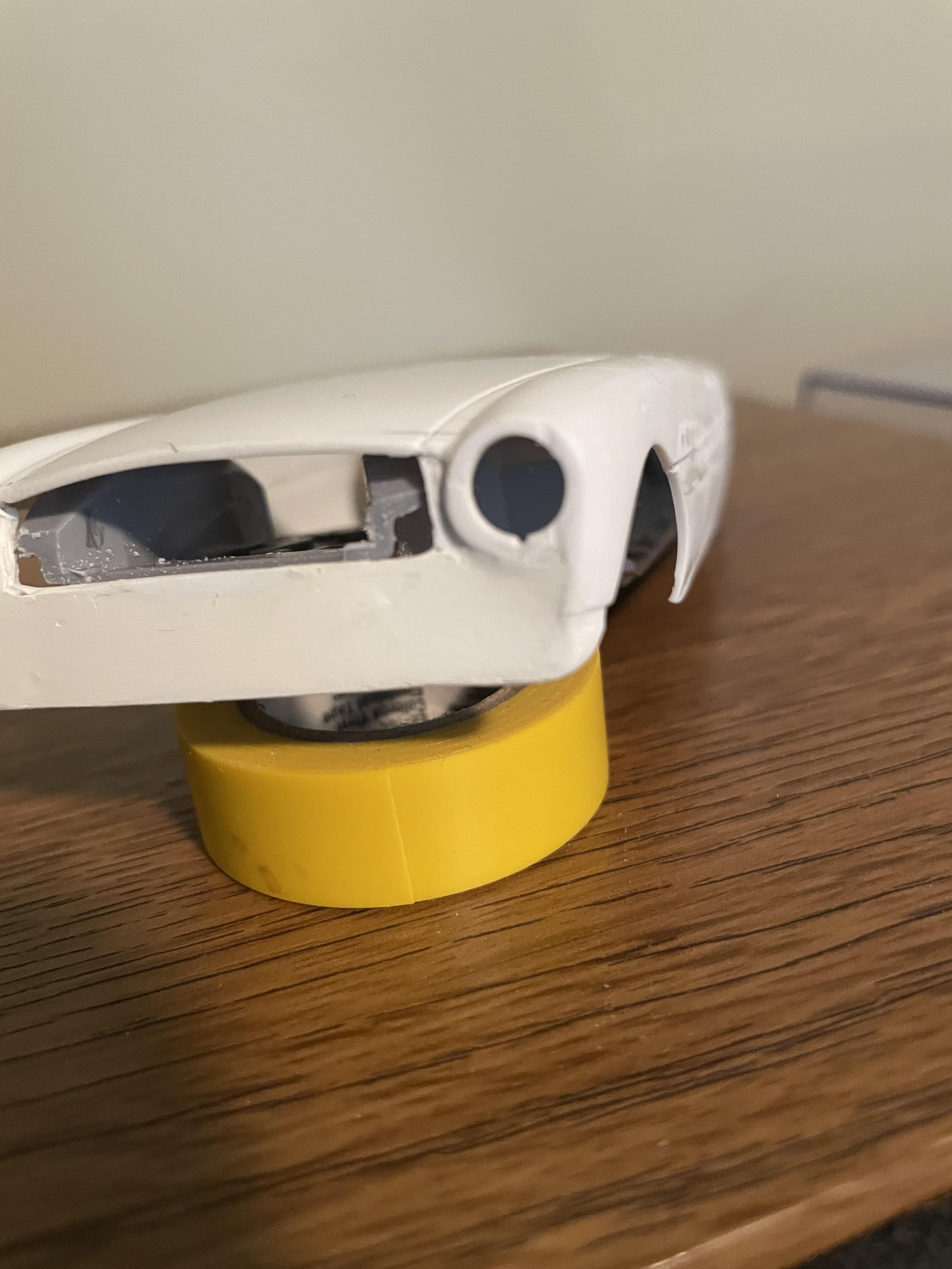

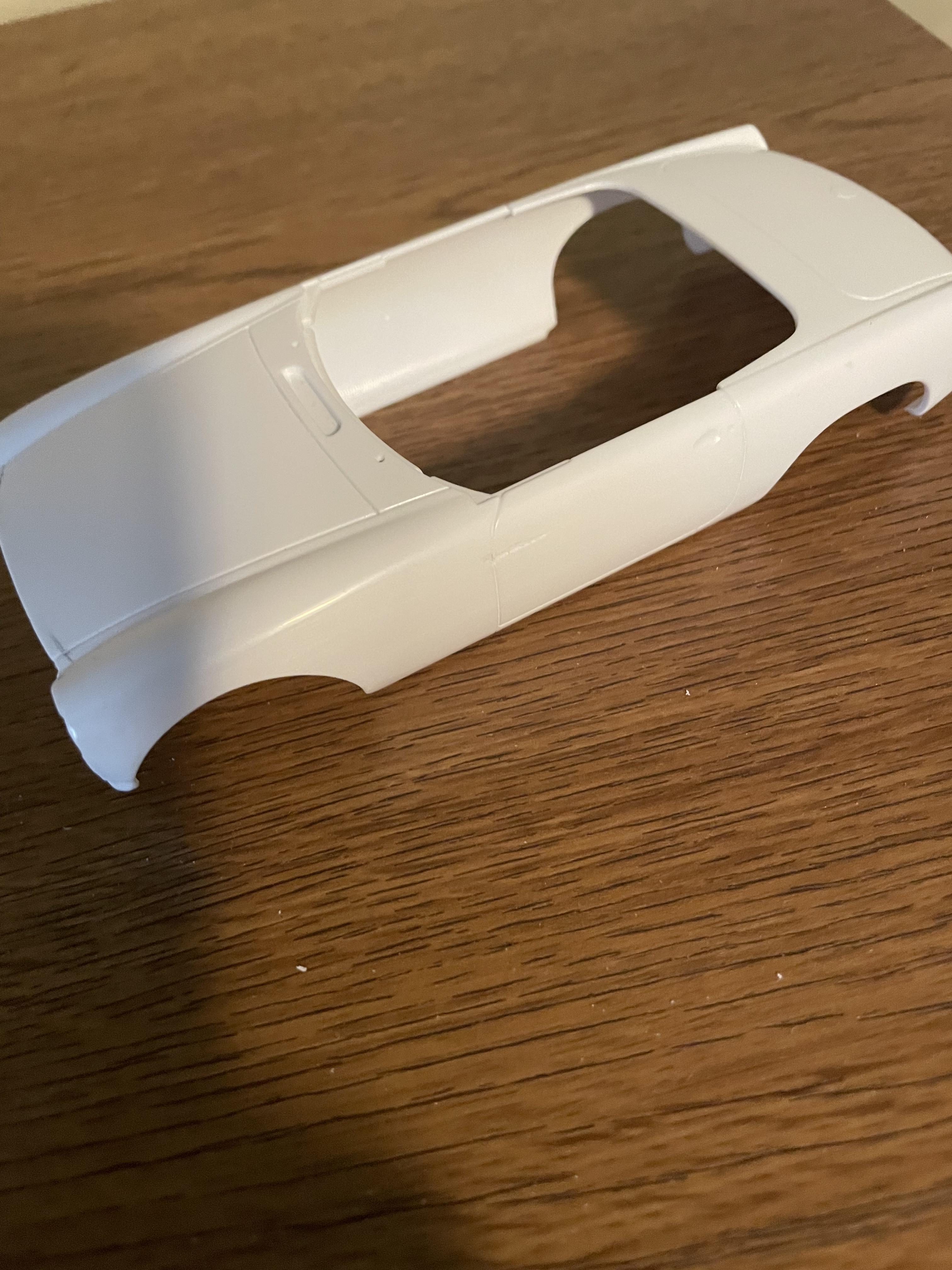

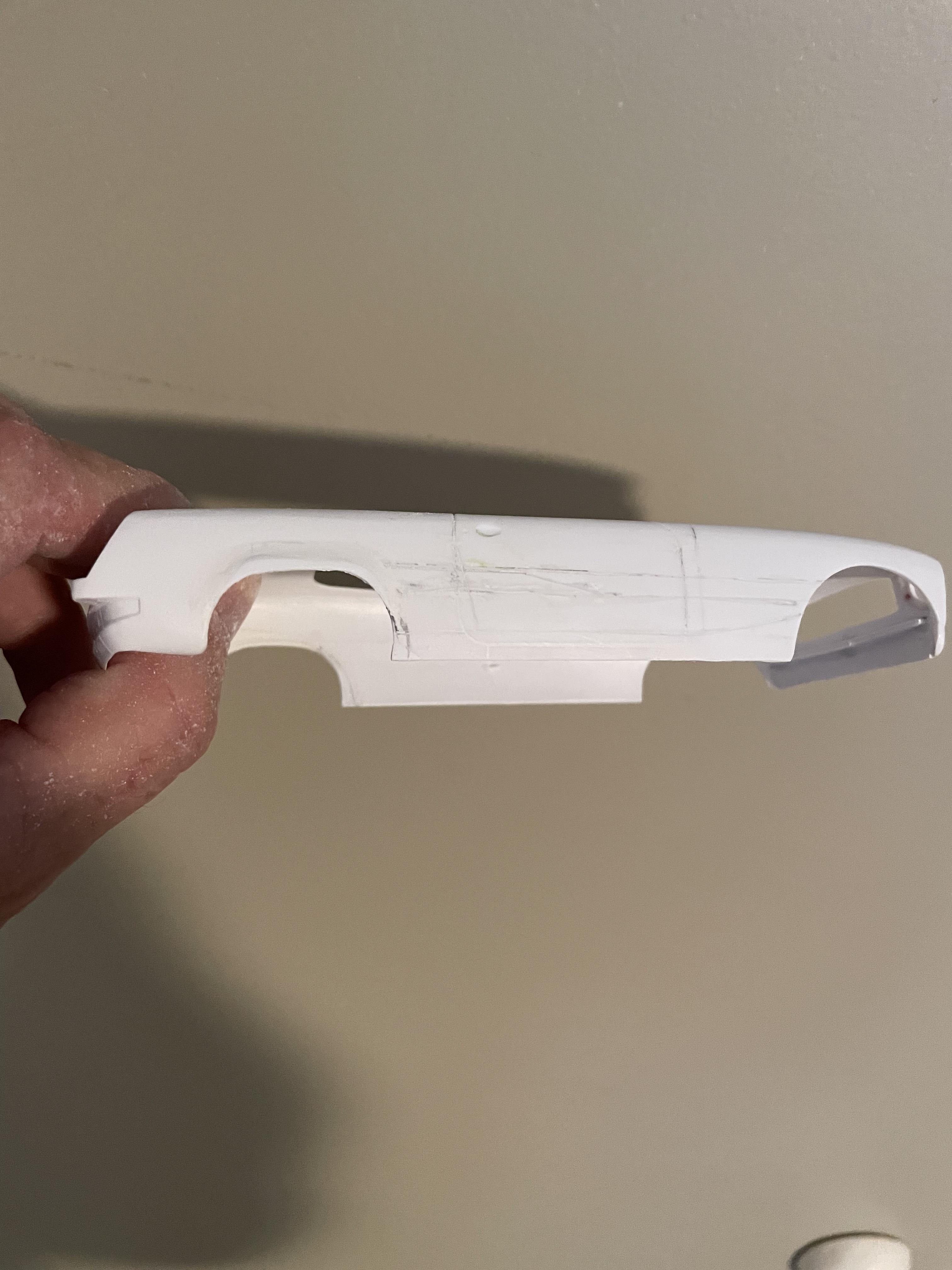

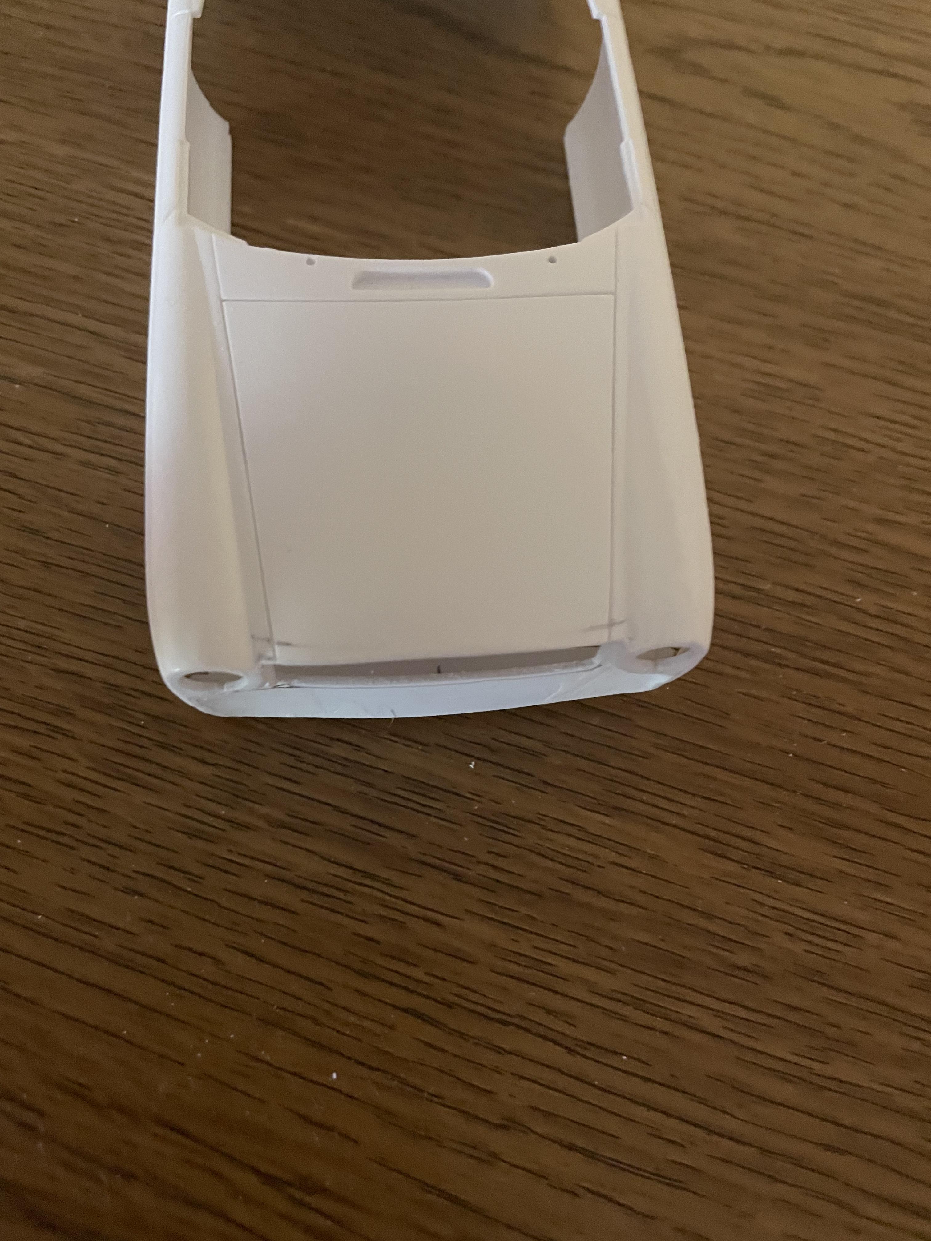

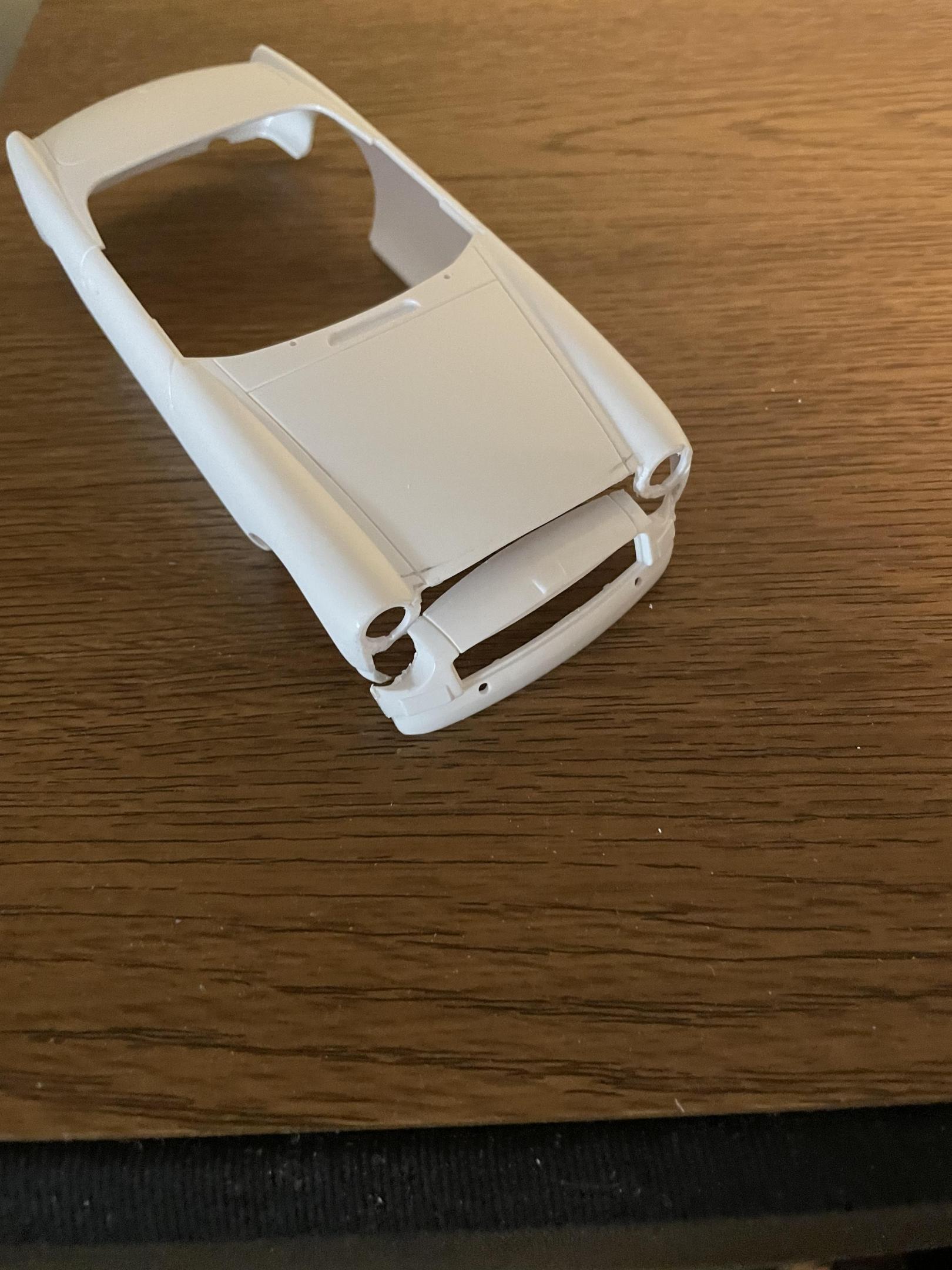

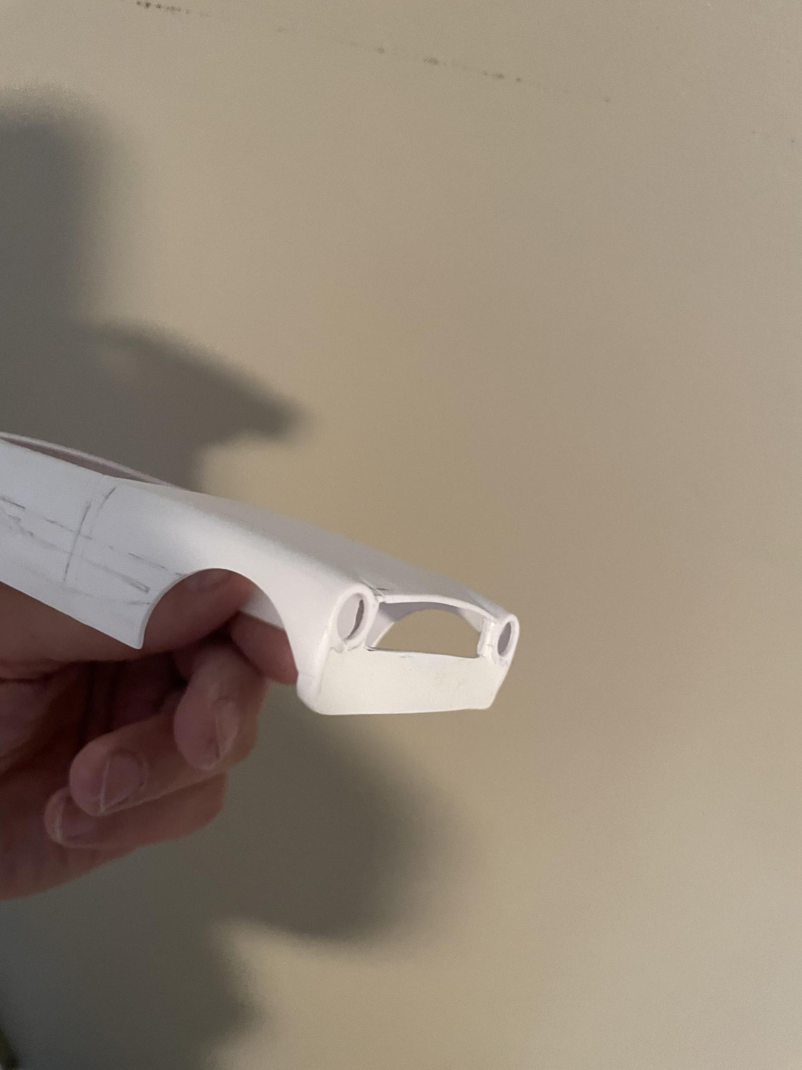

I forgot to take a picture of the body before I started hacking but got the front cut off and the side molding shaved down. I’ve cut out a piece of styrene for the front and have that glued up with a back brace to create a slight curve to it. With the side molding shaved off, the sides already seem a bit flatter, there is a section along the bottom of the body that curves in and I’m thinking that if I remove it I may be able to leave the sides alone. That would put the width off a little to scale but I’m okay with that if it looks good.

It already looks a bit Midget-like with the front chopped off. I built the B a couple years ago, and during final assembly I was constantly struck by how much the back half of the thing looked like a Midget.

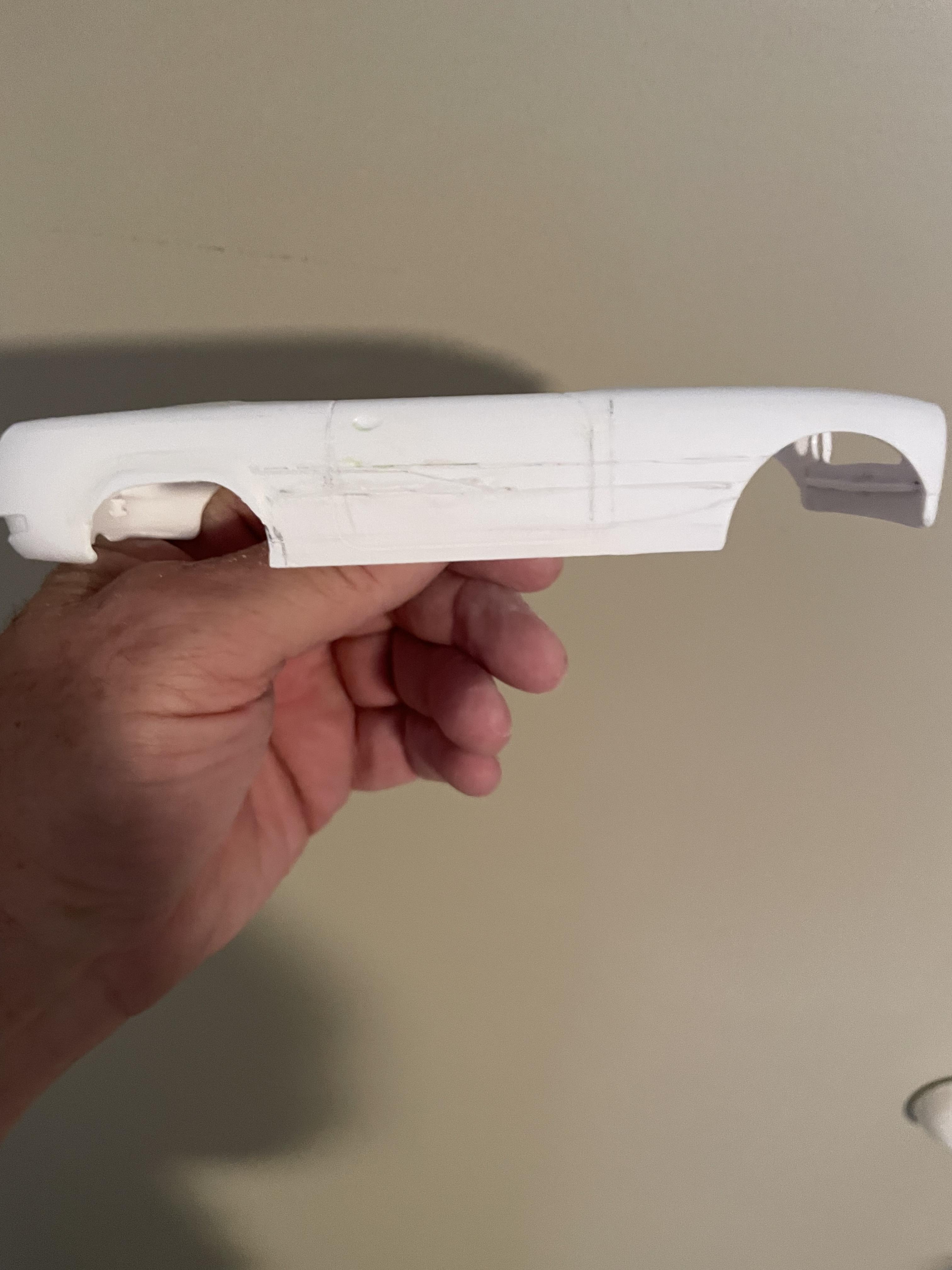

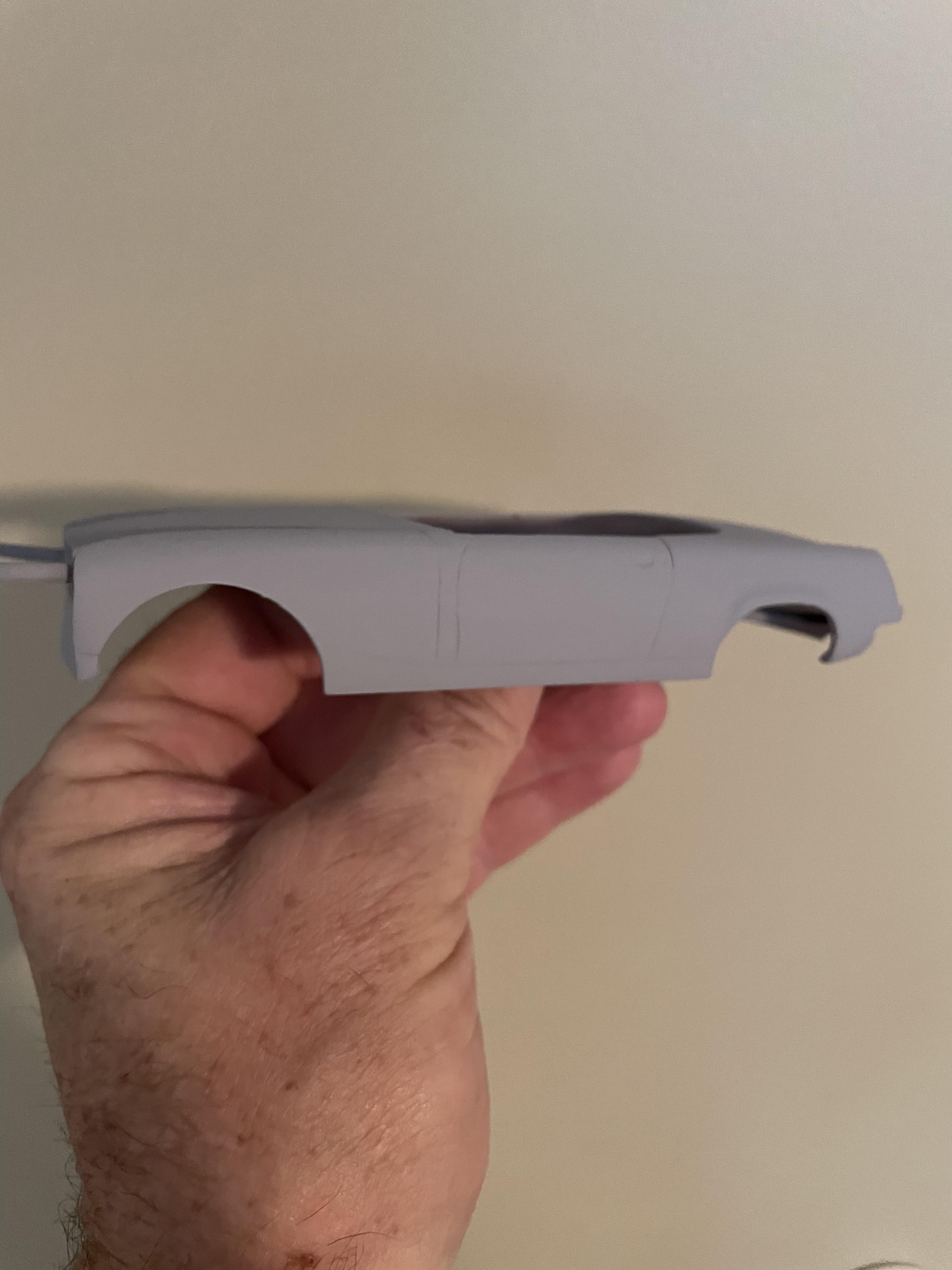

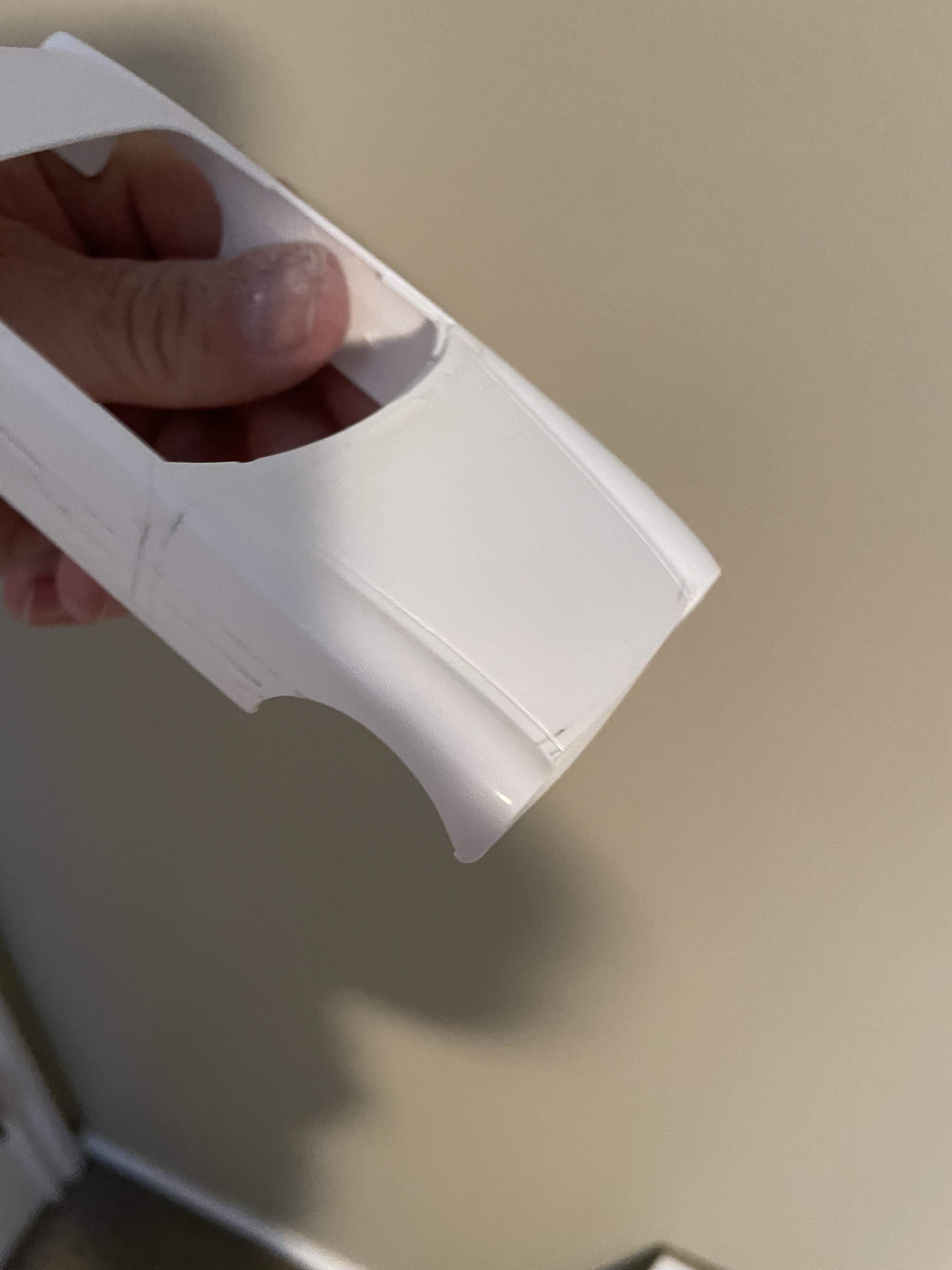

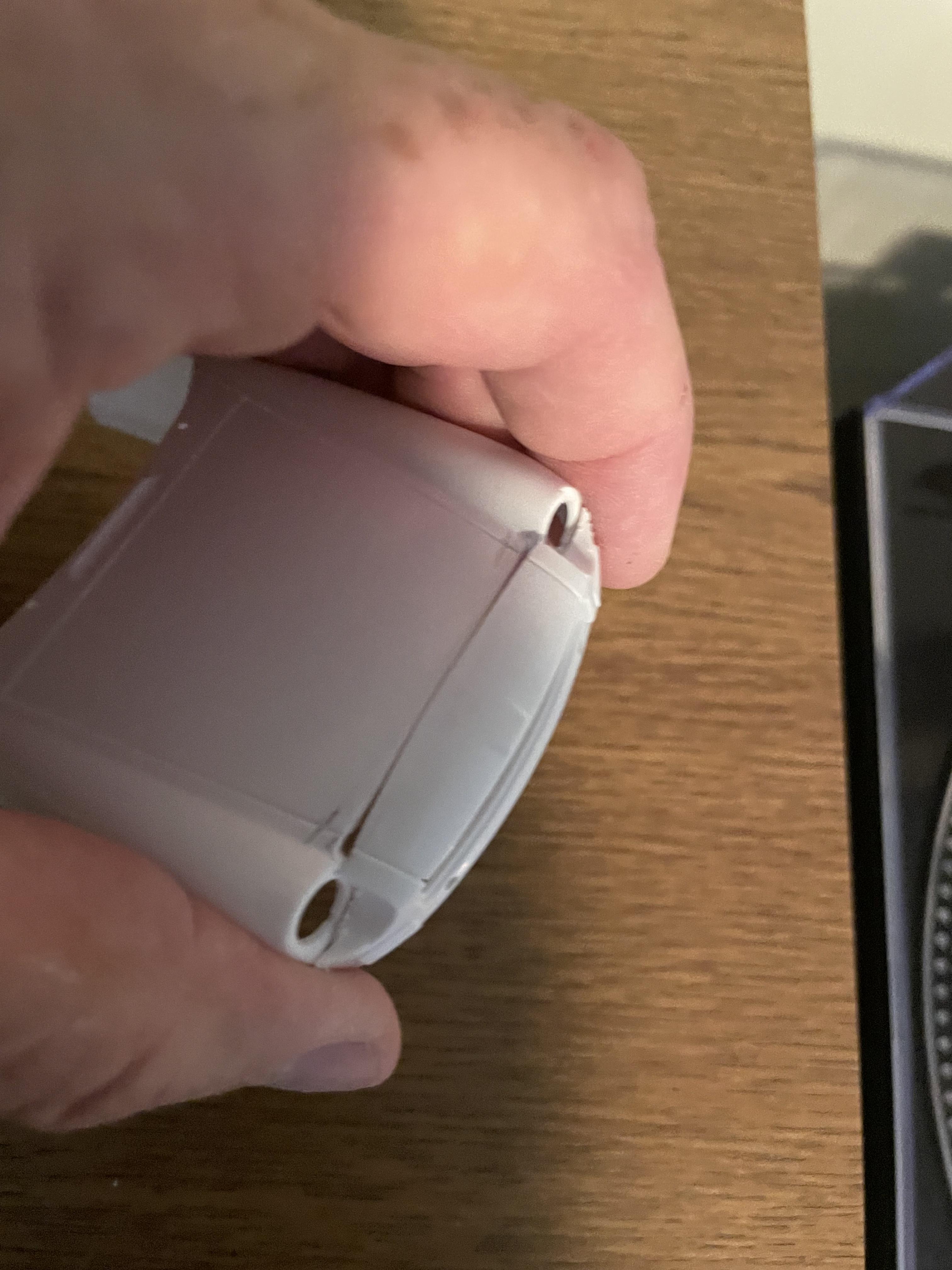

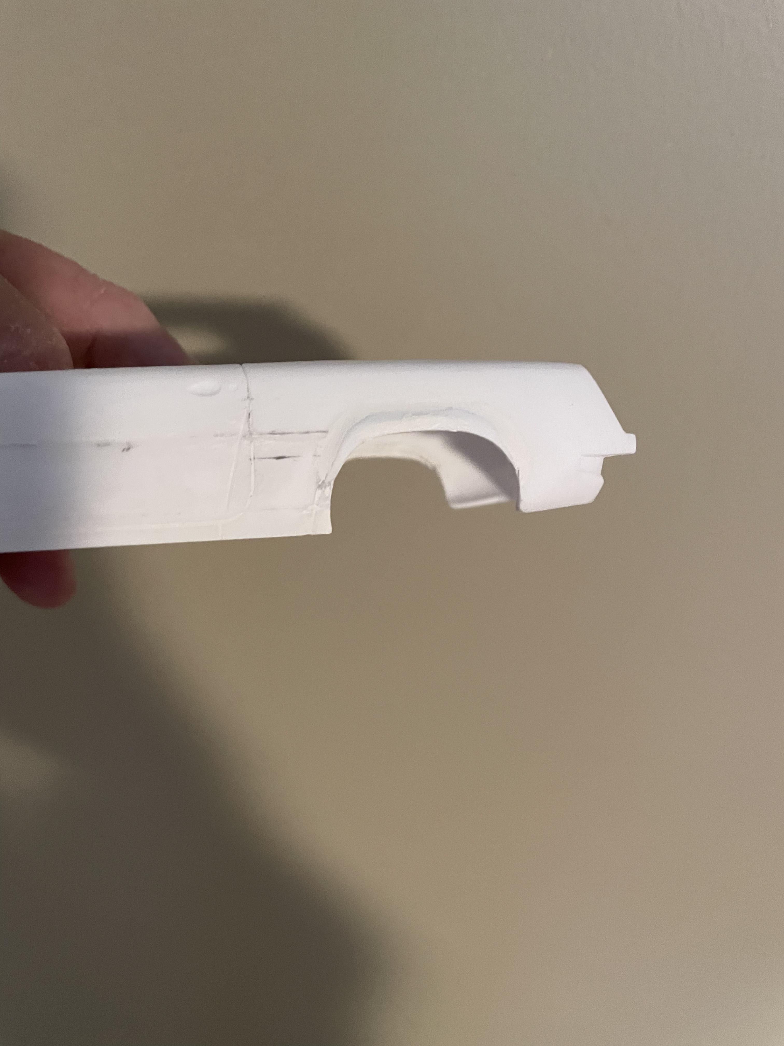

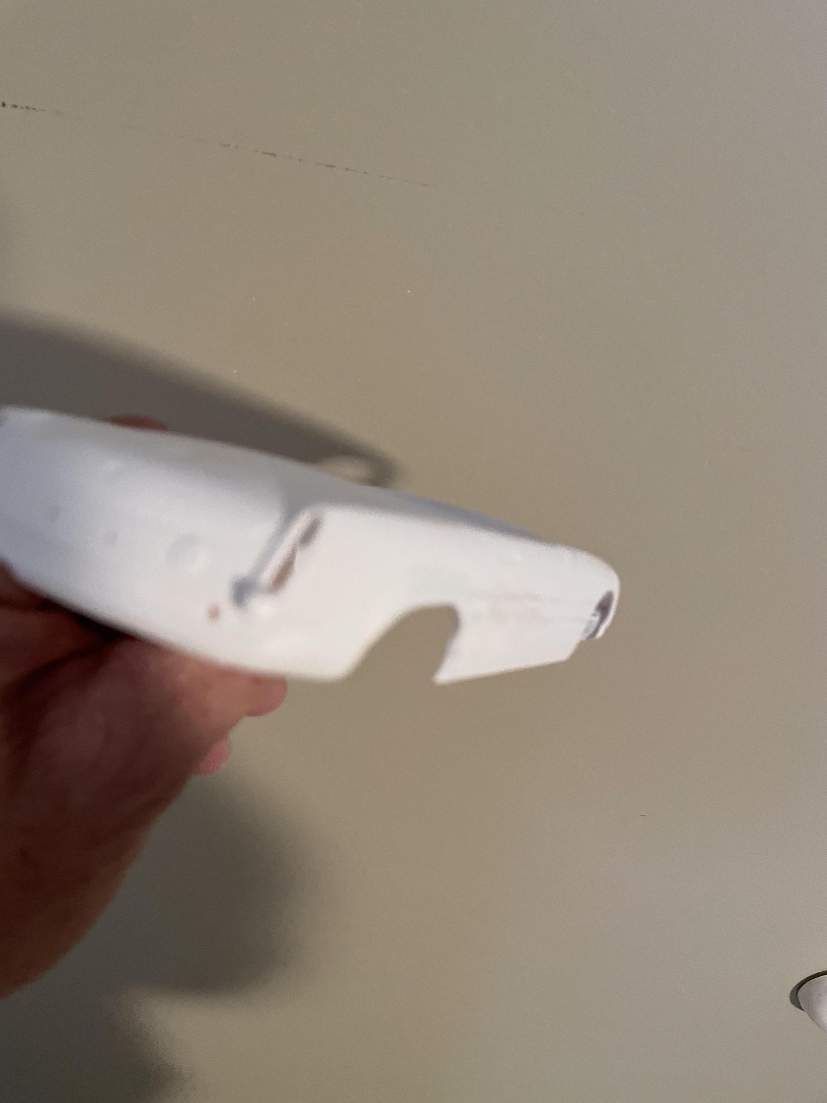

I cut the body down the side in two lines  but not all the way through, I then veed the lines out and glued them to straighten out the body curvature to more match the midget.
Next I cut off the very bottom of the body panels to eliminate them from tucking under to the frame.
I’ve made an executive decision though, I’m not going to try and narrow the body. It won’t be to scale but I think I can live with that.
Dave.

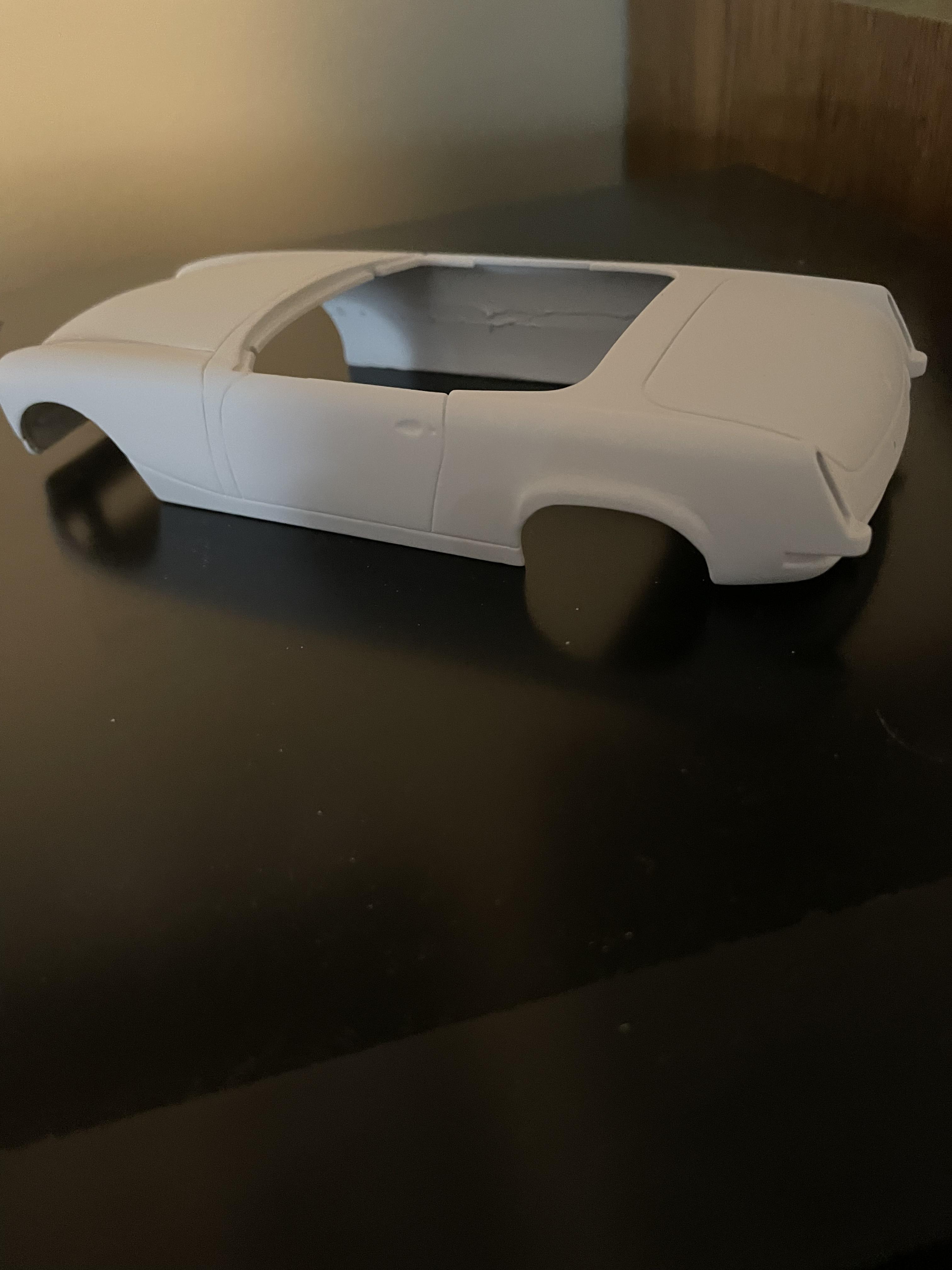

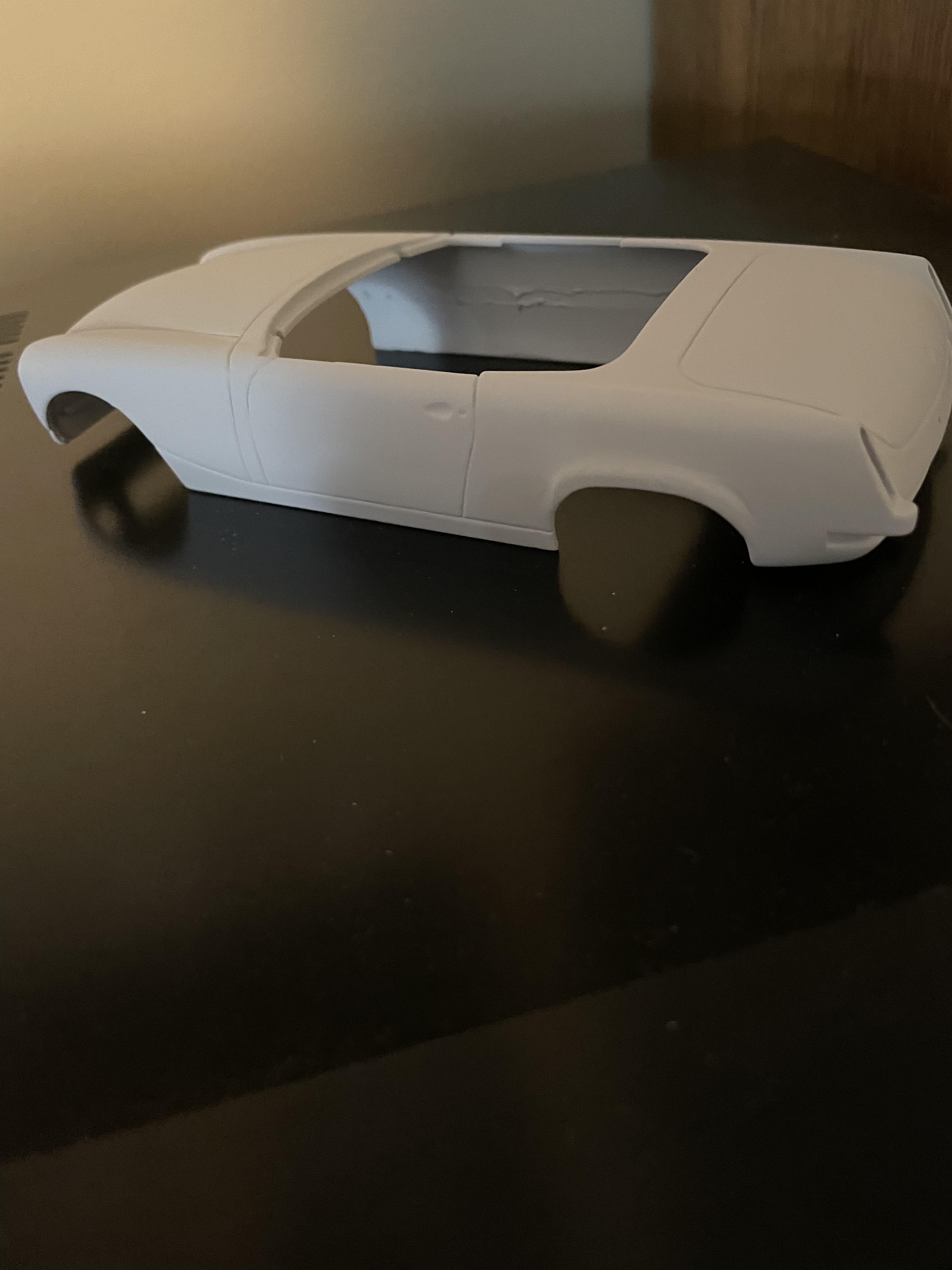

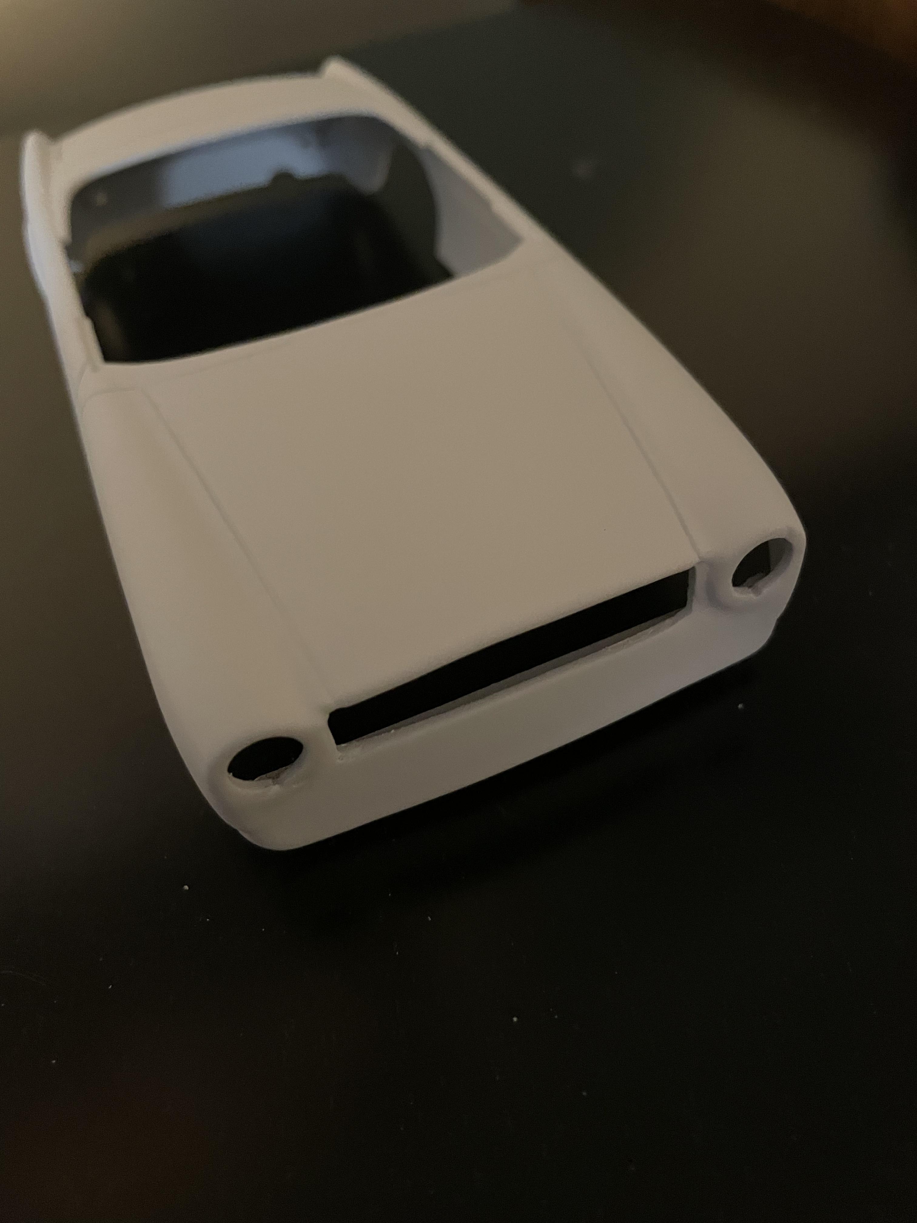

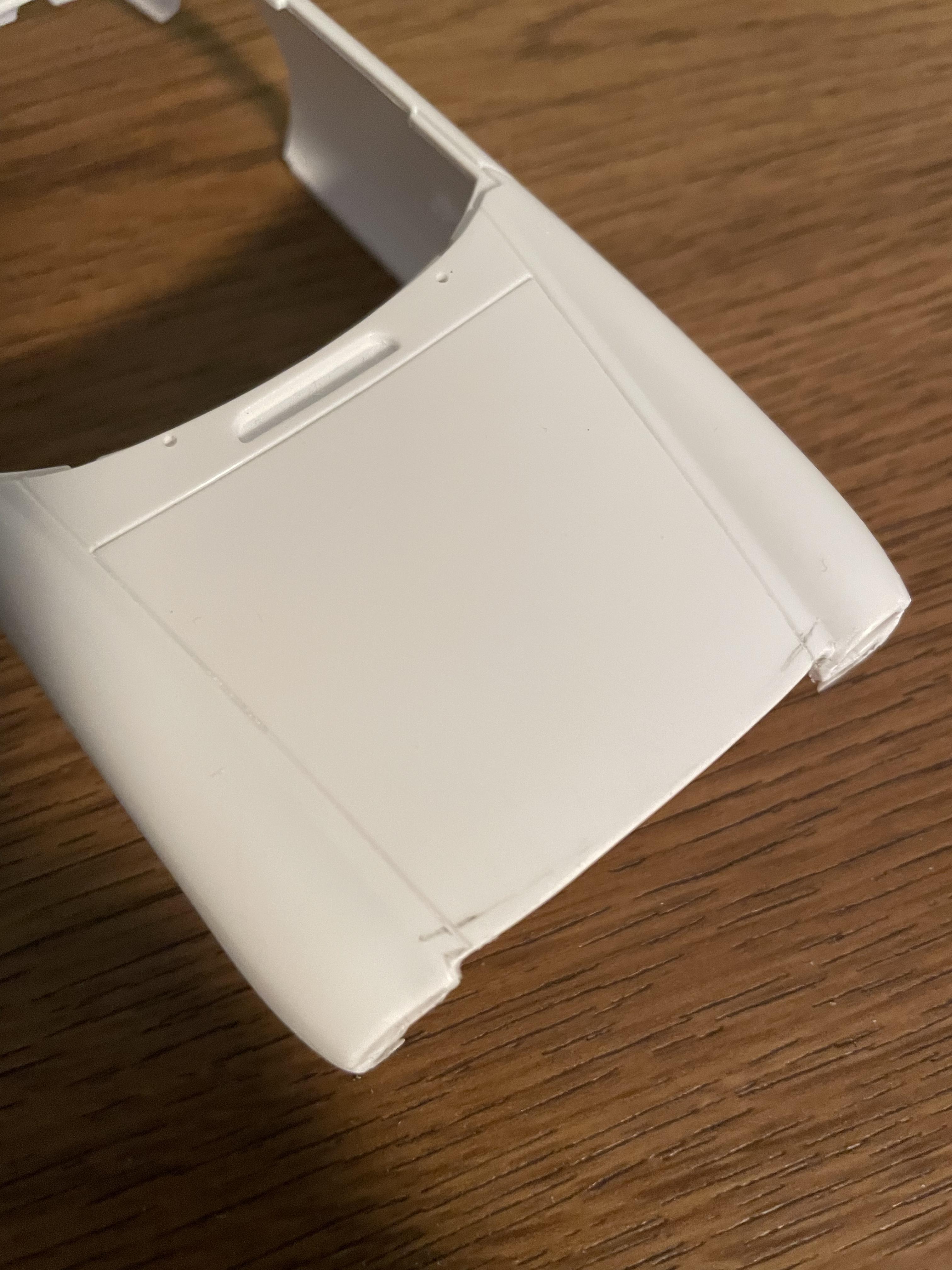

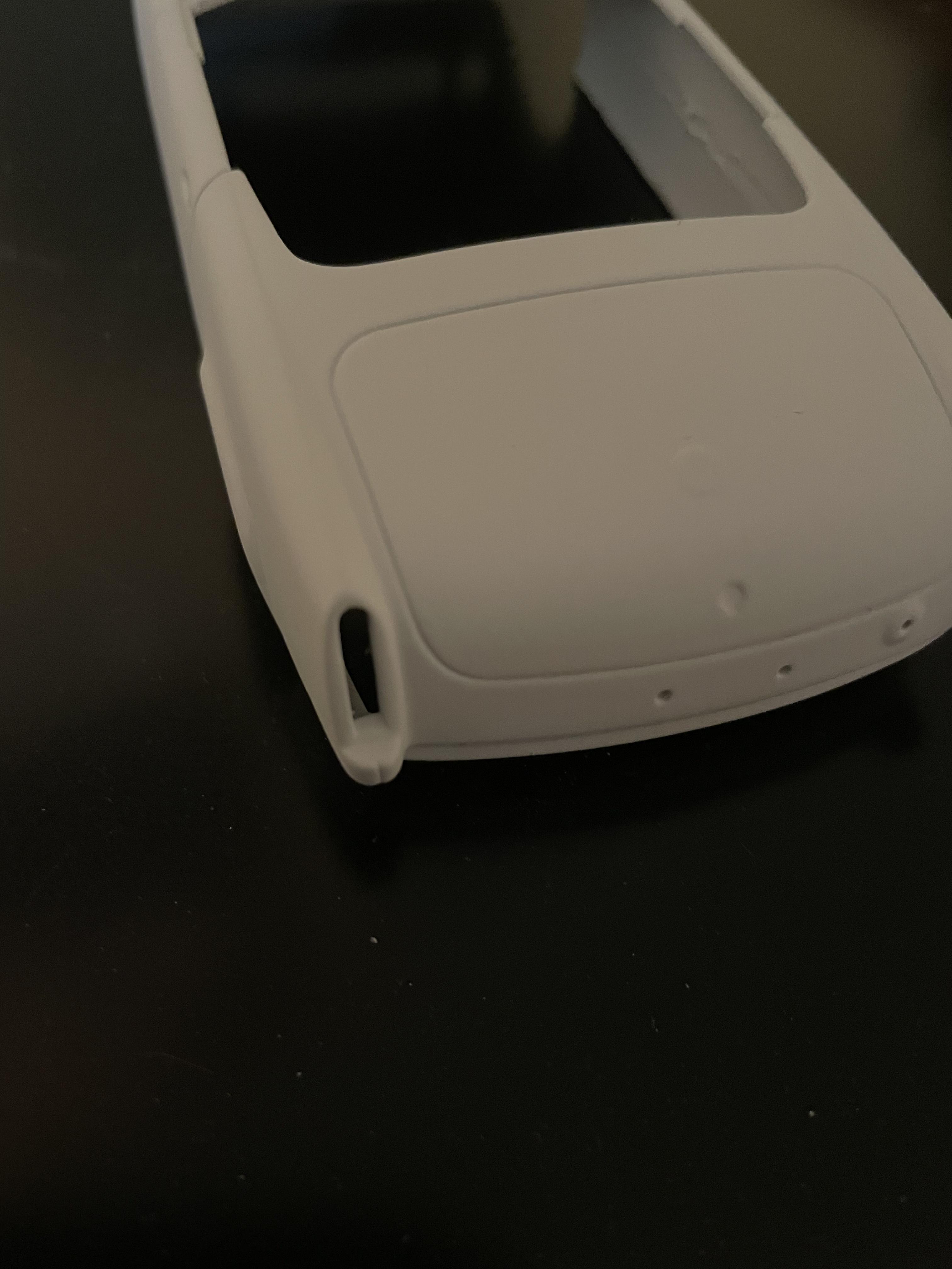

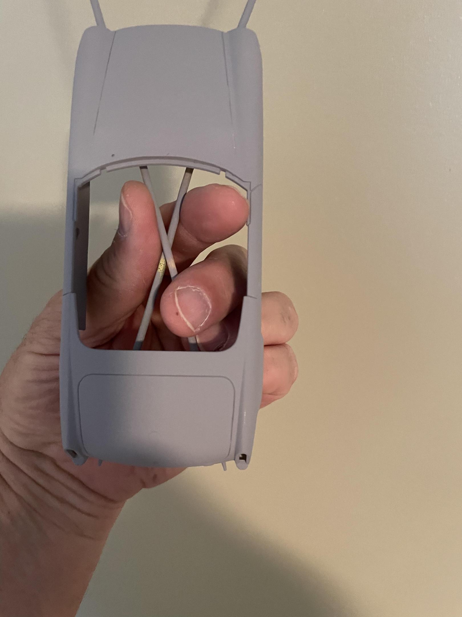

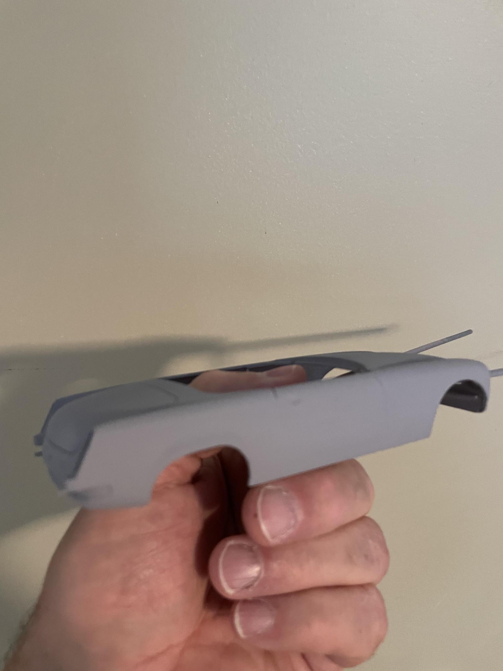

All of the body mods that I’m going to do are done. Added the rear fender flares and have filled, sanded and filled some more.
I’ve got the basic panel lines scribed in lightly and they will take some more work. The front cowl isn’t exactly correct but it’ll do.

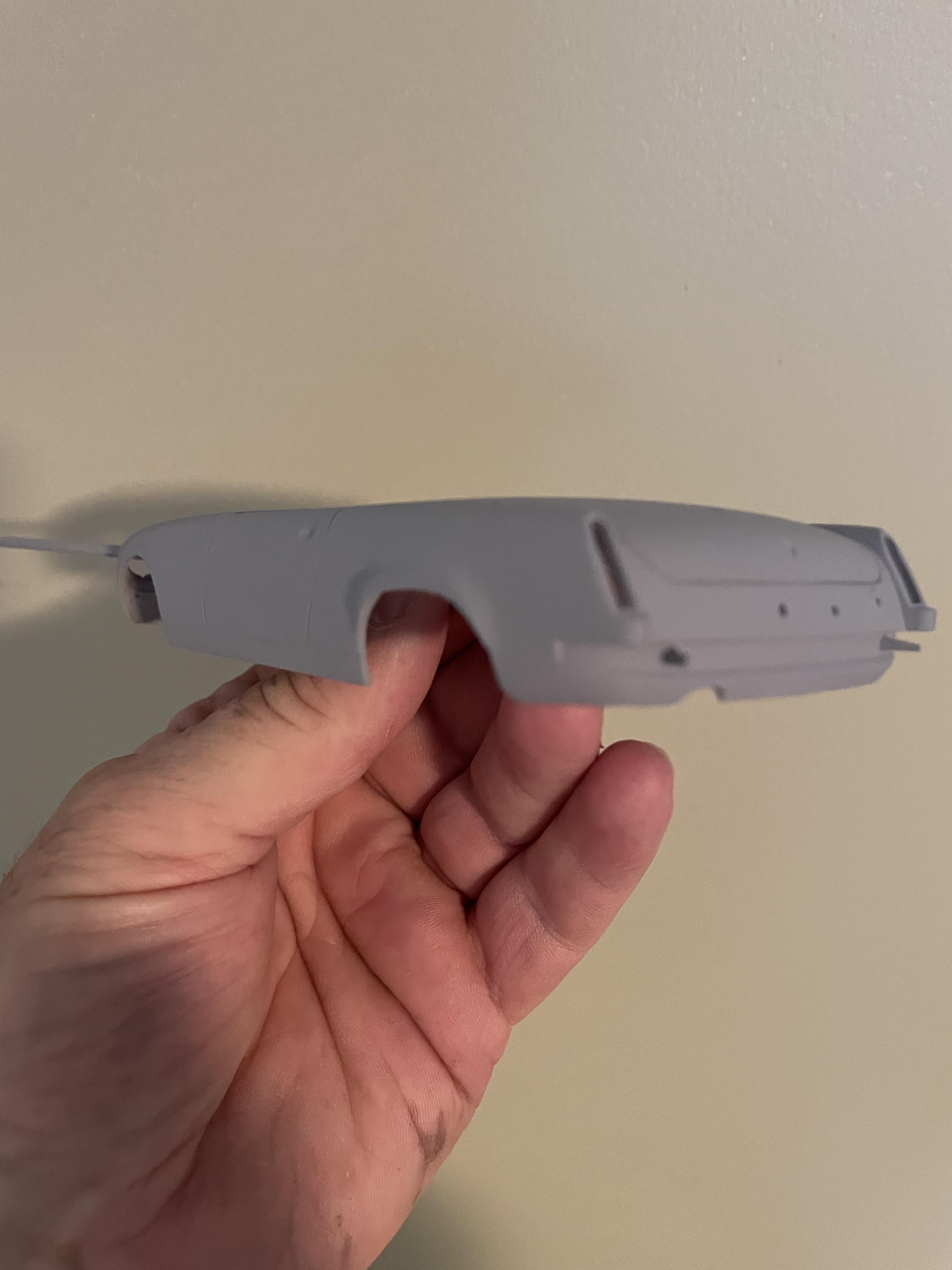

First primer coat on and now it’s just fine tuning and getting the panel lines finished.
Thanks for looking.
Dave.

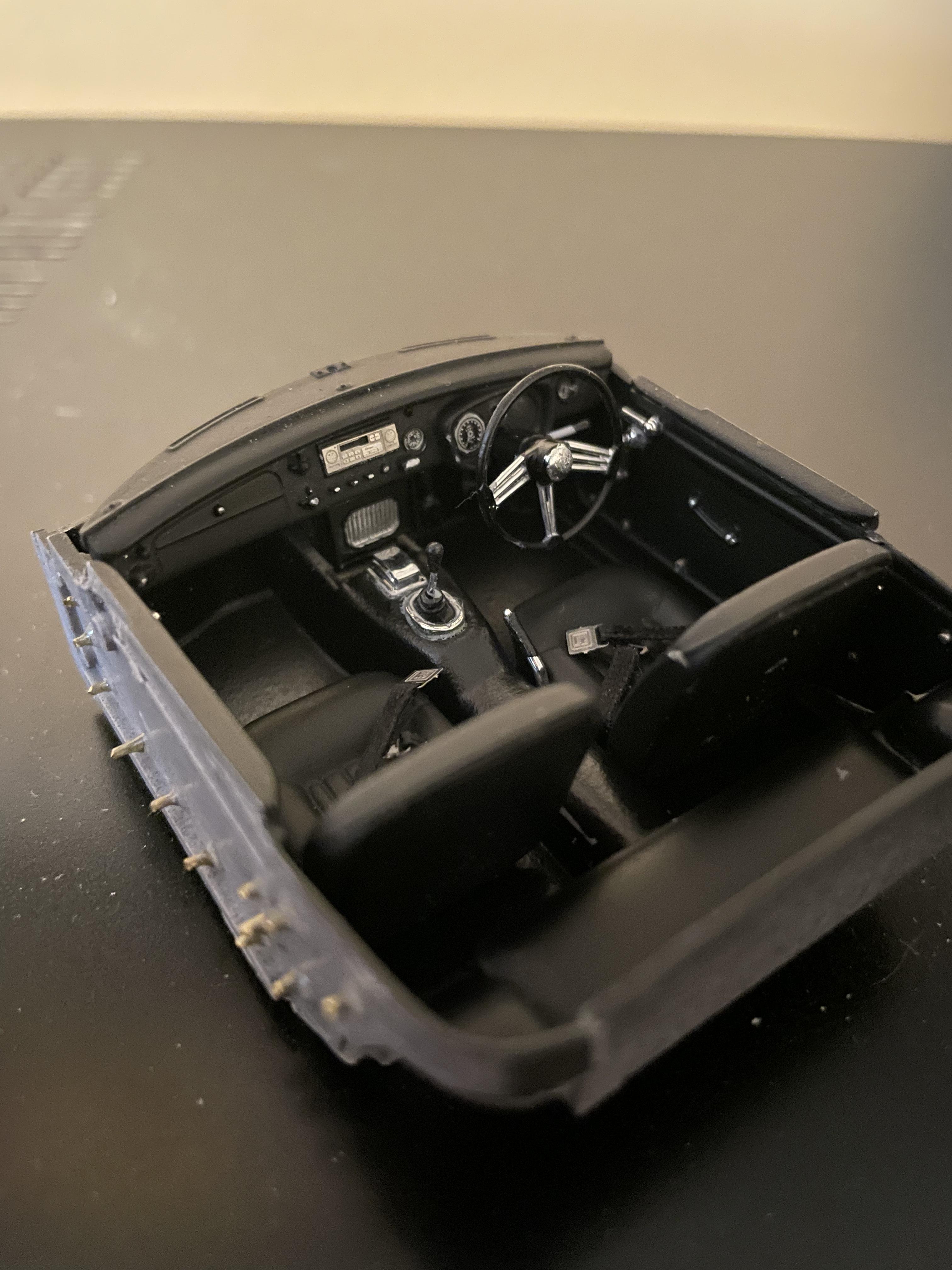

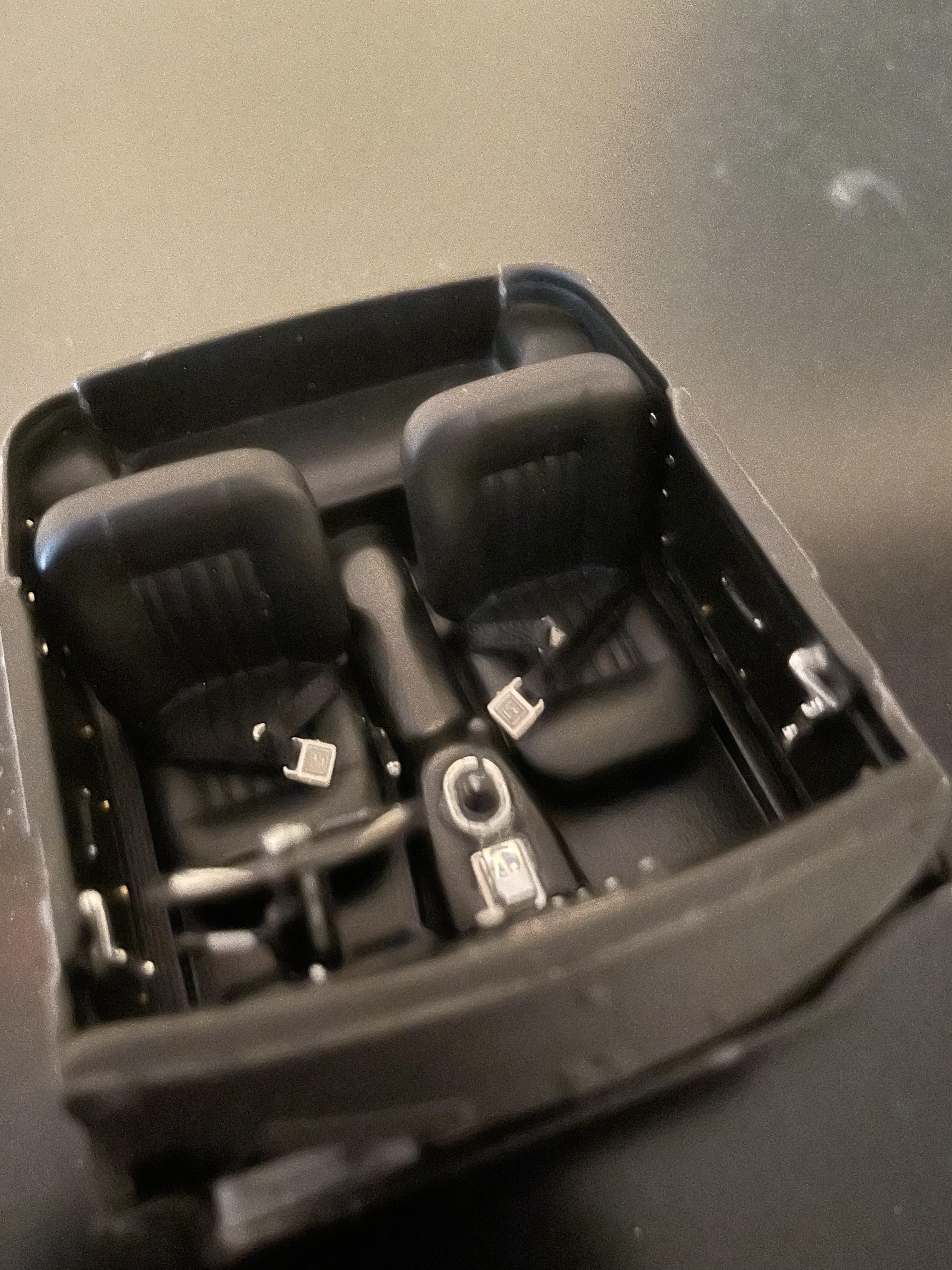

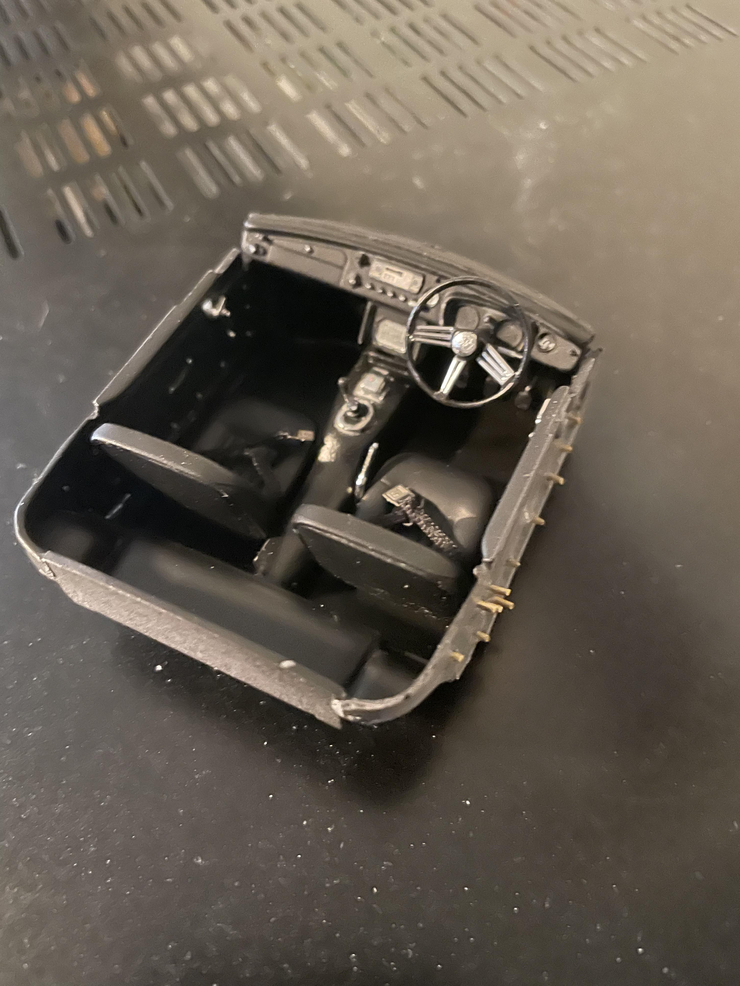

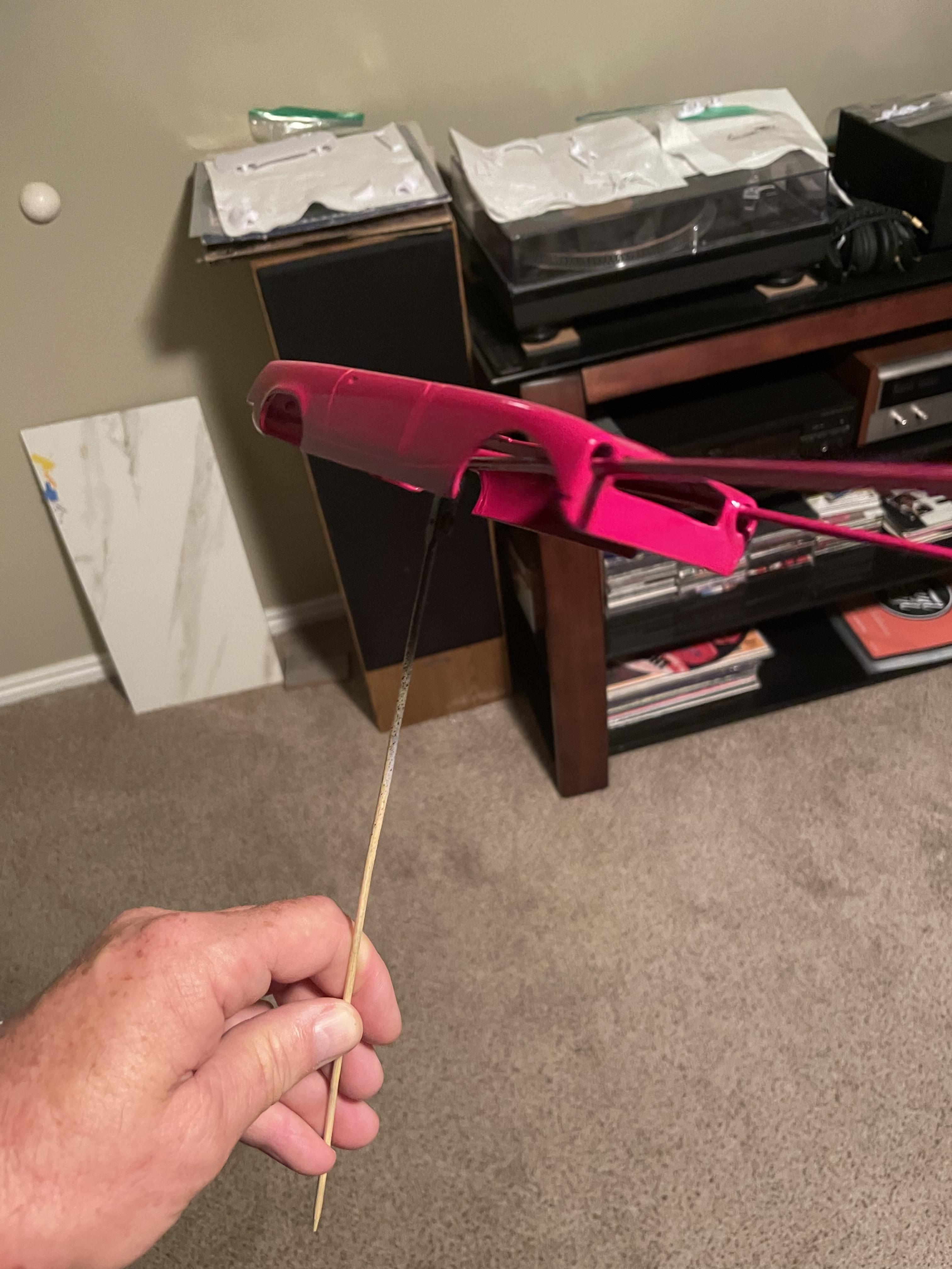

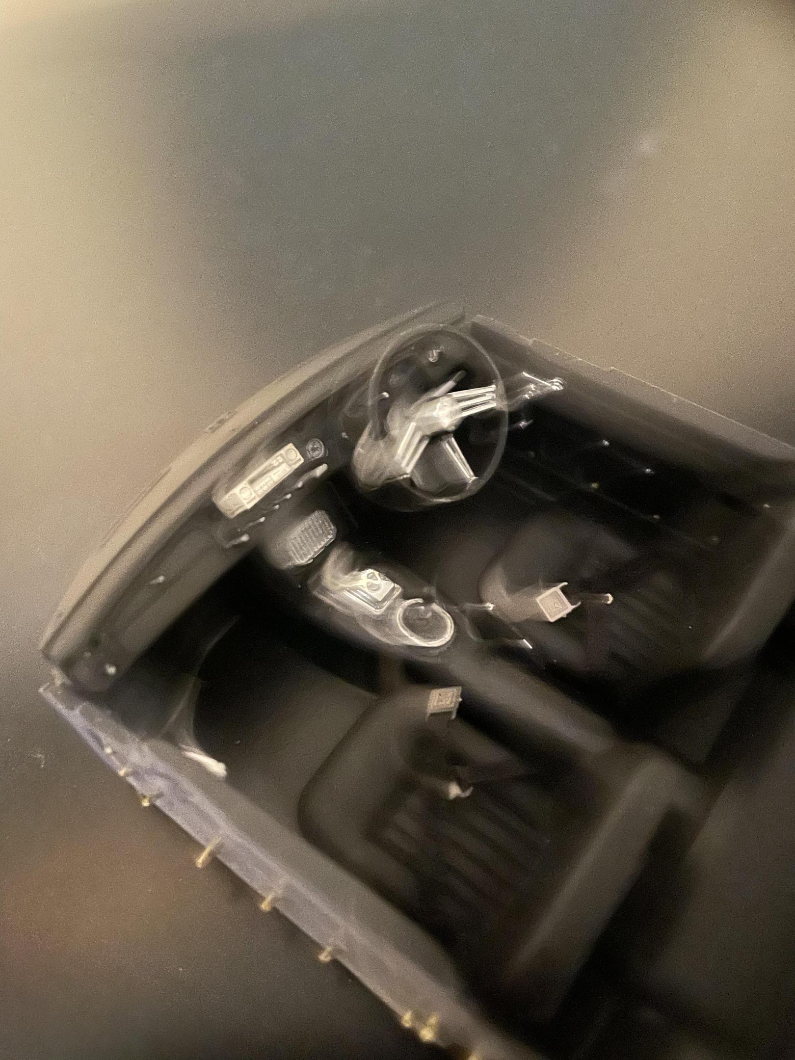

Interior is finished except for glueing the dash in, I’m going to hold off on that until I marry the chassis to the body. I didn’t want to try and paint all of the door card rivets, so they were drilled out and brass wire tipped with molotow were inserted and glued, I may need to file a bit off the backsides when it’s time for assembly.

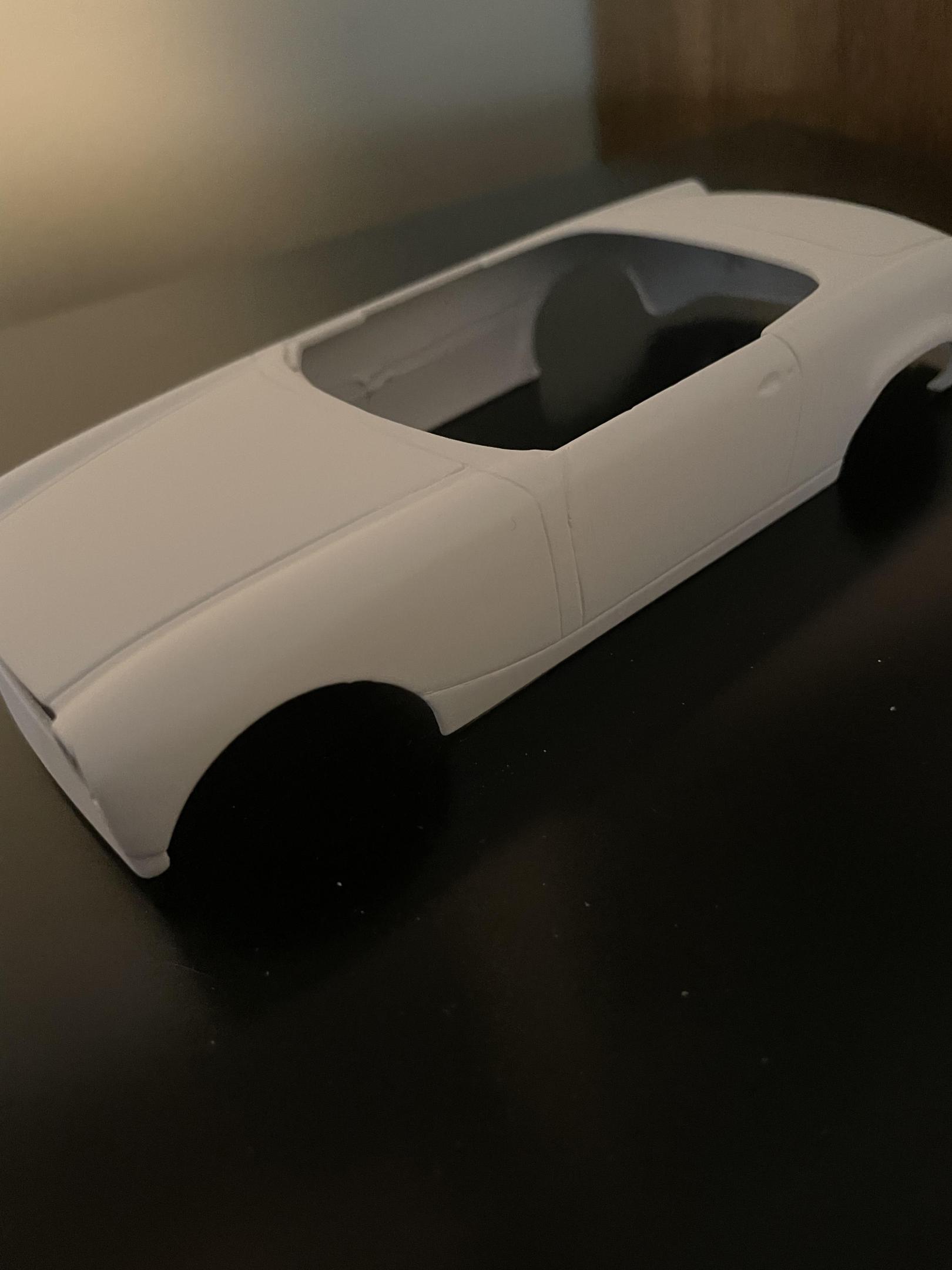

The body is in its second coat of white primer, still some areas that need fine tuning but the rear fender flares are coming together and all of the added panel lines are taking shape.

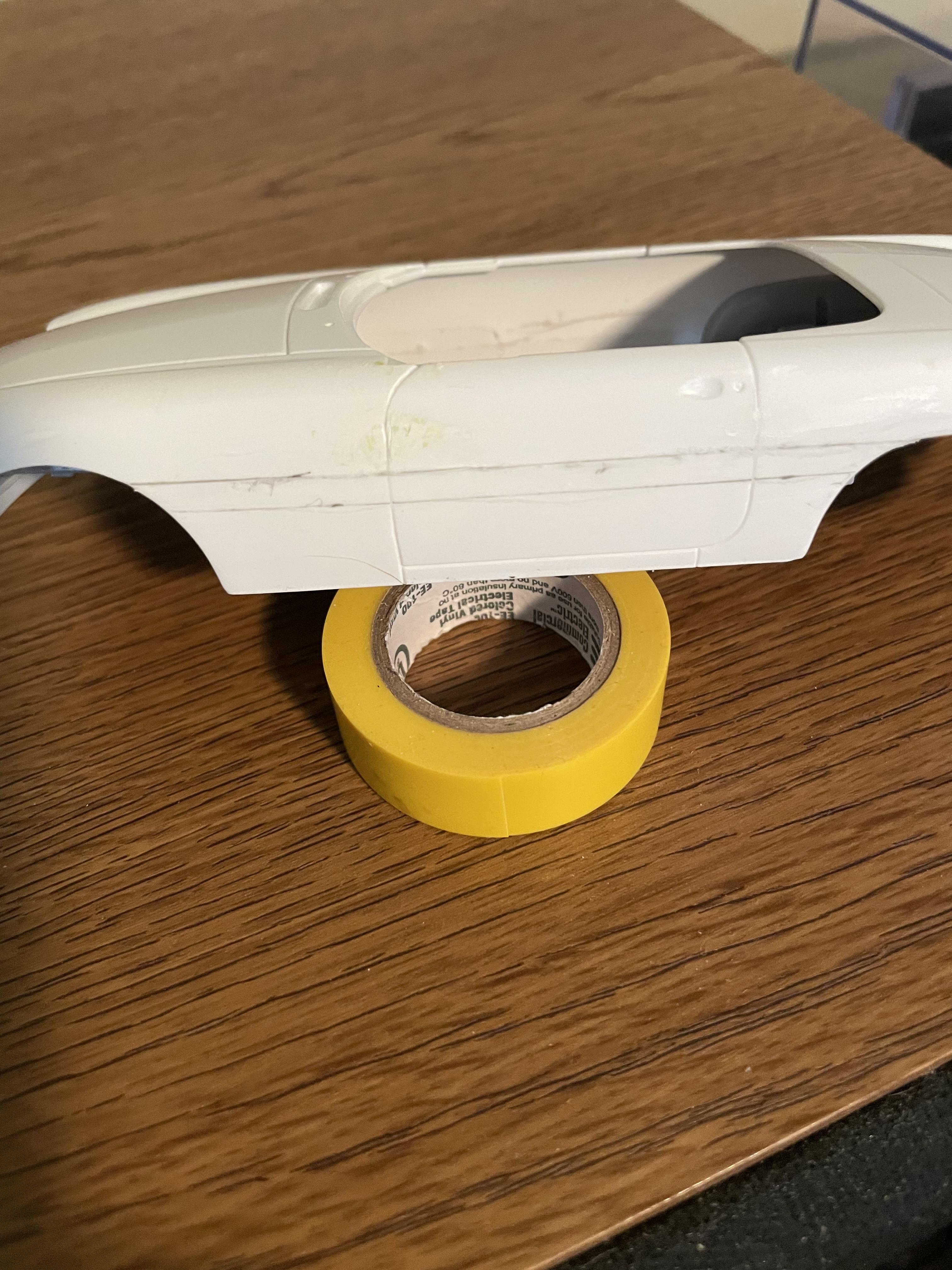

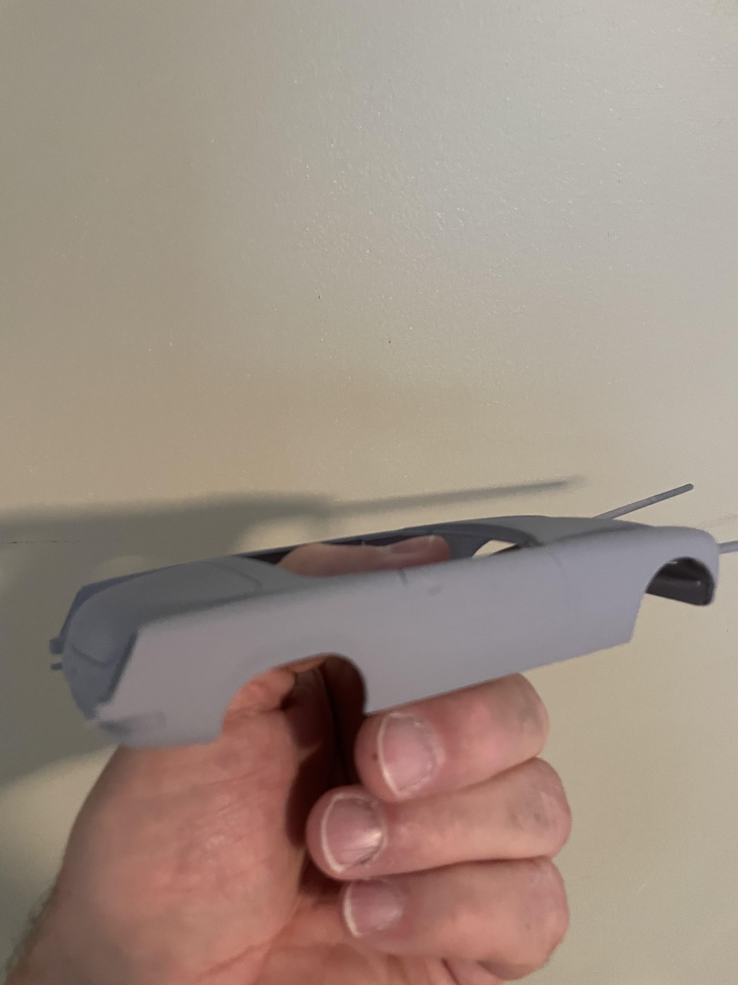

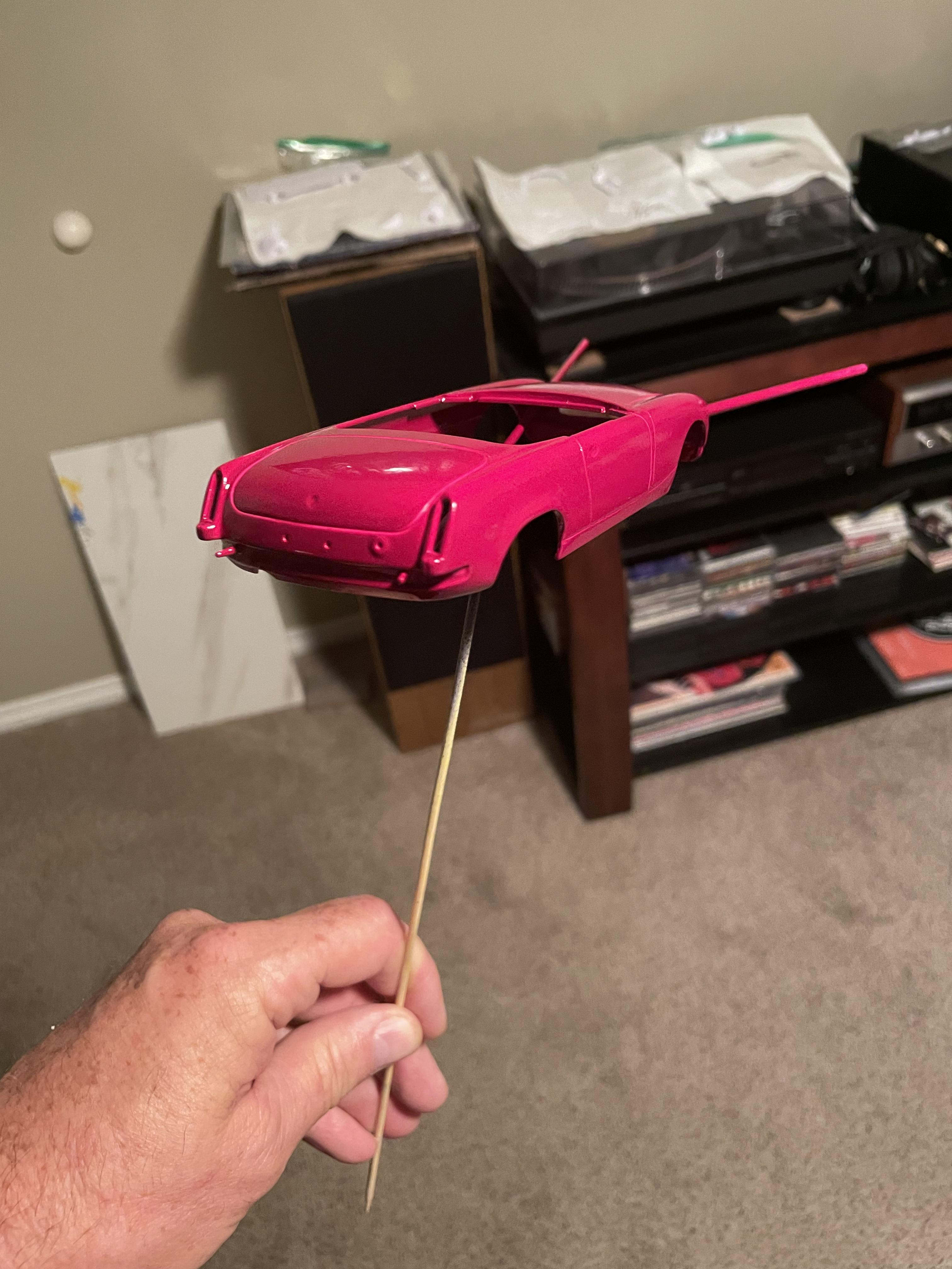

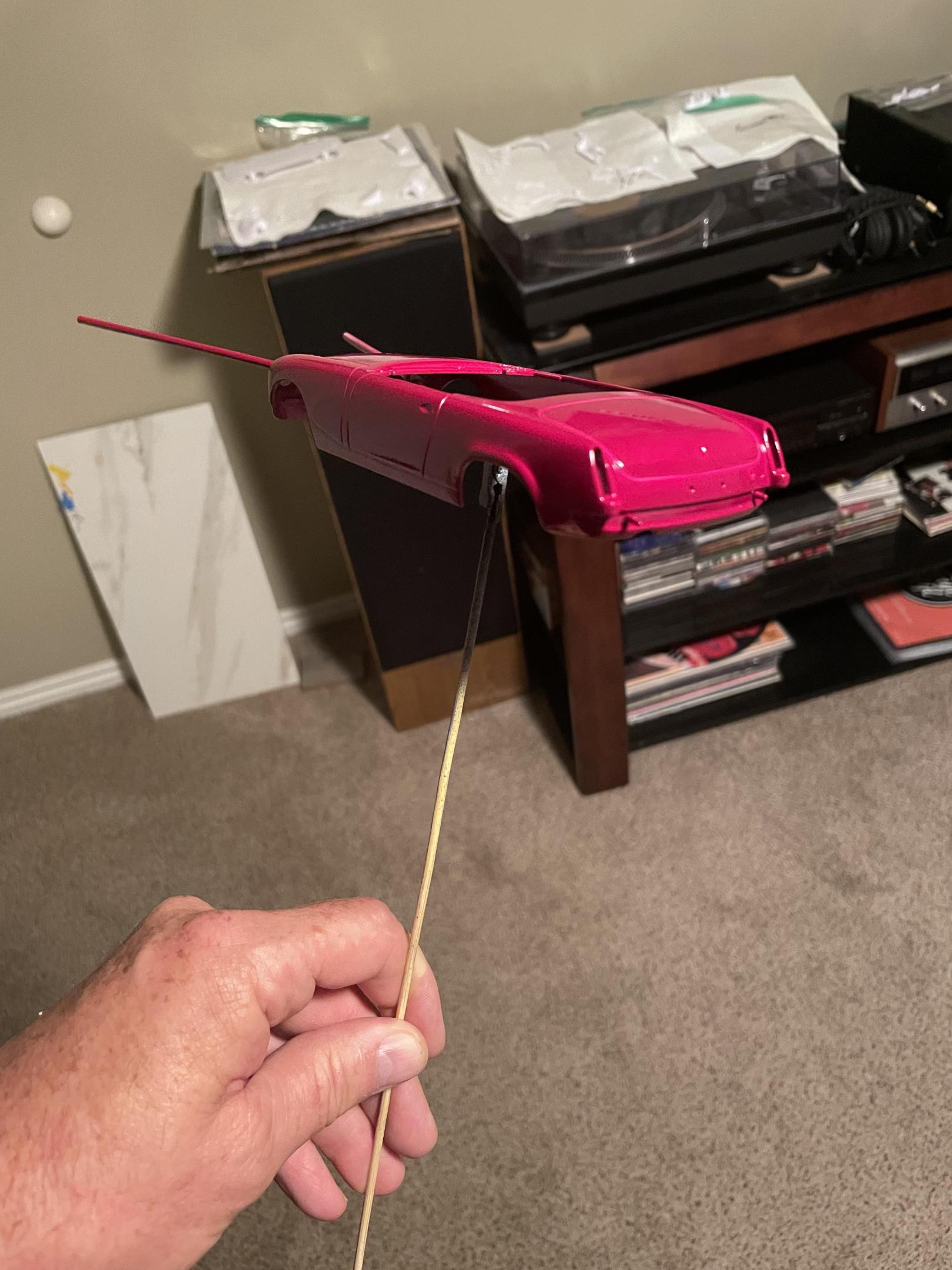

Well I’ve got the Midget in color, turned out a little on the pinkish side and this was the first time I used a white primer and you can see it in the panel lines.
Im really happy with the body work but need to make a decision on the paint.
Next step is the windscreen, I’ve got one from a AC Cobra that is much flatter than the one for the B and I think I can use it.

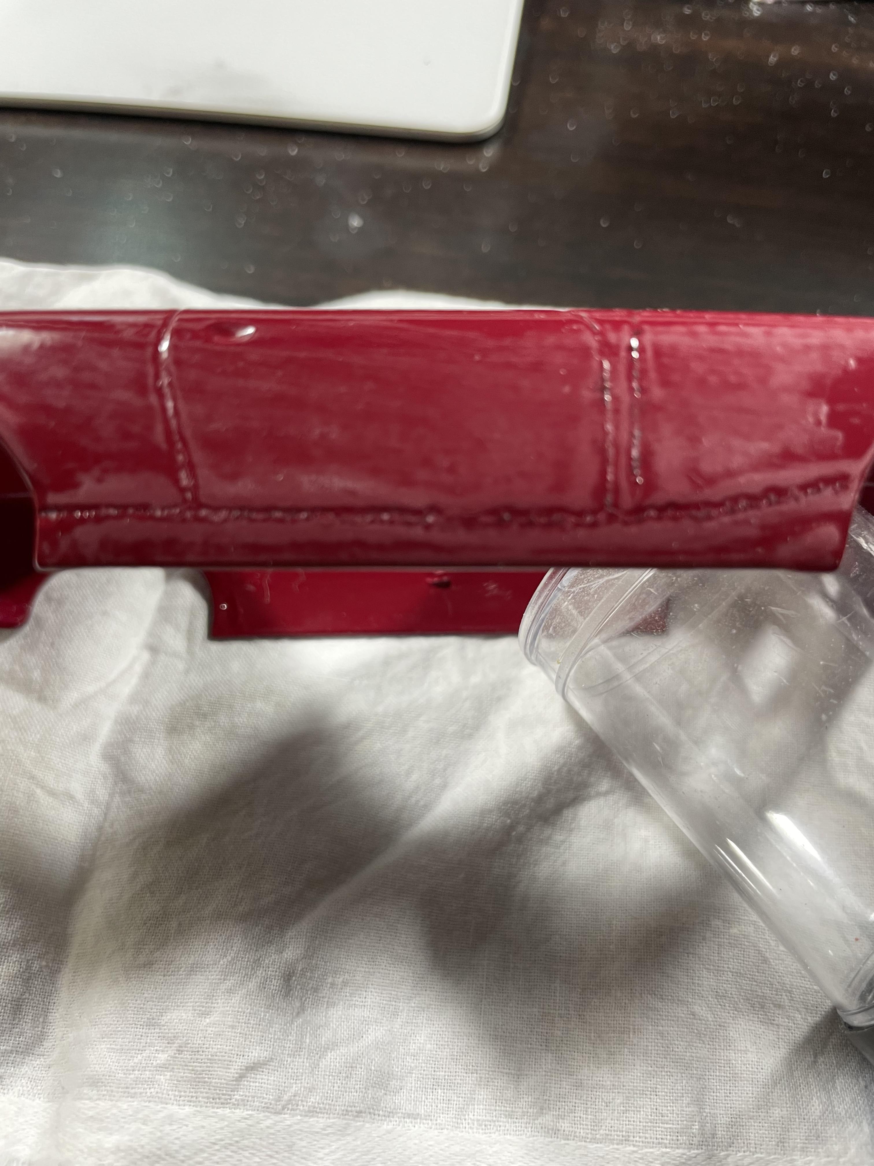

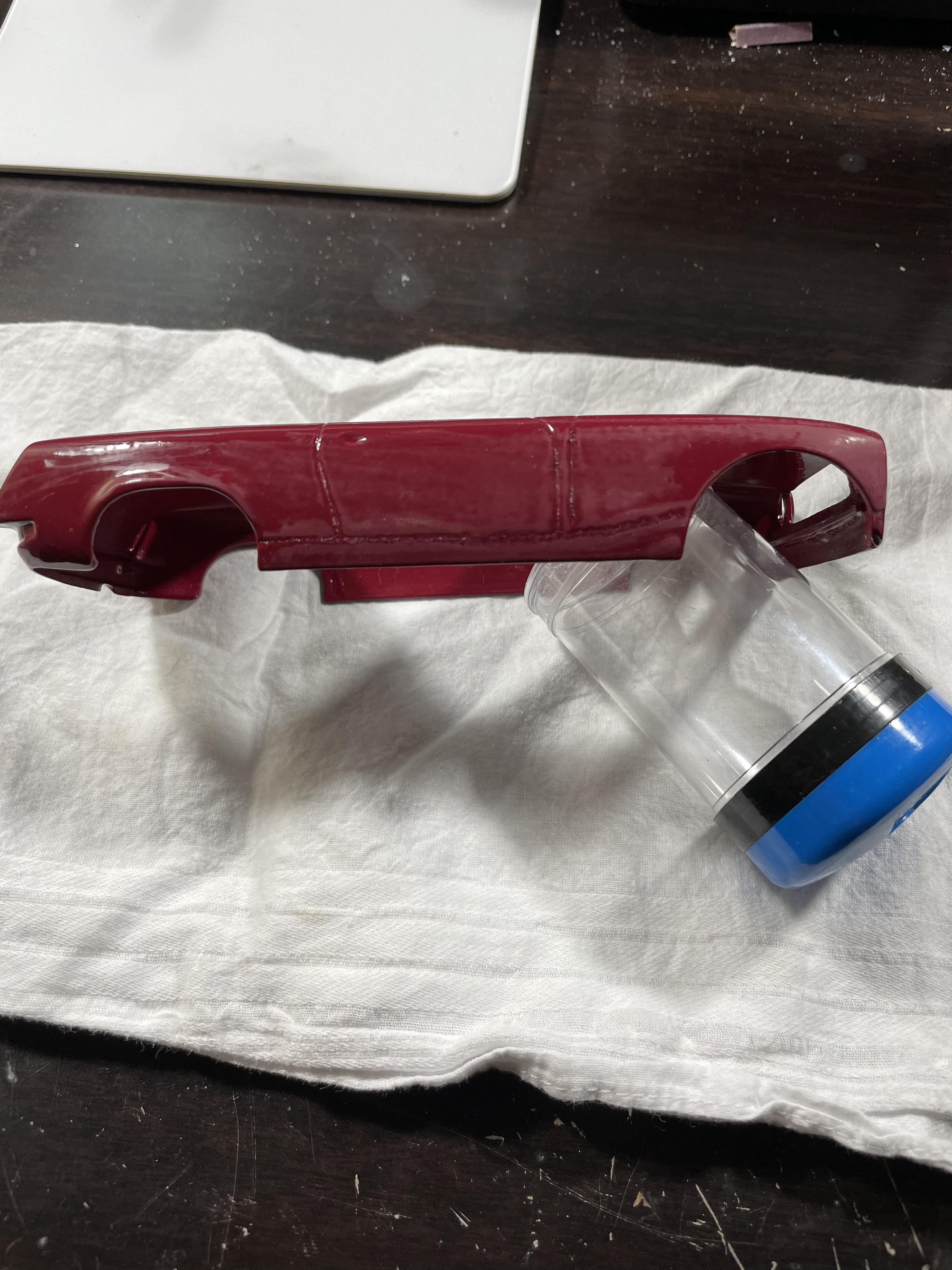

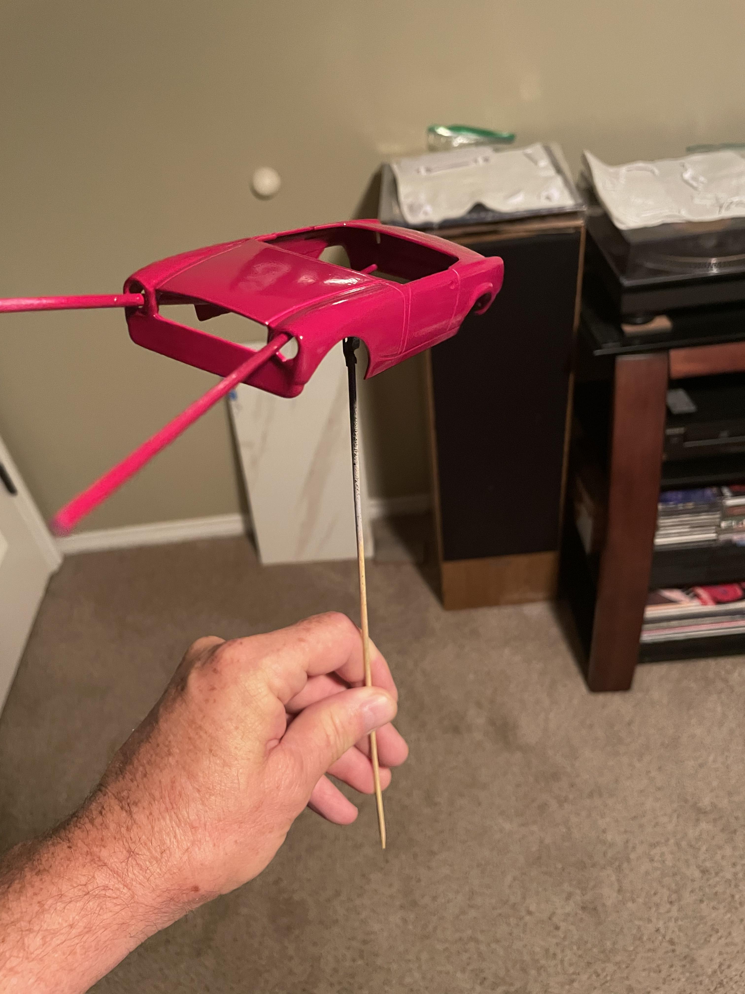

Well, I got the color on and went to clear it and the clear reacted to the panel line color. I’m at a loss as to why, but it’s going in the chemical bath.
Dave.
