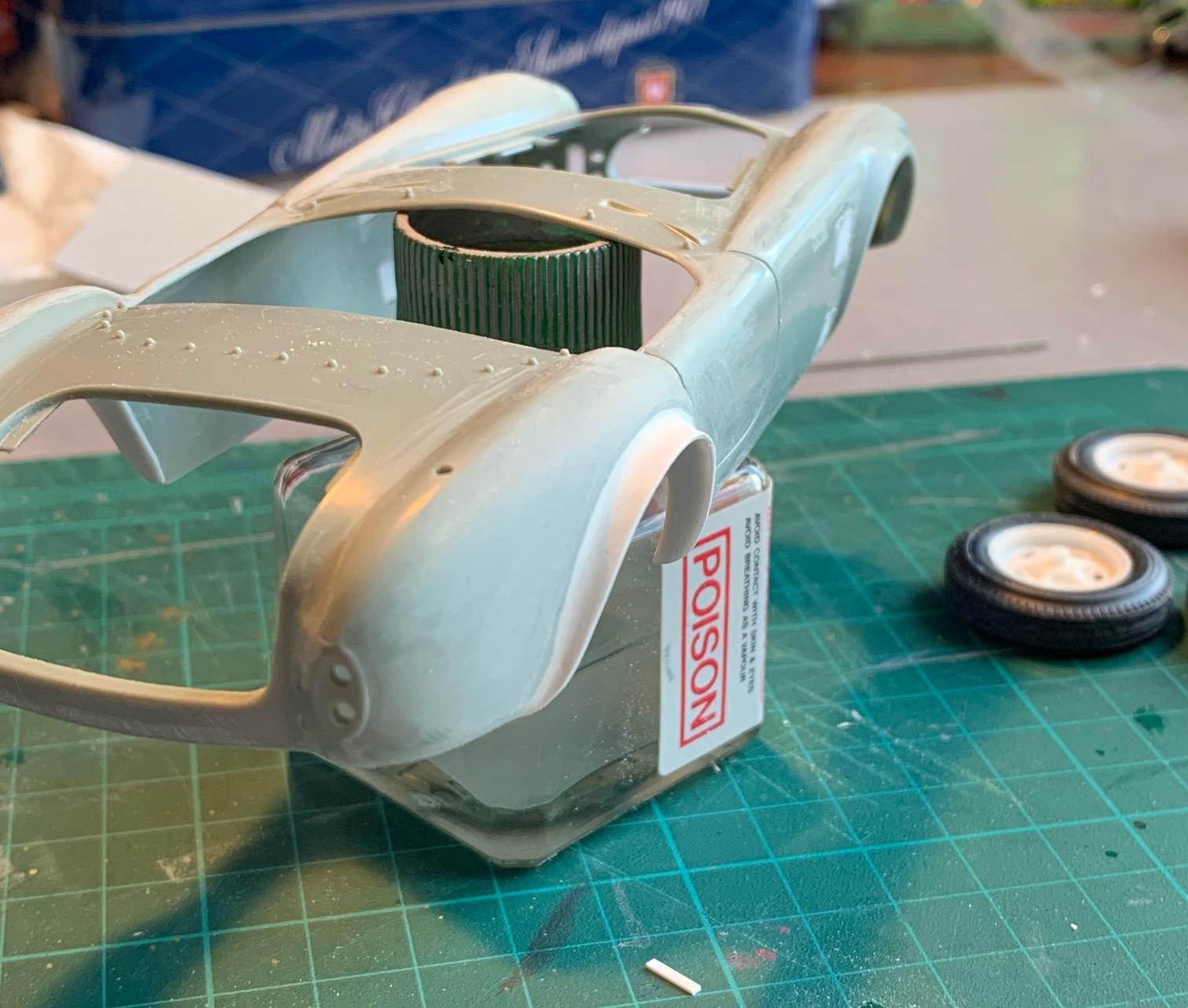

Pierre Rivard Posted August 13, 2022 Author Posted August 13, 2022 Finally got some work done on the Cobra body. The plan is for a series 1 in Sebring specs. The starting point is the Revell "62 Cobra 289" which in effect is a series 1 chassis and a body looking like a series 3 427 Cobra. I believe this kit originates from the Sunny/Minicraft kit. The body molding looks like a series 1 (narrow body) from the inside and a 427 from the outside i.e. thick fenders that I can grind down The front fender opening lips were just gently sanded with a stick to mimic the squares lip series 1 The rear were slimmed down with a mini grinder 1
Pierre Rivard Posted August 13, 2022 Author Posted August 13, 2022 I also opened up the rear wheelhouse to make room for building up a flange. Going by my ref pics of CSX2026 like the one seen above, the idea is of a flanged rear fender as opposed to the bulged out fenders of a 427 Cobra...if that makes any sense. Thin sheet Evergreen strips glued to the opening, then putty using round side of toothpick to shape it, trim, sand, etc. 4

Pierre Rivard Posted August 15, 2022 Author Posted August 15, 2022 Nose job, before and after pictures. I still need to add the 2 brake cooling ducts, not sure if they attach under the nose of embedded in the lower part of the bodywork. 3

Pierre Rivard Posted August 20, 2022 Author Posted August 20, 2022 Cobra body mods finally done. It's the first time I build one of these so along the way I discover a few fixes needing attention. I opened up the hood scoop and did some filling at the top of fenders as I saw a bit of a depression along the tool parting lines. On changes to make the body closer to the Sebring specs I filled the body side vents & exhaust ports, added the little flares at the back of the front wheel openings and moved the fuel filler port (with a splash guard). The flares may be a bit overdone... I'll wait to see what it blends in better after primer. 3

Pierre Rivard Posted August 24, 2022 Author Posted August 24, 2022 I finally primed the Cobra body and fixed the few defects showing through. Chassis mock up of both cars also done to set ride height, wheelbase and track. 1
