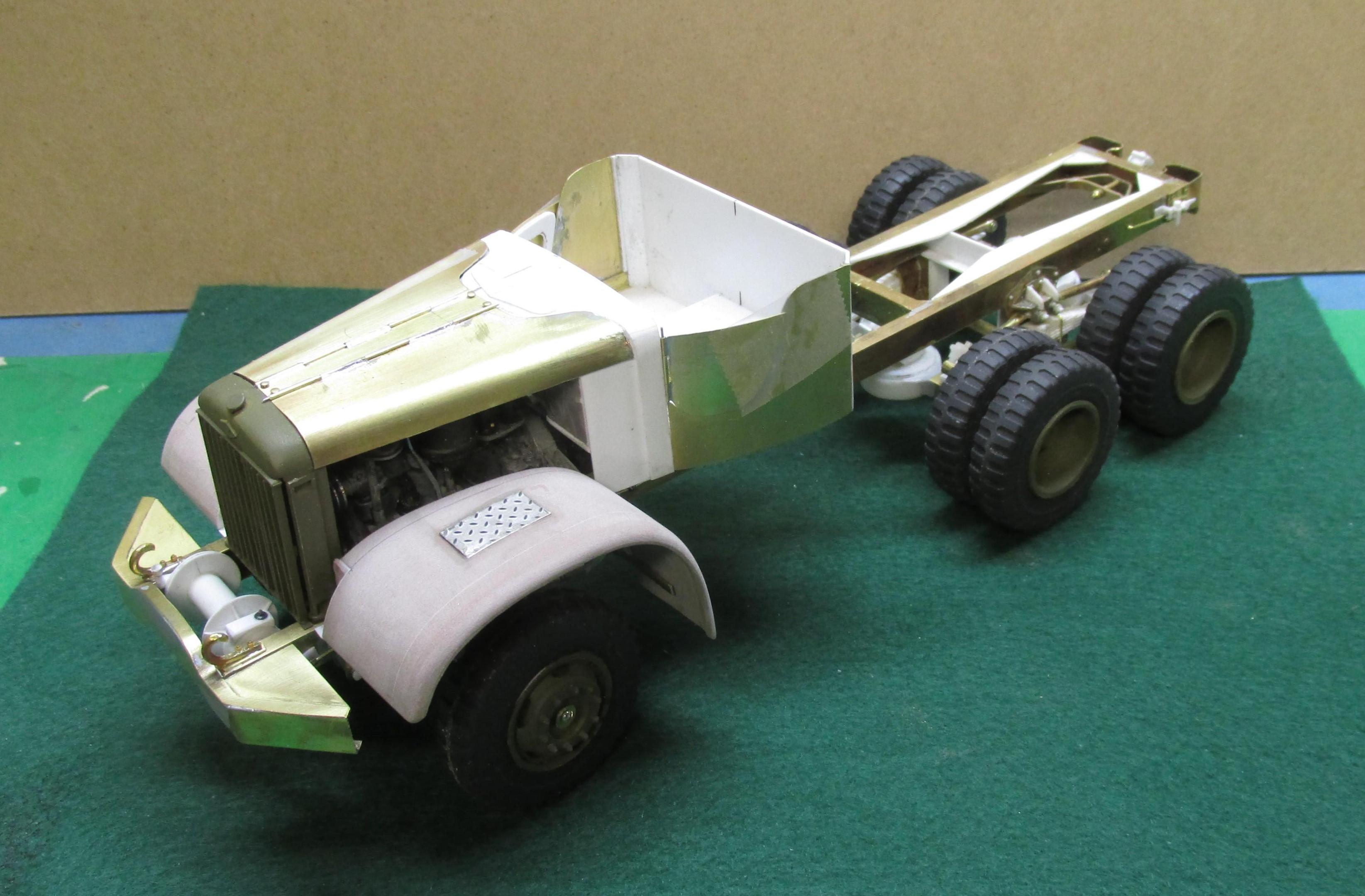

Chariots of Fire Posted November 4, 2022 Author Posted November 4, 2022 2 hours ago, gotnitro? said: fantastic work, always enjoy your skills w brass. looking forward to you starting on the wrecker body I hope you have a lot of patience, Jeff! Got a long way to go. But I did get one fender shaped and sort of put in position. Not final yet as I think it needs to move forward a tiny bit. And a notch needs to be cut out next to the radiator. 2

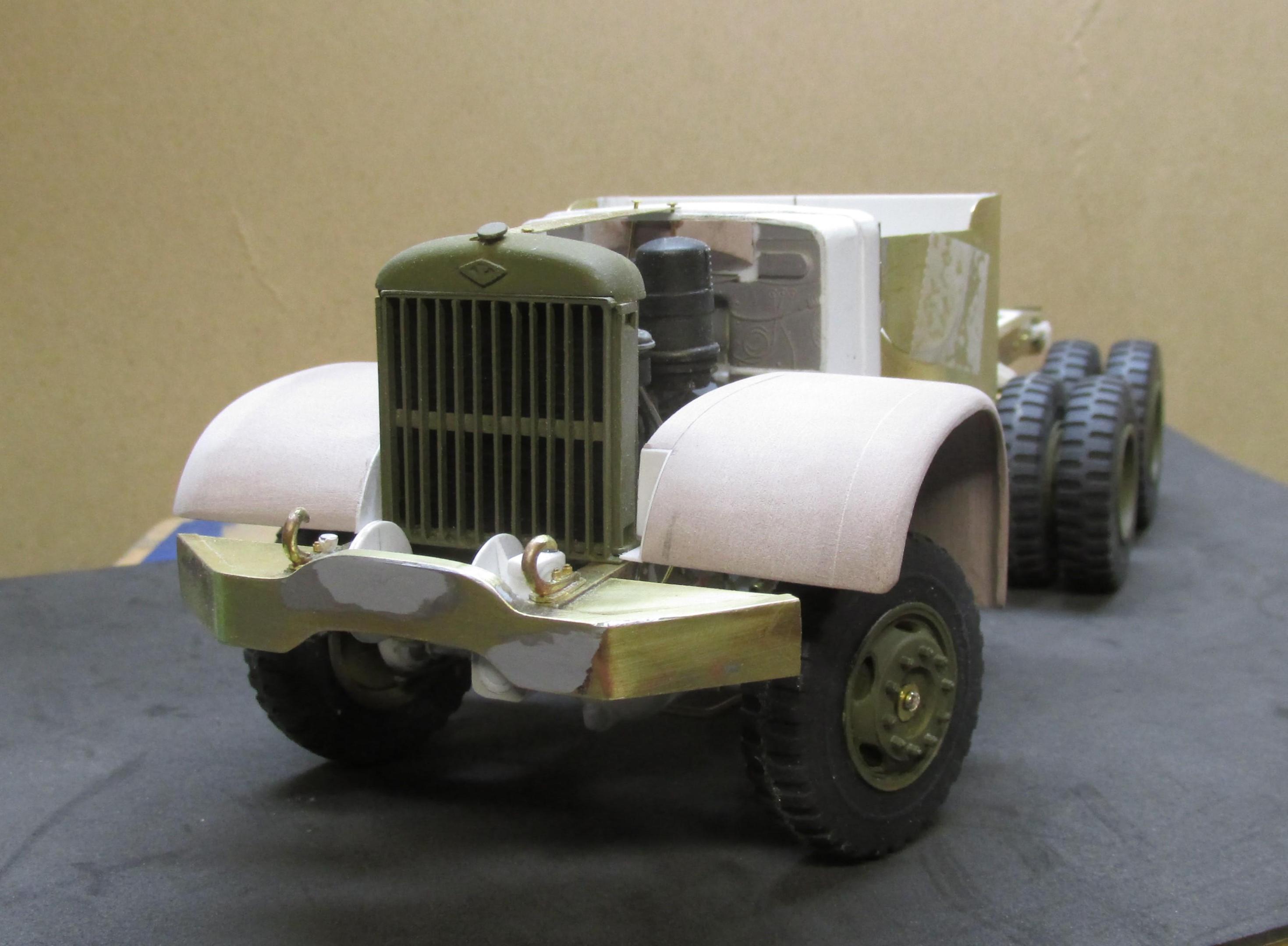

Chariots of Fire Posted November 5, 2022 Author Posted November 5, 2022 Fenders are shaped and put in place. Got some tweeking to do with the cab. It sits slightly off center in the front in spite of my early attempts at keeping it straight! 2
Chariots of Fire Posted November 8, 2022 Author Posted November 8, 2022 Still making progress. The top hood pieces are done and I'm working on the side pieces now. Some small pieces of photoetch treadplate are glued to the top of each fender. 3

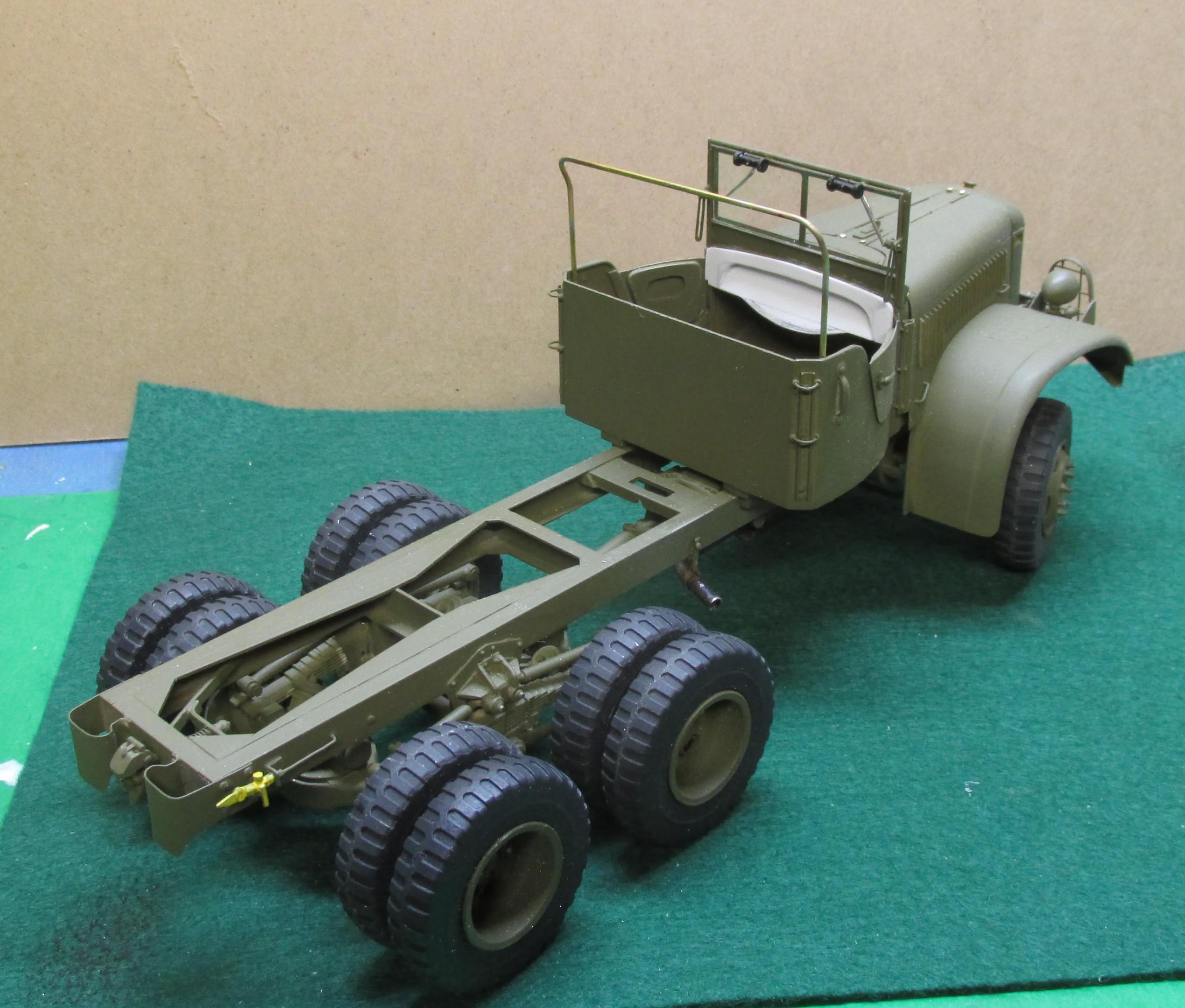

Chariots of Fire Posted November 19, 2022 Author Posted November 19, 2022 Got some paint on the fenders and frame. Headlights and guards have been installed along with marker lights and blackout light. The winch is now in place and wrapped with mylar coated wire for the cable. The cable will have a chain and hook. Glad hands have been painted; yellow for rear, red for front. the cab is in primer and awaiting the final fit of the hood sections. 3
Chariots of Fire Posted November 22, 2022 Author Posted November 22, 2022 Progress continues. Just a lot to do to get the details down. Bit the bullet and did some painting. Got the hood louvers done and went to work on the windshield wipers. got them done although I should have darkened the blades first. Wiper arms will get OD color. Started work in the cab interior with making up the dashboard. 2
Chariots of Fire Posted November 25, 2022 Author Posted November 25, 2022 Concentrating on the cab interior the last couple of days. The dashboard is done and made up using common pins, gage decals and small beads. The steering wheel was converted from an AMT wheel using bent brass wire. The horn button has a Ross insignia in the middle. Treadplate is on the floor of the cab but is hard to see. The windshield is done except for the two clamps that hold it in the upright position. 2

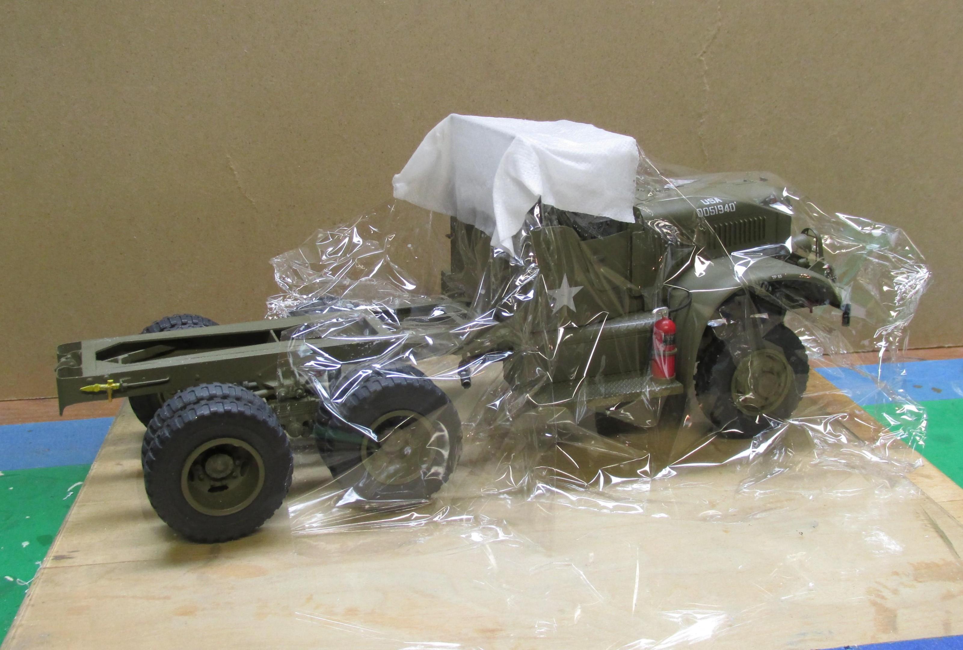

Chariots of Fire Posted December 6, 2022 Author Posted December 6, 2022 Work continues. The hubs have been added to each wheel. The body has been started and I did some experimenting with facial tissue for the top. The kind I tried is too coarse and does not look good. I found some fine tissue that will work much better and I need to find a way to get the side curtains to the right place and then cover them with the top. 50/50 white glue and water were used to "paint" the tissue. Once it hardens the top stay in shape and can actually be removed. Another detail will be the rear view mirrors. They will be turned from aluminum rod so that the faces can be polished. Then the backs can be painted OD and the arm and mounting brackets done. The "Press and Seal I used to cover the truck while doing the top I found makes a very nice rear window; just like the real one. can be polished. Then the backs can be painted OD and the arm and mounting brackets done.
