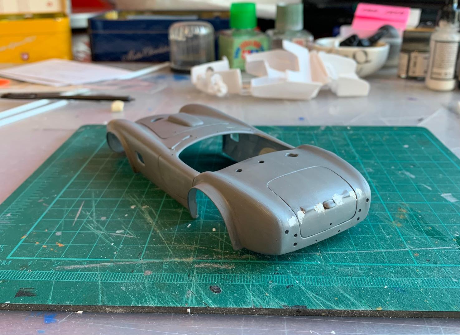

Thank you guys. I did a bit of reshaping of the front wheel opening flanges (too flat at the top) and brushed on the primer. Not bad. Some work needed to smooth out the back end and I will need to find a way to hide the body thickness around the nose GTO style cooling holes.

I said I would put a driver figurine in entry #1. Easier said than done. I had a figurine of unknown origin in my spares but it was far from an easy fit in the small Cobra cockpit. After a lot of cutting and reshaping of limbs here it is. Took 2 days but here it is. I think if I pull it off at the painting stage it will add to the build. Something I really want to repeat on future builds If I can find a source for more figurines.

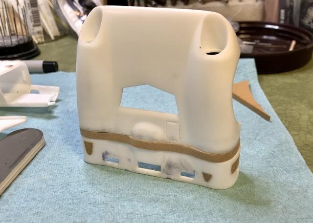

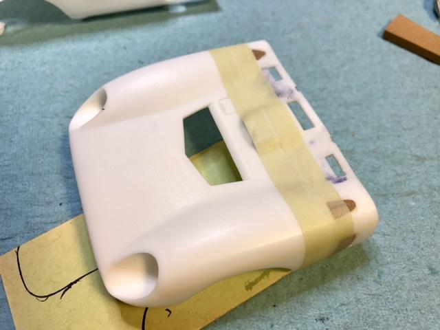

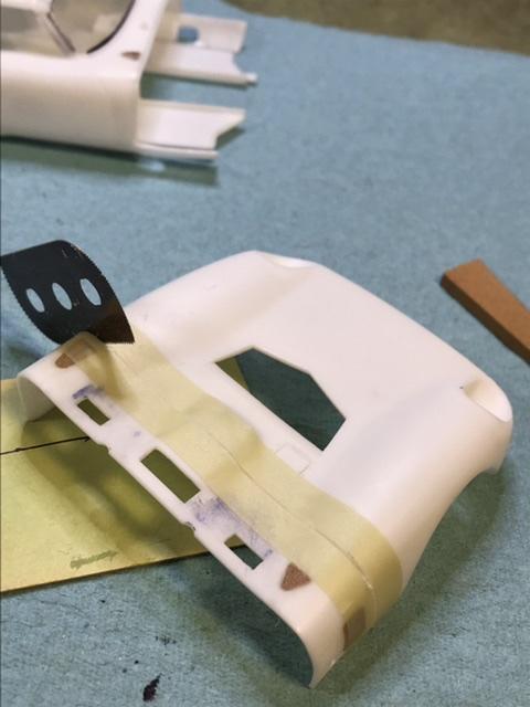

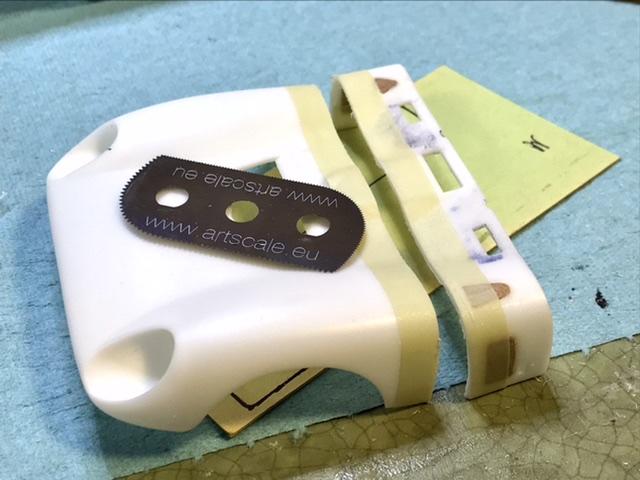

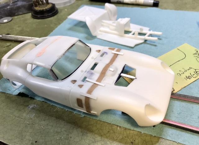

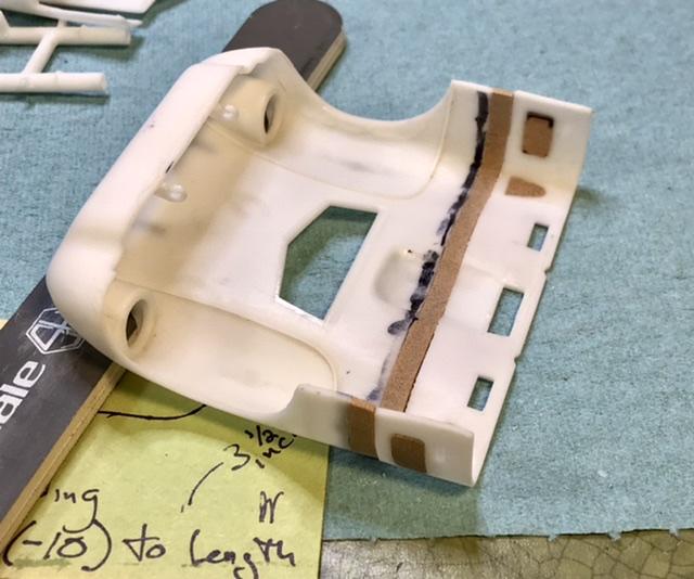

#10 goes back to surgery …

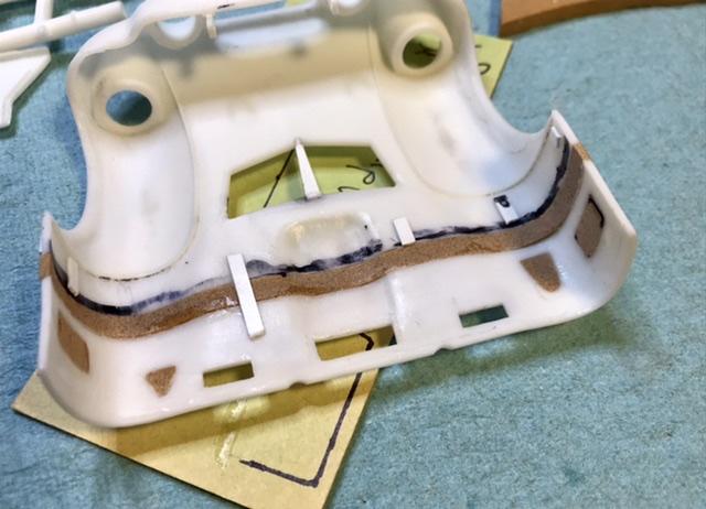

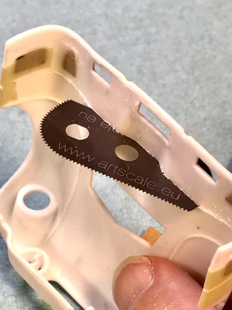

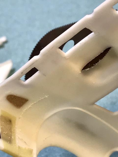

 for this procedure I’m using one of those neato razor saws that you can get on the UMM site - this new blade has teeth that curl around from length to width - its good for scribing a cut with tape as the guide … and in the last photo i’m about to cuT off my left thumb - that’s ok - we all came w two - right ??

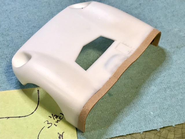

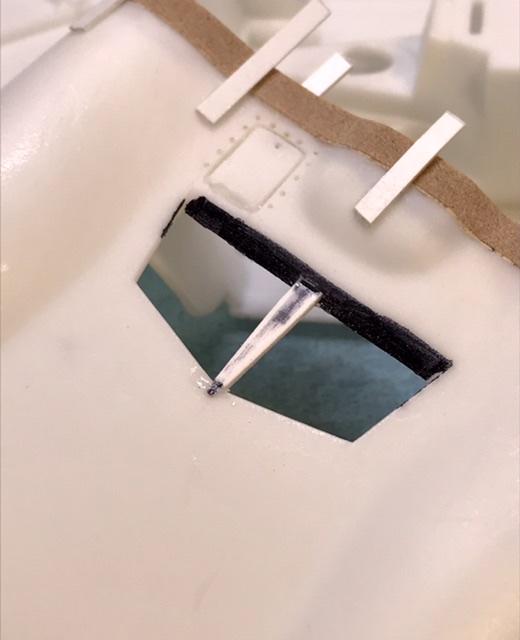

You’ll recall that the bonnett on the Bradford Daytona Coupe kit was missing about 3 to 4 inches of length ….  So once the bonnett was sawed apart i glued a peice of Renshape that is .140 thick on to the bonnett to produce the missing 3 / 4 inches … remshape
bonds well w CA glue …
  • Like 1
Thanks Gramps

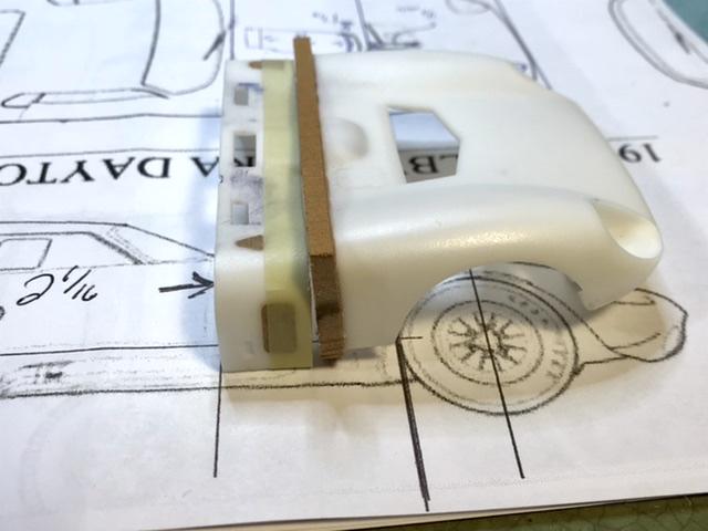

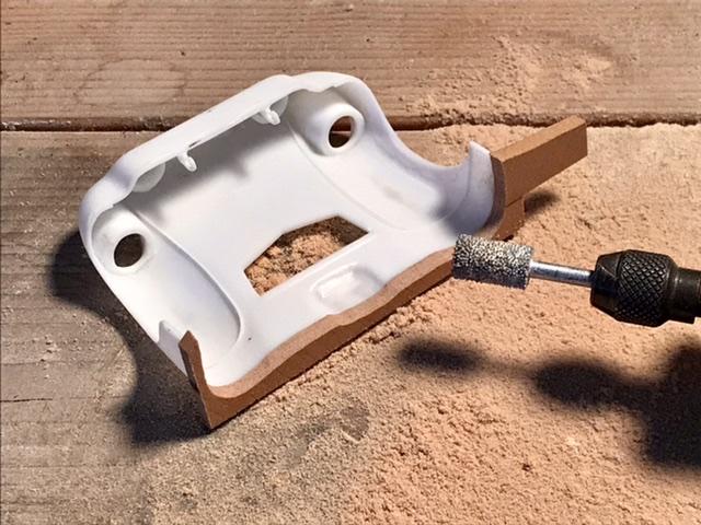

pierre - gonna use the same peice of Renshape to lengthen the frame - and then Ive got re-site engine mounts … the Perma-grit bit is random toothed and is great for shaping the Renshape - also used a sanding drum and some sanding sticks …
The  profile is now very nearly a match for the resin bonnett shell - which was made with a thin resin cast - no more than .050 -  holding the shell with my remaining thumb …

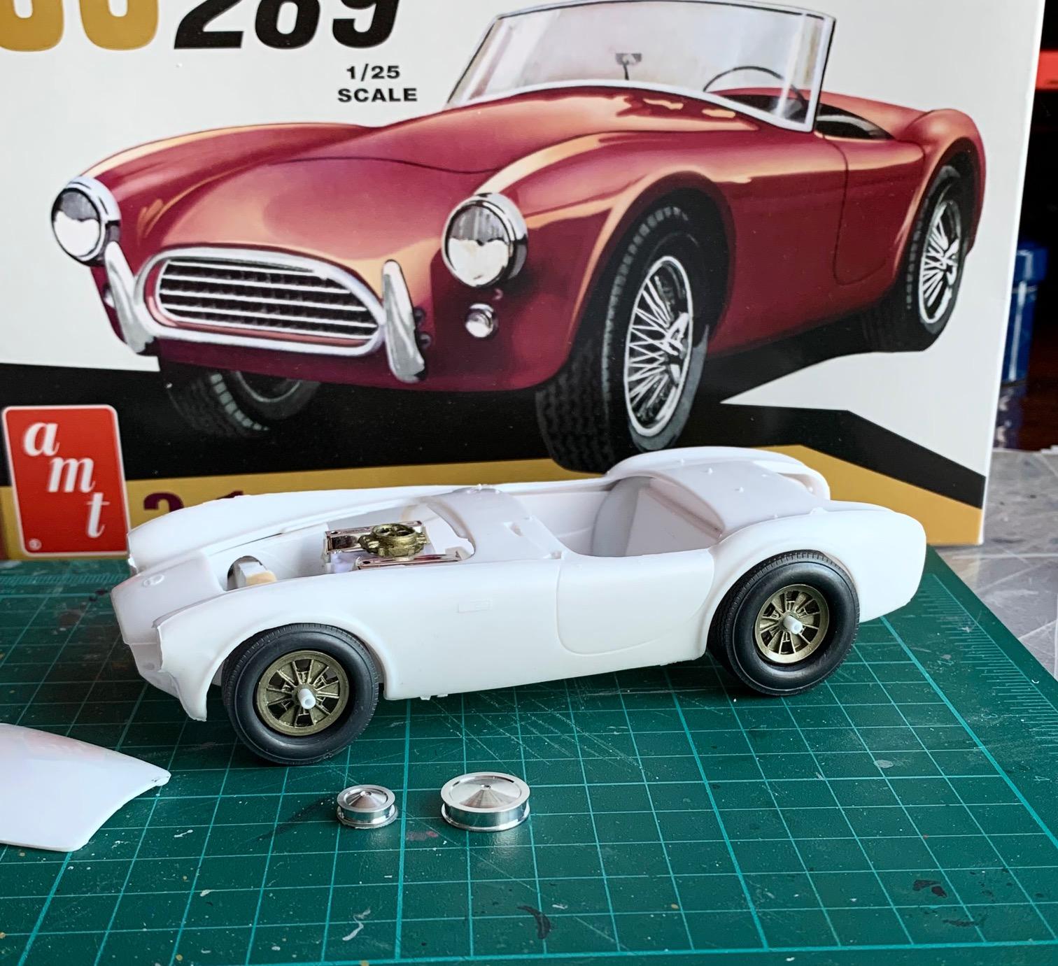

Allow me to insert an update on entry #1. The build is moving well and fast (for me)
Engine and chassis are all done. For the engine I grafted the Cobra kit's trans to a Polar Lights 427 and built up missing elements from spares (overflow tank, fuel pump and added a variety of aftermarket parts. Oil filter, breathers, carb and air filter from Protech, Connkur distributor, Parts by Parks accessory drive and VGC resin headers modified to a vertical outlet.
Chassis is pretty OOB with exception of mods to fit the bigger engine, scratch building shock absorbers and substituting kit wheels & tires with HRM components. I scratch built exhaust pipes with 3.2 mm Evergreen rod and tube material.

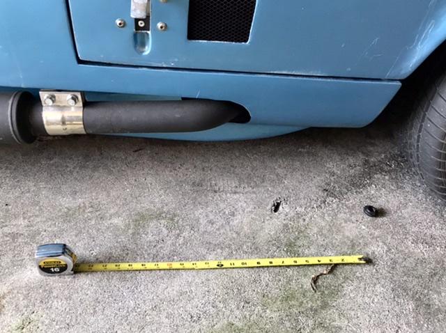

replica Daytona Coupes are actually not that rare - but they are mostly “old cars” now - you are more likely to see one sitting forlornly in the back of a mechanics workshop than at a car show - the one sitting in a corner of my mechanic’s garage - its been there for months - has what appears to be an accurate body shell - the dimension in the photo shows me that the drawings Im working fr are accurate - the length of the shell past the wheel well is just short of 24 inches - which is what I am doing in scale with the added strip of Renshape …
The bonnett is glued back together using plastic guides and CA glue - lots of sanding now - using mostly diamond coated bits and random standing sticks - also modifying the bonnett opening designed to extract the radiator air - the first one or two Daytona Coupes had a central brace and a taper in the trailing edge - the design was simplified as “production” began …
