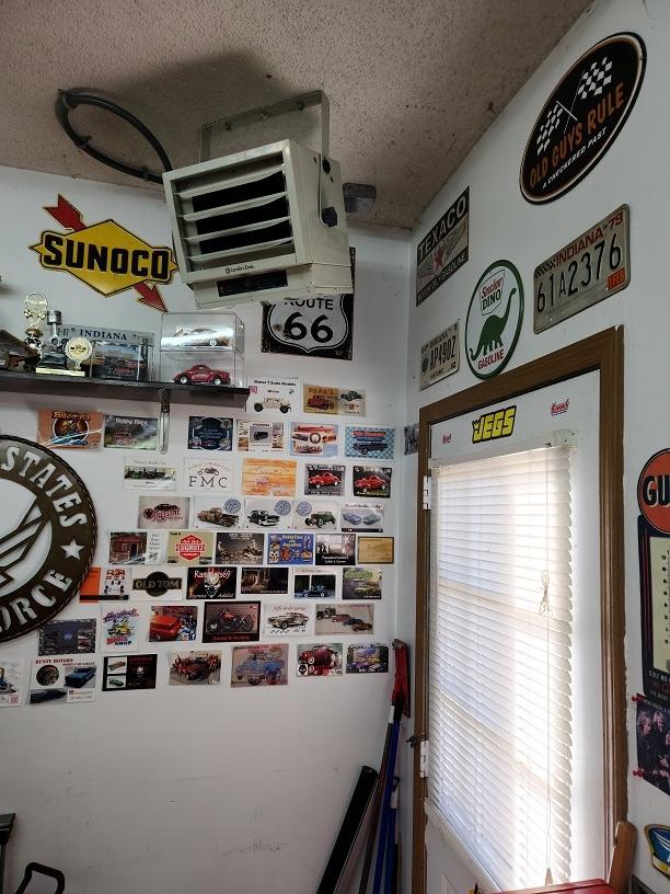

Zippi Posted October 19, 2022 Author Posted October 19, 2022 1 hour ago, slusher said: Nice wheel and tire choice Bob! One thing I do in cooler weather is paint outside and bring it in the house. I am sure you have done that buddy. Thanks Carl. This winter I'll be airbrushing in my garage. I have a 5000 watt heater that I've had for a few years and normally get it up to 55° - 60° in the winter. I'm curious as to how it's going to work out as far as painting.

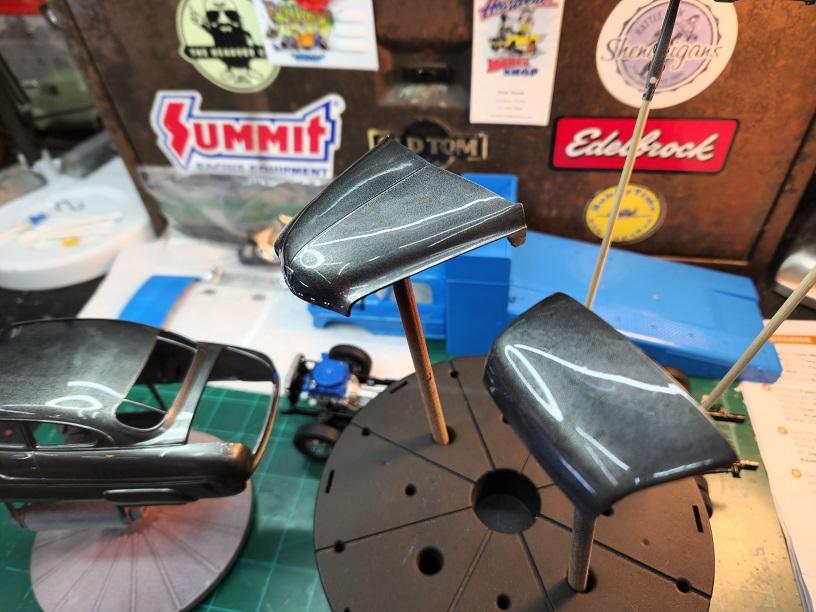

Zippi Posted October 21, 2022 Author Posted October 21, 2022 The weather was nice today do I got after it and got some paint on the 49 Merc. The paint is Tamiya X-10 Gun Metal Acrylic. I thinned it 2-1 with Mr Color Leveling Thinner. I look a little like a metallic but it should change a little during the curing process. 2
Zippi Posted October 21, 2022 Author Posted October 21, 2022 27 minutes ago, cobraman said: Looking good ! Thanks Ray. The color is a little off from the cap and it has a metallic look to it. Not what I was going far.
TransAmMike Posted October 21, 2022 Posted October 21, 2022 Well my Friend, looks darn good to me. I like the color myself.
Zippi Posted October 21, 2022 Author Posted October 21, 2022 1 hour ago, TransAmMike said: Well my Friend, looks darn good to me. I like the color myself. Thanks Buddy. I like the color, I was just expecting it to be darker.

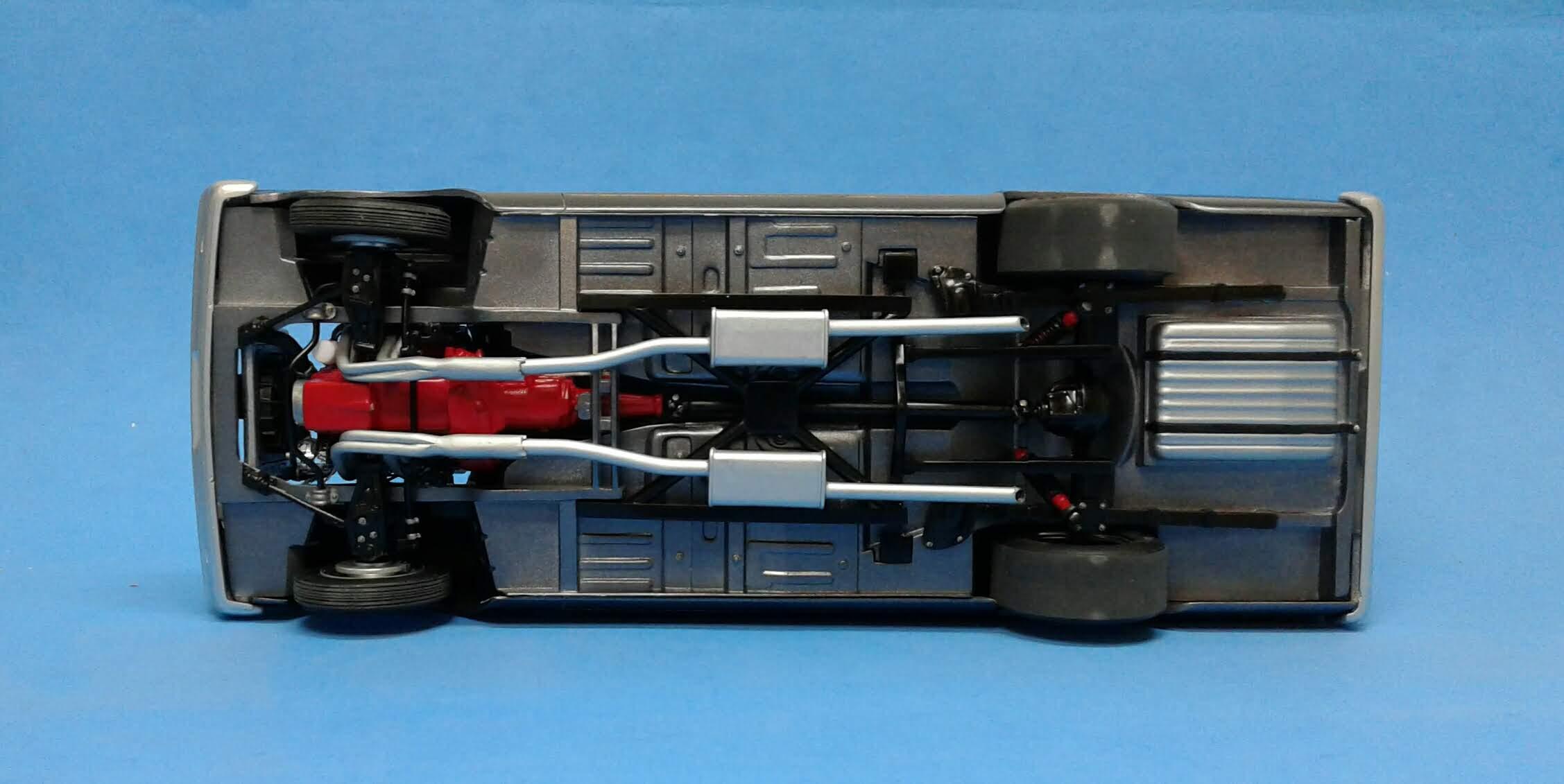

Plowboy Posted October 22, 2022 Posted October 22, 2022 13 hours ago, Zippi said: Thanks Buddy. I like the color, I was just expecting it to be darker. Tamiya TS-13 clear typically darkens most metallic paints to a degree. I painted a '63 Fairlane around three years ago with Gun Metal and it looked almost like Light Gun Metal out of the can. Like you, I was hoping it would be dark like the lid on the spray can. Three coats of TS-13 brought it right where it should be. This is what the chassis looks like with no clear. This is what the body looks like. 3
Zippi Posted October 22, 2022 Author Posted October 22, 2022 3 minutes ago, Plowboy said: Tamiya TS-13 clear typically darkens most metallic paints to a degree. I painted a '63 Fairlane around three years ago with Gun Metal and it looked almost like Light Gun Metal out of the can. Like you, I was hoping it would be dark like the lid on the spray can. Three coats of TS-13 brought it right where it should be. This is what the chassis looks like with no clear. This is what the body looks like. That looks pretty good Roger. I'll be hitting mine with Tamiya X-22 Clear once it cures for a few day and I wet sand it.
stavanzer Posted October 22, 2022 Posted October 22, 2022 Nice Garage Workshop, Bob! And the Merc is looking sweet!

Zippi Posted October 22, 2022 Author Posted October 22, 2022 1 hour ago, stavanzer said: Nice Garage Workshop, Bob! And the Merc is looking sweet! Thanks Alan. Much appreciated man.

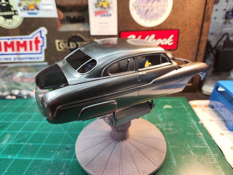

Zippi Posted October 24, 2022 Author Posted October 24, 2022 Alright fellows....I wet sanded the body this morning and shot the Tamiya X-22 Clear on about an hour ago. I'm just not sold on this paint job. It's nice and shiny but for some reason it came out a little blotchy. It still needs a good polishing after it cures out for a few days. 2
