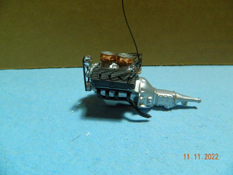

bluestringer Posted November 11, 2022 Author Posted November 11, 2022 Back on it. Got the engine done. Now to do something with the rest of it. 3

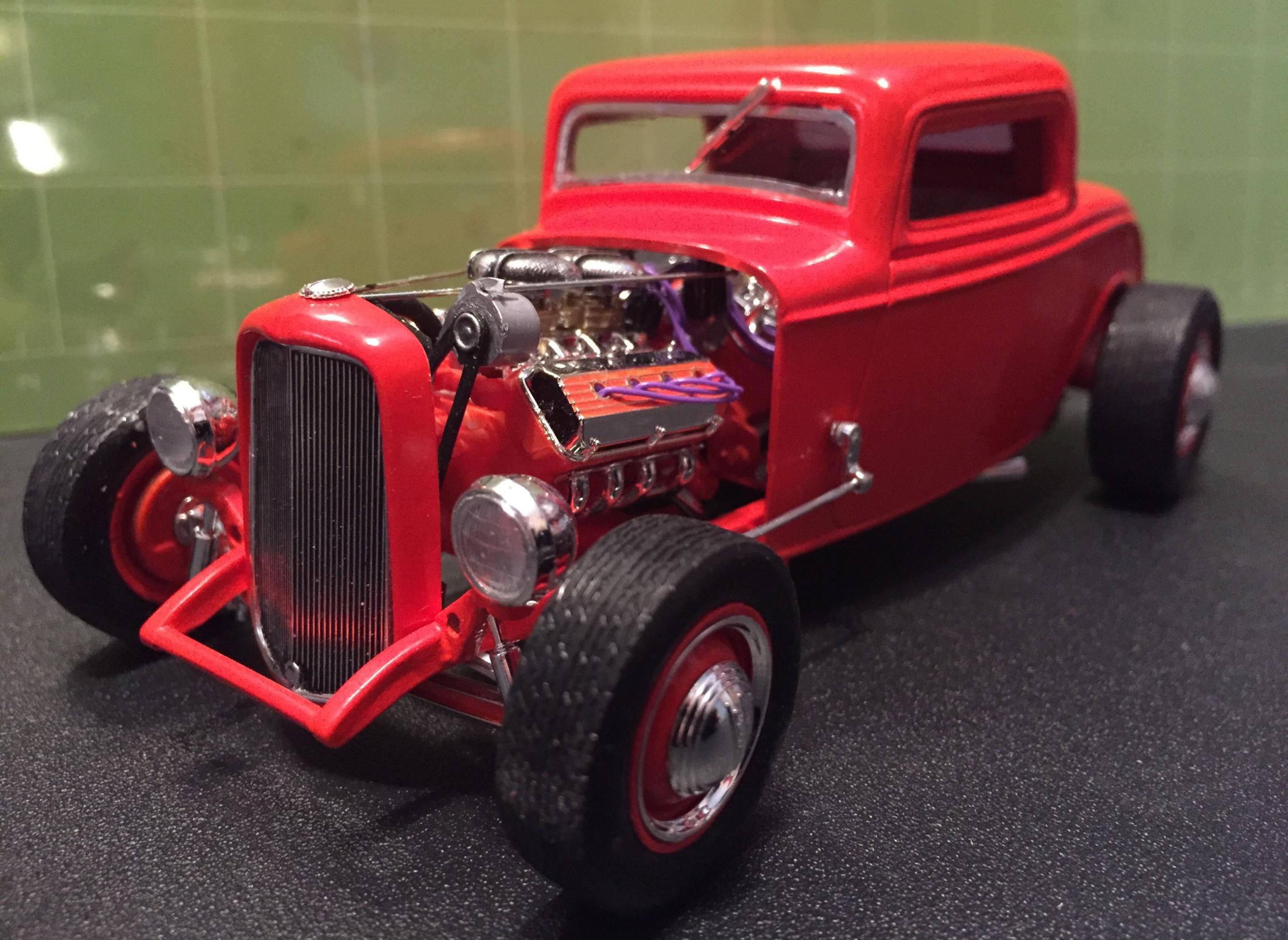

customline Posted November 13, 2022 Posted November 13, 2022 James, I'm wondering if you might be having the same trouble I often have when lowering/channelling; during the "mock-up phase" I have trouble seeing what it is that is causing my problem. Why won't this body fit lower on the frame? Channeling creates lots of problems like that. Something always interferes and often I need to re-engineer to clear the interference. Sometimes it's the bell housing/transmission. You may need to create a floorboard/firewall/transmission tunnel relationship to accommodate the engine placement. Or re-locate the engine a bit in the vertical or front/rear placement, whichever is easier. you can only make the tunnel so big before there is no foot room. You will also need to use an outside drag link for steering; that hemi leaves no room for a steering box inside the frame rail. After stumbling my way through these and other issues, I am finding ways to head them off by planning ahead and being prepared to scratch-build a lot. But that's where the fun is! Oh, and sometimes I cheat. Sometimes there's a shortcut, depending on the intent of the build, the statement being made. Below is an example ? (a highboy need not have a transmission hump) and its consistent with some current AMT kits out there ?

customline Posted November 14, 2022 Posted November 14, 2022 (edited) 3 hours ago, bluestringer said: Thanks Jim. I did run into the problem with the steering box, not sure how I'm going to fix it yet. It's odd though, this hemi is the kit engine for the non coupe version, but the instructions do not show a steering box install on that version. I guess I could leave it off, but I don't know. Still having a lot of problems because I don't know what I'm doing. May put it back in the box and start another build and come back to it later. Yeah, that thing with the steering box? That sort of thing wouldn't bother me in the past but it does now. If it will show and the kit didn't provide it, I'll try to scratch-build it. Sometimes, depending on the front axle and how it is located, the engine and whatever else gets in the way, the easiest work-around for me is the outboard steering set-up as shown below on this 1:1 and on one of my not-so-illustrious builds. BTW, that deuce coupe below is the "Beach Boys" kit. One of the worst Revell kits ever, IMHO. Edited November 14, 2022 by customline 1
