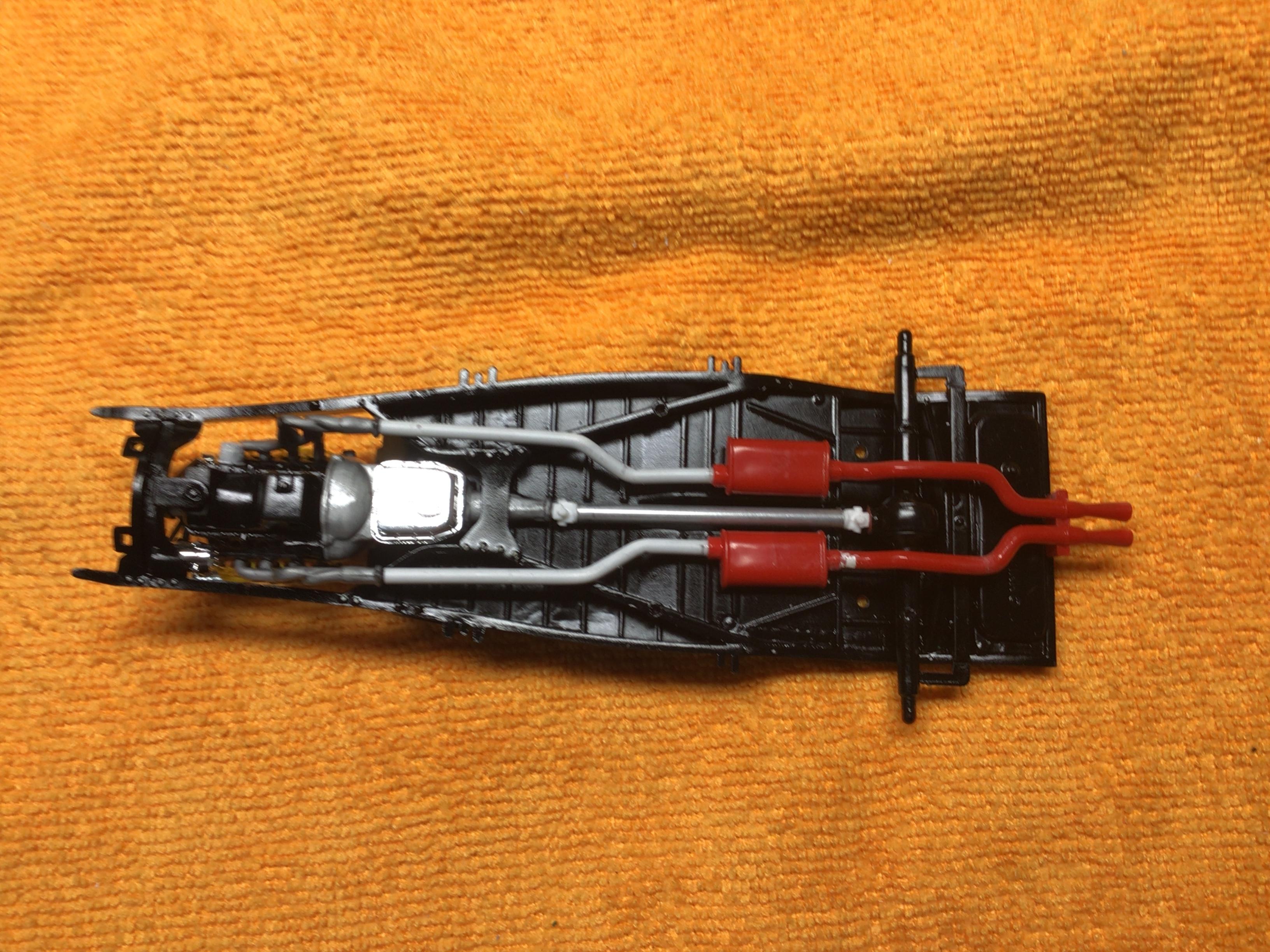

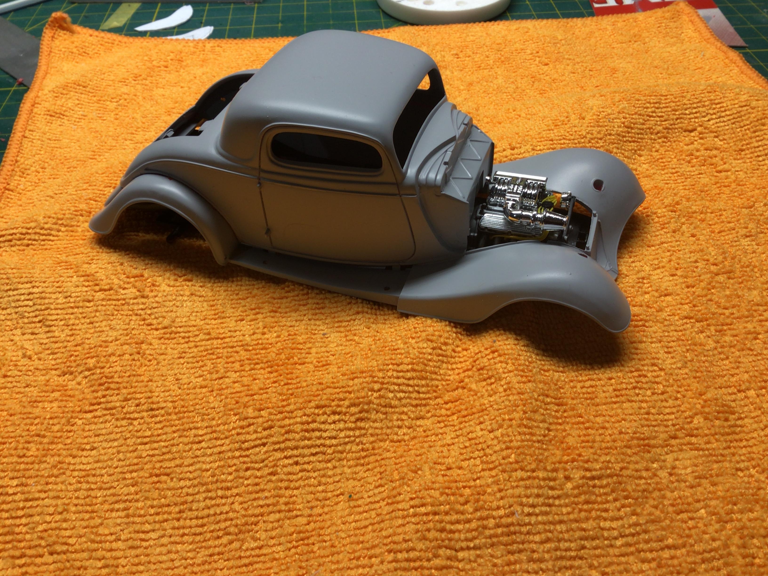

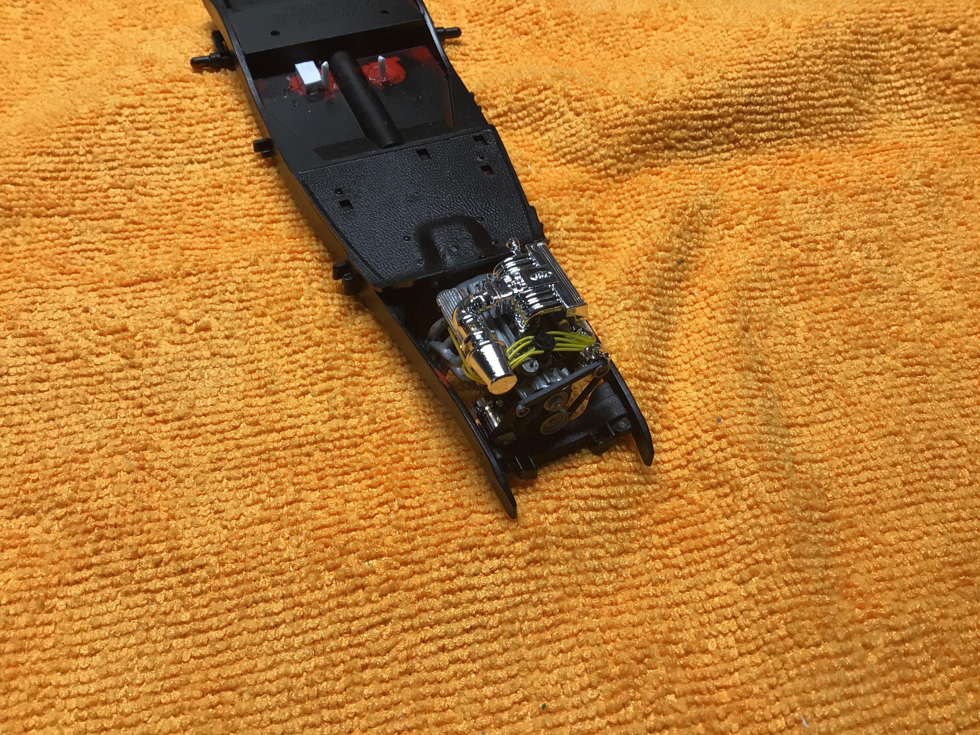

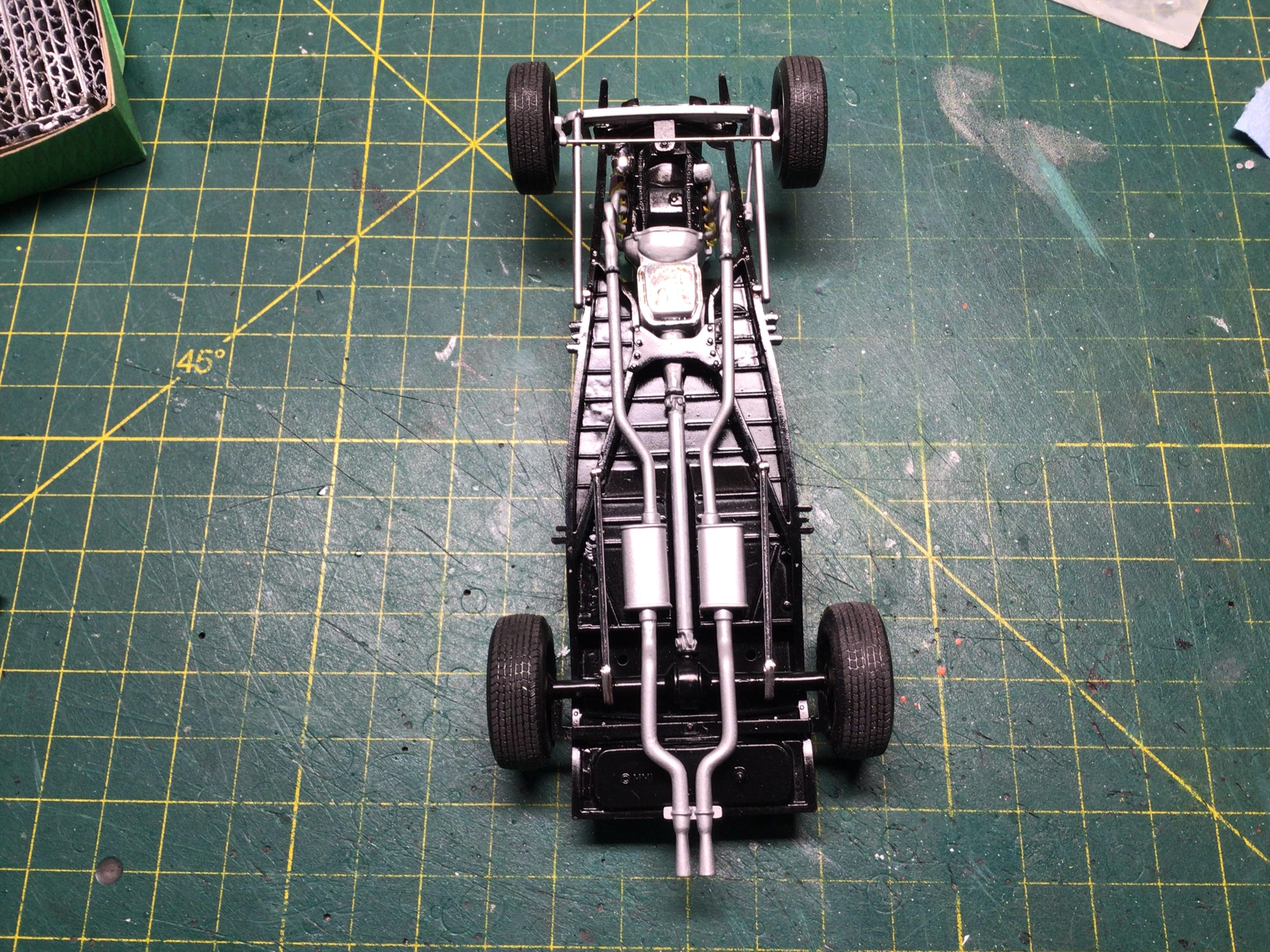

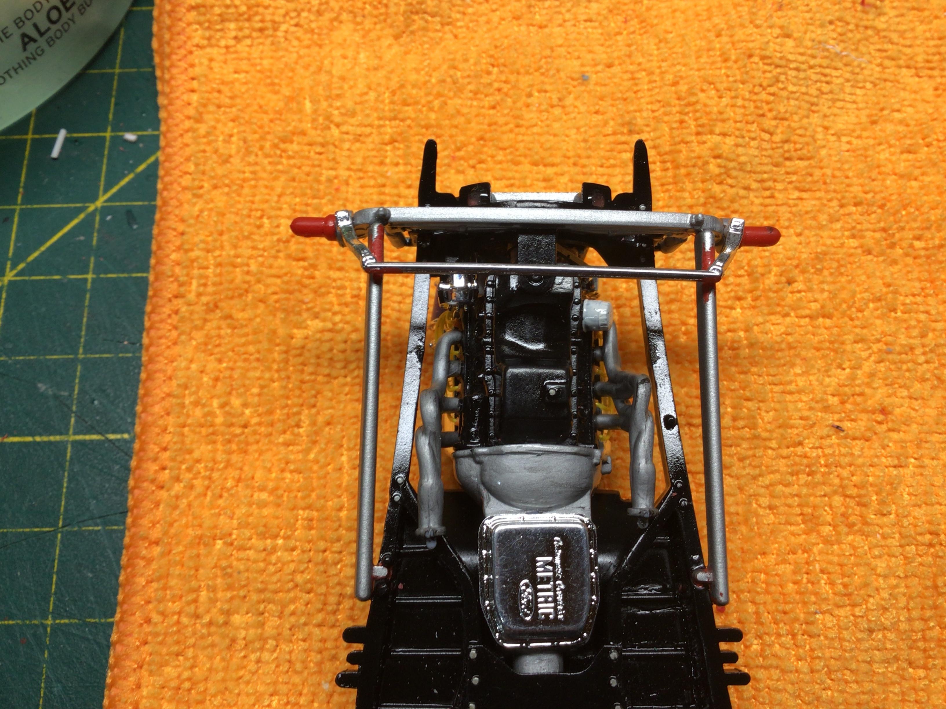

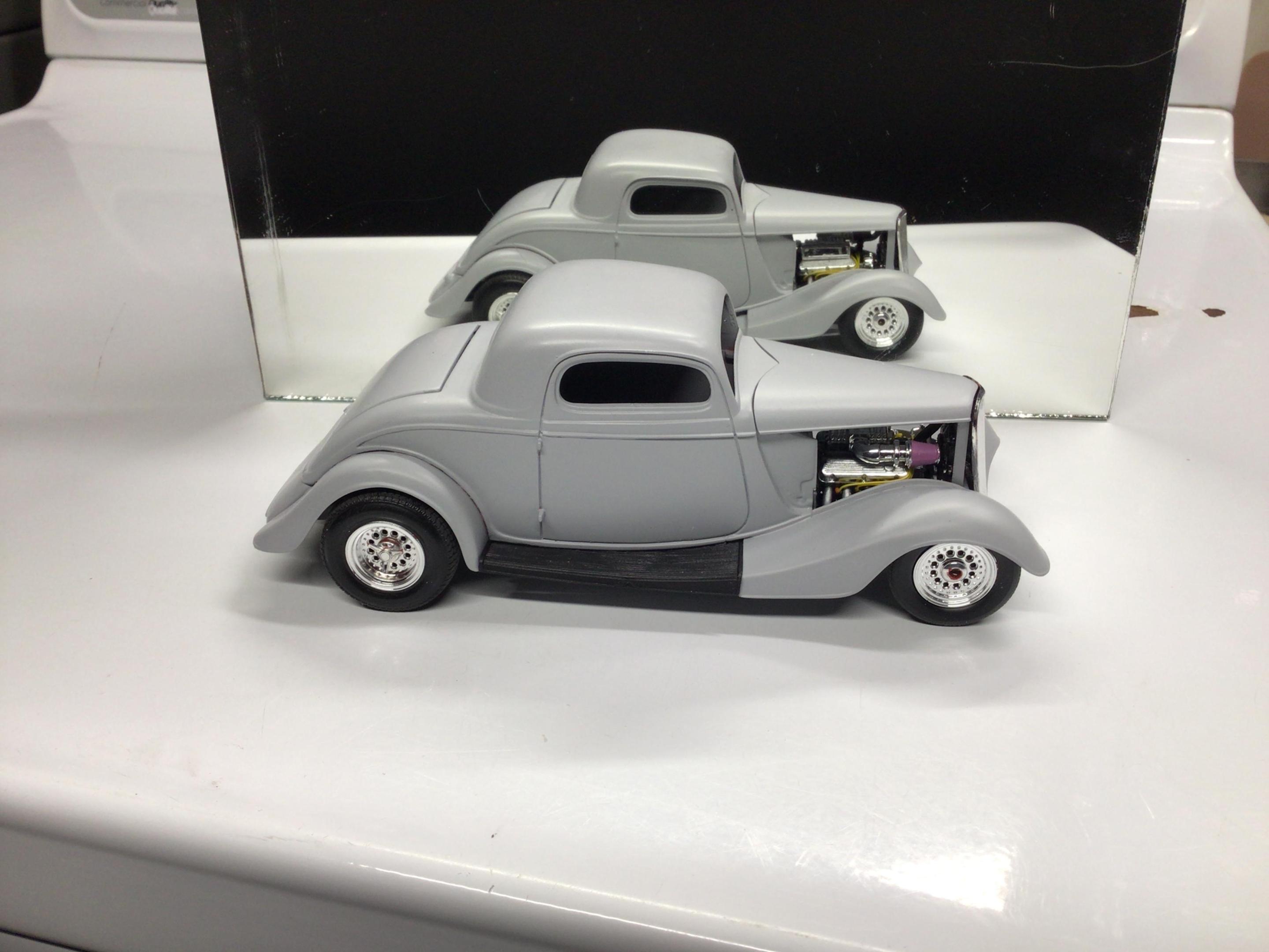

NOBLNG Posted November 24, 2022 Posted November 24, 2022 This is an old Monogram kit that I got already built for five bucks. I have never done a 3 window so I had to snag it.? It was never painted and the roof had some gaps where it was glued on so I decided to refurbish it. I’ve disassembled it and re-fitted the top and fixed the ill-fitting deck lid. I did a motor swap since I don’t like having a Chevy motor in a Ford!? I salvaged the back half of the exhaust system and fabbed up some mid pipes. I also got rid of the torque tube and fabbed a driveshaft from aluminum tube and resin u-joints. I may do a wheel swap if I can find something I like in the parts box. Thanks for looking, comments welcome.? 5

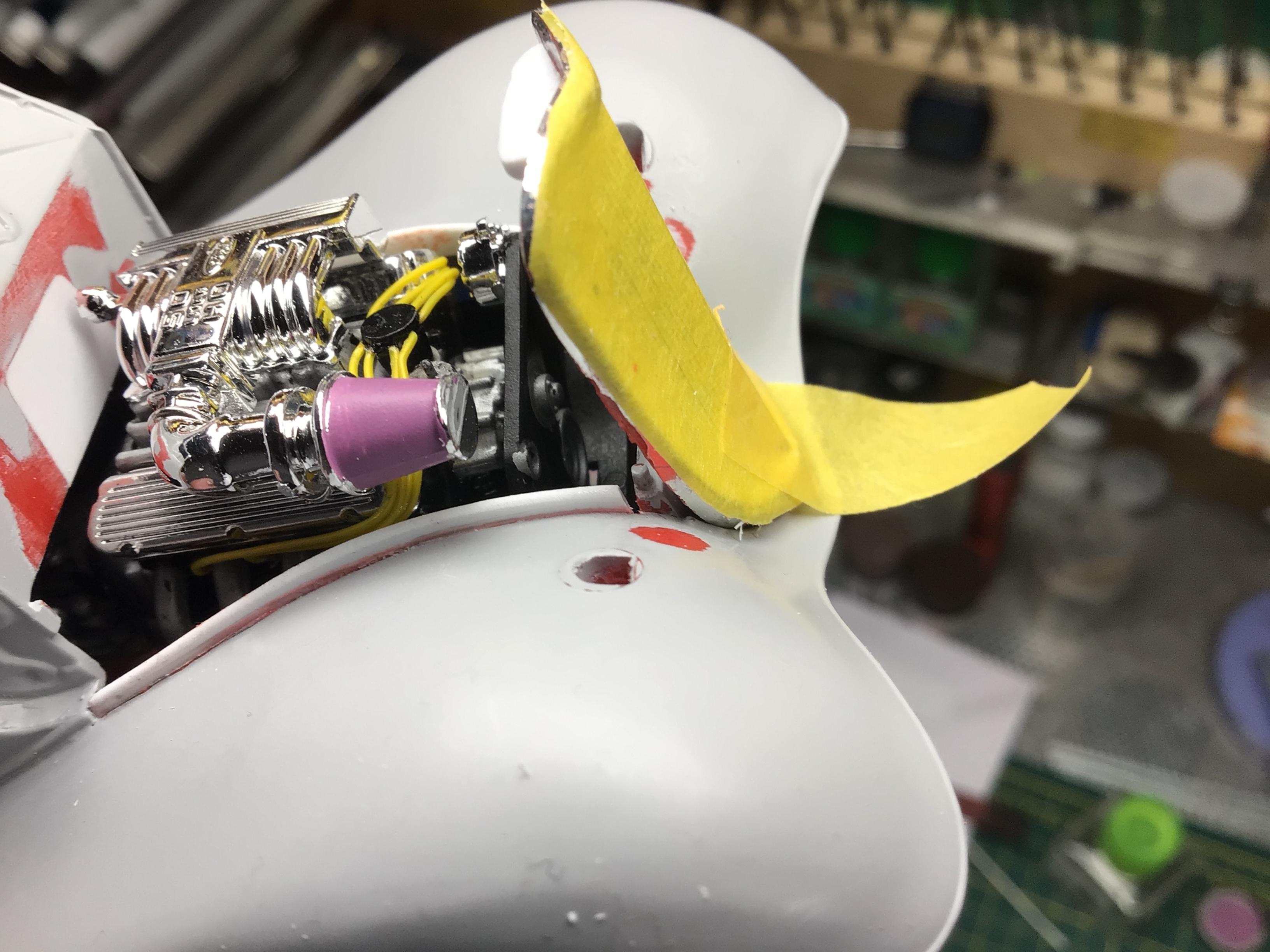

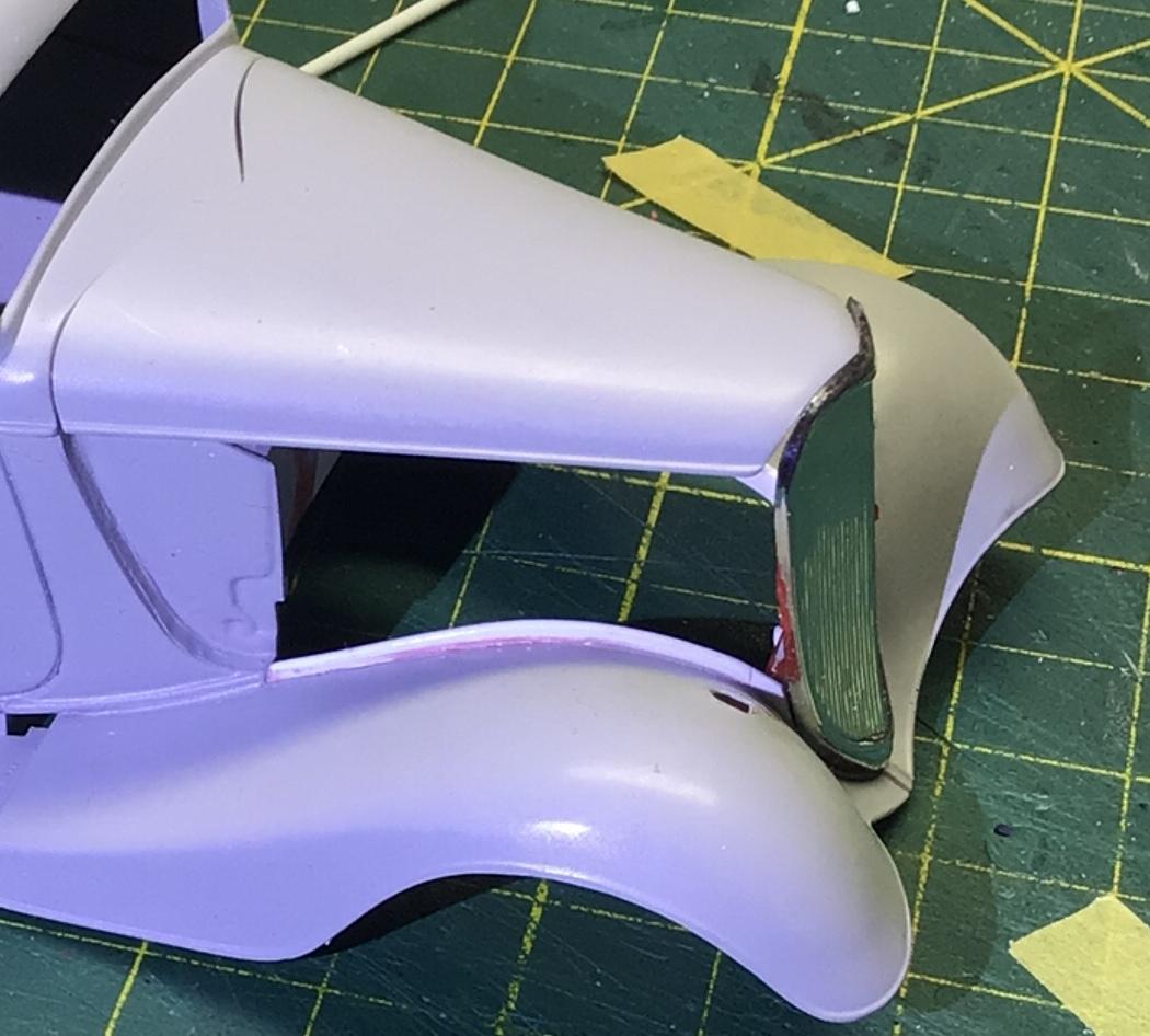

NOBLNG Posted November 25, 2022 Author Posted November 25, 2022 Thanks everyone!? It is a nice looking kit, but has the typical problems….like lack of decent mounting points.? I’m currently trying to get the grill mounted securely. I guess the hood sides that I am not using were the main support for it??♂️

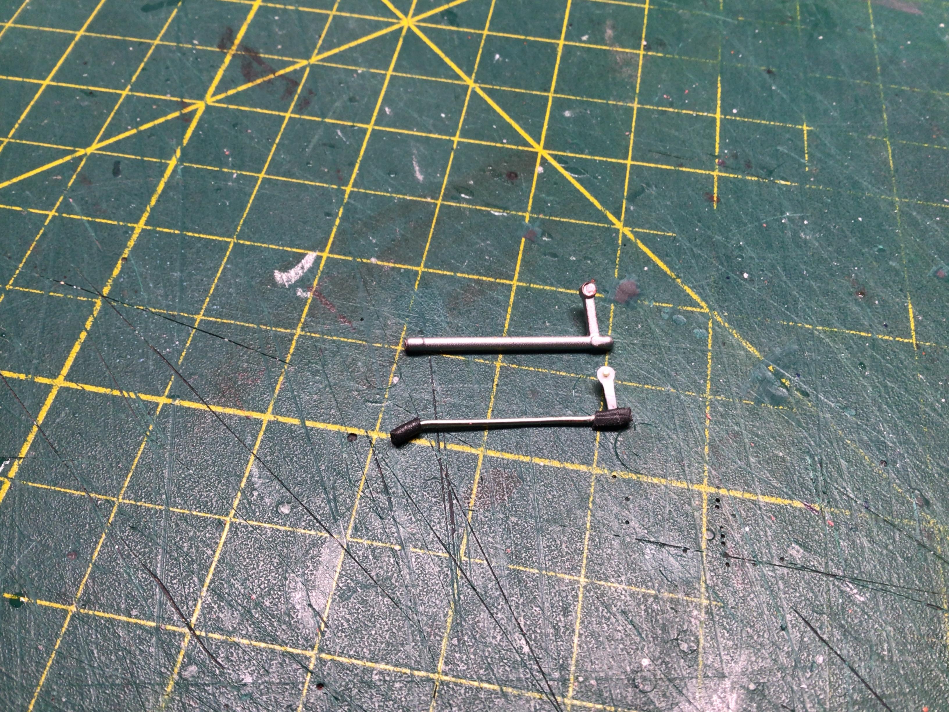

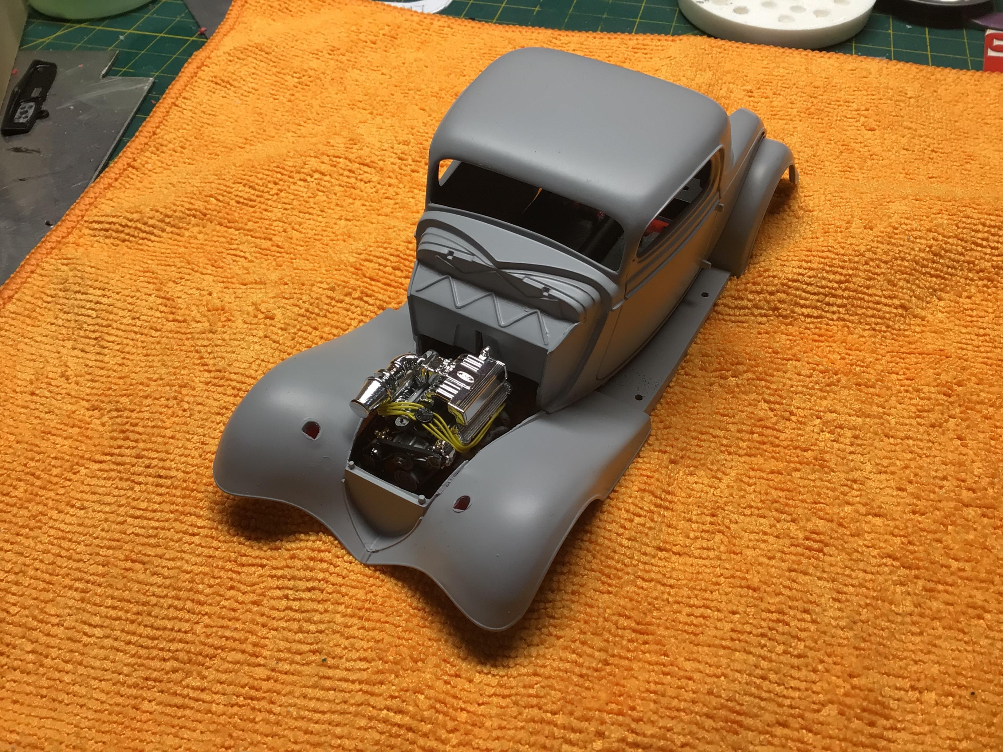

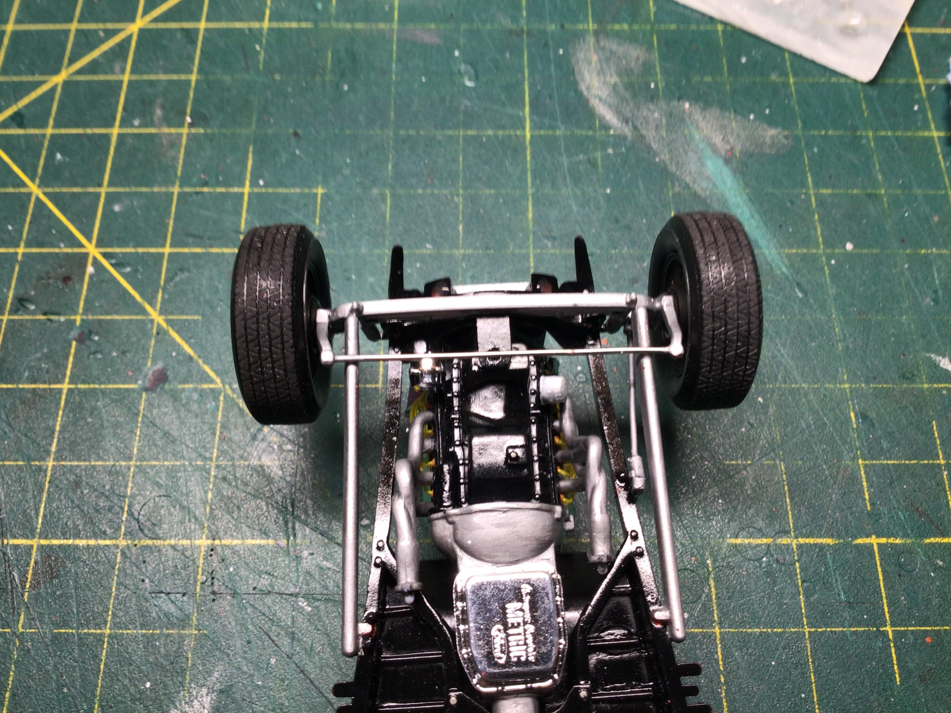

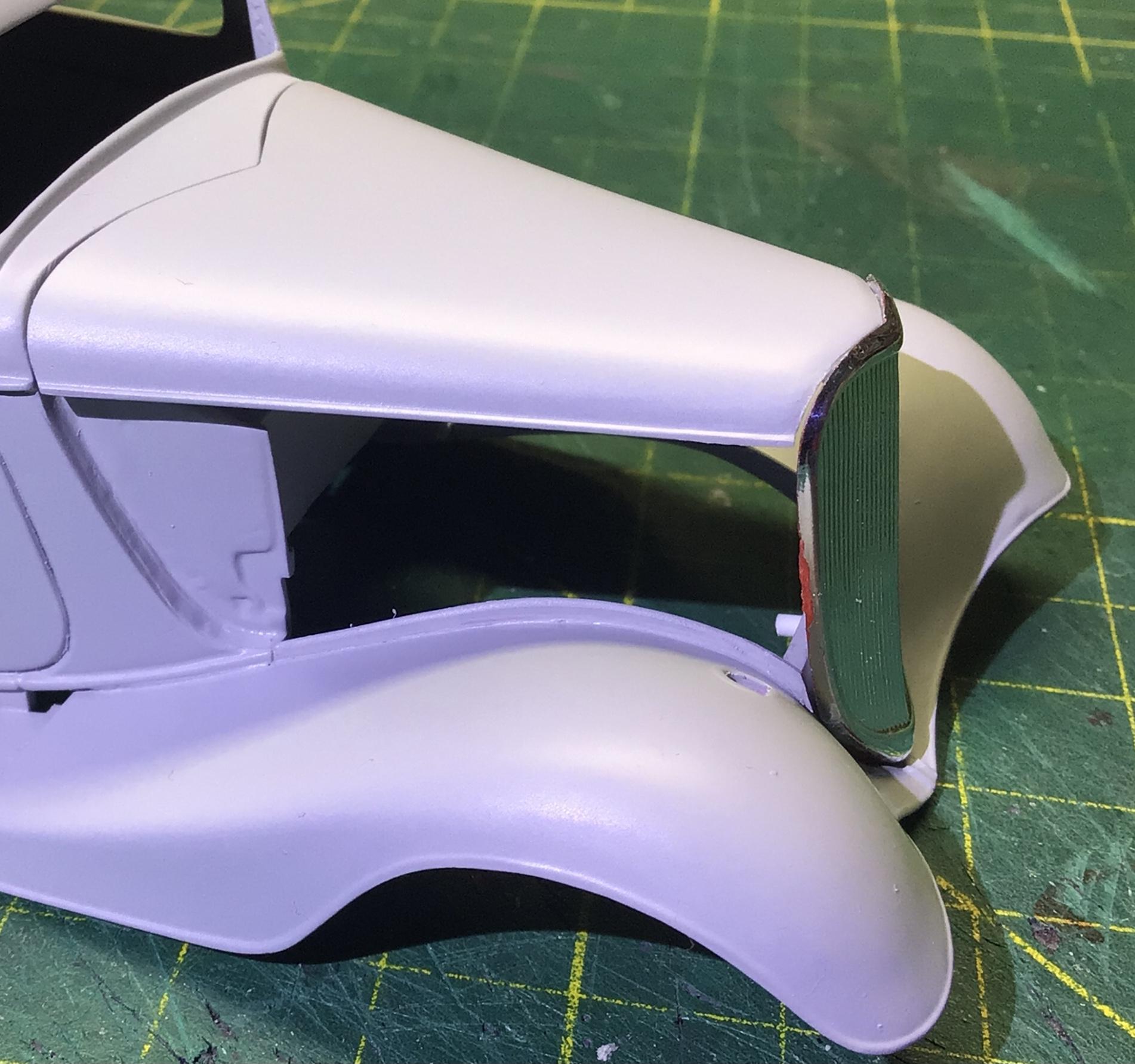

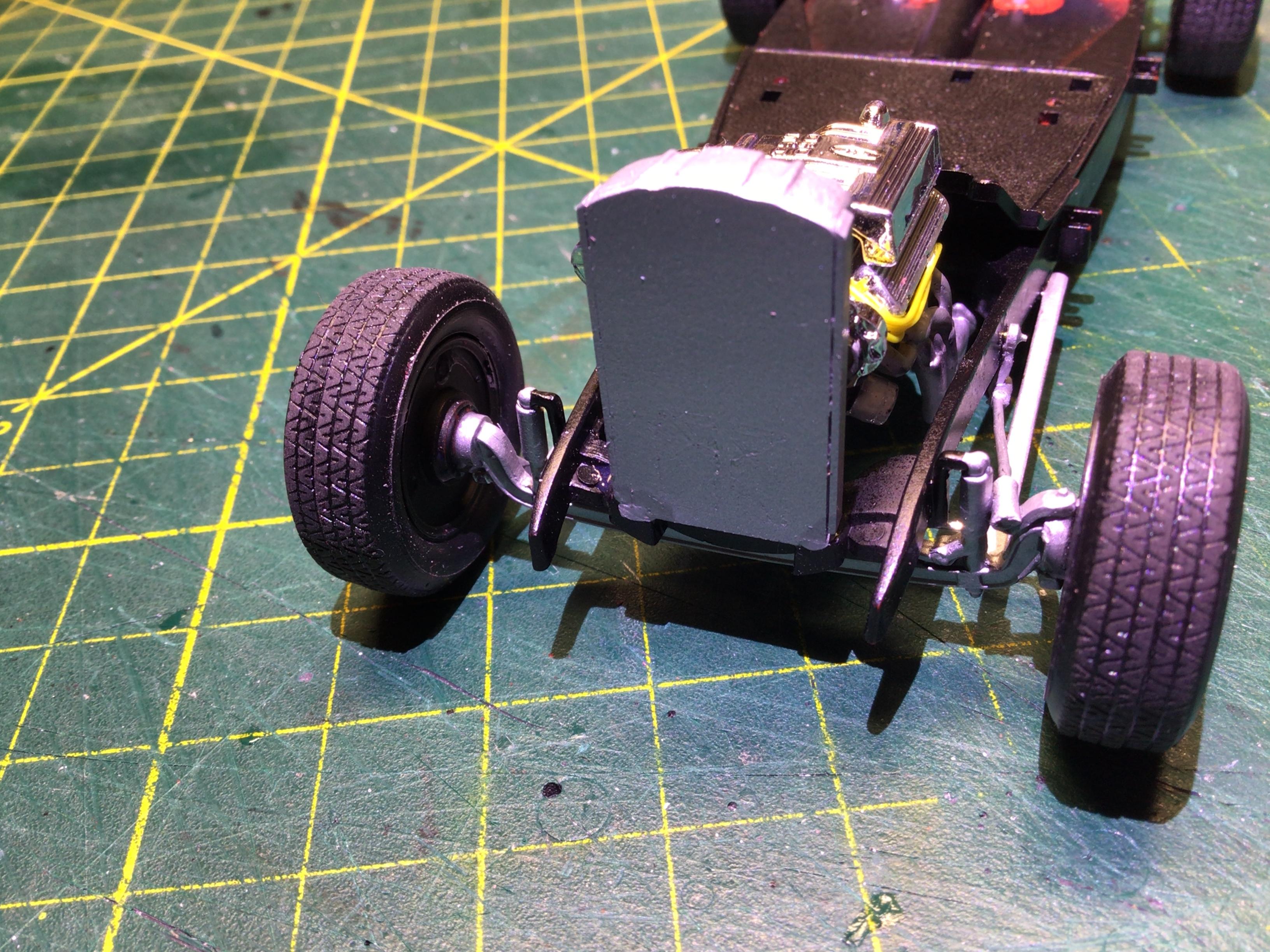

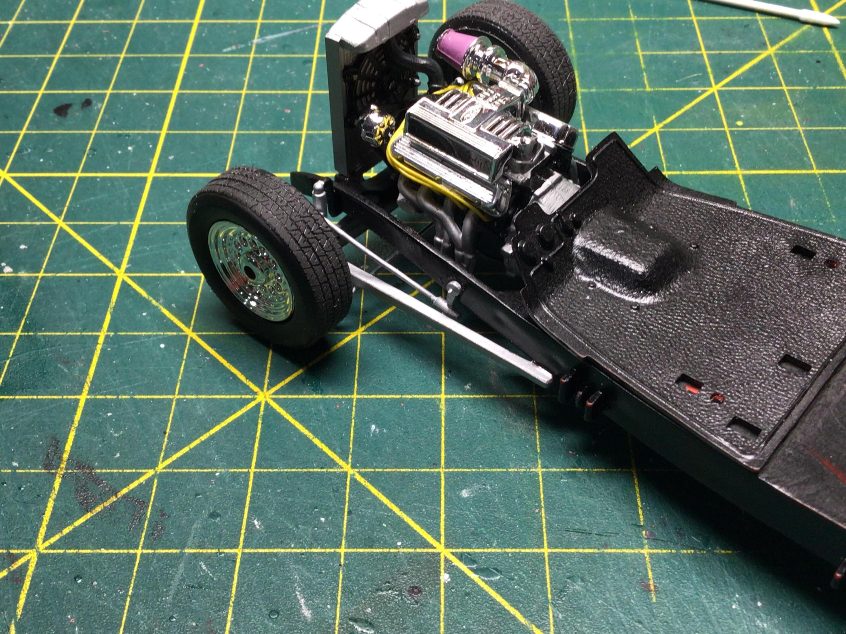

NOBLNG Posted November 27, 2022 Author Posted November 27, 2022 (edited) A bit more progress on this one. I have the wheels and radiator mounted solid now. I couldn’t get the tie rod to sit nice, and it’s way too short anyways, so I lengthened it with some .033” wire. I scratch built a new drag link also since there is no real connection point at the knuckle. I have the body ready for paint now I think. I added a bit of Milliput to the lower front hood edges so it meets up with the grill better. Edited November 27, 2022 by NOBLNG

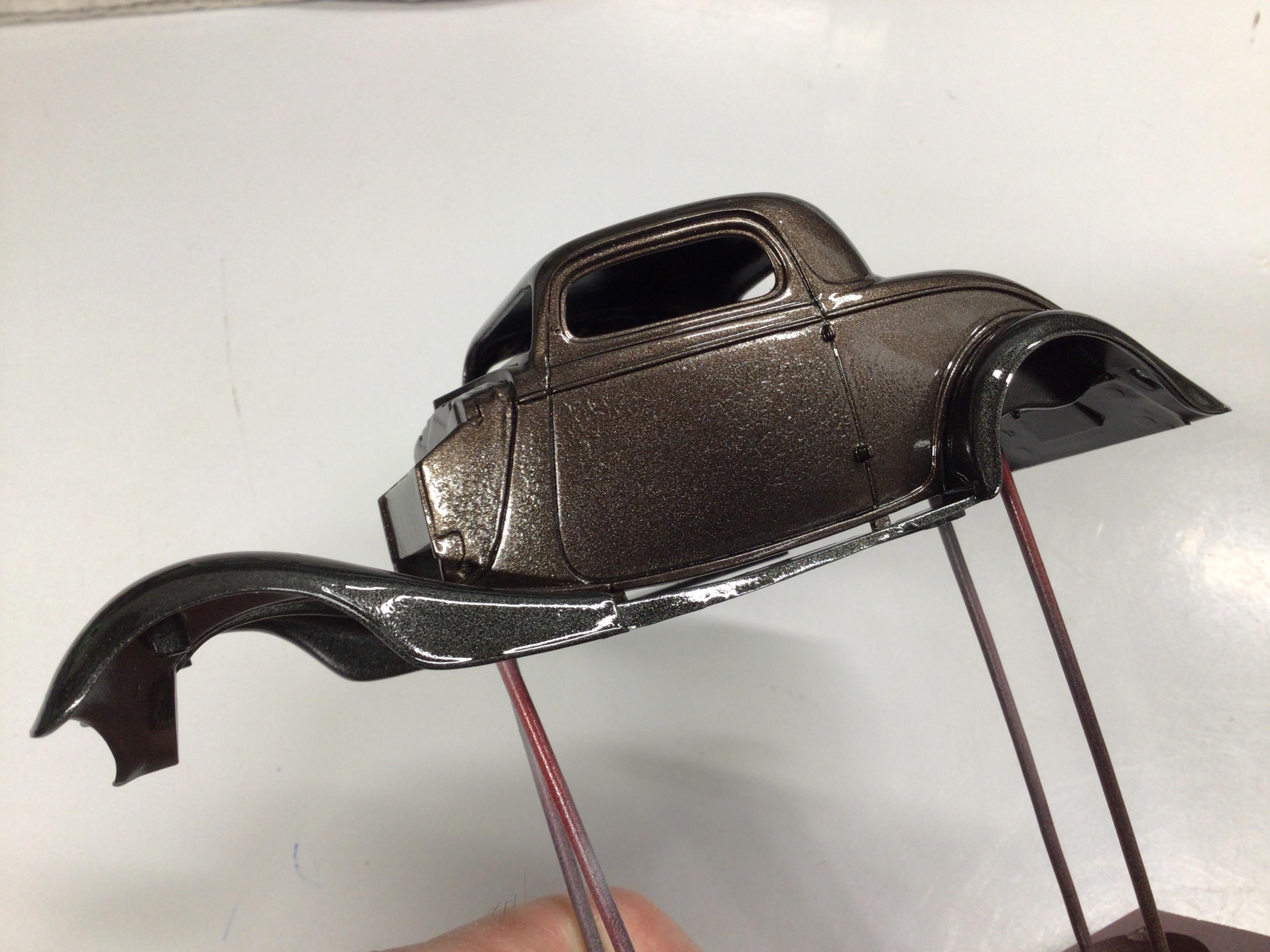

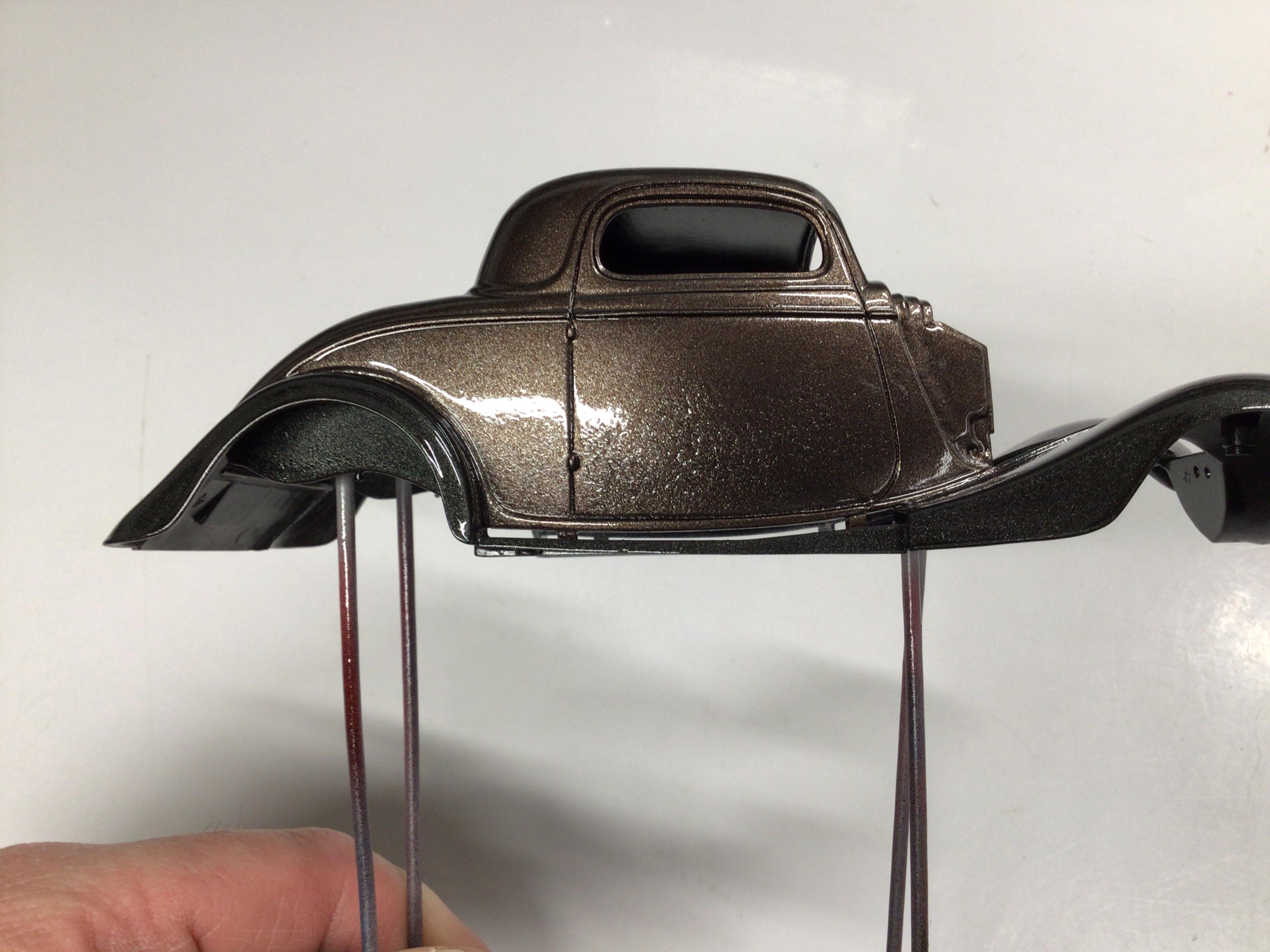

NOBLNG Posted November 30, 2022 Author Posted November 30, 2022 I got some paint on it. Tamiya X-33 bronze and Testors Blazing Black. 2

NOBLNG Posted November 30, 2022 Author Posted November 30, 2022 7 hours ago, slusher said: That a sharp color combination Greg! 2 hours ago, KWT said: hoowee... that's looking nice 1 hour ago, FLHCAHZ said: Looks great! That color changes teh entire look Thanks Guys! I wasn’t thrilled with it when I peeled all the tape off. A little bland looking I thought. I think once I get the chrome engine and wheels installed it may spice it up a bit though.?

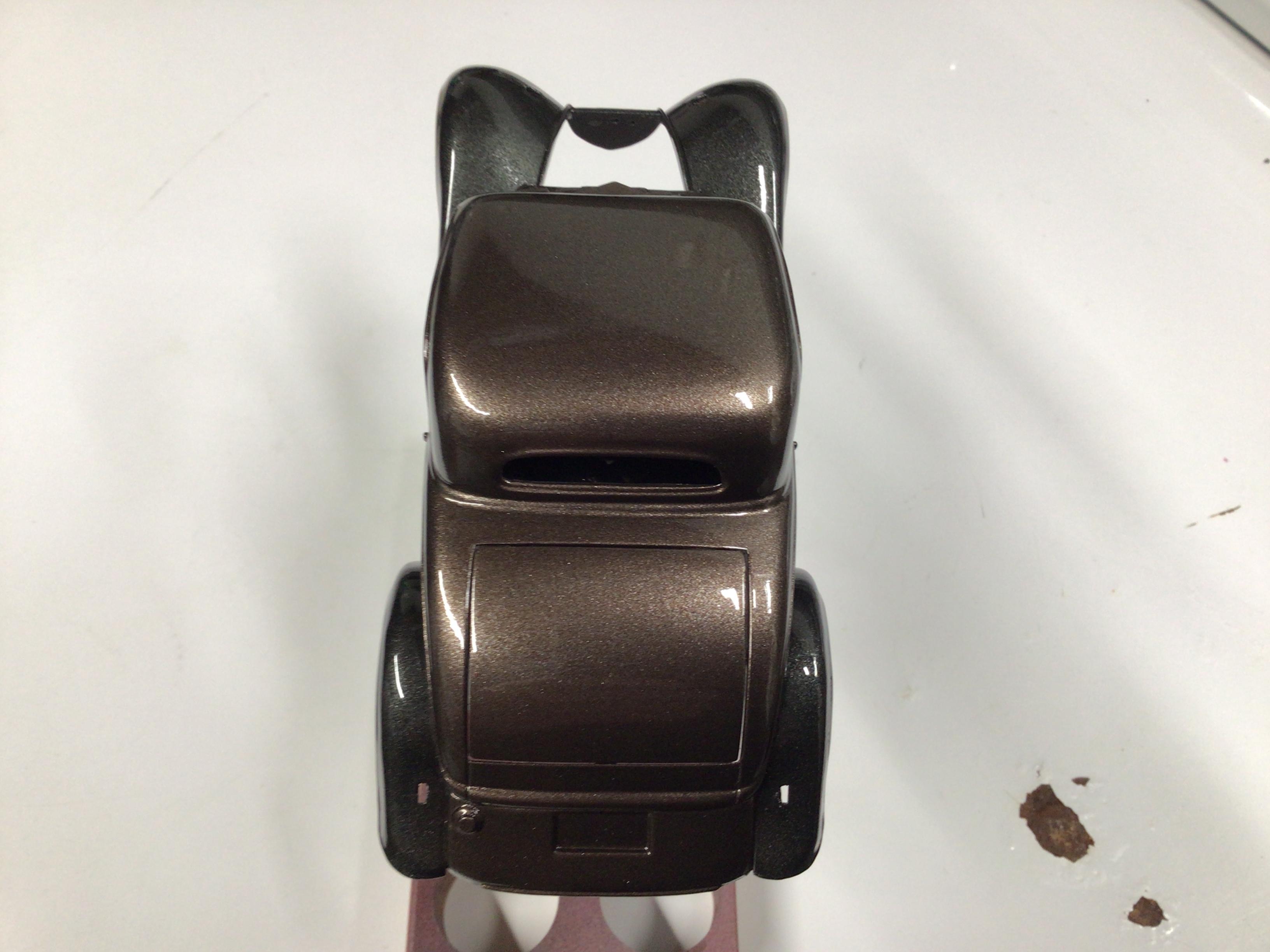

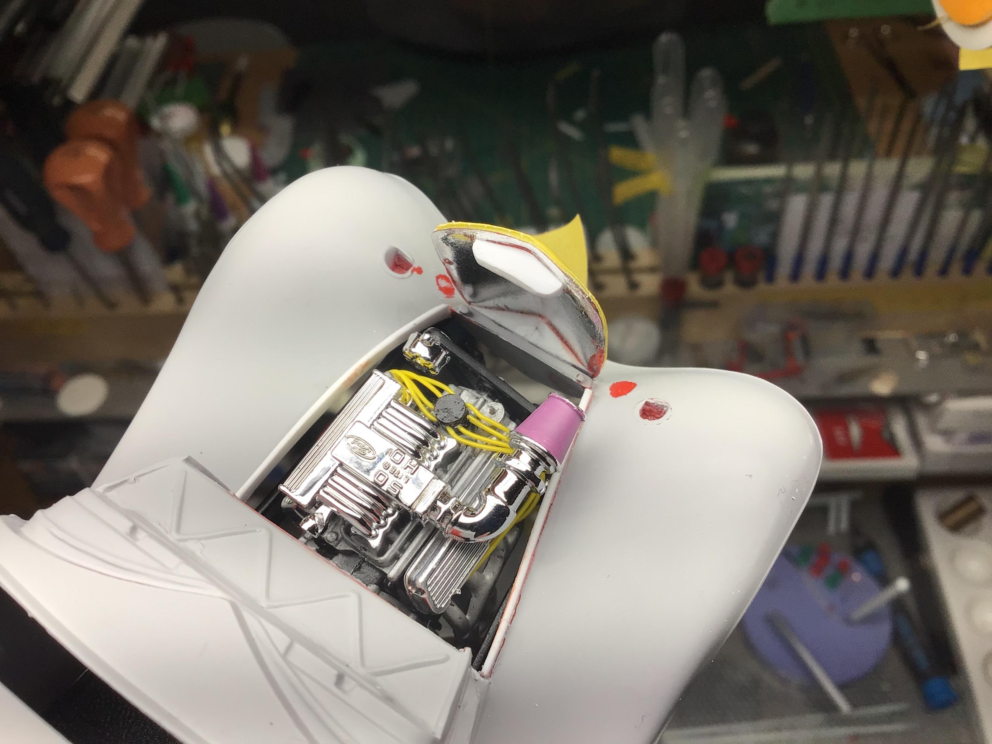

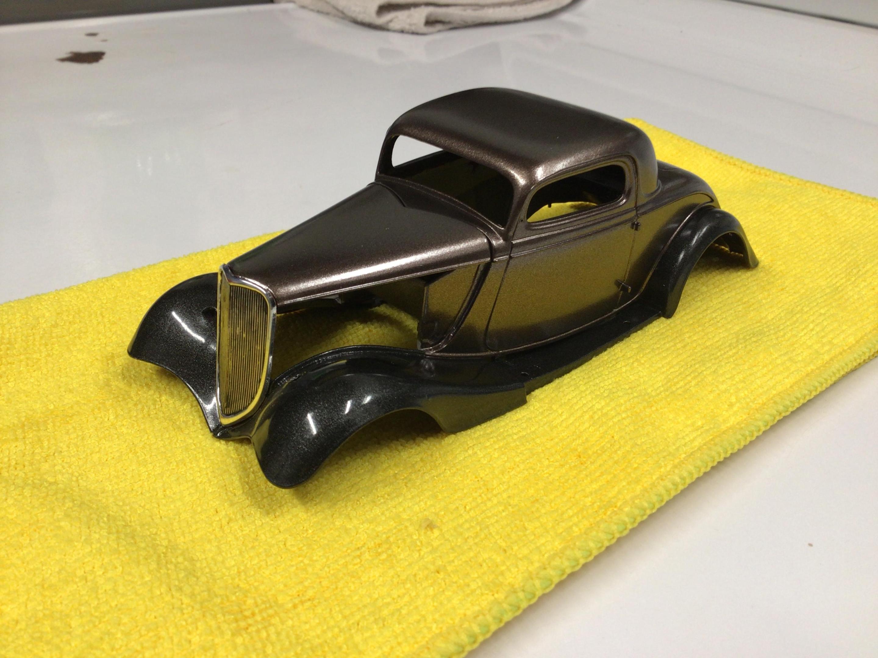

NOBLNG Posted December 8, 2022 Author Posted December 8, 2022 (edited) I should have left well enough alone. I sprayed some acrylic clear and the first coat went on nicely. The second coat crinkled on the doors. The roof, trunk and fenders are fine. So I gave the doors a light sanding and put another coat on and got the same results. I guess it’s going into the pond.? Edited December 8, 2022 by NOBLNG
dino246gt Posted December 8, 2022 Posted December 8, 2022 I hope you don't submerge it, probably just needed more time for the paint to gas out, maybe, hopefully? Do the light sanding and a good washing, then let it sit for a few days before more clear. Or use the dehydrator. I'm sure it'll turn out looking great!
NOBLNG Posted December 8, 2022 Author Posted December 8, 2022 1 hour ago, dino246gt said: I hope you don't submerge it, probably just needed more time for the paint to gas out, maybe, hopefully? Do the light sanding and a good washing, then let it sit for a few days before more clear. Or use the dehydrator. I'm sure it'll turn out looking great! I haven’t dunked it yet. I might try polishing it out? The bronze is a Tamiya acrylic and it sat in the dehydrator for a long time before the clear. The clear is a spraybomb from Rondex that I bought for fixing the door hinges on the wife’s Jeep. It worked fine on the previous project and 90% of this one.?
bobthehobbyguy Posted December 8, 2022 Posted December 8, 2022 Great color. Hope you can save it. Unfortunately mixing paint brands is always dicey.

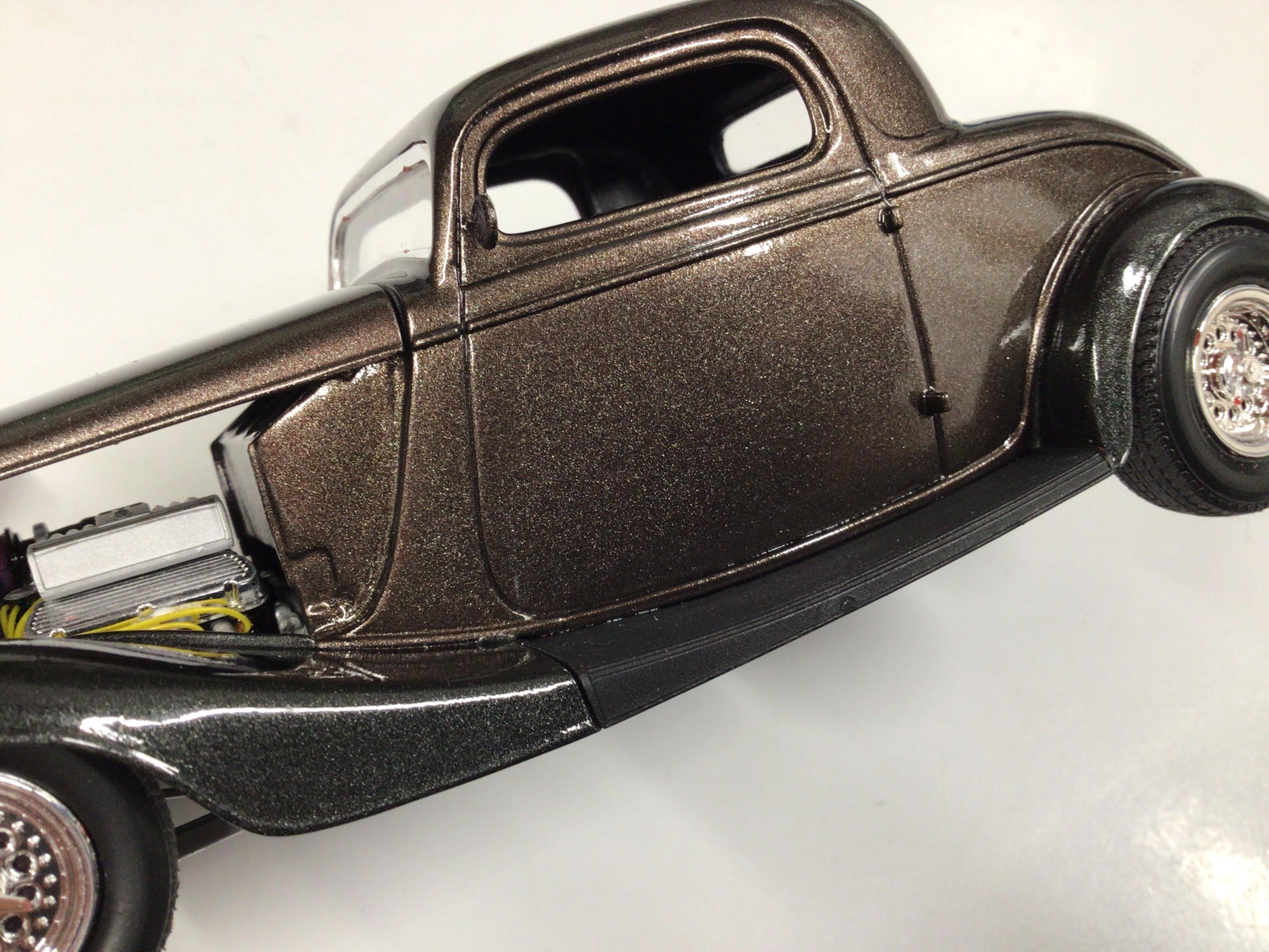

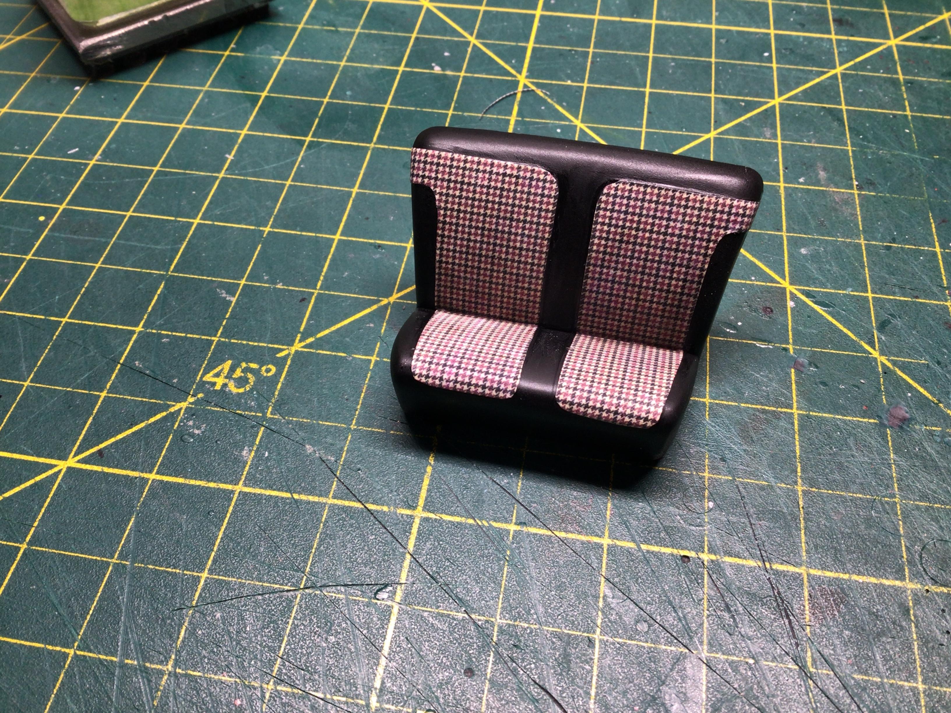

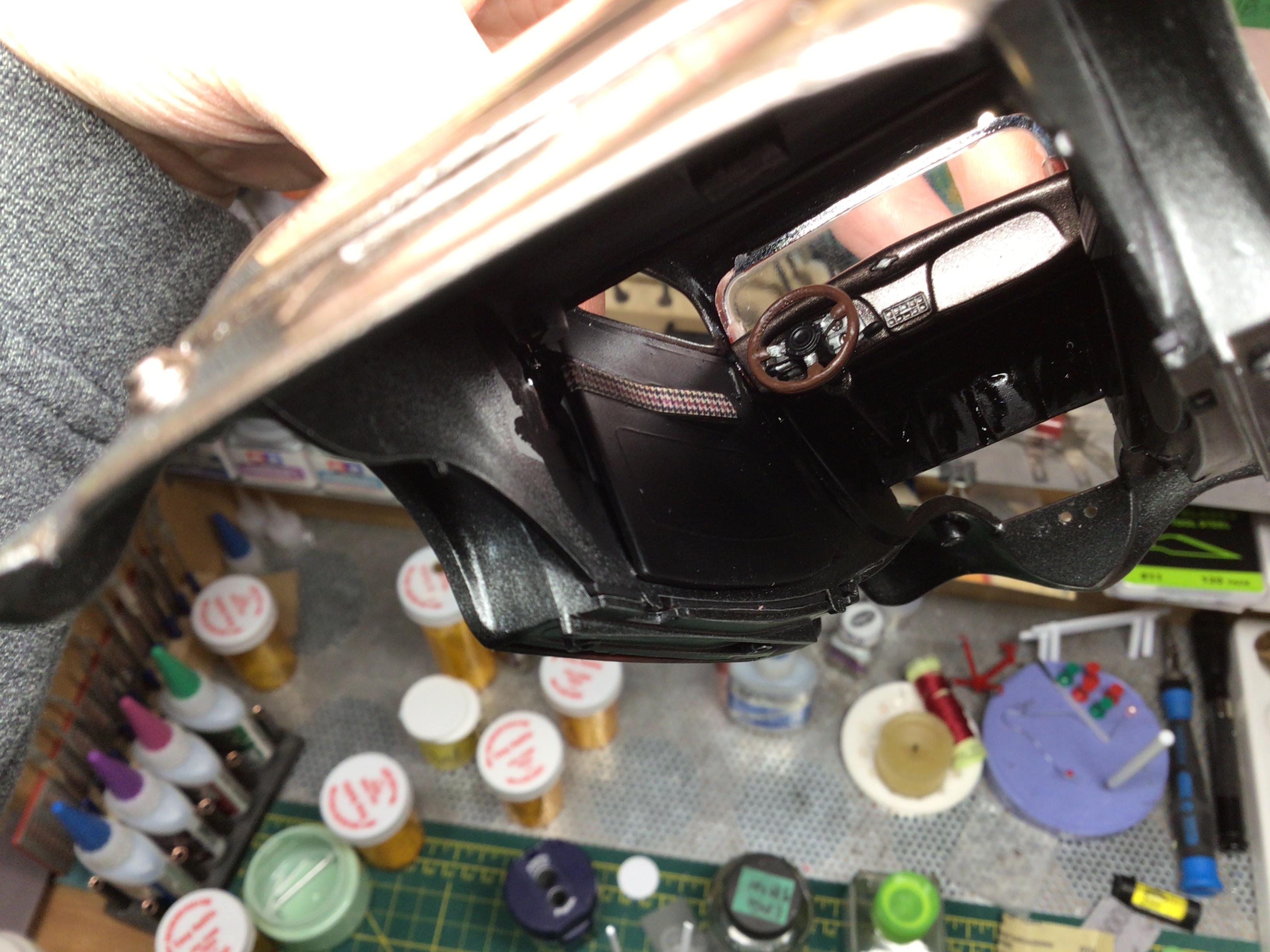

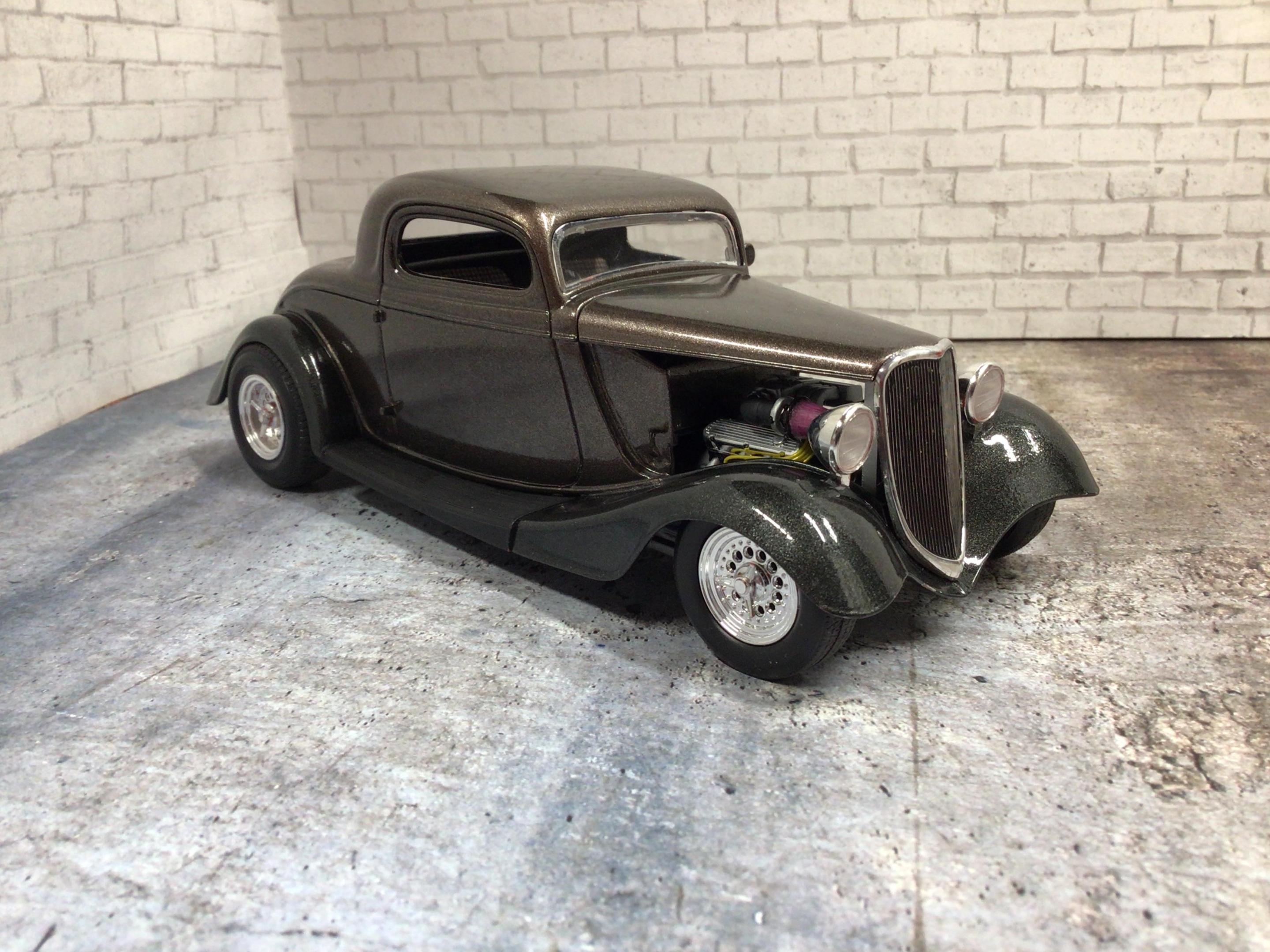

NOBLNG Posted December 12, 2022 Author Posted December 12, 2022 (edited) I managed to save the paint job on this. After sanding it down again, I decanted a bit of the clear and sprayed a couple really light coats through the airbrush before a heavier coat from the can. It’s not perfect, but probably as good as a repaint might turn out.? I added a little houndstooth upholstery to the interior even though it isn’t too visible in there. More pics under glass here: http://www.modelcarsmag.com/forums/topic/177032-‘33-ford-3-window-coupe/ Edited December 12, 2022 by NOBLNG
