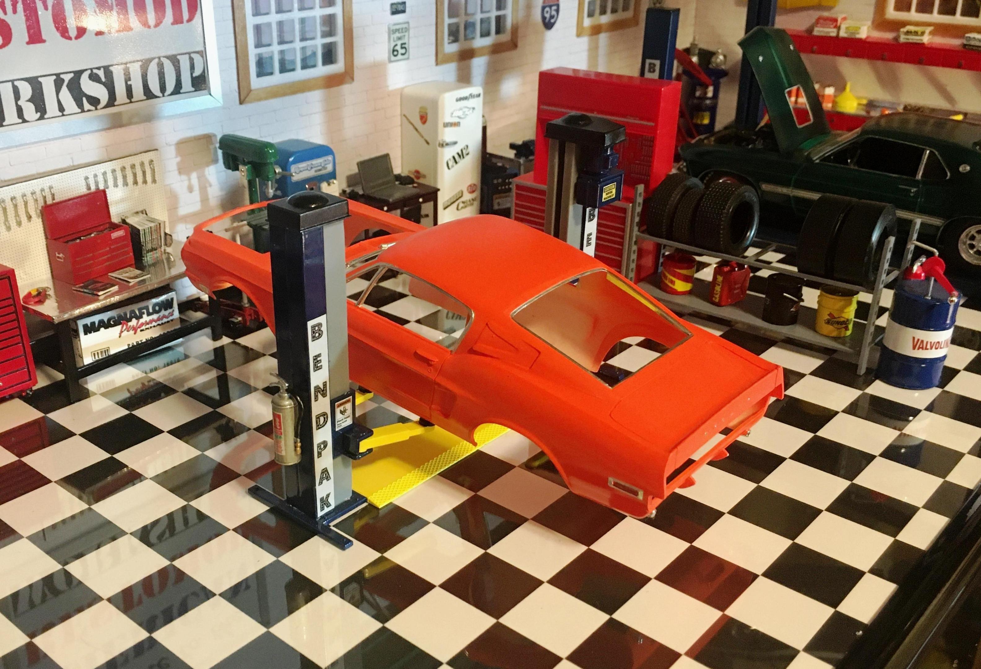

Bills72sj Posted December 5, 2022 Posted December 5, 2022 I have accidentally made flat paint by decanting a Testors Gloss Competition Orange and then thinned it too much with lacquer thinner for airbrushing.
