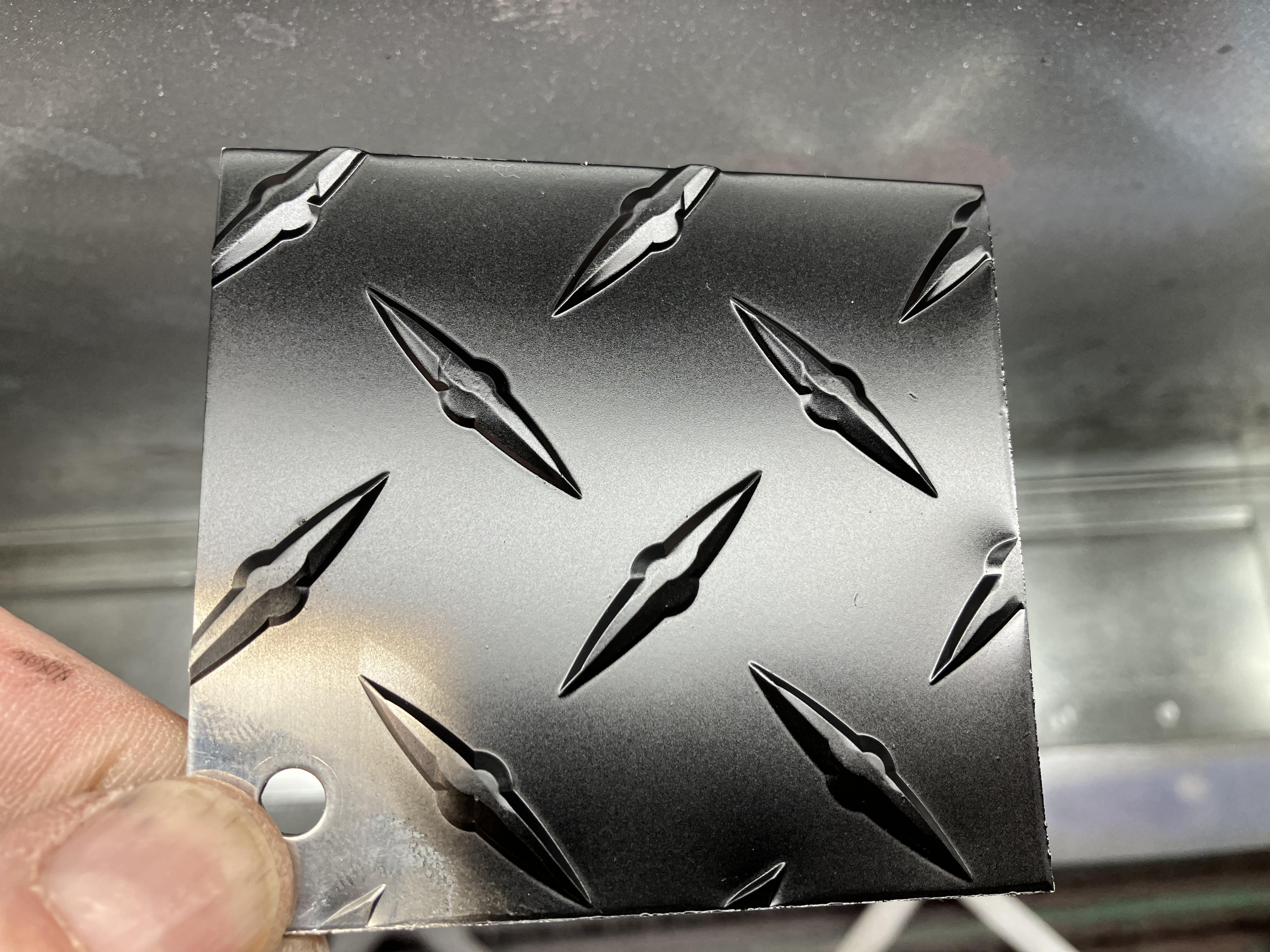

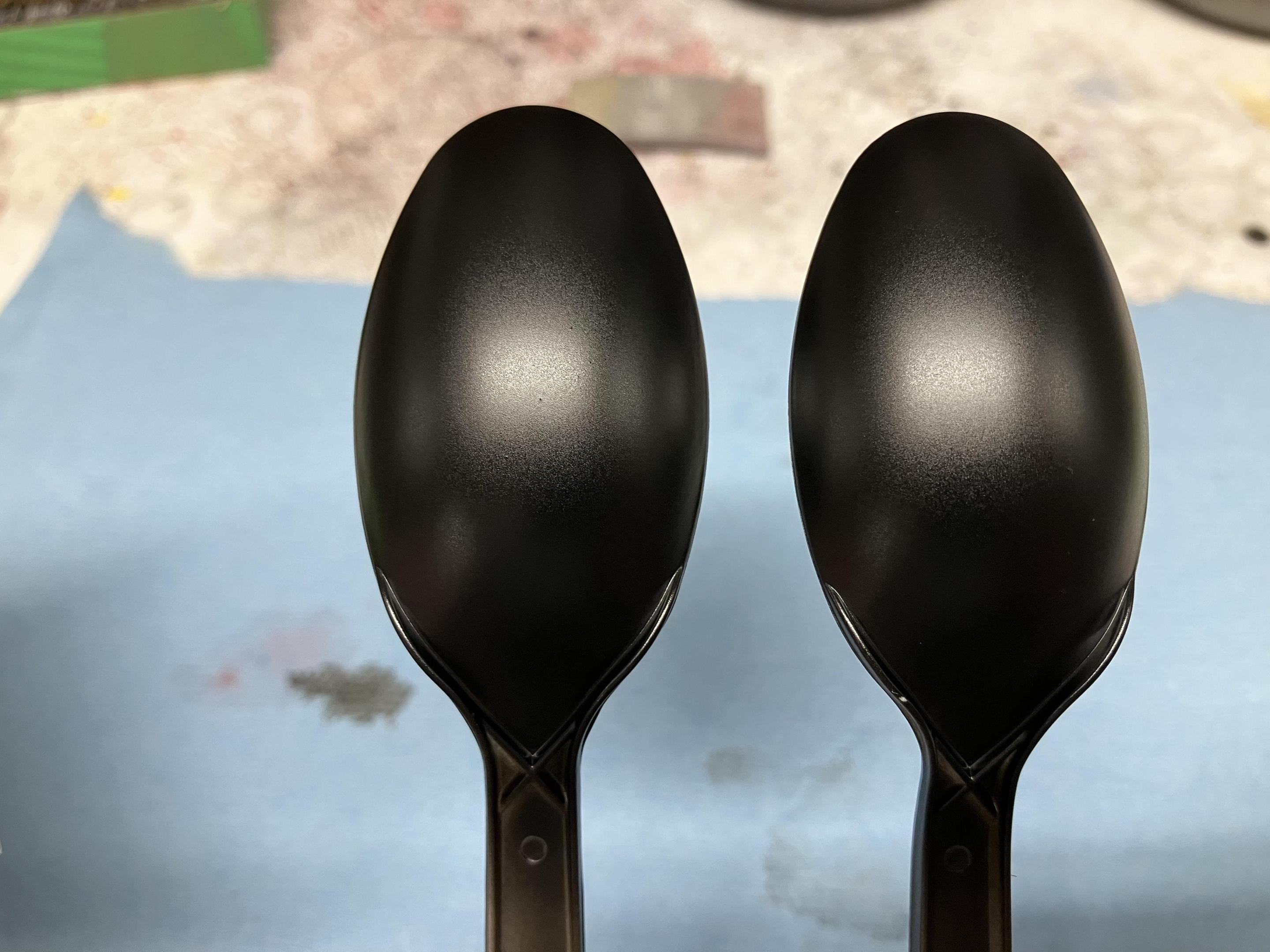

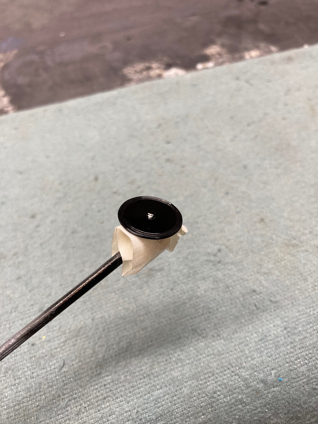

I had some spare time today so I did a test with some tremclad semi gloss that I have. I thinned it approximately 1:1 with lacquer thinner. It sprayed real nicely I think. Tremclad is made by Rustoleum and marketed in Canada. I believe it is likely the same stuff as Stevens first picture., although I couldn’t find a comparison that would verify it.

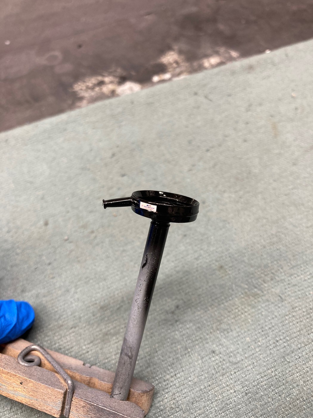

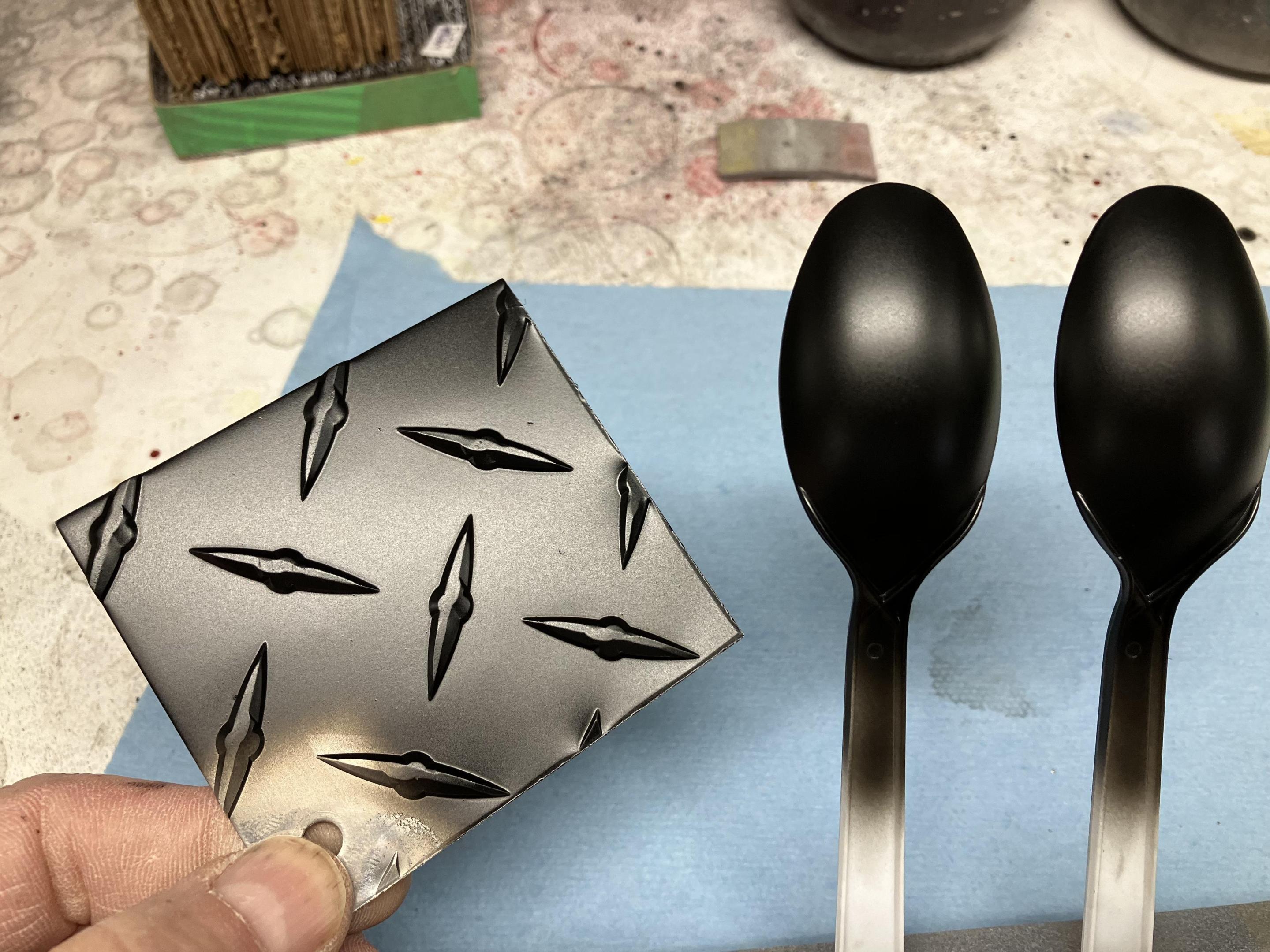

I did a preliminary test of the Rustoleum just a short time ago, and as someone had already stated, it's pretty thick in the can, (probably a little thicker than Testors) so it requires quite a bit of thinning, which in my estimation, is a good thing as it will be more economical.
The first thing that I noticed when I opened the can was that it smelled exactly like Testors enamel, which is also good, as it will be a familiar product to work with.
I sprayed some of the thinned satin paint, thinned with lacquer thinner, (although it appears that thinning a little more than 50-50 would be better) directly on to a bare piece of sprue, (no primer)
It sprayed pretty well and laid down very smooth.
After about a half an hour of drying time, it's pretty dry to the touch, and appears to be drying much faster than the decanted paint did (although it's still a little tacky) and it has the exact satin sheen that I was hoping for.
I think with just a bit more thinning, this stuff should be just the ticket for an economical satin black paint.
Tests for the gloss and flat will be done at a later time.
Steve

It looks like you're headed to 1.25-1 thinner to paint. Gonna be good stuff !!

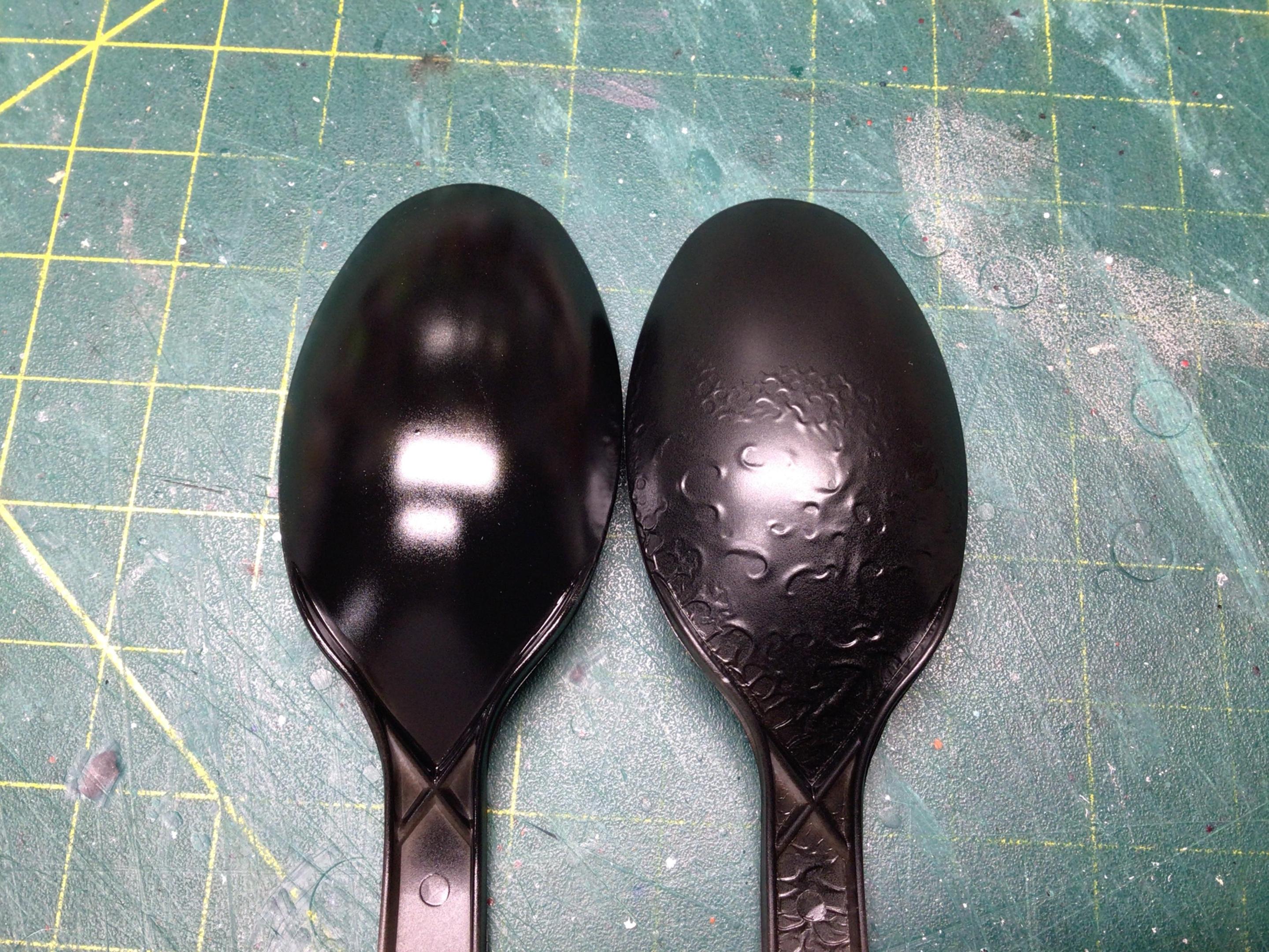

Just FYI. Same two spoons with Mr. Hobby UV Cut clear gloss on the left spoon and Tamiya TS-79 semi gloss clear on the right one.
Well, it is an enamel paint, so using a lacquer clear over it is most likely going to be a risky proposition.
Steve

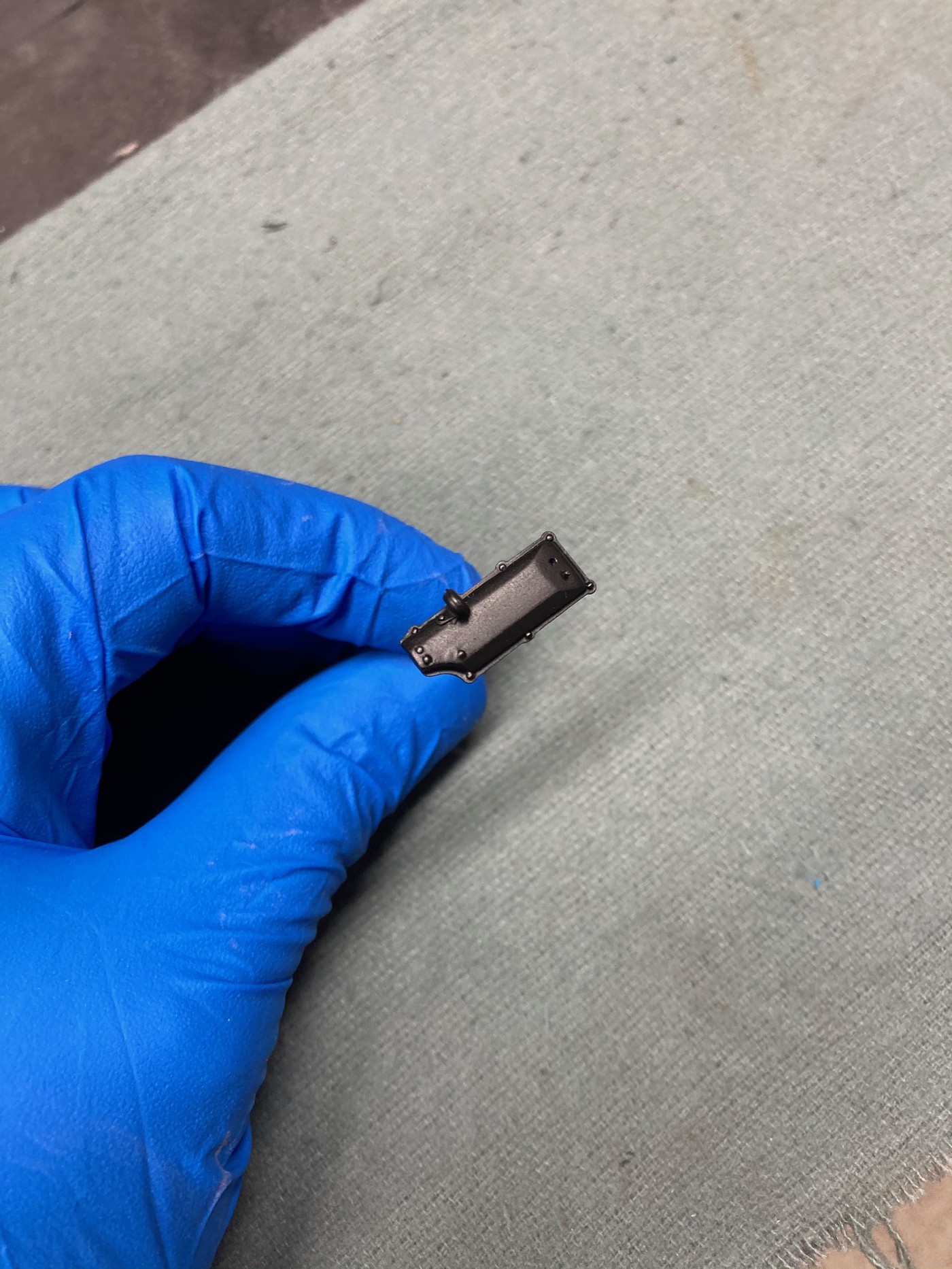

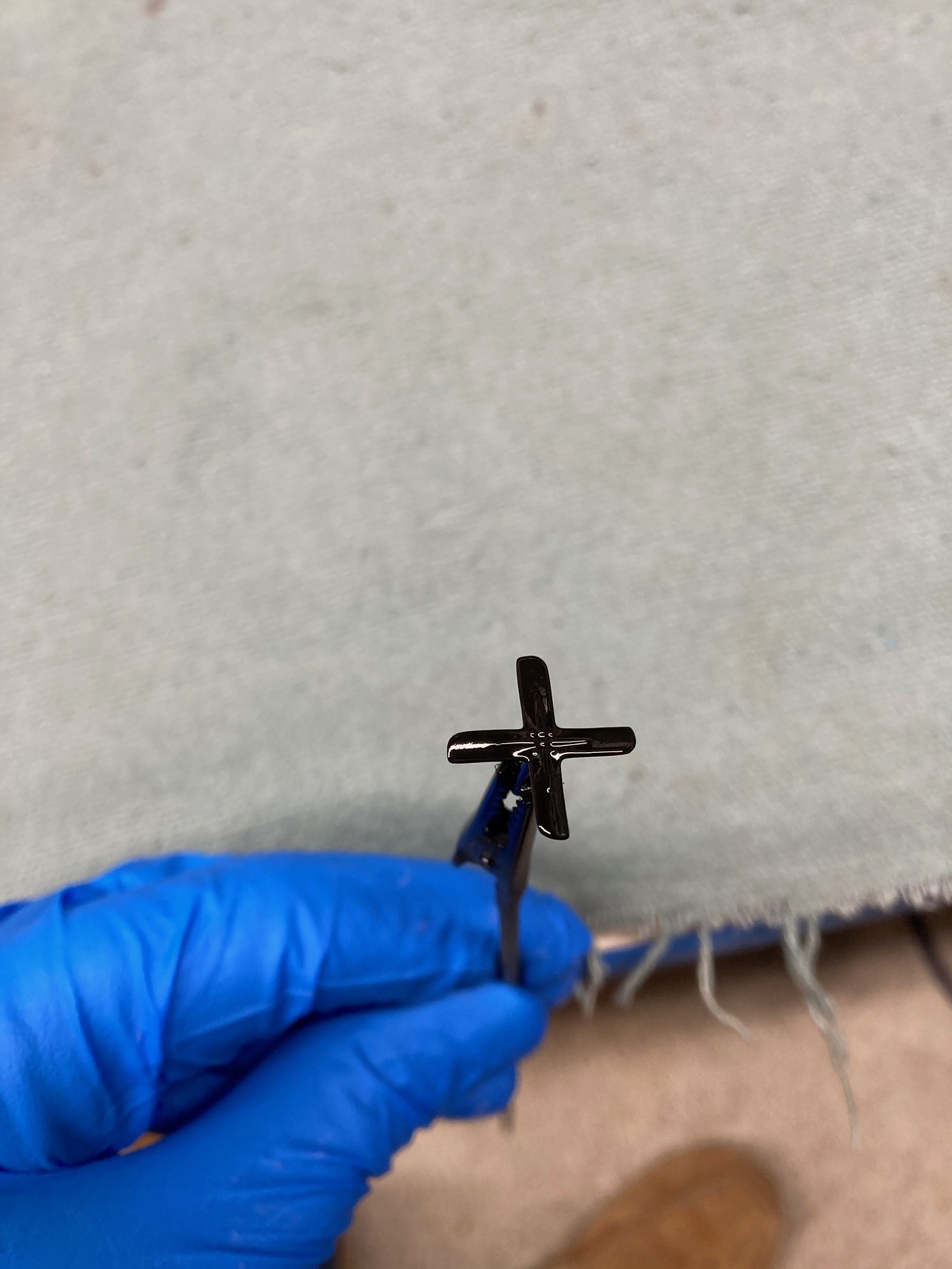

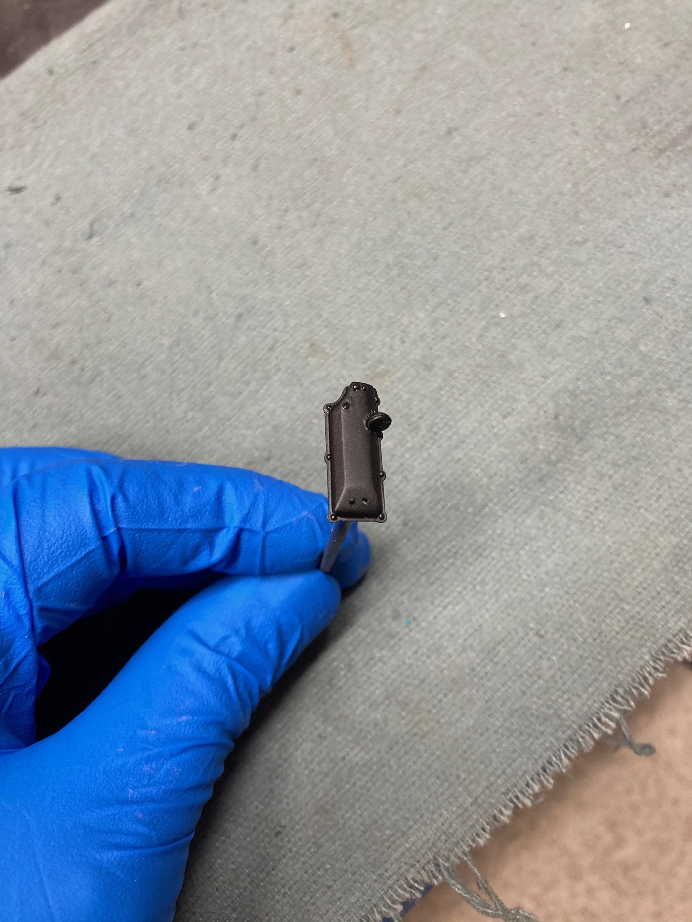

In case anyone is interested, here are a couple of parts airbrushed with the canned Rustoleum paint.
Heater box painted in satin:
Fan and Starter painted in gloss:
I've got some flat mixed up for airbrushing, but have yet to try it.

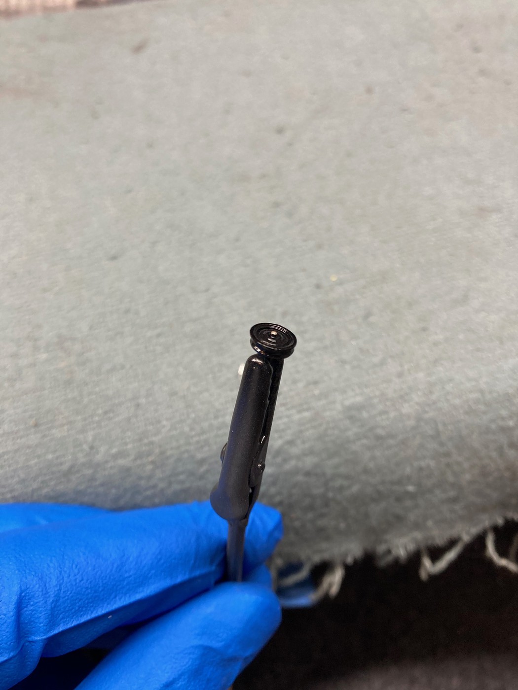

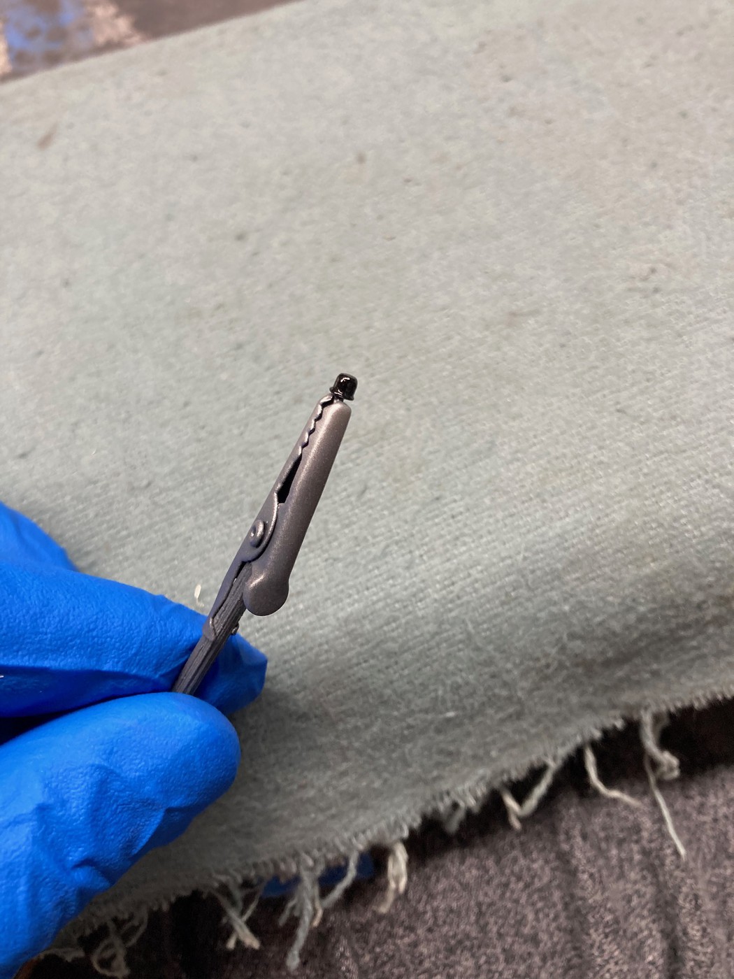

Did some painting today, some of which included spraying Testors clear lacquer over this black enamel paint.
It all went exactly as it would have with the little bottles of Testors enamel.
Seems as if my days of wasting $3.00 on a 1/4 oz. of paint is over.
At least for some colors.
Steve

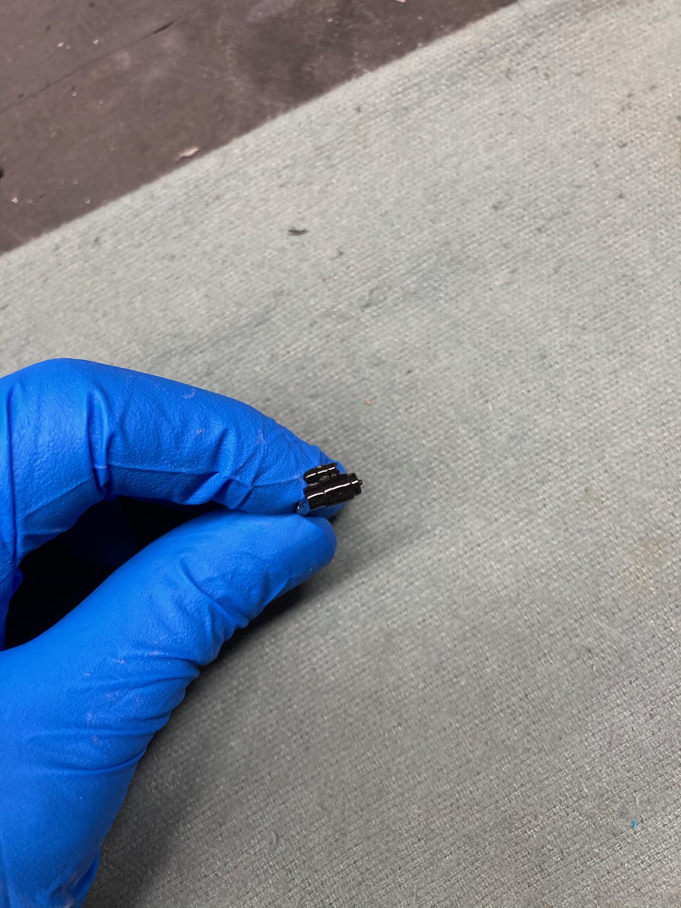

I gave this a go as well, using the satin black. Great results airbrushing it.  I now have a new “go to” for frames, engine parts and some interior components. Thanks for bringing this to our attention!
