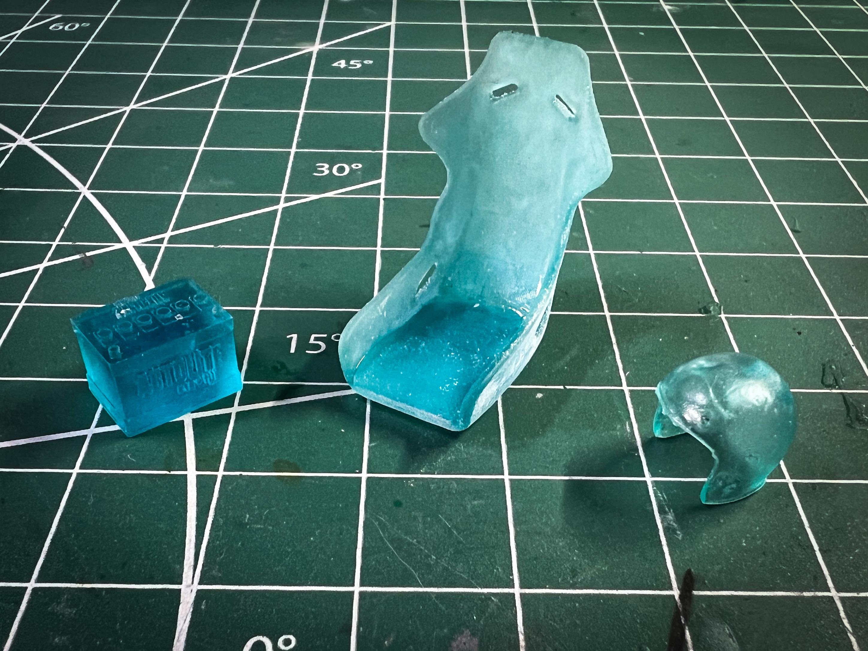

Next step: the wheels - what can we do to THOSE to add some detail and realism?  Well, first thing that struck me was the lugnut detail is kinda soft and uninspiring, so I drilled them out…
…and 3D printed a whole bunch of replacements…
…and now I have separate pieces that I can paint more easily and that look a little better I think:

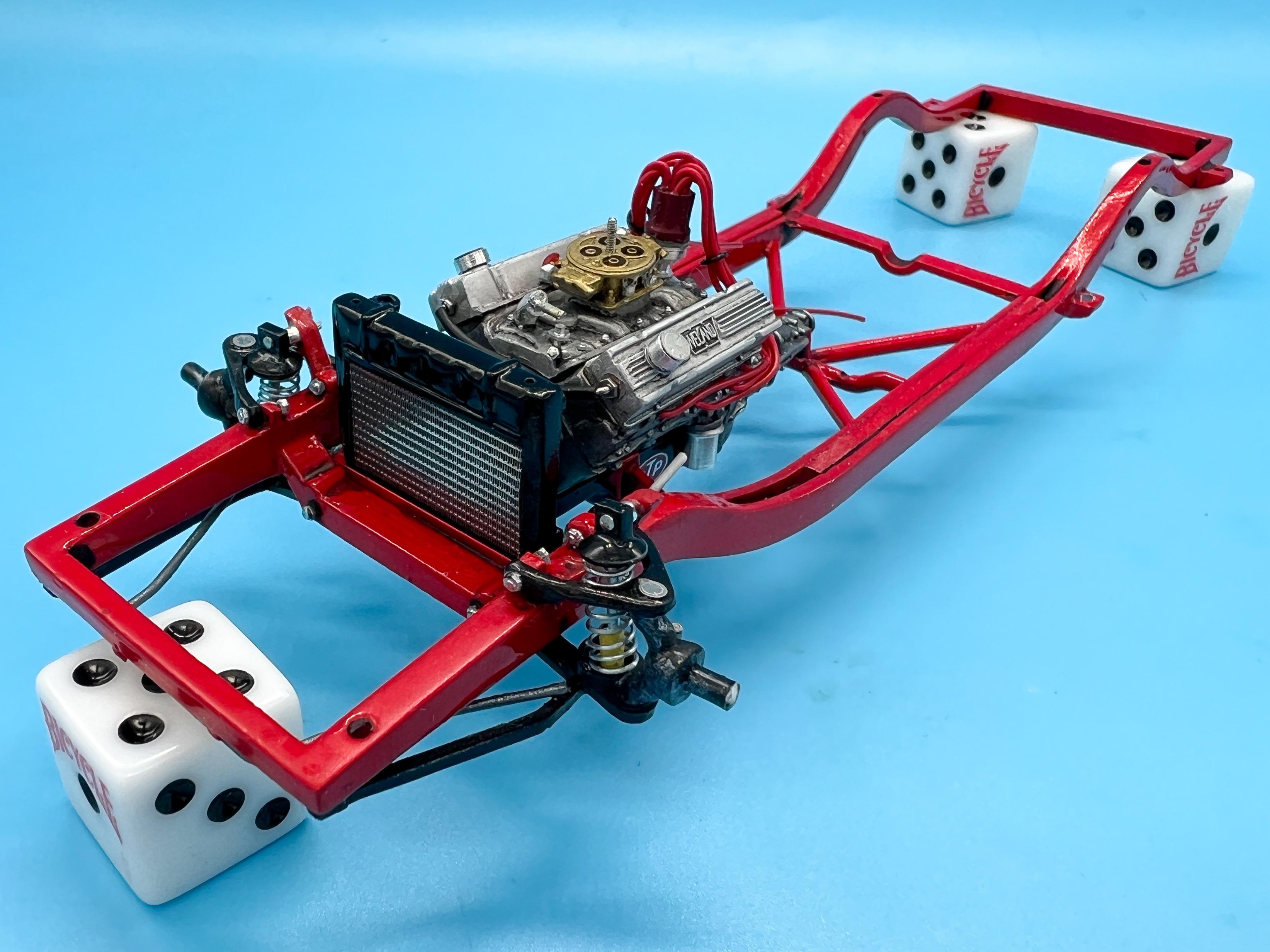

Another update, seeing as I’ve been kinda bad about posting updates…I’m kinda in that ‘primer and paint’ stage where nothing is really getting BUILT right now, but I made SOME progress anyway…

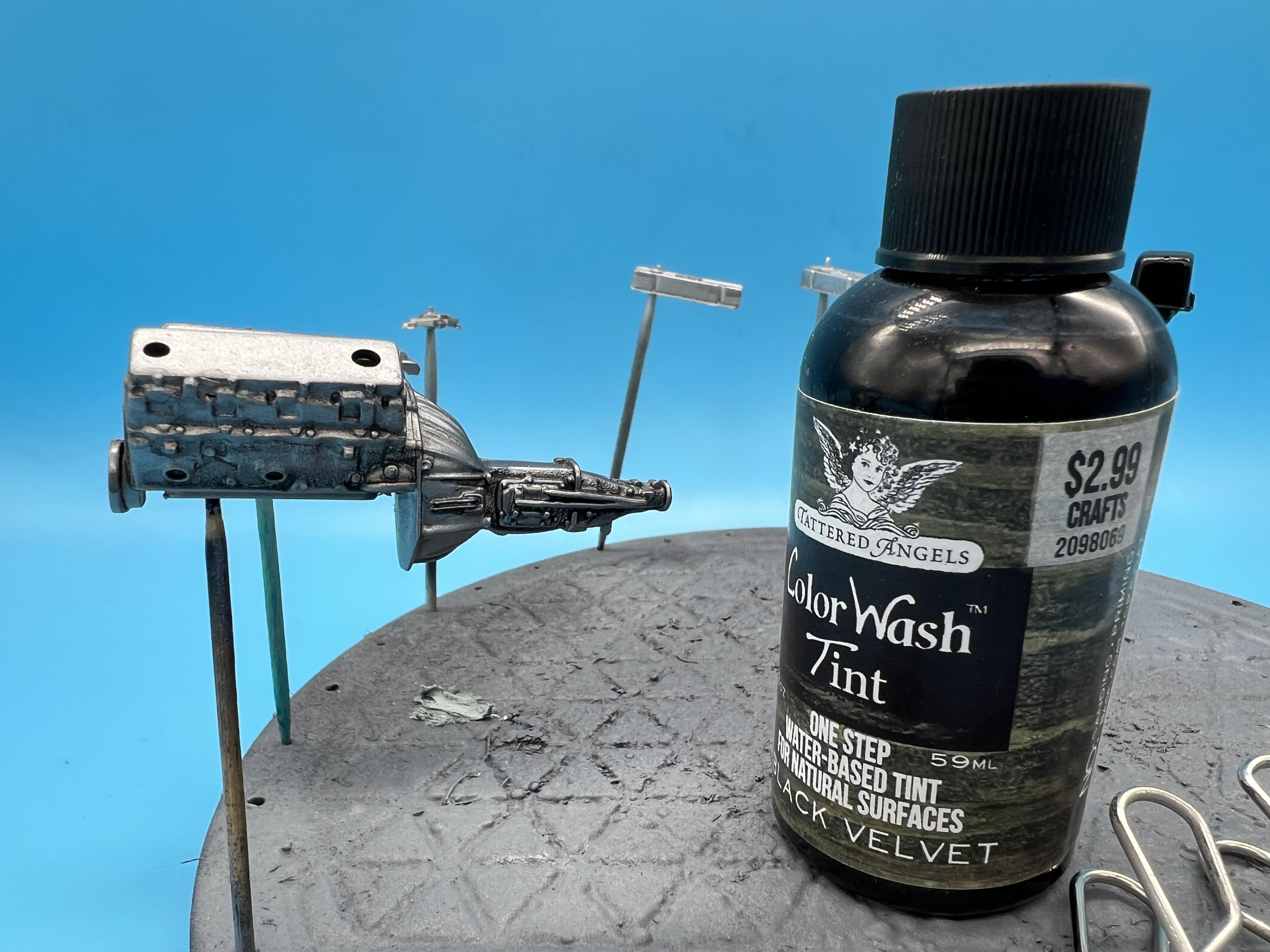

Got the engine components painted in various metal finishes, plus some of the suspension components…
…and then gave all the mechanical bits a blackwash.  I’m going for used-but-not-ruined as my weathering ethos on this…just a nice clean well-maintained car that has maybe just been refreshed a little for a fresh season at the track:
The intake manifold is amongst the more complex parts on the engine in terms of adding detail - drilled out all the molded-in holes and replaced them with 3D printed nuts and bolts:
Those washes really help bring out some detail in these parts, especially coupled with a lighter colored fastener…
I spun up some parts on the lathe and used some aftermarket pulleys to start dressing this thing up…plenty left to do still but I’m kinda building this as I go so I don’t lose any crucial tiny pieces 🤪
Shot the carb too - need to make a plate to mount it to the intake and then figure out all the details THAT will have added to it:

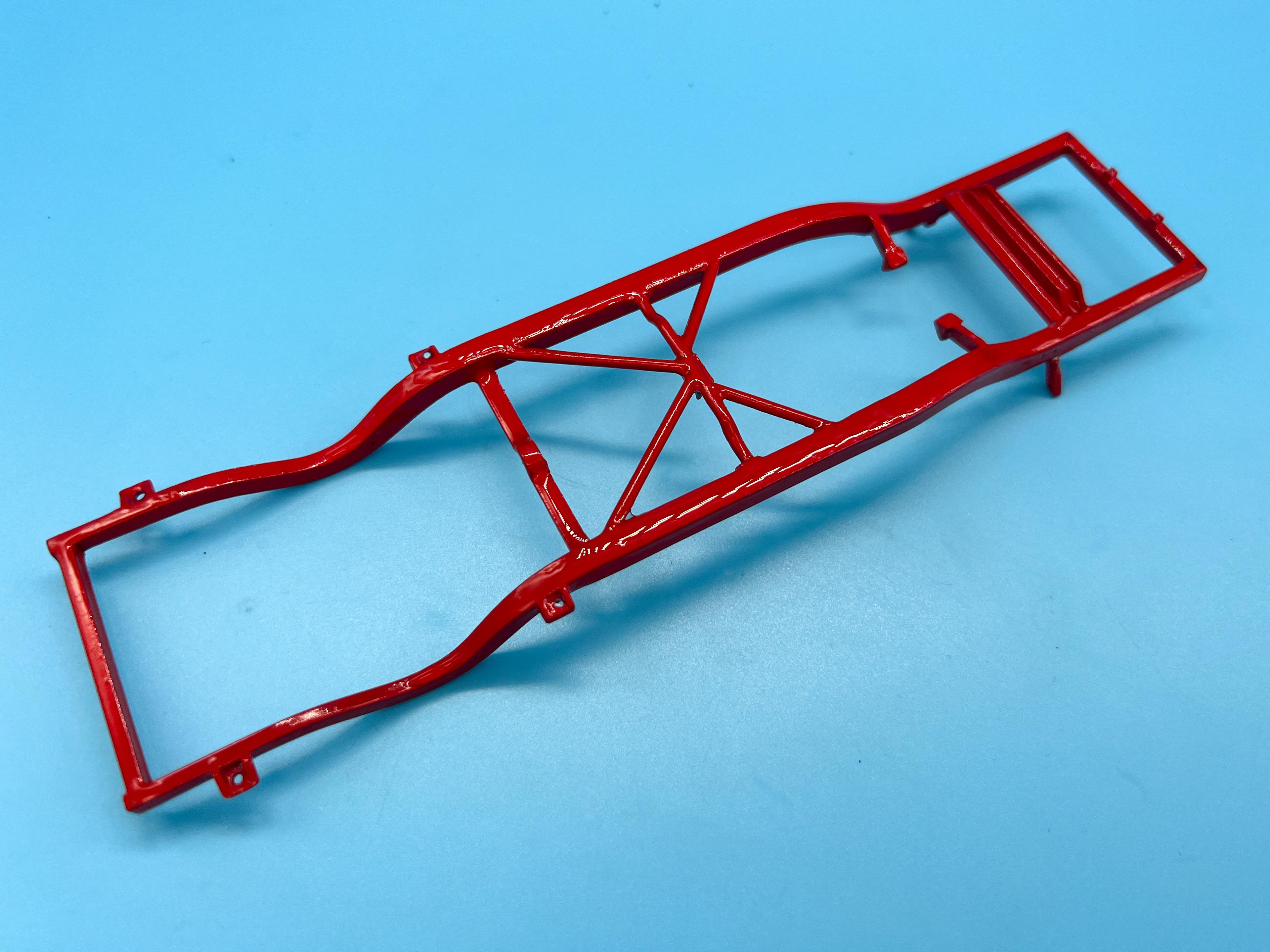

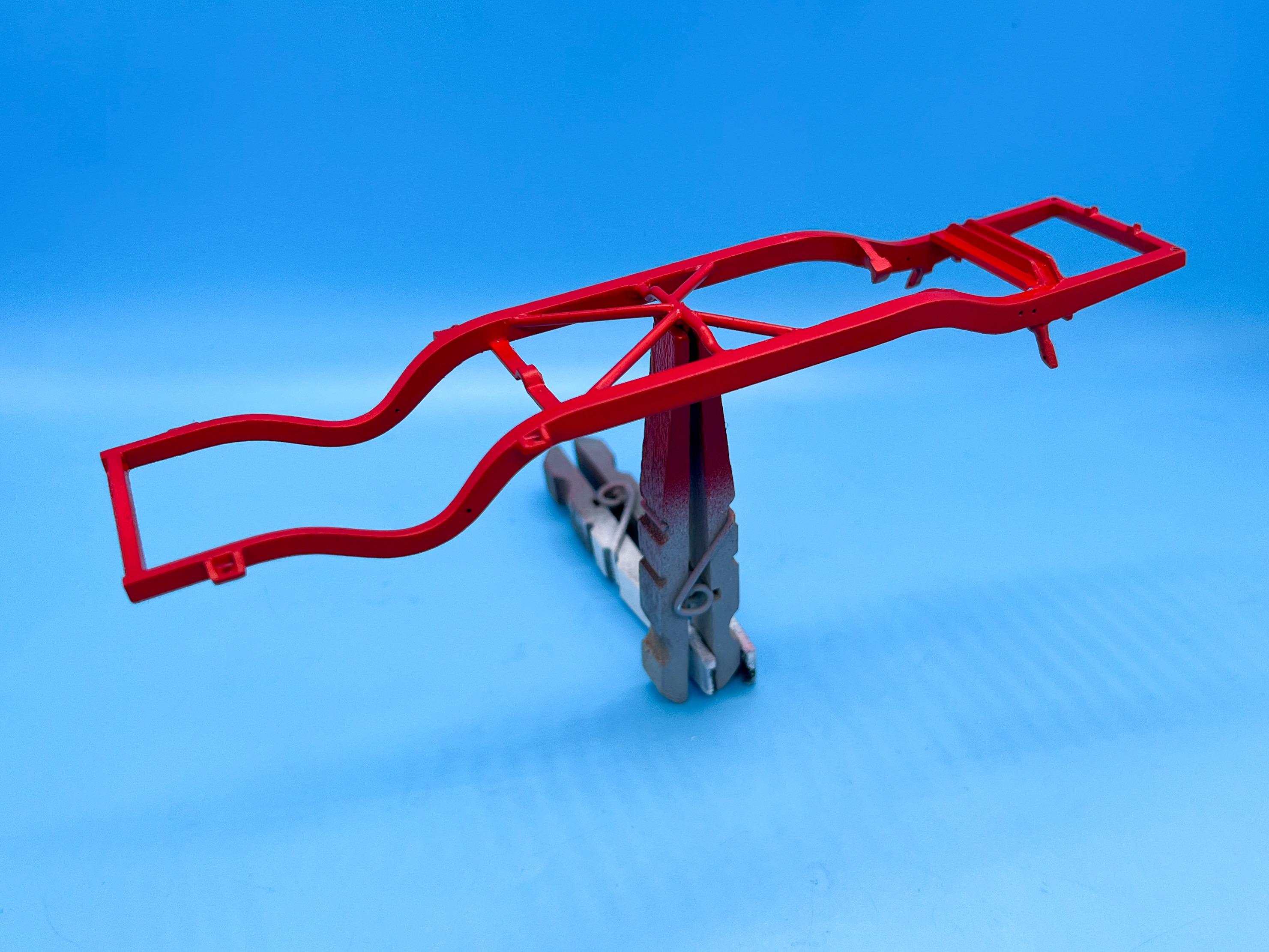

Got the frame in color:
And then hit it with some clear (and got WAY nicer of a finish than I really need…but this too will be getting some light weathering):

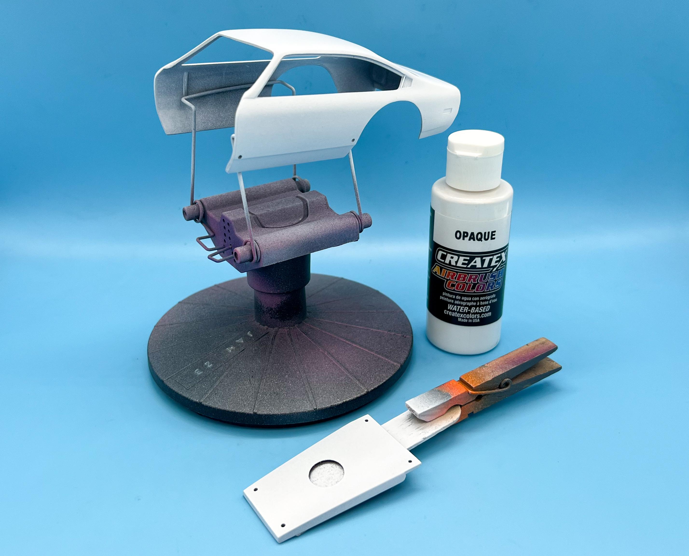

And finally, I did a little filler work on the body to get it smooth and hit it with primer…
…and then, having turned it from white to gray I immediately then turned it back to white again as a base for the rest of the paintjob:
MOST of these cars didn’t have super complex paintjobs, but some were nicer than others anyway - I’ll be going for the ‘nicer than others’ option but still shooting for something period correct…

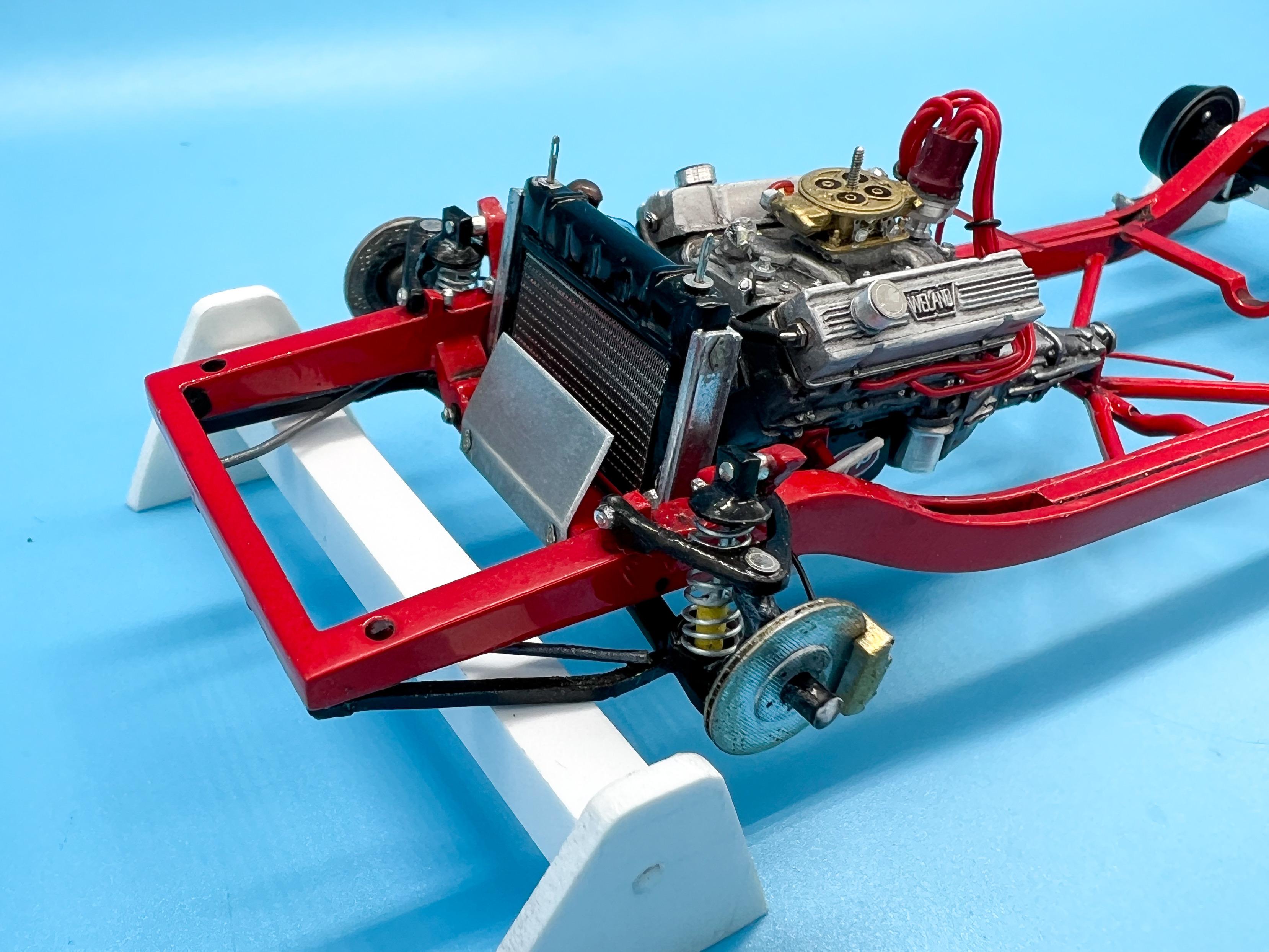

Tonight's mini-update, seeing as I’m replying anyway…started detailing up the radiator with this nice photo etch mesh…I’m securing it with a little Future which seems to work fine and not ruin the look:
And I made the front shocks and got those installed…printed the tops, the shaft is a silver pin, the shock body is brass tube painted and lightly weathered and I wound some springs out of jewelry wire.  The outside spring (not that you can see it here) is wound tighter than the inside one, given these cars always lean the one way…

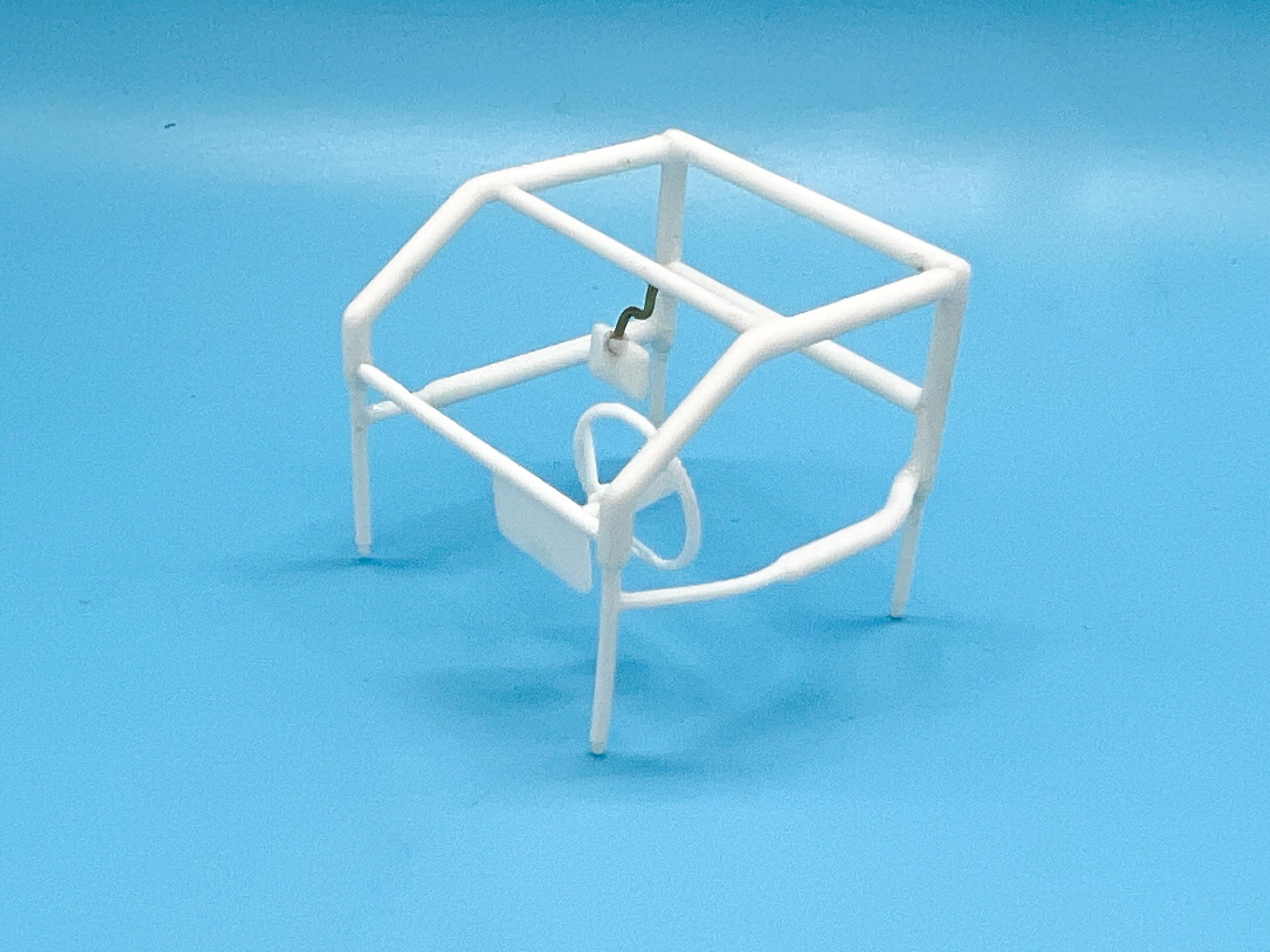

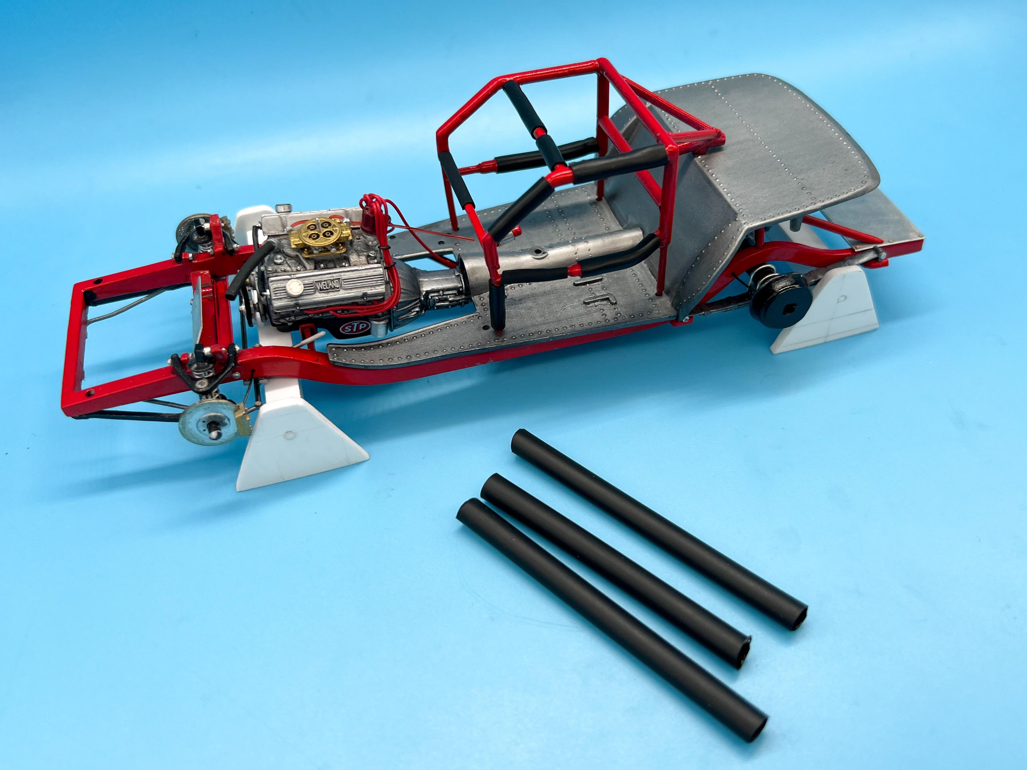

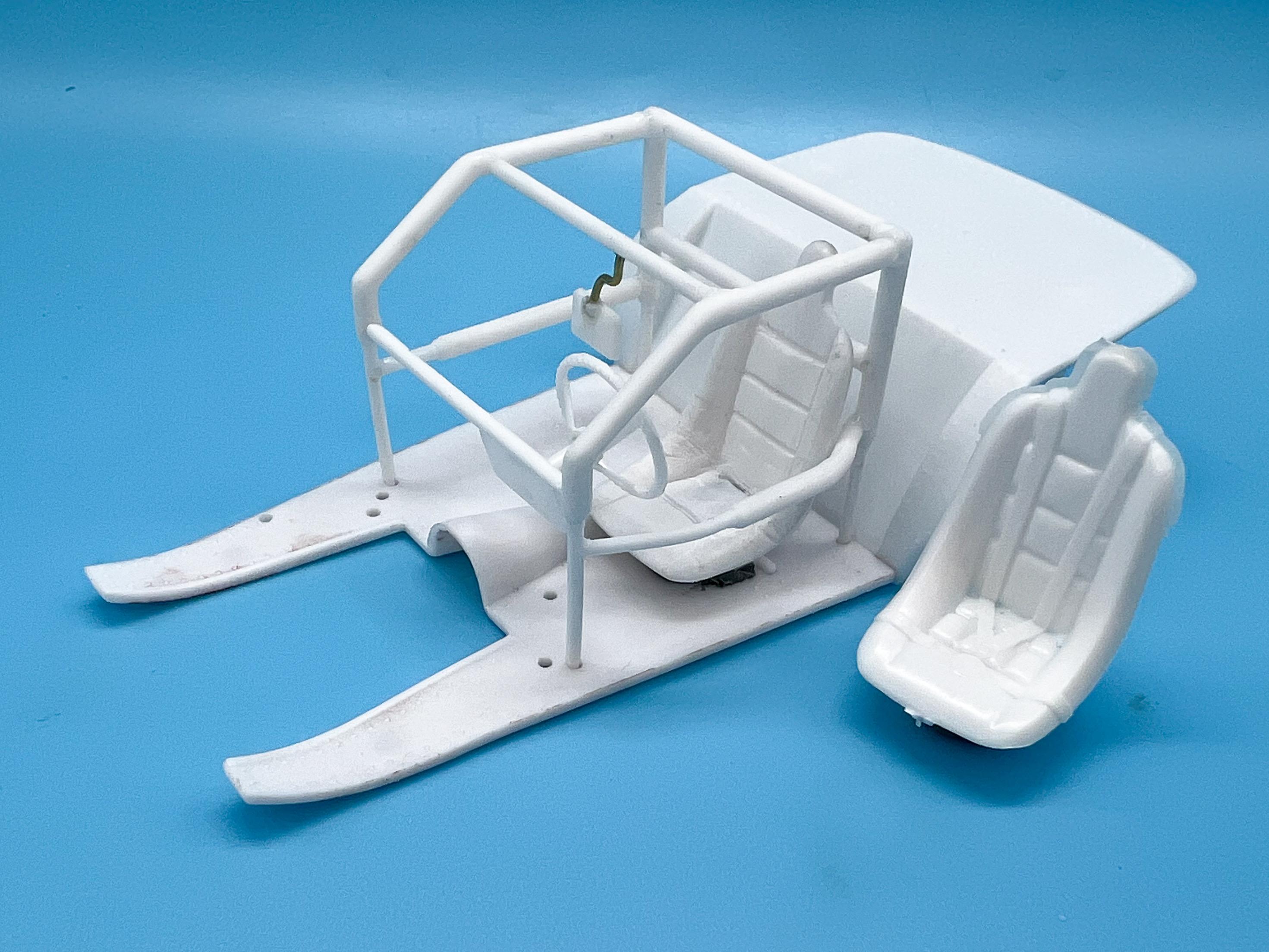

Cleaned up the rollcage ready for assembly.  I was all set to remake it from styrene rod rather than clean up all those awkward lines, then decided it would be character building to do it the harder way…
Using the floorpan as a jig is a good idea when assembling these, and drilling out the mounting holes so it fits together nice.  Still in progress here, but close to being done:

Next job, remove the molded-in seatbelts from the kit seat so I can add my own later.  An original part sitting to the right, for comparison:
Shot some primer on that today and used a little filler and it looks surprisingly good considering all the grinding I did on it 🤪

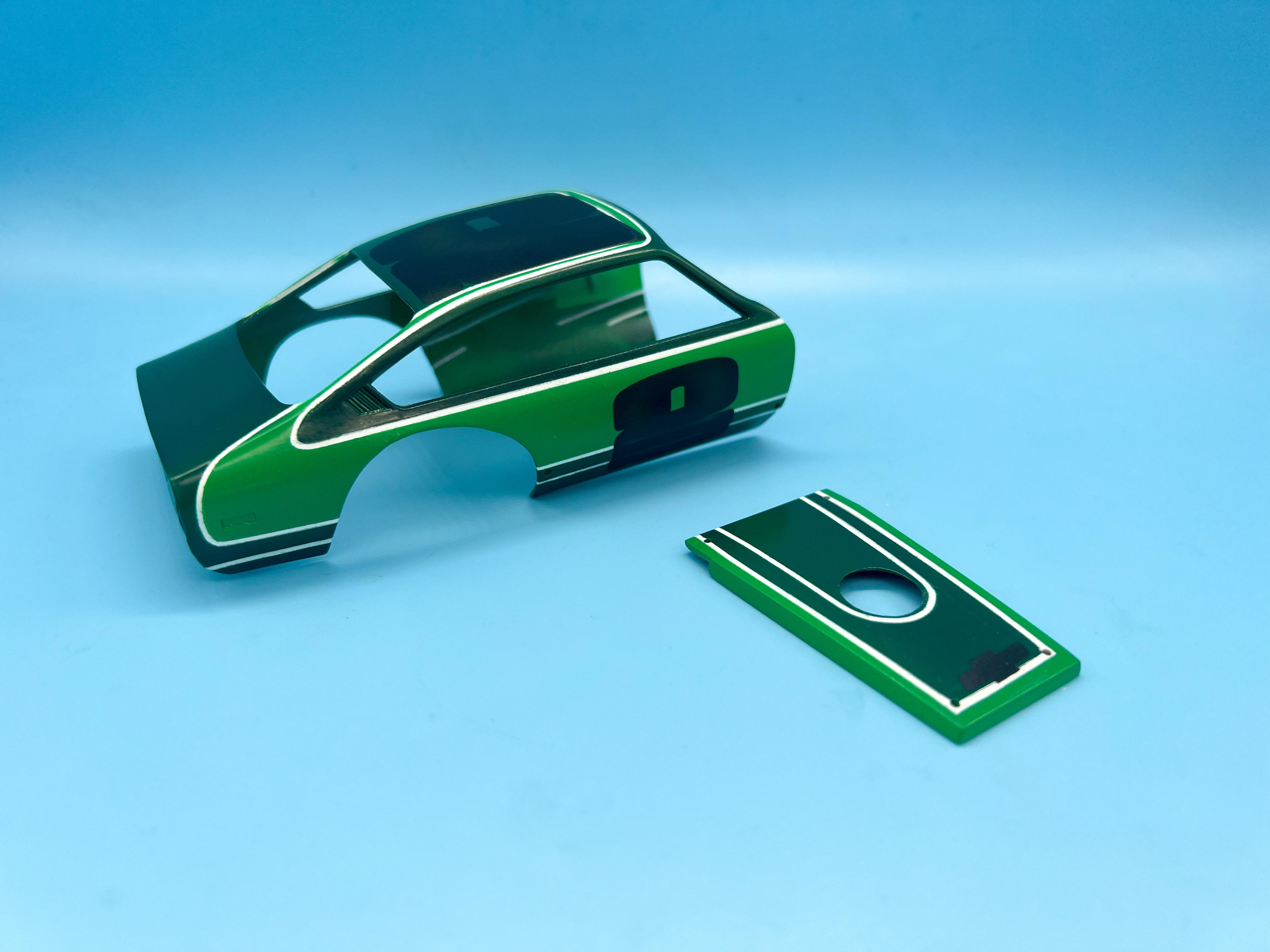

Some more progress today.  Took a shot at polishing out that Createx acrylic clear, and it was OKKKKKK, kinda, but not mindblowing.  Luckily, I have more stages of paint to go anyway, so no harm no foul.  I found some cool pics when I was researching this build of 70s late models with some cool chrome vinyl (I think?) and holographic vinyl numbers so I’m stealing that idea for this one too.

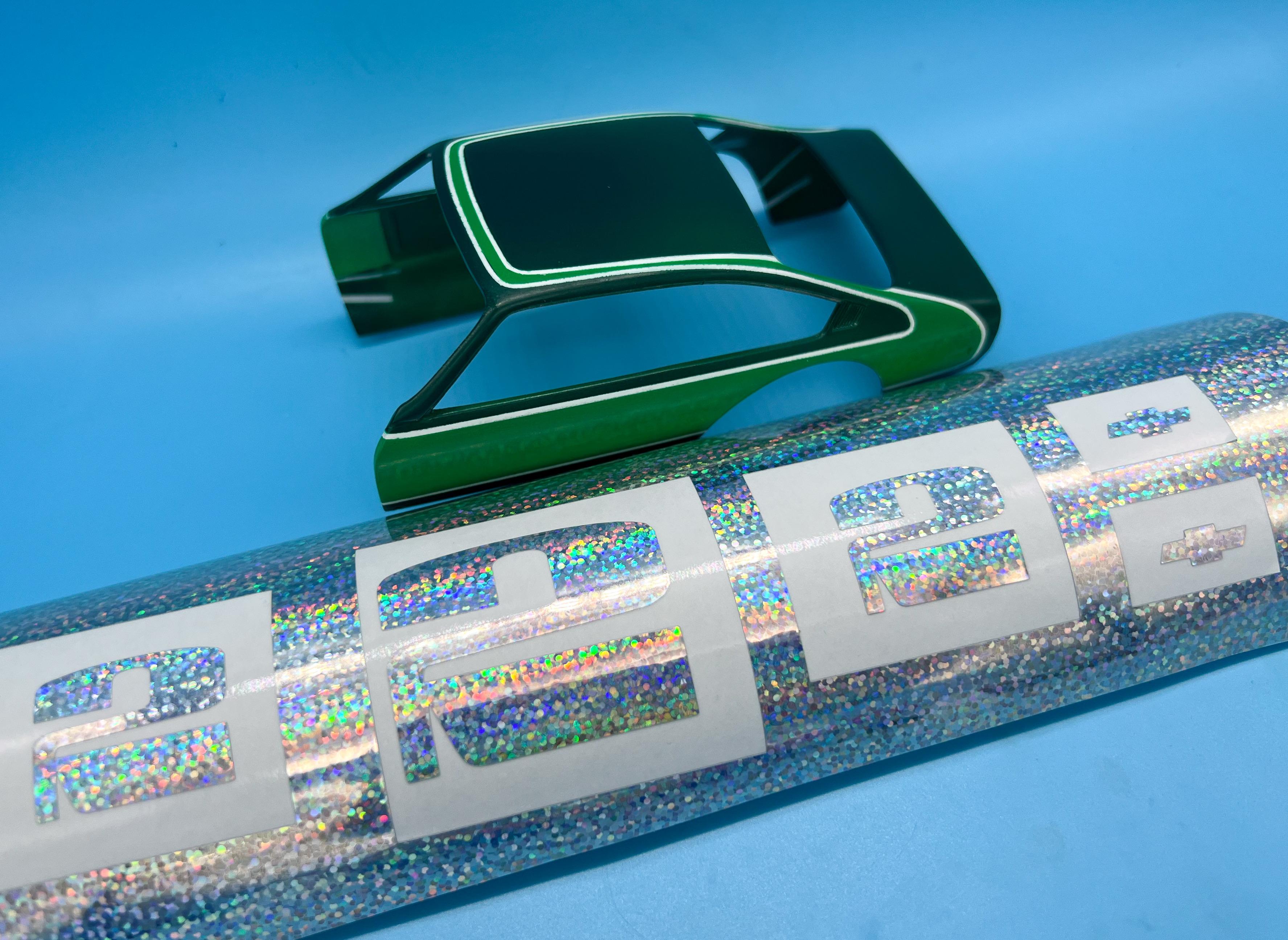

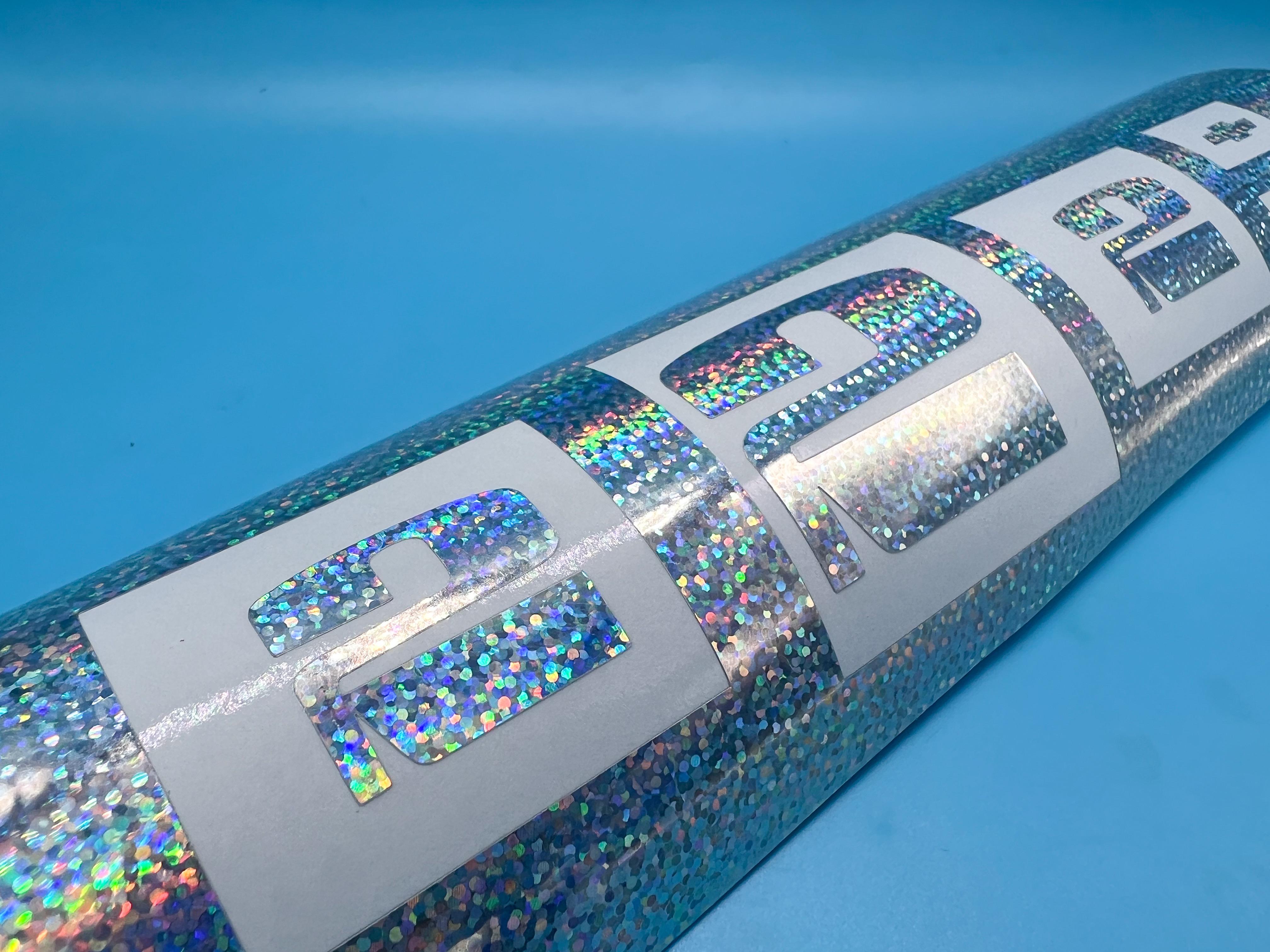

Designed and cut out some numbers:
To make them actually look thought-out and finished though, I’ll be laying down a painted black shadow behind them, so that was the next job…
Now, I won’t get to see the finished effect until right at the end of the paint process because clearing over that vinyl somewhat ruins the effect of it, so I’ll need to be patient…
Meantime, added some decals, and the state identifiers on the side with some old (possibly era correct) Letraset dry transfers:
Letraset has a very thin clear backer that shows up at this stage, but it disappears with just a mist of clear over top so don’t be alarmed if you ever use this stuff…

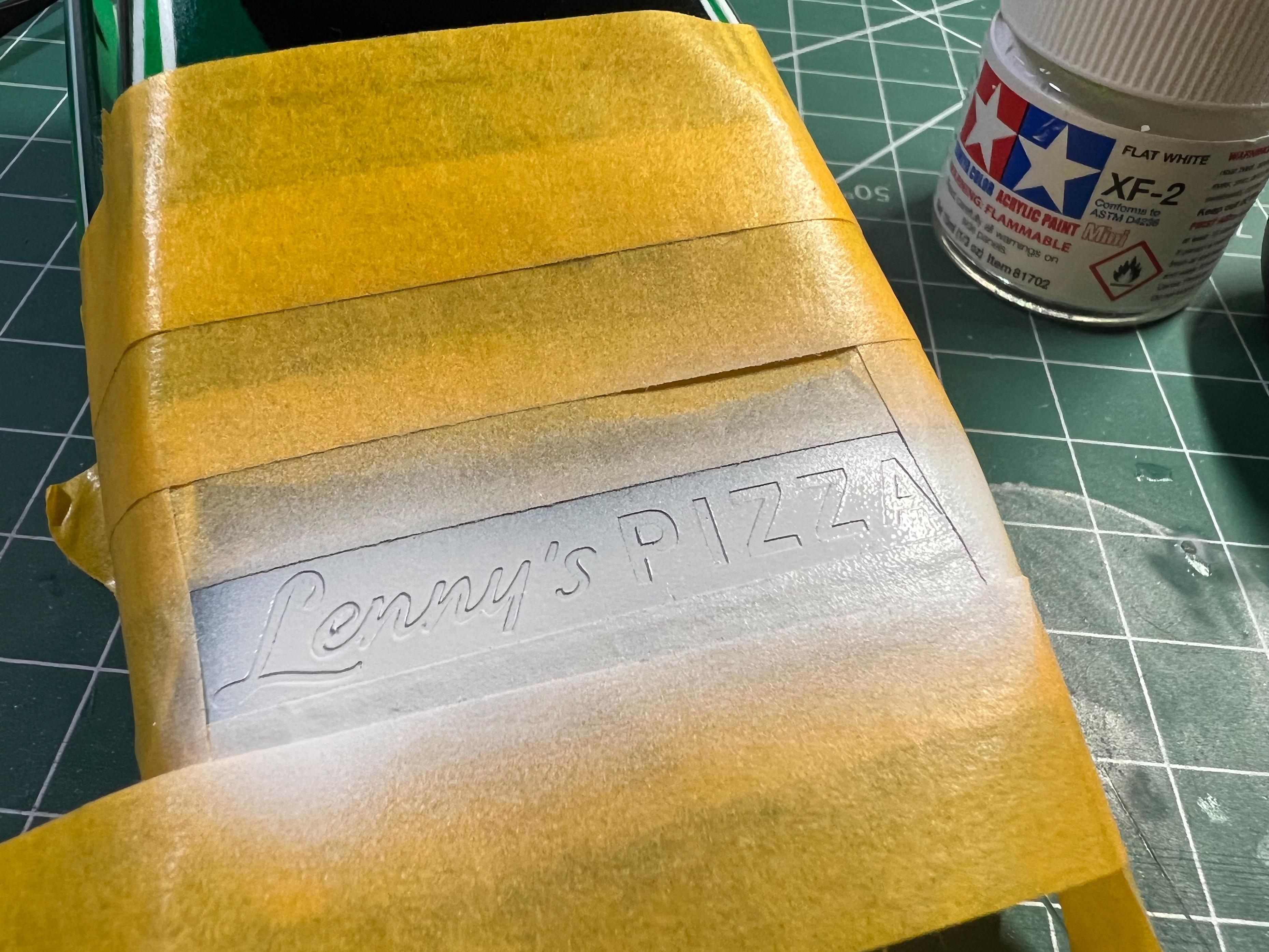

Agreed!  It’s fun figuring out who a good sponsor would be, then working out the logos and seeing it all come to life!

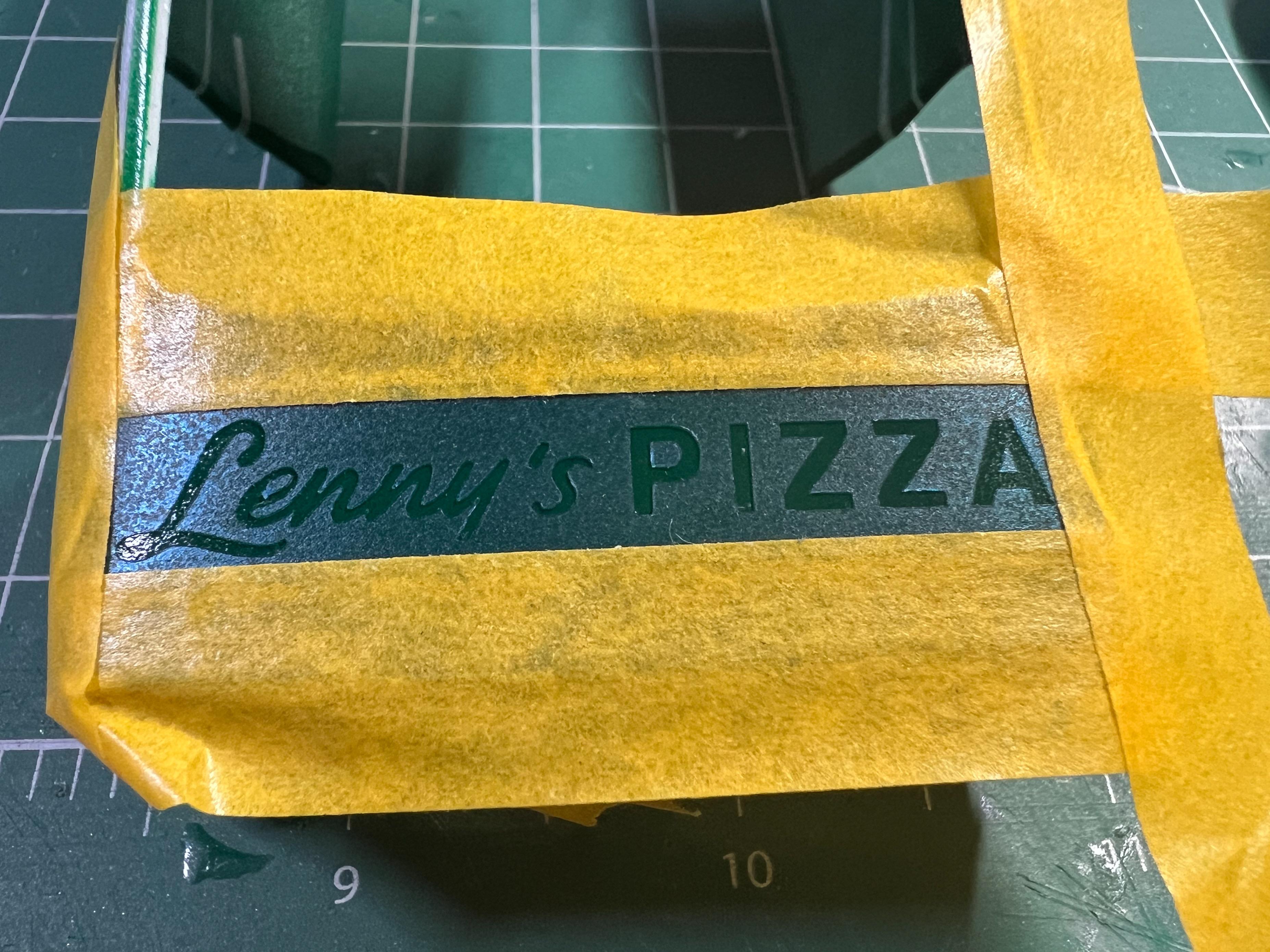

Speaking of logos…the logo I wanted wasn’t available as a digital file, so I made that this week and soon as I got a chance cut some masks…
Shot some Tamiya matte white, my current favorite opaque white paint…
Then some red (yes, I use Post It’s for masking sometimes 🤪)
And that’s the last piece of the paintwork puzzle on this one…

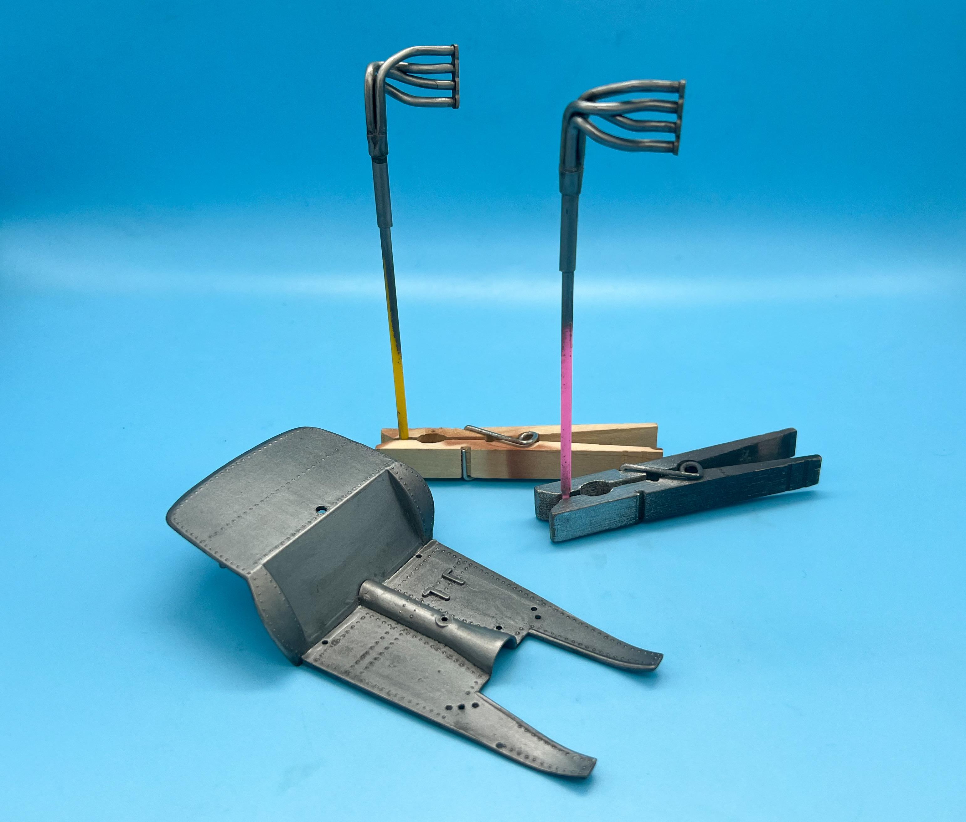

My other project this week has been the headers - the kit pieces aren’t the best and I wanted actual hollow exhausts, so I sliced up the kit parts and added some pins so I could securely mount the tubes and not worry about them snapping off at some point:
Used some thin copper to finish up the collectors:
And shot them with some Vallejo metal finishes and a couple of different color washes:
Also made a start on painting the floor too, whilst I had the metalizers in the airbrush:
Will add some dry-brushing to that floor to add some realism and pick out the rivet detail before I start adding all the other stuff…seat, battery, fire extinguiser, roll cage etc etc etc.

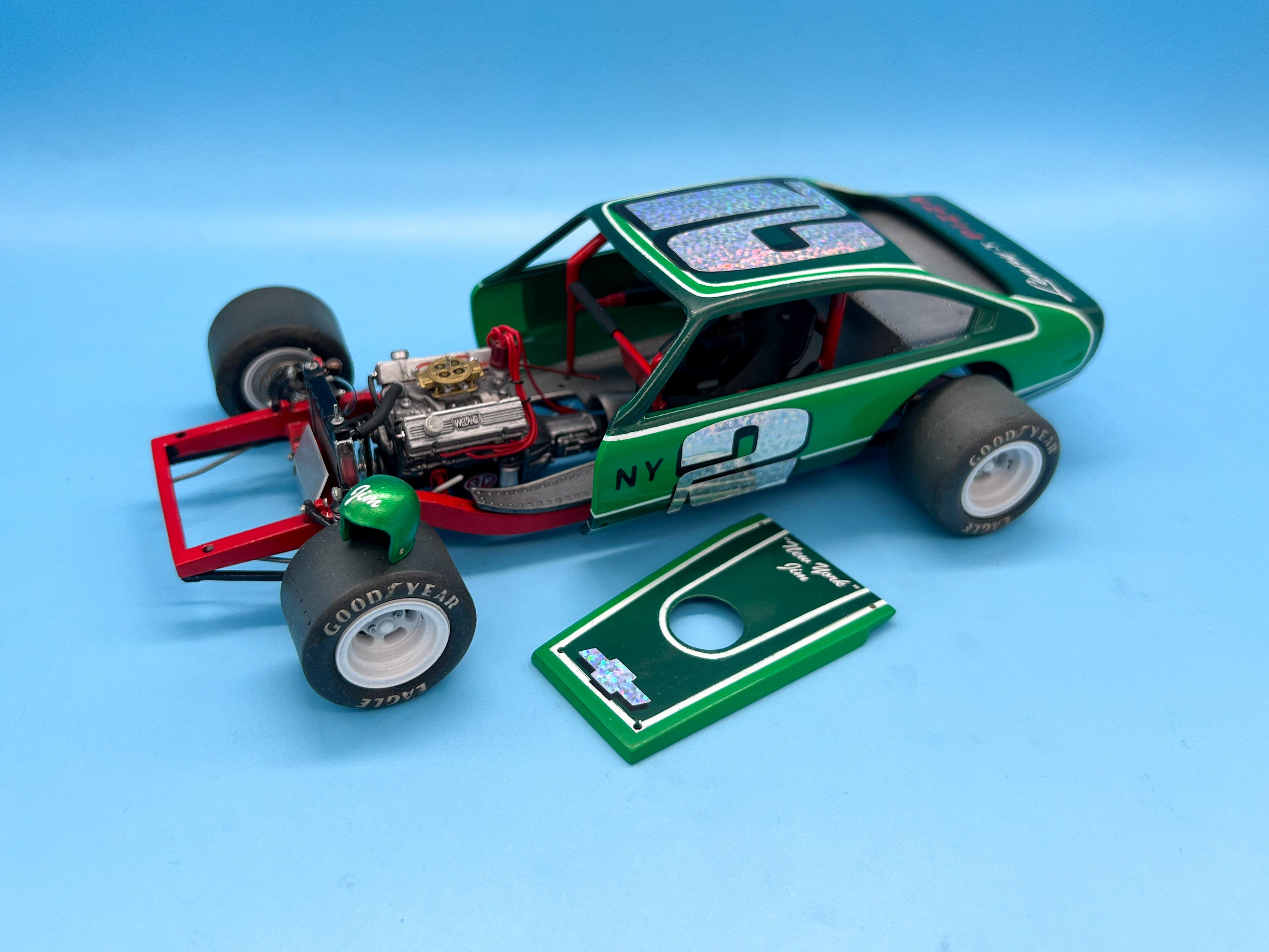

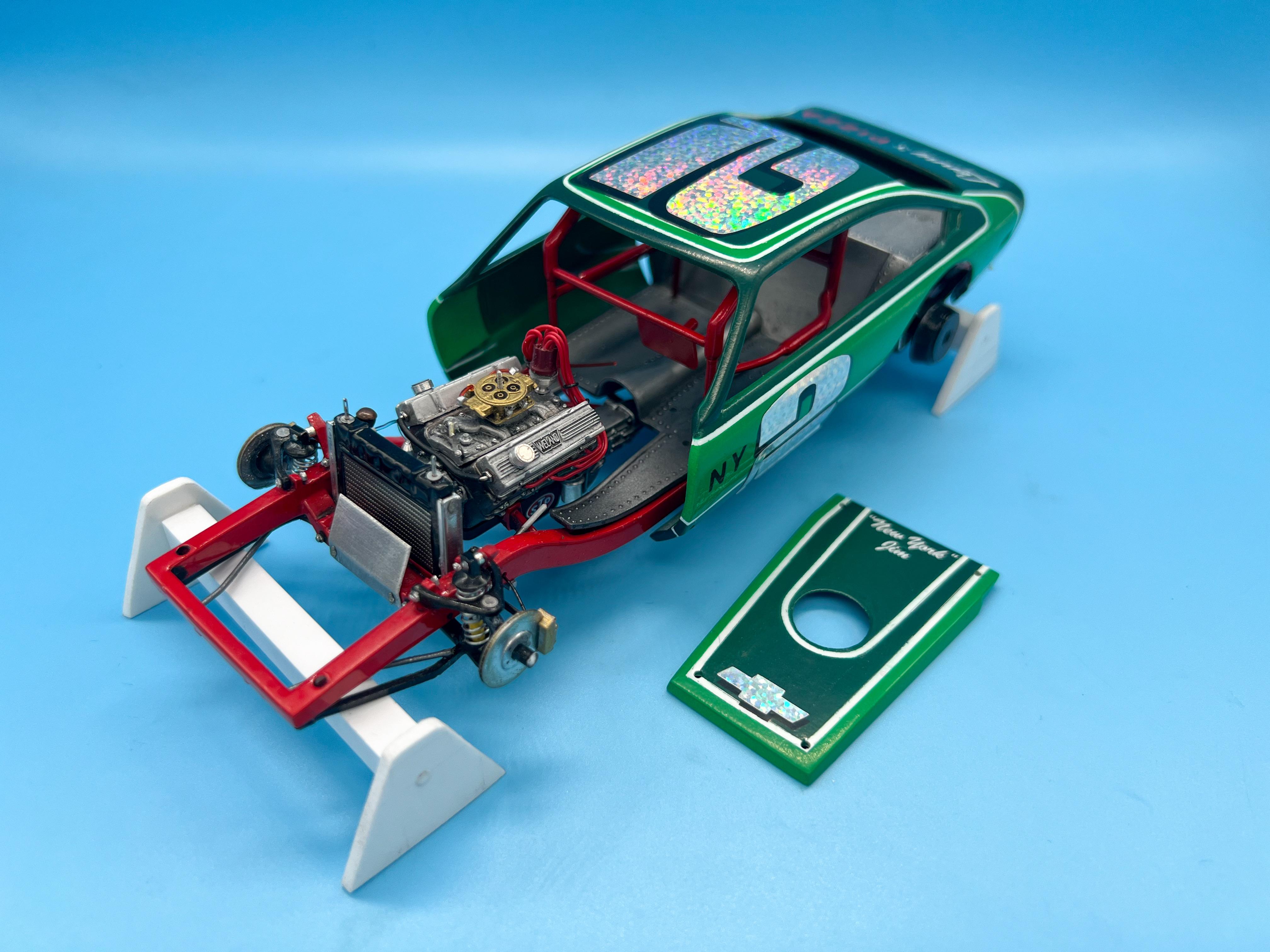

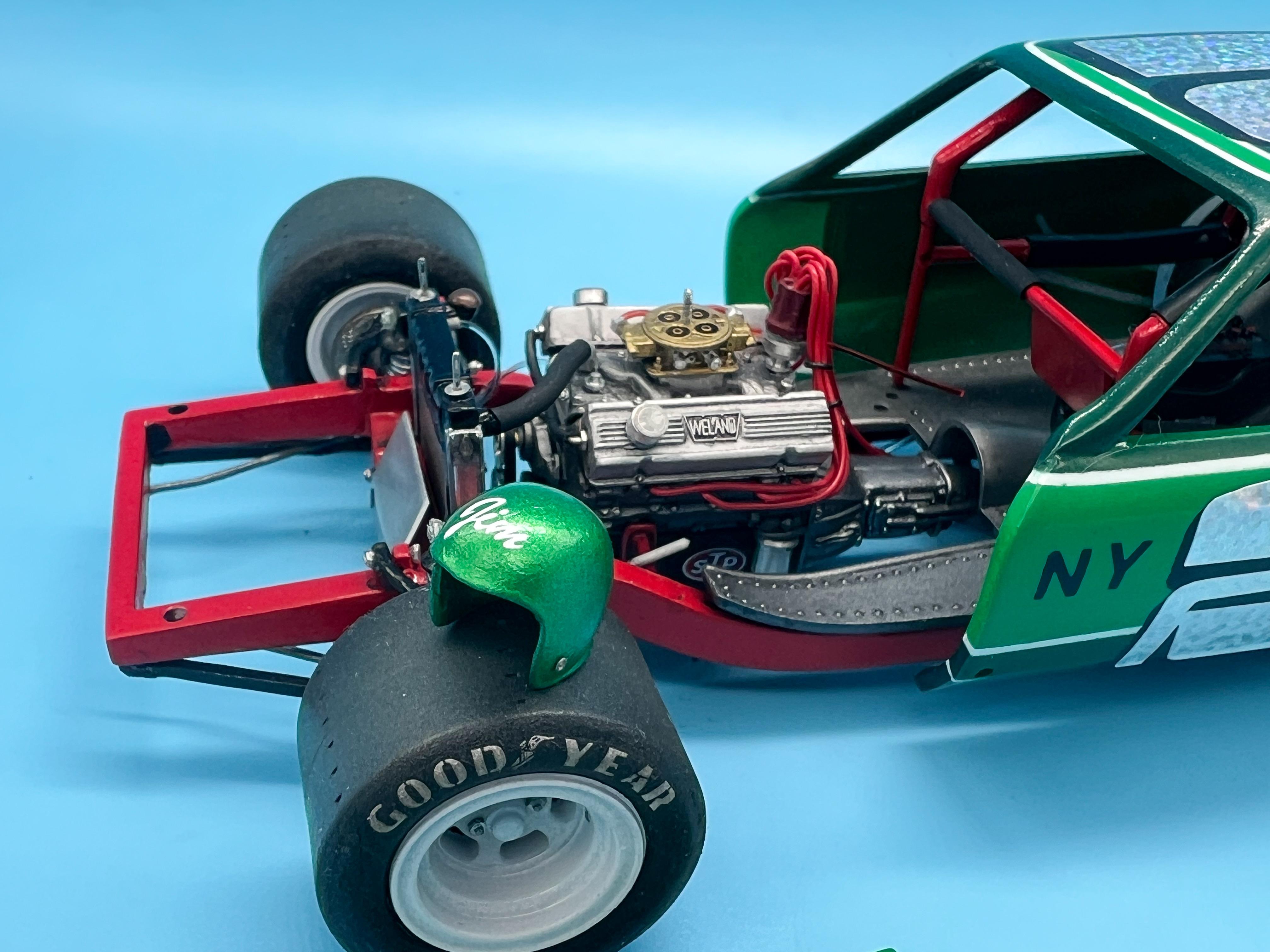

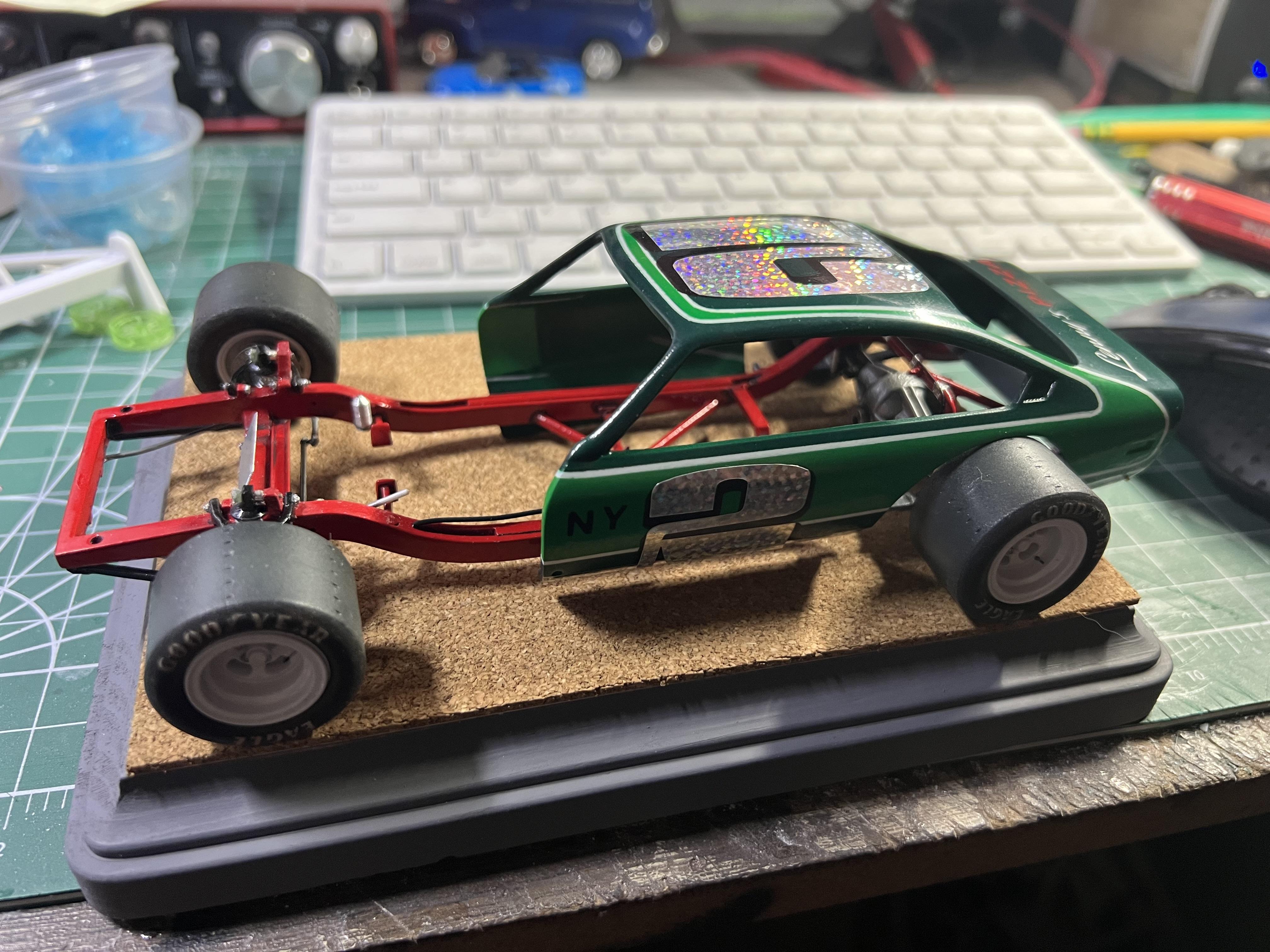

A little more progress today…got the body ‘polished out’…actually I flattened the orange peel and got it relatively smooth and uniformly kinda-glossy by doing a partial polish but not all the way to show-car.  I don’t want it looking syruppy, but I didn’t want lumpy paint either…
Then, with that done, finally time to add the holographic numbers I’d been excited about:
Next up, finished up the brakes finally and got them properly mounted to my satisfaction.  The disks were shot with SMS chrome, got a black wash and then some thinned Vallejo rust around the edges:
Made a little rock-shield (I guess?) to mirror one I saw on some 1:1s in reference pics.  Not sure how much it would protect the radiator, but maybe it’s a simple air flow thing or something?

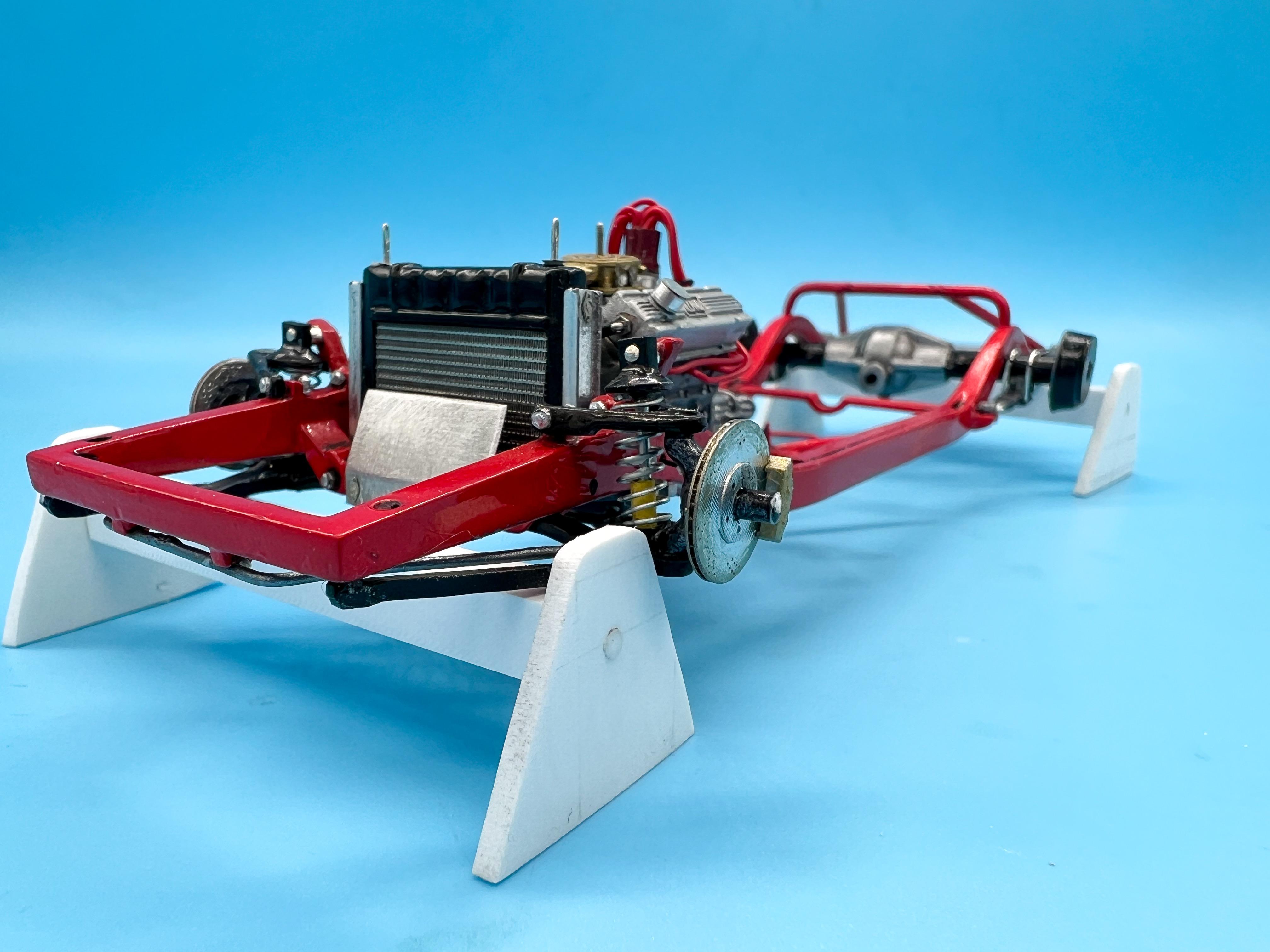

And as you can see in the pics above I’ve been detailing the radiator some today.  Made a radiator cap, mounting brackets and installed the hood pin posts:
There’s an aluminum catch-can on the other side that I forgot to photograph and I made a start on the hoses…need to finish the driveshaft so I can get the engine in place before I can get the hoses installed before I can glue the radiator in 🤪

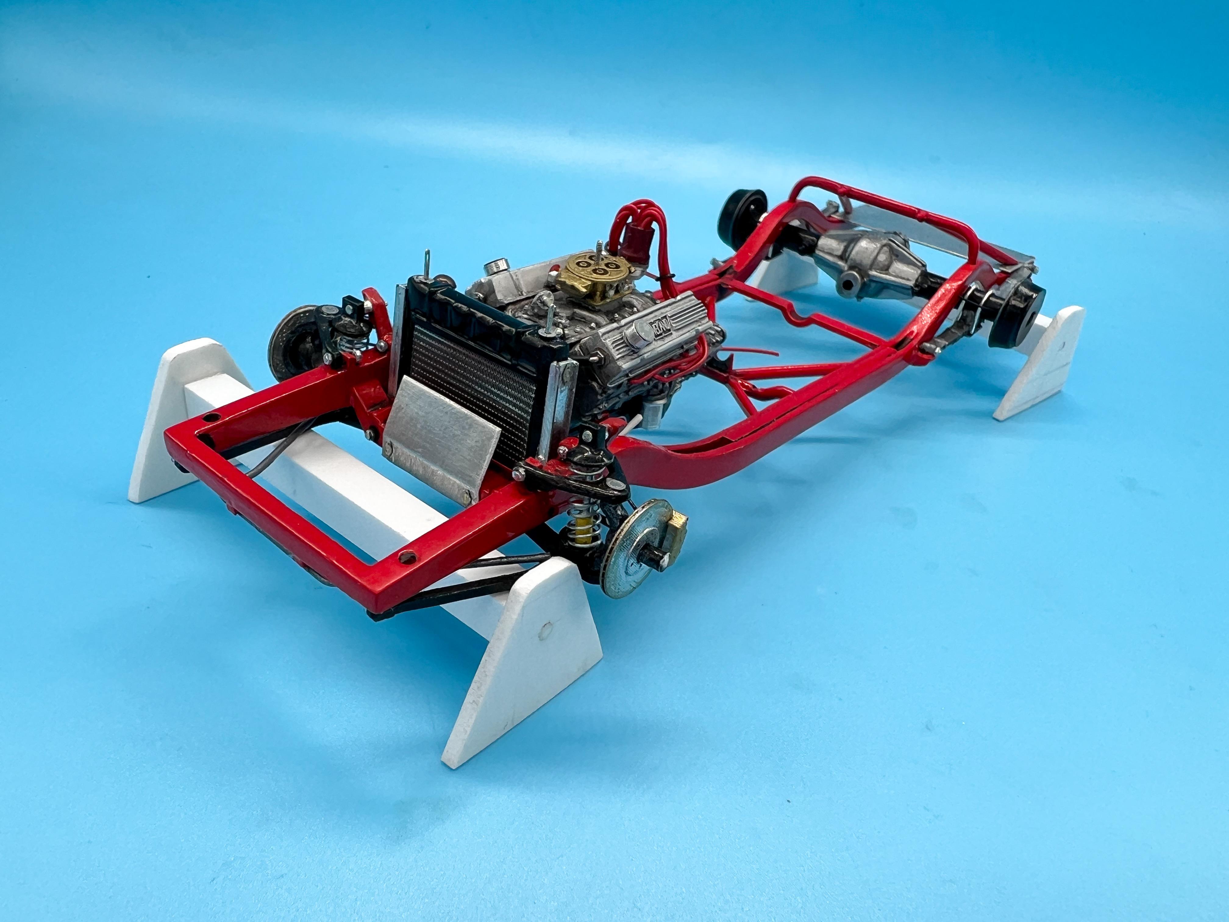

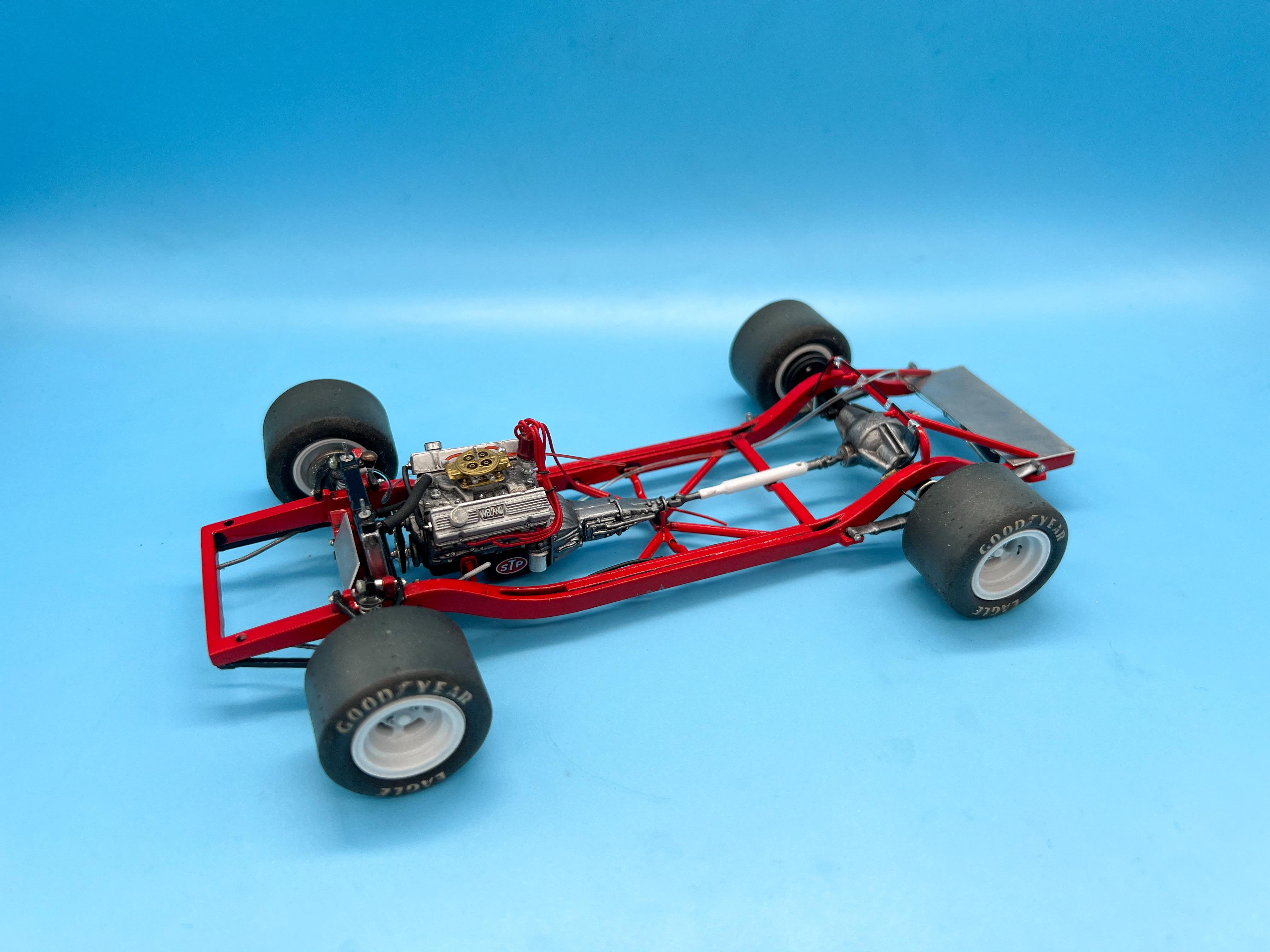

Quick motivational mock-up…it’s starting to look like a thing!
Still a bunch of work to do, but I like how it looks so far!  More soon, soon as I’ve done more!

On 5/6/2023 at 10:54 PM, Rattlecan Dan said:
Coming along Marvelously. I like your supports idea. I've been propping up with styrofoam,(not so good sometimes).Thanks for the tip and post.
Thank you!  And yeah, I’d been meaning to design and print some little stands like this, then decided I ought to be a ‘real’ modeller and just build some 🤪

Looking good. Like the reflective numbers. Most places wont let you run those now. At least where I live. Blinds the drivers and the people in the stands and lots of times it's hard for the score keepers to read the numbers with the lights reflecting off of them. I still they look good though, even on the real thing.
Interesting - but it figures.  I would think a lot of places would have a transponder system but I’m sure plenty don’t.  Figures they’d want the numbers as clear as possible
Some more progress this weekend…
Got the gas tank mounted - made some safety straps and added some fuel line and a couple of little details:
Still needs to be subtly weathered with a little dust and dirt…
I still wasn’t totally happy with the seat I’d been messing with, so I printed a Recaro for it, along with a battery…plus an era-correct helmet:
Shot the helmet (and steering wheel) with a little flake green, for my own amusement…
Got the roll-cage padding in place - used some 1/8” heatshrink and as low of a heat as I could blast it with so I didn’t warp anything:
Got the driveshaft painted - a lot of tracks stipulate it has to be white so it got a white center section, and with that done I could finally get the engine in place for good (and, in turn, with that done I could finally get the radiator in place and the hoses run):
Whilst the glue was drying on the wheels, I decalled that little helmet from before:
And it’s starting to look like a thing!
Next project, aside from a bunch of little bits on the interior and some chassis stuff I didn’t get to get, is that I wanted to make a base for it.  I’ve got a bunch of little wooden bases that it’ll JUST fit on nicely:
So I got out in the yard today and finally used some of that Rustoleum that some people rave about for something modelling related:
I’m not trying to make a full diorama scene, but it’ll have a little piece of asphalt underneath and some concrete barriers to add a little interest.
Thanks for looking - more soon, soon as I’ve done more!
