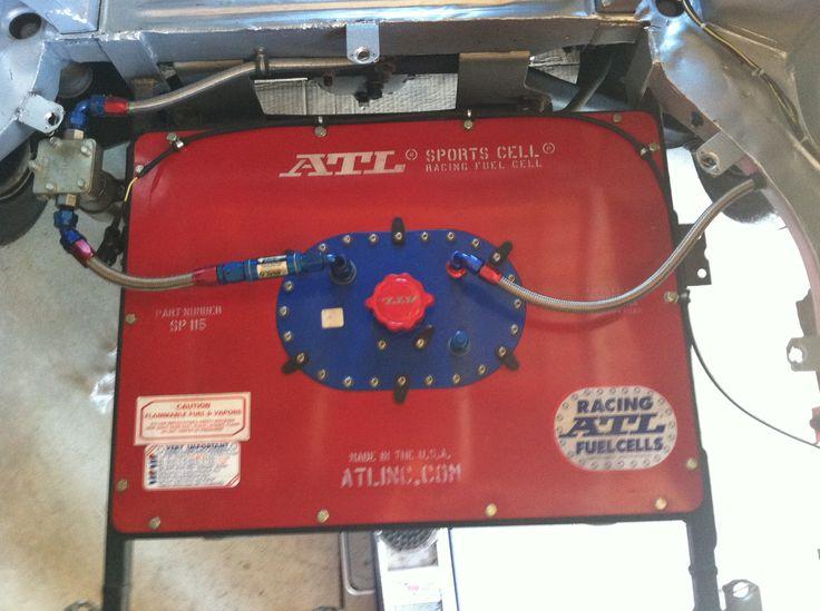

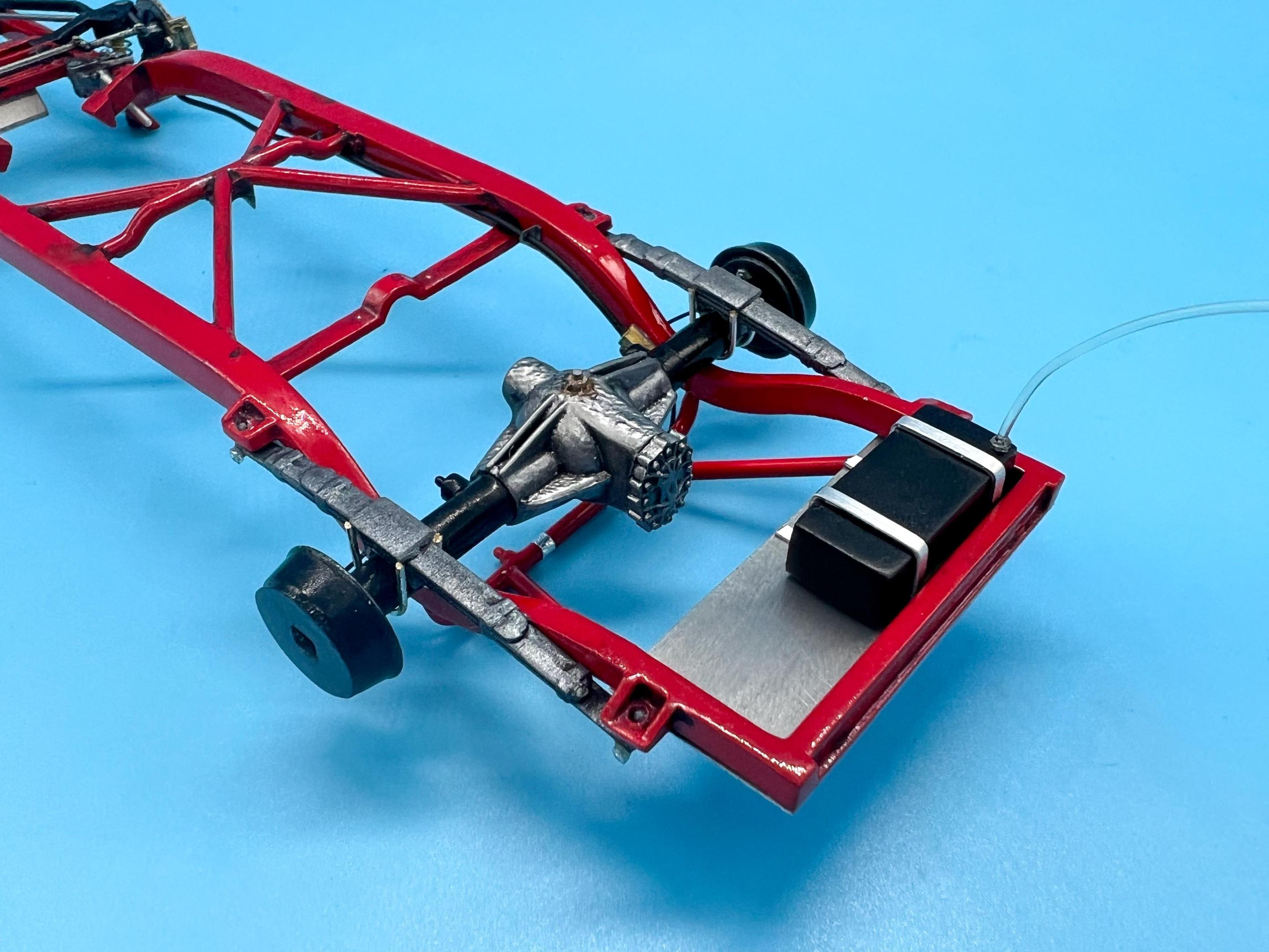

dwc43 Posted May 15, 2023 Share Posted May 15, 2023 9 hours ago, CabDriver said: Just so you know, for future builds, fuel lines and vents and roll over valves are mounted on top of the fuel cell. Some pickups have floaters which look like wings on the fuel pick up and it floats on the fuel to keep the pickup covered. Some cells have dams on the right side that holds fuel so it won't uncover the pickup and most pickups are in the RR of the cell too. On that pic I sent you, the left side has a washable steel screen filter in it on that leads to an electric fuel pump which is illegal on circle track cars. It won't shut off when the engine dies, so it can start a fire. On the right side you see a rollover valve with a vent hose. Most of those should go straight up and have an S or a line looped to prevent fuel and dirt from getting to each other. The filler is the red cap in the middle. Most of those can be changed out to allow for a filler tube, think nascar type cells. Hope that helps. Great build too. Quote Link to comment Share on other sites More sharing options...

horsepower Posted June 10, 2023 Share Posted June 10, 2023 On 5/15/2023 at 5:58 AM, dwc43 said: Just so you know, for future builds, fuel lines and vents and roll over valves are mounted on top of the fuel cell. Some pickups have floaters which look like wings on the fuel pick up and it floats on the fuel to keep the pickup covered. Some cells have dams on the right side that holds fuel so it won't uncover the pickup and most pickups are in the RR of the cell too. On that pic I sent you, the left side has a washable steel screen filter in it on that leads to an electric fuel pump which is illegal on circle track cars. It won't shut off when the engine dies, so it can start a fire. On the right side you see a rollover valve with a vent hose. Most of those should go straight up and have an S or a line looped to prevent fuel and dirt from getting to each other. The filler is the red cap in the middle. Most of those can be changed out to allow for a filler tube, think nascar type cells. Hope that helps. Great build too. Those little "wings" on the pick ups are actually pieces of plate that sit flat on the bottom of the fuel cell and the wings are shaped to perfectly fit in the corner of the cell and it spaces the pick up just off the bottom of the cell and right in (usually the right rear) corner of the cell and its weight along with the weight of the foam in the cell keeps it in the right position so it should be really hard to get it uncovered, plus some build a small can like shape with a trap door that will allow fuel to flow in but will close keeping it there for a little reserve. 1 Quote Link to comment Share on other sites More sharing options...

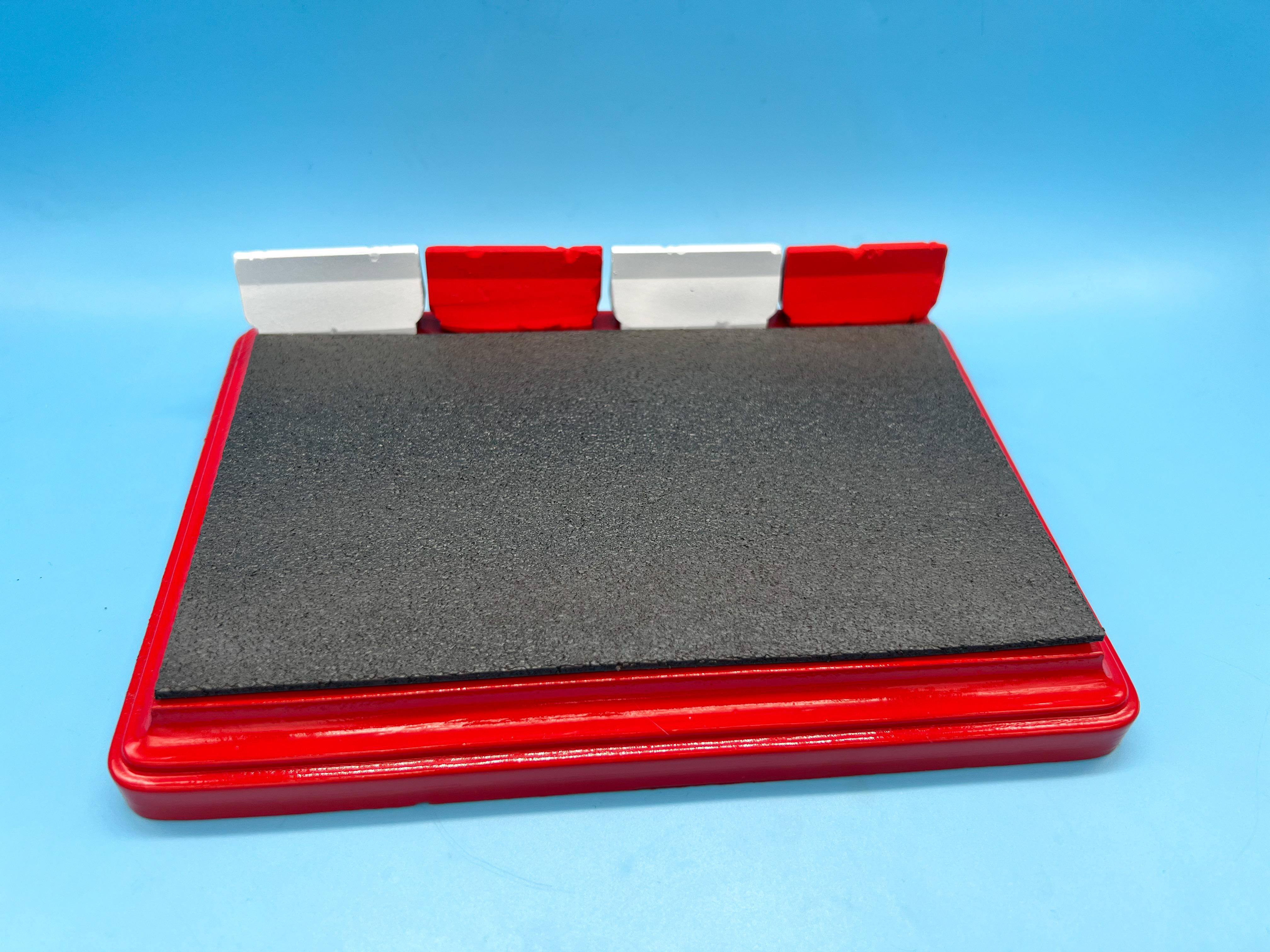

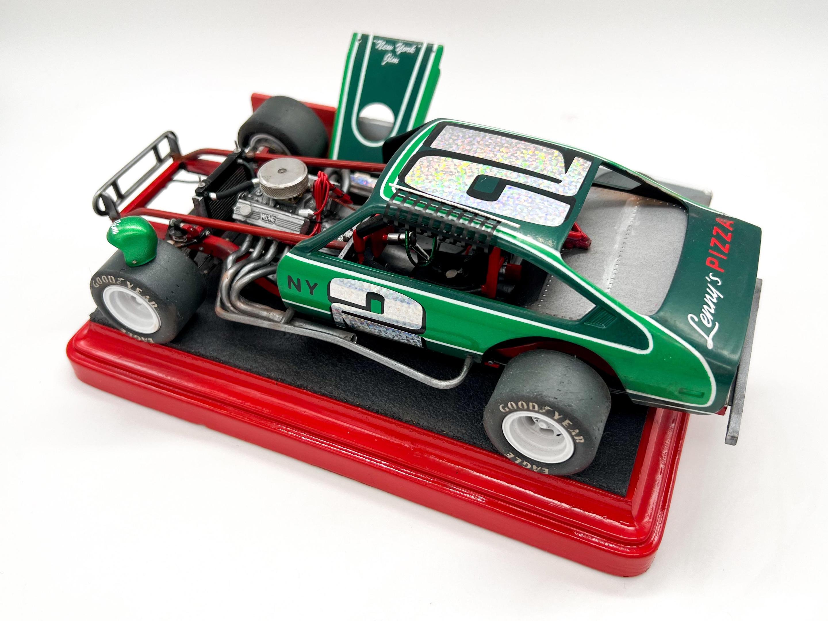

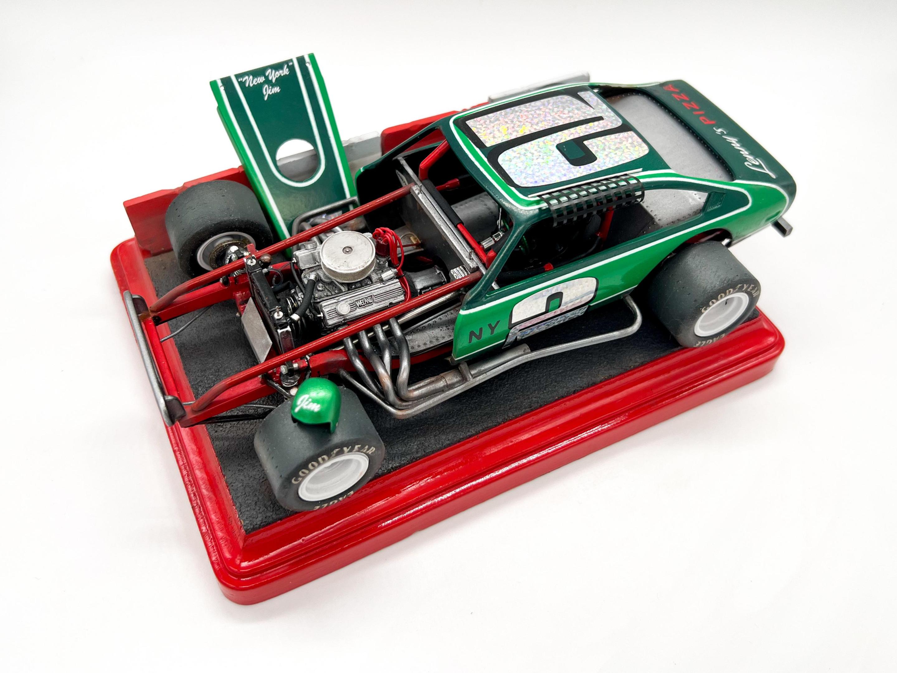

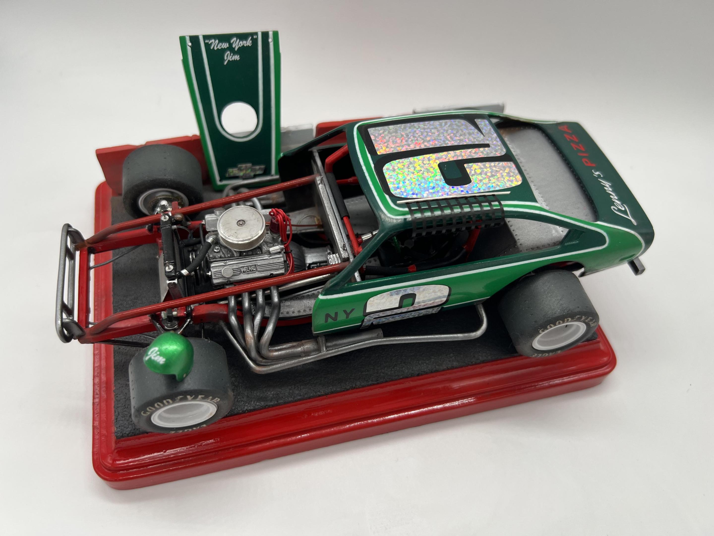

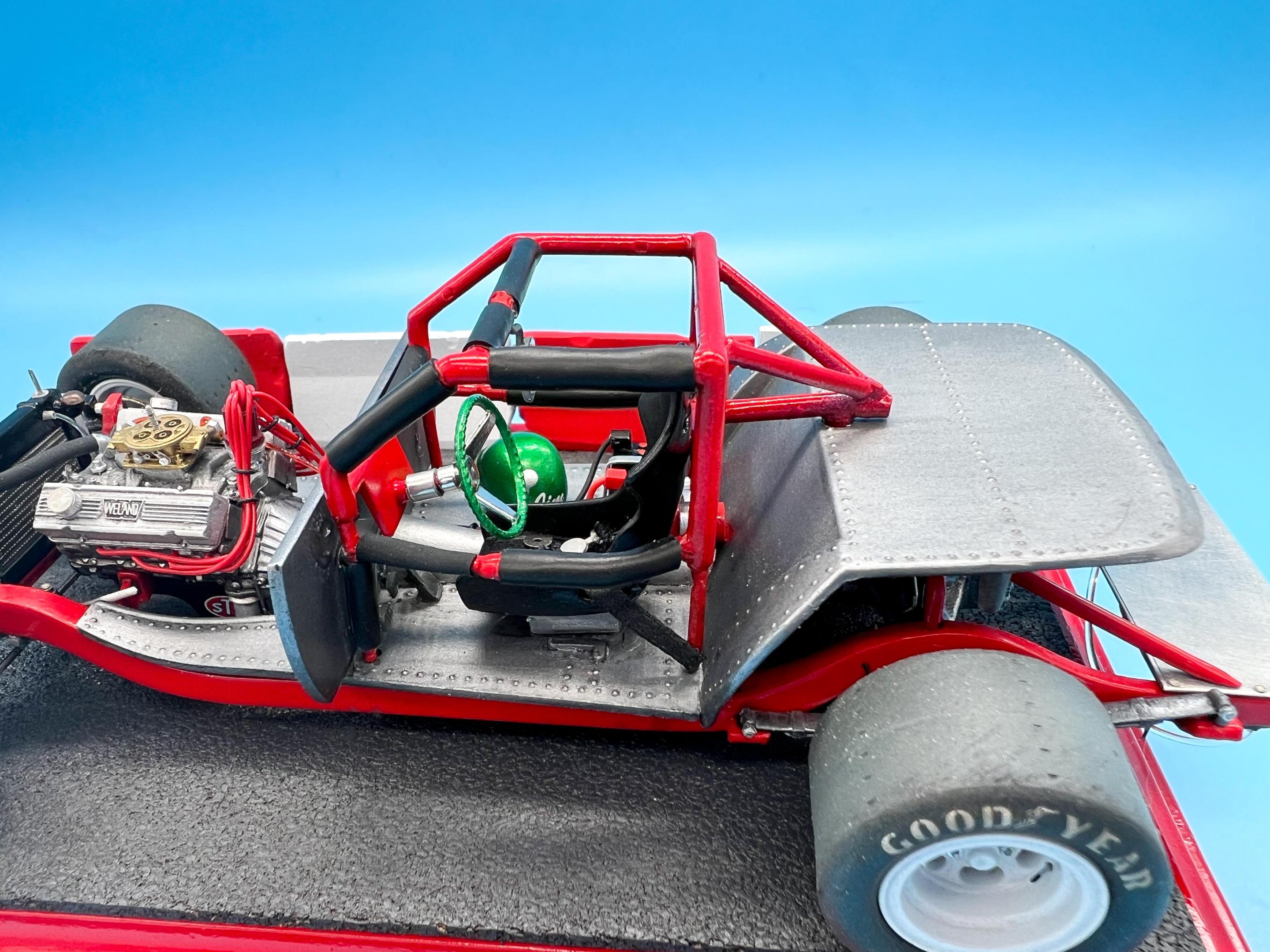

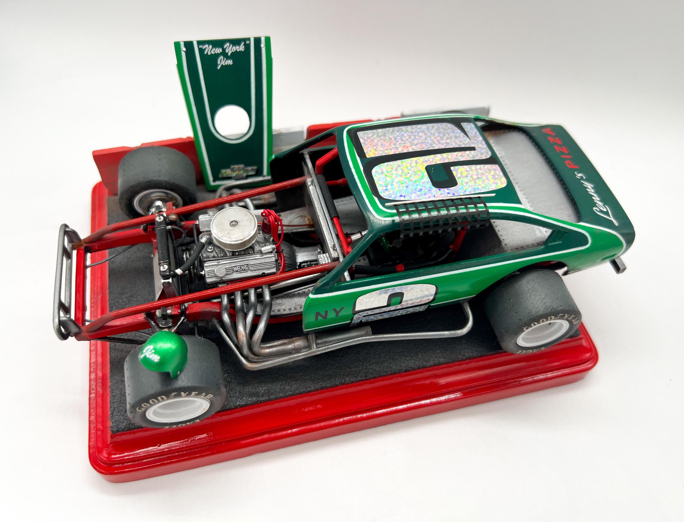

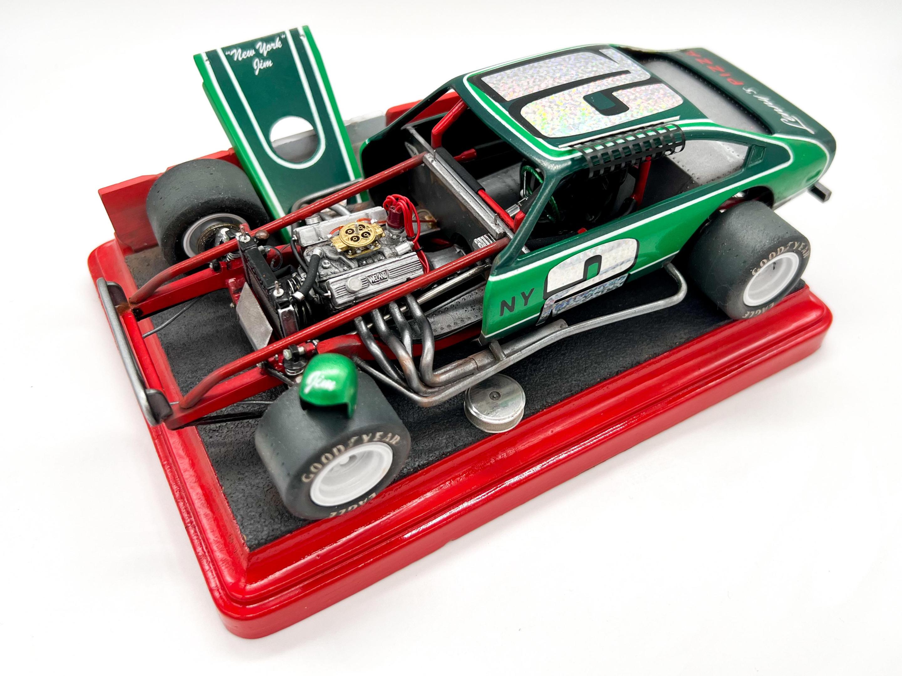

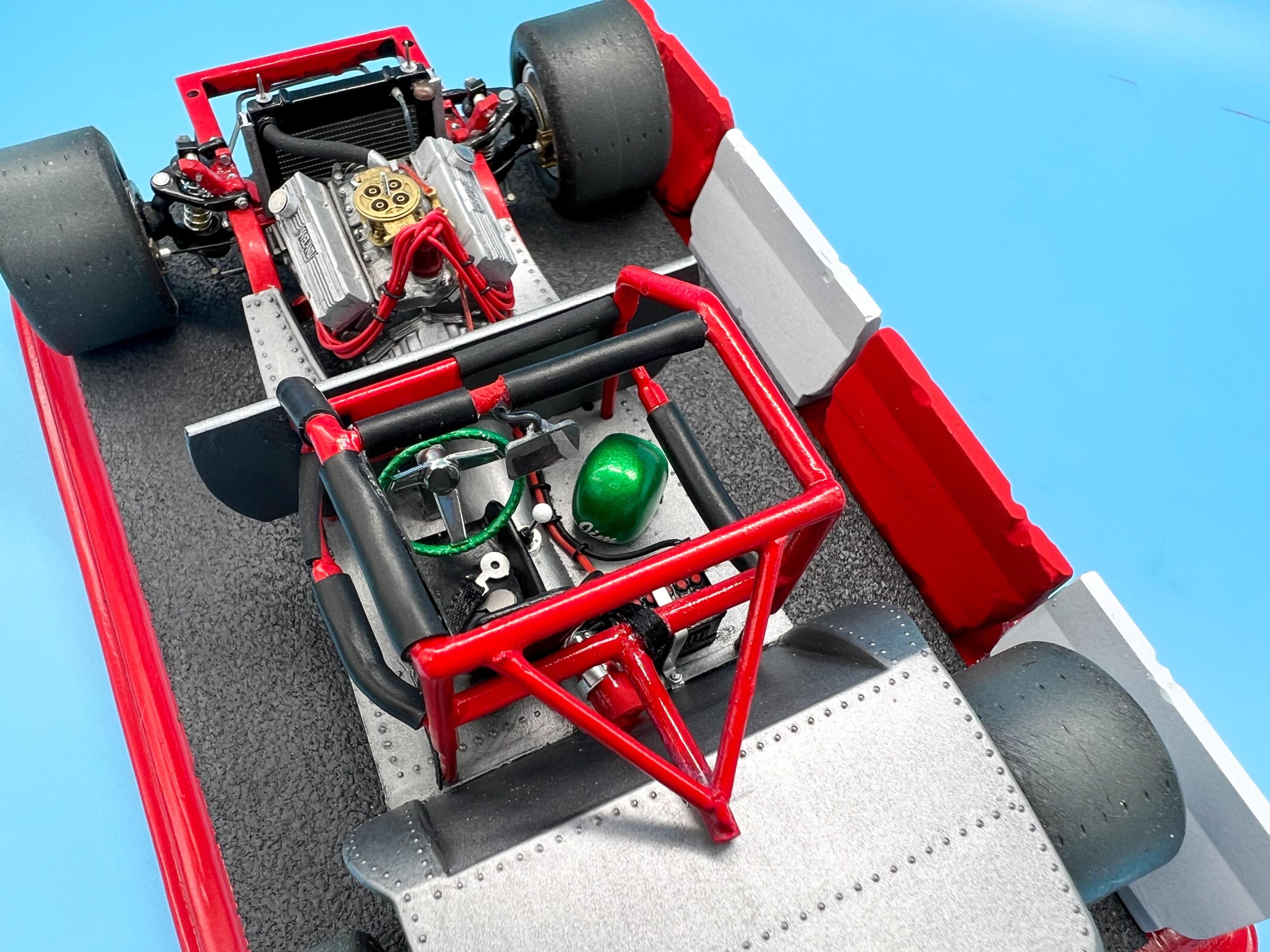

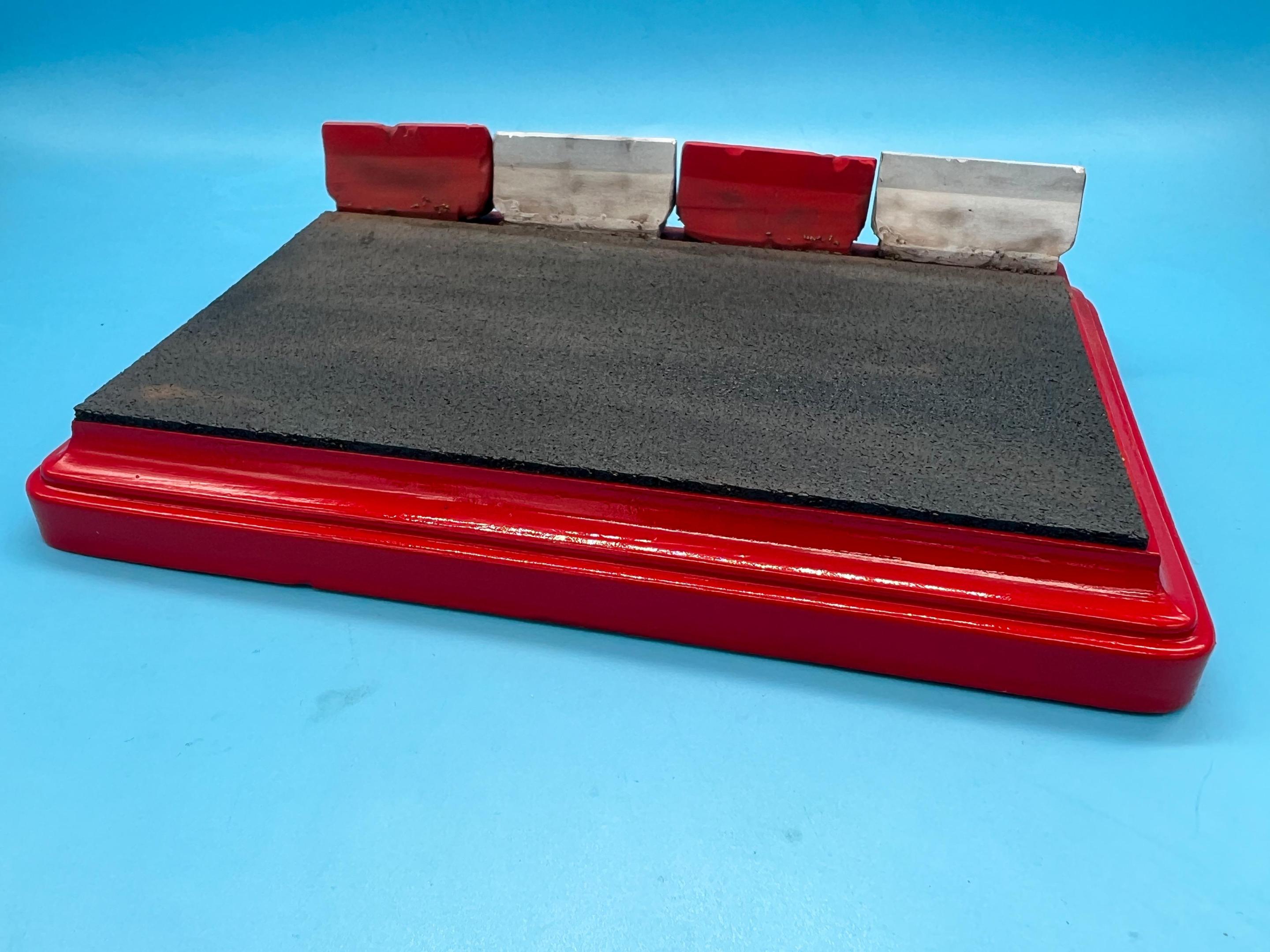

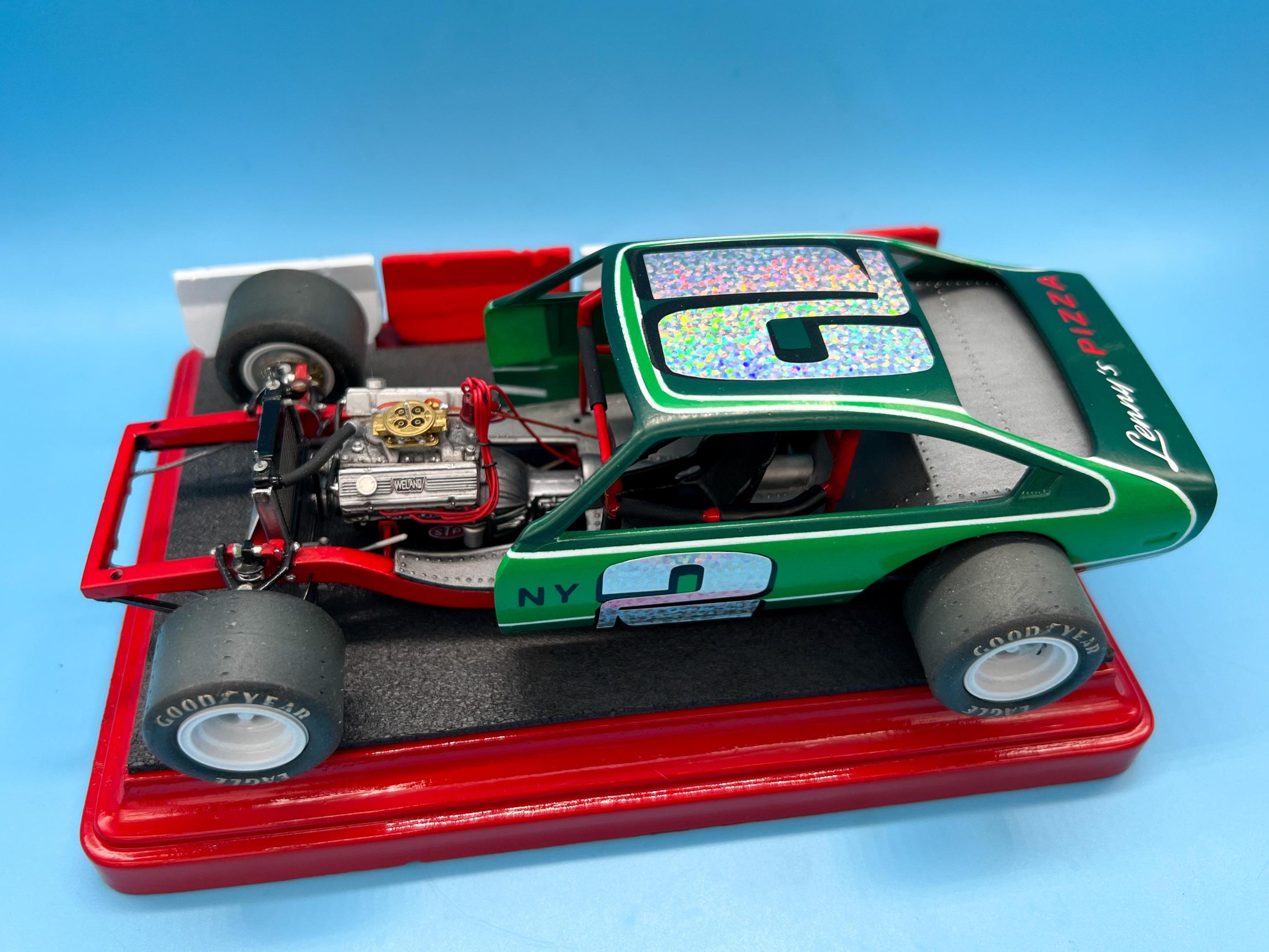

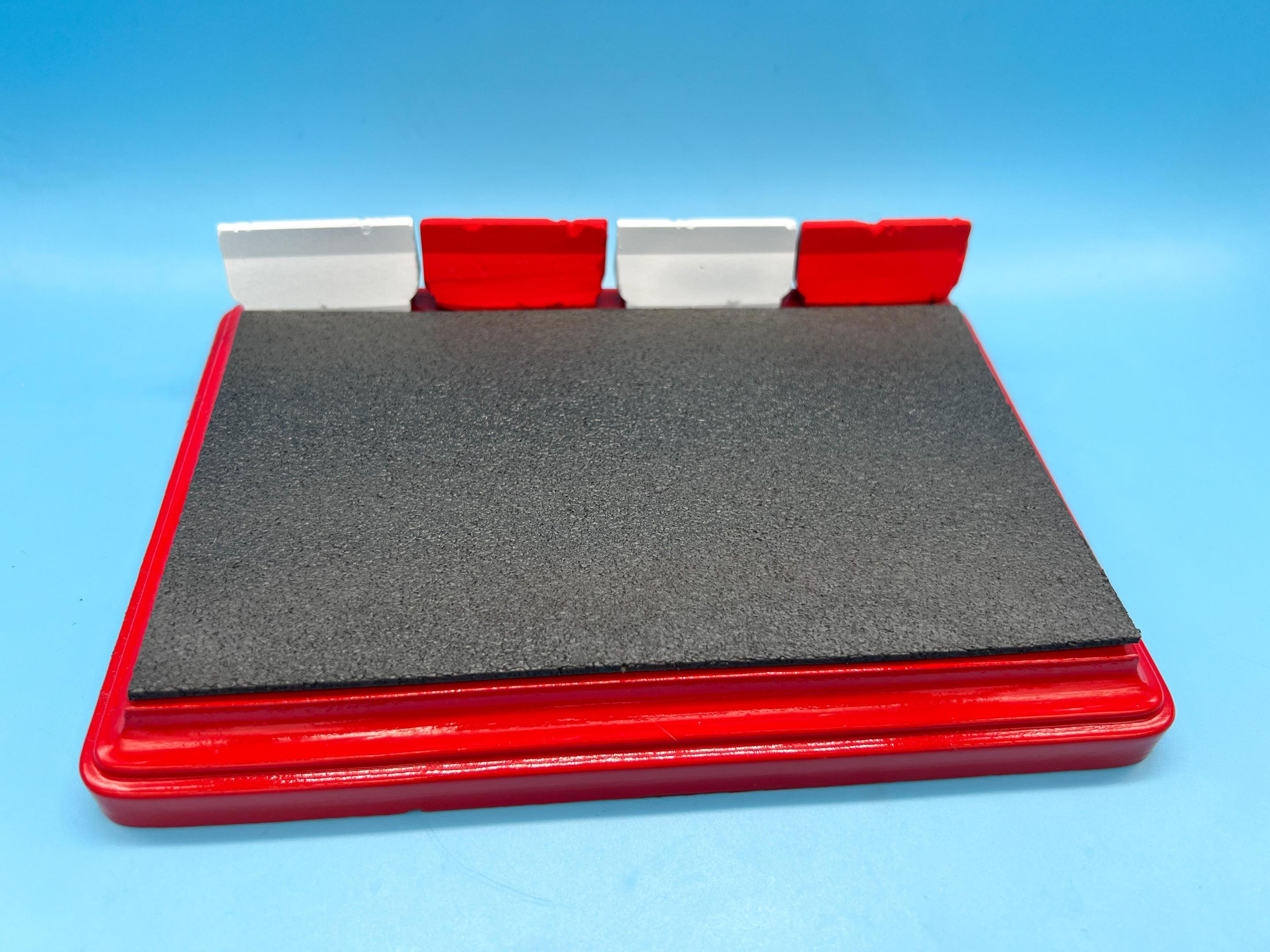

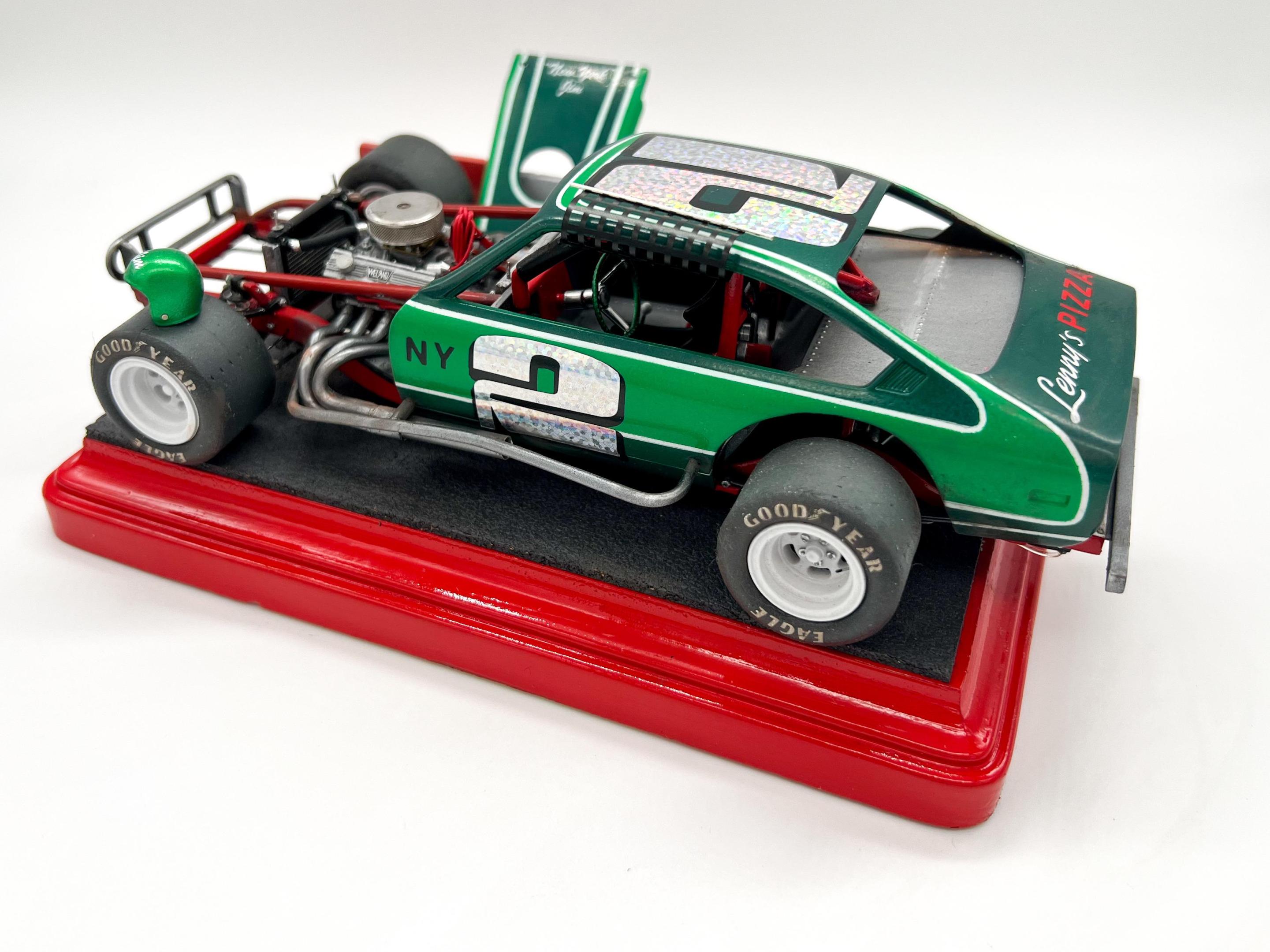

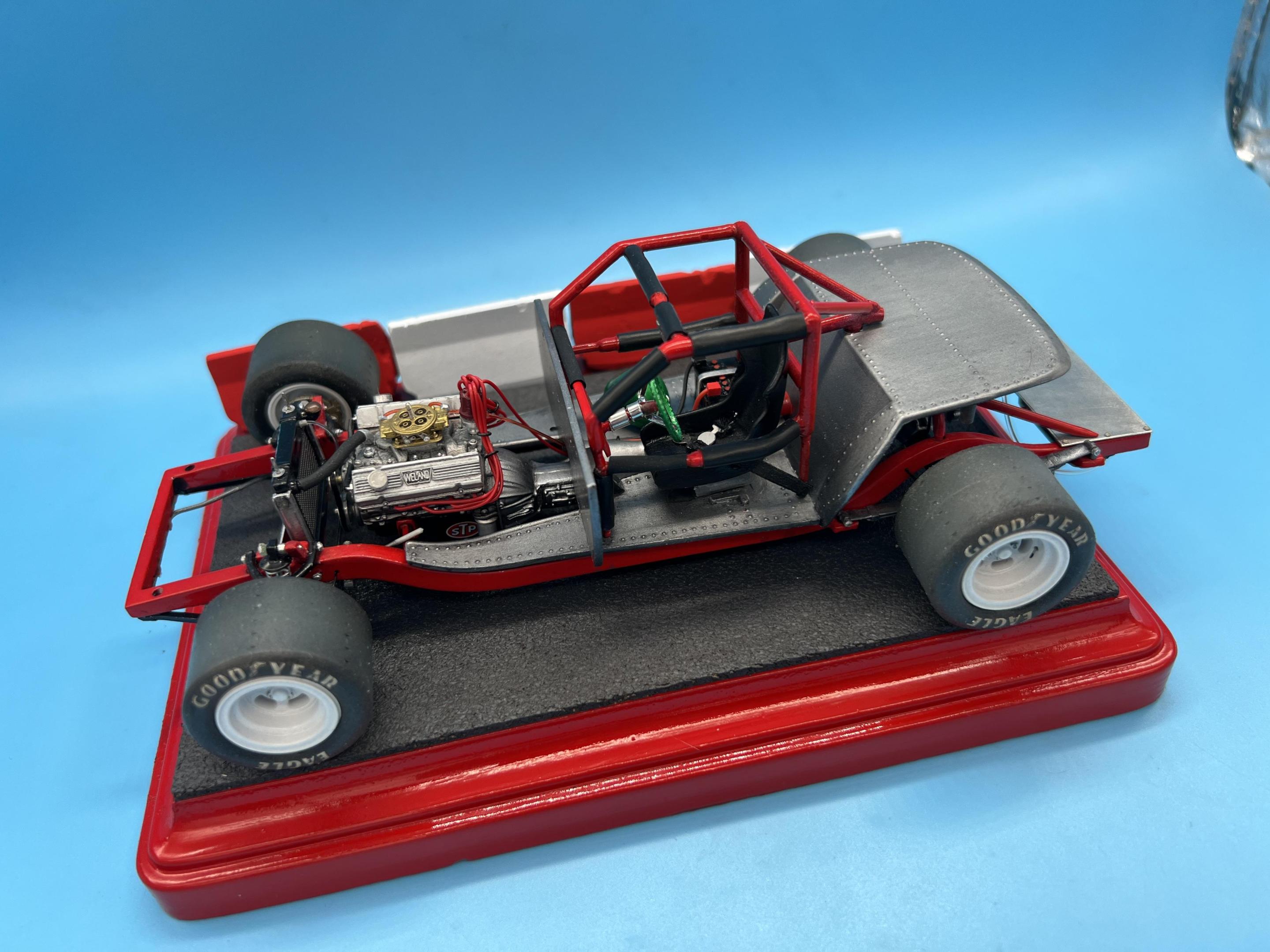

CabDriver Posted June 11, 2023 Author Share Posted June 11, 2023 Thanks for the nice comments, and useful info fellas…noting a bunch of stuff into my brain for future builds - thank you! We had guests in town for the last three weeks, so I had little sporadic 10-minute periods of time at the bench to get this thing wrapped up for the last few weeks. Most of what had to be done was simple assembly, so I didn’t take a bunch of pics, besides some interior shots before I got the body glued in place: And some weathering on the base to make it look a little less fancy and new looking: And then it was just a case of finishing assembly and doing some light weathering to the finished build: And a shot of it with the last one of these I built…I always kinda feel like I should build a couple of each type of race car I build, so that they each have someone to race 🤪😂 Thanks for following along, and for all the helpful comments…I’ll definitely be building more of these so I appreciate all the pointers! 4 Quote Link to comment Share on other sites More sharing options...
Straightliner59 Posted June 11, 2023 Share Posted June 11, 2023 Looks just like it ought to. Nice work, Jim! Quote Link to comment Share on other sites More sharing options...
stinkybritches Posted June 11, 2023 Share Posted June 11, 2023 Spectacular work as usual, Jim. Quote Link to comment Share on other sites More sharing options...
dwc43 Posted June 11, 2023 Share Posted June 11, 2023 Great looking cars. Quote Link to comment Share on other sites More sharing options...
Rattlecan Dan Posted June 11, 2023 Share Posted June 11, 2023 It's gorgeous in every aspect. Beautiful workmanship and attention to detail. Wrapped up in an incredible paint job. Would like to see one shot of it with the hood on. The two together is a great shot. Quote Link to comment Share on other sites More sharing options...
Bainford Posted June 13, 2023 Share Posted June 13, 2023 That's just the bee's knees, Jim. Your efforts have paid off. This build evokes everything it should about period modifieds. I just love this build. Quote Link to comment Share on other sites More sharing options...
Rattlecan Dan Posted June 17, 2023 Share Posted June 17, 2023 Jim, in my humble opinion: It sure does belong in the Under Glass (finished) Nascar section of the Forum. Showroom material for sure! Quote Link to comment Share on other sites More sharing options...

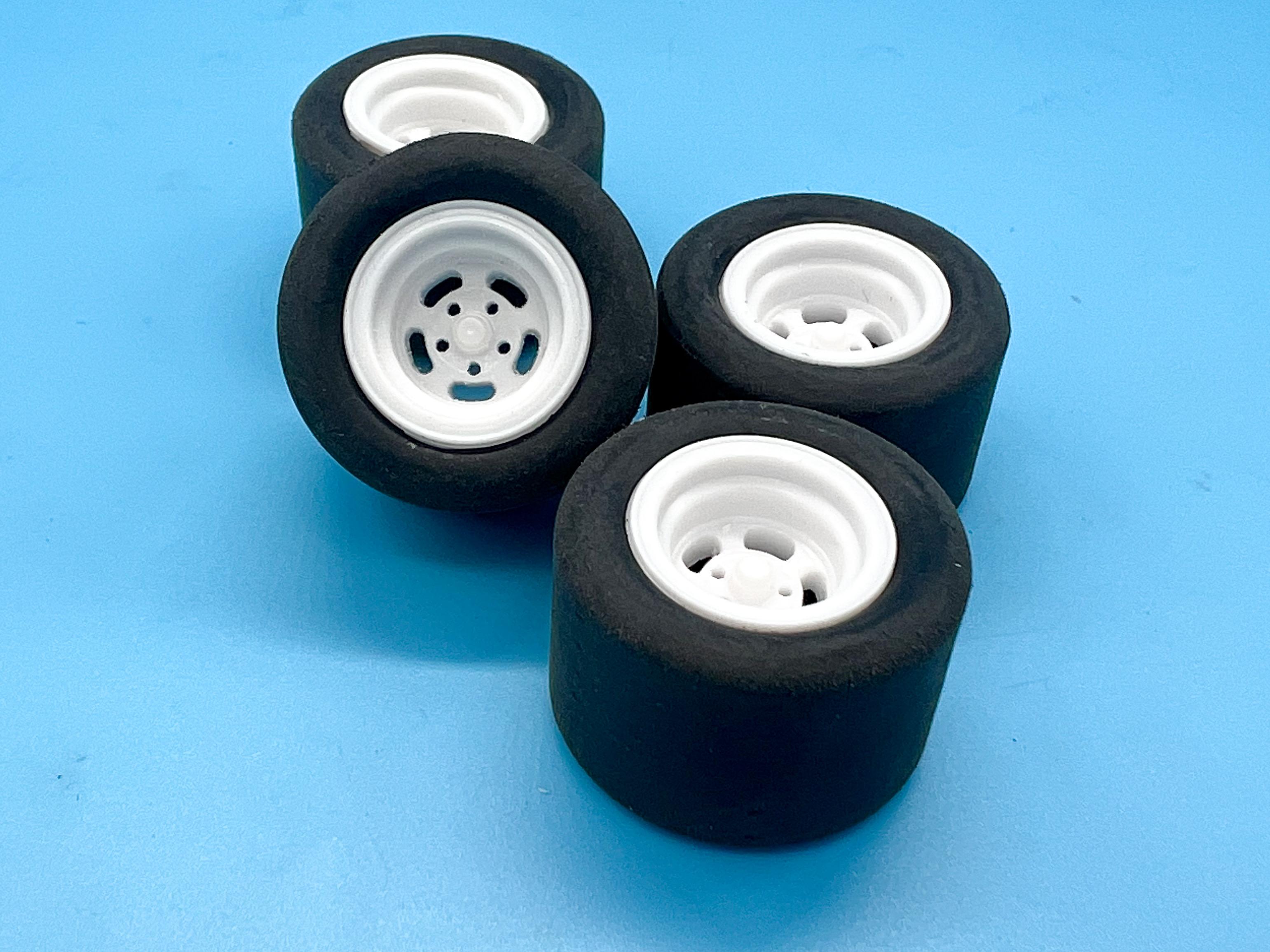

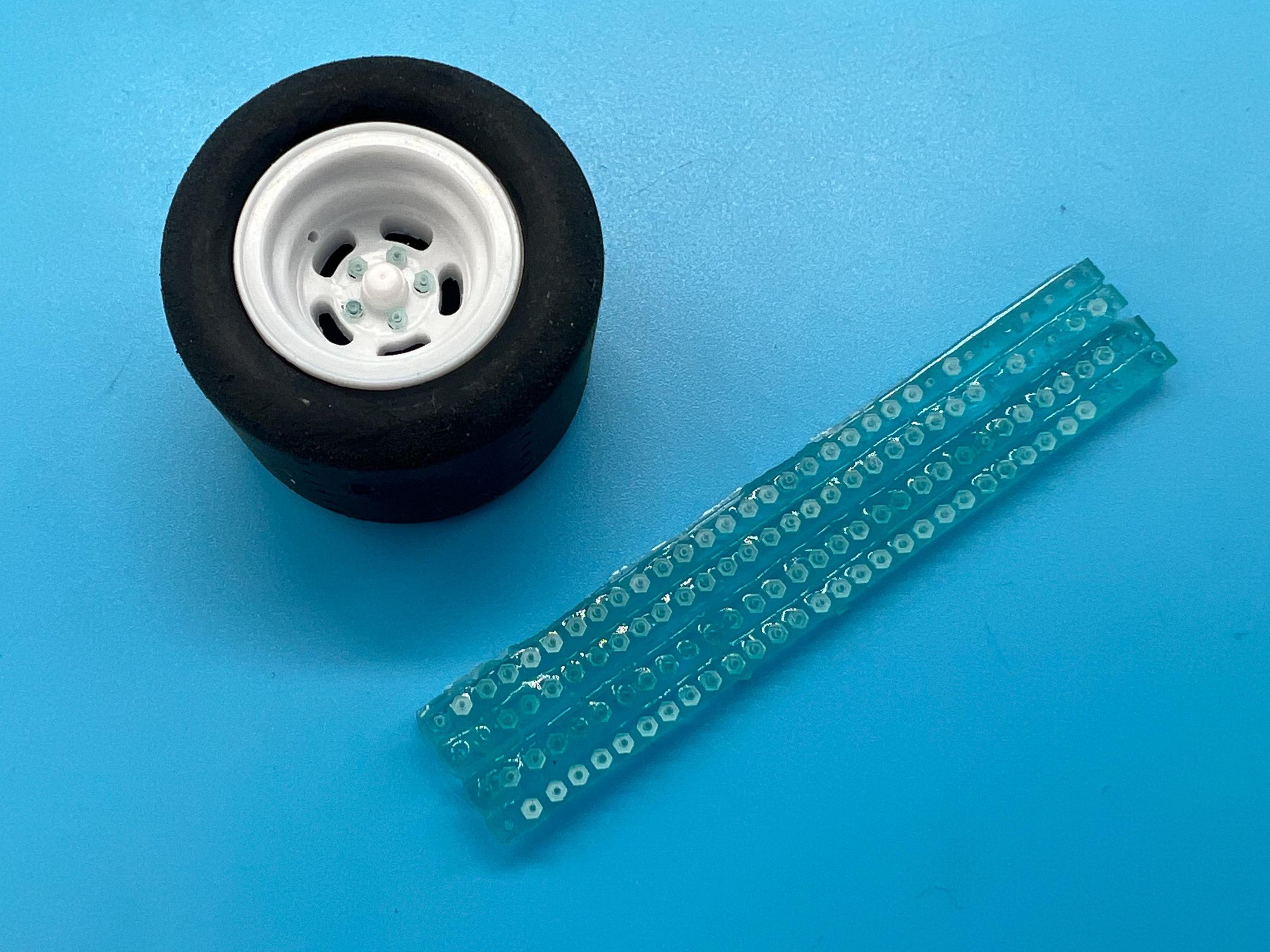

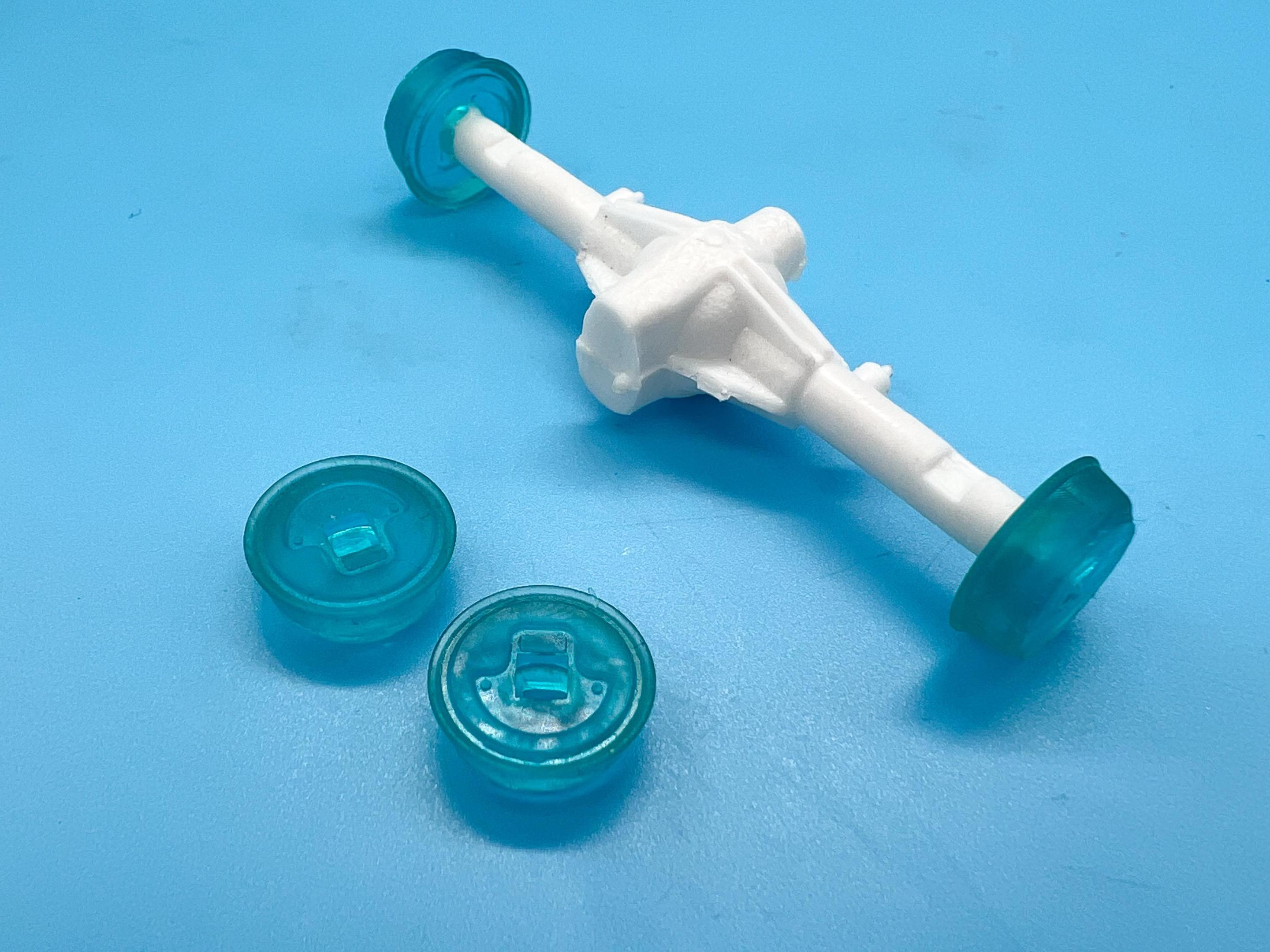

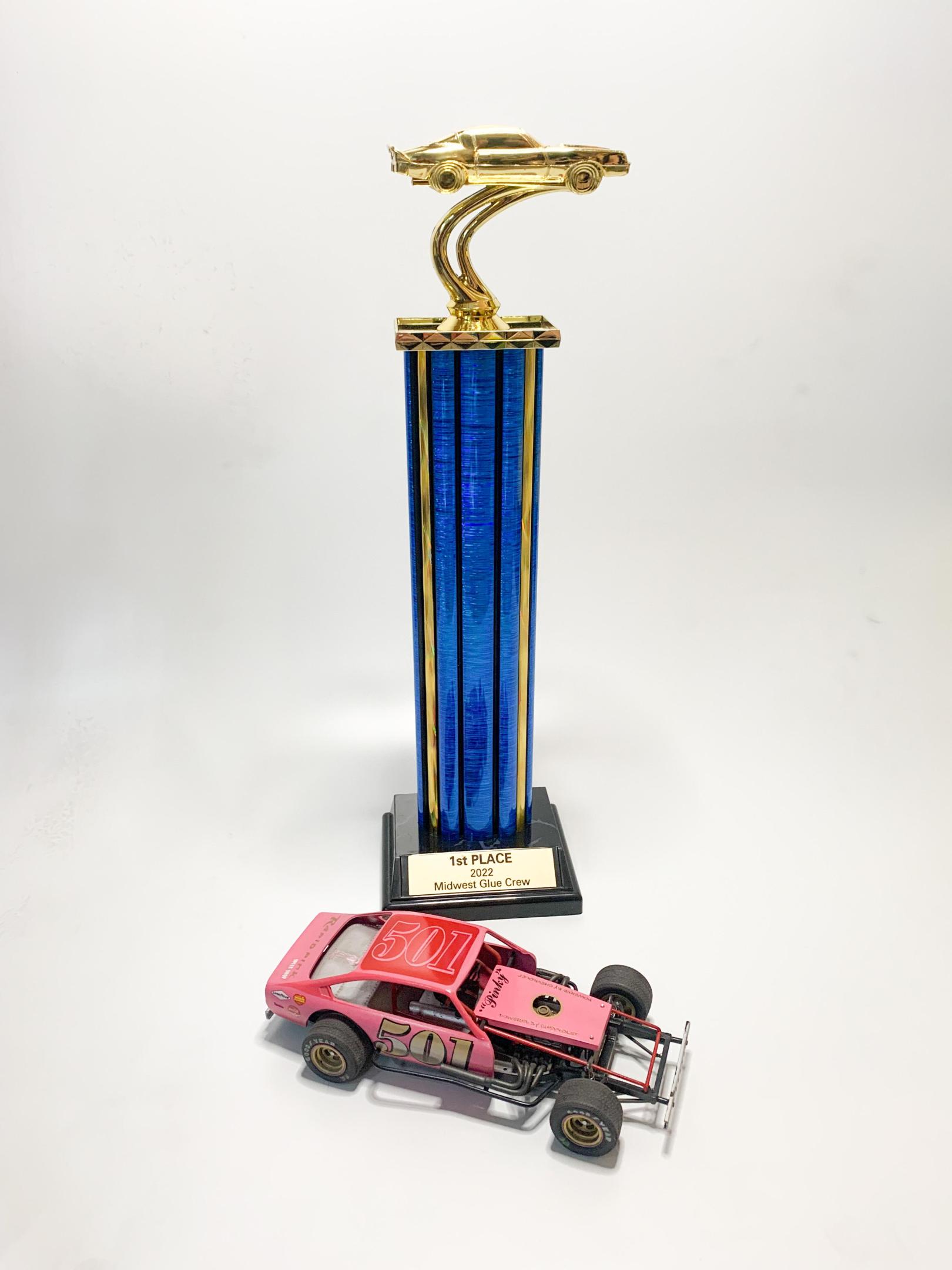

dust collectors Posted July 20, 2023 Share Posted July 20, 2023 On 4/1/2023 at 11:35 PM, CabDriver said: A couple of years back I built the evergreen MPC Rat Trap Vega, then last year entered it in a local show and it won best oval car: The prize was…another of the same kit 🤪 And the condition was, build it and bring it back next year and enter again. Deal! I doubt I’ll get away with another box-stock build with some light detailing though, so for this year’s entry I decided to see how far I could detail up one of these fairly-simple kits and really bring it to life - kinda like those amazing full-detail NASCAR builds done by people I admire like Clay Kemp and the late Dave Thibodeau. First step in the manual is tires (why do NASCAR guys often start with the tires?!) and I wanted to switch out the treaded kit ones for a set of slicks. I COULD print some, but the aftermarket has plenty of options so I ordered a set that I suspect are designed specifically for this line of MPC kits. They slide right on the wheels like a glove! These are actually injection molded rather than resin, and they come with waterslide tire lettering which is a big bonus in adding some detail. So, how much detail can we add to a tire, whilst I pondered that, I spent an hour or so cleaning up the mold lines, rounding off the edges and sanding some flats on the bottom to make them appear as though some weight is squishing them a little. Kit tire on the left, new replacement tire center, sanded and prepped tire right: I then shot the tires with a coat of Createx base (which is a translucent clear, almost like a primer) that allows better paint adhesion to tough-to-paint surfaces and tomorrow I can hit them with some airbrushing to add some realism. Next step: the wheels - what can we do to THOSE to add some detail and realism? Well, first thing that struck me was the lugnut detail is kinda soft and uninspiring, so I drilled them out… …and 3D printed a whole bunch of replacements… …and now I have separate pieces that I can paint more easily and that look a little better I think: Tomorrow’s job on the wheels will be making some balancing weights and valve stems and playing with those tires some more. This is gonna be a fairly deep dive into a bunch of probably boring little details (like sanding tires and making lugnuts) so if you’re not into that - apologies for being boring 🤪. More soon, soon as I’ve done more! These little details make a world of difference! Quote Link to comment Share on other sites More sharing options...
