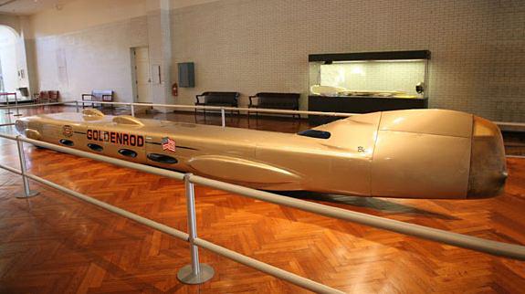

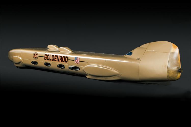

Straightliner59 Posted April 10, 2023 Posted April 10, 2023 In photos of the Summers Bros. Goldenrod, it's apparent that the section of the tail that housed the 'chute tubes was thin fiberglass, somewhat resembling that of corrugated panels. It appears somewhat translucent, as well. I don't recall the colors I used (one was likely Humbrol Unbleached Linen), but the stuff applied over the base was more or less dabbed on, with a brush, to create a mottled look. It's not perfect, but it's at least an attempt!? 3
