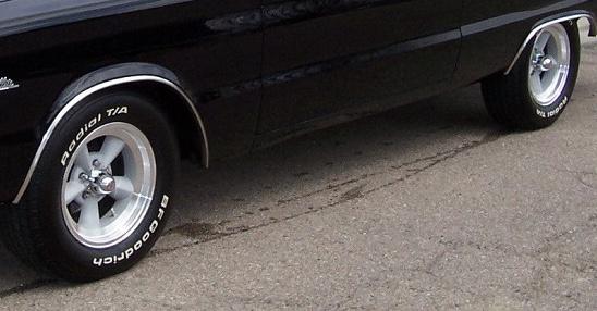

Monty Posted April 15, 2023 Posted April 15, 2023 (edited) I'm looking to replicate the finish on the spokes of these wheels. Please be as specific as possible (ex: Testors #1615) when listing your recommendation. http://media.fotki.com/1_p,rtdkfwdsgftkdtdxswrbwbbfqfwtk,vi/rbdkwbrrkxbrstgdrkkxbrwbqgtbb/6/3766926/14276847/04032016_09-vi.jpg If you can, I'd appreciate seeing pics of wheels painted with whatever you recommended. Thanks! Edited April 15, 2023 by Monty
espo Posted April 15, 2023 Posted April 15, 2023 Two suggestions to look at for that shade of silver. #1 Tamiya X-32 Titanium Silver and #2 Tamiya XF-16 Flat Aluminum, The Flat Aluminum would give you the flat finish in the picture and be very close in color. The Titanium Silver would have a low gloss finish. I have used both colors mainly for engine components as well as chassis parts.
Dpate Posted April 15, 2023 Posted April 15, 2023 If you're gonna use Tamiya I'd recommend there LP line up instead of the XF line. The XF line up of metallic paint's aren't that good compared to the LP version. The Titanium silver while very nice, will not give you the results you're looking for on those rims if done over black base - probably a grey or white base. Alclad's matt aluminum will give you very close results to the center of the rims, and the outer part i would look more towards a white aluminum again on a grey or white base not black.

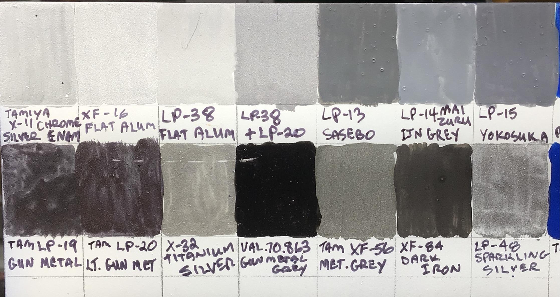

NOBLNG Posted April 15, 2023 Posted April 15, 2023 (edited) I would call that a very light grey and not metallic at all? Here are the samples I have. The LP-14 mixed with white might work, or maybe they have an even lighter grey? Edited April 15, 2023 by NOBLNG 2
Ace-Garageguy Posted April 15, 2023 Posted April 15, 2023 25 minutes ago, NOBLNG said: I would call that a very light grey and not metallic at all? Here are the samples I have. The LP-14 mixed with white might work, or maybe they have an even lighter grey? Excellent...and yup, at the scale we're talking about, those spokes will not have a discernable metallic look.

peteski Posted April 16, 2023 Posted April 16, 2023 (edited) I believe those wheels are one-piece forged or cast aluminum. Then the rims are turned on the lathe, resulting in that shiny metallic look. The spokes are left natural rough aluminum (or maybe they are even sandblasted) to give them that dull gray/silver look. I have simulated this on the Revell '32 Ford 3-window coupe wheels by masking the outer parts of the kit's "chromed" rims, masking the hub and lug nuts with liquid mask, and spraying the centers with "steel" color paint. That was over 20 years ago and I don't recall what brand of paint I used. It could have been Alclad II steel. It is metallic with very fine metallic grain, and it has a dull finish. The spokes on Monty's wheels almost seem to have bluish cast to them. That might just be an artifact of the photo. If not, maybe use one of the Alclad Aluminum shades, and maybe even add some Alclad transparent blue to tint the color a bit. Alclad metallic paints have very fine grain. Edited April 16, 2023 by peteski 3

TECHMAN Posted April 16, 2023 Posted April 16, 2023 ??? Sorry I don't have the "set-up" to post pictures, and only offering "what I use" to paint these type of rims (primarily the American TorqueThrust)........ On the 1:1 vehicles, I used a gray primer to "refinish" the darker gray colored spokes, the lighter gray I used a "flat aluminum" to paint....... On the models, I have used "flat-gray" for the darker, and "flat aluminum" for the lighter colored rims, (like in the original picture}...... Not perfect, but at least something that will make your model "resemble" the picture.....? DJ
