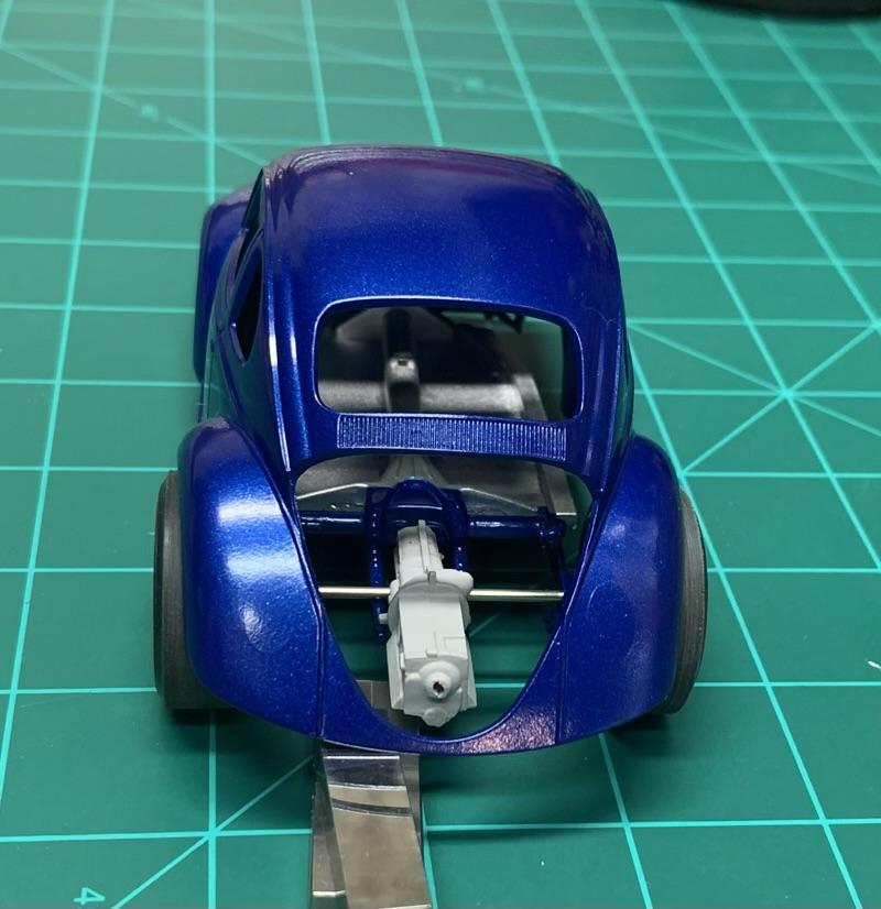

First mock up.  I think it looks a little goofy from the side, but I kinda dig the front and rear angles.  It should serve the purpose this build was intended for anyway.

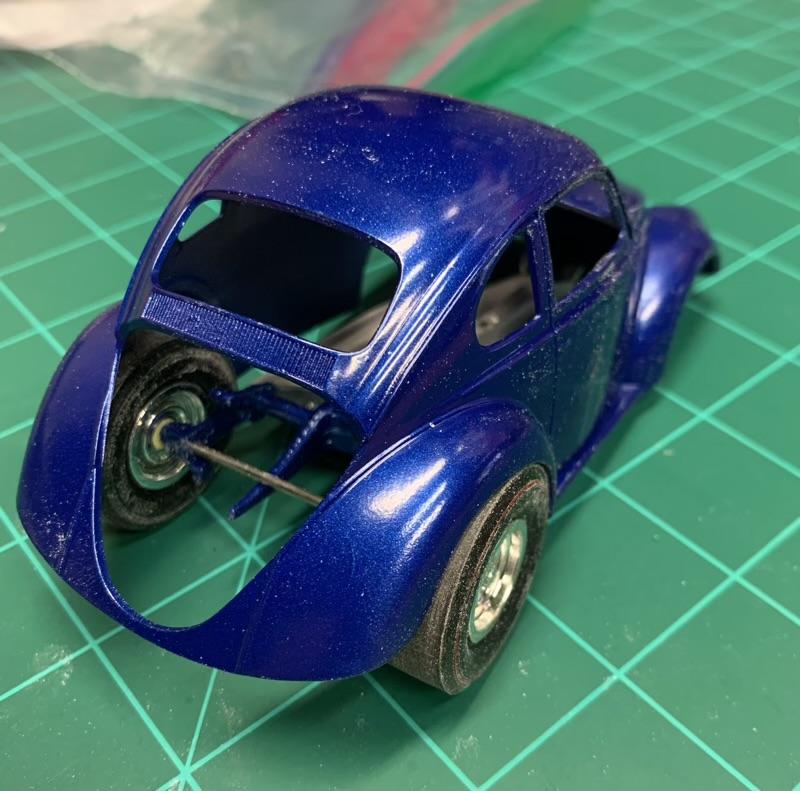

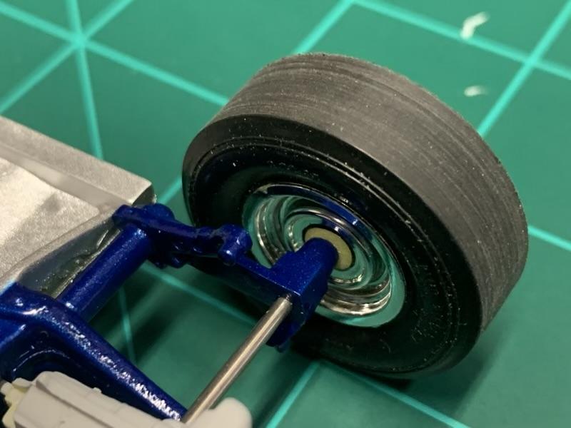

I do want to narrow down the rear axle a little to tuck the tires in more.  I want them either even with the fenders or just slightly outside.  But this is a bit more than I want.  I already trimmed the backside of the rim and it got me closer, so now I think I’ll shave a little more there or maybe trim the suspension where it meets the axle.  I’ll need to cut a little off the metal axle too.

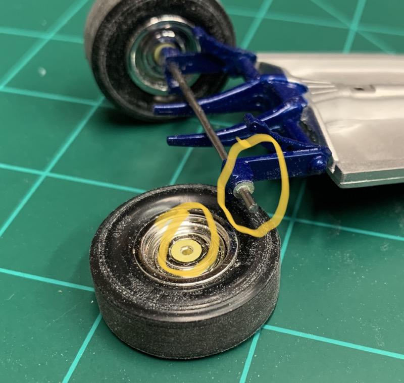

Back at the bench this morning while my wife is out.
 I narrowed down the rear axle to pull the rear tires into the fenders.  Super easy mod to do, and it went exactly as I planned.  As I mentioned in the last post, and all that’s needed is to shave a little material off the back side of the rims where the axle goes in, shave a little more off the rear suspension where it meets the rims, and cut the axle down a bit.  I think I took about 1-1.5mm off roughly.  Here’s a better shot of the offending area.
And here’s the result.  Once assembled the rims won’t be sitting on the tires.
IMG_3036.jpeg.752484fcc4ca2b04f40e05ae600b6a4b.jpegIMG_3037.jpeg.39f1c47afff1663a6facbf74826b2e4b.jpeg

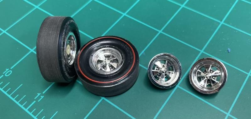

On 7/19/2023 at 5:18 PM, atomicholiday said:
Rims and tires are pretty much ready to go.  I used a tool I made chucked up in my drill to sand the tires.  Makes the job easier and to me it looks more realistic.  Works pretty good for normal treads.  I’d never used it on slicks before now.
Are these red line tires prepainted, and if so are they included in this kit?

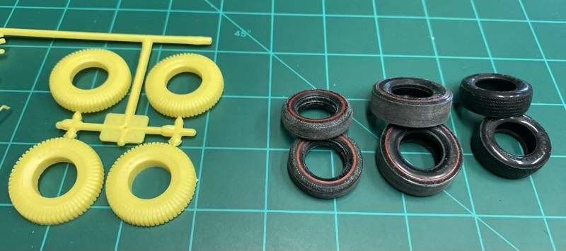

Hey Craig, yup.  The tires come with the kit as red-lines.  Actually comes with eight tires total.
This kit has quite a few extra bits and pieces, and a few different building options.

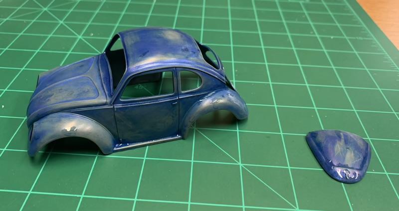

Well if there’s one thing I am getting good at this year, it’s stripping paint.
91% isopropyl alcohol is amazing stuff when it comes in contact with Testors extreme lacquer.  This body had about six (admittedly too heavy) coats of paint and clear combined.  Soaked it for about two hours and it scrubbed right off with a toothbrush.  And didn’t touch the primer.
On the bright side, I think I’m single handedly keeping the Testors brand alive!  Or not…
Looked kinda cool just like this! :)
Yup, there was a split second after clearing all that paint off when I looked at it and thought “barn find!”
