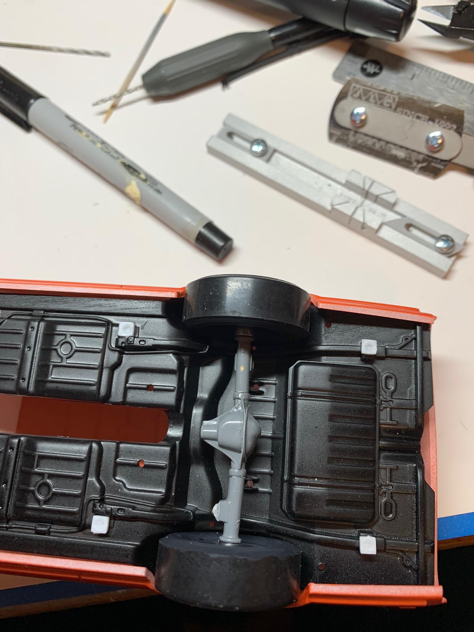

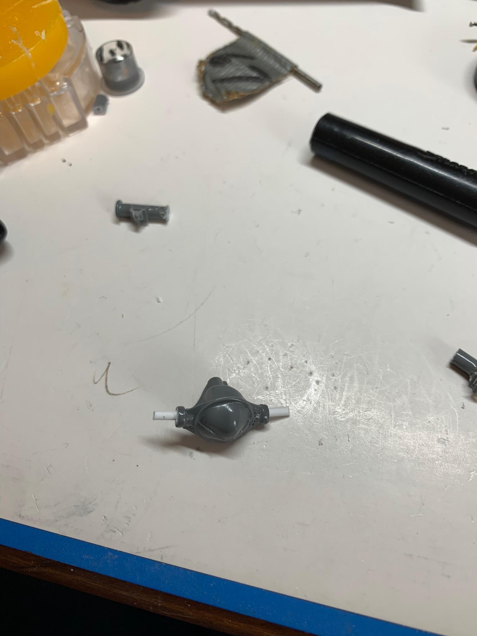

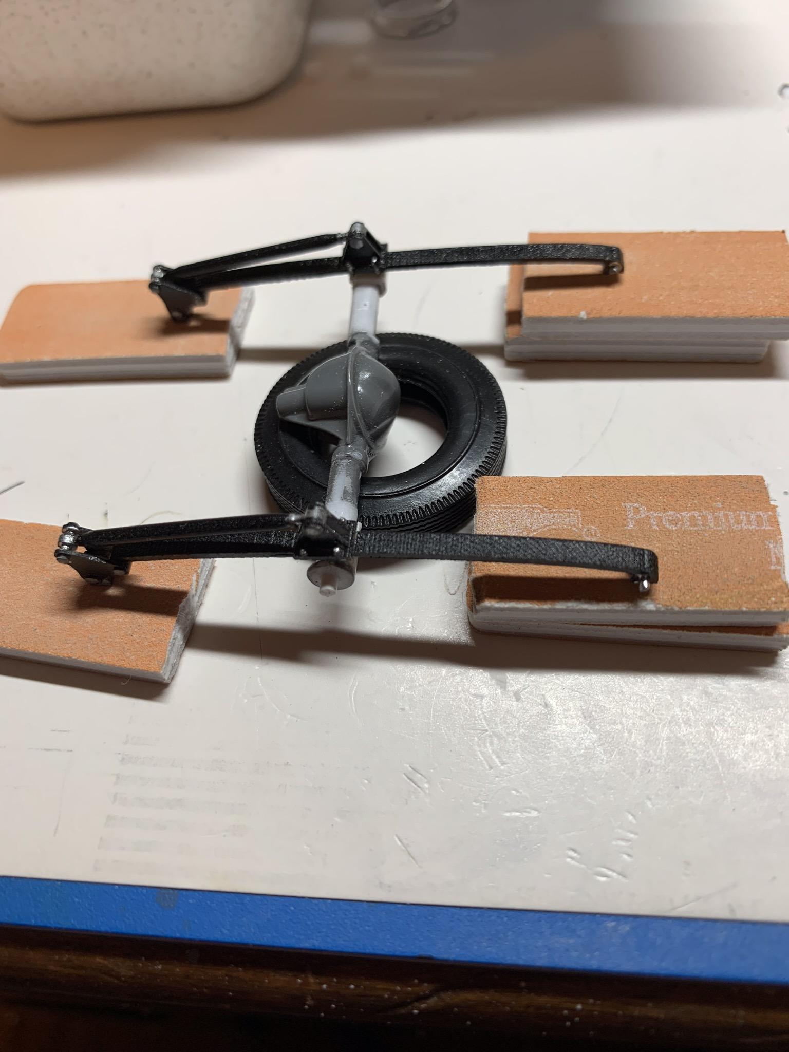

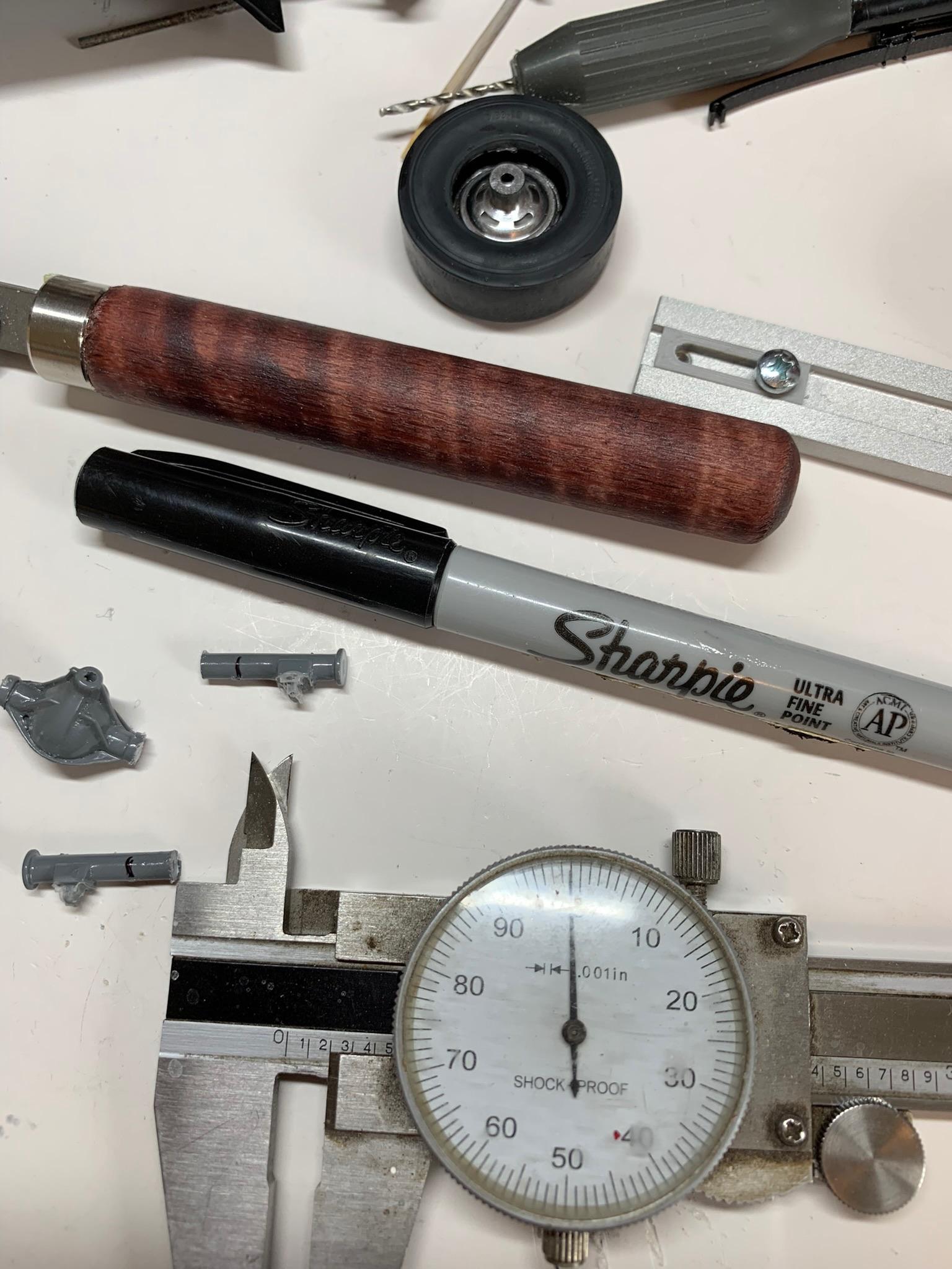

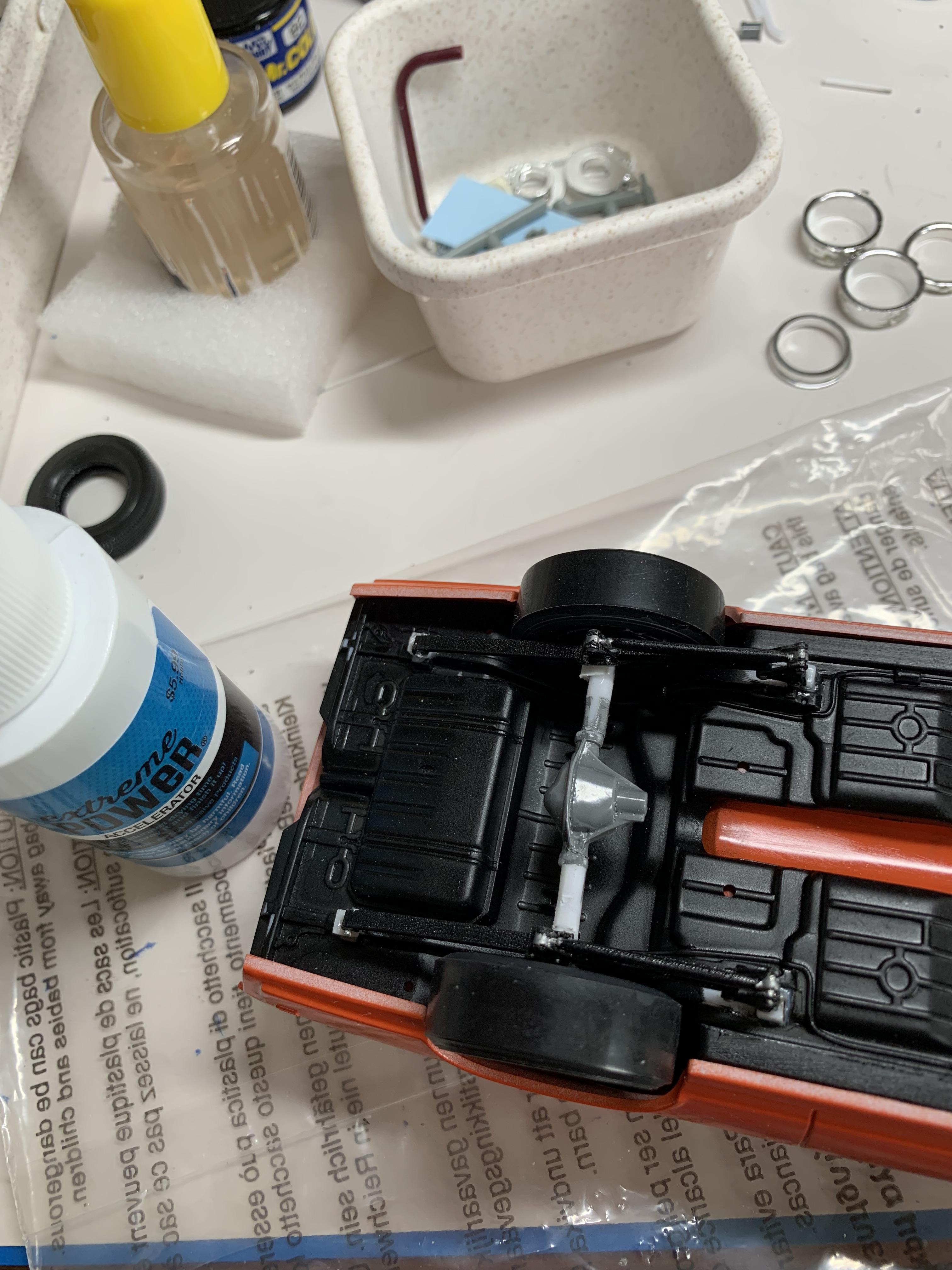

Thanks, gentlemen.  You help to keep me motivated to finish this one.  I, however, have no excuse for this last delay.  Anyway, I got the rear end drilled out for a metal axle, shortened .200” on each side, in order to use the rear wheels (thanks again, Roger).  I then decided to use plastic rod instead (easier to cut).  That’s it for today.

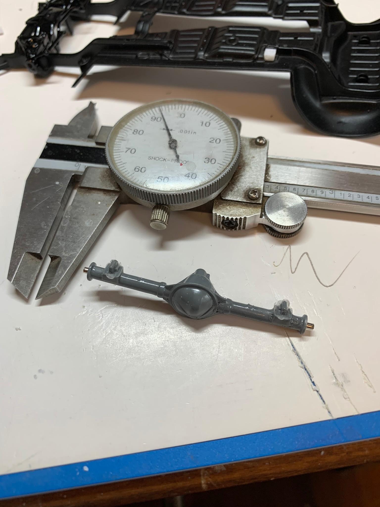

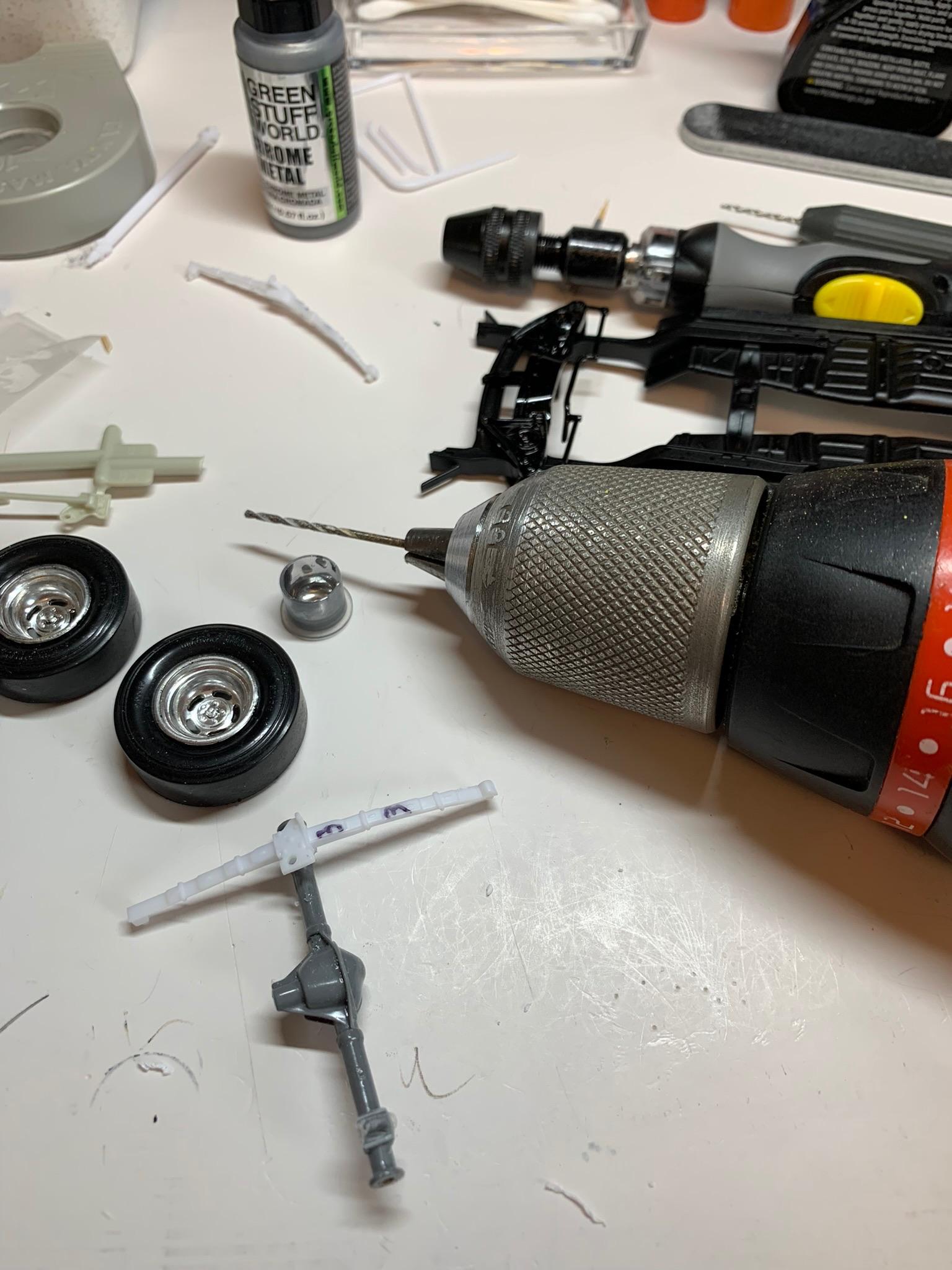

Thanks much, Daniel.  Trial fit for width of axle with slicks.  Looks close.

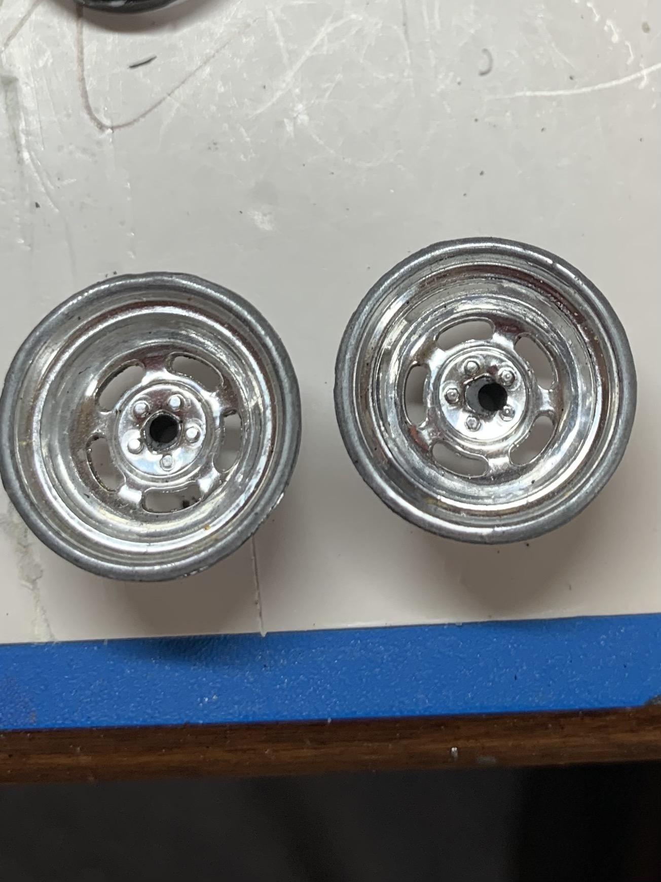

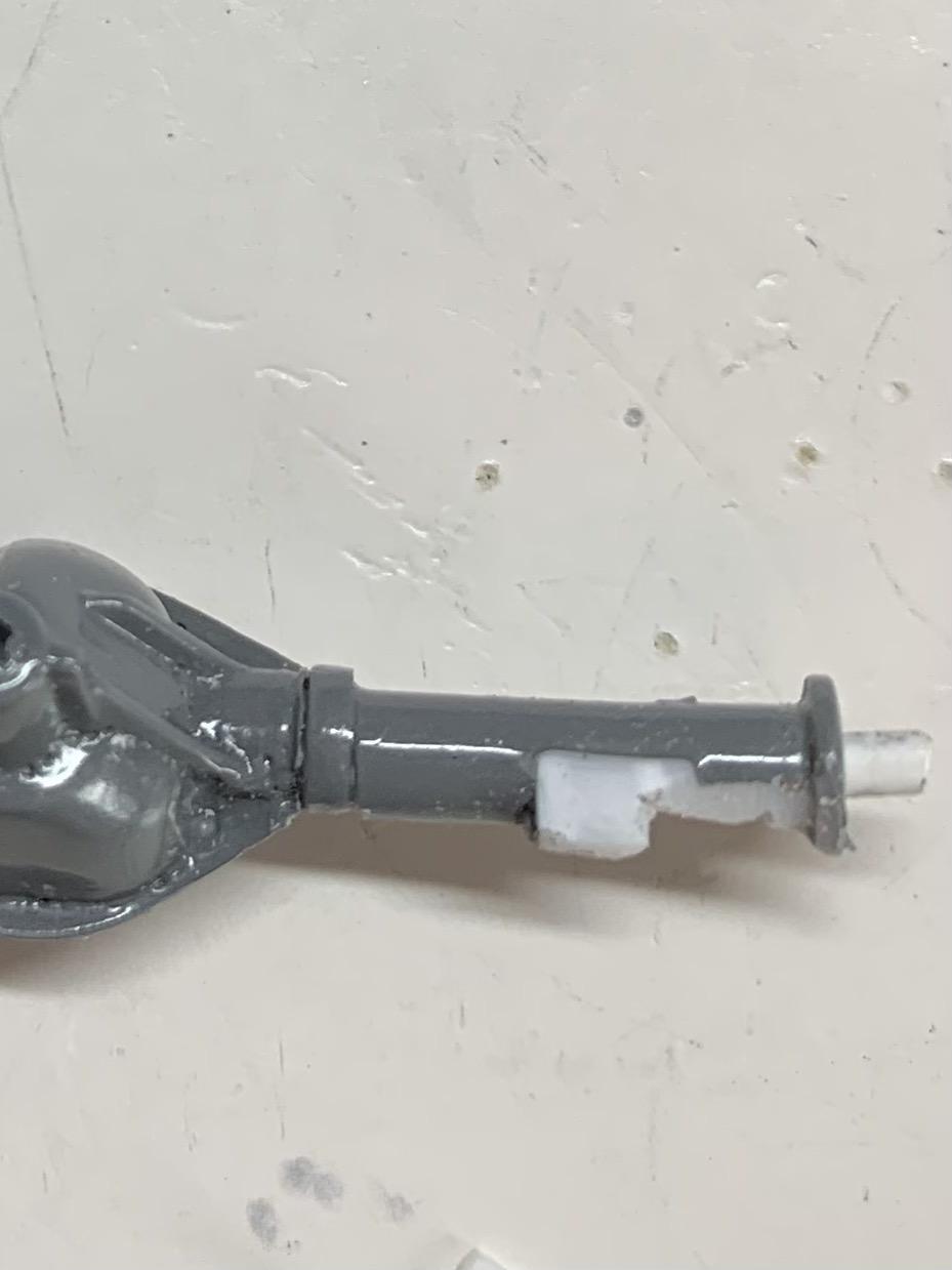

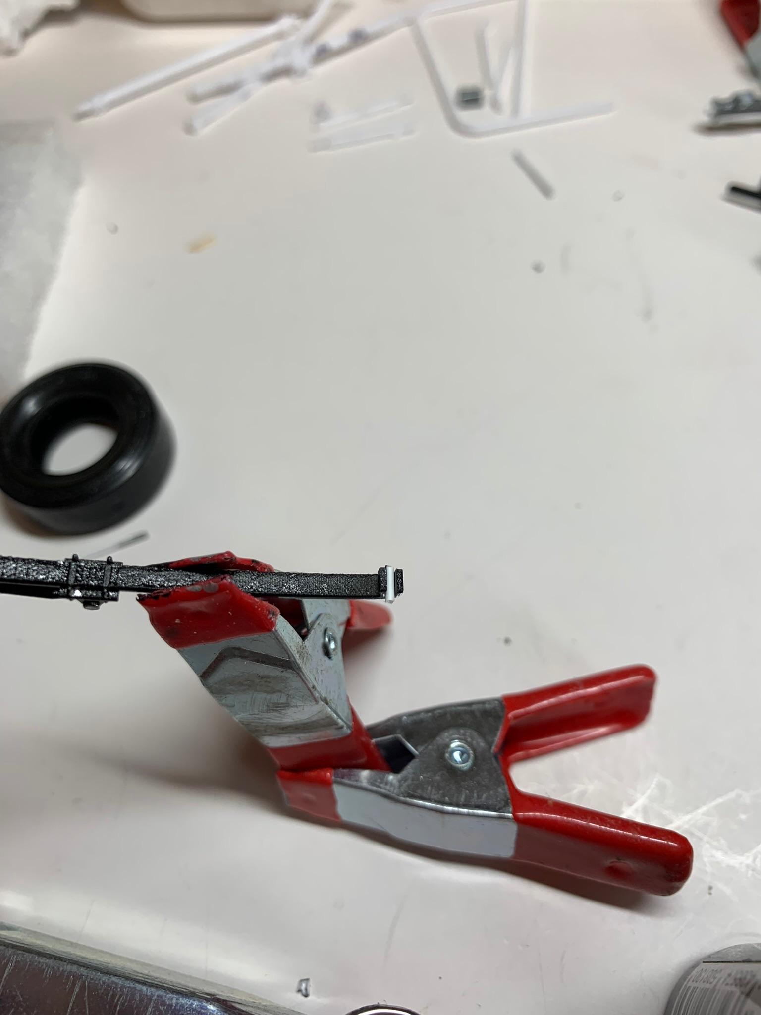

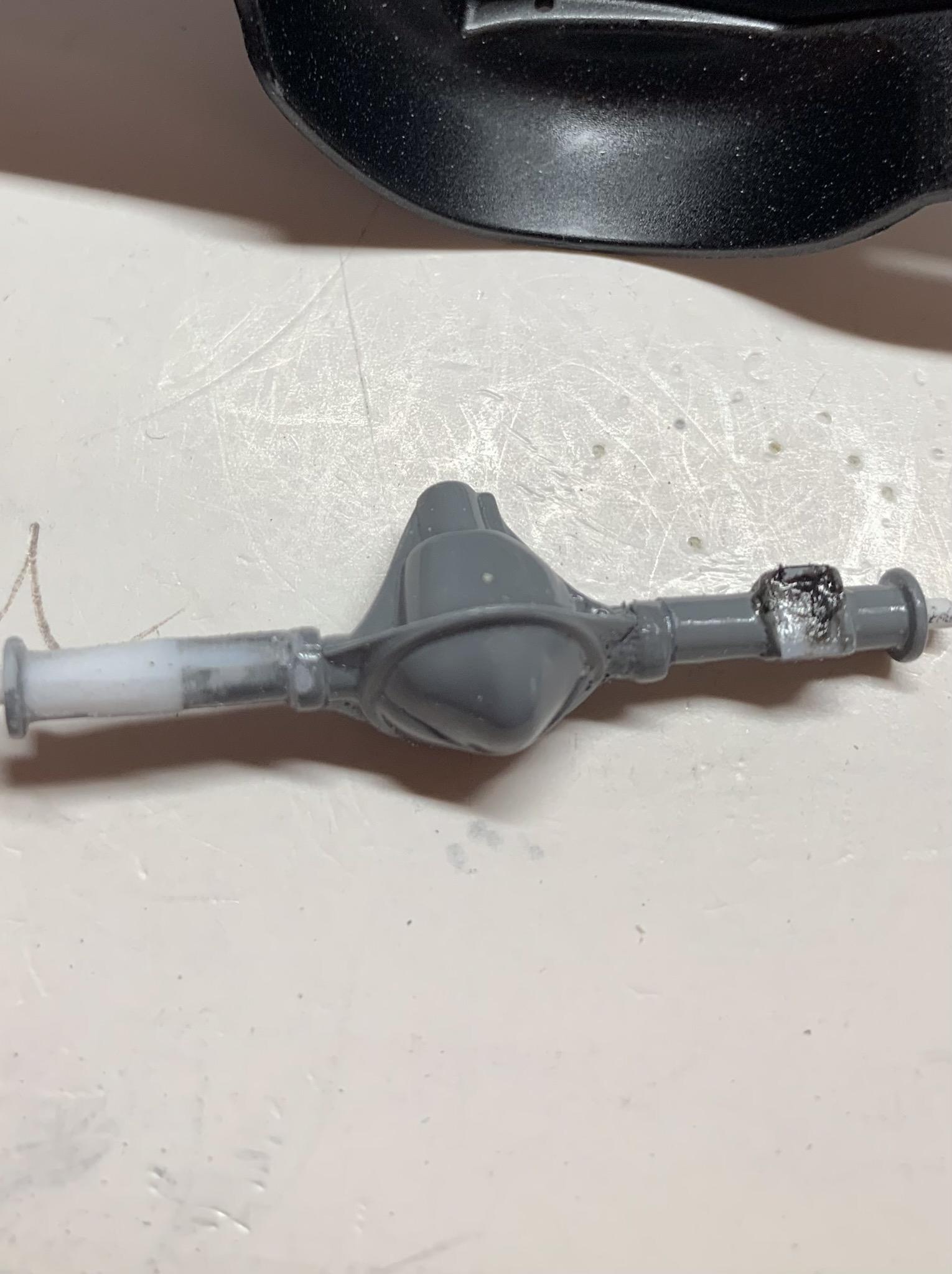

Glued the rear axle back together, hopefully properly aligned.  Touched up the outer rim of the wheels with some GreenStuff and a micro brush.  Put some 1/32” rod in the springs.  The reason the springs look so rough is they are not the smoothest castings you can get from Shapeways.
  • Like 3

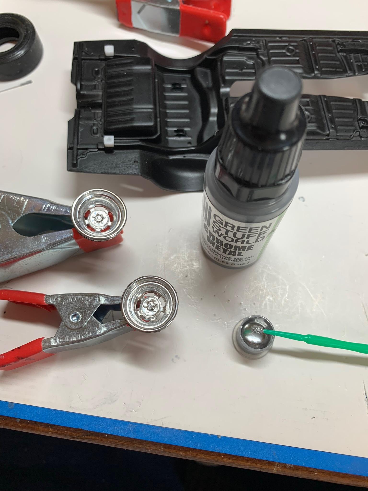

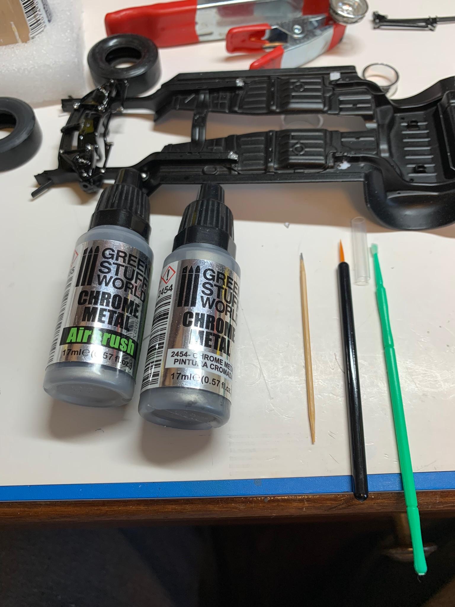

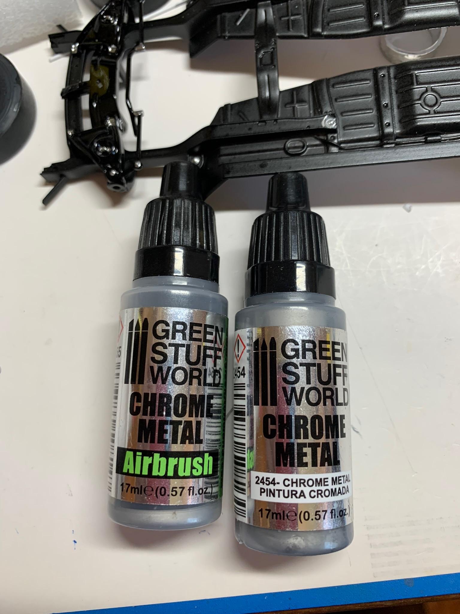

The GSW chrome looks good. I have some and tried it. Put one pretty heavy first coat and it looked great. Then a few minutes later sprayed another coat and it wasn't as shiny. What was your process?
Sorry for the delay.  The GSW was only put on the outer edge of the wheels (thanks again, Roger) and applied with the microbrush as shown.  I tried to airbrush the GSW when I first got it a couple years ago with less than stellar results with the air brush version (there are plain and air brush types available).  The “plain” version I like a lot for touch ups and interior work applied with tooth pick, micro brushes, and just got some mascara throw away type really small pointed brushes that work pretty good.  I tried to show the difference between the plain(on the lower right of the roll bat) and airbrush version on the left.  If you look at the top of the bottle(s) , you can make out the superior chrome look on the “plain “ version.
  • Like 1
I have only tried the airbrush version. Looks to me like the brushable version is a little darker.  Thanks for the reply.

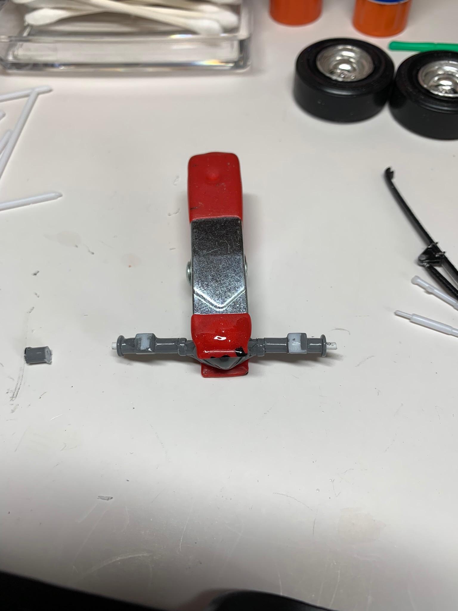

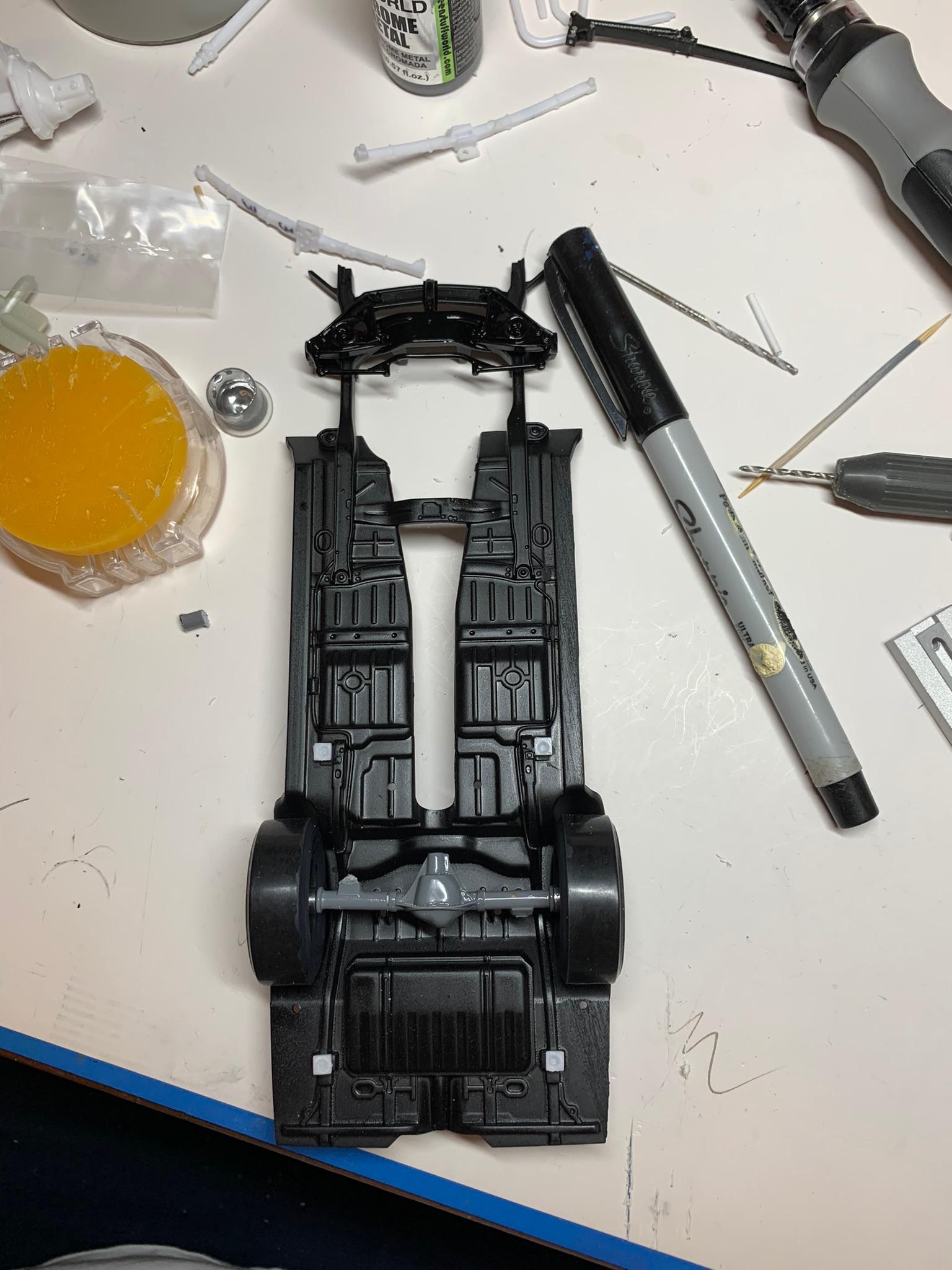

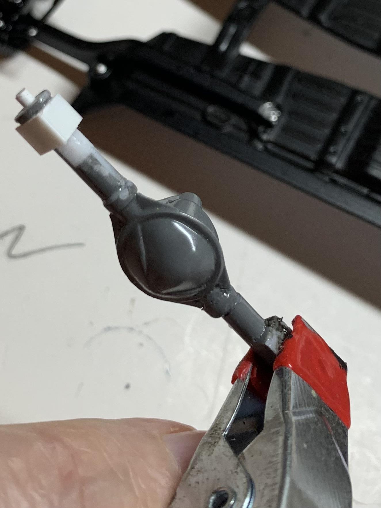

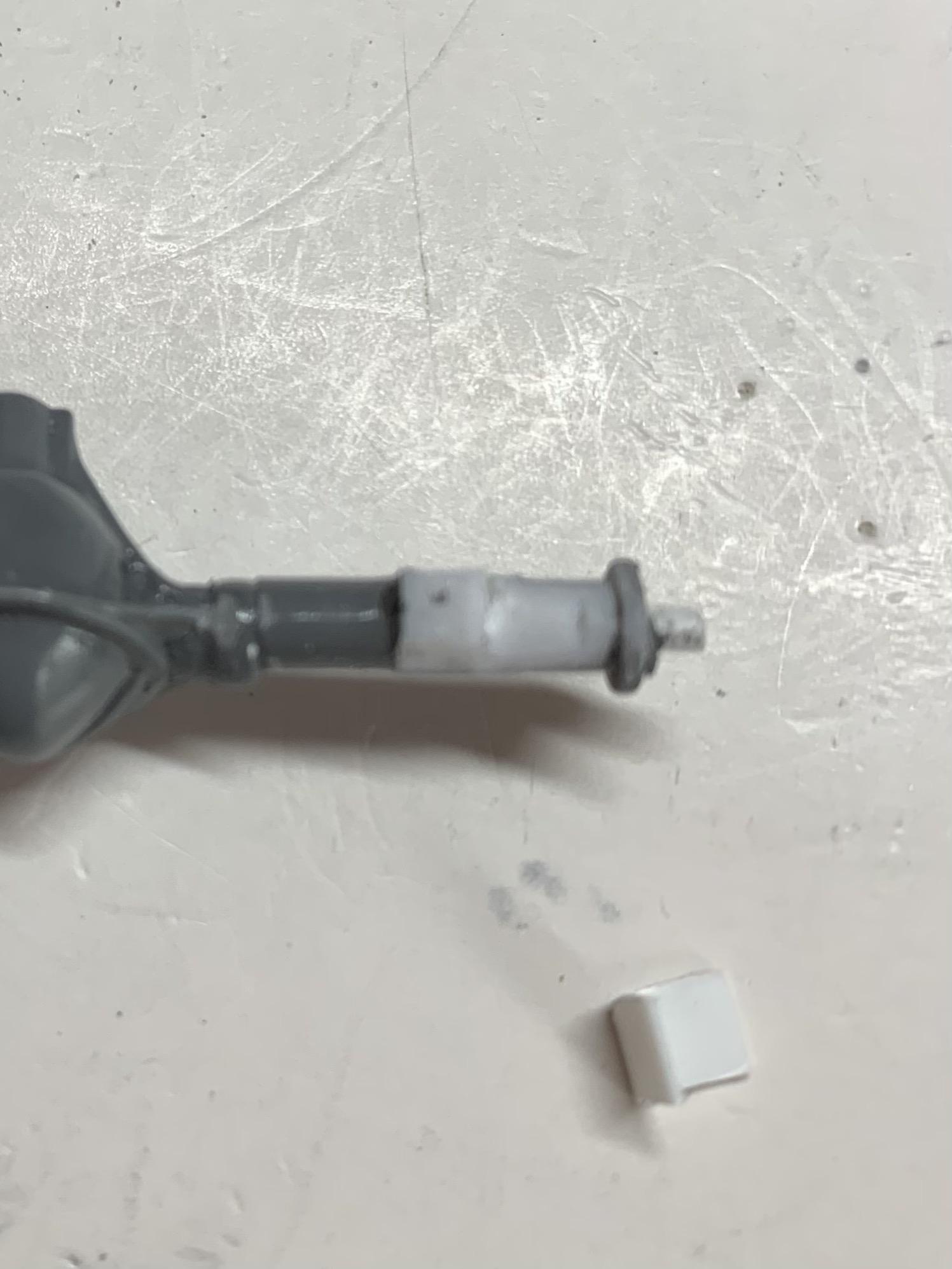

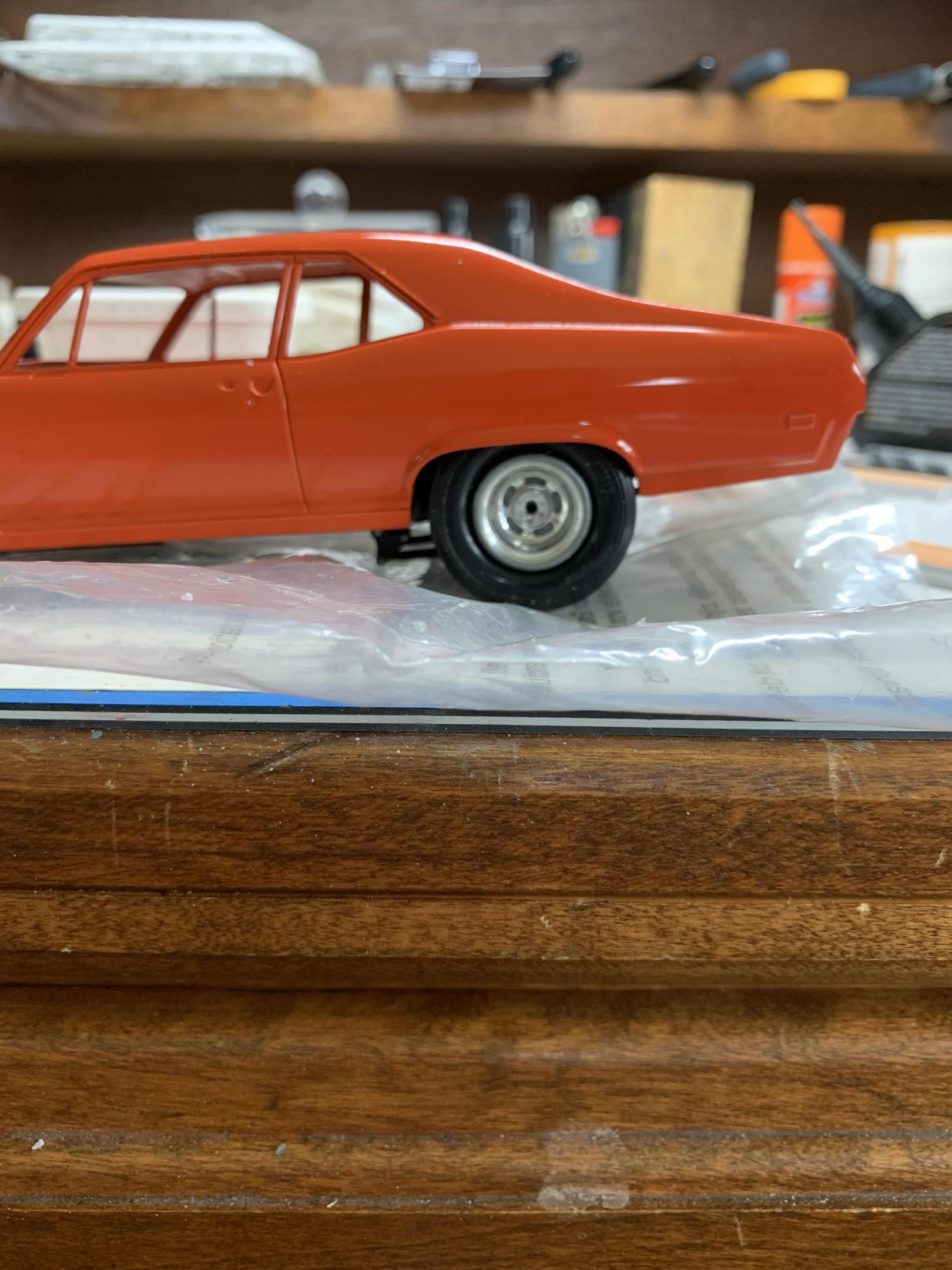

After some “slump” time, I am back at it.  After shortening the rear axle (actually, a no-n in 1:1 cars) , I realized (duh!) that the spring mounts were too far inboard now.  I still can’t believe I pulled such a dumb move.  The reason behind shortening the axle was the wheels stuck outboard too far.  Well, I have since fixed this issue (hopefully) by drilling out the wheels to remove the hub caps that came on these wheels.  Anyway, I have made new spring mounts, made a jig for gluing, drilled out the inner wheel hubs I scrounged up so they will slip over the rear wheels, and set her aside to dry.

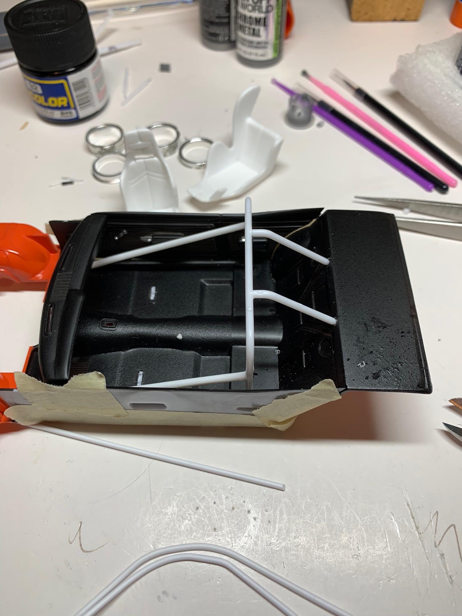

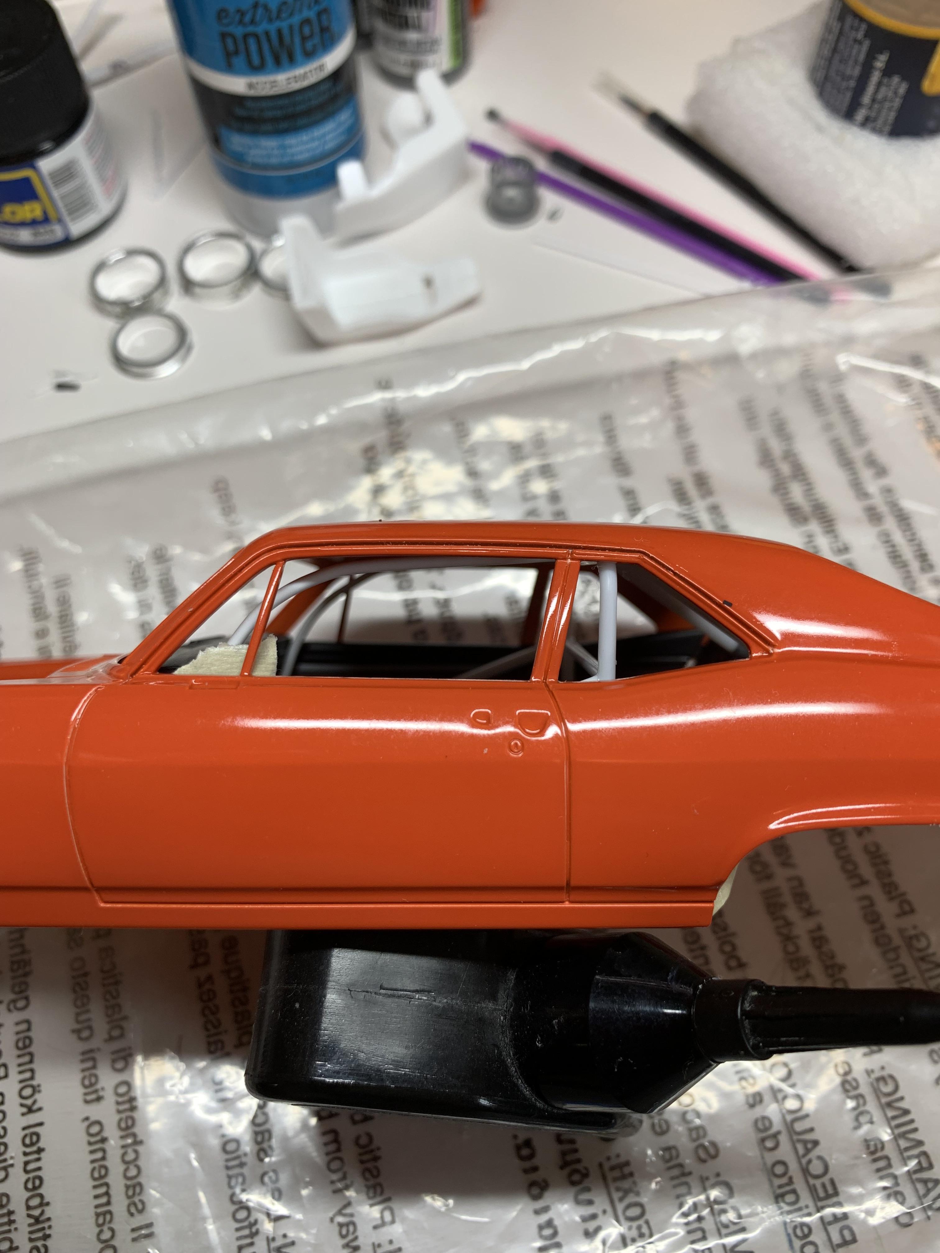

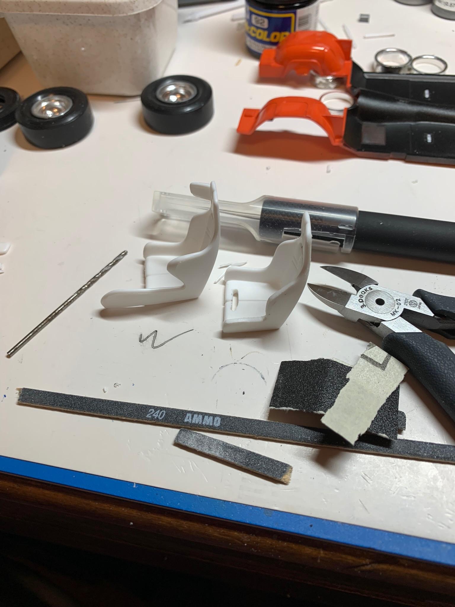

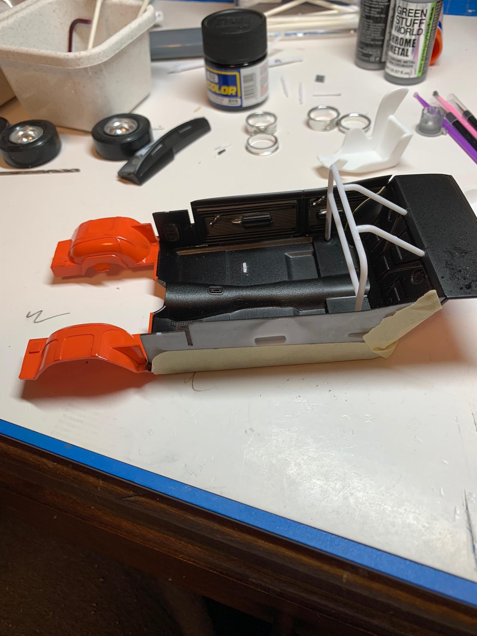

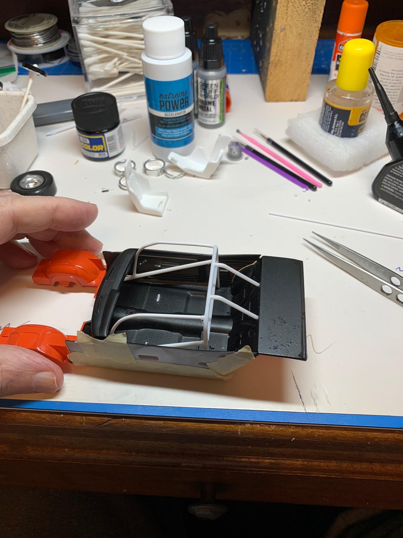

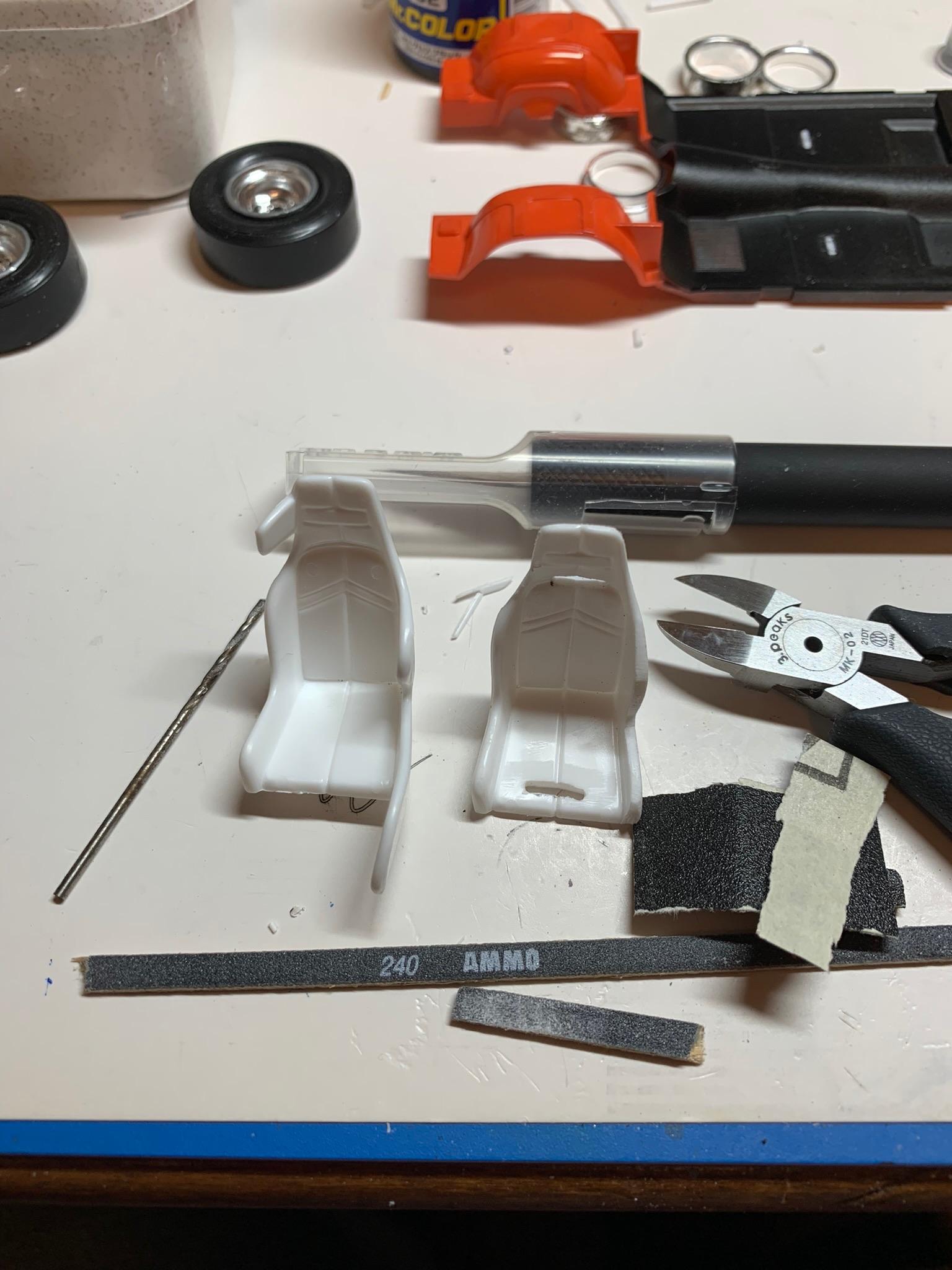

Thanks, Roger.  Some small progress.  Worked on the roll bar that came in the kit, changed the diagonal.  Scrounged up 2 racing seats from NASCAR kits, modified them to more closely resemble Mike’s Kirkey seats.  Cut some forward bars up to fit, held the side panels on with tape.

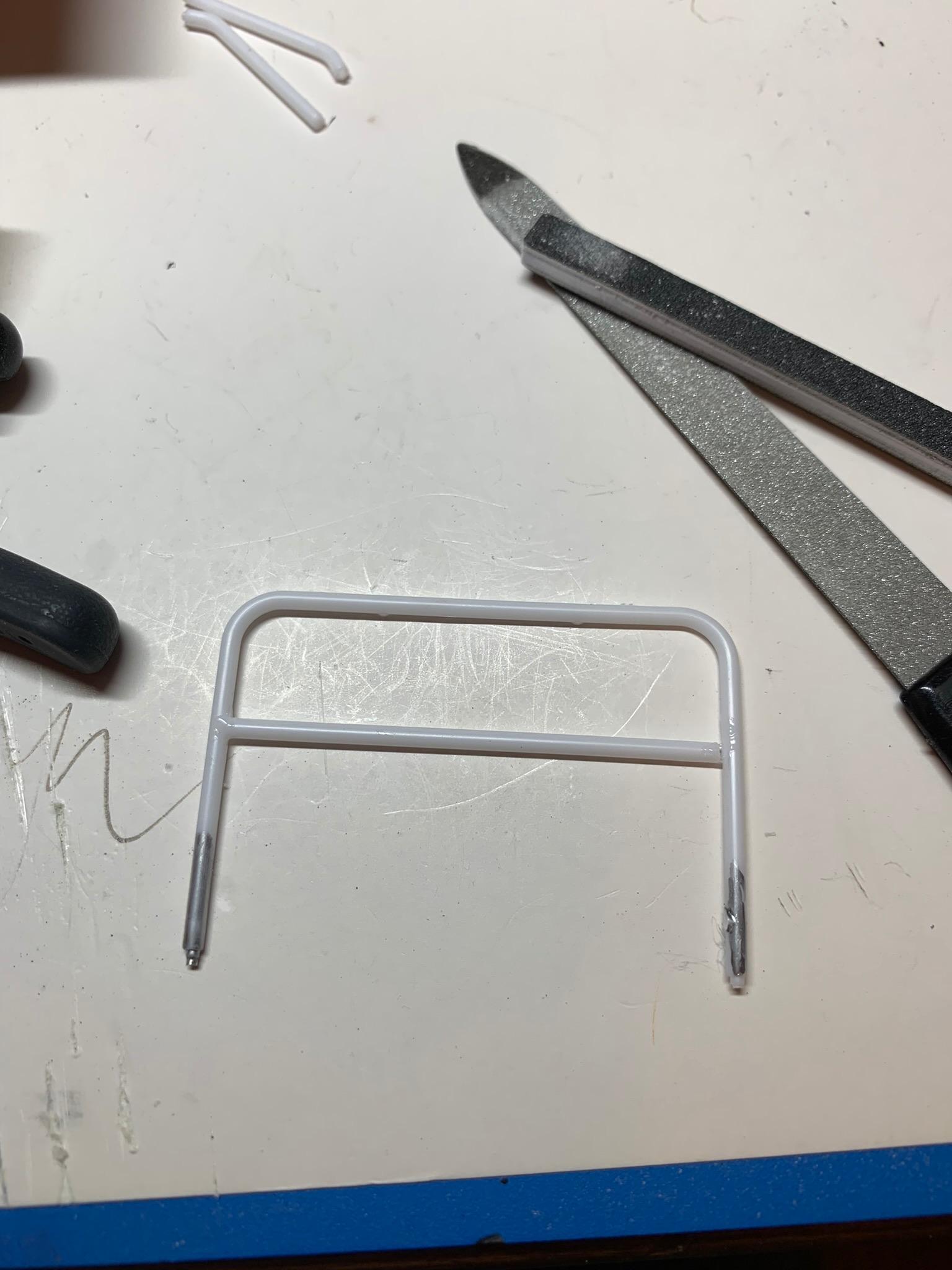

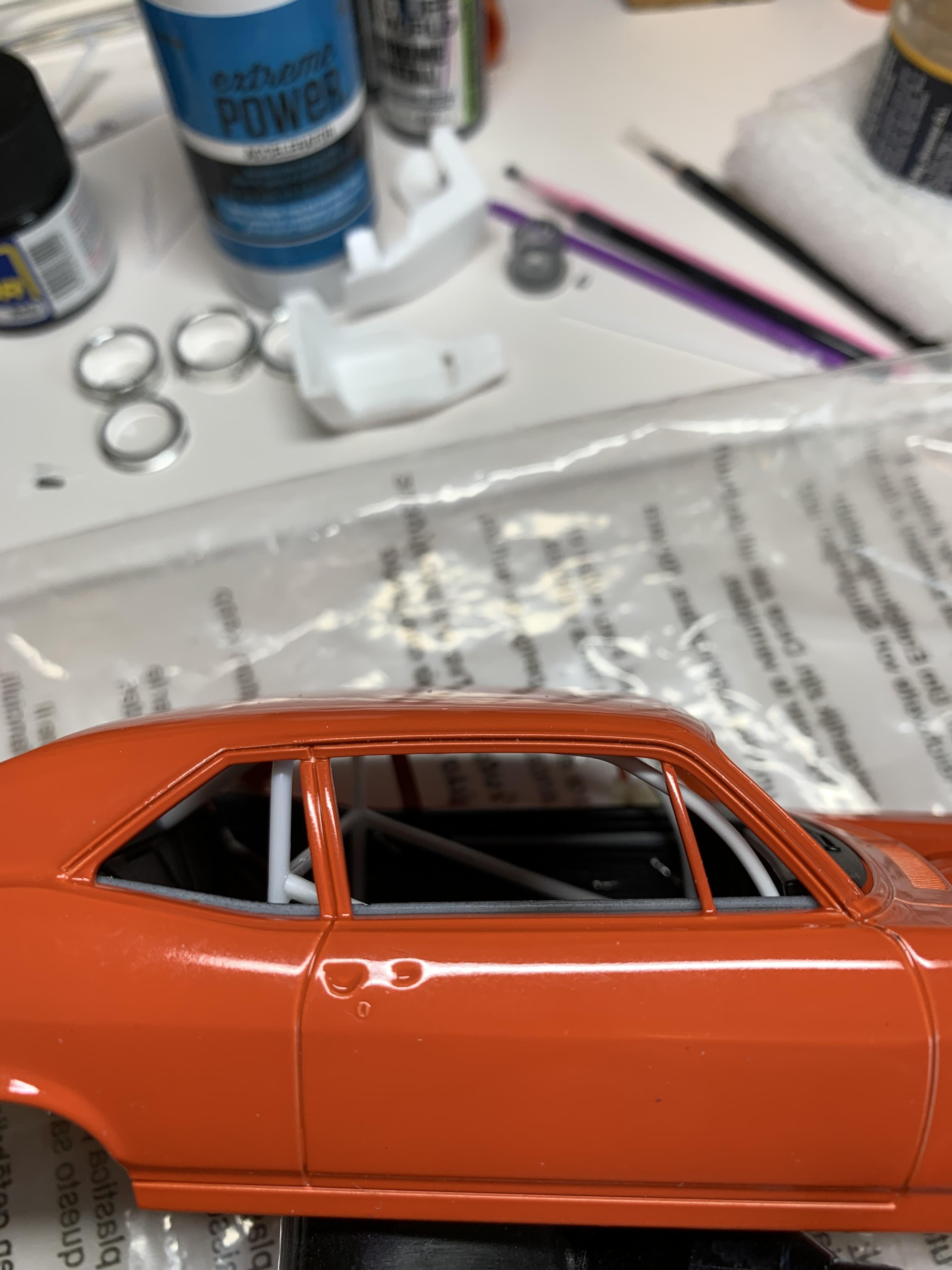

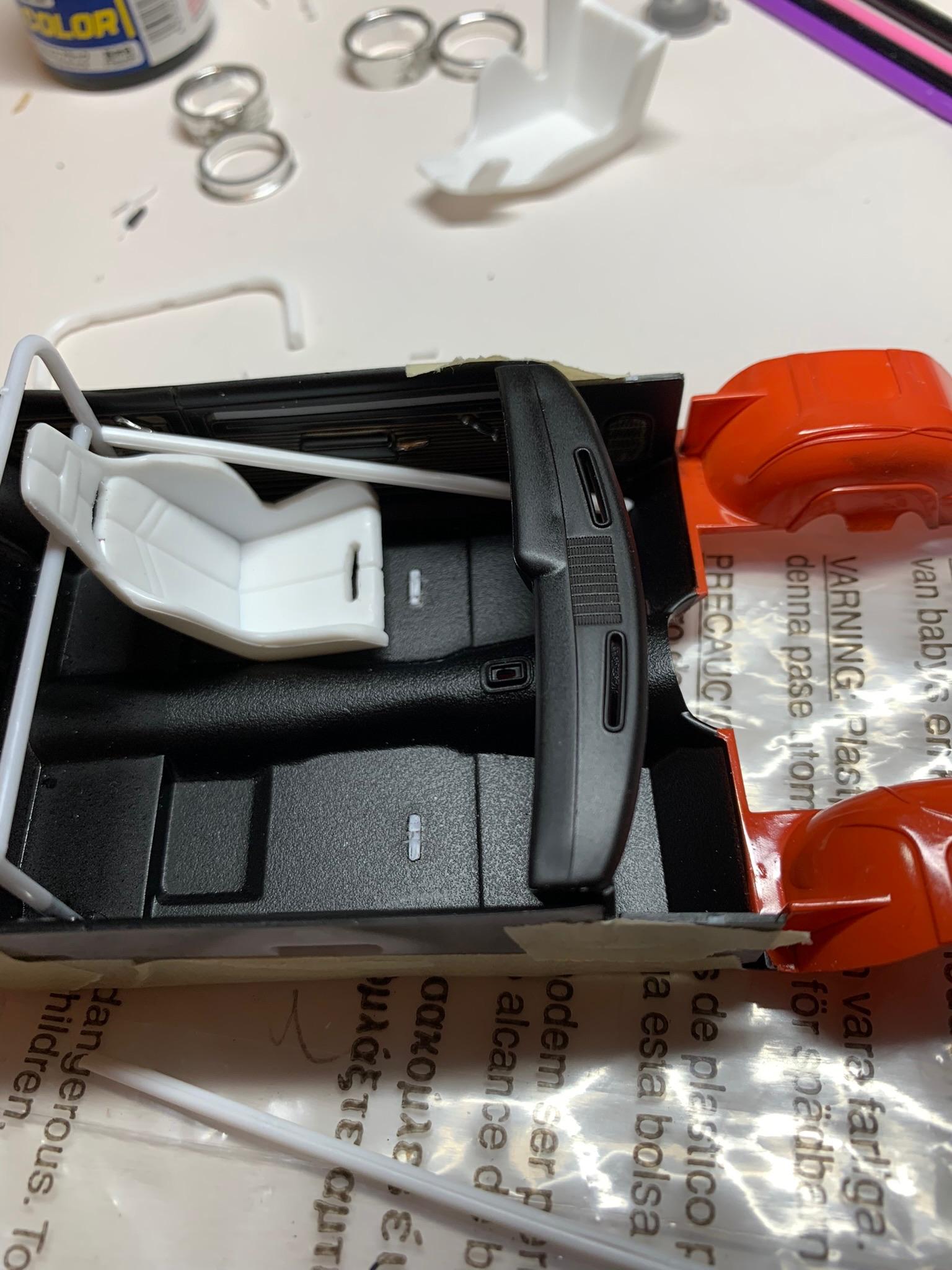

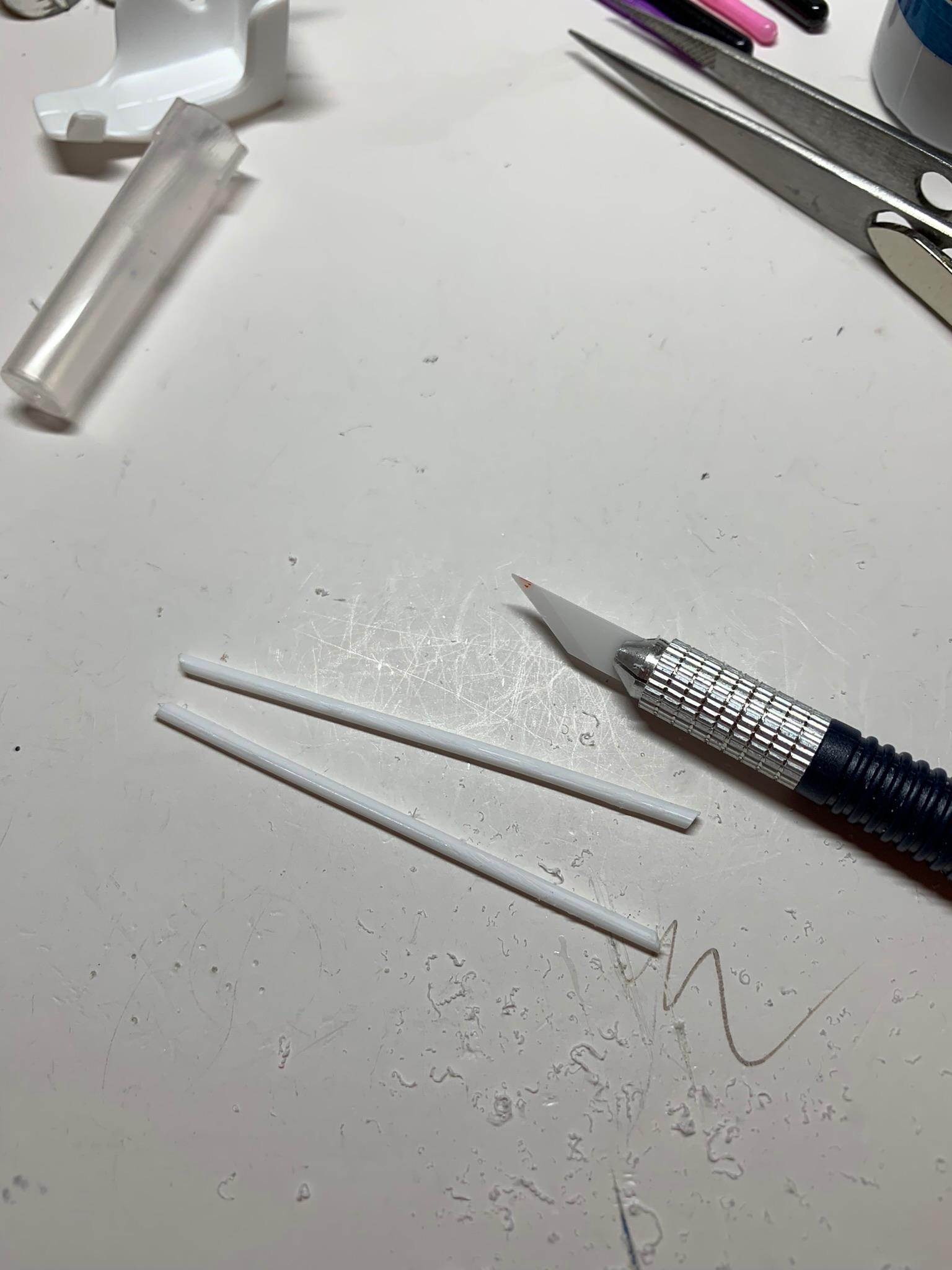

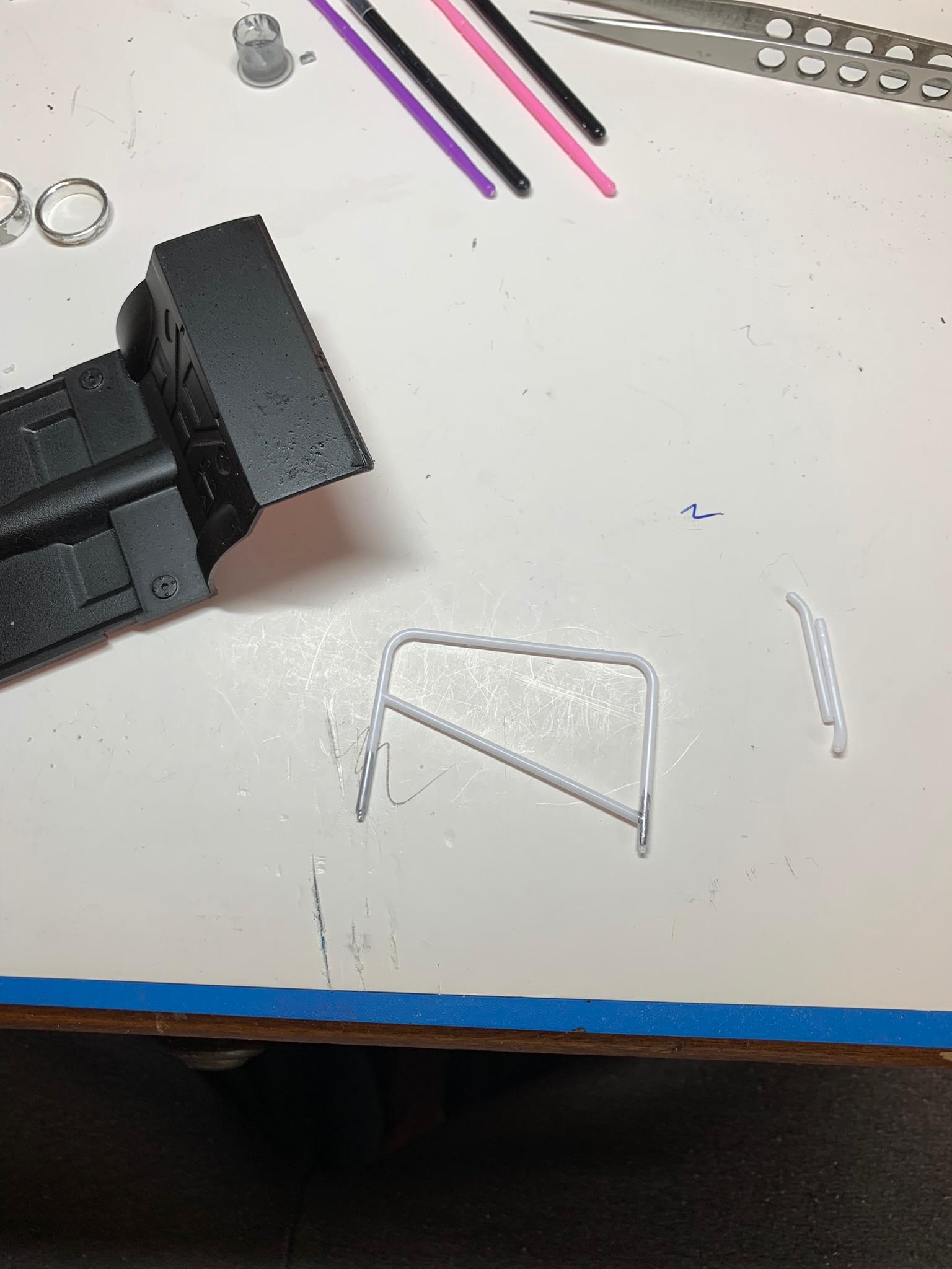

You are too kind, gentlemen, but I thank you.  Some small progress on the roll cage.  One of the joys of modeling is you learn something every time you try a different approach or try to stretch your skills.  This is my first roll cage.  In this case, I learned it would have probably been easier to build the cage from scratch instead of using the bar from the kit, some tubing from a nascar kit, and some 1/16 Evergreen rod.  Anyway, my ceramic bladed knife (much safer, no cuts) helped remove the seam line from the NASCAR tubing.   Side bars are fitted, glued only at the bar.  The top bar was hand bent and glued on with ModelMaster cement (after letting it set a few minutes and get tacky).  I actually liked working with it better than the medium super glue I had used previously on the cage.  Going to let it dry overnight and see how it fits inside the body.  Looks like it might be slanting down hill a bit and have to be adjusted.

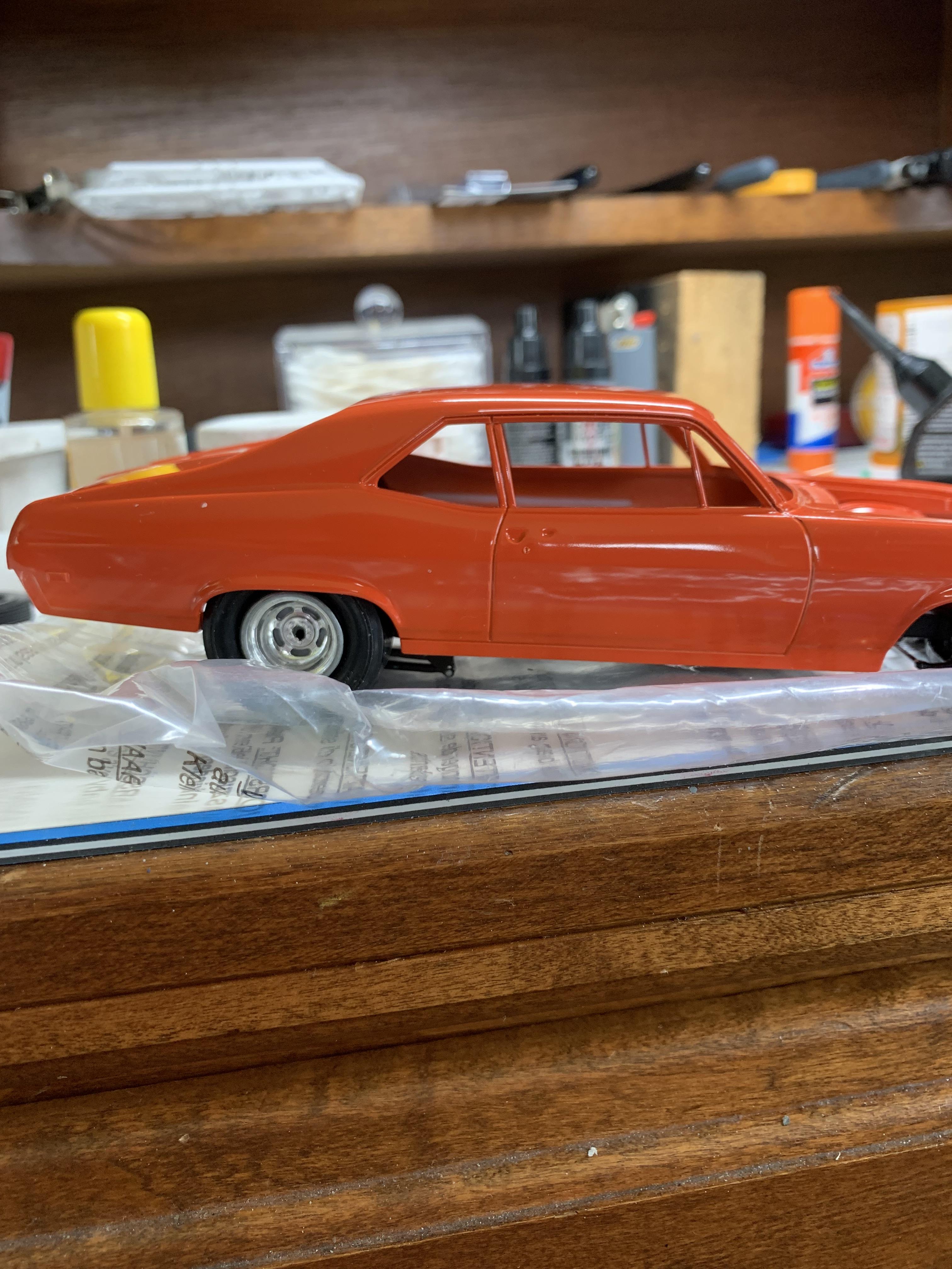

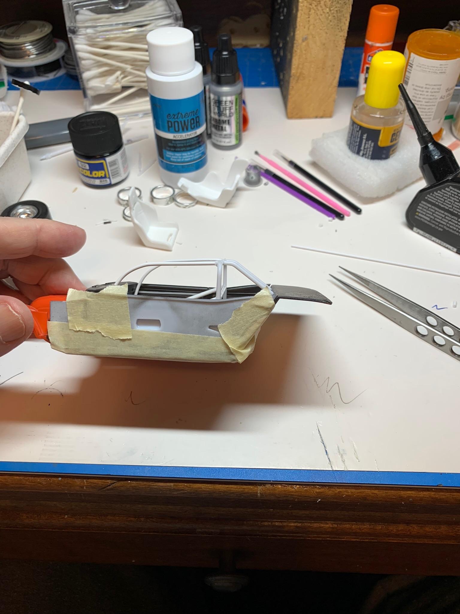

Thanks, Daniel.  Trial fit, without windows, may raise the front bar up some.
