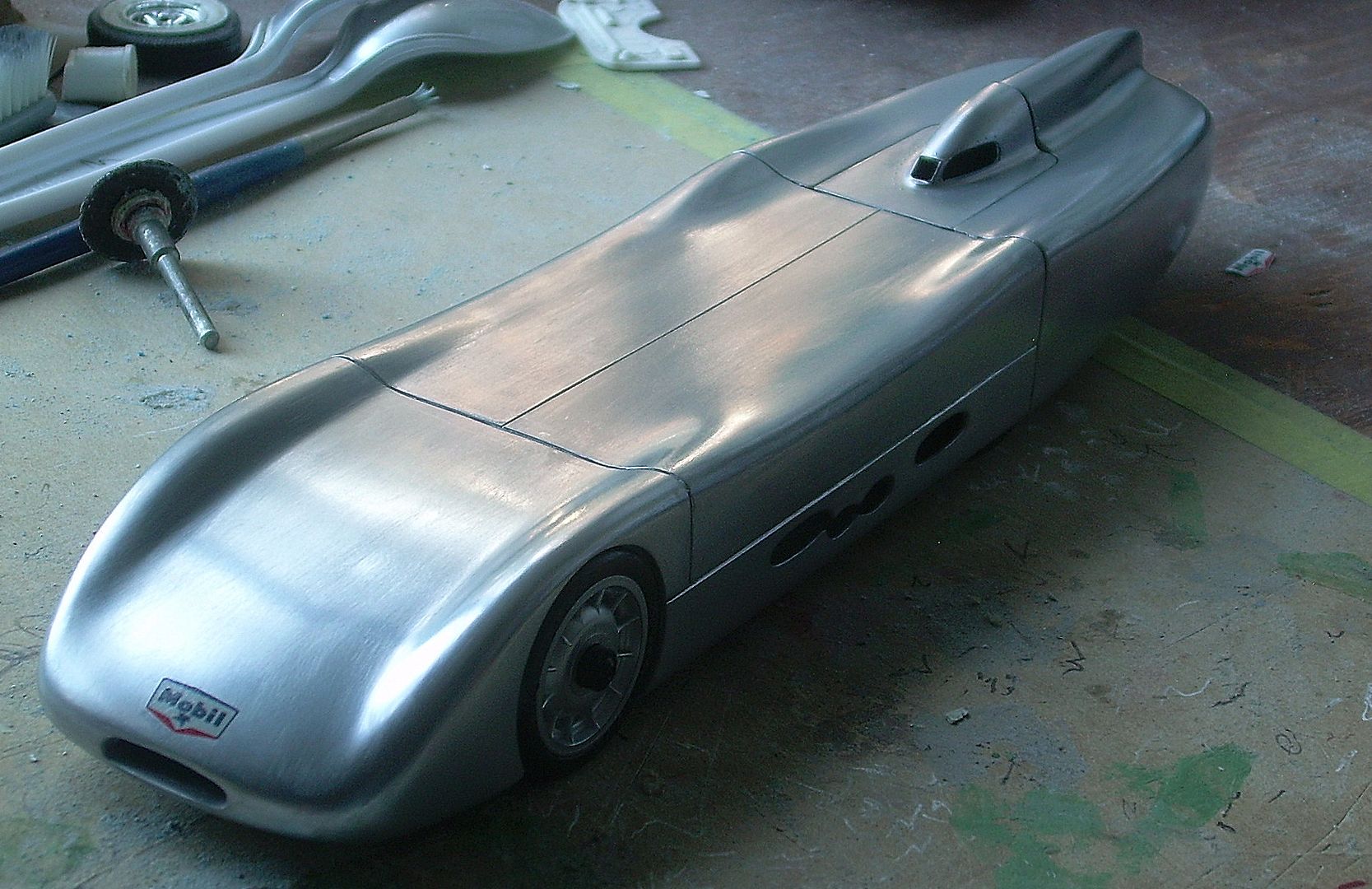

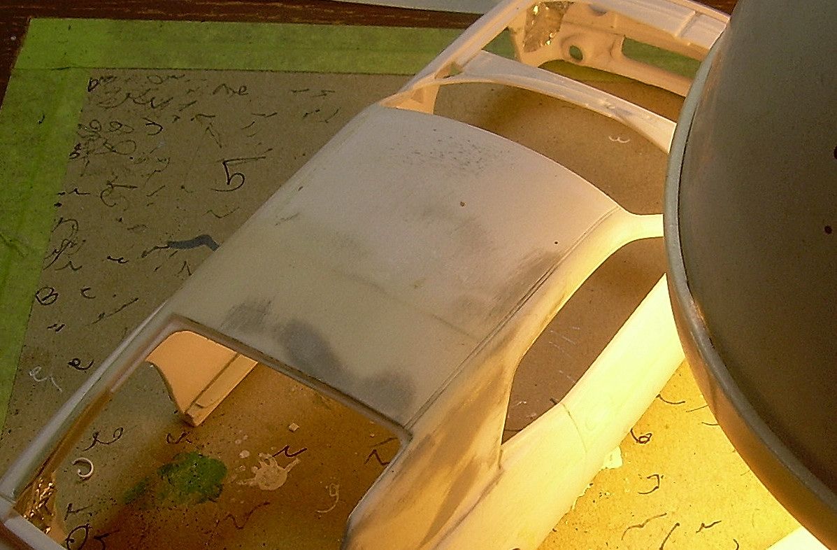

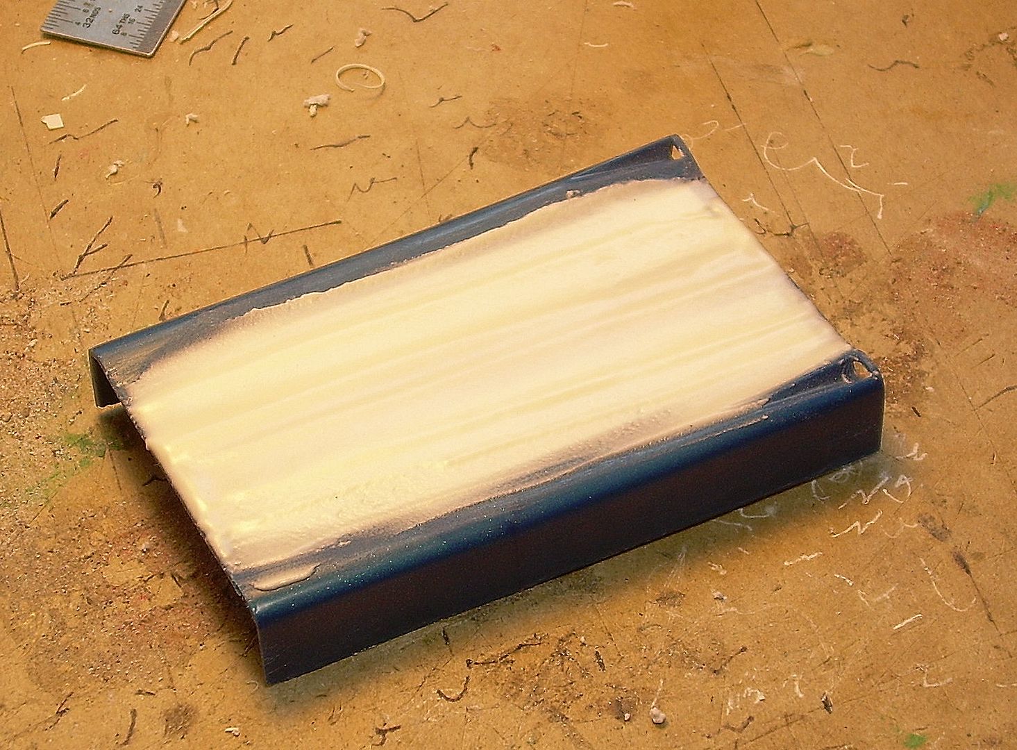

Ace-Garageguy Posted June 26, 2023 Posted June 26, 2023 (edited) Everyone has opinions. I've done considerable testing. If you really want a stable, tough-enough to withstand scribing new lines without flaking off, easy-to-sand filler with no shrinkage and excellent adhesion, I recommend West 105/205 epoxy, thickened with microballoon. It's used as a lightweight filler on sport/experimental aircraft because of its superior performance. EDIT: If you're in a big hurry, forget it. It takes 12 hours to cure to the point it can be sanded and scribed. Below, I've used it over styrene inserts in the engine cover, to backdate the car to the non-supercharged configuration. Finished...and it still looks like this 11 years later. It's also tough enough to accept scribed lines, even very close together...without edge-flaking or breaking up...as shown on the Challenger roof extension below. NO other filler, in my experience, will do this. Edited June 26, 2023 by Ace-Garageguy 2 1
