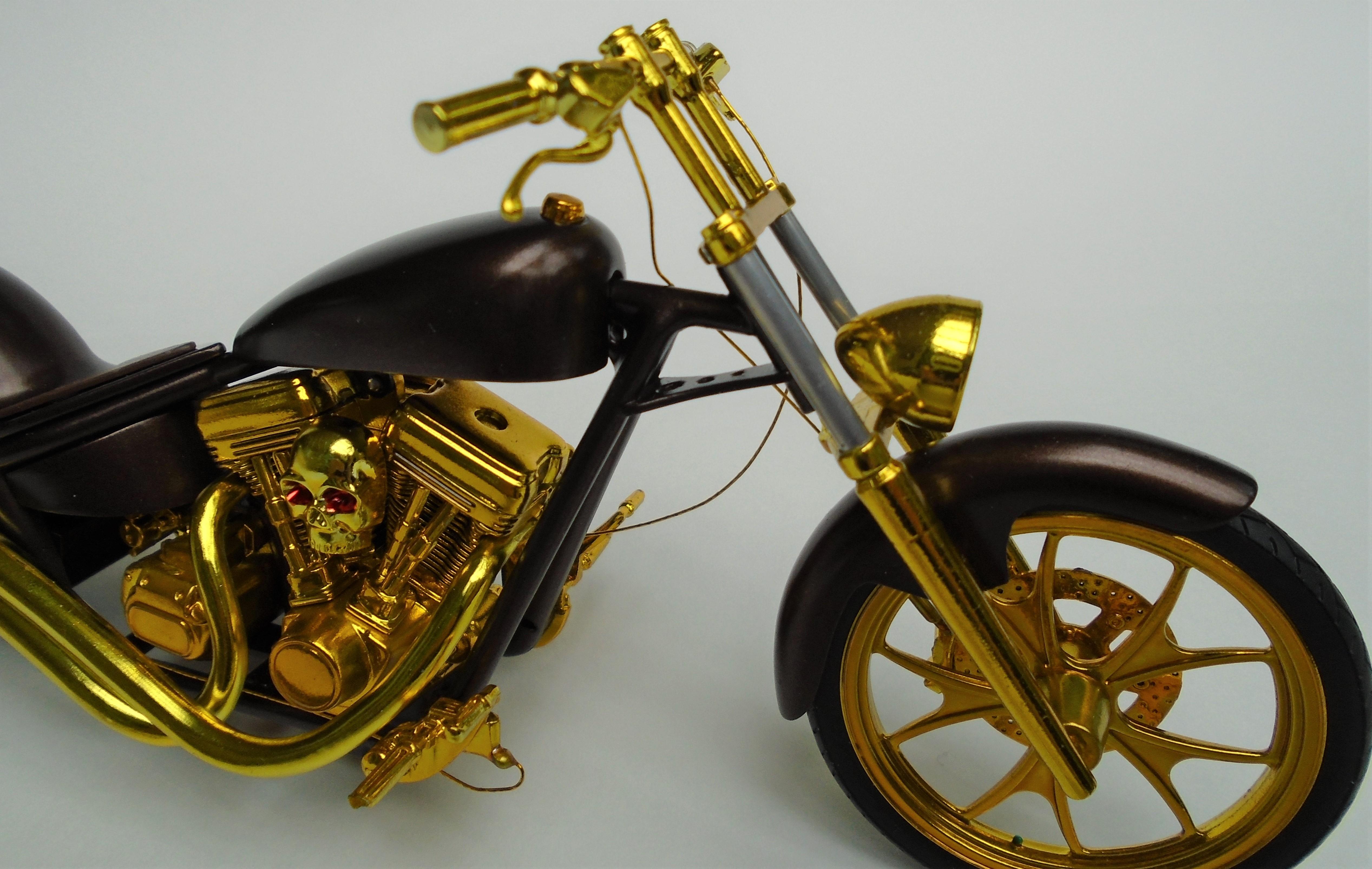

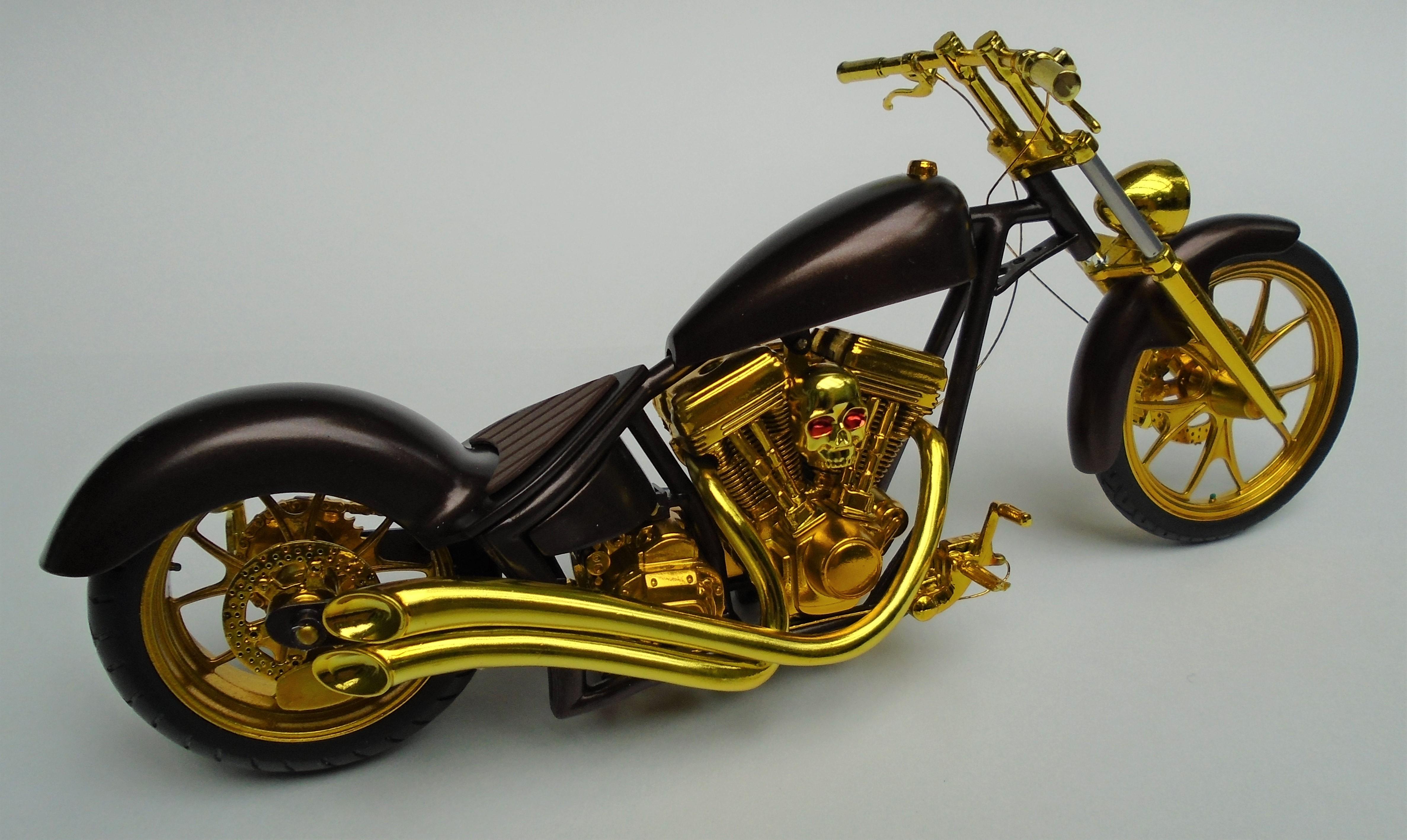

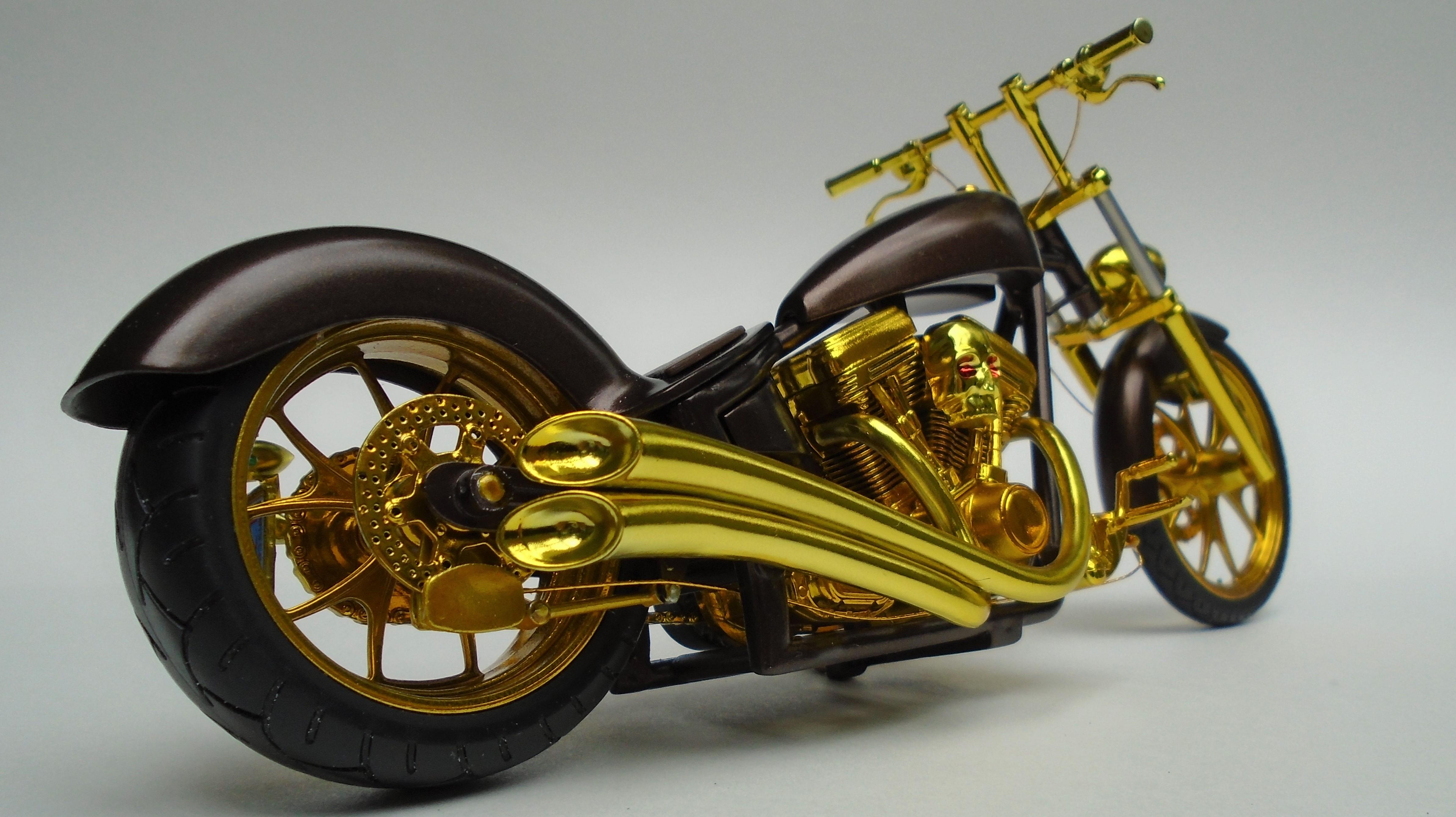

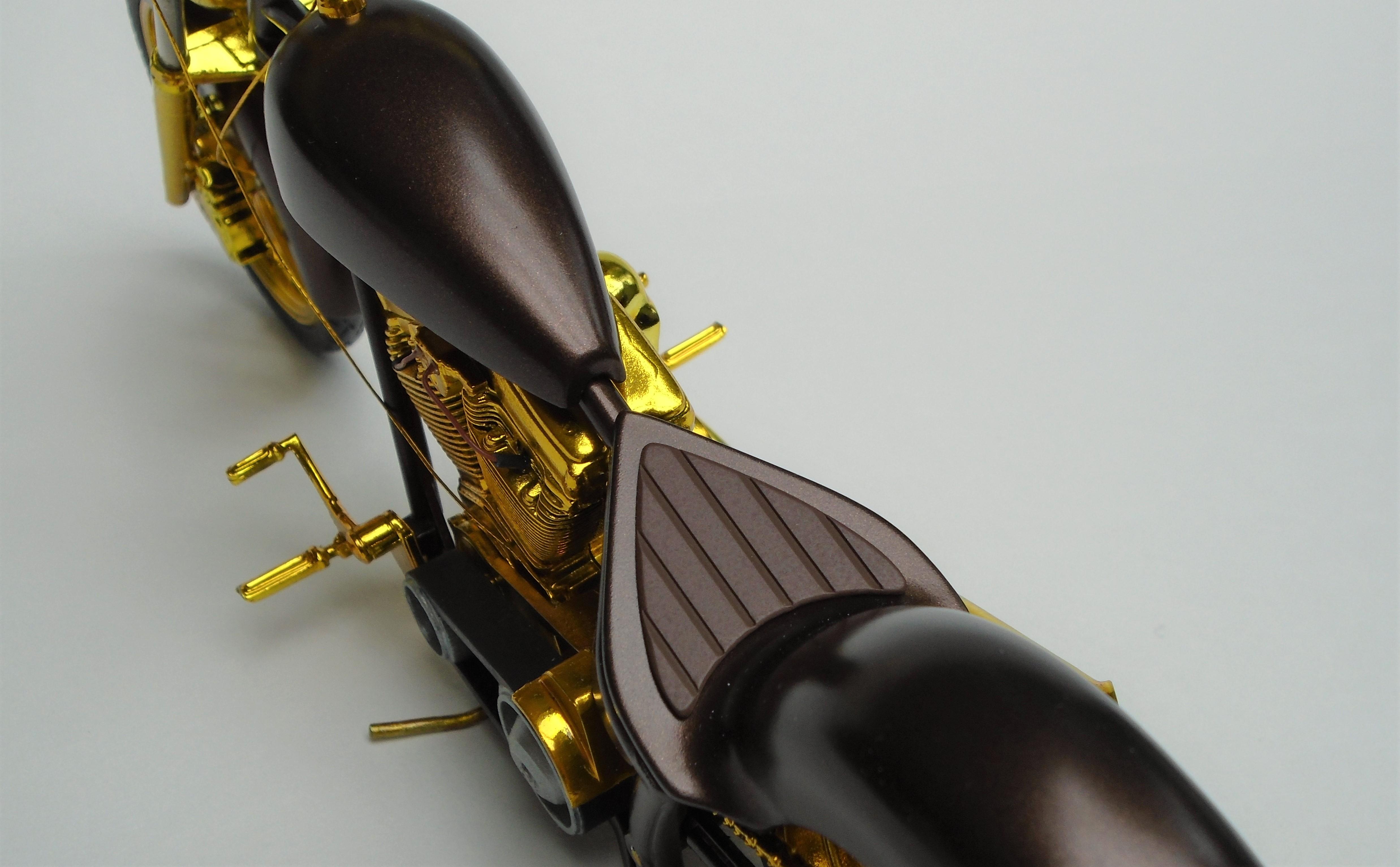

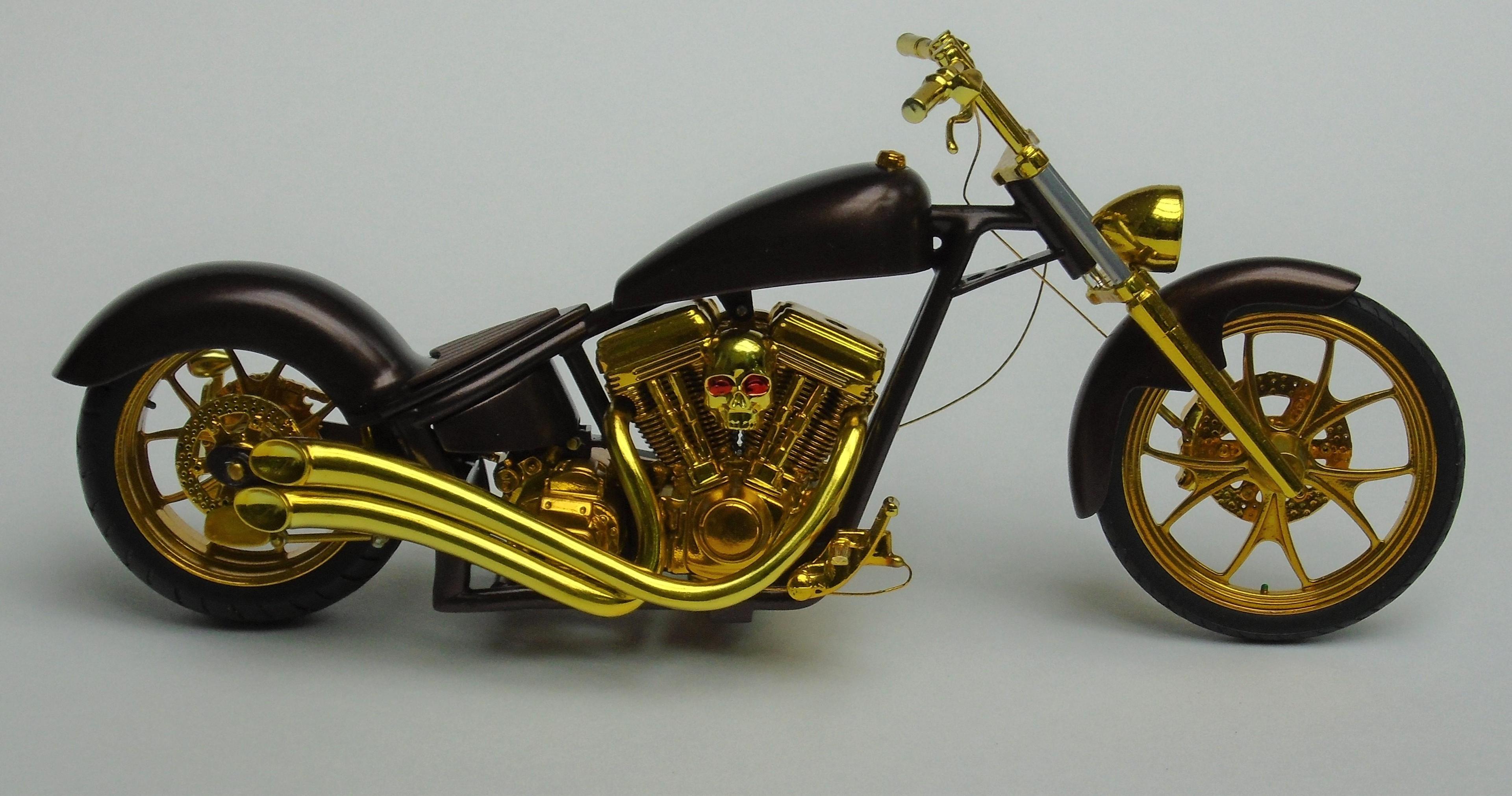

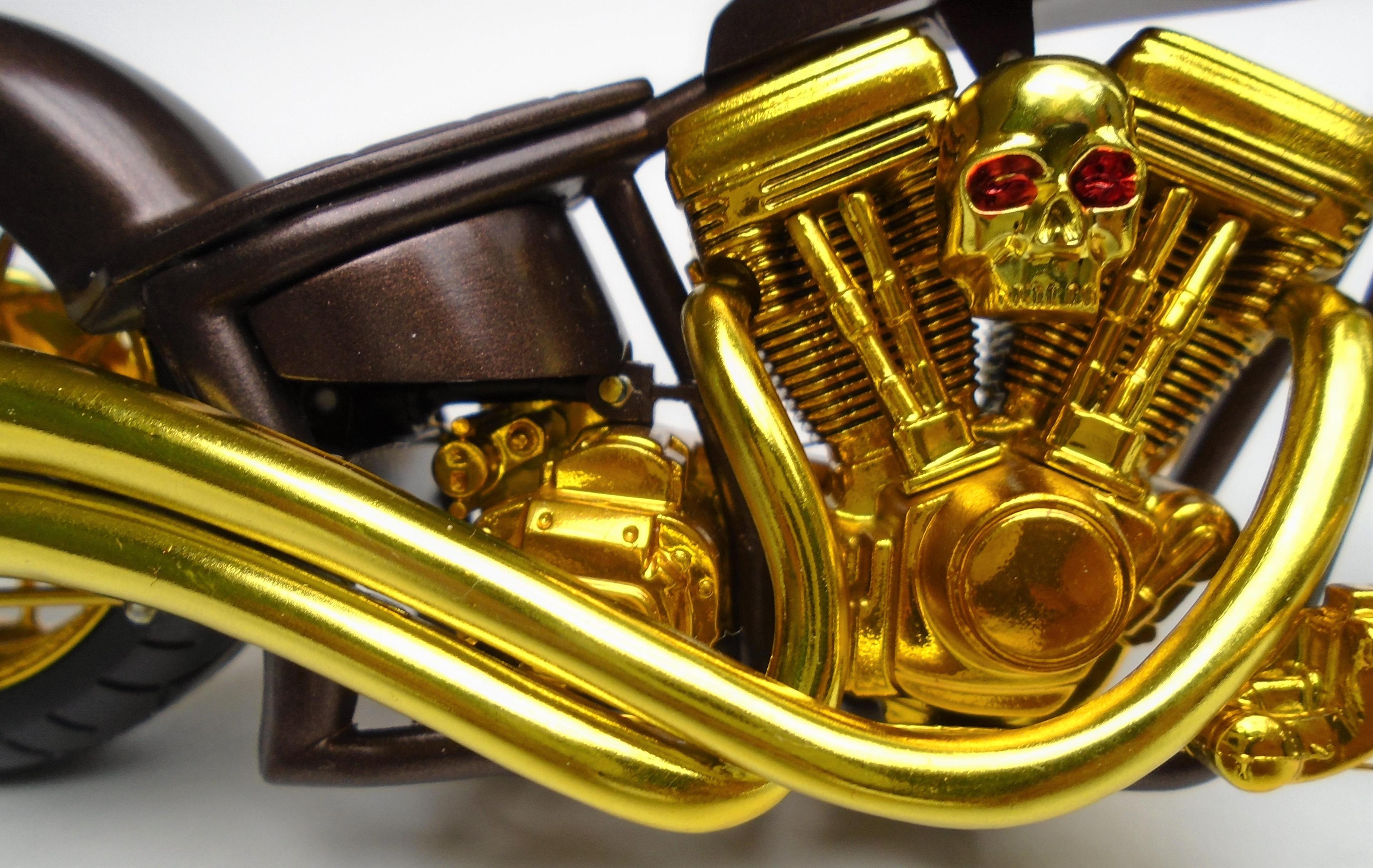

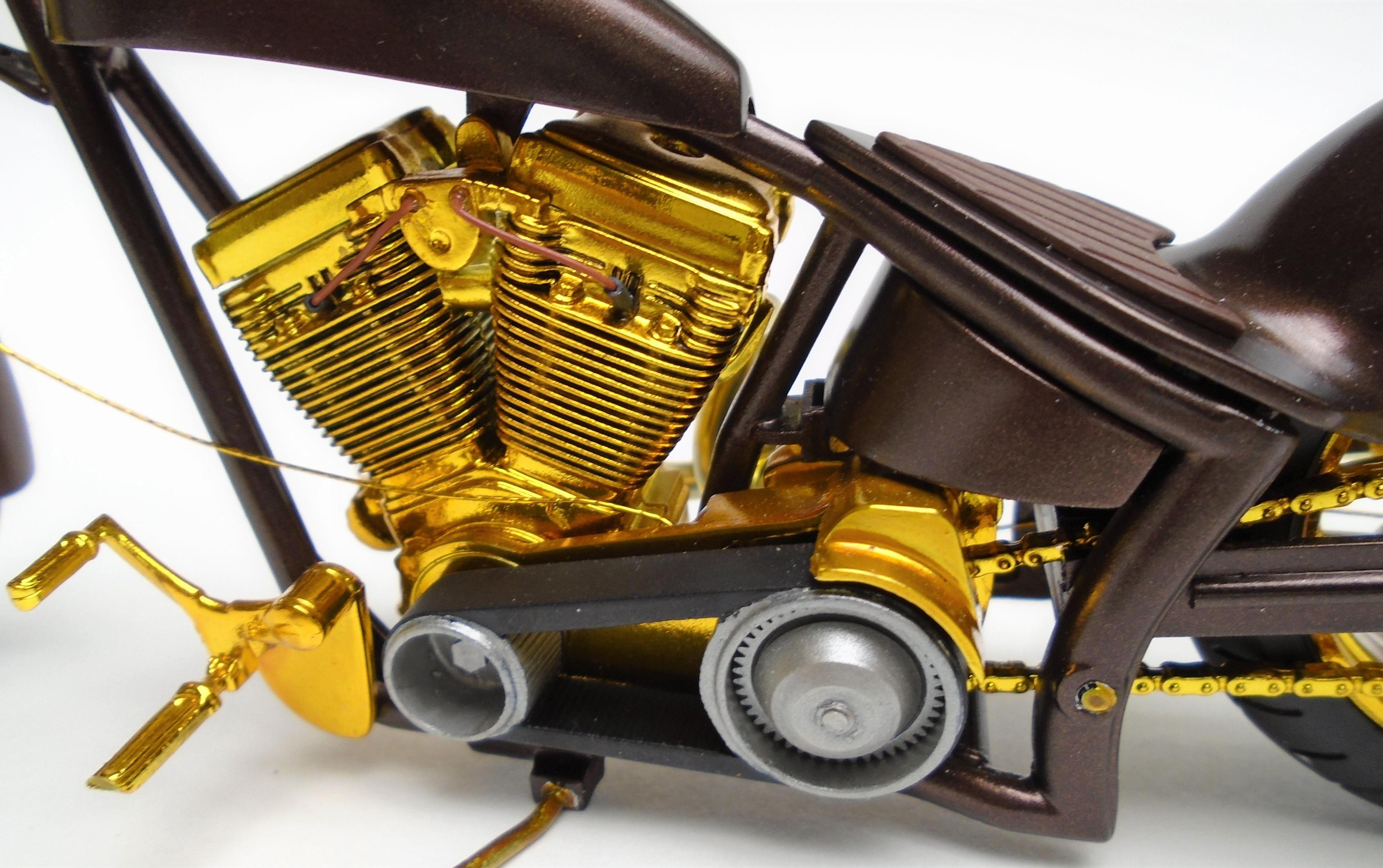

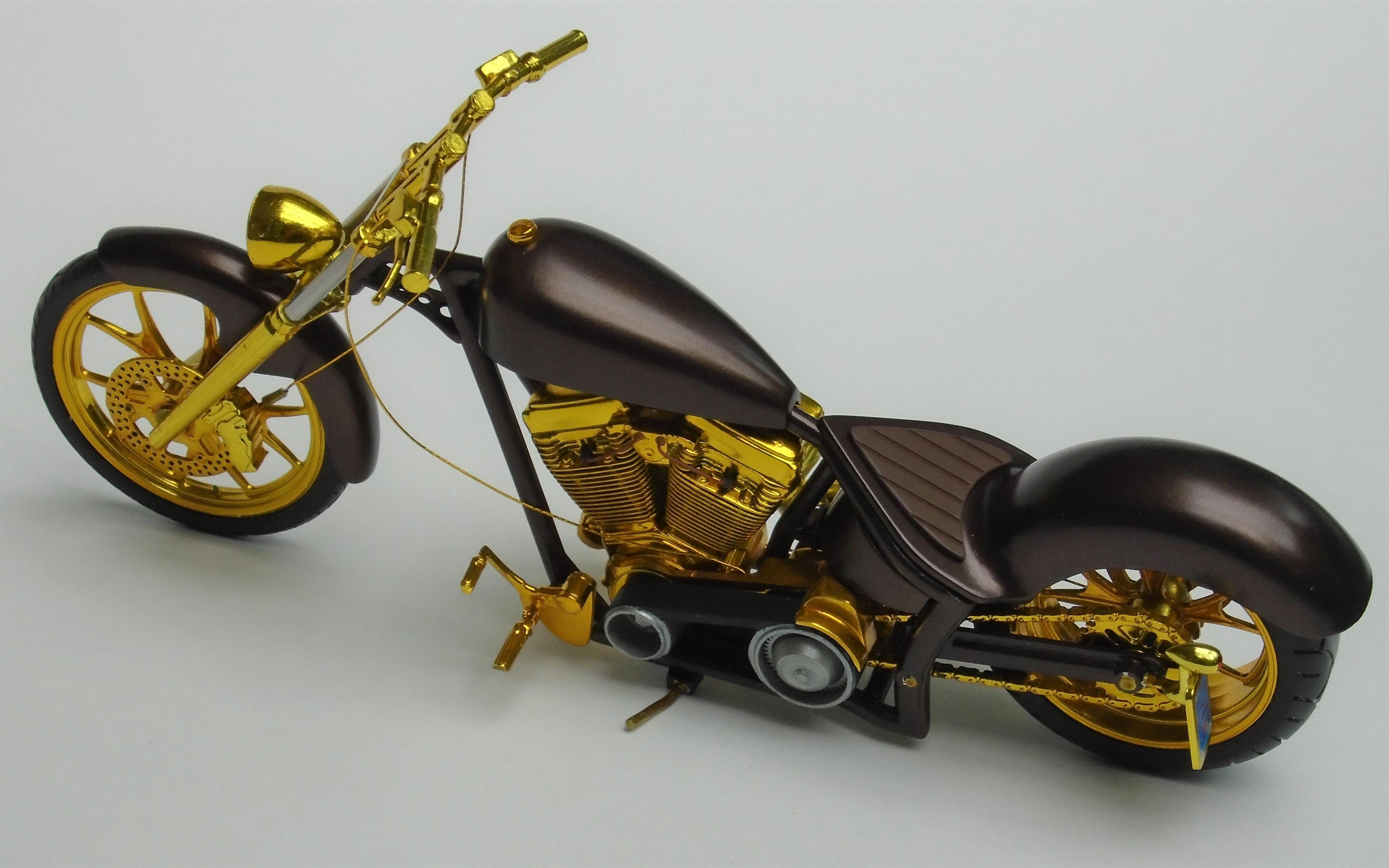

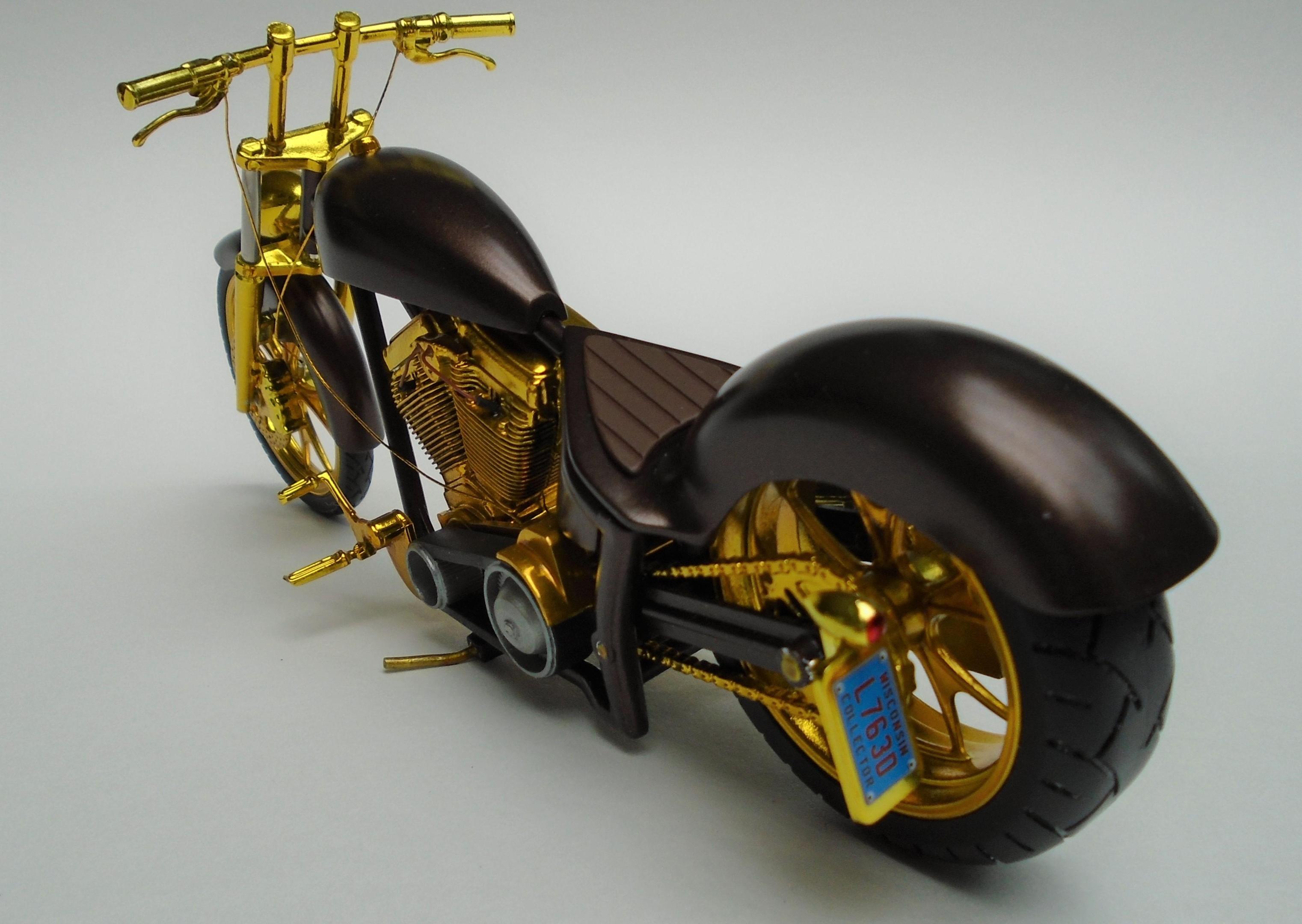

Claude Thibodeau Posted July 24, 2023 Posted July 24, 2023 Hi! Having build and ownewd many custom 1/1 Harleys, I was interested by the Revell series of 1/12 HD bikes. I discovered they were plagued with many ill-fitting components, so, why not go for major mods? But the project was on the slow burner for about 3 years. Oh well... The softail-type frame was converted to a mono-hidden shock swingarm, and the upper tube was bent down and the neck extended to get a lower and longer look. The gas tank, rear fender, oil-tank, primary and fork were modified. The swingard, mono-shock, rear brake caliper, seat, kickstand and clutch were scratchbuilt. I built an Arlen-Ness style narrow springer out of aluminium for it, but decided to keep it for a future, more elaborate project instead. The finish is Model-Master's Burnt Iron lacquer + semi-gloss sealer, and the chrome was "gold plated" with Tamya's clear yellow acrylic. Molotow's chrome on some components. Hours of fun with styrene! 8

peteski Posted August 10, 2023 Posted August 10, 2023 (edited) That is really cool! The "gold" finish using Tamiya clear yellow came out surprisingly well (better than I would have expected). One thing you might consider doing is painting the exhaust tips flat black, so they don't look like they are closed off. Edited August 10, 2023 by peteski

Claude Thibodeau Posted August 16, 2023 Author Posted August 16, 2023 On 8/10/2023 at 6:26 PM, peteski said: That is really cool! The "gold" finish using Tamiya clear yellow came out surprisingly well (better than I would have expected). One thing you might consider doing is painting the exhaust tips flat black, so they don't look like they are closed off. Hi peter! Thank you. I will look at your suggestion, but the shallow molding of the tips make it a bit complicated... CT
peteski Posted August 16, 2023 Posted August 16, 2023 5 hours ago, Claude Thibodeau said: Hi peter! Thank you. I will look at your suggestion, but the shallow molding of the tips make it a bit complicated... CT I wonder if you could take a Q-Tip or similar cotton swab, dip the end in flat black paint, then dab it into the depression in the end of the exhaust pipe? That way you should have a neat round black spot of paint. But before you try it on the exhaust, maybe practice on something unimportant to see how well this trick works for you.

Claude Thibodeau Posted August 21, 2023 Author Posted August 21, 2023 On 8/16/2023 at 2:42 PM, peteski said: I wonder if you could take a Q-Tip or similar cotton swab, dip the end in flat black paint, then dab it into the depression in the end of the exhaust pipe? That way you should have a neat round black spot of paint. But before you try it on the exhaust, maybe practice on something unimportant to see how well this trick works for you. Hi Peter! I will experiment. thanks for the suggestion. CT 1
