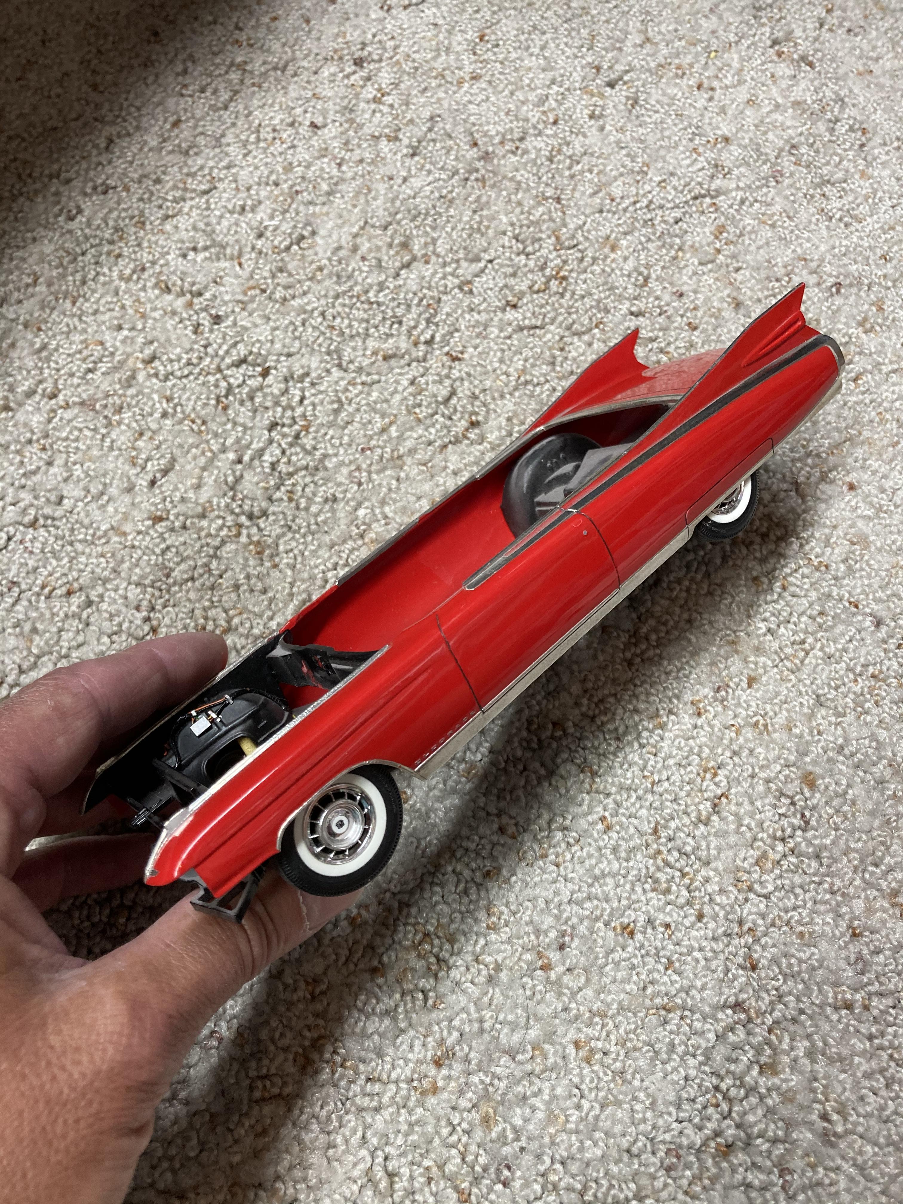

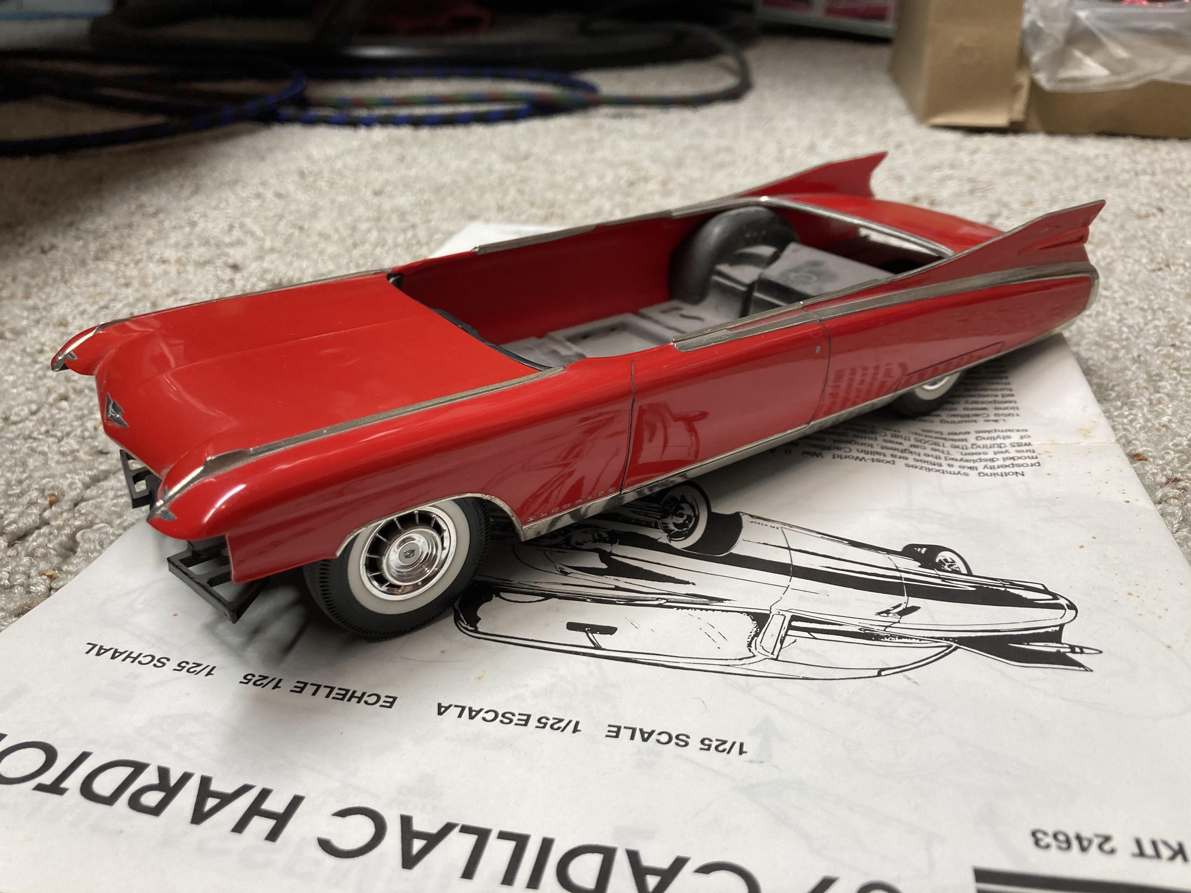

Milo Posted August 17, 2023 Share Posted August 17, 2023 It is not a mirror Does anyone know why this is happening? I'm gonna blame it on my airbrush cuz it's pretty bad. I'm using tamiya acrylic thinner and tamiya acrylic gloss clear 1:1 it's on a testors enamel paint job. Video_20230816_204715_949.mp4 Quote Link to comment Share on other sites More sharing options...
stitchdup Posted August 17, 2023 Share Posted August 17, 2023 your paints arent compatible with each other Quote Link to comment Share on other sites More sharing options...

espo Posted August 17, 2023 Share Posted August 17, 2023 Hard to tell without seeing it in person, but in the picture, it looks as if there may be some sort of contaminant under the paint. Was the body cleaned before painting? Were there any other projects that you are working on also on the work bench at the same time? Sometimes moving back and forth between builds you can bring contaminants from sanding or even a slight over spray on to another project and if not cleaned well before painting sometimes you can get a finish that will look like this. My first thought would be a resin body or parts in the work area that may have been handled and then you pick up this body to paint. I will not even sand or cut on a resin part in my build area for this reason since it takes so little to do something like this. Quote Link to comment Share on other sites More sharing options...

stitchdup Posted August 17, 2023 Share Posted August 17, 2023 6 minutes ago, Milo said: Everyone said that this would work. Also everyone says that acrylic covers everything its the other way around, you can use some enamels over acrylic but but acrylic doesn't like going over enamels. theres something in acrylics that causes the enamel primers to soften again and restart the gassing process but it doesn't happen the other way around. maybe its just more porous than acrylics and soaks up some of the thinners. The tamiya paints (and some craft hobby paints) just confuse things by having acrylic enamel written on the jars. You can use duplicolour primers with the tamiya paints and so far i've found it to work for the majority of my paints, both acrylic and enamels 2 Quote Link to comment Share on other sites More sharing options...

jaymcminn Posted August 17, 2023 Share Posted August 17, 2023 When did you apply the base coat? Enamel can take weeks to gas out whether or not it "feels" dry and your acrylic top coat will react if it's being sprayed over "wet" enamel. Really, the best suggestion has been made several times in responses to your threads, which is to buy a pack of plastic spoons and practice until you get fairly consistent results. Learning how to airbrush is a lot less painful when you're ruining spoons instead of kits! 2 Quote Link to comment Share on other sites More sharing options...

Dpate Posted August 17, 2023 Share Posted August 17, 2023 Man from what I seen in the video based off the hood, and some parts on the body you got more issues to worry about than a clear coat. Looks to me the enamel didn’t cure, and the clear with the thinner dissolved some sections. If you do not have a dehydrator? You’re gonna have to be patient, and let the testors enamel dry properly for a good while. Really depends on what you thinned the enamel with, and without an added hardener it’s gonna take a long time. If I were you I’d take the time to practice, read up, and be patient or you’re gonna have a miserable experience. You also don’t have to have everything the same brand. There’s nothing wrong with doing that, but mixing products work just fine long as you know what you’re doing. You could thin that testors enamel with Mr hobby leveling thinner, and it will work every time. That’s just an example of a different product used with a different product. 1 Quote Link to comment Share on other sites More sharing options...

Muncie Posted August 18, 2023 Share Posted August 18, 2023 (edited) Old School enamel, which I believe is what Testor's enamel is, dries by evaporation of the thinner as the first stage and oxidation of the binder in the second stage (reference 1976 Ditzler manual). It may take 6 months or longer for an enamel to completely dry. If the enamel is not completely cured, the thinner in lacquer thinners are hot enough to lift the enamel color coat. That looks like what you have here. That's old school but it applies to the paints Testor's enamel color and Tamiya lacquer clear that you are using. There is a lot of newer technology in most of the available paints and those need a little testing to ensure compatibility. There is a learning curve here., yeah, i did this... we've all had some experiences... Edited August 18, 2023 by Muncie Quote Link to comment Share on other sites More sharing options...
