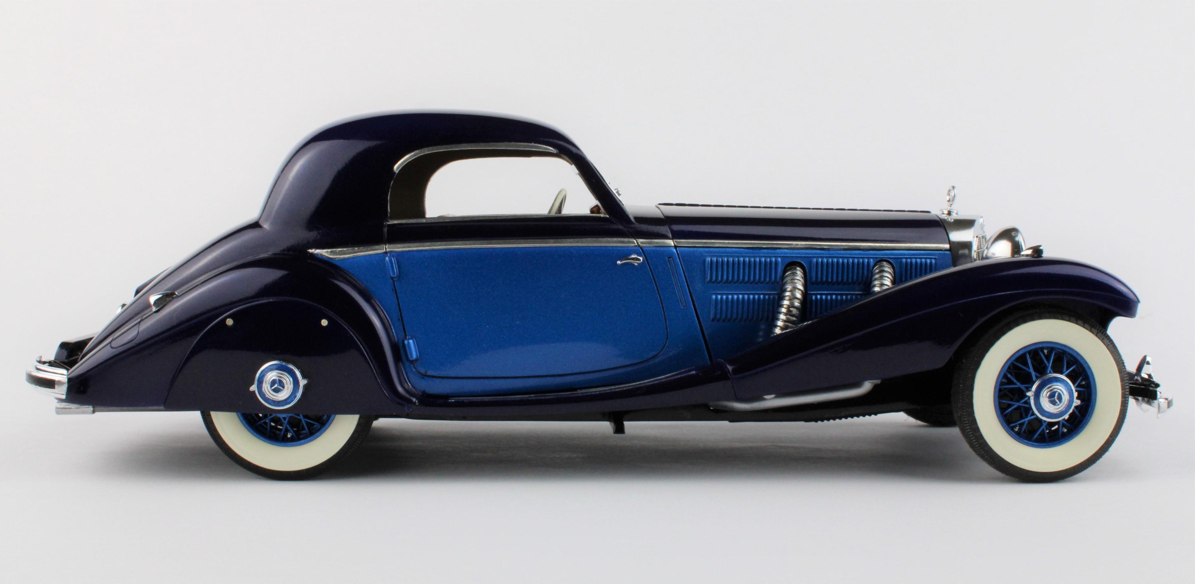

jaymcminn Posted October 15, 2023 Share Posted October 15, 2023 Molotow airbrushes very well without thinning. It can be handled lightly after several days drying time. The results are excellent. The radiator shell, headlamps and exhausts on the Mercedes below as well as the bumpers on the Ferrari were airbrushed Molotow. Molotow does have its limits... it's not as durable as kit chrome and doesn't like to be overcoated or handled much. On the plus side it doesn't require any special prep other than a perfectly smooth surface. 2 Quote Link to comment Share on other sites More sharing options...

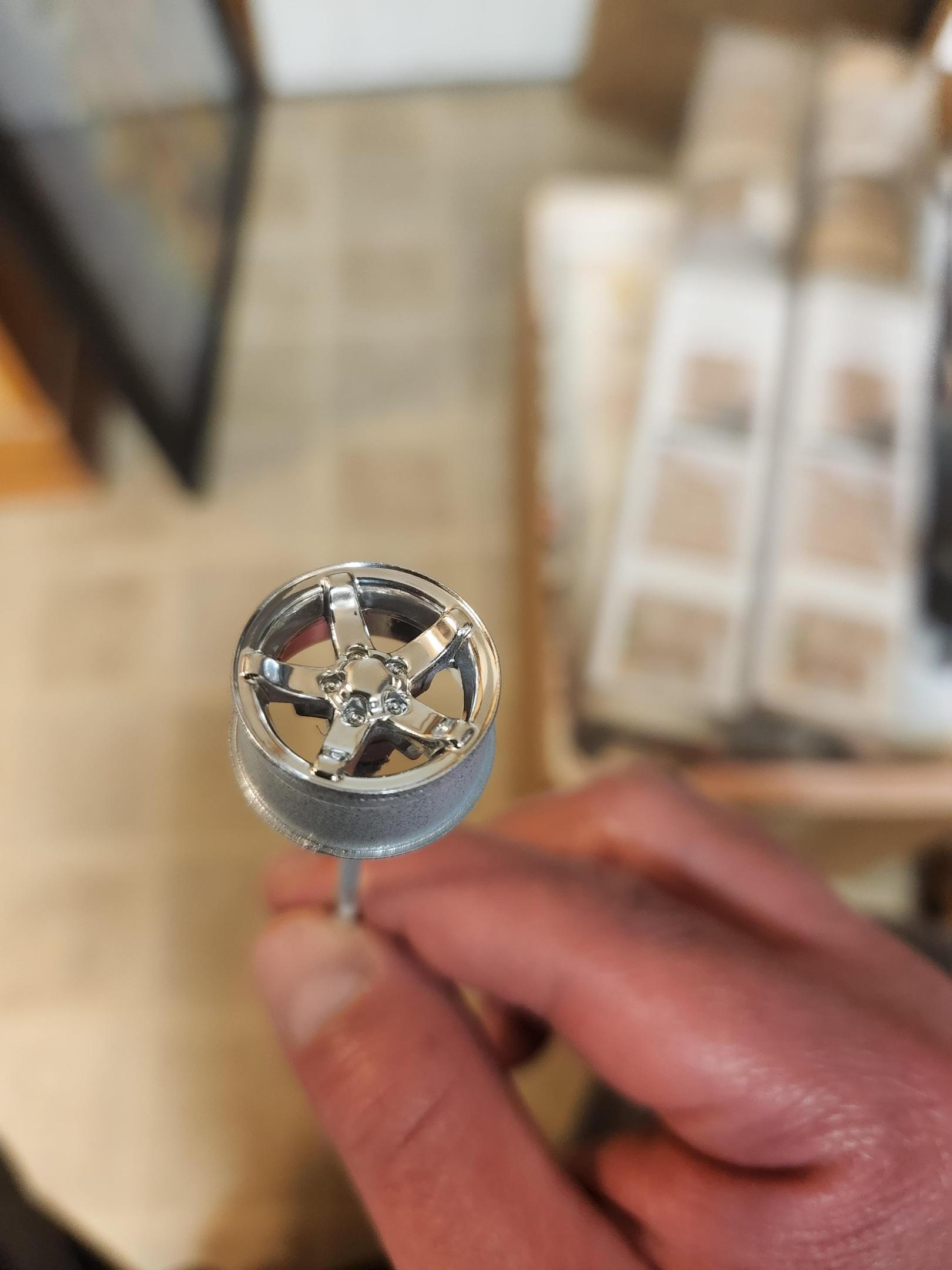

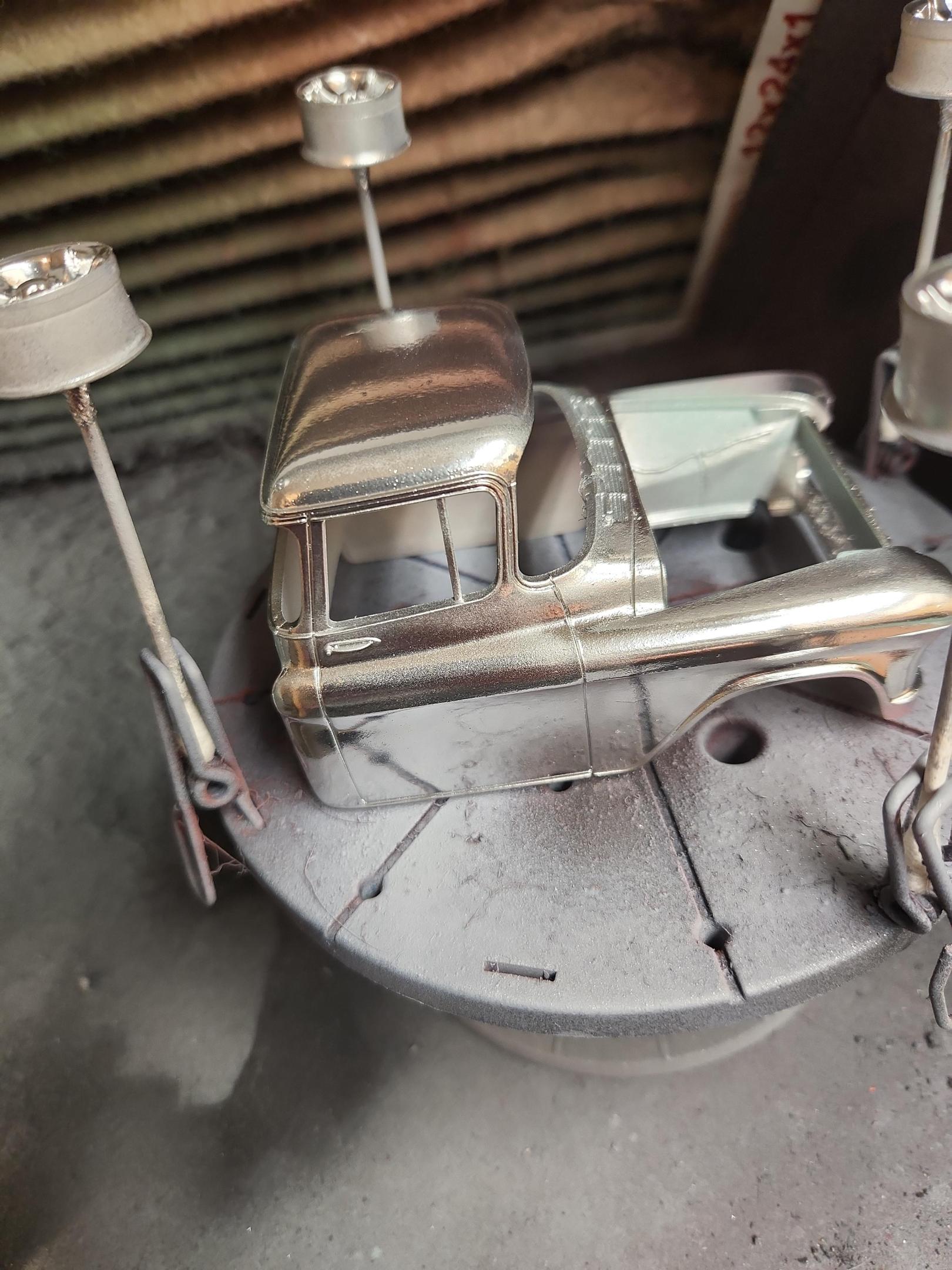

hgbben Posted October 15, 2023 Share Posted October 15, 2023 43 minutes ago, NOBLNG said: So you don’t need a primer or black base? No. Just shoot it straight, I shoot at 24psi and only needs a moderate 1st coat as it levels quite well. All in the prep as with everything..the wheel was primered and the test cab was just laying around no prep on that. 1 Quote Link to comment Share on other sites More sharing options...
Roadrunner Posted October 16, 2023 Author Share Posted October 16, 2023 That wheel looks absolutely fabulous. Thanks for posting it. Quote Link to comment Share on other sites More sharing options...

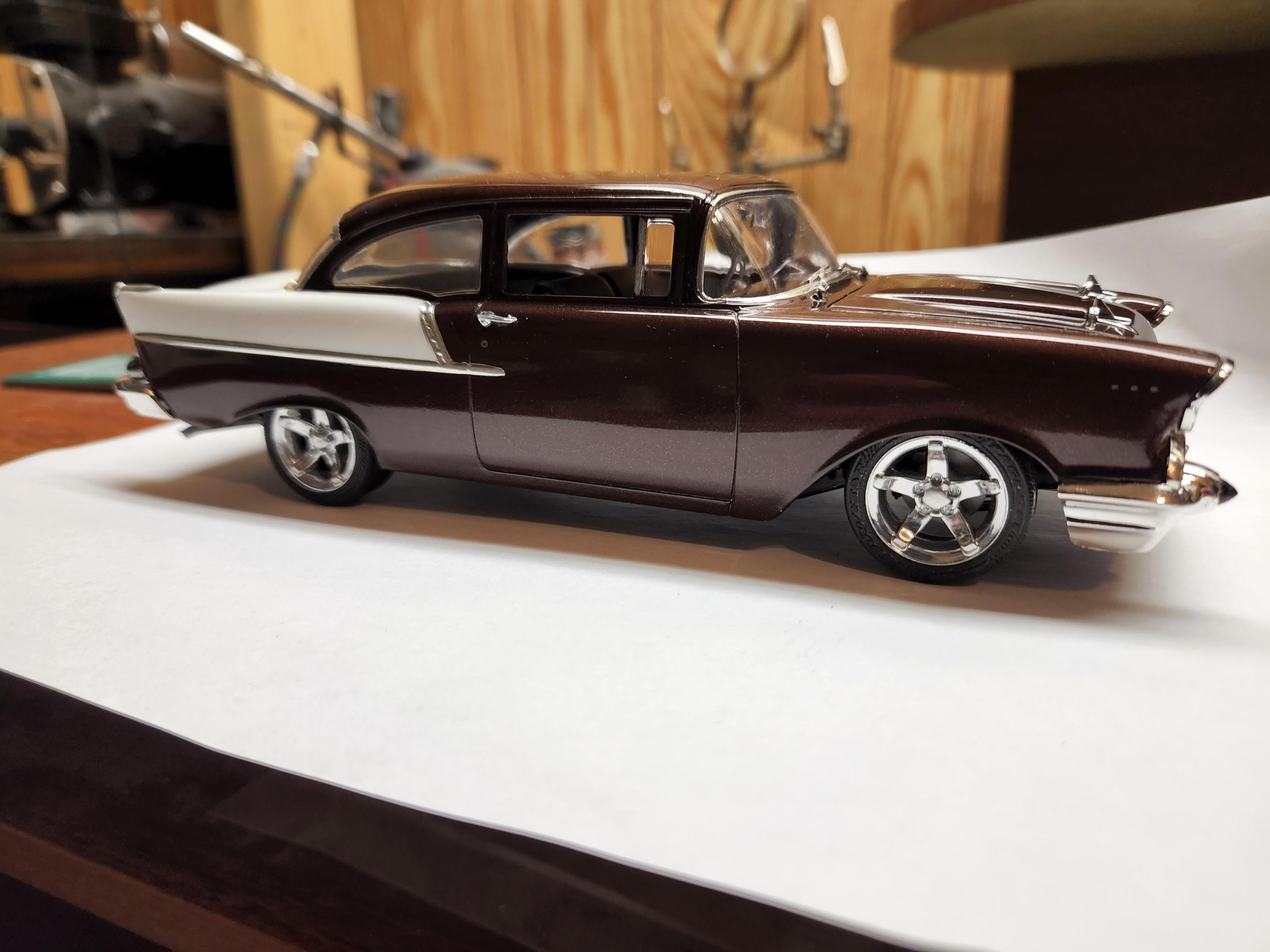

hgbben Posted October 16, 2023 Share Posted October 16, 2023 12 hours ago, Roadrunner said: That wheel looks absolutely fabulous. Thanks for posting it. Here it is on the car that it was used on. 1 Quote Link to comment Share on other sites More sharing options...

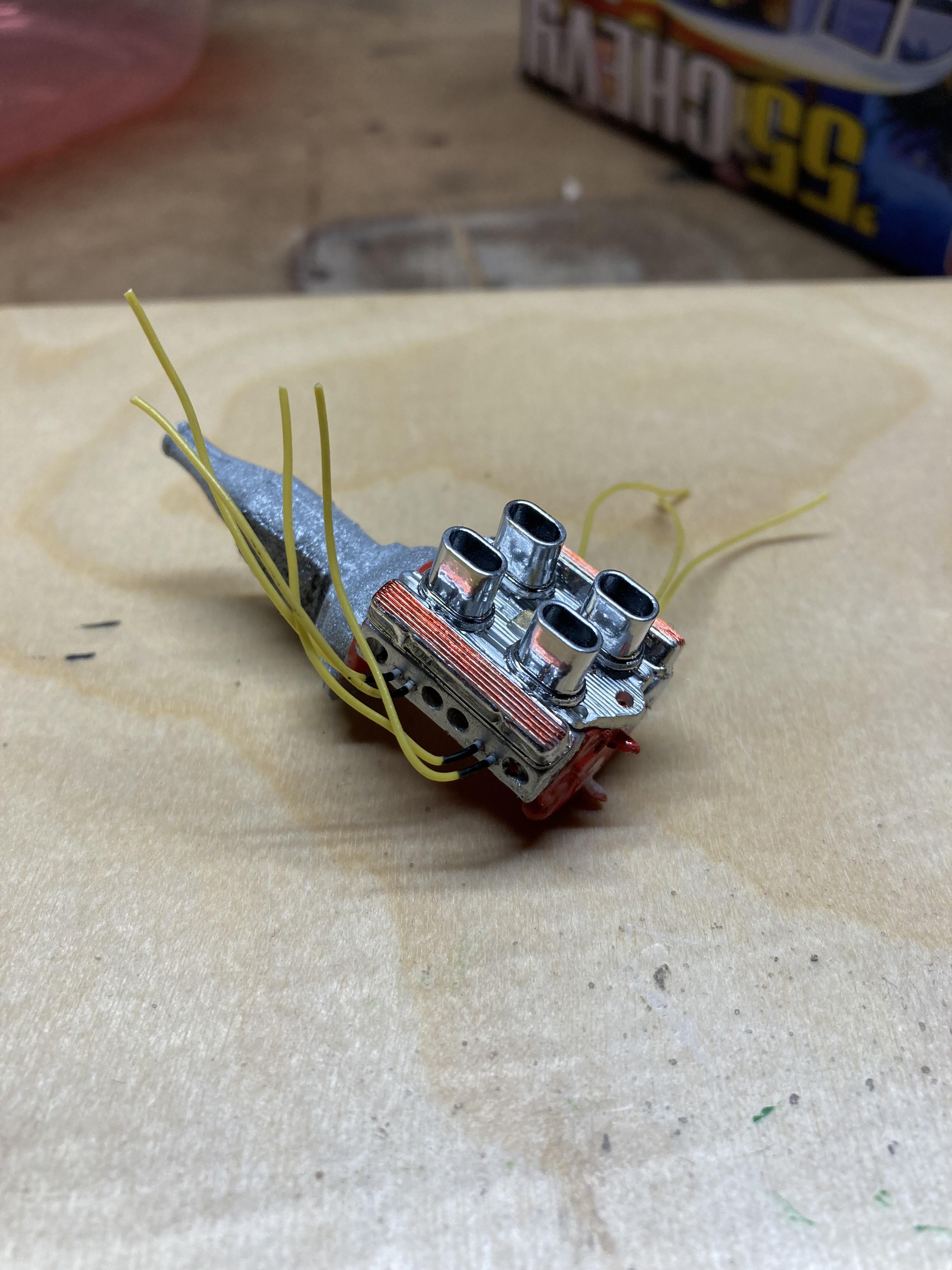

Rick L Posted October 17, 2023 Share Posted October 17, 2023 These velocity stacks were made from plexiglass and spray painted directly with Molotow. This was my fist experiment spraying plastic without primer. They’re holding up fine. 1 Quote Link to comment Share on other sites More sharing options...
