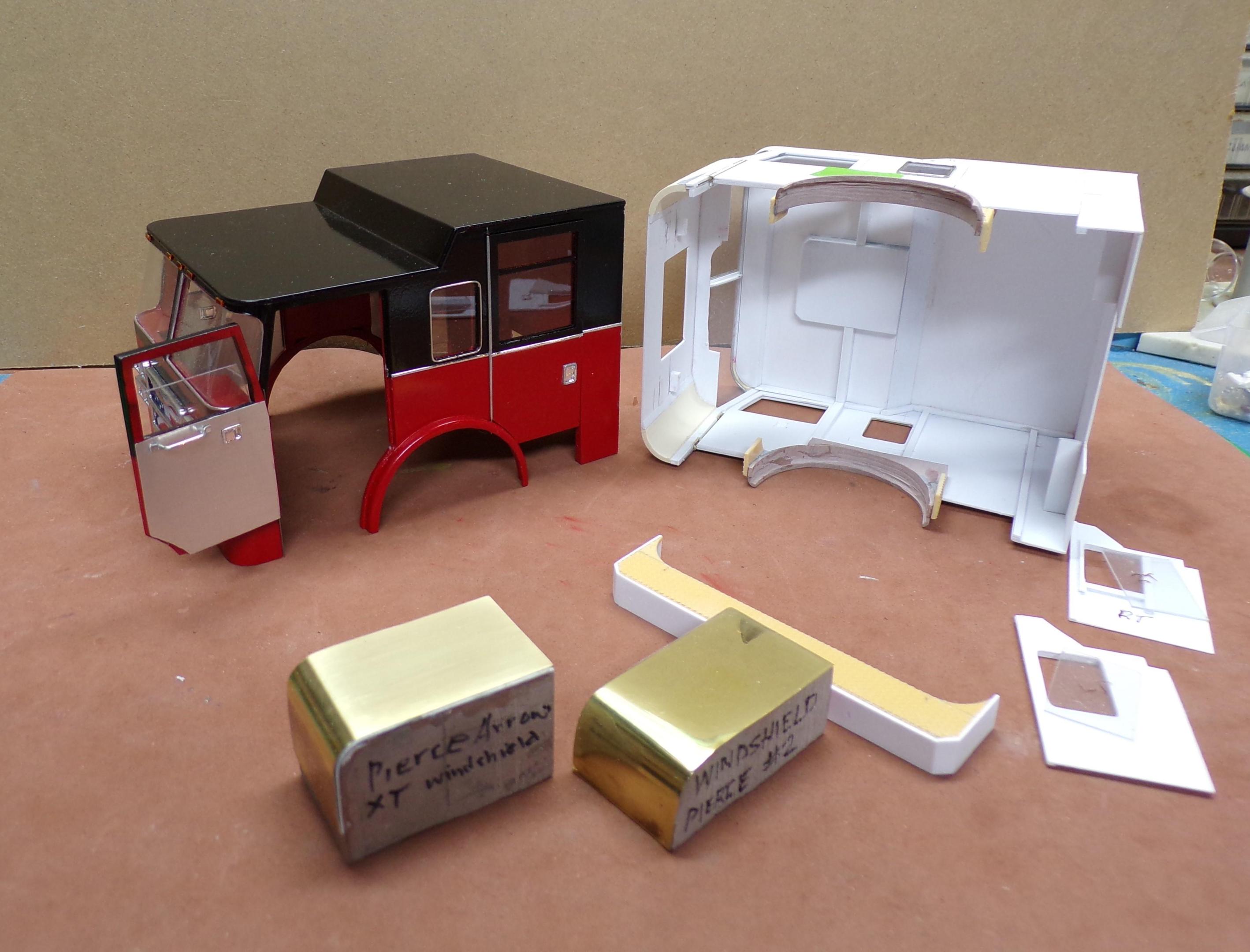

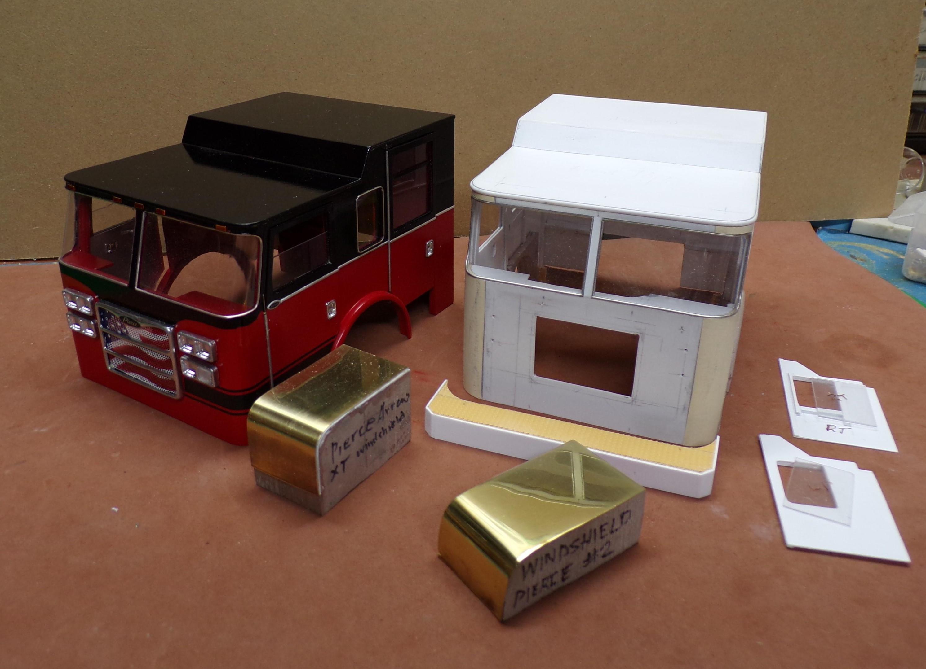

Chariots of Fire Posted January 16 Author Share Posted January 16 This project has been slow in making progress. I have not been satisfied with the cab build. Too many little things that have cropped up to continue with it so I began again. This time where I moved too quickly, I'm taking more time and being a little more careful in the way things are going together. Sloppy is the only way to describe what I did the first time. Sometimes that is the way things go and we need a little comeuppance to get our mind moving in the right direction. The first cab was a learning experience; the second a better result. It might look ok from a distance but the first cab (left) is not right. The door line, which I thought could be offset resulted in the accent strip looking like it jogs up and down. It really doesn't but with the doors protruding that is the look you get. Not good! The cab on the right is the second version and I think will be much better and closer to what it should look like. The brass covered renshape pieces are the bucks I made to vacu-form the windshield sections. The pieces to the right are the interior panels for the center part of the cab where the fixed side windows are. I also fixed the area around the doors where there will be entry steps. In the first instance I should have paid closer attention to those details and did not. That meant making some adjustments that were not good. In the second cab the interior fits much closer to the cab sides and it will be easier to get the steps to where they need to be. The square raised portion inside will become the AC unit. The bumper is made of Evergreen sheet stock and a section of treadplate. Next up is to cut the rear doors free and get the hinges made. 6 Quote Link to comment Share on other sites More sharing options...

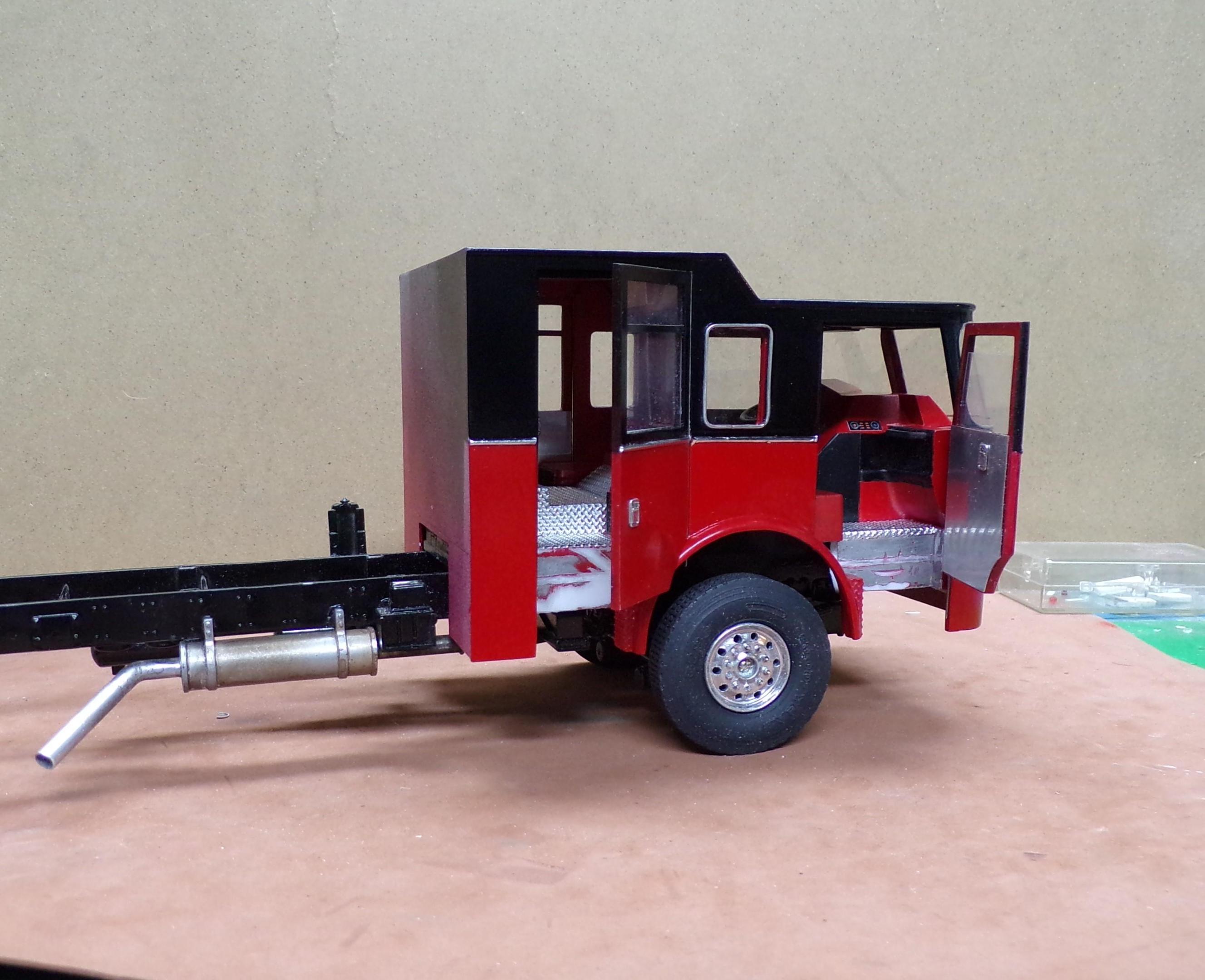

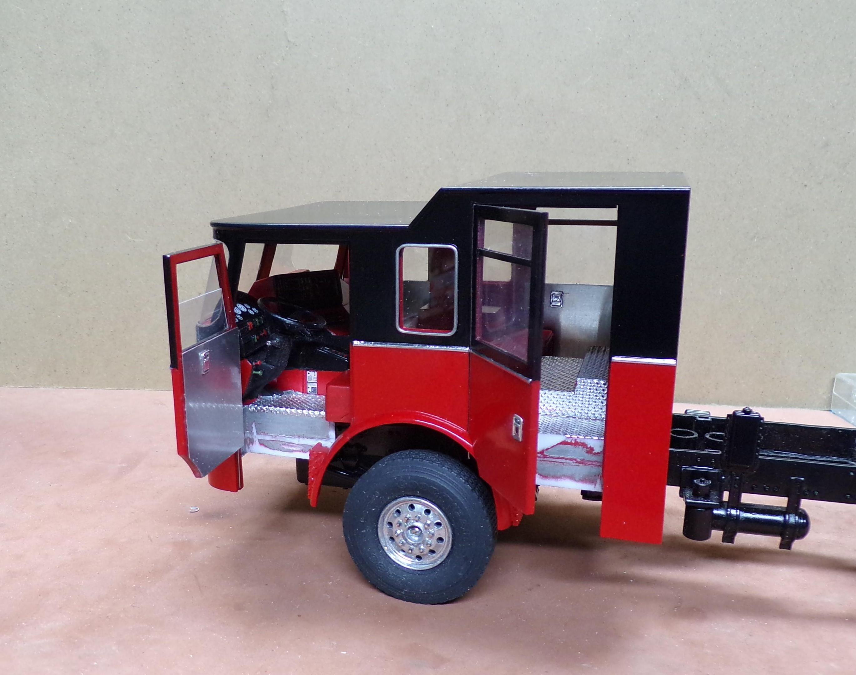

Chariots of Fire Posted February 11 Author Share Posted February 11 We're back at square one and where I left off with the first cab. The second cab is nearly done. The interior bucket is installed but without the seats. All except the driver's seat need the SCBA bottles attached and then the seat belts installed. The steps are also yet to be done but progress has been made. The cab needs to sit lower on the frame so some adjustments will need to be made. For one thing the batteries are too wide where they are under the interior bucket. Some trimming with a dremel should take care of it. They won't be seen at all on the finished build. The front will be appropriately shimmed to be sure it is level. The turn signals also need to be filled and colored at the corners. Steps from the former cab were removed and will be rebuilt. 1 Quote Link to comment Share on other sites More sharing options...

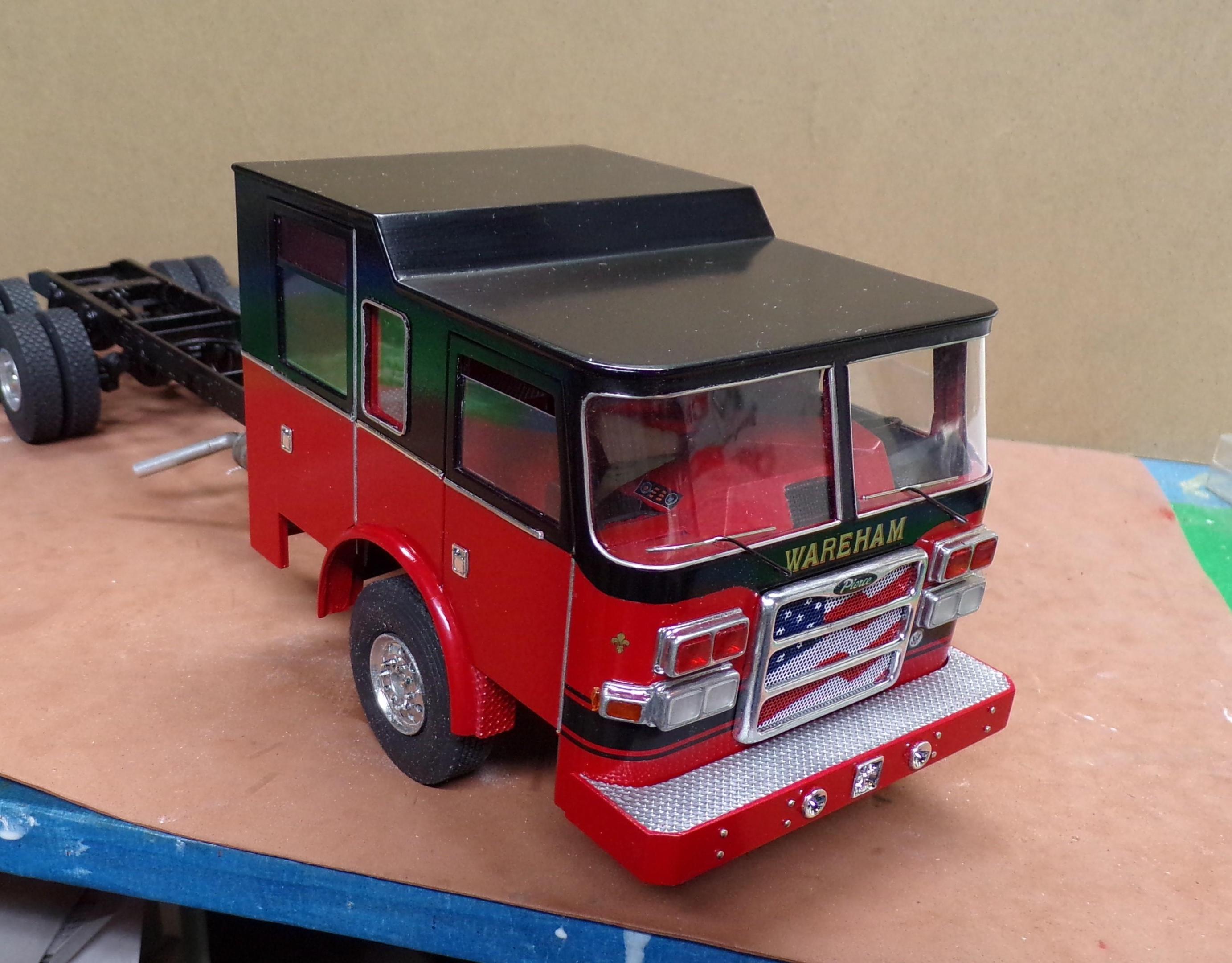

Chariots of Fire Posted February 14 Author Share Posted February 14 Worked on the build a bit today. Snowed most of the day so it was a good time to settle in. Bumper is mounted and a few decals were put on. 2 Quote Link to comment Share on other sites More sharing options...
