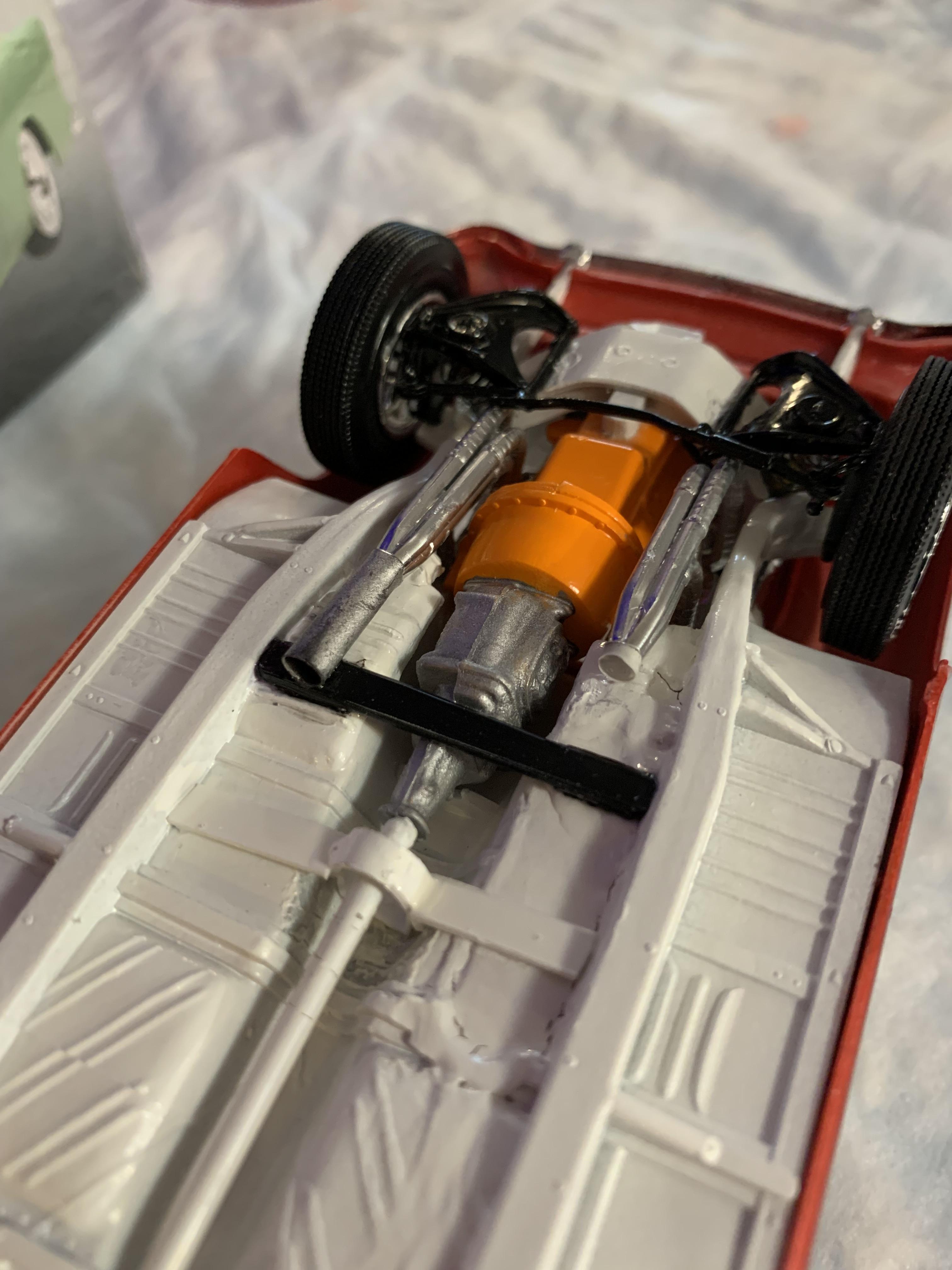

Chassis and suspension, prior to engine and driveline installation...

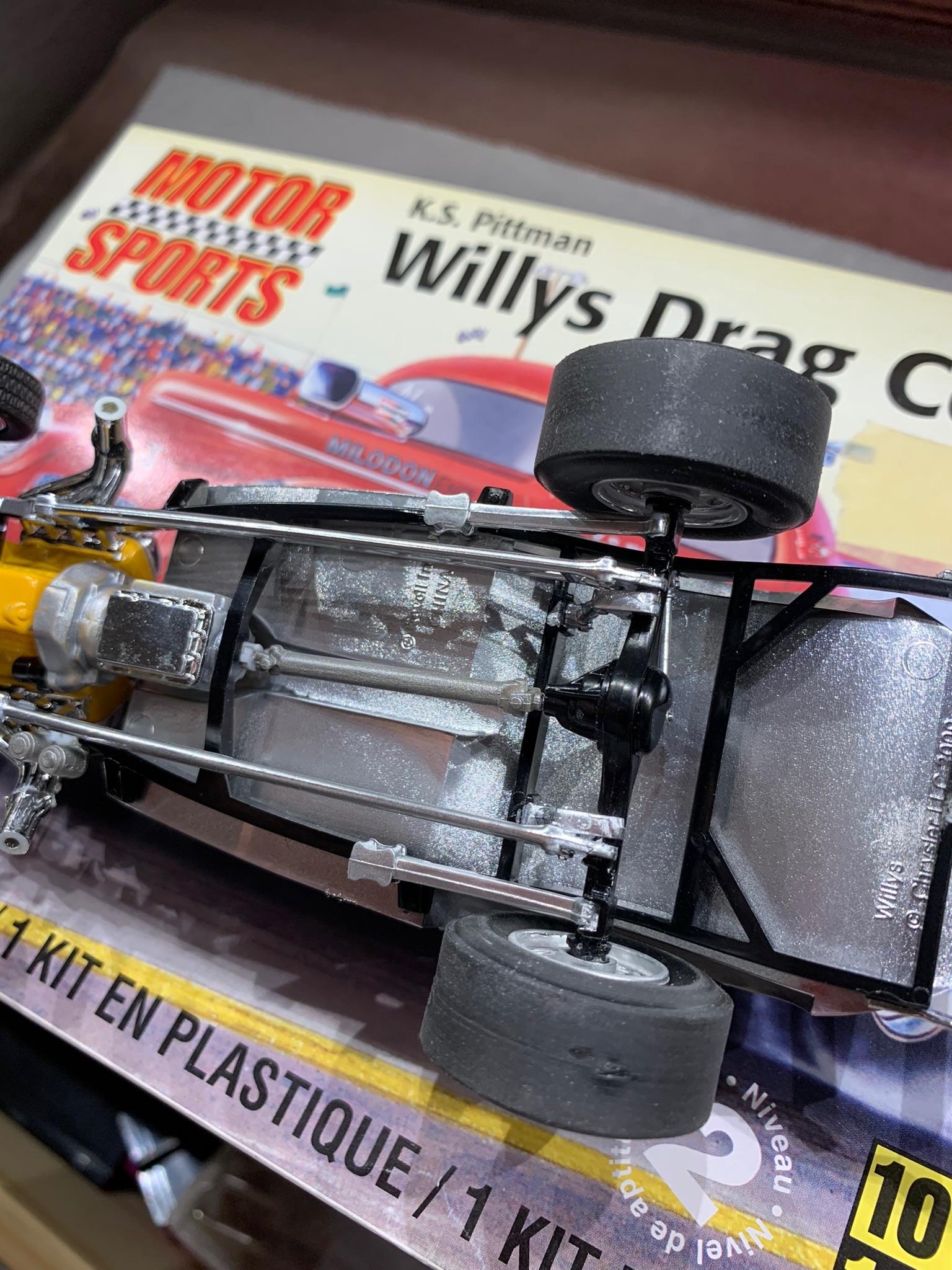

A couple of minor updates to the article as presented in the magazine:
First, there is a minor correction to the text on the caption at the left center of page 17 of the article in issue #222 of Model Cars magazine.  At the end of the second sentence reference is made to a Watts linkage.  The application shown in the picture is not a Watts linkage, instead it is a simple sway bar.  The original text submission called it a sway bar but somehow during editing process the words were changed to Watts linkage.
A Watts linkage provides a similar purpose - preventing the axle from swinging side to side - but is a more complicated design that is also more effective at doing its job.  You can see a proper Watts linkage on most of the various funny car model kits that replicate a first generation Logghe funny car chassis.  Minor point here, but there are some members of the MCM forum that highly value precise accuracy, and wanted to make sure this correction did not escape their - or your - attention.
Second, as a contributor I have a feeling that I often drive my respective editors crazy with too much material that has to be cut back or deleted to meet the available magazine space (and most likely, the continued interest level of its readers(!)).  But for those with an extra in-depth interest in the subject presented here, note the image below and its associated caption which didn't make the final cut in the magazine coverage:

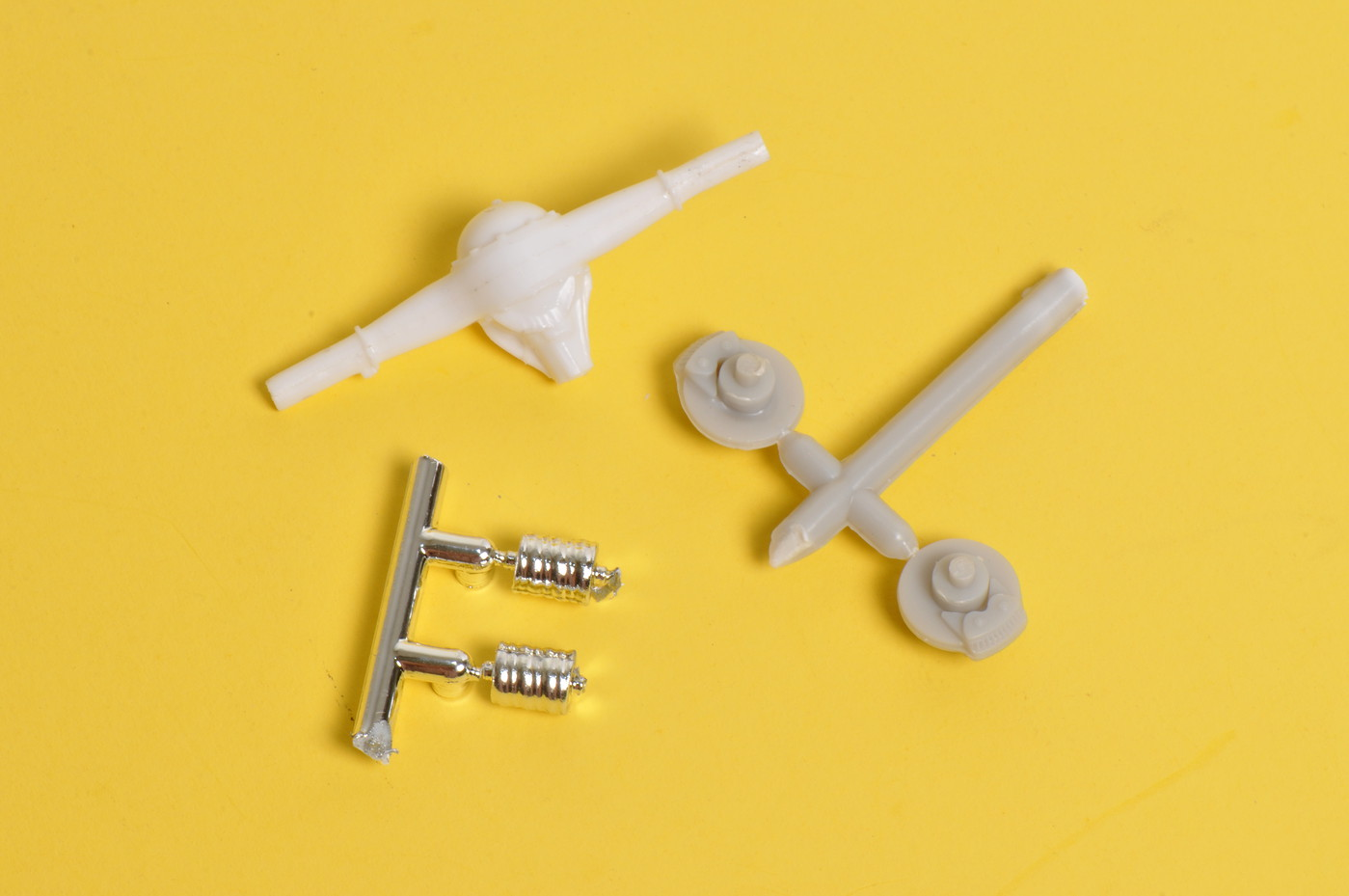

"Many variations on this basic theme are to be encouraged.  (UPDATE #2 - The following has been revised based on Ron Thorne's research per his posts below ).  Most Gassers back in the day ran 1950s Oldsmobile or Pontiac differential/axle assemblies, and that is what is contained in the modern-era Revell 1941 Willys Gasser kits (and is what I used in my project).  Those desiring a more robust looking rear axle/differential unit can use the equivalent parts found in Revell's 1951 Anglia (as seen here) and the original (1963 tooling) Revell Stone Woods and Cook kits and its reissues.  Ron has identified this design as being an "HO 33 Eaton" component.
AirHeart early style front disc brakes can be found in the AMT Piranha and Surf Woody kits and would be a correct high-buck setup for the era depicted by this project.  Suspension-wise, some builders used large rear coil springs with air bags instead of the more common quarter-elliptic leaf springs, the units shown here are from the modern AMT-Ertl kit of the Barris Ala-Kart."
Best,,,TIM

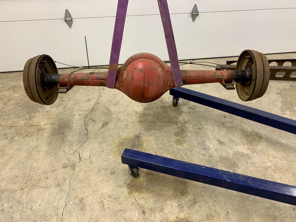

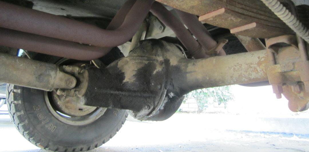

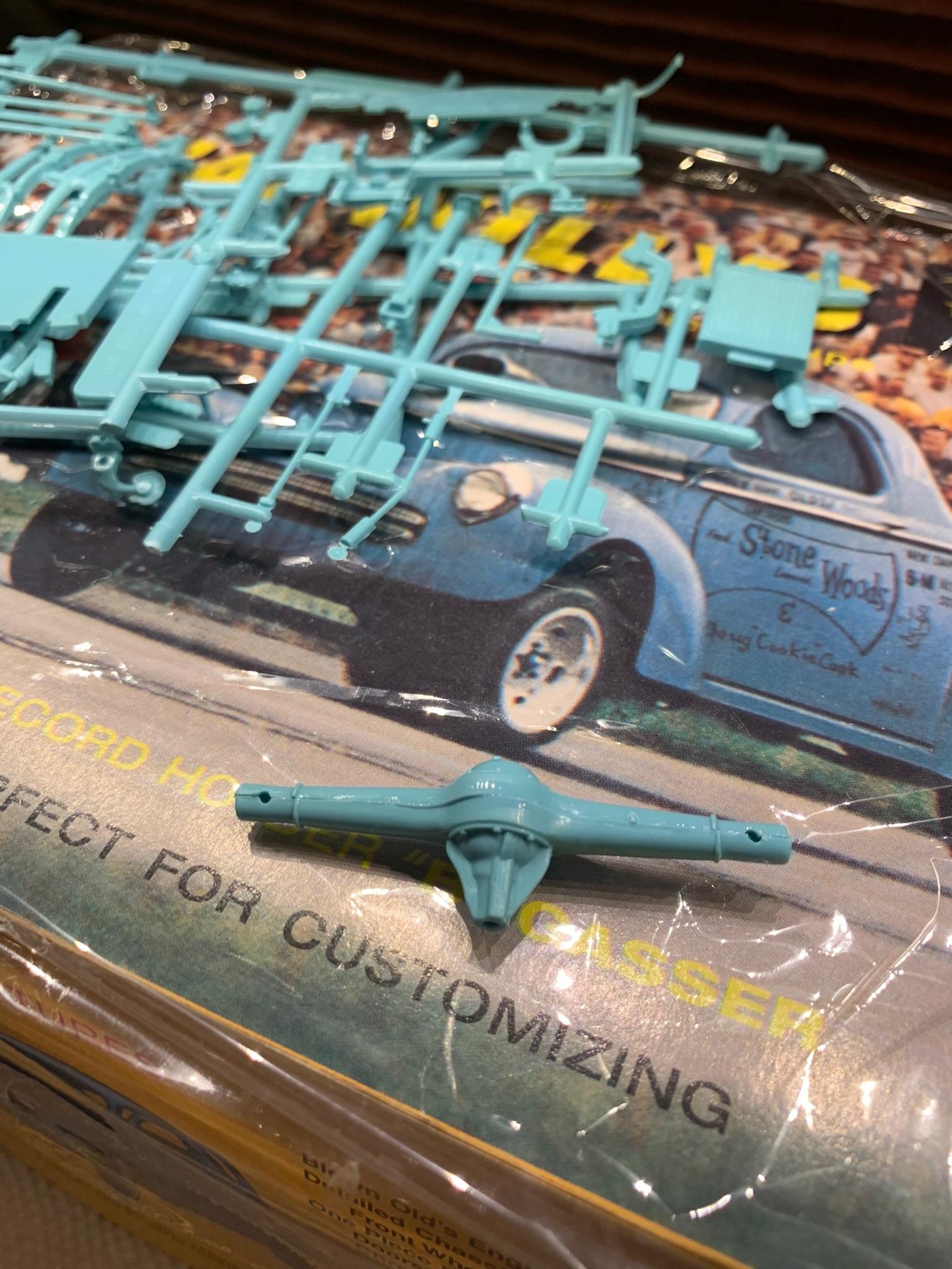

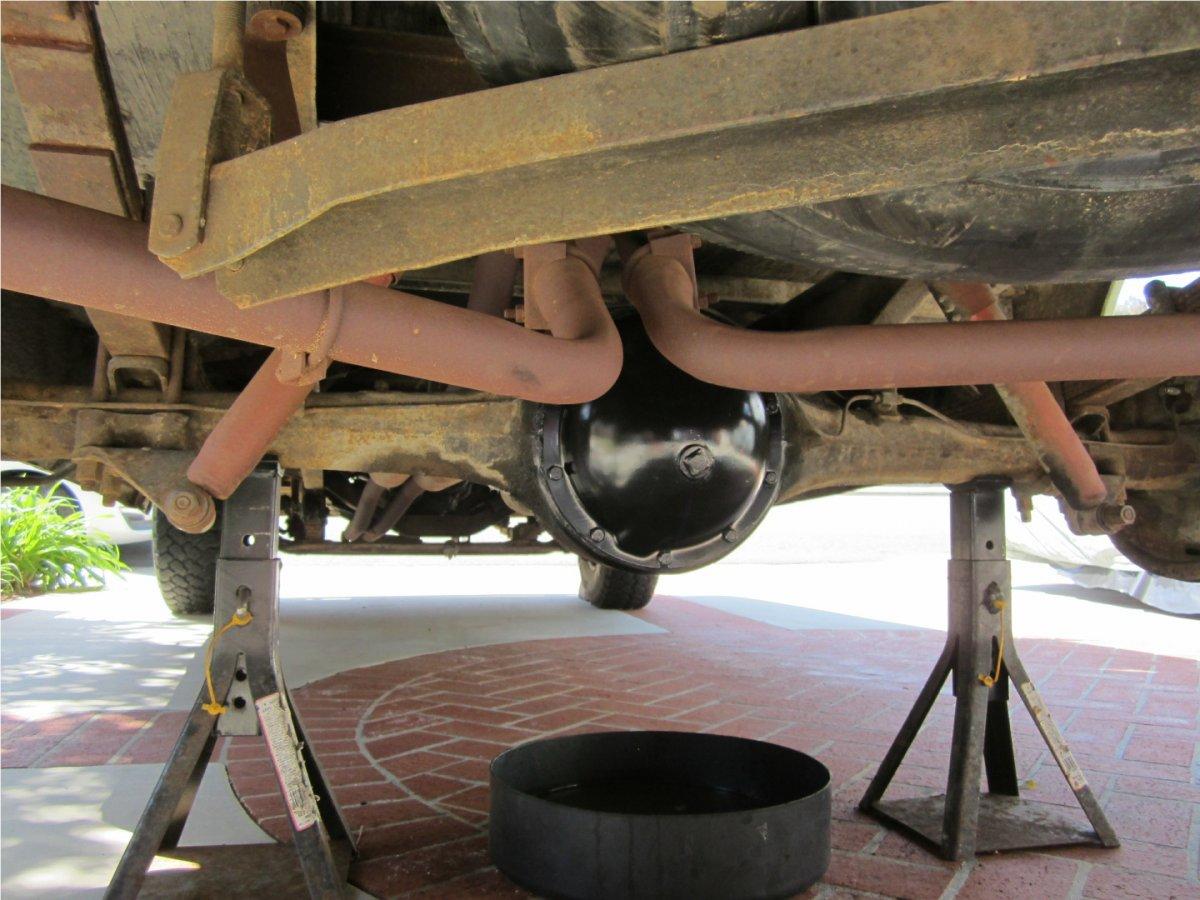

Uhh, that rear end appears to have bolts on the rear cover, unlike the Old-Pontiac rears (pic included).   Thank you for all you do for the hobby.
  • Like 2

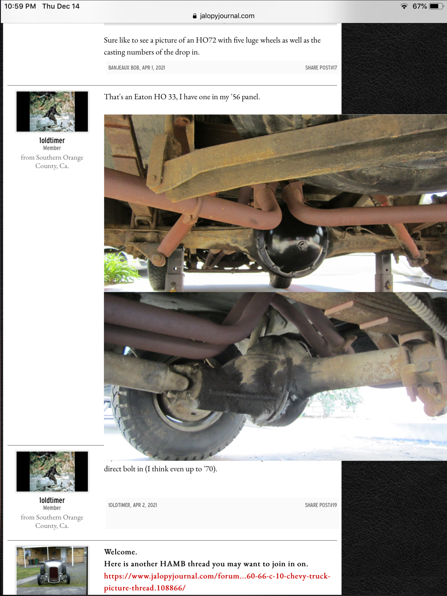

On further investigation, the Revell Anglia kit comes with an HO style Eaton rear end (not Olds Pontiac), which, oddly enough, has a bolt on type inspection rear cover along with the removable front center section.  So, 2 sets of bolts on 1 rear end?!!
  • Like 1

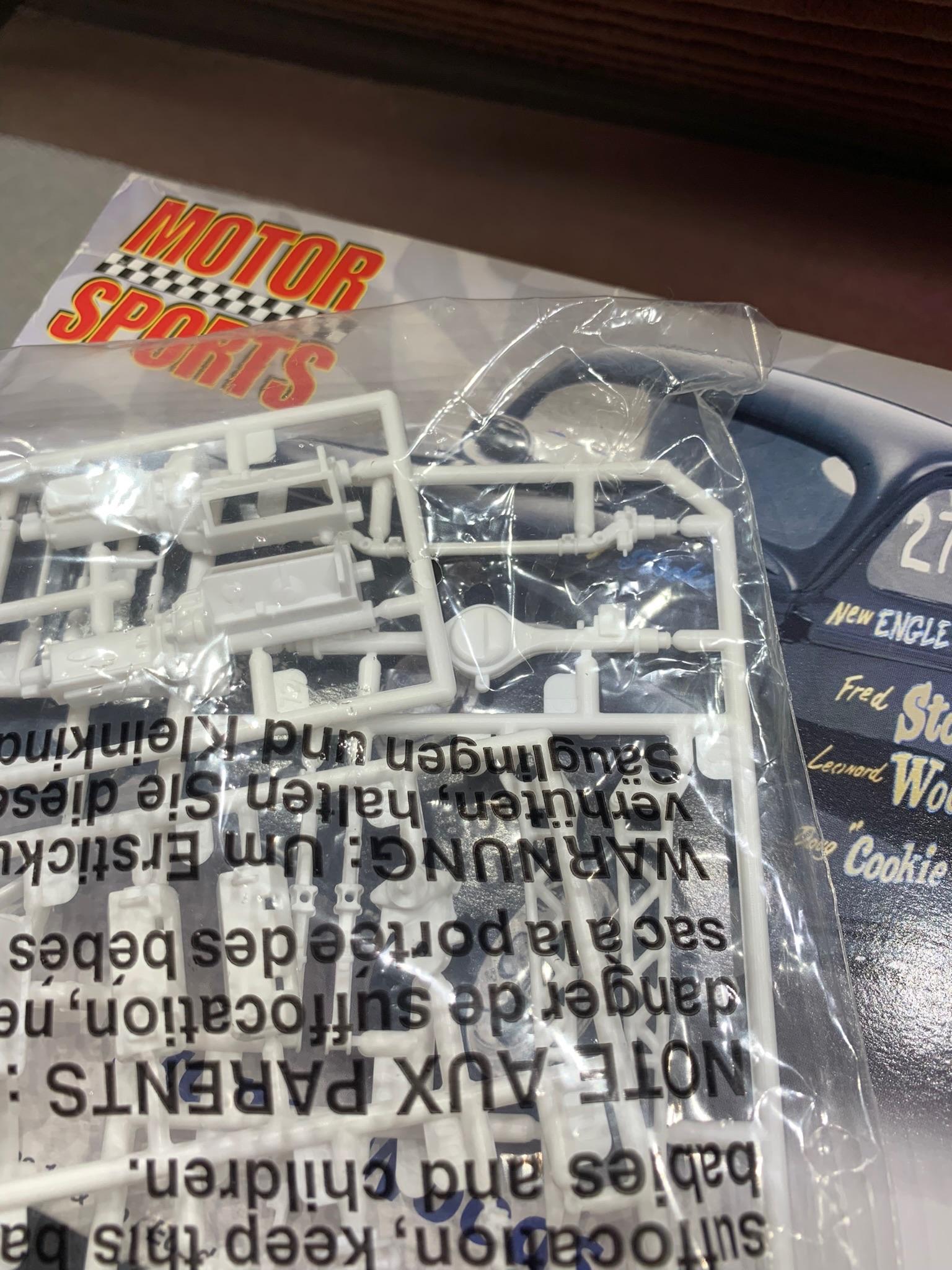

Next, I checked both the Revell Anglia and Revell SW&C (1963 tooling) rear axles and they are essentially identical...likely certainly based on the same original wood pattern, but with tweaks for the slightly different rear suspension parts breakdown and narrower tread width of the Anglia.  The Miss Deal rear also looks the same but (and this is news to me) scaled slightly larger for some reason.  I also looked at the Revell 1950 Olds kit, which had an axle/diff that was not quite the same as the earlier mentioned kits, and the AMT/Ertl 1962 Pontiac kits; the latter looked more like the 1/1 scale image you posted above if I am remembering correctly (I was in a bit of a rush at the time).

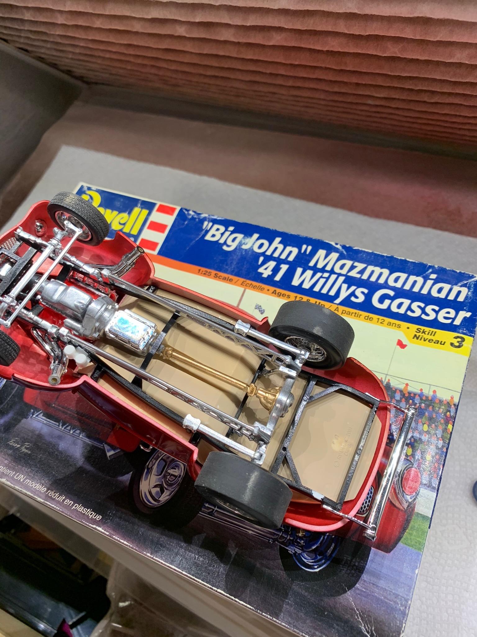

Well, once I get going, it is hard for me to stop.  The 47?-56 Olds is smaller overall in dimensions and considerably weaker than the 57-64 Olds-Pontiac.  Luckily, I had some kits and built models to look at and it appears that Revell missed the boat on the 1963 Stone Woods & Cook and the Revell Skippers Critter kits as they have the HO33 Eaton rear in them.  I have included some of my models and kits pictures to elucidate this.  Close inspection of the rears (specifically the bolts, singular and plural) will help.  I have been accused of being too damned particular as they are “only models”.  Perhaps so, but, if I am going to do something, I am going to do it to the best of my knowledge.  I also find this interesting .
  • Like 2
Expand
Thanks for the additional info and backup, Ron.  My above referenced file on rear axles and diffs only had Mopar designs.  So having done further follow-up using research of 1/1 scale late 1950s to early 1960s Olds axle photography, I now agree with your conclusions.  I have updated/corrected the original photo/caption above to reflect your findings.  While I would challenge anyone to beat me on identifying 1960s muscle era V8s, I am nowhere near as savvy on rear axles, so your help on this is much appreciated.
It is just fascinating to me how we are always finding out new things in this hobby, even all these years later.   Why would Revell have used a non-prototypical rear axle/diff design on their original SW& C tooling?  Beats me...but the proof is above.

Here's an example of the properly setup, partially completed rear suspension using the airbag setup referenced in my "supplemental" photo and caption above.  This is from Travis Medford and you can see (and you should check out) his entire build in this same forum folder under the "'32 Ford Y-Block Drag Coupe series of at the link below....TB
Photo and project credit: Travis Medford

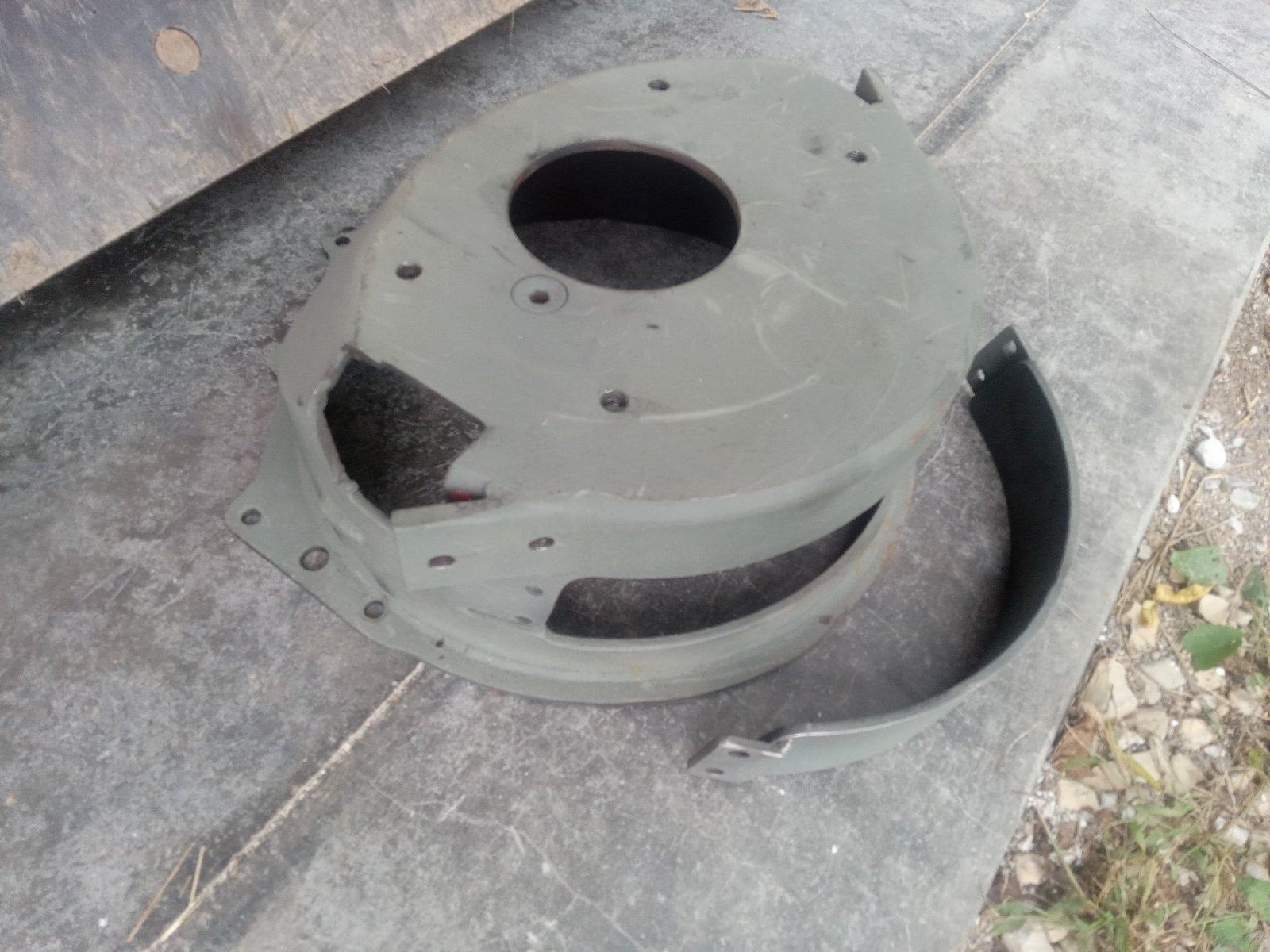

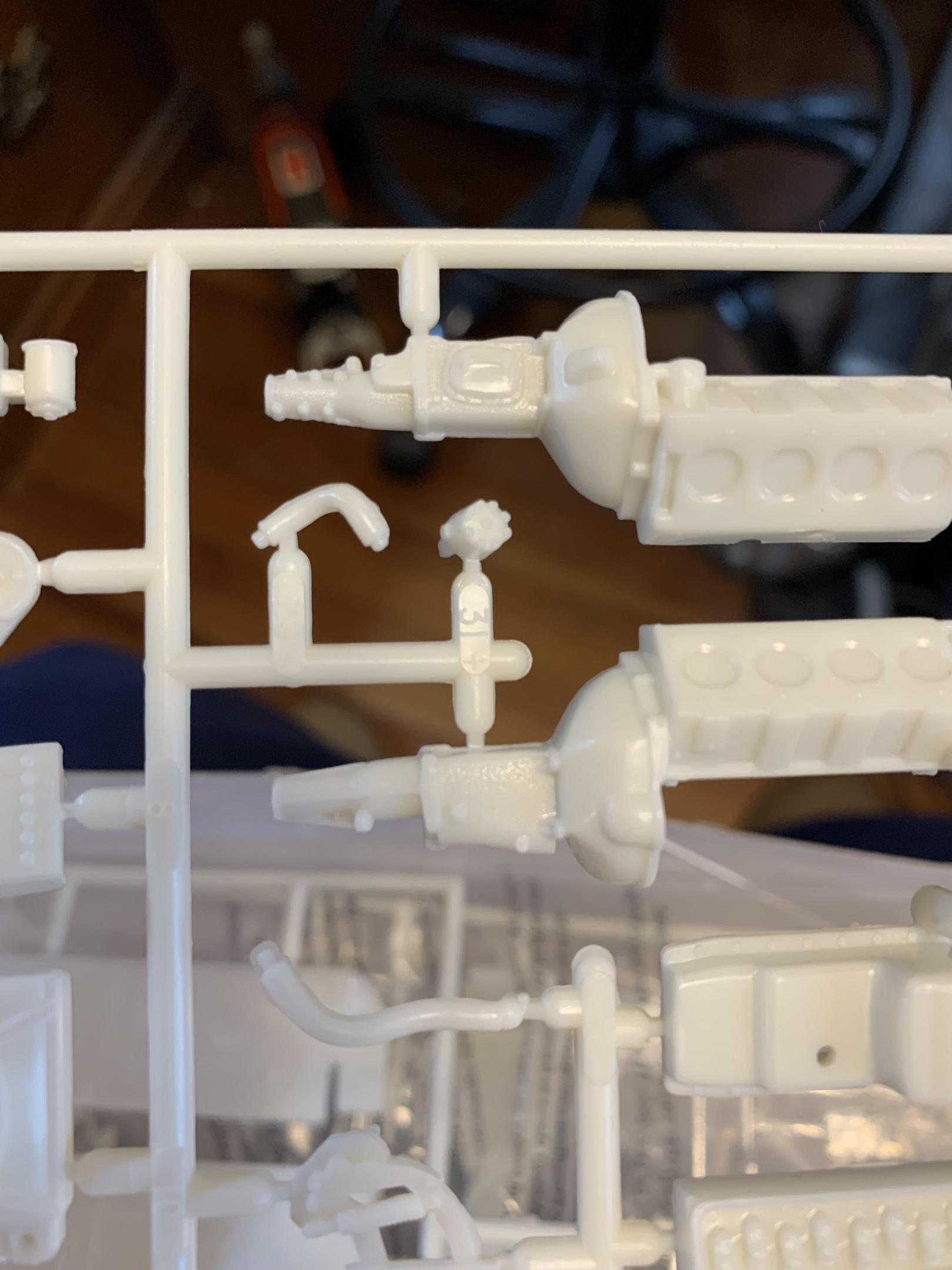

Since the window for text edits has expired, this note will have to suffice as a further update to my note above about the rear axle linkages.  The technically correct terminology for the rear end "sway bar" is actually "Panhard Bar".  For anyone who is into this level of detail, recommend you dig out your copy of MCM #22 and replace the words "Watts Linkage" in the text for the caption at the left center of page 17 with "Panhard Bar".  Thanks...

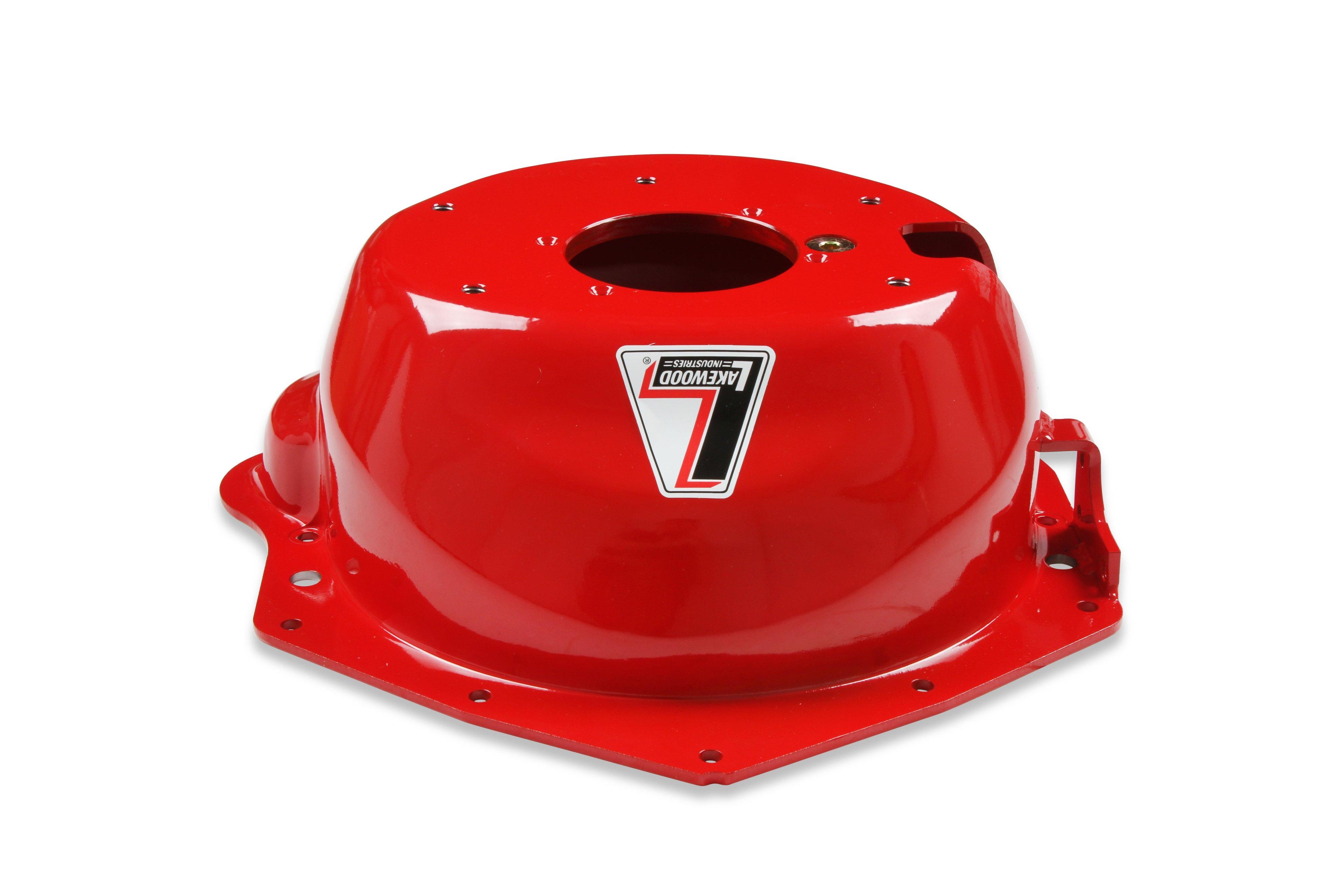

Also, if I am remembering correctly, my original article submission mmay have made reference to consideration of a Scatter Shield as becoming a requirement for manual transmission Gassers during the course of the 1960s. (Again, if my memory is correct that I included this mention in the text, it would have been omitted in the final article presentation due to space limitatations.)  I didn't find one I liked but considered using the bellhousing/pseudo scatter shield lookalike in the c.1975 tooling of AMT's 1955 Corvette kit, which included a few extra parts for a drag racing themed build version.  Also briefly considered but rejected the original Monogram 1969 Z-28 Street Machine kit tooled in the late 1970s.  Any of you have better suggestion for a kit-based source of a period correct scatter shield sized to fit a Chevy 283/327 with a four-speed manual tranny?

i gotta check out that bell in the 55 vette.. dont remember it
as for the Z, that model had so many neat parts..
cute little turbos, oil pan, torker intake and the dana rear!
last but not least.. motorwheels!

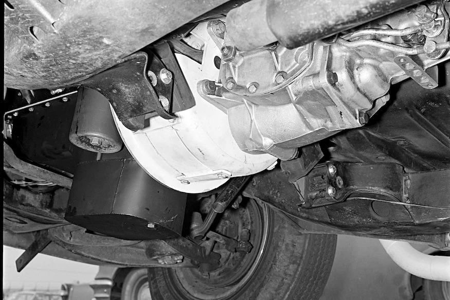

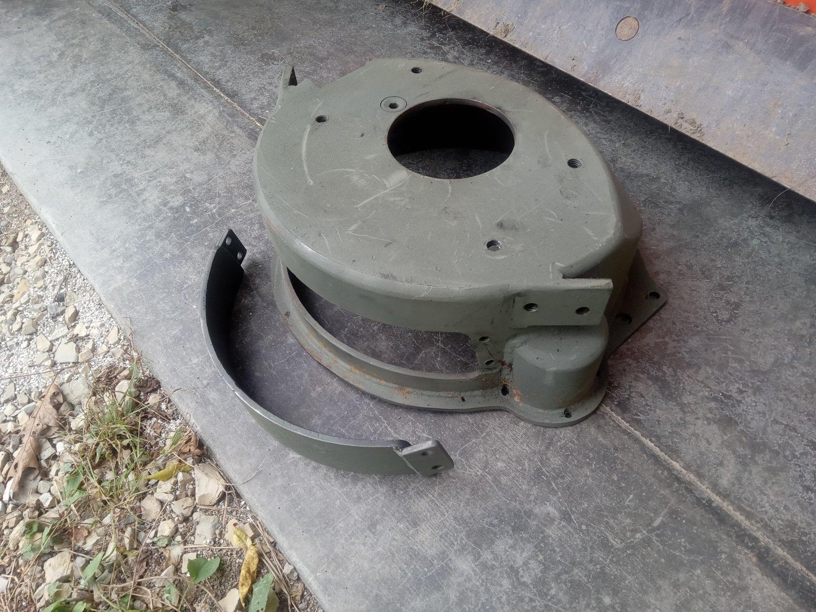

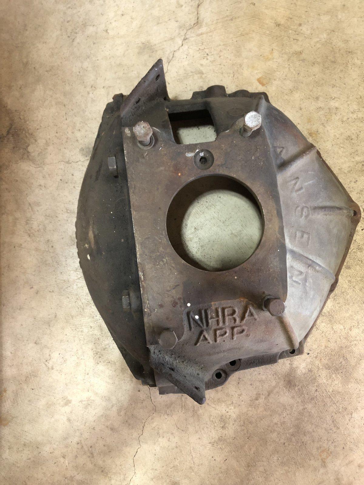

The Revell parts pack looks similar to a Lakewood Bellhousing/scattershield.  I don’t have a picture but I am 99 percent sure I used one on this P/S 55 Nomad.  Of course, in the early 60’s, the cast iron Ansen scattershield with the bolt on cover (had to weigh 50 lbs) was an option.  The Chevelle pro street is somewhat similar to a Lakewood (no bolts, of course).  Just another one of those head scratchers in the modeling industry as every tech man in the country checked all the cars coming in for a scattershield.
  • Like 1
Well Tim, you are one of those model building masters that go to the extreme to duplicate exact detail.  I'm guessing envy is the best description I can say about how I feel about the fantastic work.
That being said, I'm definitely watching, and I too loved the myriad  variety of gassers back in the day.
Still another pic of an early Lakewood bellhousing I believe on John Barkley’s D/S 57 Chevy (circa 1968) with the bolt on inspection cover.
