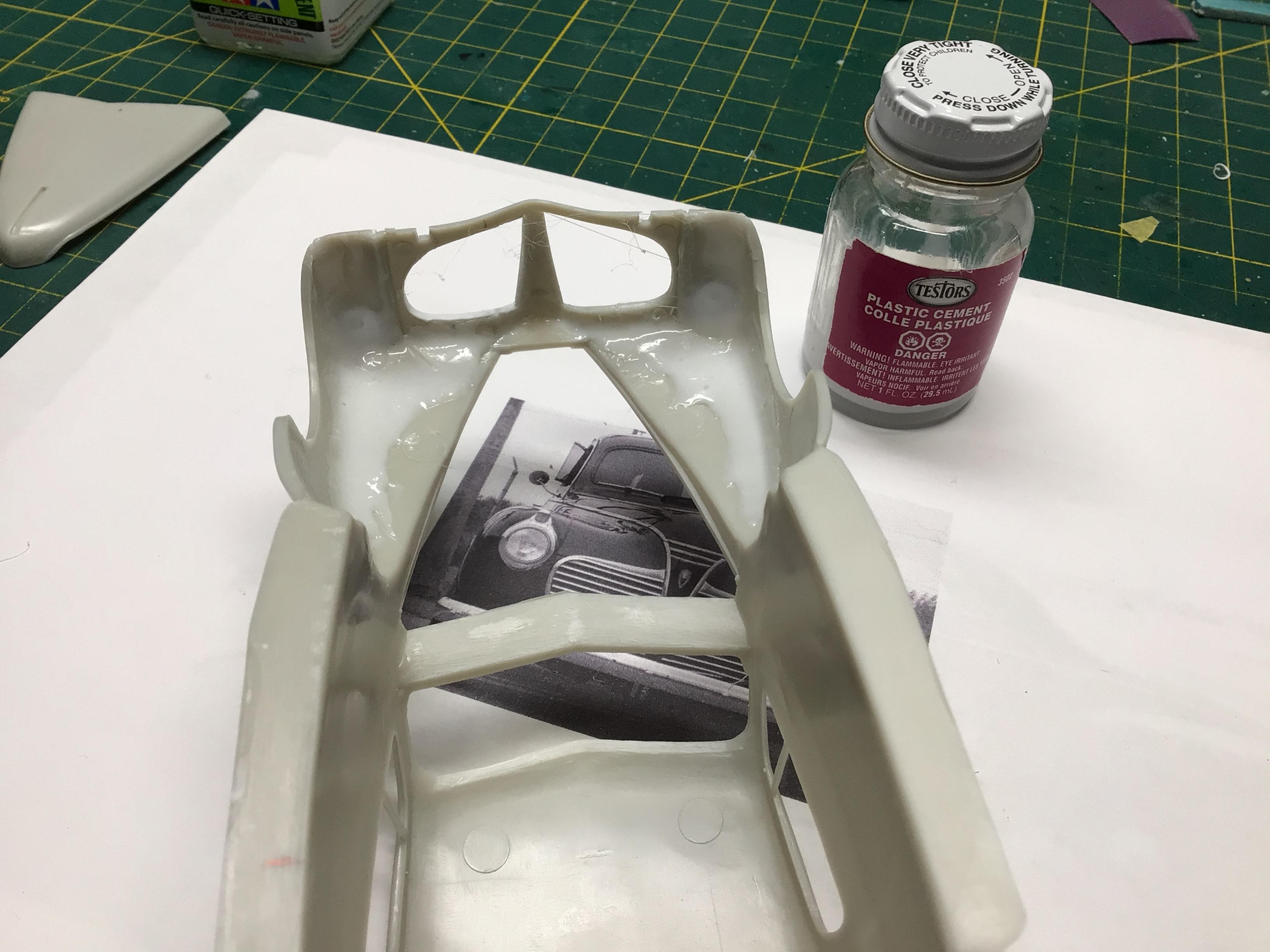

customline Posted February 26, 2024 Author Posted February 26, 2024 18 minutes ago, NOBLNG said: No, it was in a glass bottle, but it’s likely the same stuff. No, it looks like you have a solvent type. The one I pictured above is thicker; runny but not watery. It's a mystery, Greg. Hopefully the Dehydrator will suck the life out of it pretty soon. Is it still gooey or can you stick a finger in it and not get any on it? Did it bond to the plastic really well? The reason I used the Plastruct "welder" was its pretty hot and I wanted to get a good bond. The solvent type cements are not all the same, some are hotter than others- they melt the plastic and evaporate at different rates from brand to brand and maybe the one you used is a "cooler" type. You just gotta wait it out ?.
NOBLNG Posted February 26, 2024 Posted February 26, 2024 3 hours ago, customline said: No, it looks like you have a solvent type. The one I pictured above is thicker; runny but not watery. It's a mystery, Greg. Hopefully the Dehydrator will suck the life out of it pretty soon. Is it still gooey or can you stick a finger in it and not get any on it? Did it bond to the plastic really well? The reason I used the Plastruct "welder" was its pretty hot and I wanted to get a good bond. The solvent type cements are not all the same, some are hotter than others- they melt the plastic and evaporate at different rates from brand to brand and maybe the one you used is a "cooler" type. You just gotta wait it out ?. It is pretty hard…but not as hard as virgin styrene. I can still dent it slightly with my fingernail. I want it to be firm so it won’t smear or clog the sandpaper when I shape it. I might not even sand through to it, but it is there for insurance.
customline Posted February 26, 2024 Author Posted February 26, 2024 2 hours ago, NOBLNG said: It is pretty hard…but not as hard as virgin styrene. I can still dent it slightly with my fingernail. I want it to be firm so it won’t smear or clog the sandpaper when I shape it. I might not even sand through to it, but it is there for insurance. I went through just a little and mine was like you describe so when I hit white I stopped the shaping operation for another day. You're getting close. I shot mine this afternoon with Ace Premium gloss black and tried to put it in my new dehydrator but it wouldn't fit! The body is mounted on a Tamiya spray stand and it wouldn't fit under the "dome" ? ! ! I gotta raise the dome or chop the stand ? Normal, perfectly normal.

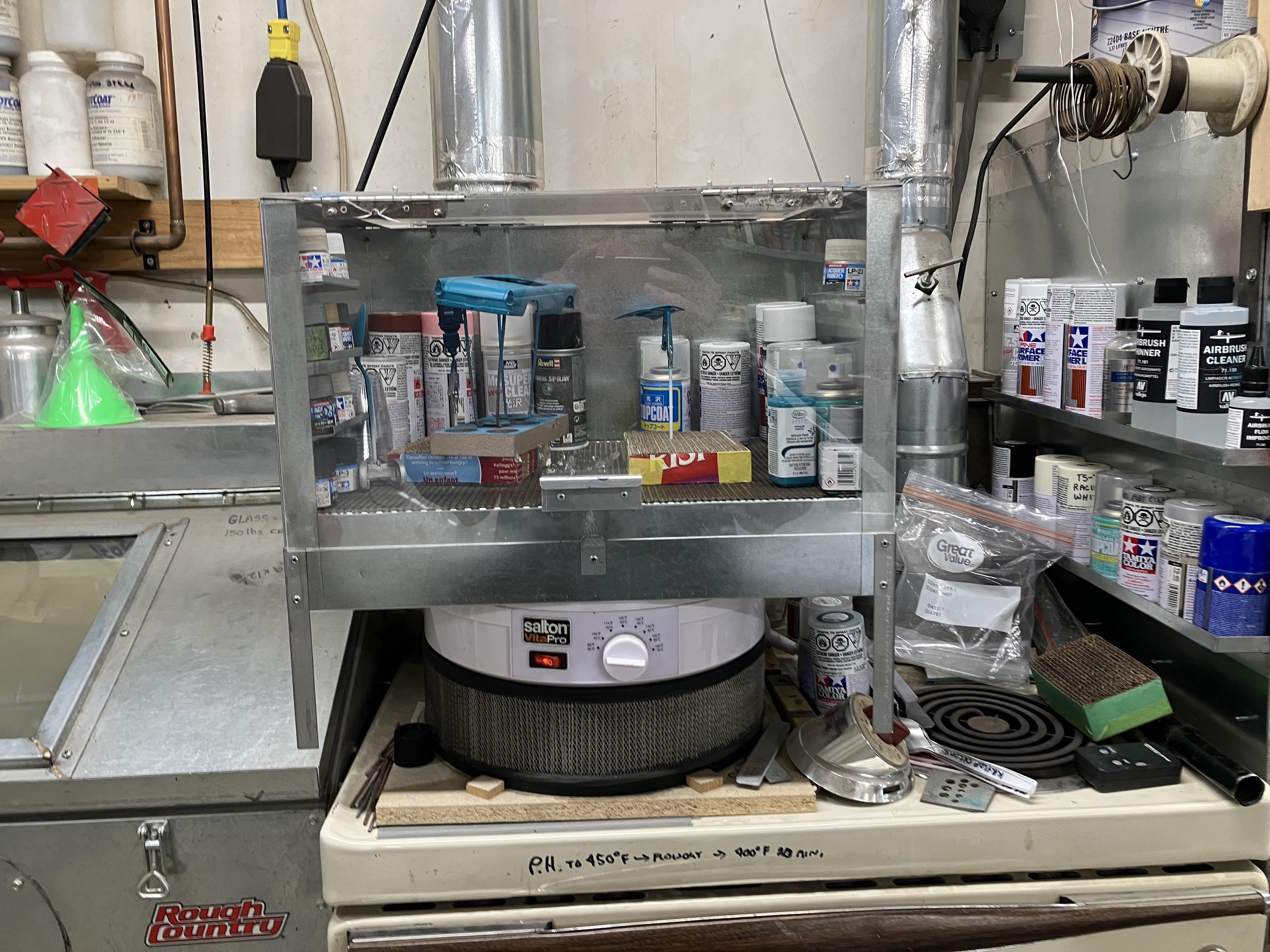

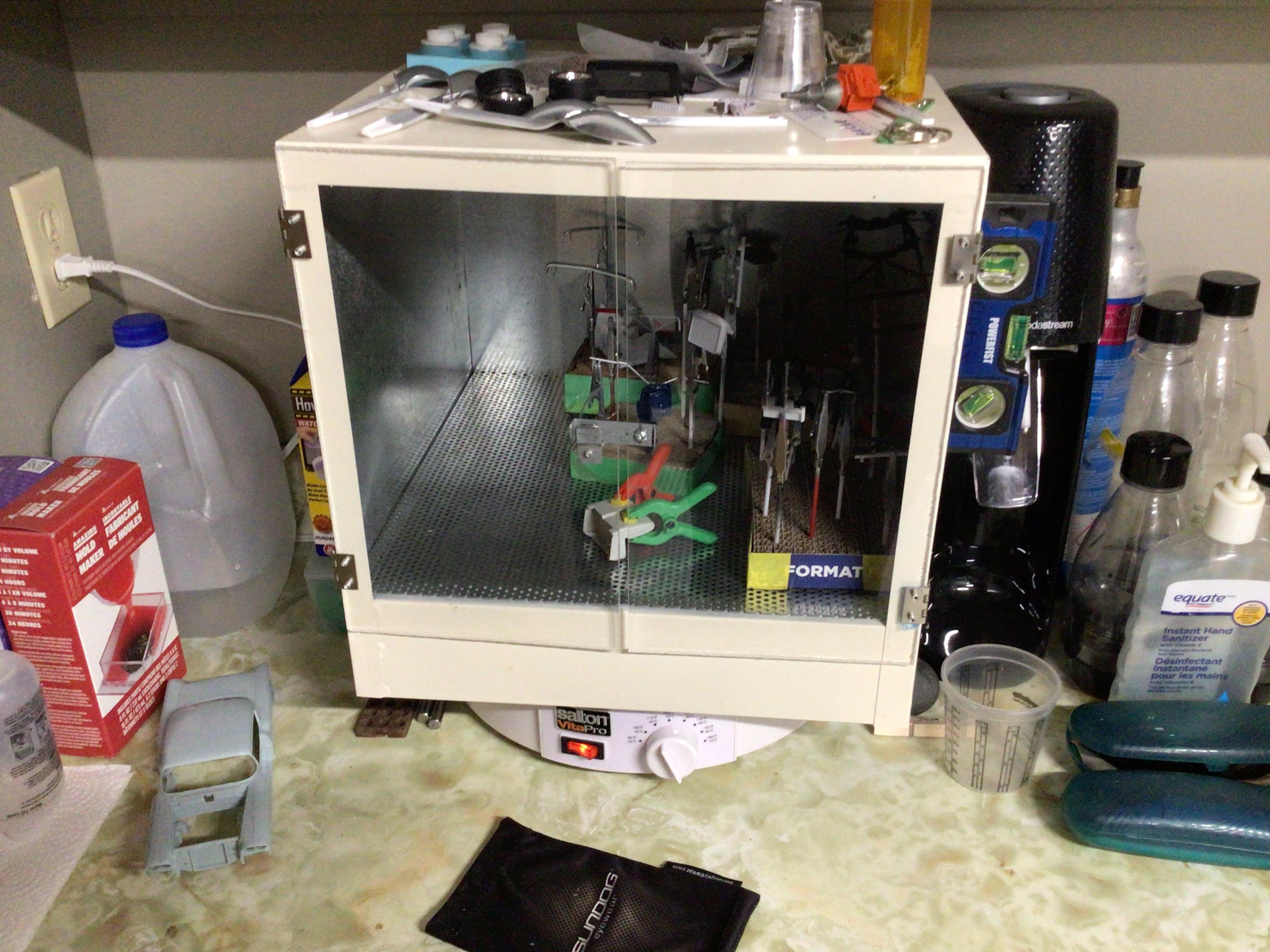

NOBLNG Posted February 26, 2024 Posted February 26, 2024 (edited) 22 minutes ago, customline said: I went through just a little and mine was like you describe so when I hit white I stopped the shaping operation for another day. You're getting close. I shot mine this afternoon with Ace Premium gloss black and tried to put it in my new dehydrator but it wouldn't fit! The body is mounted on a Tamiya spray stand and it wouldn't fit under the "dome" ? ! ! I gotta raise the dome or chop the stand ? Normal, perfectly normal. This is the one in my garage. I found an auto air filter that fit nicely under it, since my garage is filthy. And I keep it on low heat so I can store some “soon to be used” paints in it. My detached garage has a heater going in it constantly, but it gets pretty chilly in there sometimes. This is the one in my basement. I have cranked it up to the max 160F to dry paint and it has not melted any styrene. You could certainly build a box from plywood or cardboard that would give you more room and easier access. The clear doors are not really necessary, and the heat is not high enough to cause a fire hazard. The main thing is to allow airflow out of the box. Edited February 26, 2024 by NOBLNG 1

customline Posted February 27, 2024 Author Posted February 27, 2024 (edited) 19 hours ago, NOBLNG said: This is the one in my garage. I found an auto air filter that fit nicely under it, since my garage is filthy. And I keep it on low heat so I can store some “soon to be used” paints in it. My detached garage has a heater going in it constantly, but it gets pretty chilly in there sometimes. This is the one in my basement. I have cranked it up to the max 160F to dry paint and it has not melted any styrene. You could certainly build a box from plywood or cardboard that would give you more room and easier access. The clear doors are not really necessary, and the heat is not high enough to cause a fire hazard. The main thing is to allow airflow out of the box Thanks, Greg.....I have work to do ....edit: I really like the air filter, my garage is filthy too ! ? Edited February 27, 2024 by customline

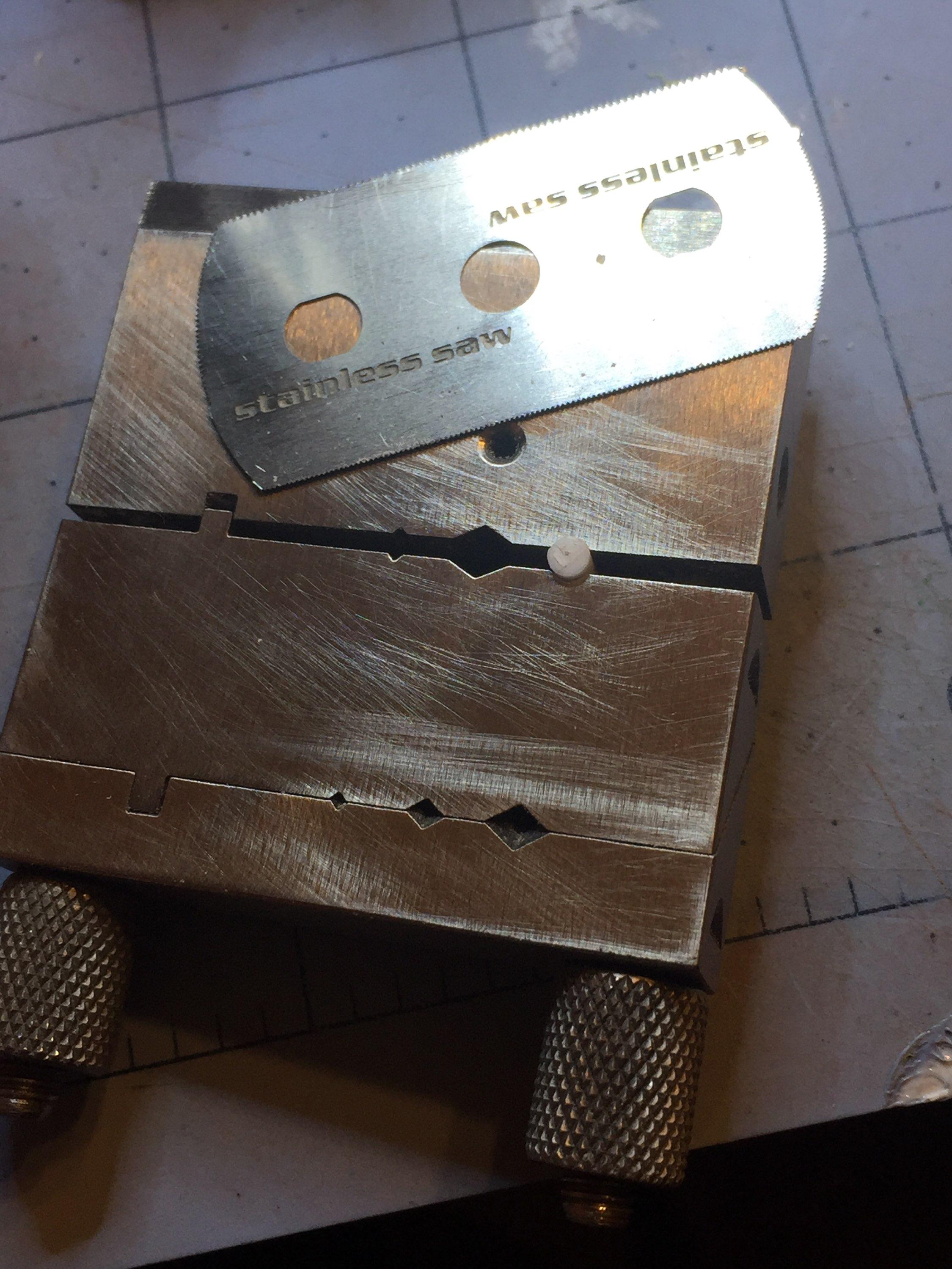

customline Posted March 7, 2024 Author Posted March 7, 2024 (edited) Greg did a really nice detailing job on his interior and I was at the point of just painting the damned thing and getting on with it. But I then felt shamed ?. Okay, so even though I had a coat of primer on it I thought I should make an attempt to at least make some cranks and handles. I started by drilling in the centers of the hardly visible escutcheon and then discovered I could center-drill a piece of .100 evergreen rod and slice off thin pieces with my PE saw blade. I could then insert an .020 brass wire through the door panel and slide the new escutcheon down the wire and hit it with a tiny drop of solvent to bond it. then I found I could center-drill a piece of evergreen 1/16 rod and bend a piece of .020 brass wire into a crank shape and CA glue the wire into the rod. I then sliced off the 1/16" rod leaving a knob on the new crank. I finished off the knob with a drop of CA. The handles are just more .020 wire bent to shape. Simple. Not great, but adequate. Better than nothing. You can probably cast some handles and cranks but for me it's just not worth all that. After the interior is painted, I will add the new hardware and paint appropriately with Molotow and some ivory enamel. Easy. ? Edited March 7, 2024 by customline 2
NOBLNG Posted March 7, 2024 Posted March 7, 2024 Those look great Jim. Way better than what was barely there. I like how you use your vise as a guide to cut the escutcheons off.?
David G. Posted March 7, 2024 Posted March 7, 2024 Clever work on the door hardware Jim! The results are impressive. David G.
customline Posted March 7, 2024 Author Posted March 7, 2024 8 hours ago, NOBLNG said: Those look great Jim. Way better than what was barely there. I like how you use your vise as a guide to cut the escutcheons off.? Thanks, Greg. I love my little vise. I have other vises but they're kind of personal. ?. The PE saw is extremely useful, especially for removing chrome parts from the sprue in this particular kit where sprue cutters won't work very well. 2 hours ago, David G. said: Clever work on the door hardware Jim! The results are impressive. David G. Thanks, David. I actually didn't injure myself in the process! That's impressive. ? 1

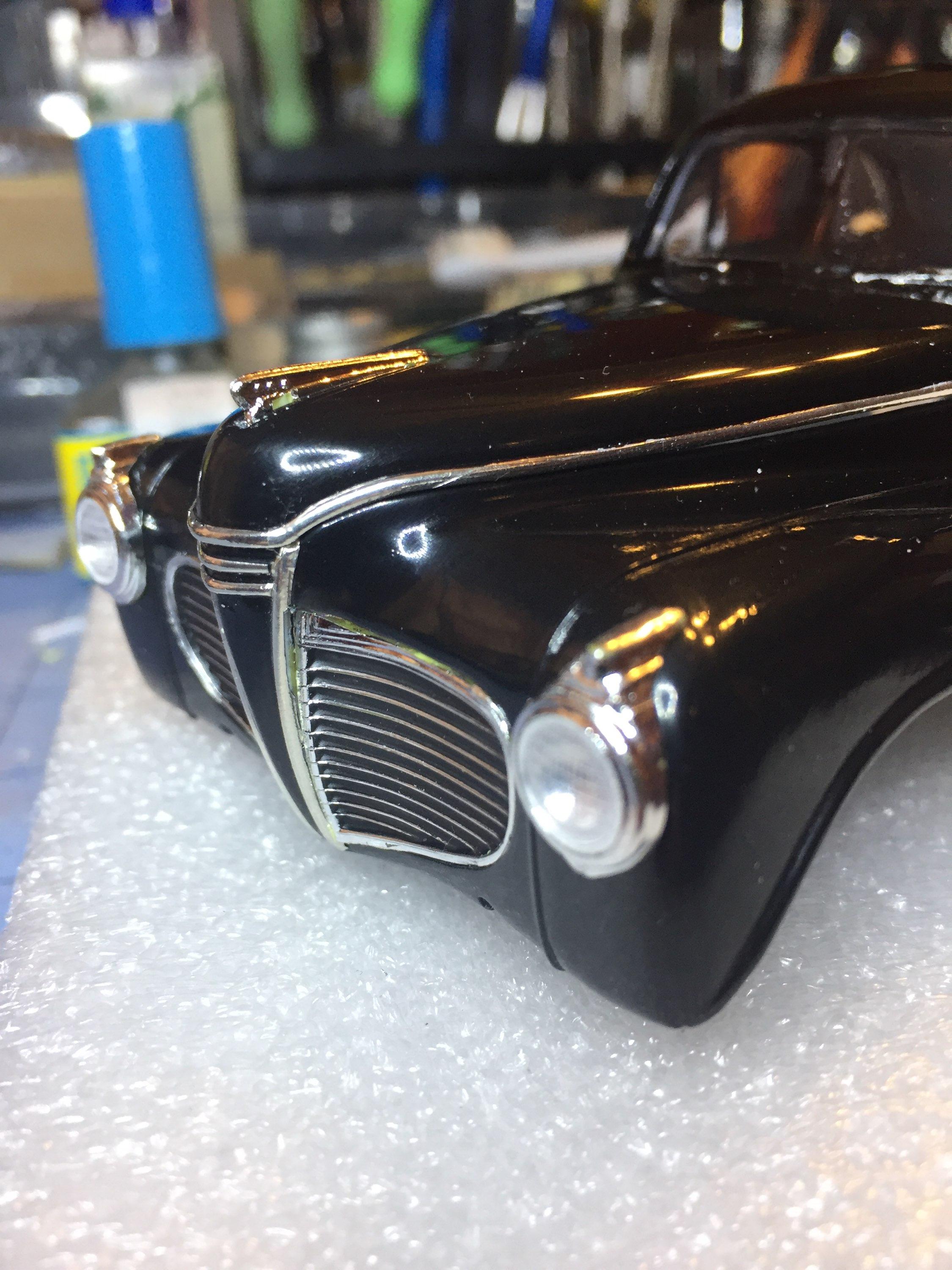

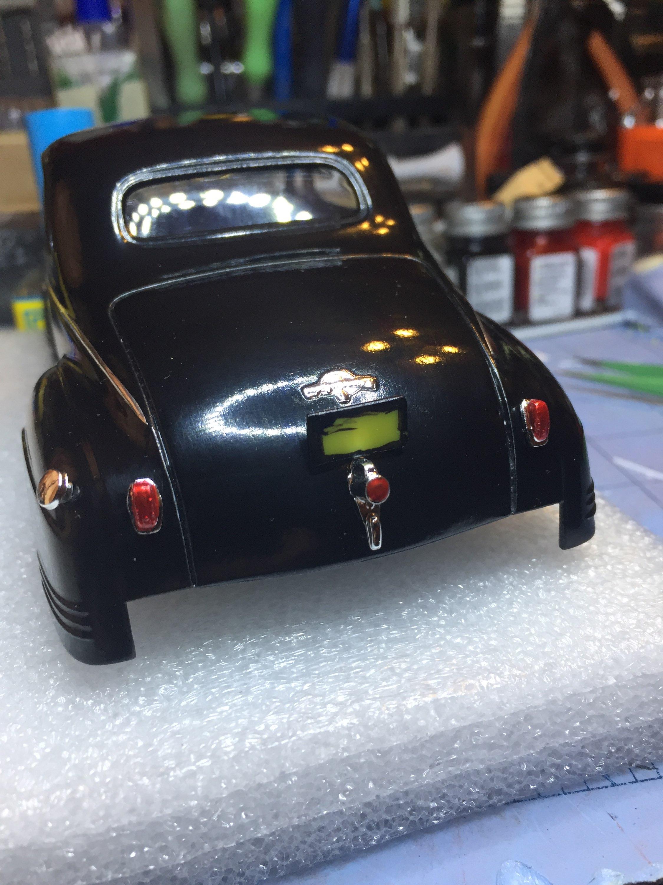

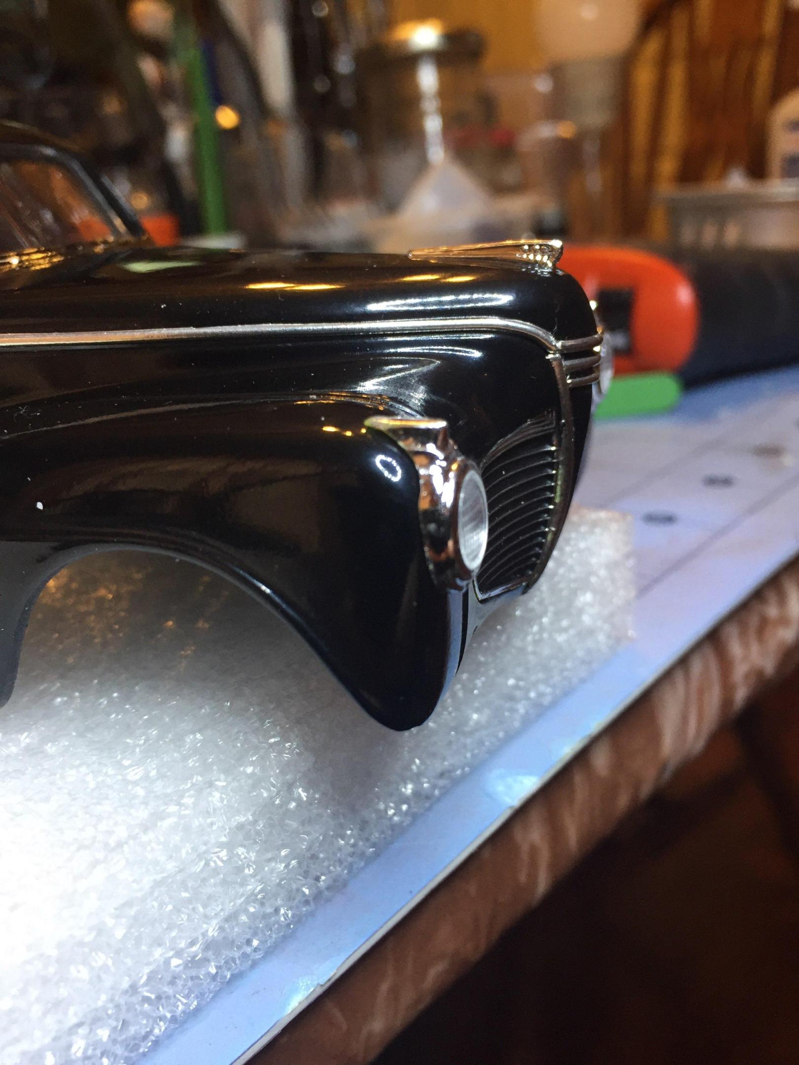

customline Posted March 8, 2024 Author Posted March 8, 2024 This is how well the body work went. The paint, not so much... I rushed it and made a mess of it but I'm OK with it. I gotta finish up a few things and then call it done. I used 5 minute epoxy to hold the headlights from the inside as well as the glass. The rear plate mount, trunk handle and the tail lights are pinned. Thanks for stopping by. By the way, there's a third tail light. Who knew? ? 1
David G. Posted March 8, 2024 Posted March 8, 2024 The chrome trim strips never looked so good on this kit. David G.
customline Posted March 8, 2024 Author Posted March 8, 2024 1 hour ago, NOBLNG said: It’s looking really great Jim!?? The narrative is "its an Earl Scheib paint job" ? 1 hour ago, David G. said: The chrome trim strips never looked so good on this kit. David G. Thanks to both of you for your kindness ?

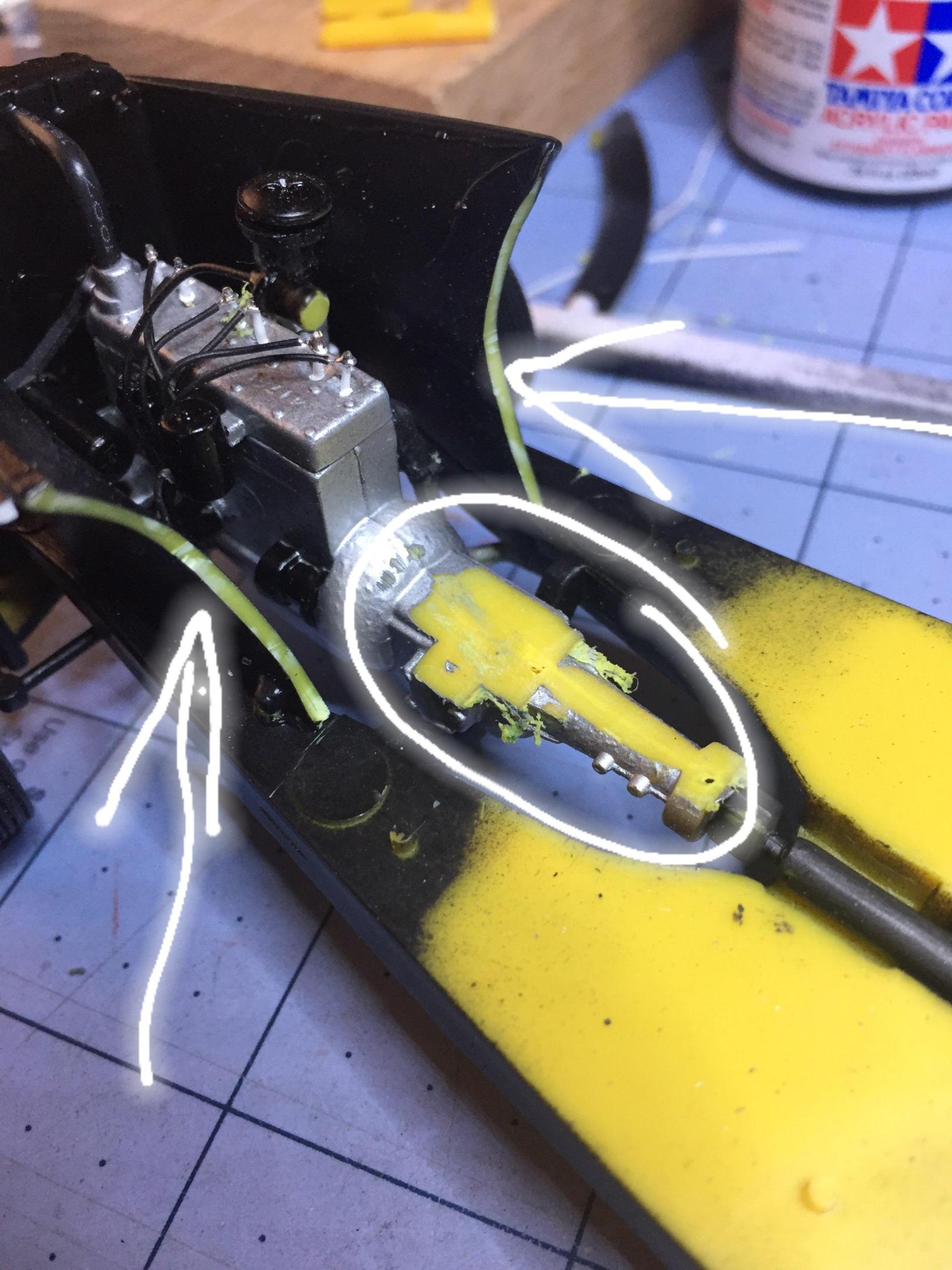

customline Posted March 8, 2024 Author Posted March 8, 2024 Update: While trying to detail the interior tub, I was distracted by the fact that the floor does not extend to the full width of the body ? which I already knew and had decided to "fix" ?. So then I thought I would do a trial fit of the tub and, as I suspected earlier, had to do more "fixing". Using my trusty #11, I removed a very small amount of the rear edge of the inner fender panel at a time until I was satisfied that that was not the only thing keeping the tub from fitting all the way down on the chassis. So I grabbed my fully charged Dremel Micro and removed a small amount from the transmission ?. OK, nobody sees it. That did the trick! Well, that and I drilled the two front holes on the tub a bit bigger. I'm still playing with the floor extensions; more on that later. ? 2
