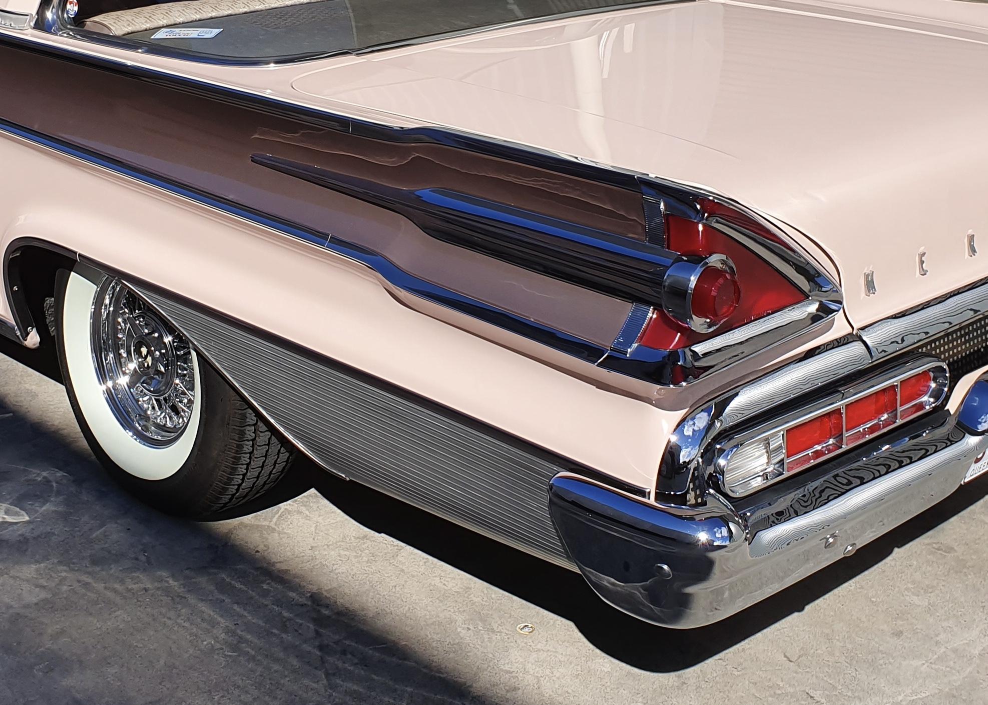

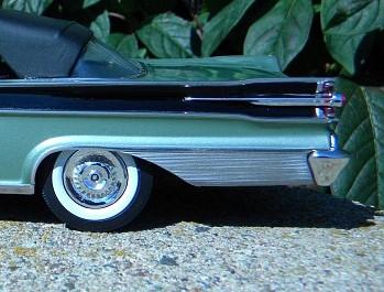

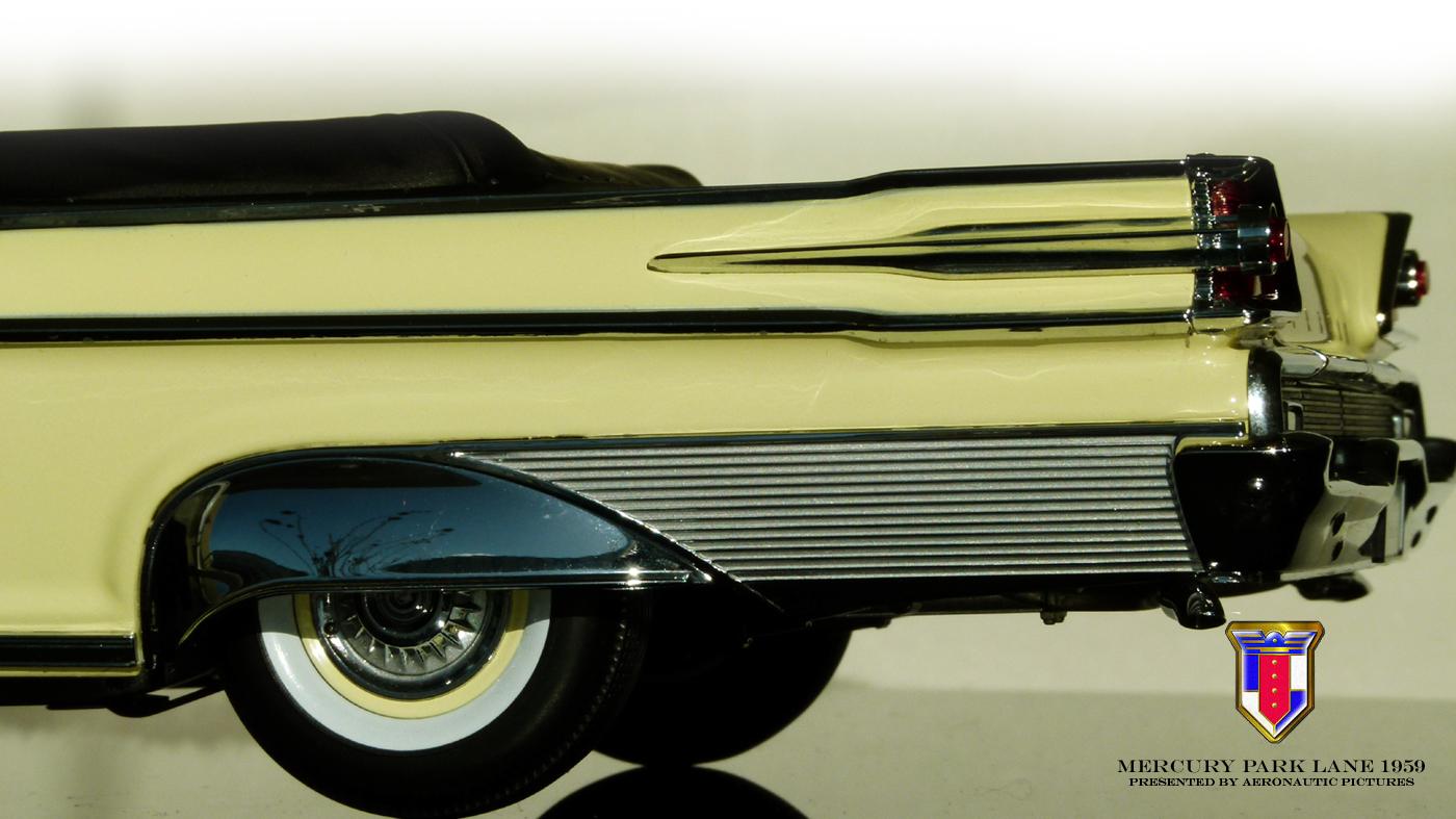

hedotwo Posted January 25, 2024 Posted January 25, 2024 I'm about to start on a 59 Merc convertible that has a bunch of skirt rash. I've done a hardtop 59 previously that had about the same amount of rash that I chose to just remove to smooth, then foil with a matt chrome. Before I start the work on this convertible I thought I'd ask for any suggestions on how to possibly recreate the fine texture on the lower portion of the fender. I'm attaching a photo of Steve Guthmiller's beautiful 59 for what it should look like. Thanks!

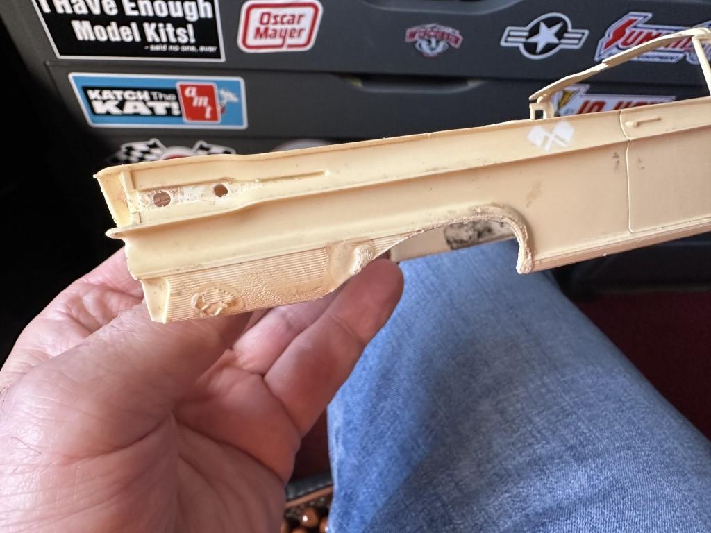

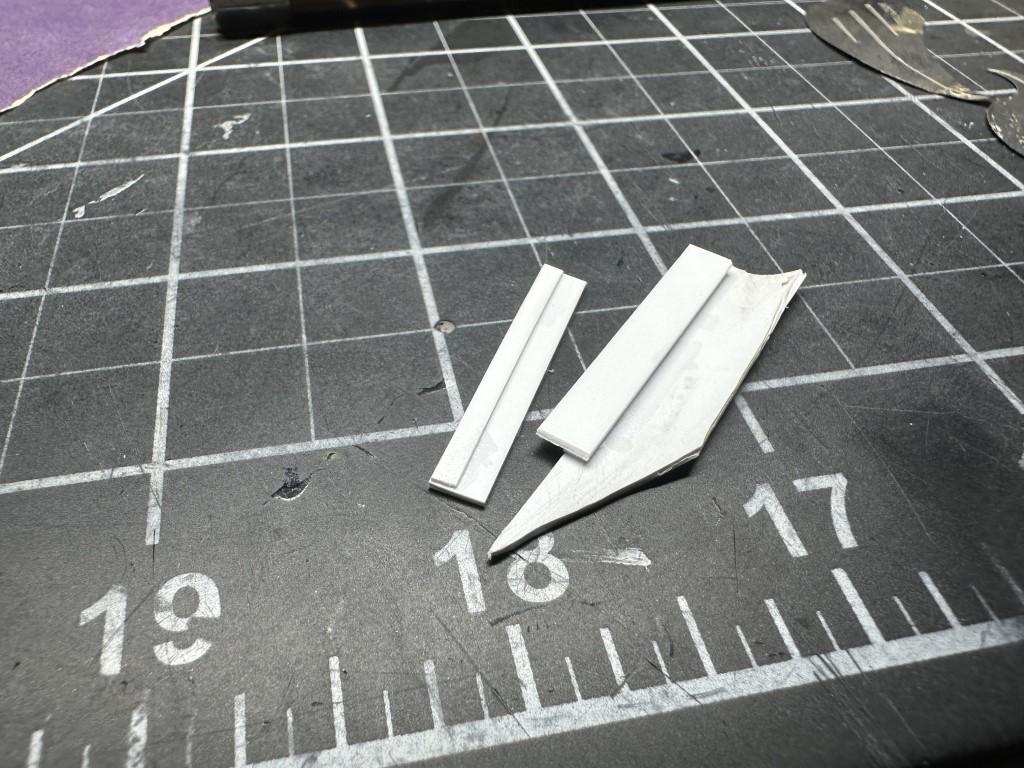

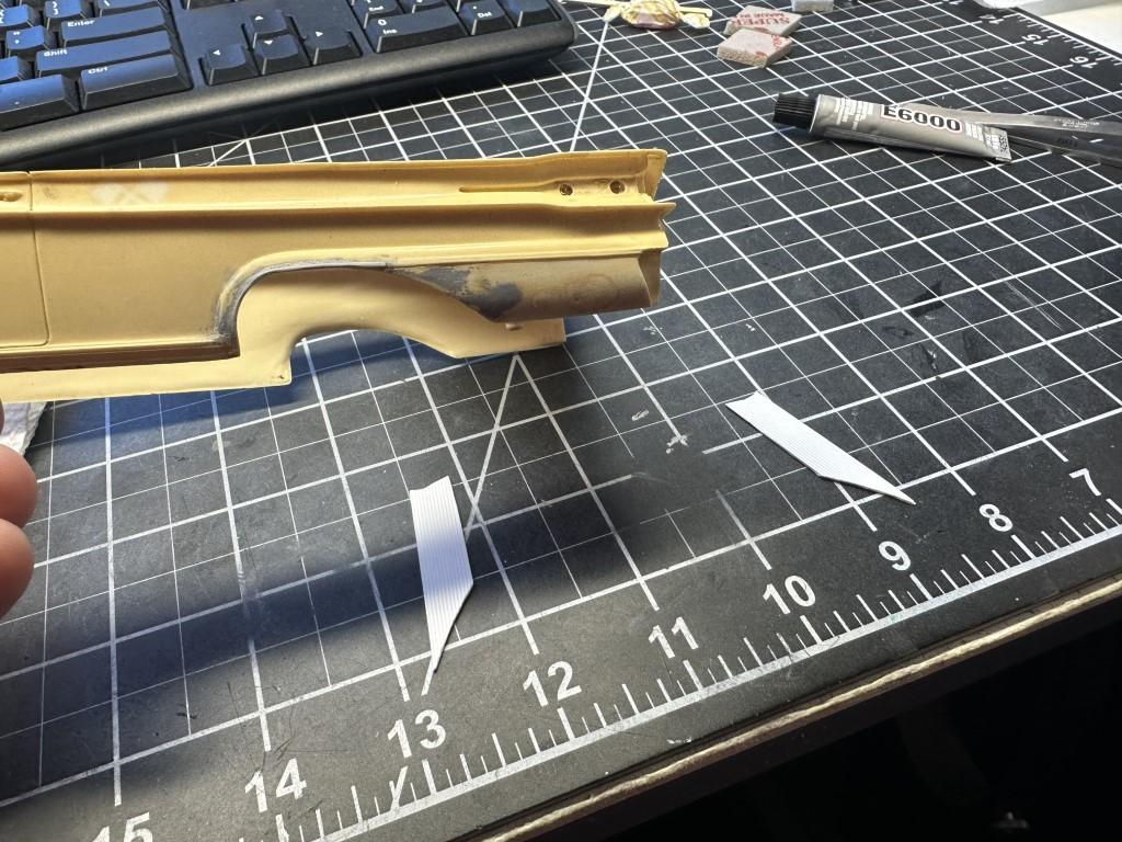

hedotwo Posted February 4, 2024 Author Posted February 4, 2024 I made a template with foil of the rear quarter panels, taped to the ribbed sheet and then cut and sanded to fit. Now, I just need to do the cutting of the existing panels (gulp) and then trying to get a slight bend under on these 040 thick pieces. If they don't bend and stay I may try and sand them down to a thinner thickness and try again. 1

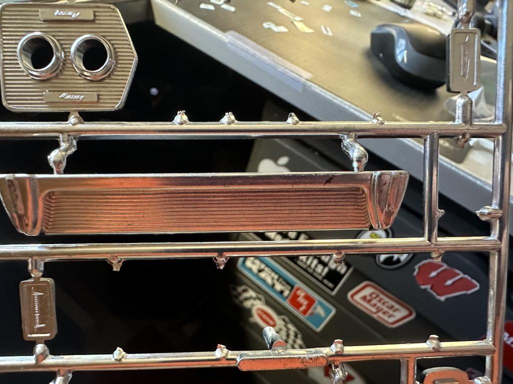

ChrisBcritter Posted February 6, 2024 Posted February 6, 2024 Rich, there's a custom rear bumper in the AMT '66 Mercury kit; it has a finely ribbed pattern that should give you what you need. You'll need one for each quarter panel. Should be easy to find since the kit's been reissued so many times.
hedotwo Posted February 6, 2024 Author Posted February 6, 2024 Thanks for the suggestion Chris... had I known this I may not have bought a sheet of the corrogated, although I can always use it in the future. Turns out the Merc rear bumper is the same as the Evergreen sheet as far as rib spacing and depth so I'll just use the two pieces I've already cut from the sheet. Just hoping to get them to bend under a bit to match the existing. This project is next in line on my bench...

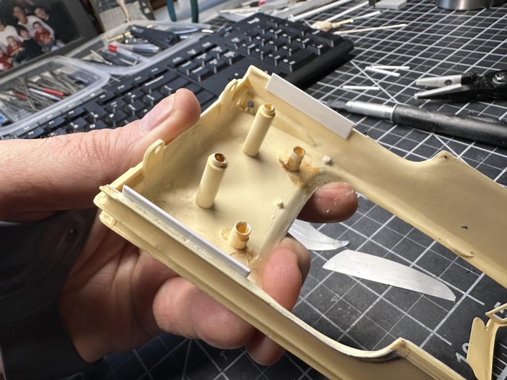

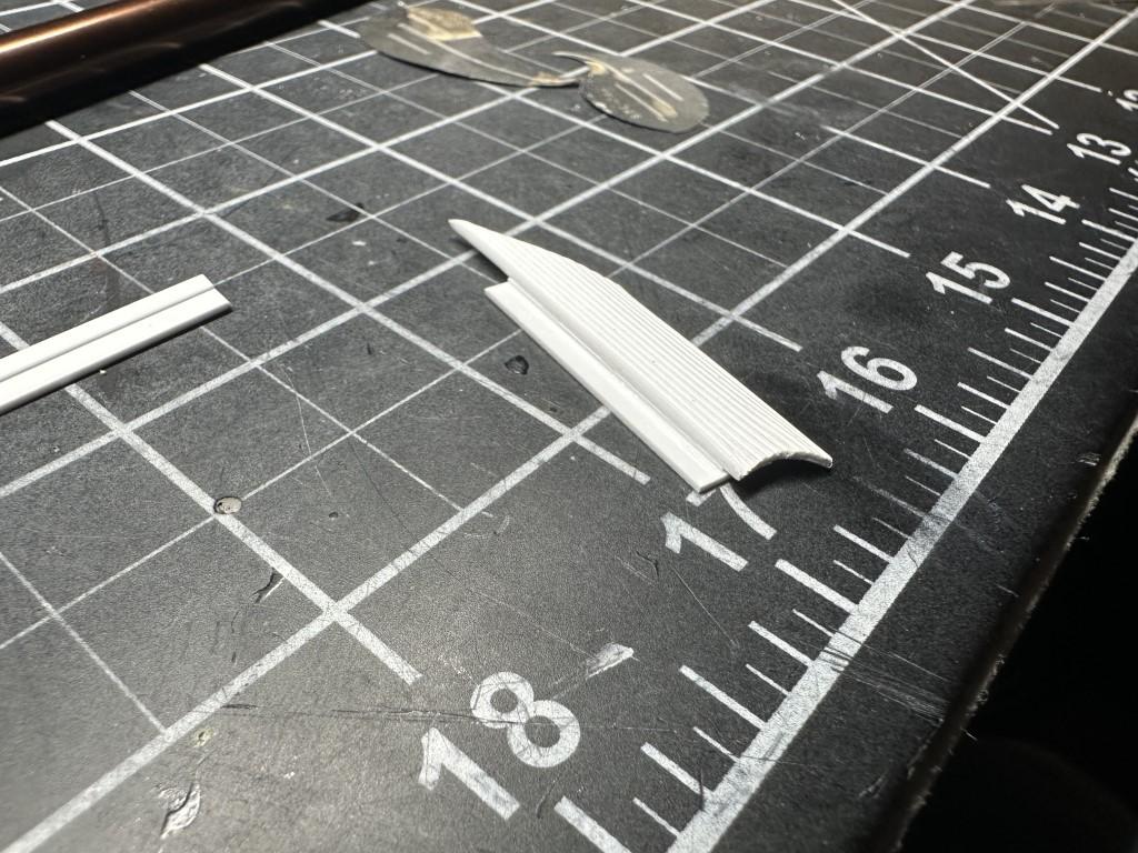

hedotwo Posted February 8, 2024 Author Posted February 8, 2024 So I went ahead and did the quarter panels. Turned out ok, but not great. I used a PE razor saw to remove the old quarters and fortunately the body trim kept the saw nice and straight. I sanded down the height of the ribbing a bit and bent the pieces just a bit by laying them on a 1/4" rod and pushing hard, just enough to get them to wrap under instead of being flat. Not the smoothest result, but better than nothing I guess. I added a couple of 030 strips to add strength to the pieces when I attached them. 1
