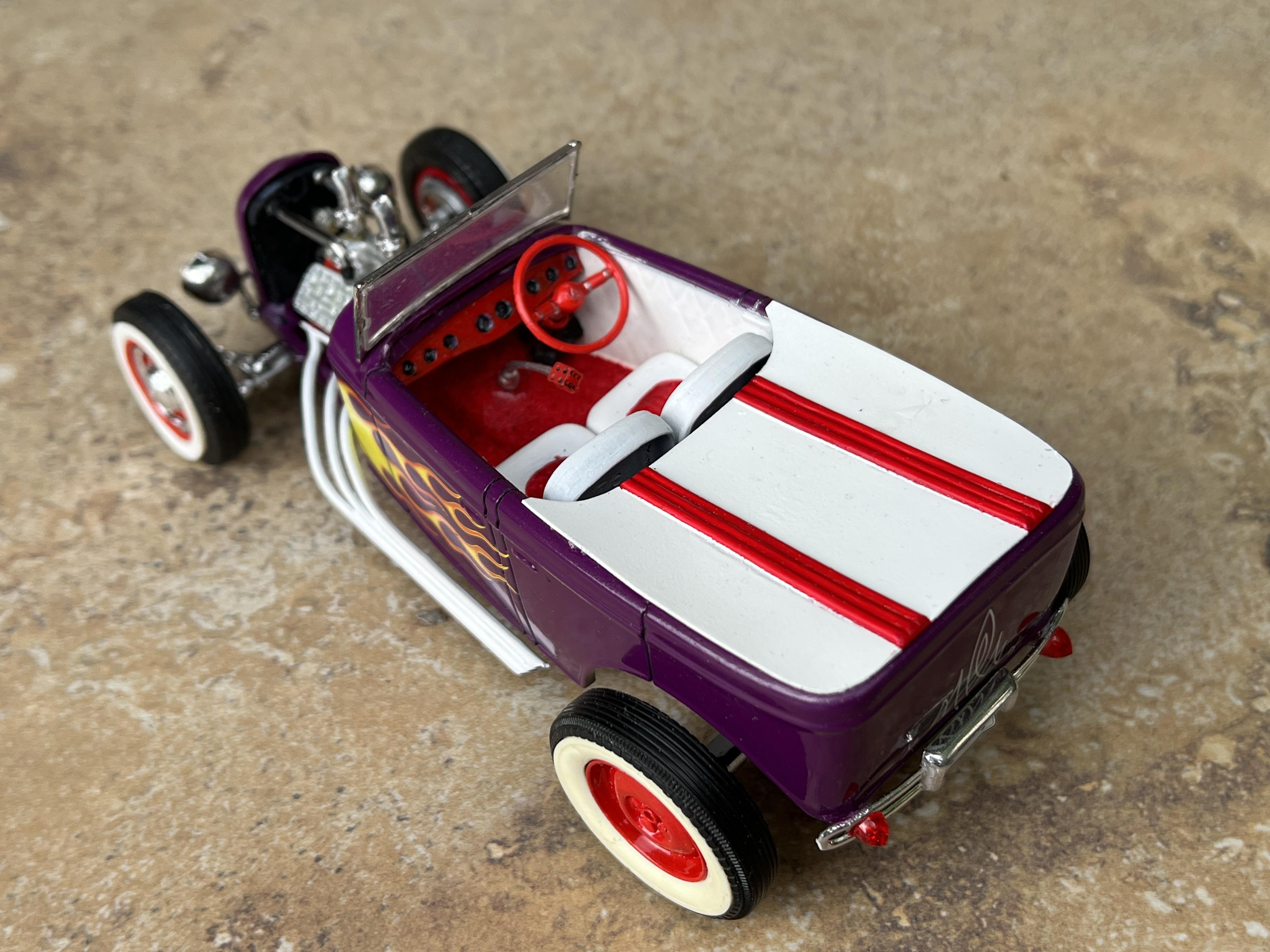

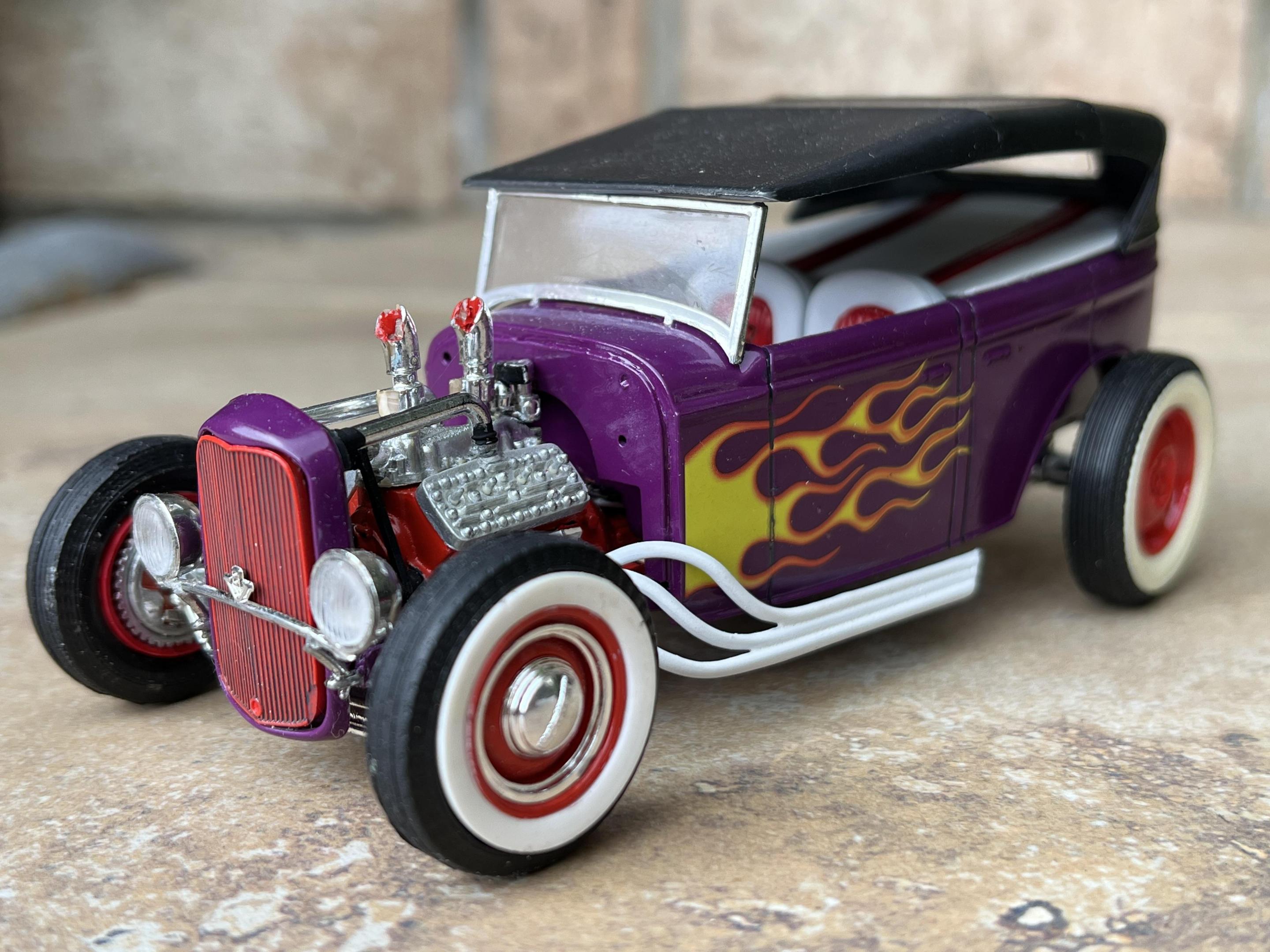

Last year I built a similar styled model but based on the somewhat clunky MPC Switchers 32 phaeton. Hope you don't mind me popping it on here for inspiration, not that you seem to need it!
Cheers
Alan
