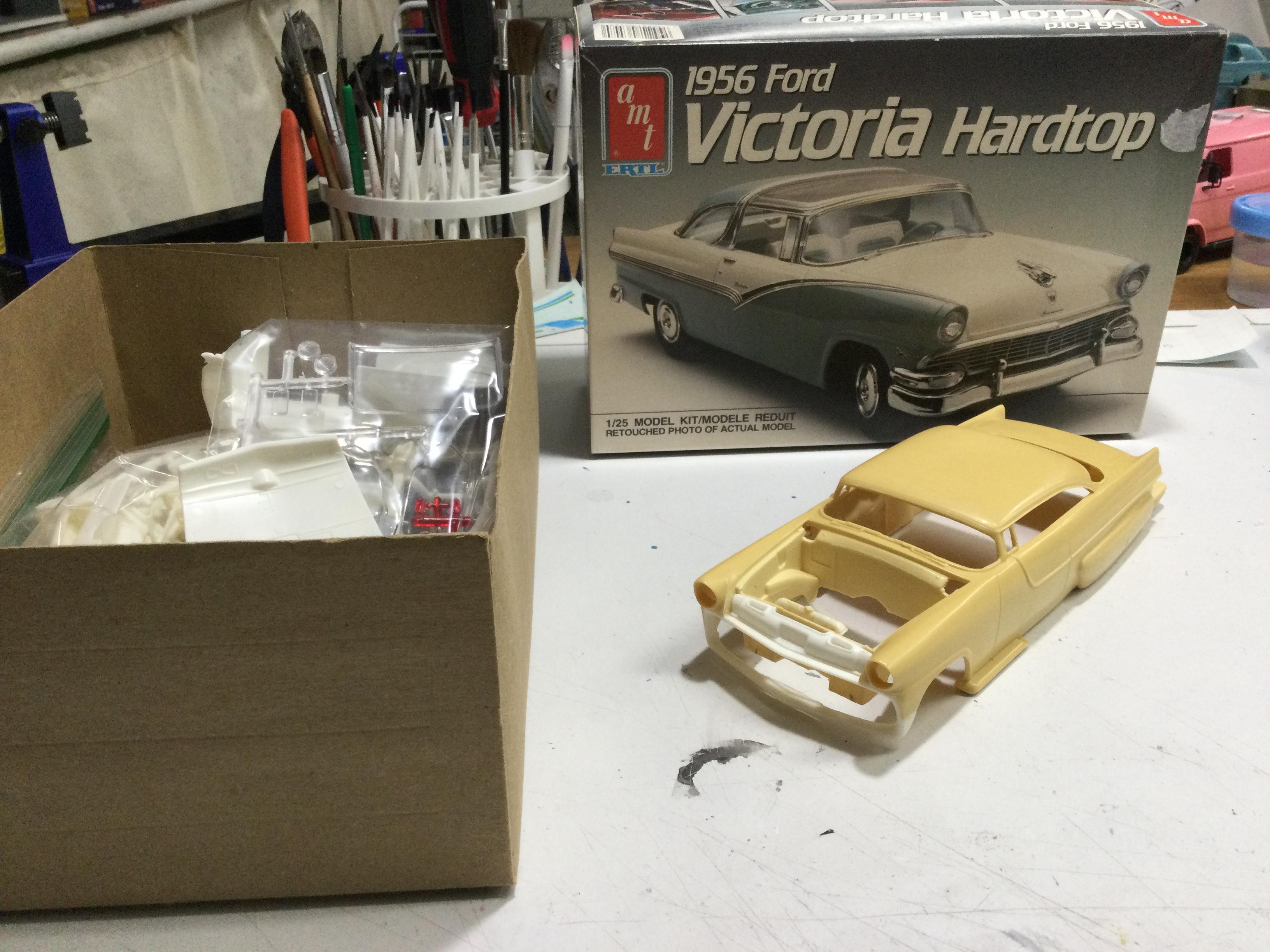

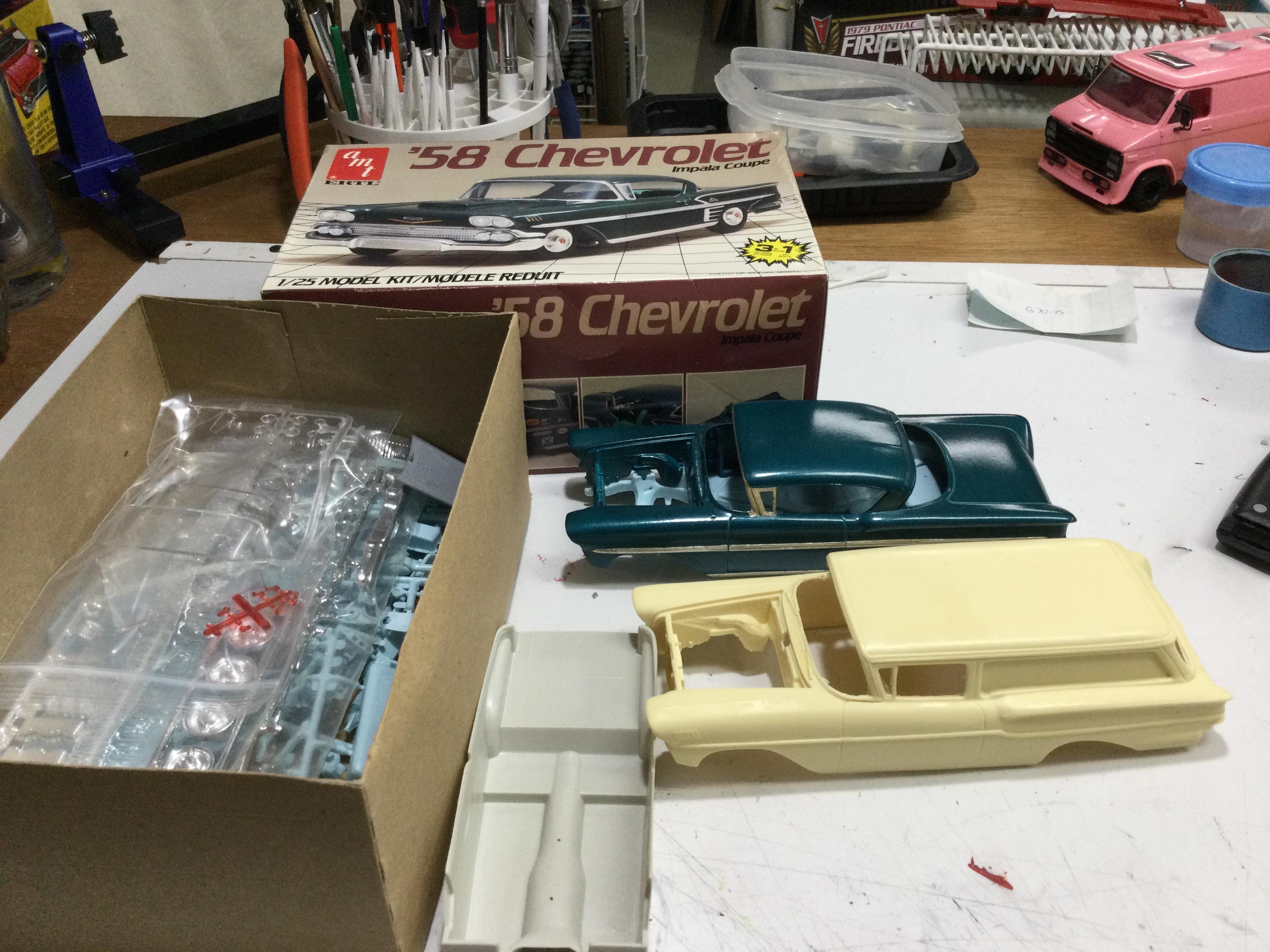

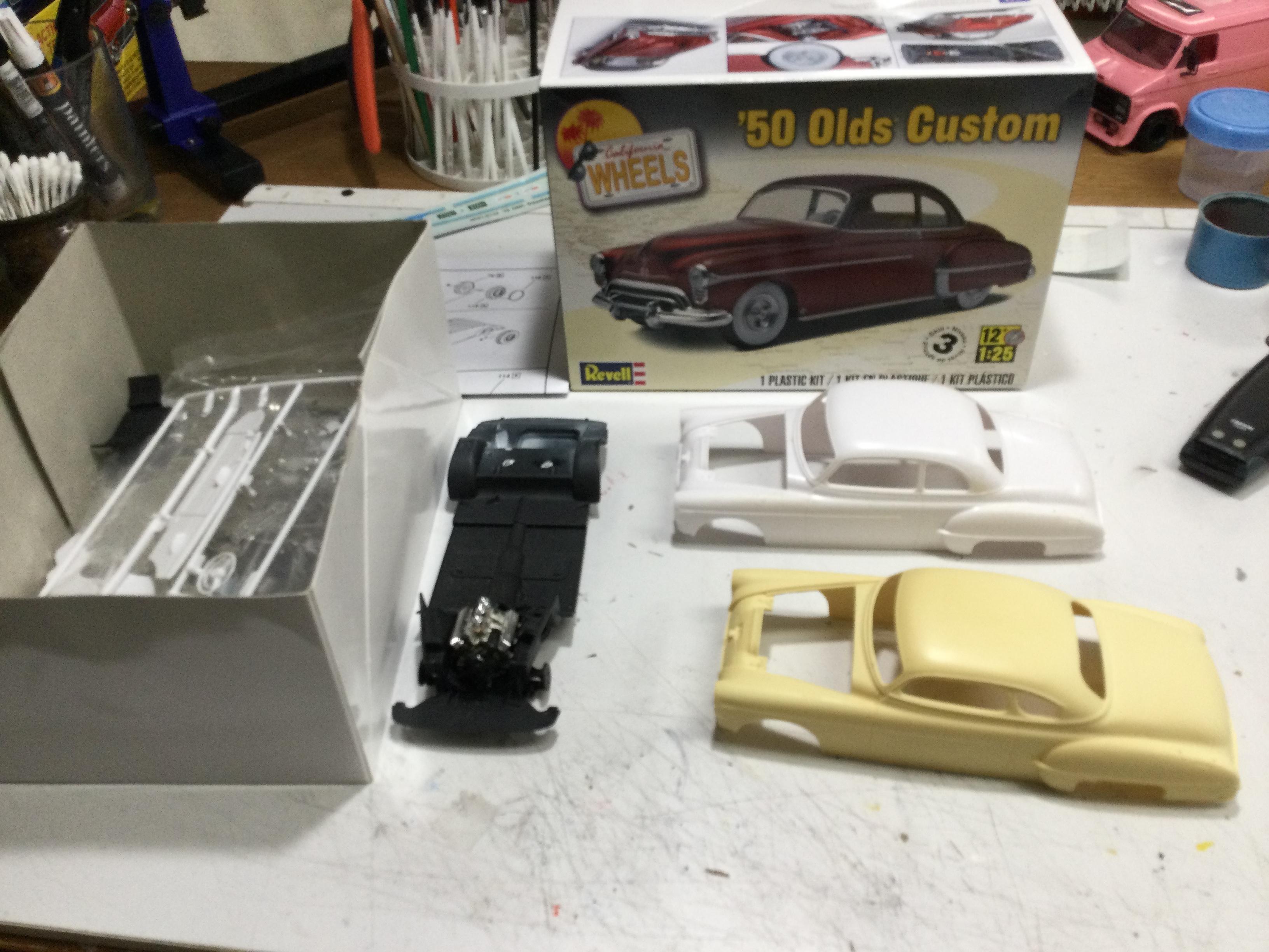

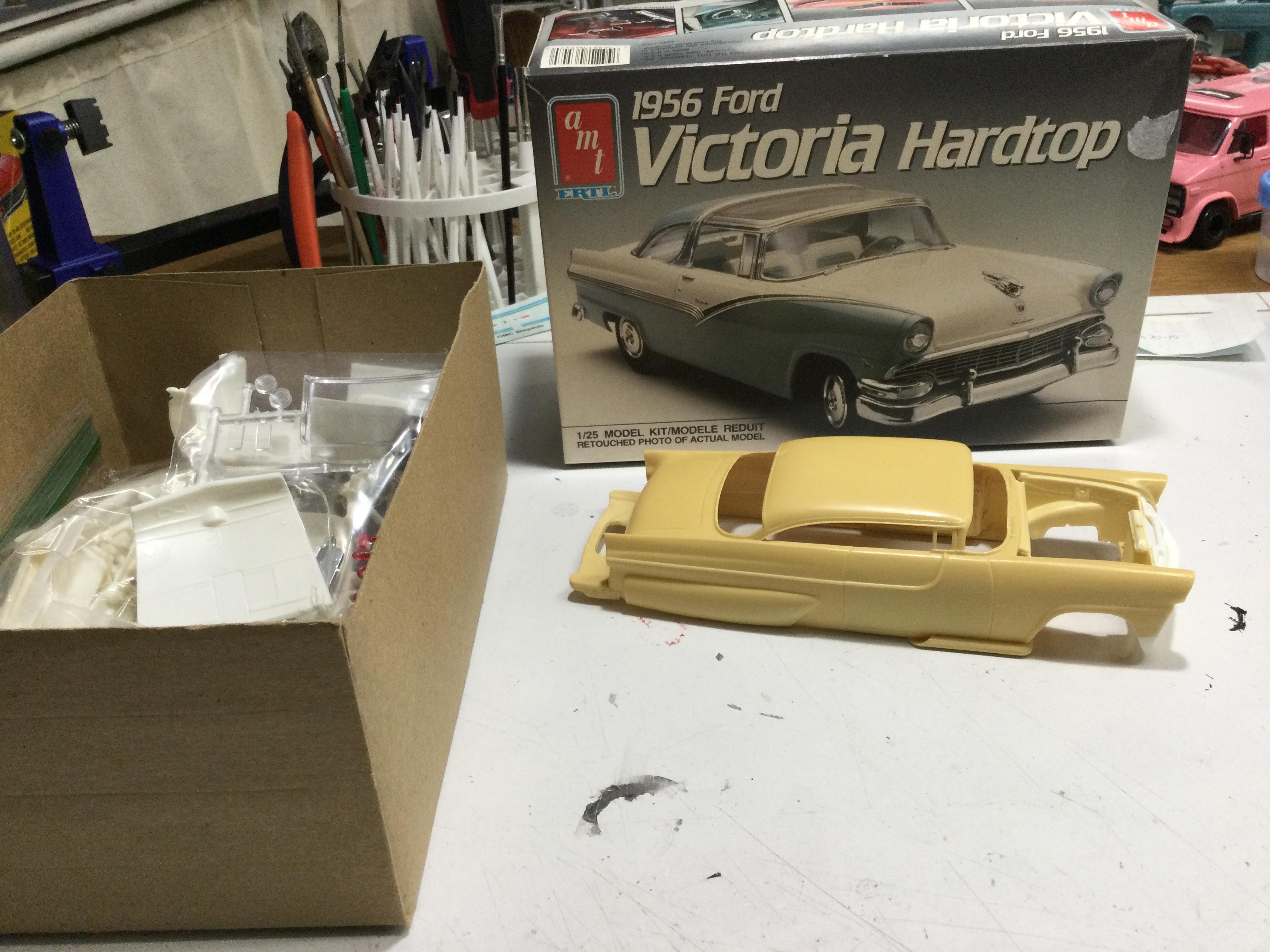

ewetwo Posted February 29, 2024 Author Posted February 29, 2024 Here are photos of the resins with the donor kits they were in. Though some are missing tires and wheels.
