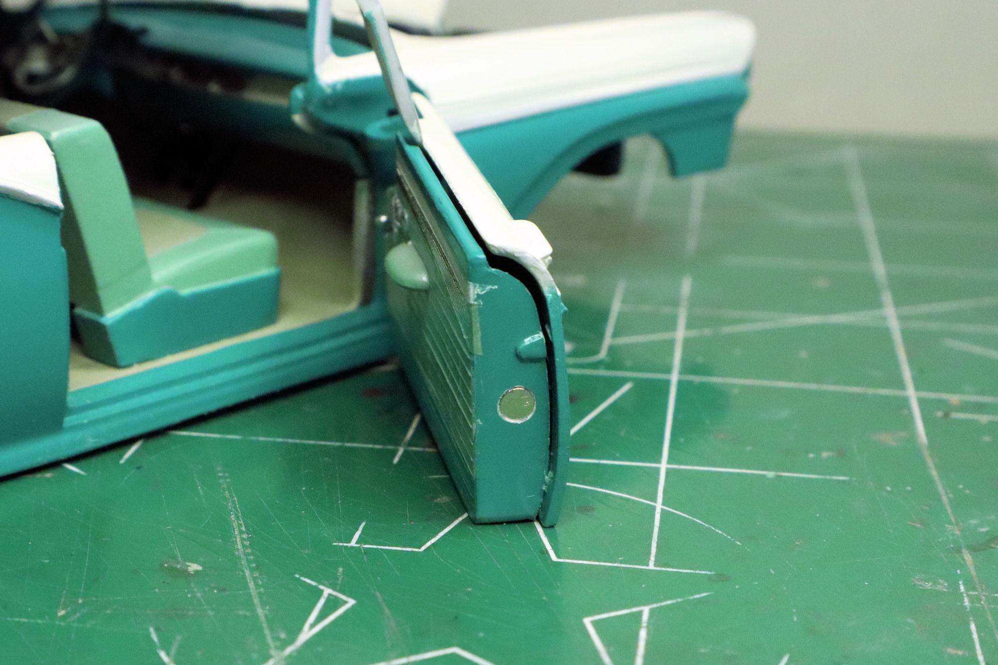

Hello Everybody!
It's time for a quick update on the '57 Ford.
I've installed the micro magnets in the body and doors.
Now it's time to check the alignment and adjust as needed.
This is just a crude test fit to check basic alignment and function. Assembly is just a mockup at this point.
As always, thanks for following along and always feel free to share your thoughts, opinions and insights.
David G.

9 hours ago, customline said:
Using those little magnets to keep your doors aligned is worth the extra effort. Good work, Dave.
Thanks Jim. I do like the way that they are working out so far. I think I'll be using them a lot more often in my future builds.
I mean I do have 300 of the little buggers! ...well, 296 now.
But at the rate I build that should still be more than a life-time supply.
David G.

Those magnets are a great idea to keep the doors aligned properly. I think I need to try that on something in the future.
Overall I really like how the Ford is coming along. Especially the color choices on body and interior are spot on. This will be a very cool model when finished.
Link to comment
Thanks for your kind comment Niko. Color schemes are a big factor for any build but more so for a Fifties era car when paint options were one of the main selling points.
I'm very pleased with the magnets so far. I've already started mentally planning uses for them in my next three or four builds.
David G.

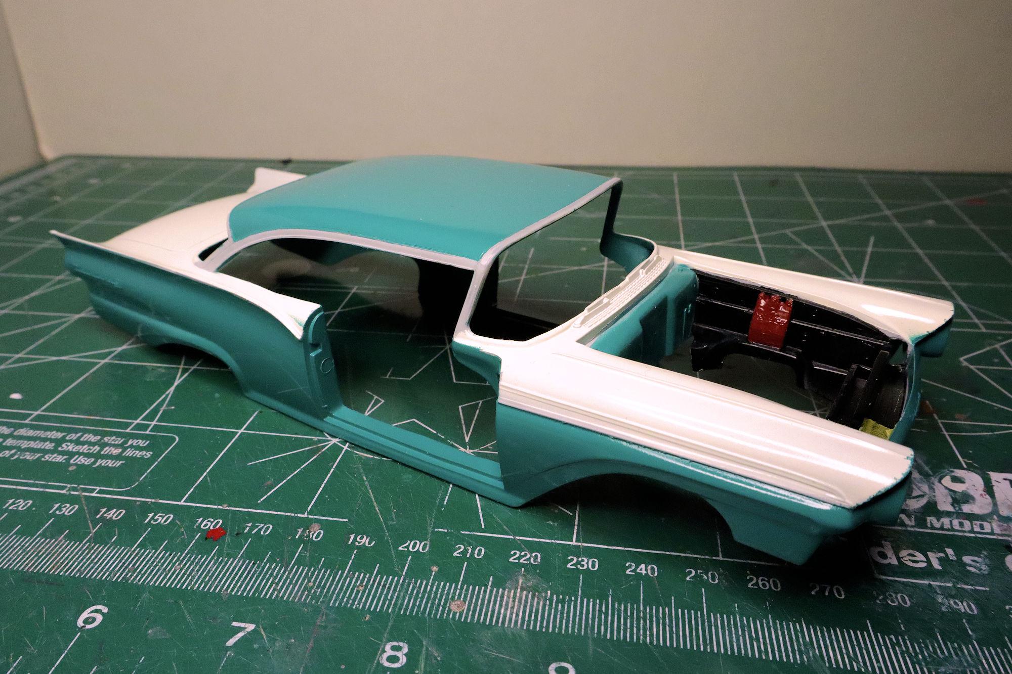

Hello Everybody!
Progress has been slow on this one lately as I've been focusing most of my attention on my Disney Love Bug build. (link)
It's a Polar Lights snap together kit and I've allowed myself to be distracted ease of the build and the quick results. Working on Polar Lights snap kits is rather like the model building version of eating popcorn. Once you start, it's hard to stop as long as there's still something left in the box.
Anyway, on with the update.
Color sanding revealed some additional paint issues. The paint was kind of thin in some places and I was down to the primer by the time I got it smoothed out.
Which is okay as I planned on spraying another coat anyway.
No, that's not a shiny spot... that's primer.
As always, thanks for taking the time to look and please feel free to comment.

On 3/31/2024 at 8:21 AM, David G. said:
Hello Everybody!
David G.
Just for future reference, you can install those magnets before paint, fill them with a little putty, sand and paint.
That way, they'll still do their job, but they'll be almost entirely invisible.
I use these magnets for creating removable hood hinges, installing them in the body and hinges prior to painting, and adding metal strips to the hood.
You can see in these photos where the magnets have been circled in blue, and then the finished pieces and model.
Steve
Link to comment
Steve
Thanks for the pointer Steve.
I ordered the magnets right about the same time I started the build and didn't receive delivery on them until after I sprayed the first coat of paint. And I wasn't exactly sure how to use them so I had to spend some time experimenting to find the best use for this application.
I figured I could address any appearance issues once I had all that sorted out and got them installed.
I did go ahead and paint the body mounted units and they're rather flush so I didn't feel the need to complicate the build by back-filling them.
This is also a proof-of-concept build too so I'd like to retain some visual evidence of the technique... if only for myself.
Thanks for taking the time to offer your advice and post the supporting examples Steve. You're one of the best builders I know of and I truly value your opinion.
