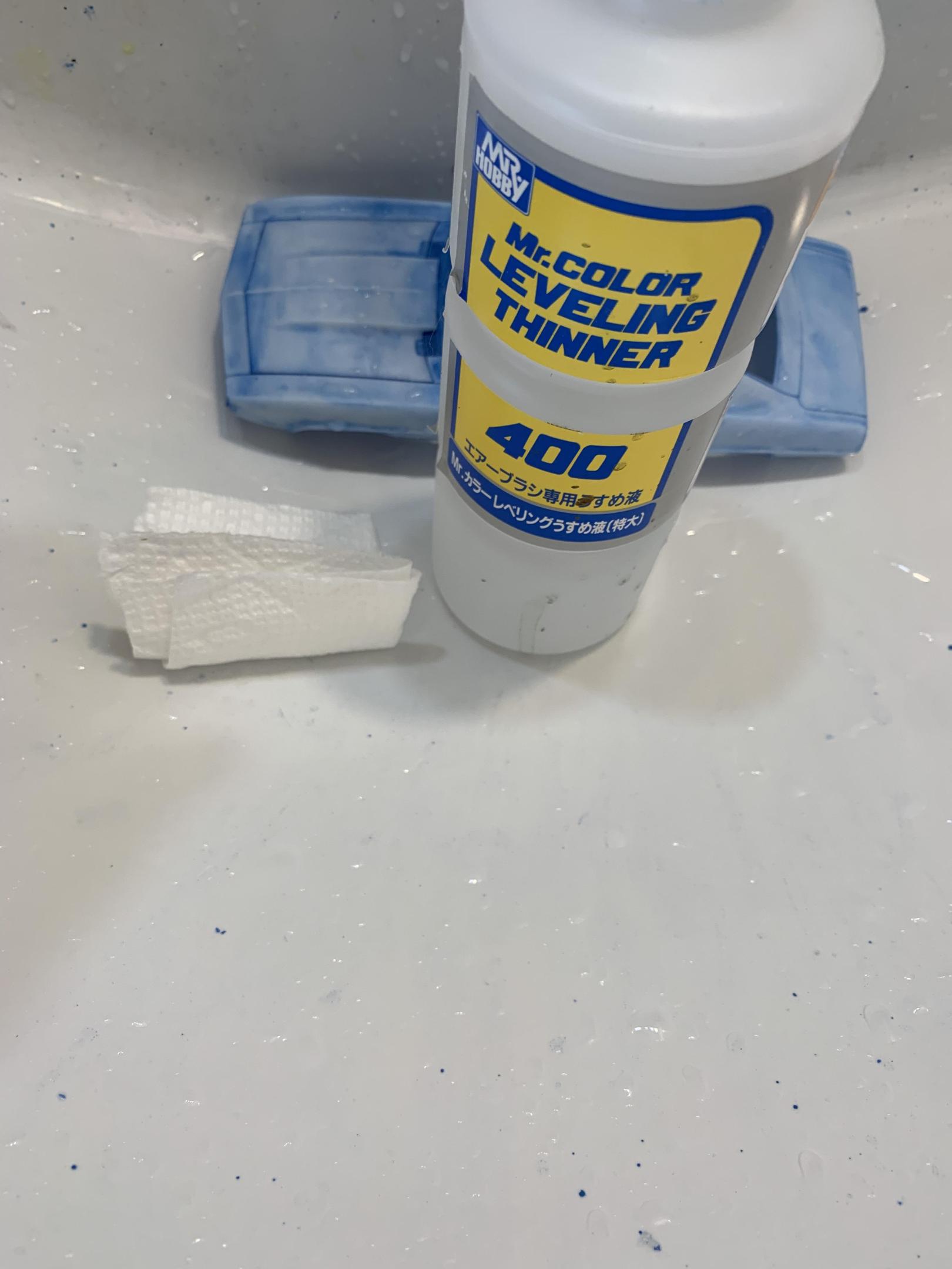

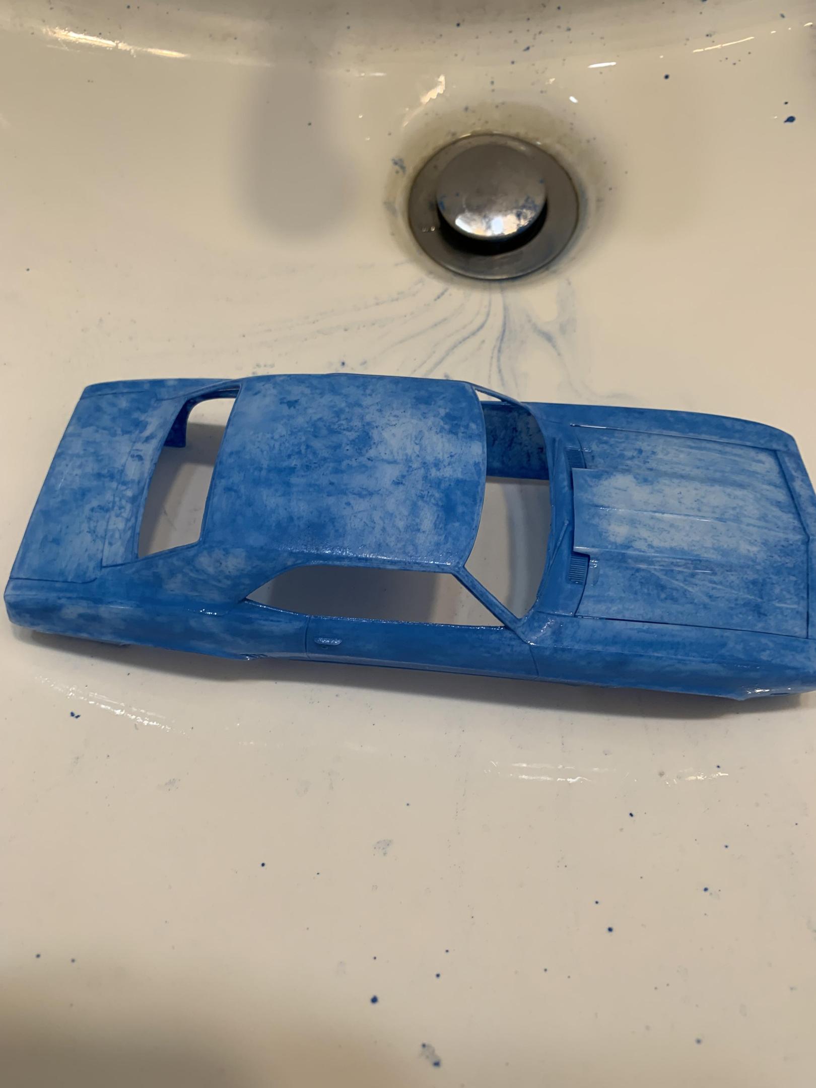

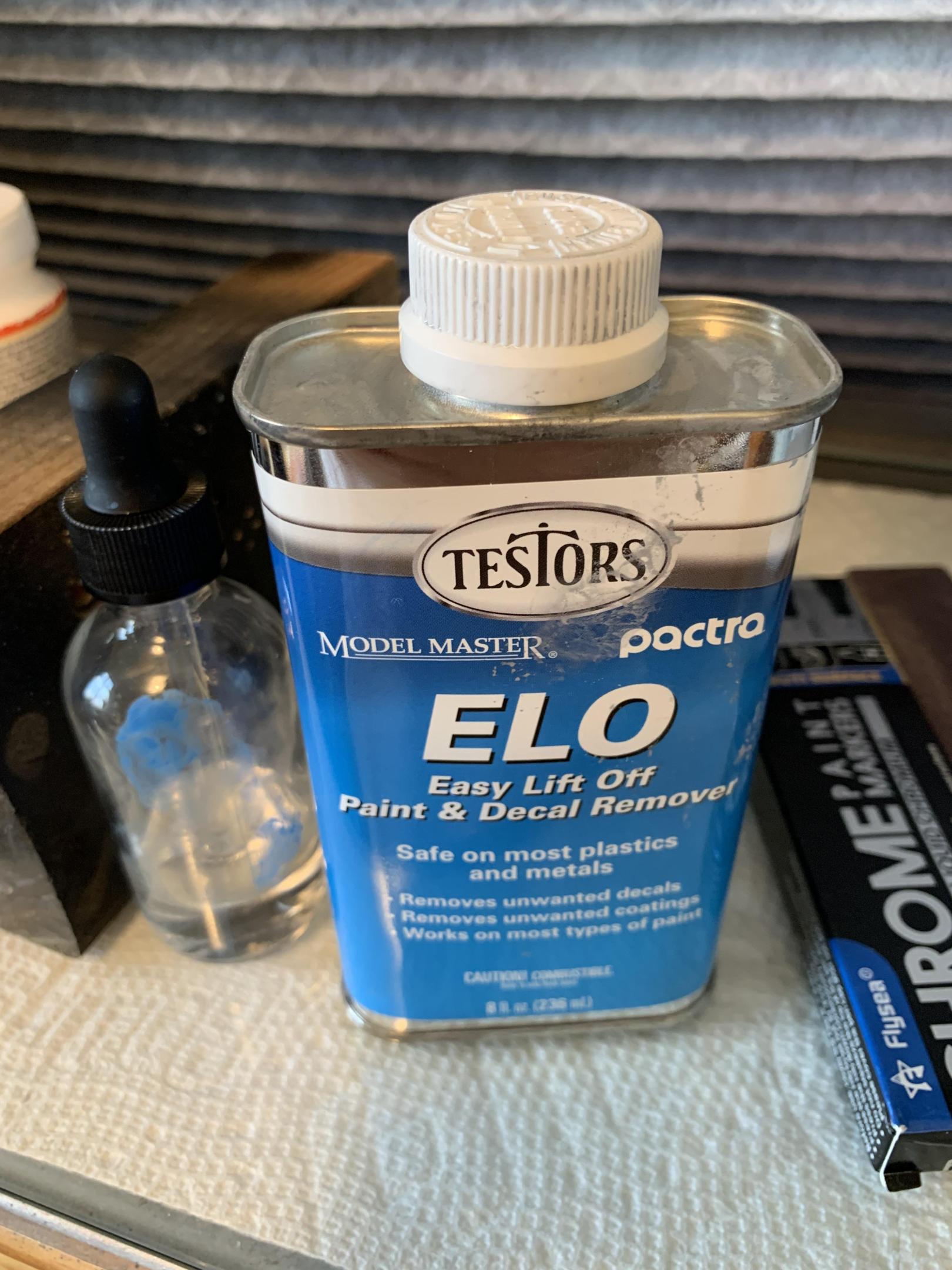

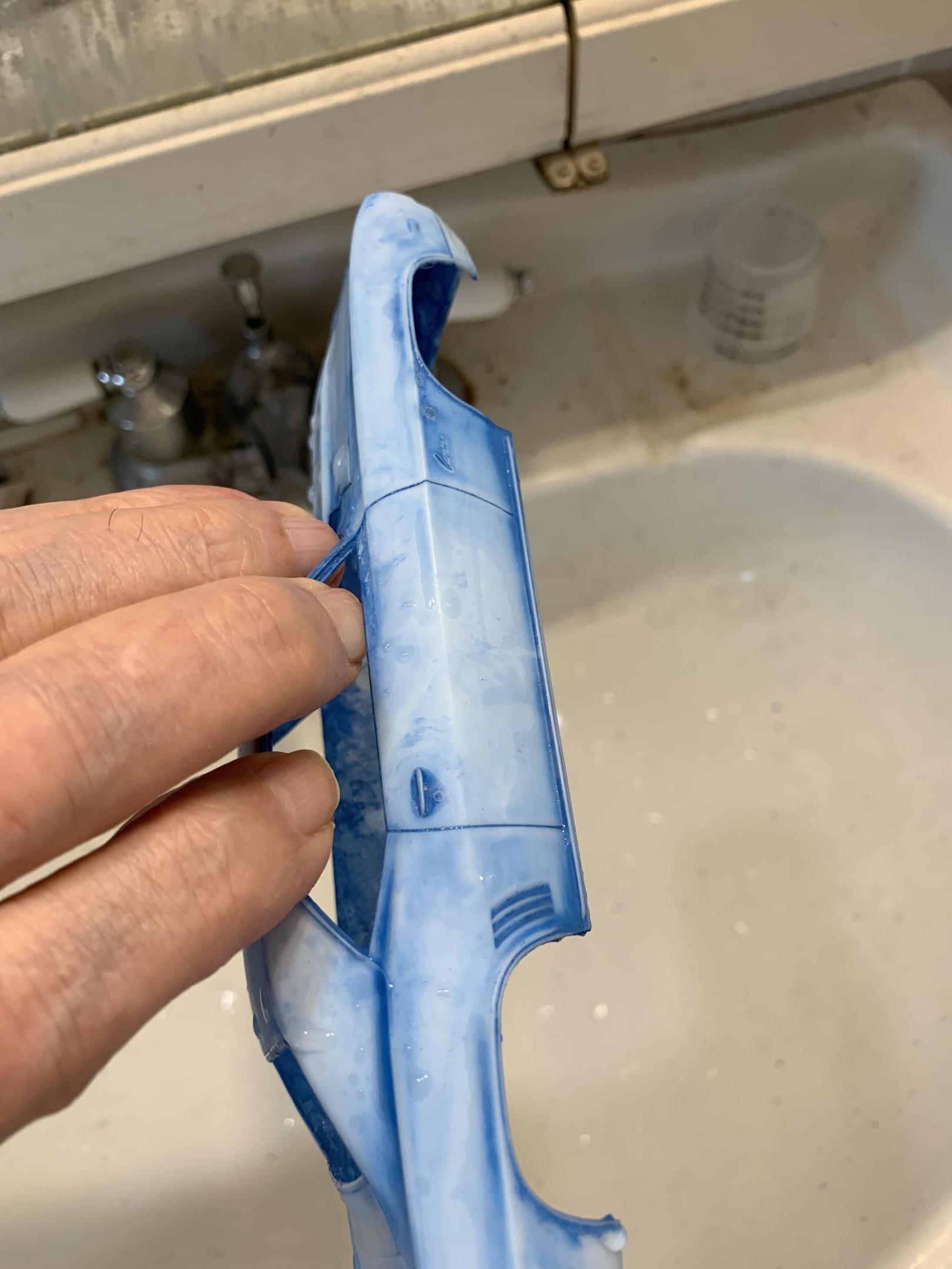

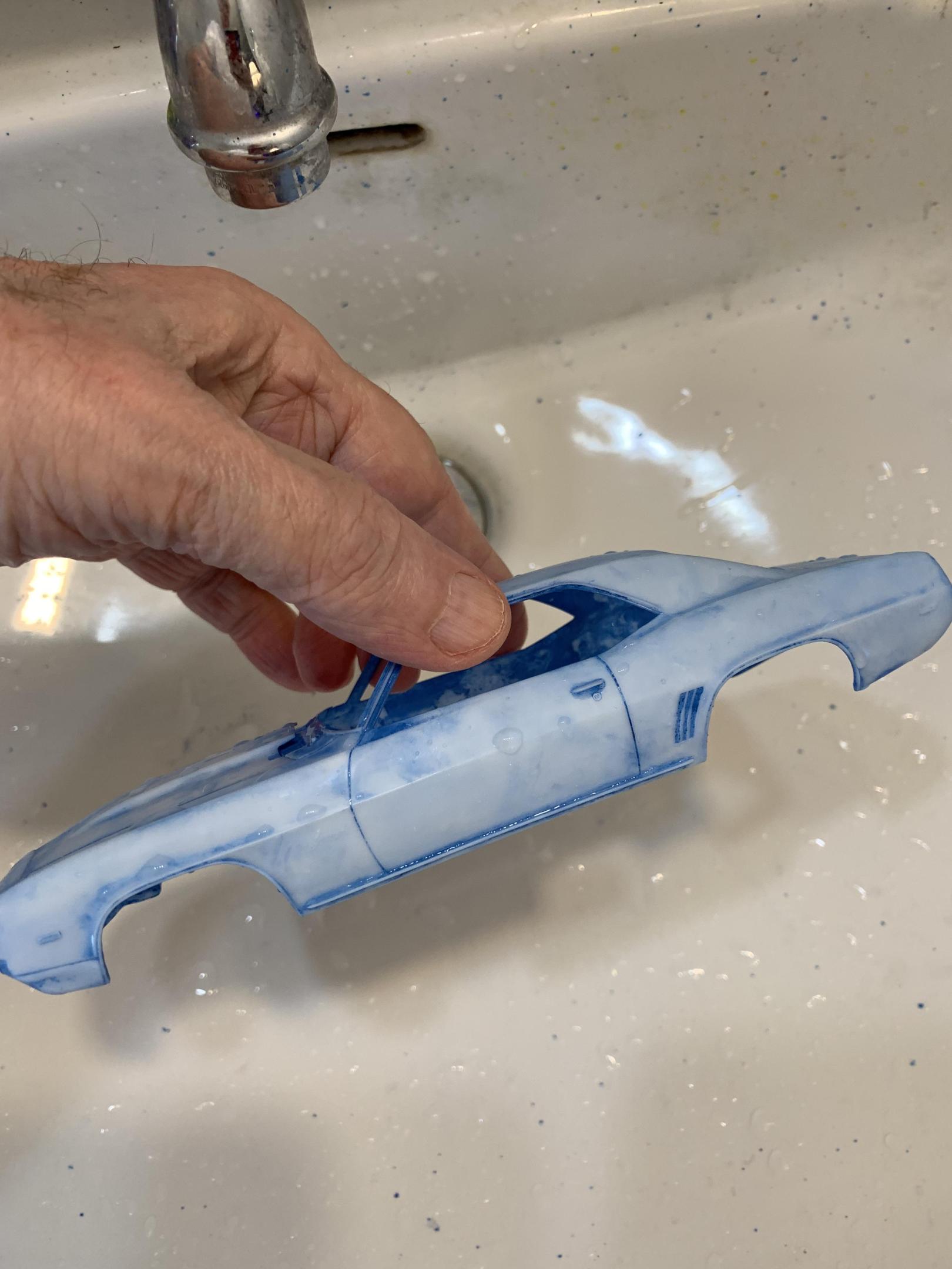

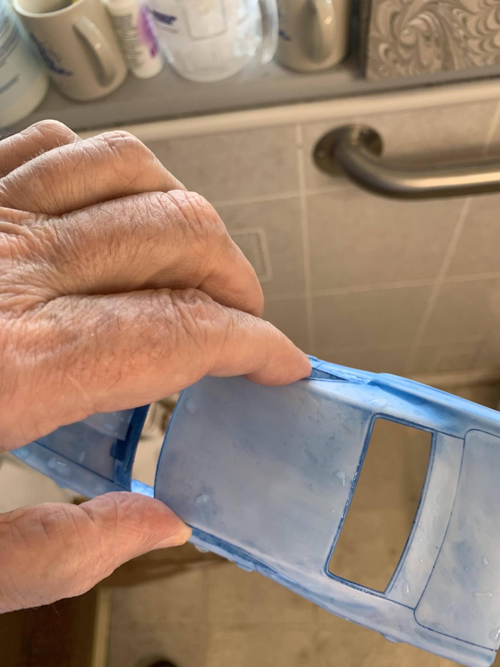

R. Thorne Posted March 14, 2024 Posted March 14, 2024 Sometimes, the bear eats you. I have never had this much trouble removing Tamiya paint before. I soaked it in 91 iso for 5-6 days. Didn’t phase it. Scrubbed it and resealed for 3 days. Nothing. Gave up and used ELO . Took off some of the paint, but not all. Took Mr. Hamade’s advice and used Mr. Color leveling thinner and scrubbed with a paper towel. Bingo! Sometimes, in the process of giving advice, we learn to take advice. TS10 was the paint I used with Mr. Super Clear gloss. This was my first time using that gloss coat (perhaps significant?). 1 1
