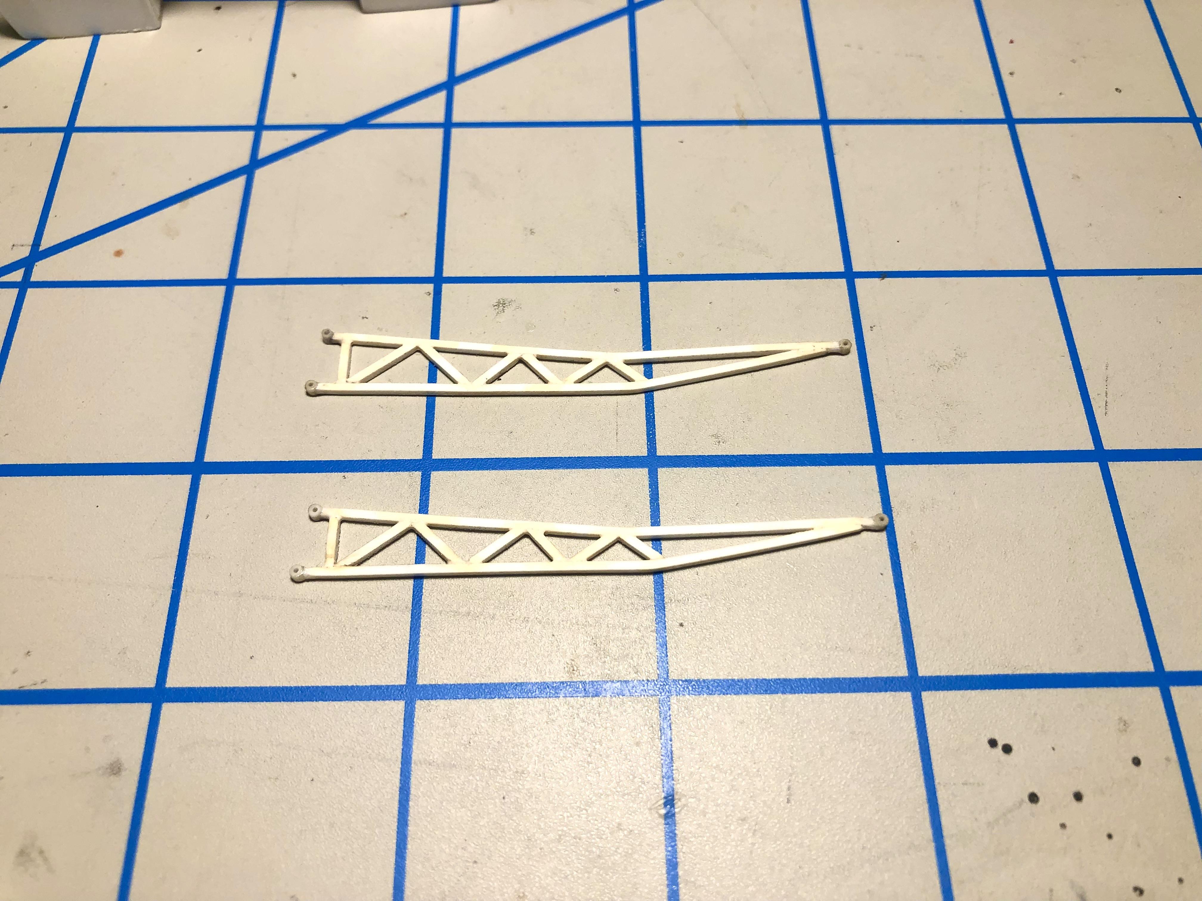

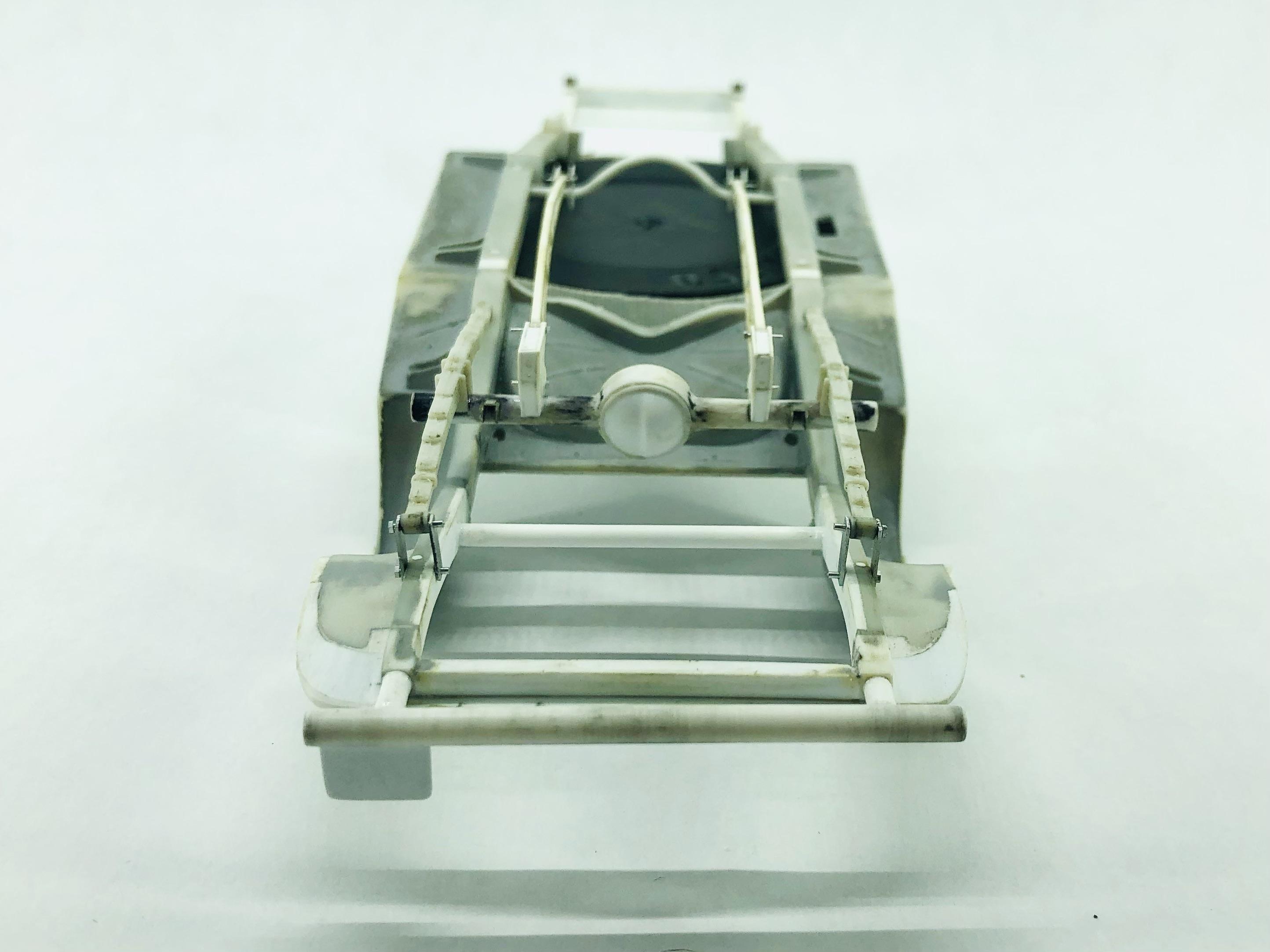

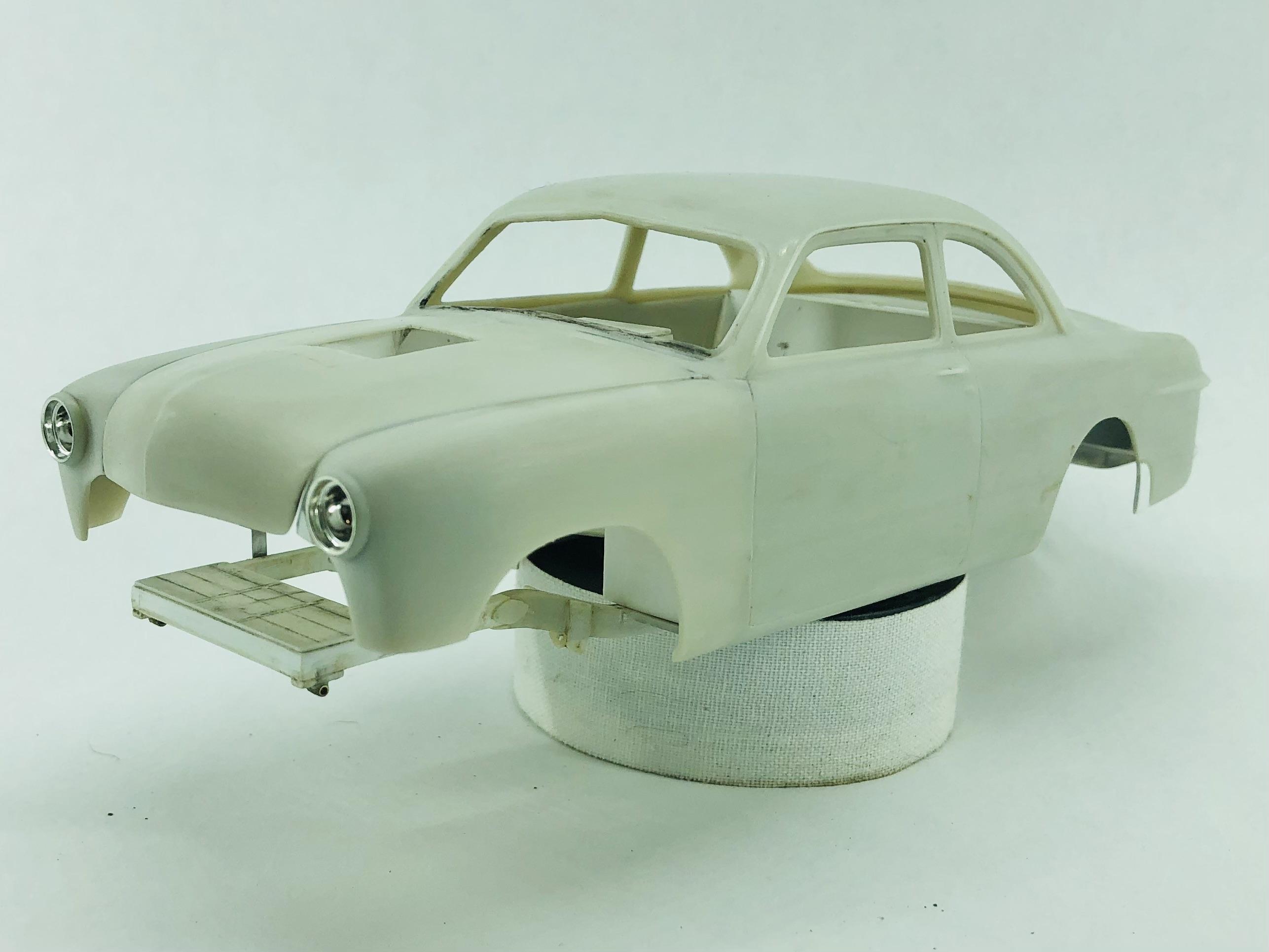

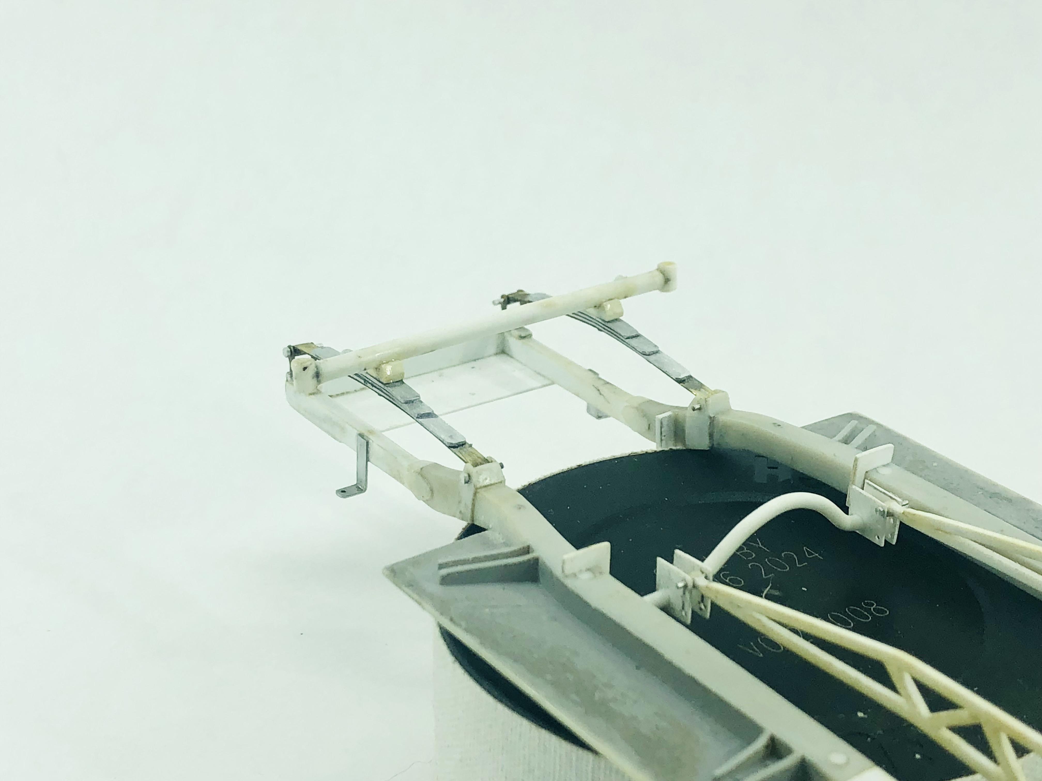

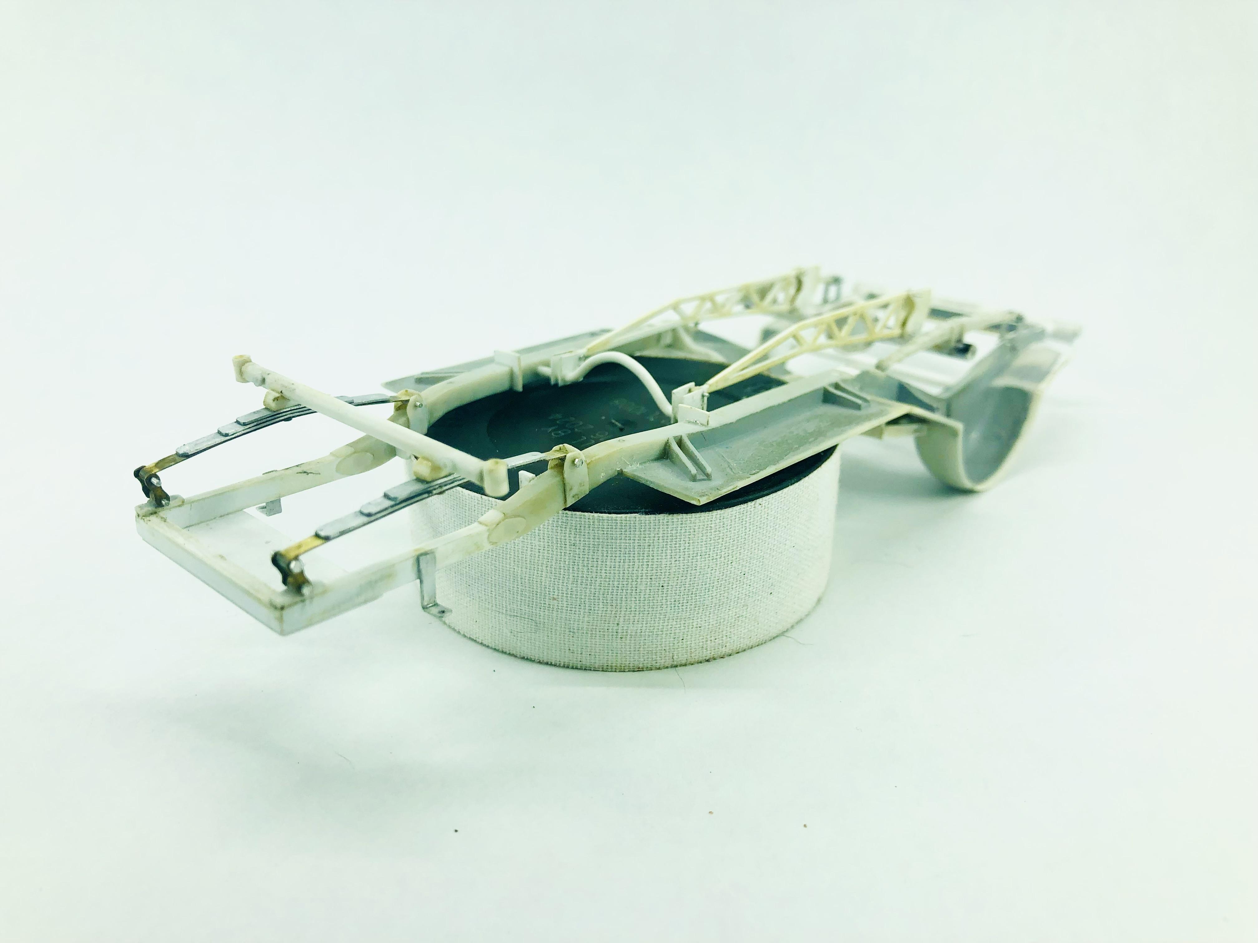

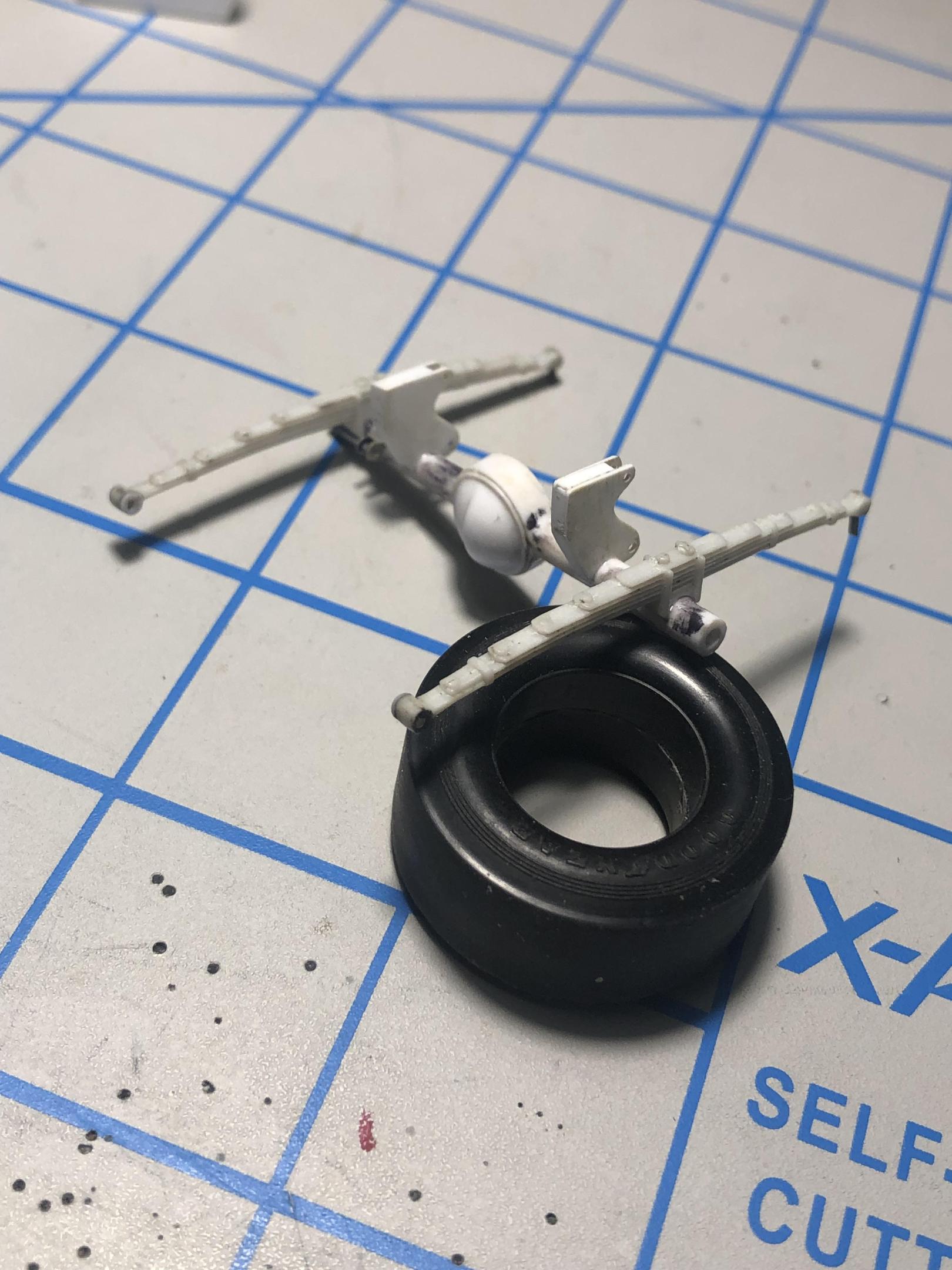

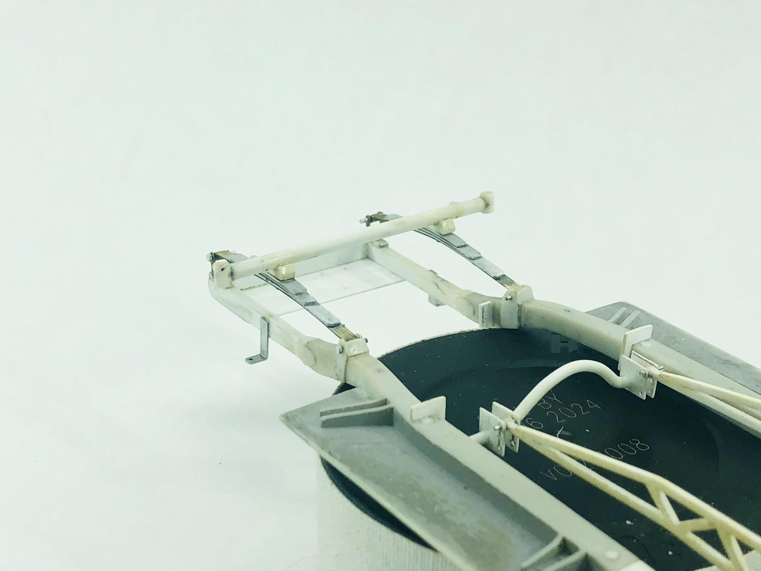

Hello everyone. I am building this coupe it kinda fits in what class a A/FX or S/SX class, pre funny, I don’t know. I altered the back half of the chassis 12’ and set the engine back 10’ . I scratched built the rear end housing brackets shackles and the ladder bars and also the front leaf springs, shackles and the straight axle, working on the shocks now. More to come…

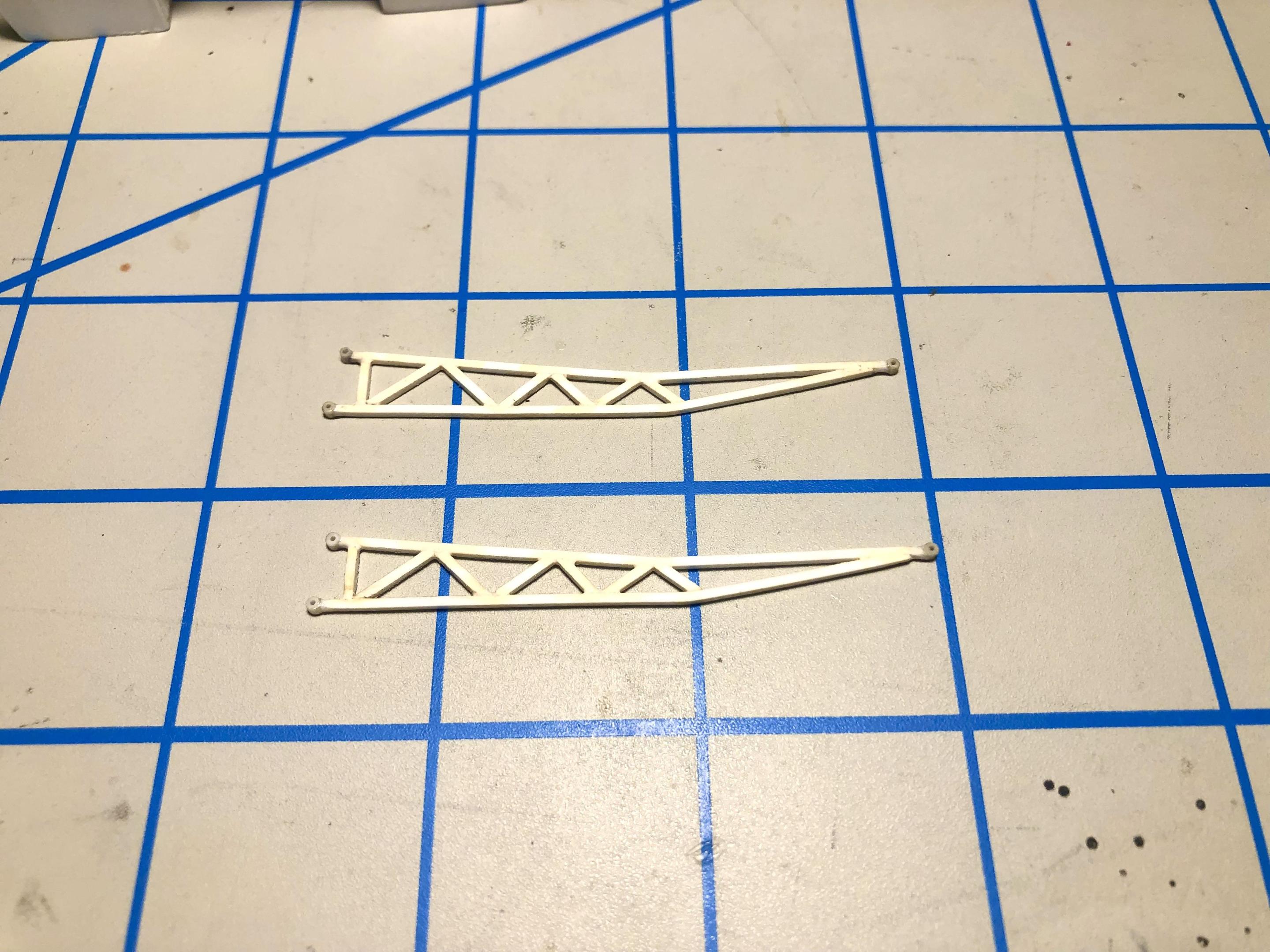

Looks great. Ladder bars a little bit long and you need a set of floaters when using them with leaf springs. I need to look that up, I'm not sure when they went to 33in. ladder bars. Anything longer than that usually guarantees a wheel stand.

Looks really good, very nice fabrication...but just a note on classes and tech:
This build would most likely fall into a "gasser" class, if it has minimum required "street" equipment like lights, etc., and depending on the year you want to represent. Specific class is determined by engine displacement, whether or not it's supercharged, and vehicle weight.
A/FX was for "factory experimental", and was limited to fairly current production cars of the 1960s.
S/SX was supercharged experimental stock, just prior to full-blown funnycars, but rules specified a '64 or newer body for the  /SX classes.
This link goes a fairly complete, pretty accurate overview of older classes.   https://nitroslots.com/thread/398/drag-racing-classses
AND...DWC is absolutely correct about "sliders" being necessary with ladder-bars and semi-elliptic leaf springs. The rear suspension will bind without them. There are several different designs, so some research would be appropriate for your specific setup.

I understand how the suspension would bind, but does that mean all the gassers built here with ladder bars are wrong?
Cars with coil springs and cars with quarter-elliptics (like the first Stone-Woods-Cook Willys) don't need sliders.
Anything with semi-elliptic springs and ladder bars will need sliders.
I got bogged down on one of my own builds when I had a DOH moment as I realized I'd need to fab sliders for the build to be right.
You can leave your ladder bars as they are, and only fab sliders that are mounted to the axle, but allow the springs to slide through them.

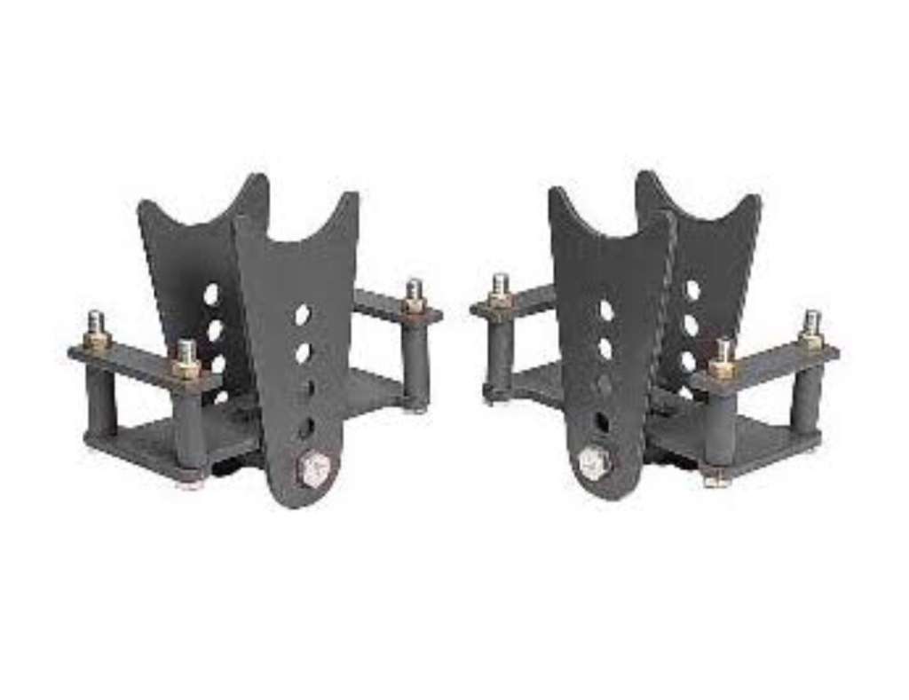

Here's one style, pretty easy to make.
https://pitstopusa.com/i-23908156-competition-engineering-floating-housing-mount-bolt-on.html
EDIT: This is about the simplest slider setup. The brackets weld to the housing, and the spring rides free on the rollers.
https://www.chassisengineering.com/product-category/rear-suspensions-and-accessories/ladder-bars/housing-floaters/
Edited by Ace-Garageguy

No apologies needed. Not my thread. I haven’t run across this before and was trying to gain some knowledge. I’m building the Moebius Nova and it has leafs and ladder bars and from what I’m seeing is wrong. My apologies to the OP, Tony, for plugging up his WIP. Nice scratch building on the chassis by the way.
Thanks for the info.  I never thought about the length but it makes since and the floaters would make since as well. I will take this knowledge and apply it to my next build…
Your info is greatly appreciated. I literally spent about 6 hours the other day on George Klass web site and the rule books on here trying to figure out what class this fit in. I was going for early 60s type pre funny car build, but a gasser class could make since.The inspiration for this build come from Jack Chrismans comet, which I plan on doing if I could ever find the decals, also thanks the info on the floaters I will incorporate into my next build as I’m planning on building another one of these cars…
