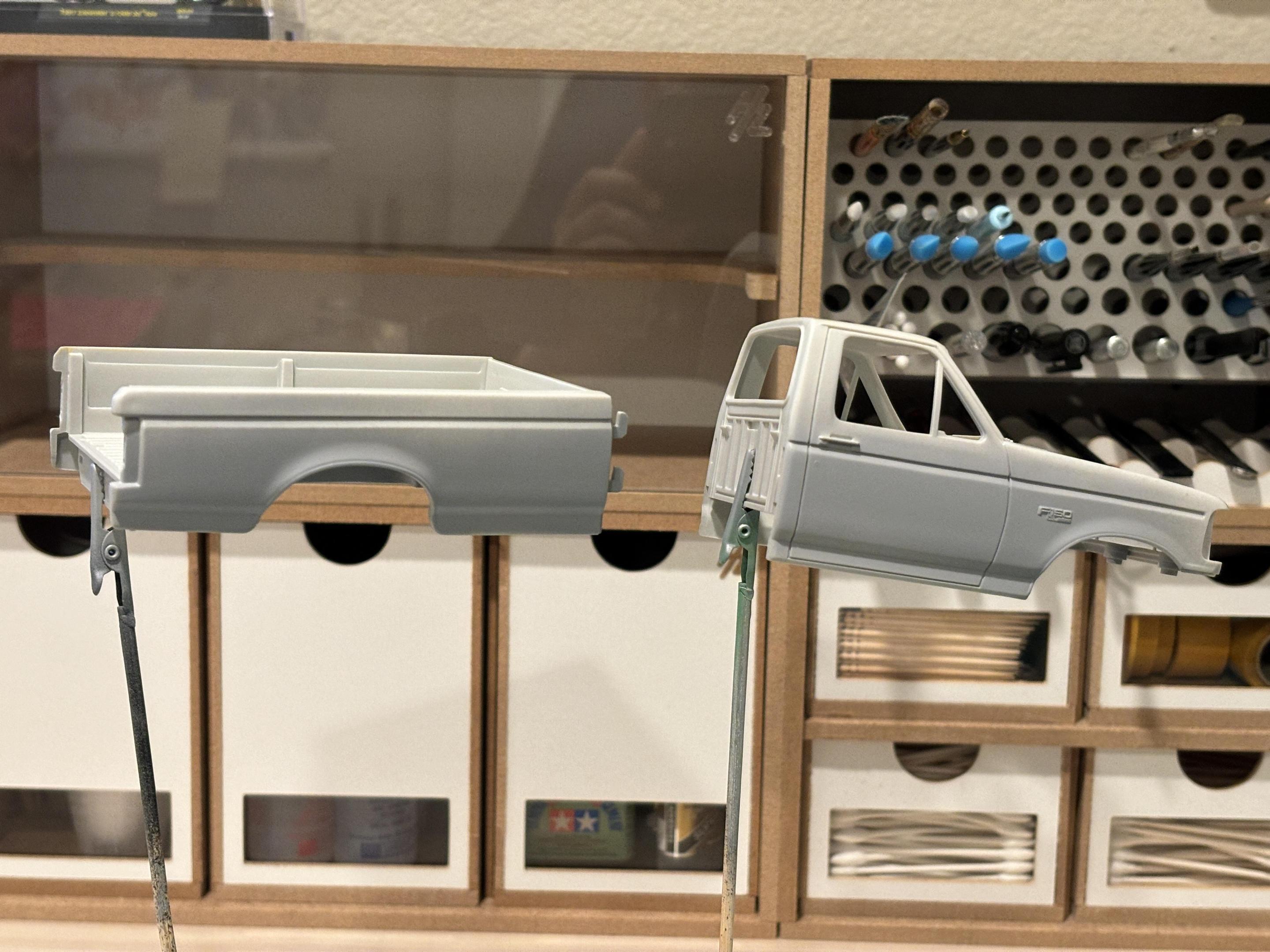

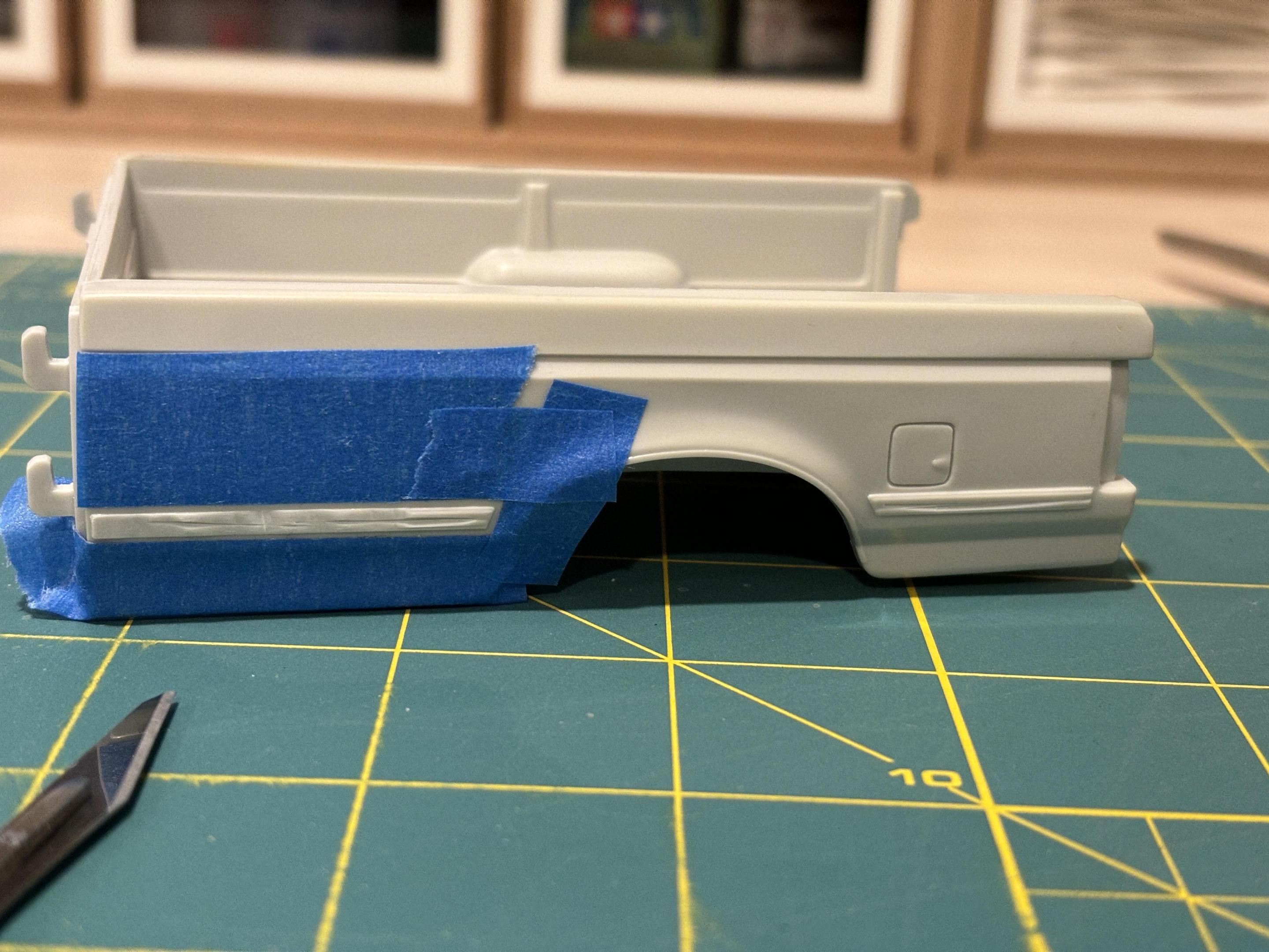

The biggest challenge will be to de-trim the truck from an XLT to an XL model. Most of this work consists of removing the side trim. The brunt of this work was done with a fresh scalpel blade and some tape for protection, followed up with various sanding sticks and pads:
After I was done, I sanded the affected areas with 400 grit to smooth the plastic down. I then brushed Plastruct liquid cement onto the areas that formerly had the side trim. The idea is that the liquid glue will get rid of the ghosting left behind by removing the side trim. This is a method I learned from Bill Guery and it has served me well in the past.
I let things dry and then re-sanded with 400 and 600 grits. I applied primer to the sanded down areas so I could see my progress. This is where I'm at now:

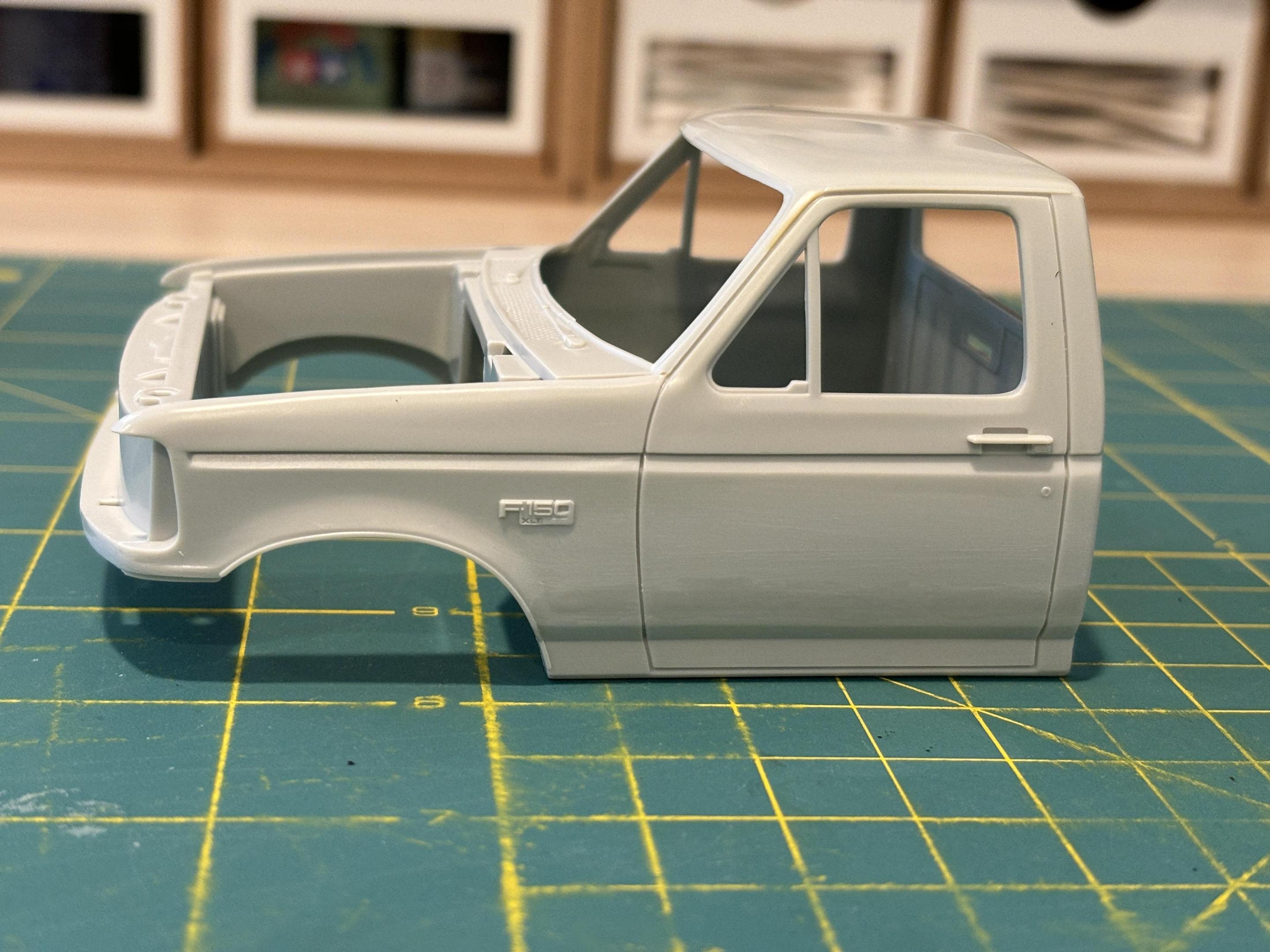

I sanded the main body parts with 600 grit to give the primer something to bite and removed the flash and (most) seam marks from the smaller bodies. I'll be washing the parts in warm water and Dawn and giving them a scuff with a toothbrush shortly:

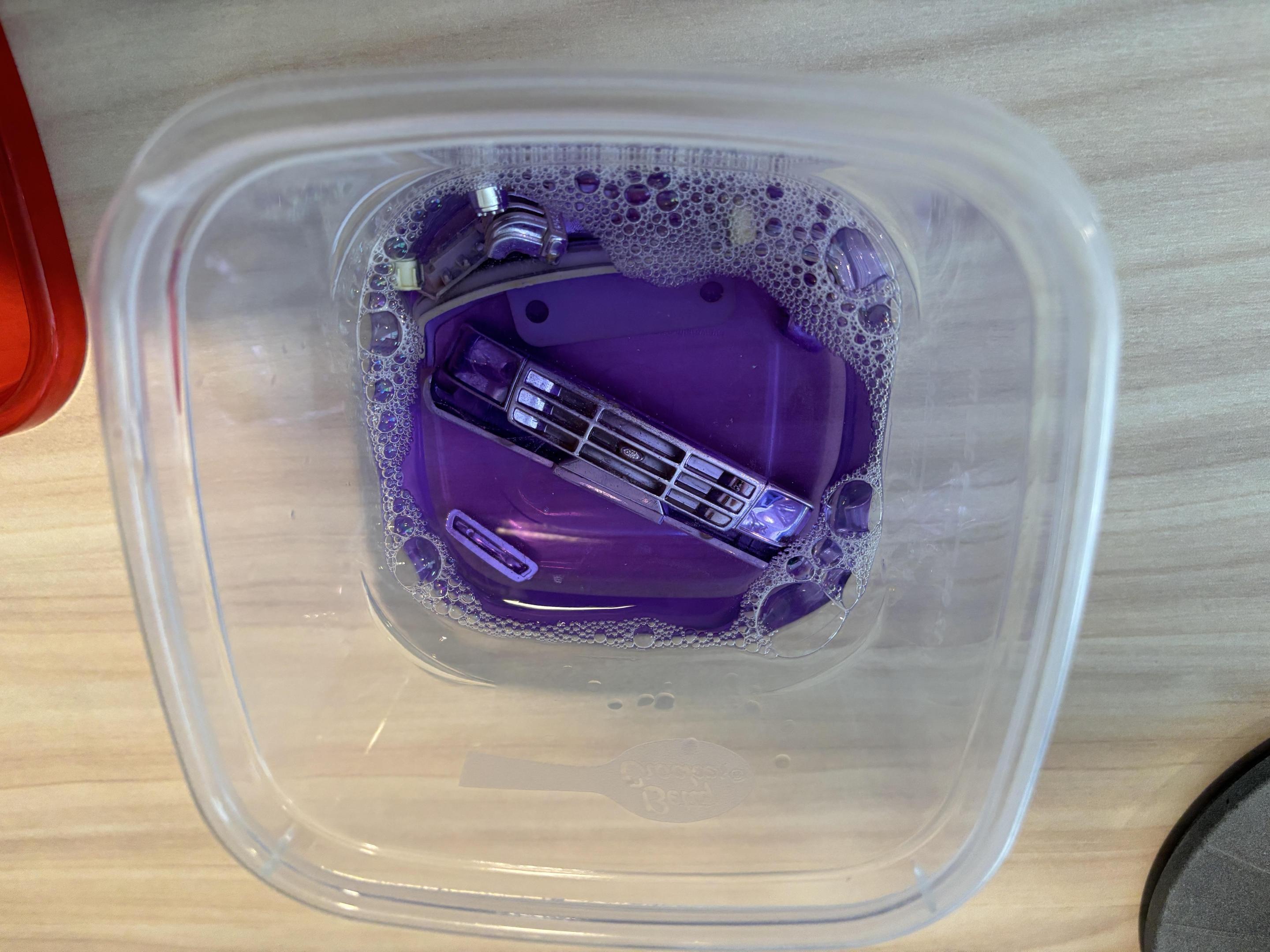

Here are all the chrome parts in Super Clean for de-chroming:
Within 5 minutes, most of the chrome was gone! I've never seen it work this fast. I'll give it a little longer to be sure that all chrome remnants are removed:

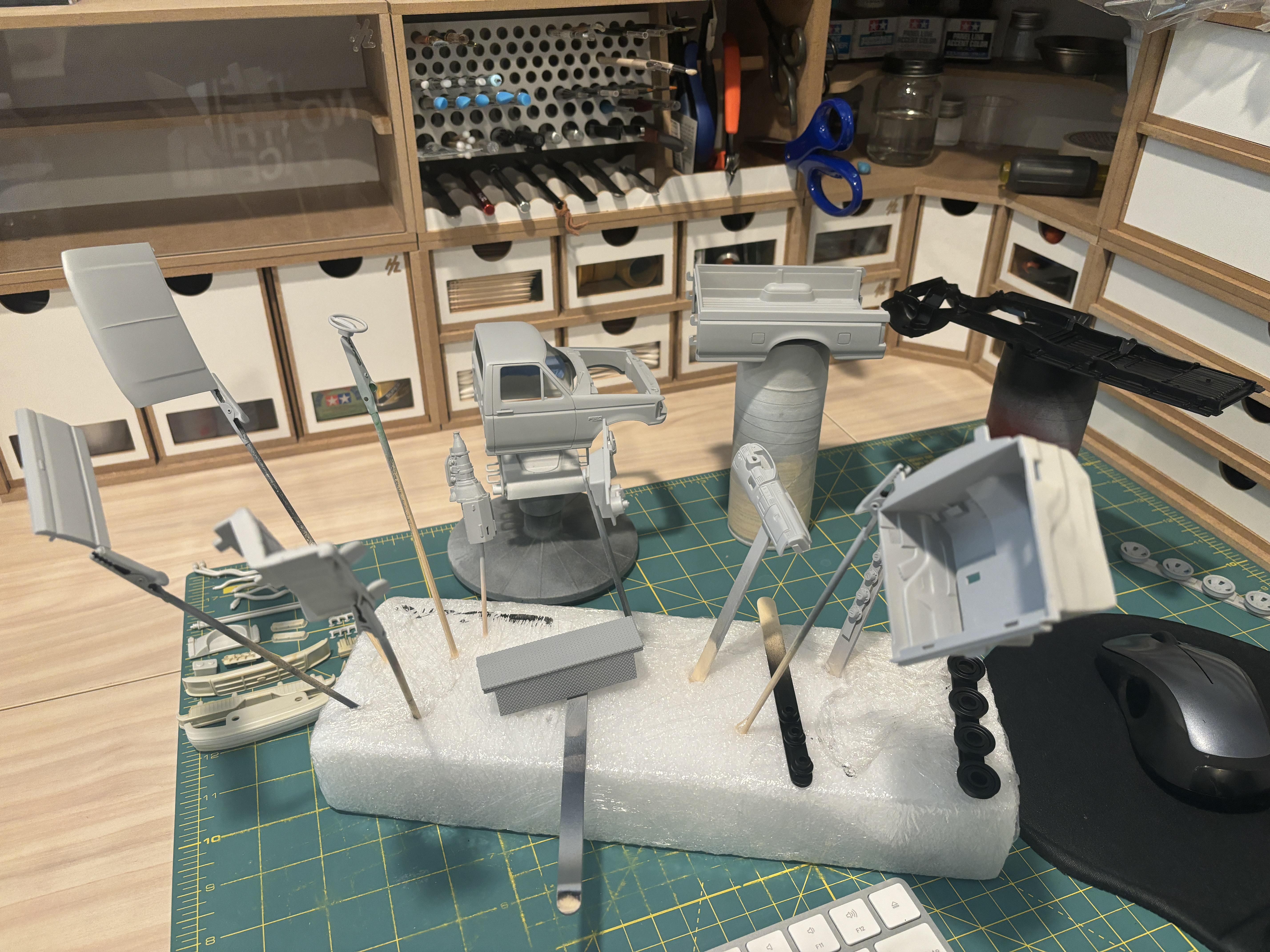

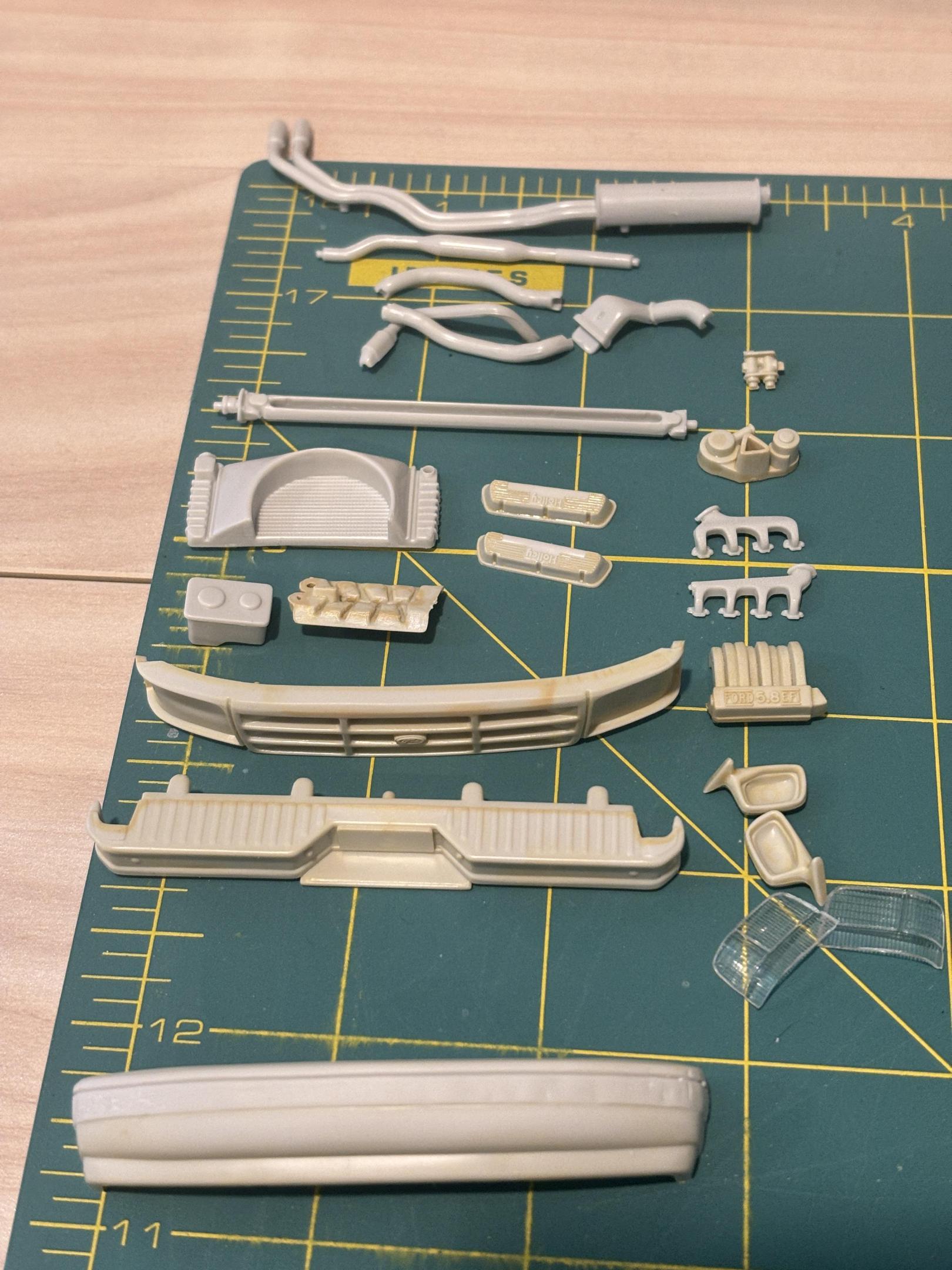

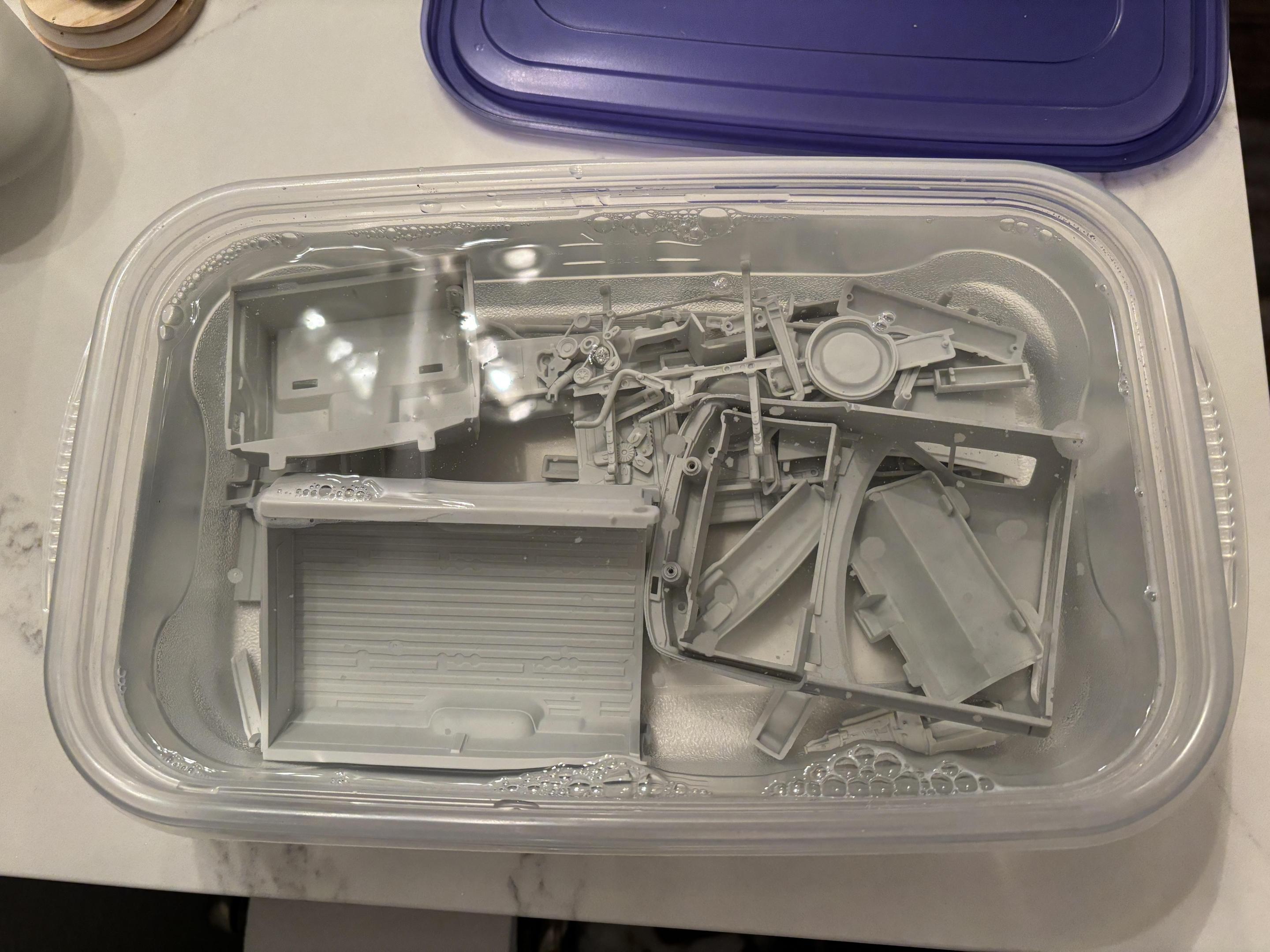

Between working a lot of OT, I've been spending time mostly getting all of the parts washed and dried. I set aside some parts that will need a little more sanding to look just right. Most of them are the parts that I de-chromed. As you may be able to tell, I have started to remove the rubber trim on the front bumper to make it look like a base XL bumper.

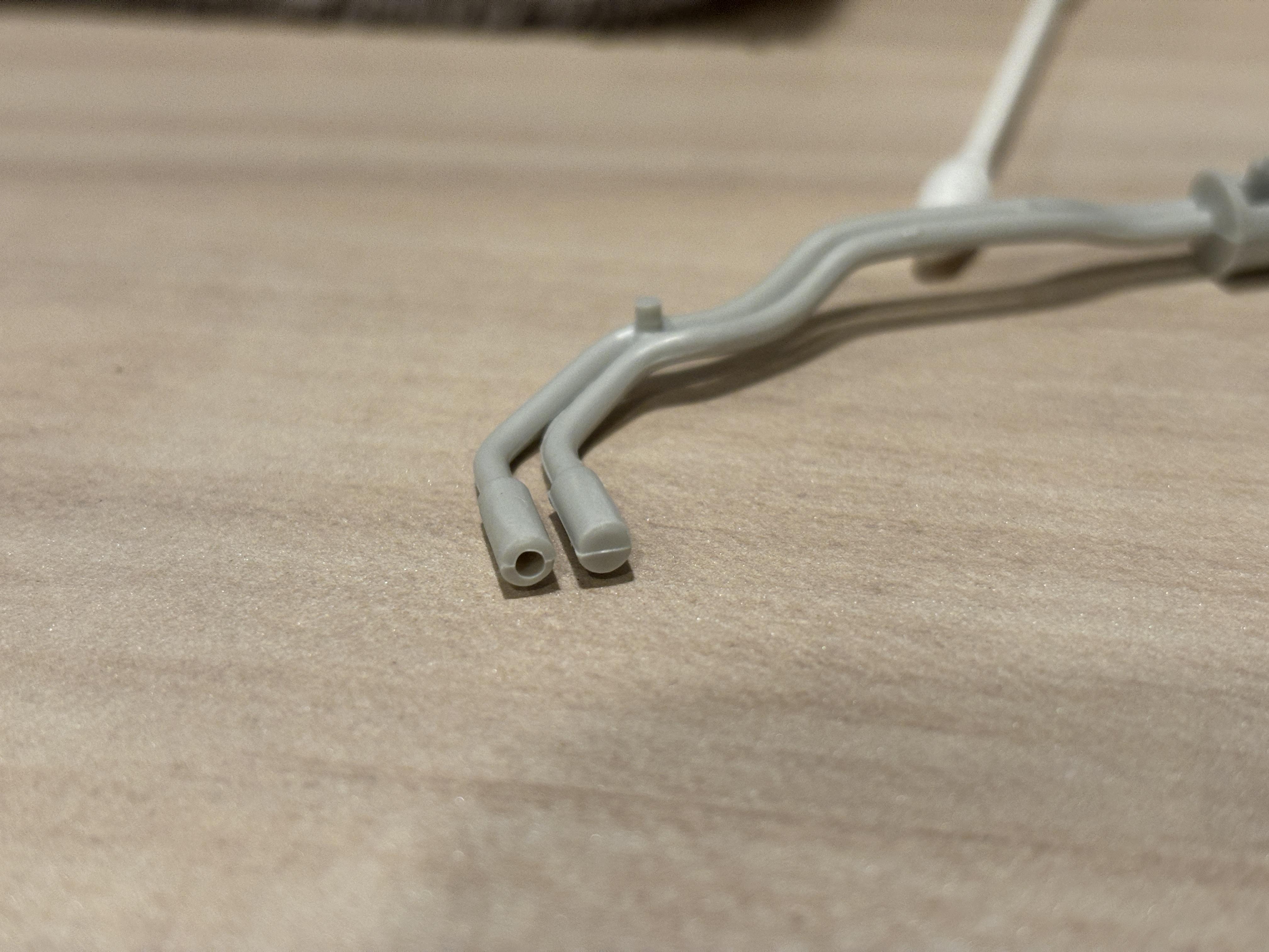

I also drilled out the exhaust tips:
I primed most of the big parts in Mr. Surfacer 1500 black and grey since I'm done with the body work. I cannot say enough good things about this line of primers.

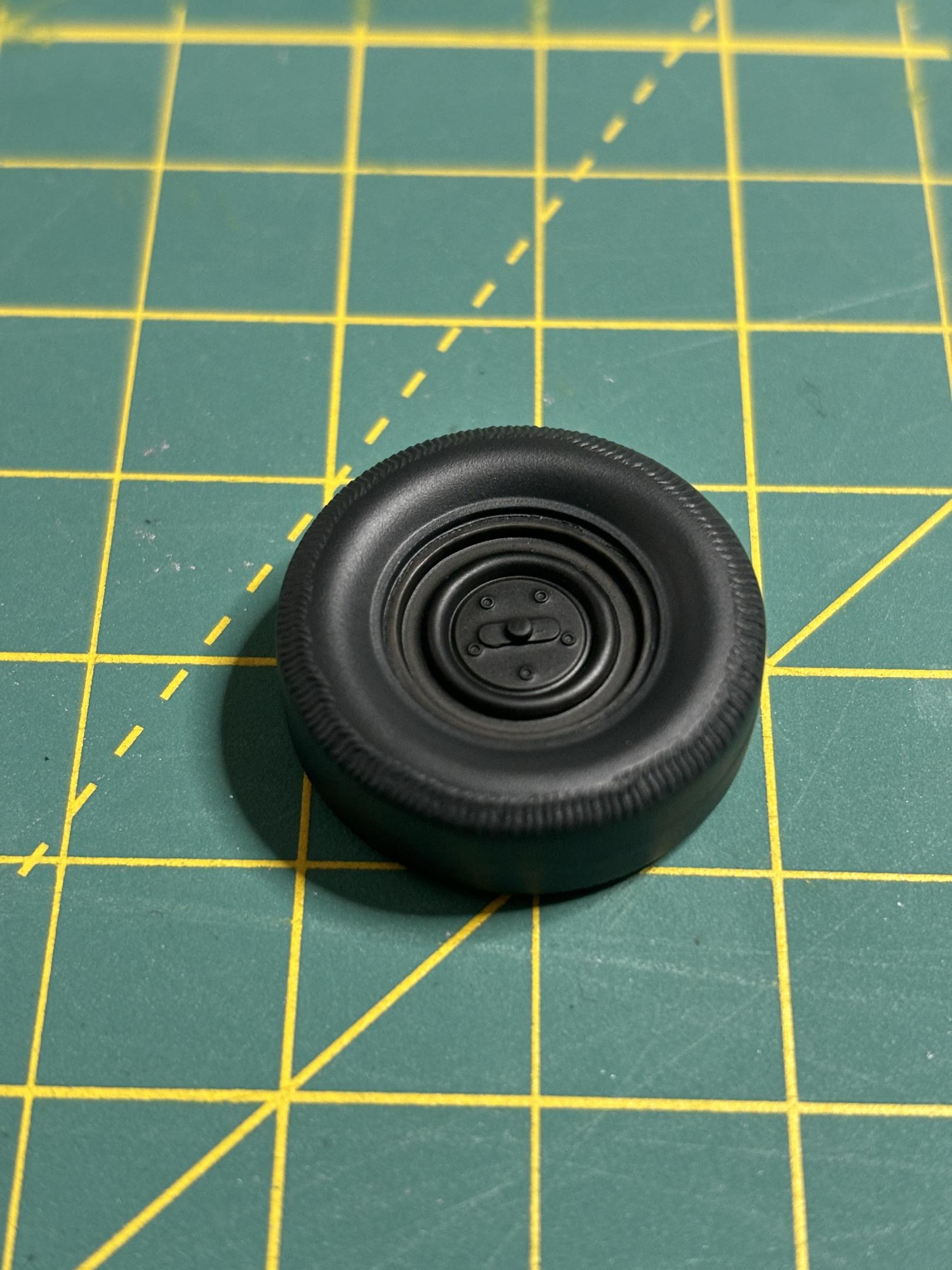

I also painted the spare tire that will be mounted to the chassis. The tire came in two pieces, so I glued it together and was able to sand away much of the seam line. I primed the whole thing with Mr. Surfacer 1500 black. I then taped off the wheel portion and painted the tire  portion with Tamiya TS-82 Rubber Black. I honestly didn't see a  huge difference with the black primer, especially for a piece that will not be visible. But it was still nice to see how TS-82 looks since I hadn't used it before.

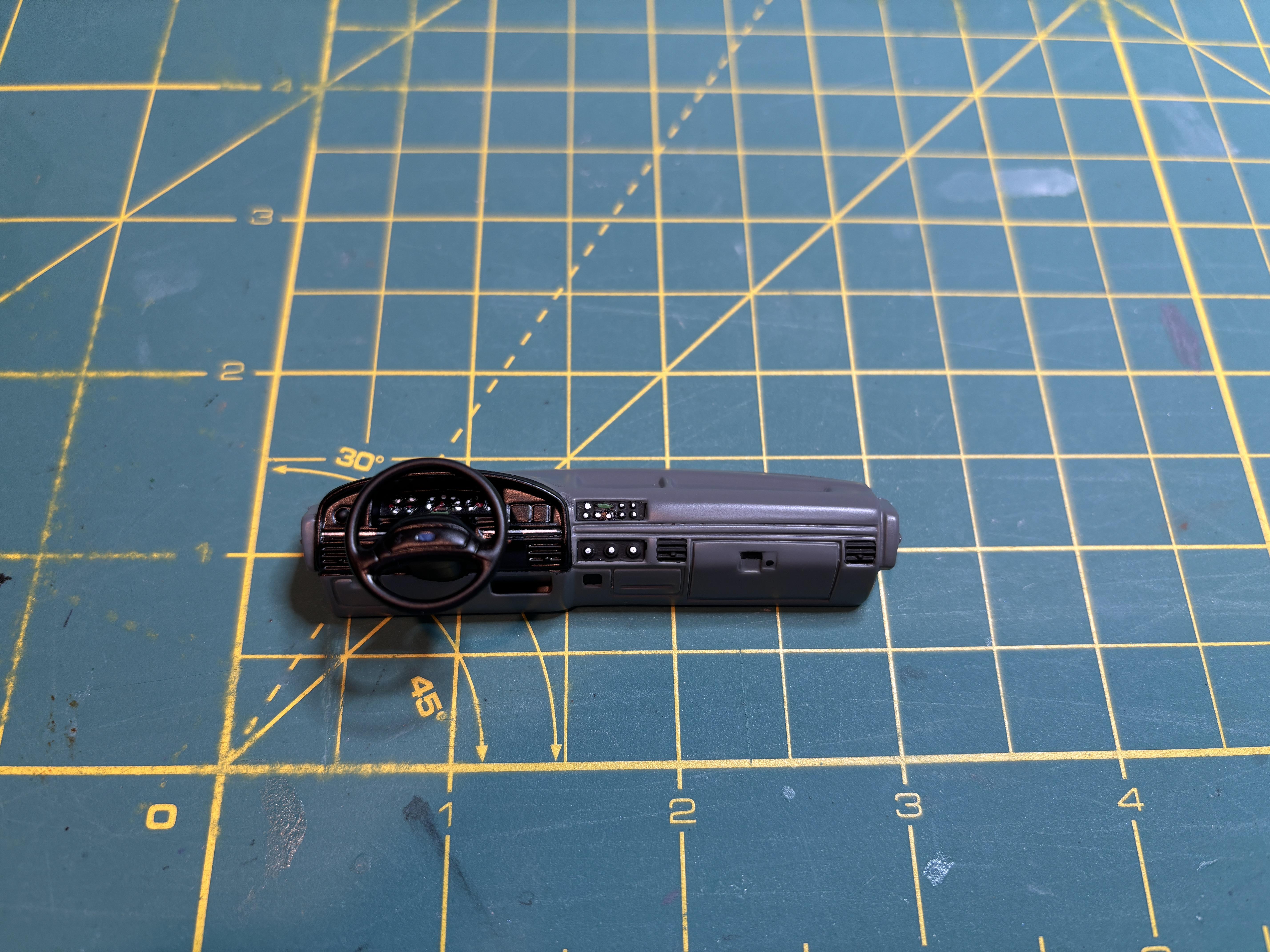

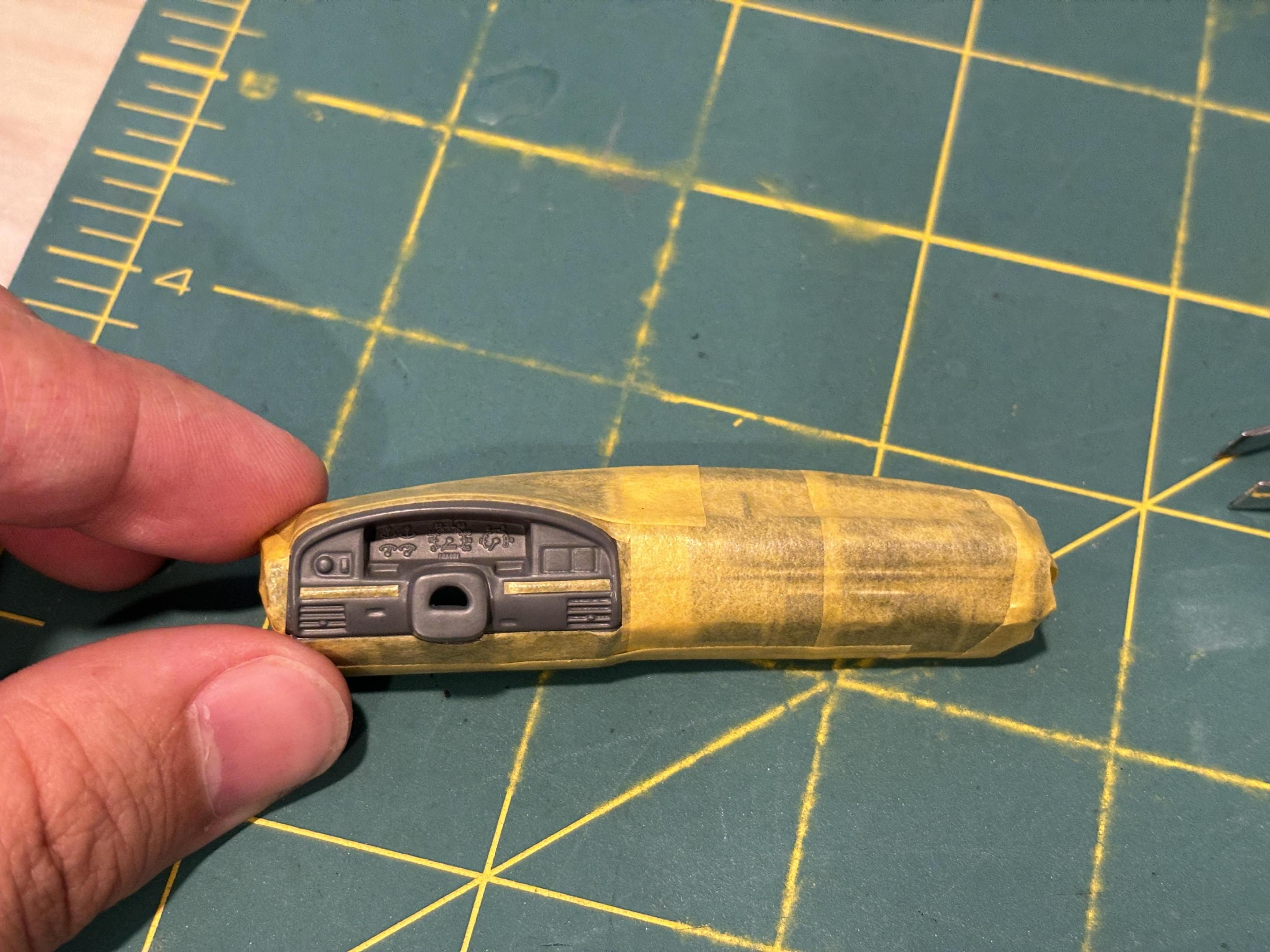

I've always liked working on dashes. I taped off the appropriate areas and spray-painted the black portions with Tamiya TS-29 Semi Gloss Black:
I then hand painted various other details with Vallejo acrylics:

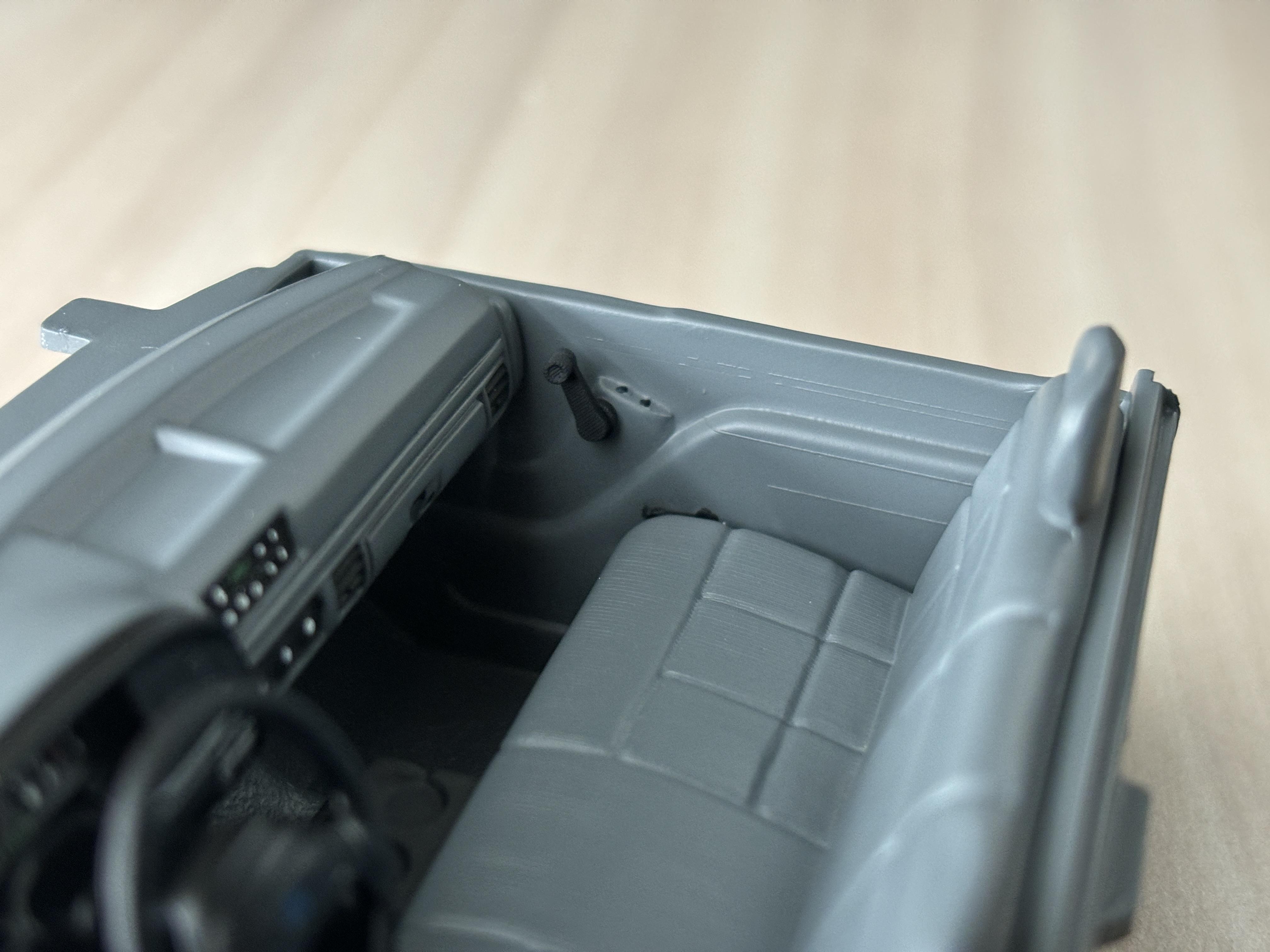

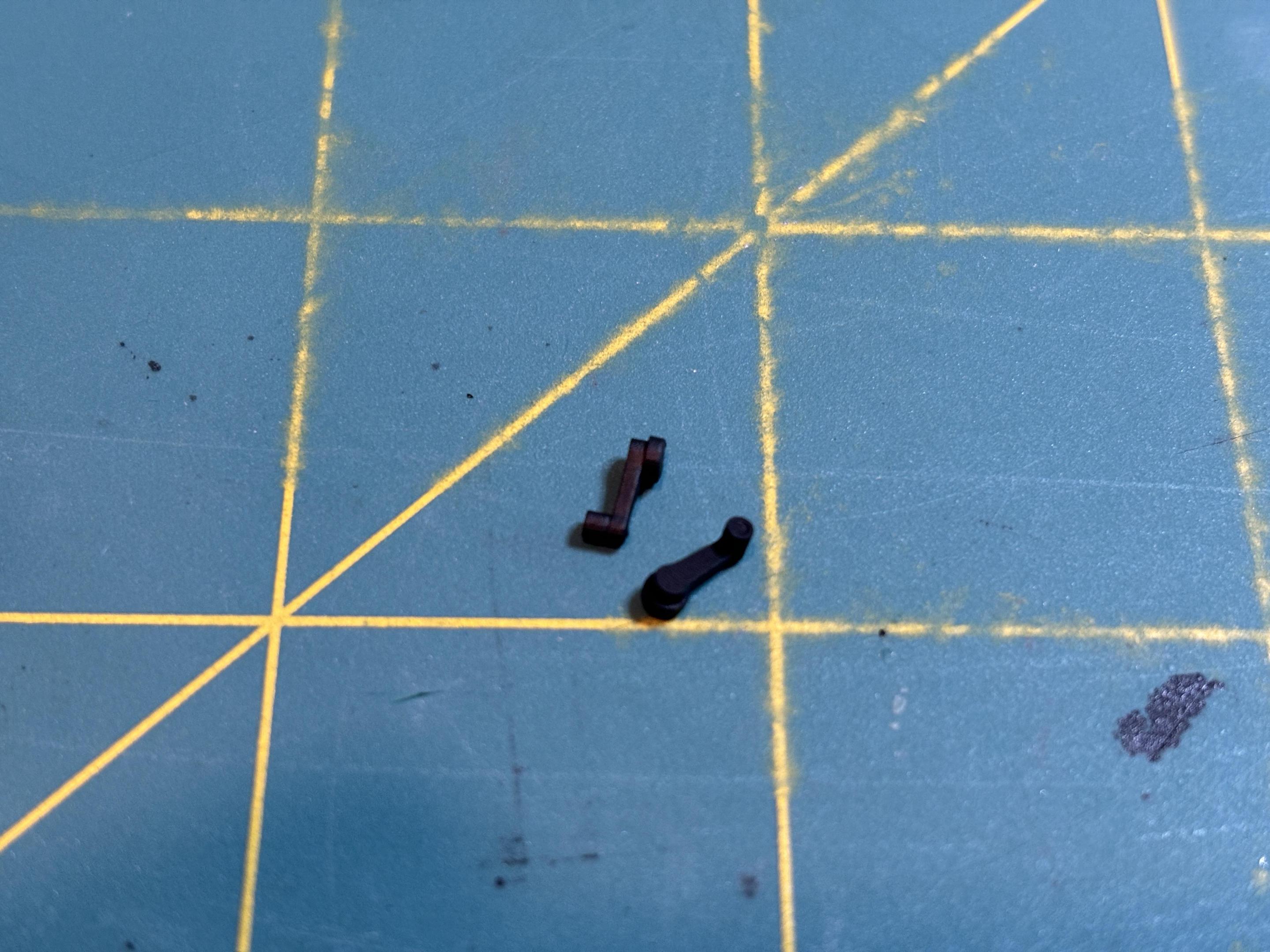

The dash has excellent detail, but the interior tub is lacking. I took some 3D printed window cranks from Iceman Collections and glued them on to provide more detail. Window cranks would have still been standard on XL trim trucks during this era.
Here they are after painting and installation:
Unfortunately, the interior door details are not accurately molded on the kit, so the location of the crank looks funny despite being in the right spot.
1993_ford_f-150_08B37DE8-2696-4983-85C8-E362F2E6E17C-52584-scaled.webp.066b24d409283a2d513f09e02a76b0ec.webp

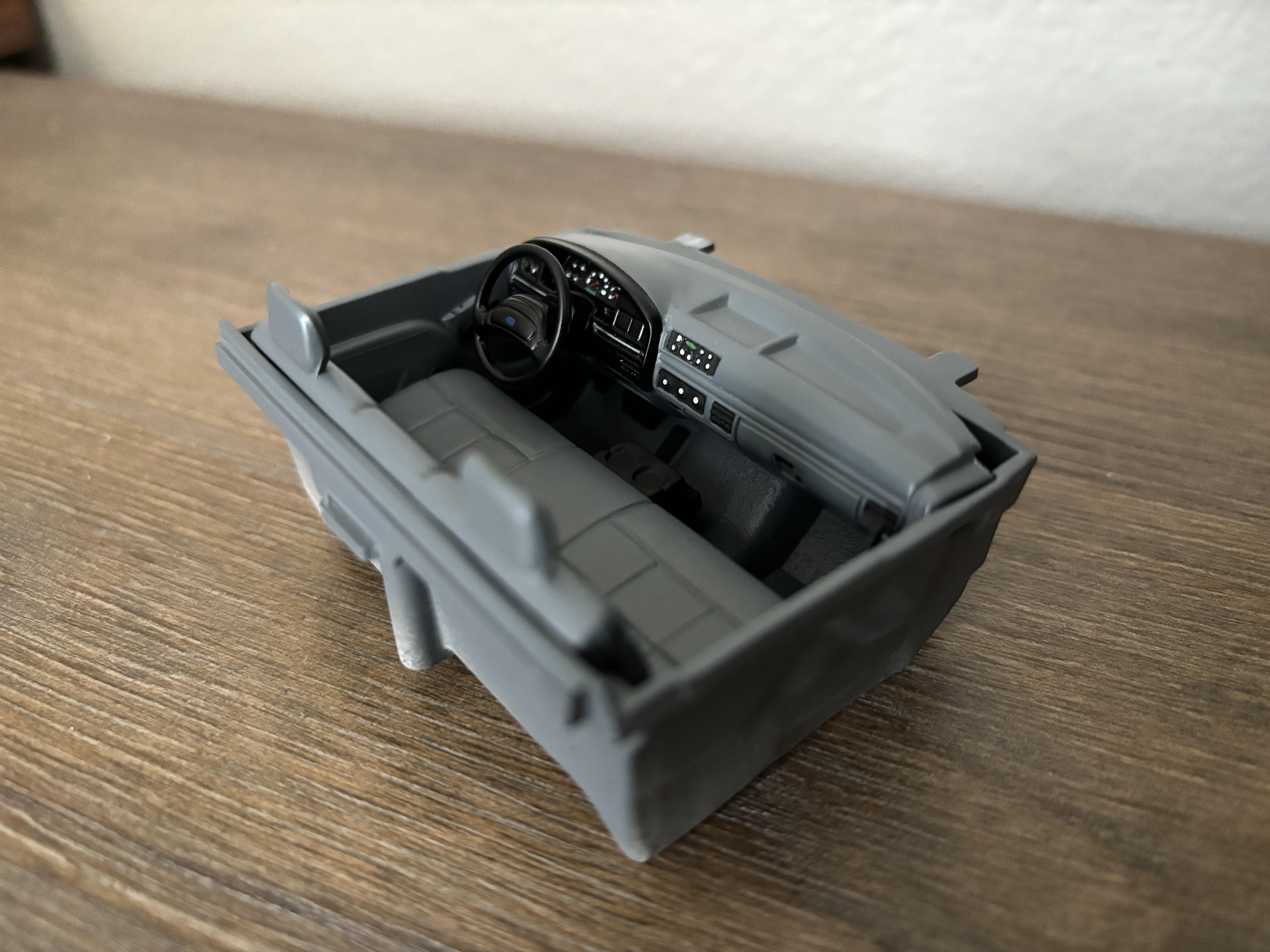

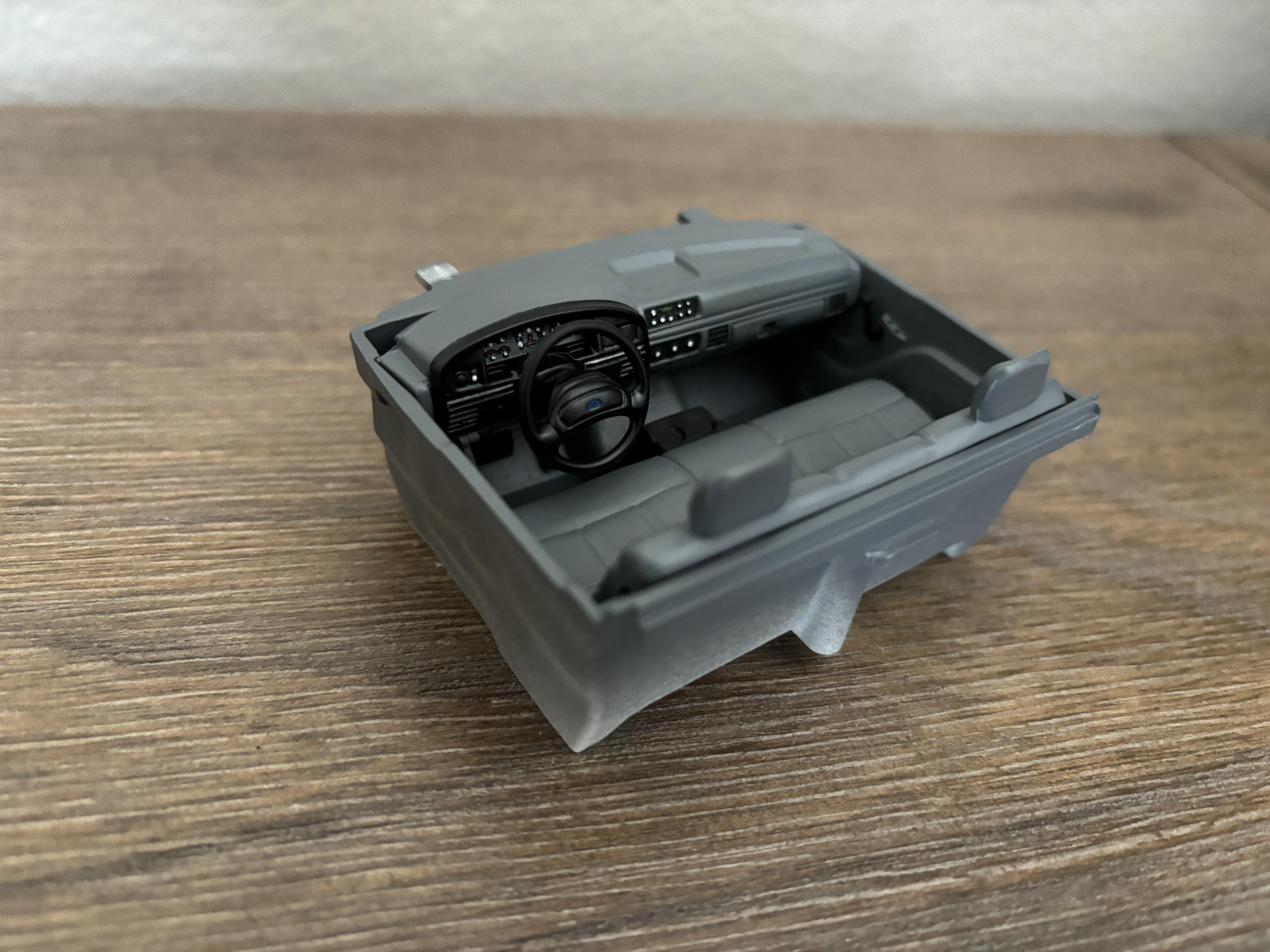

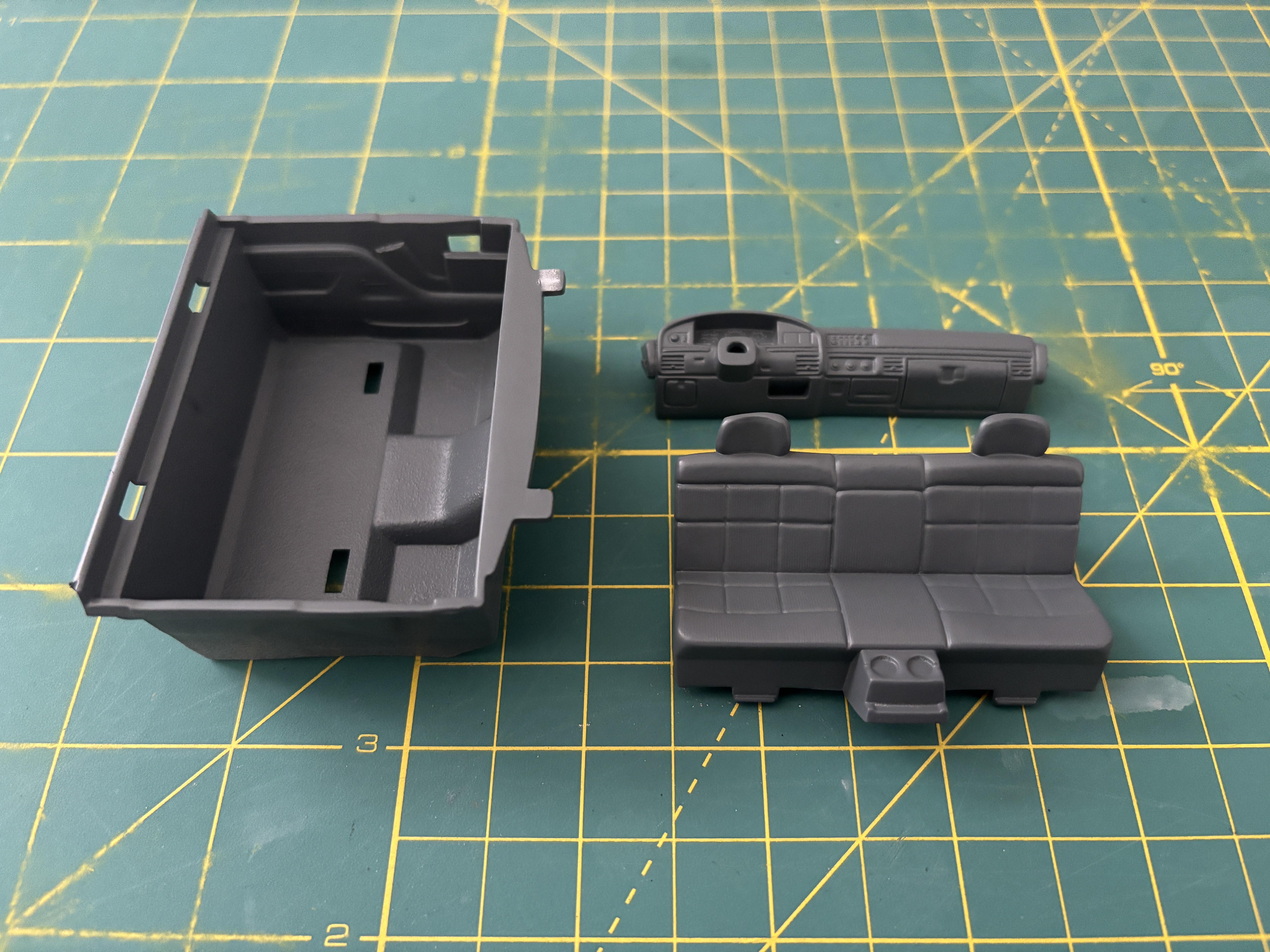

Here's the completed interior tub:
The only remnant of the kit's XLT trim origins are the upscale seat pattern. I did not feel like going through the effort of modifying it, so the bench seat will stay as-is. The bench seat comes with integrated cup holders, which are supposed to color match the seats/interior. Since this is an XL trim truck and it's not supposed to have integrated cup holders, I simply painted them black to resemble aftermarket cup holders that my dad and many of his co-workers used before they became standard on later generations of trucks.

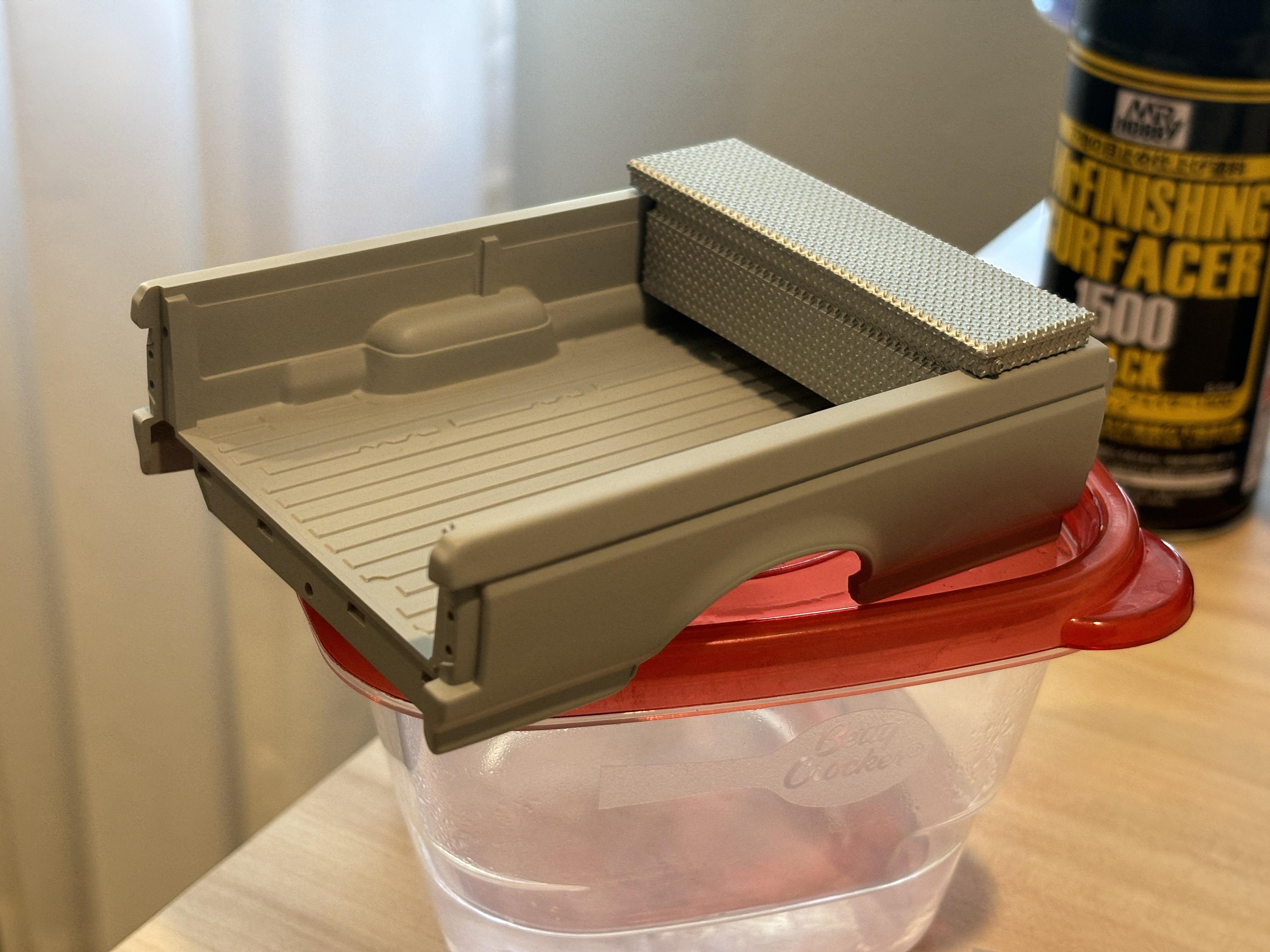

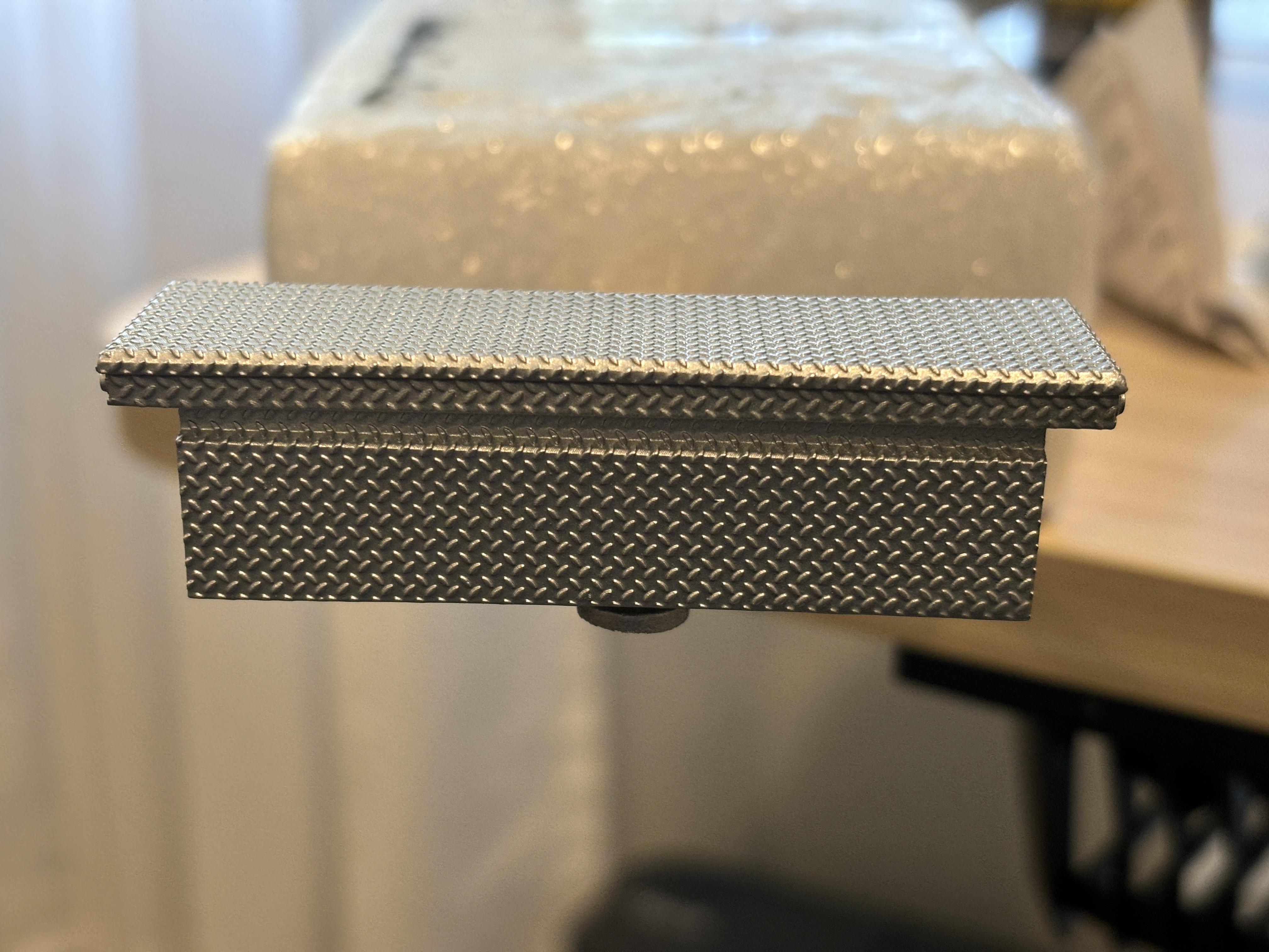

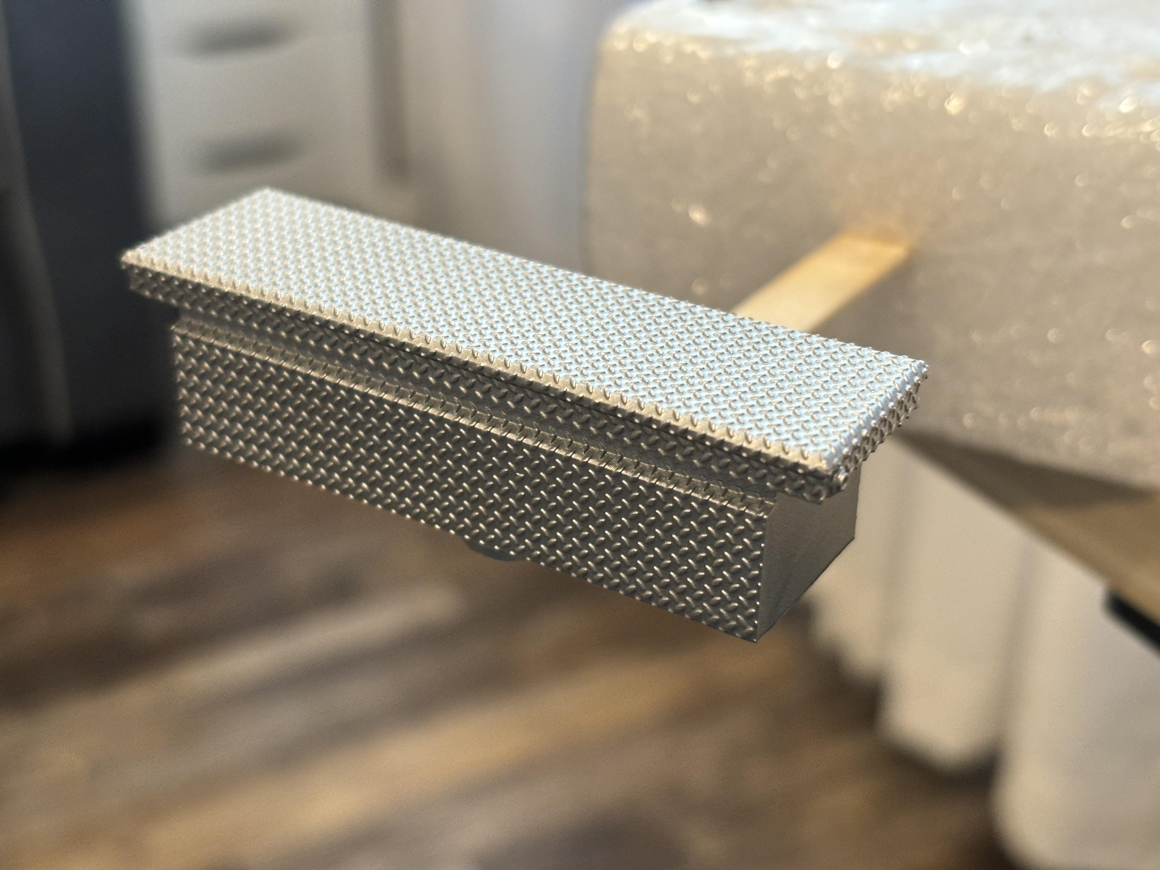

Got the toolbox done. It's a 3D-printed design that I found on cults3D. The design page describes it as intended for a Revell pickup, but the sample photos show it on an AMT F-150 and it fits like an absolute dream. The print required very minimal cleanup. I primed it with Mr. Surfacer 1500 and then painted it with Tamiya TS-17 Gloss Aluminum. Here's the link:
https://cults3d.com/en/3d-model/various/saddle-box-for-revell-pickups-1-24-scale
  • Like 3

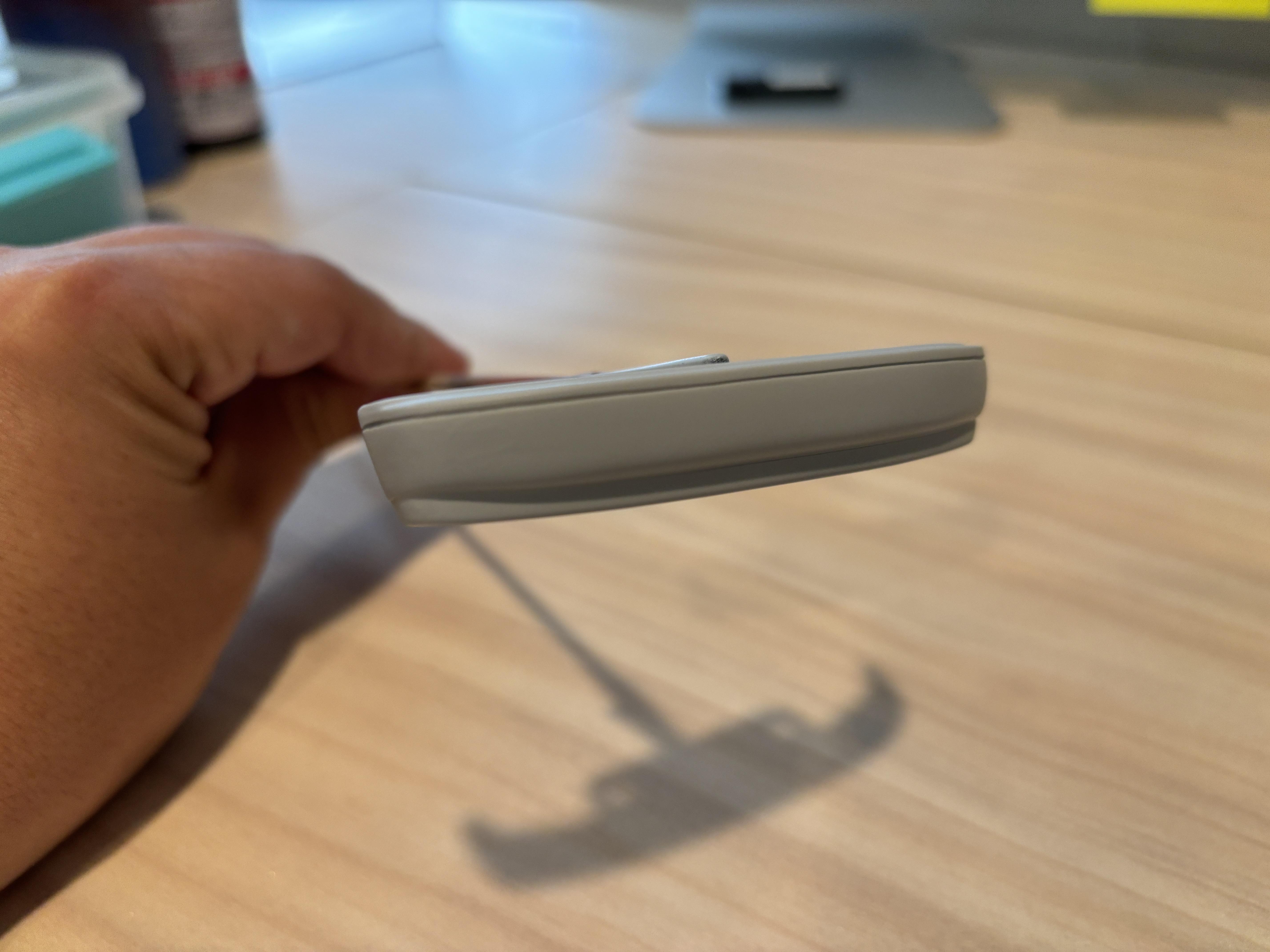

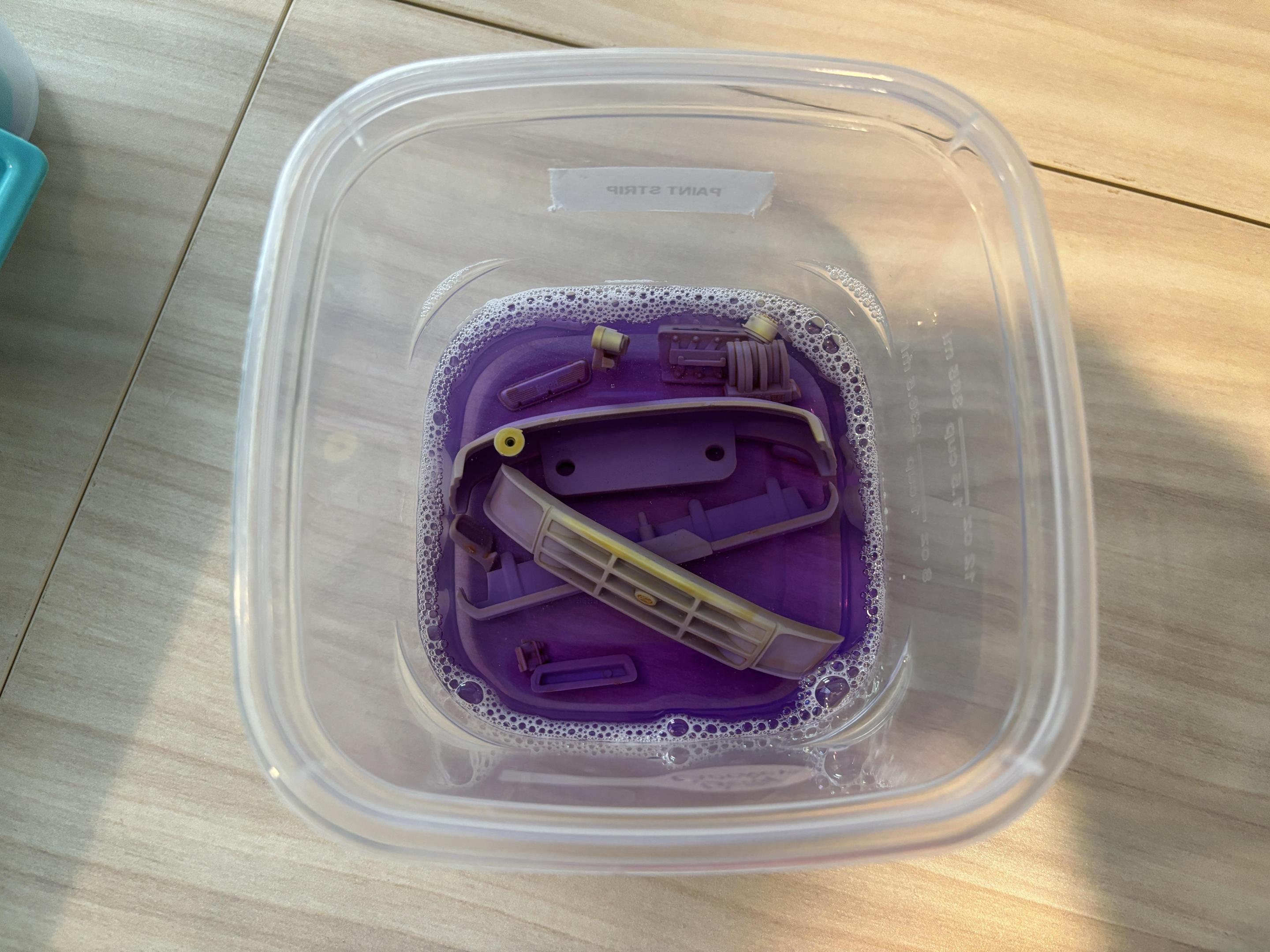

I finished sanding the rubber molding from the front bumper. I started by stripping the chrome off and then working at it with various files and sanding boards, mostly consisting of 400 grit and then 600 to smooth things out. Here it is with primer.

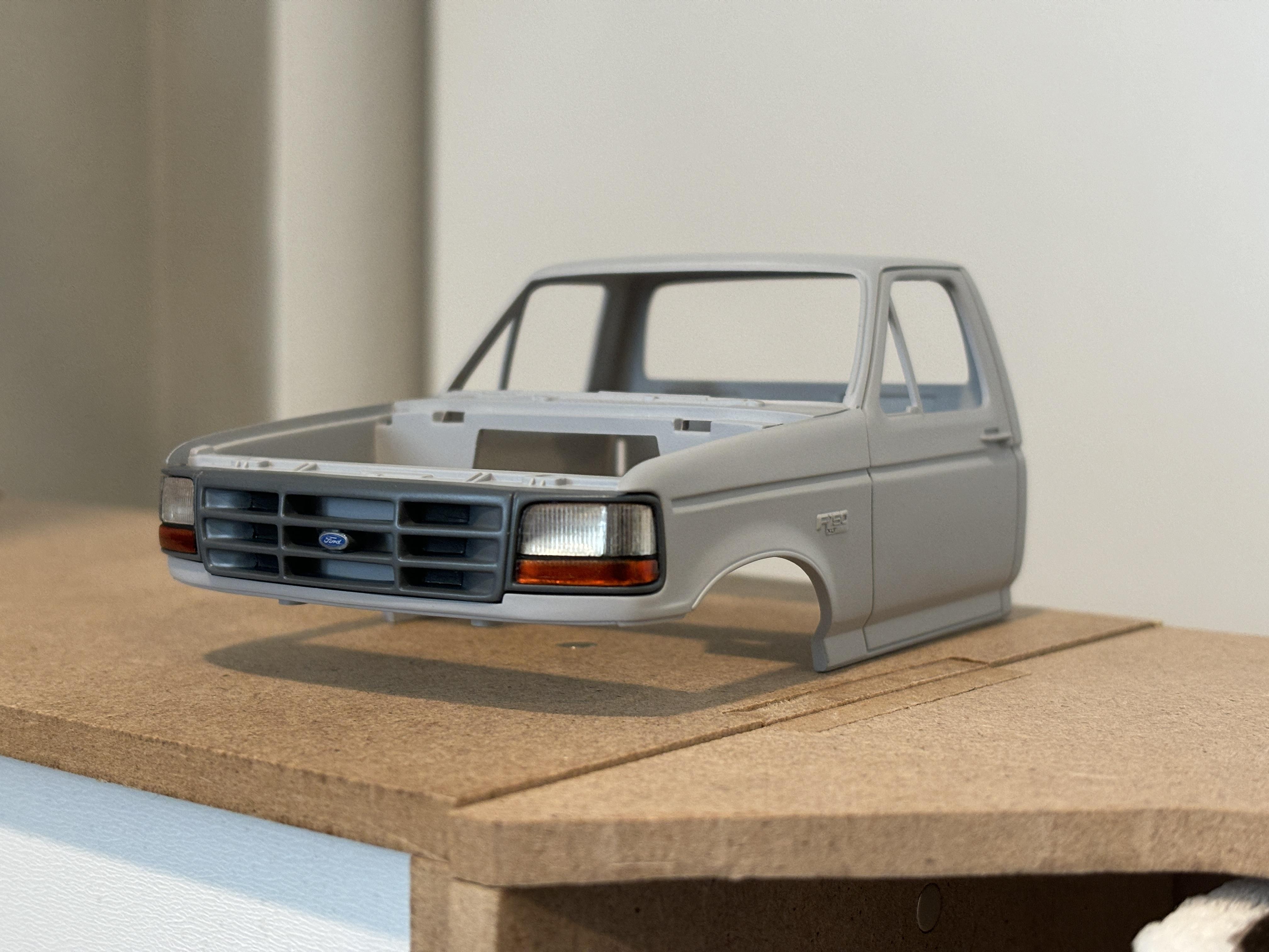

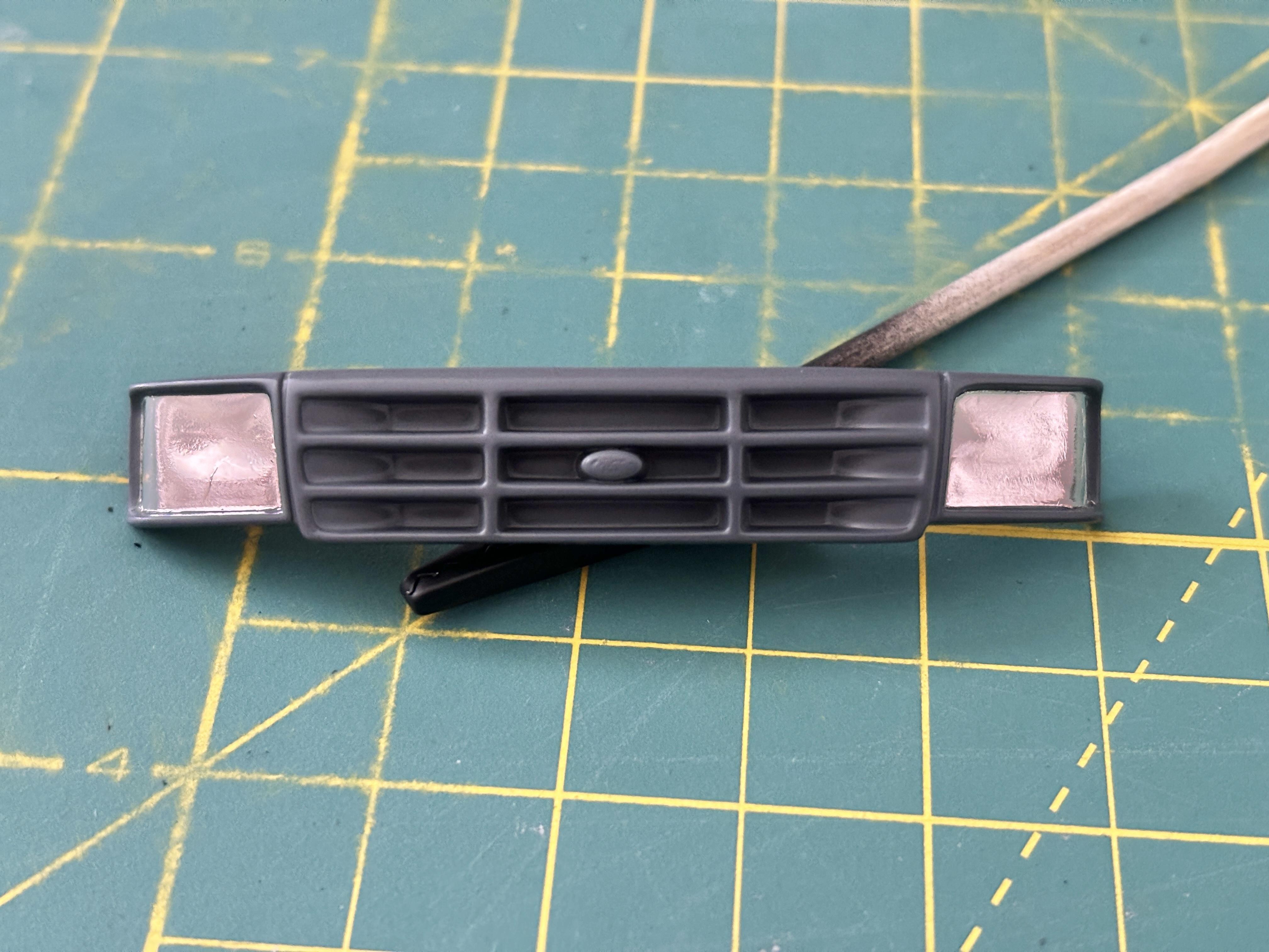

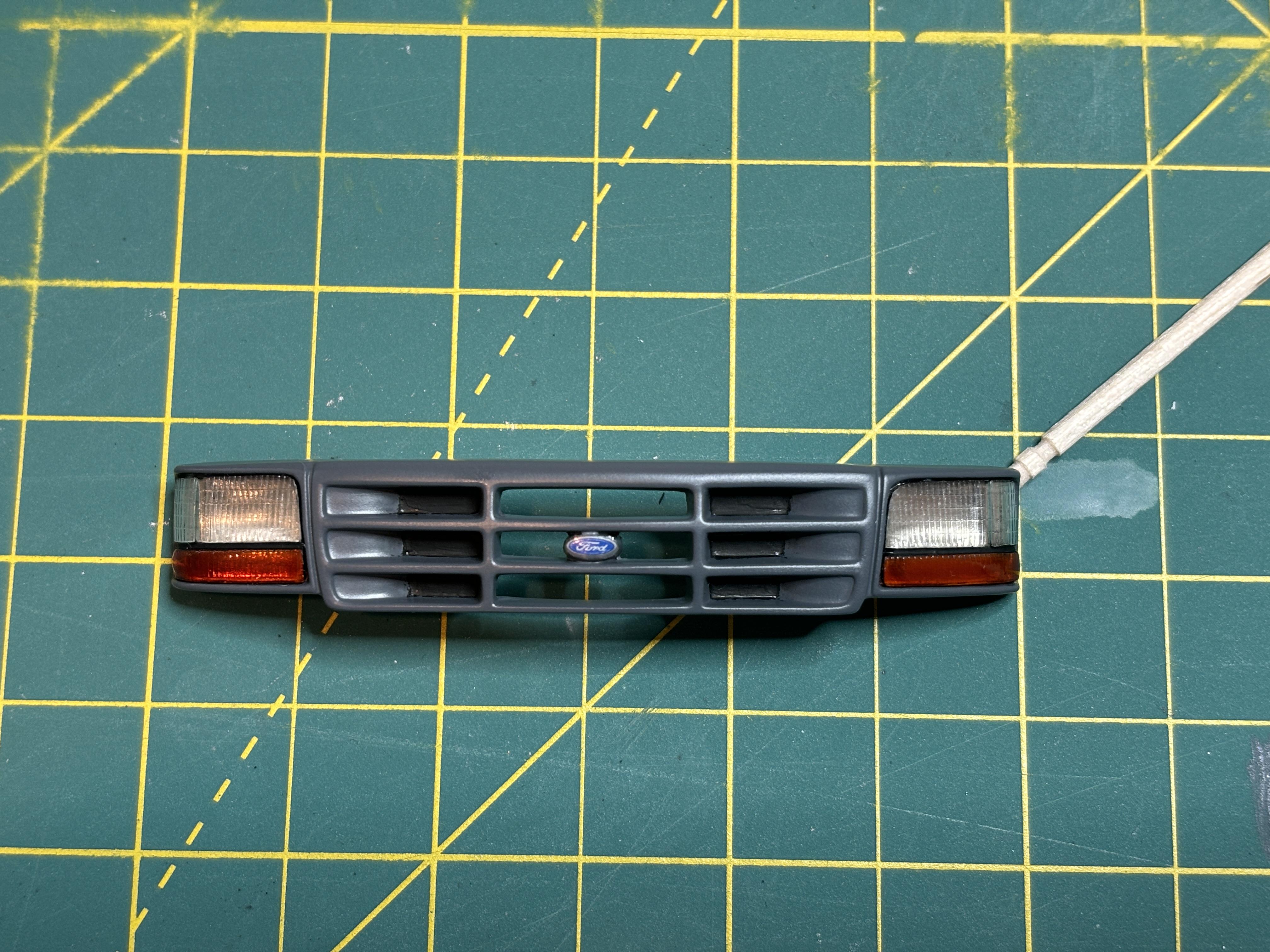

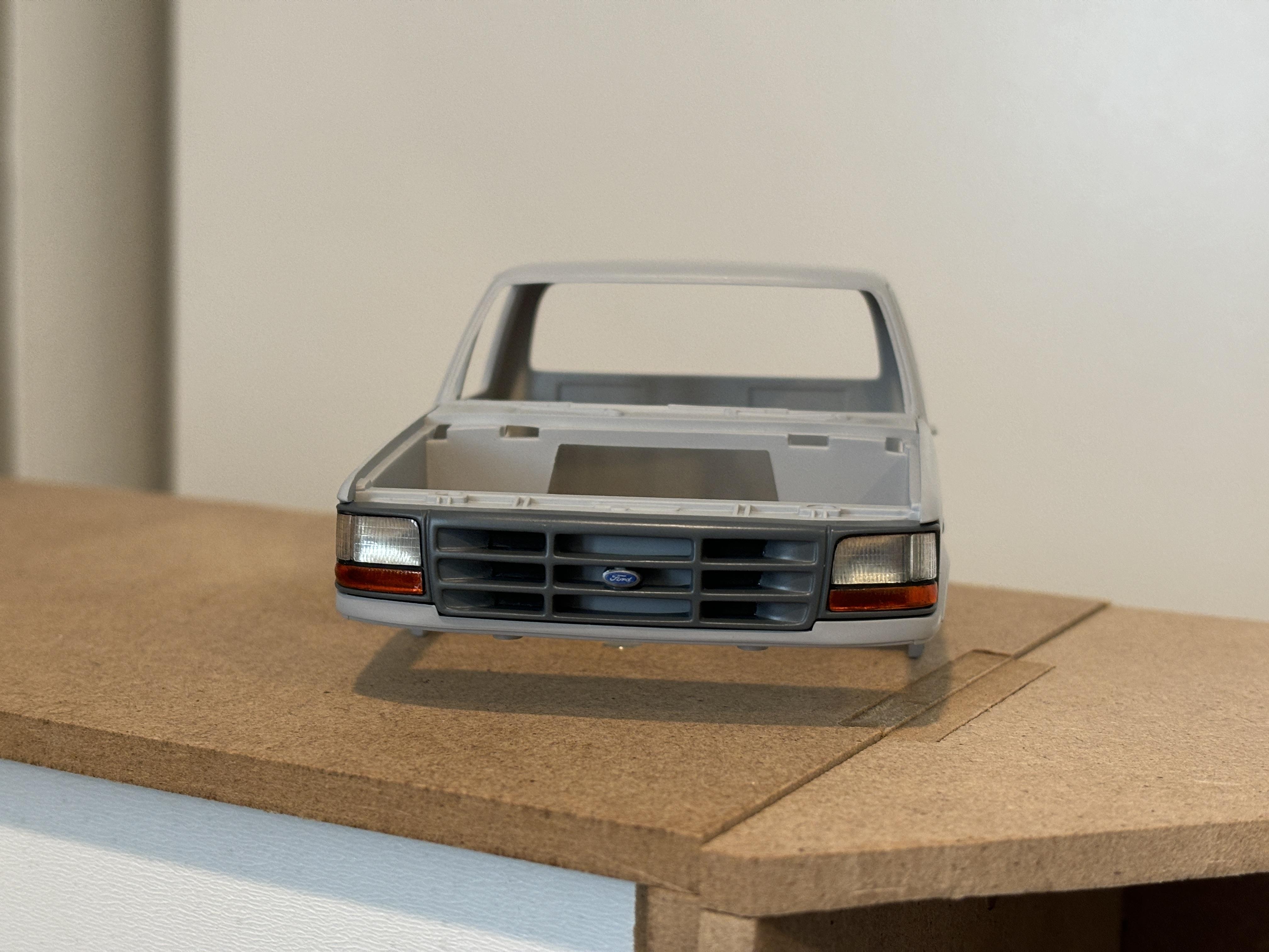

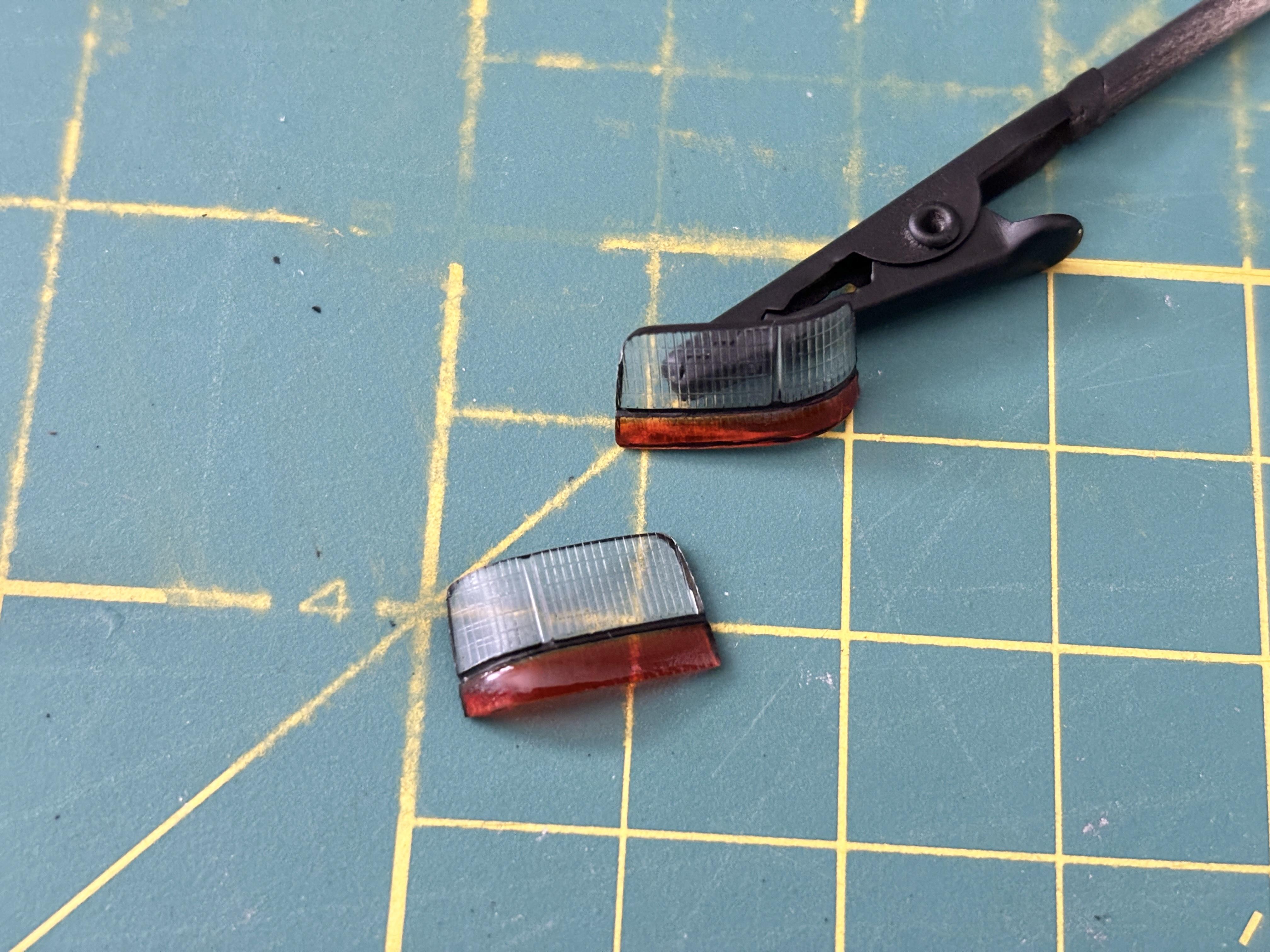

I got the front grill done. The kit comes with separate clear headlight lenses. I brush painted the amber portions with Tamiya X-26 clear orange. Vallejo black paint was used to simulate the rubber(?) separation between the bottom turn signal lens and the top headlight lens. I then used a black sharpie to outline the entire piece.
Thankfully, Ford used the same grill/front fascia for both their base XL models and higher trim models. The main difference was that the XL version was a dark grey as opposed to chrome. As such, I stripped the chrome from the kit's grill. The piece was then primed and painted with Tamiya TS-4 German Grey. I used Bare Metal Foil to simulate the backing for the headlights.
I initially painted the grill inserts with Vallejo black to simulate the vents. For various reasons, I didn't like the look so I decided to open up the middle vents. I did this by filing away the back of the grill and sanding the edges to get as clean of a look as possible. I decided to not open the outer vents as I was more satisfied with the black paint on those and the shape would have made sanding/filing more difficult. Maybe I'll try to open up all the vents on the next project. I then re-sprayed the German Grey paint and here's the final outcome:
The blue Ford oval decal is from a Lindberg Crown Victoria police car kit. The decal sheets on those contain numerous Ford oval decals and they have served me well on other Ford kits that don't contain blue oval decals. Once I get the body painted in the main color, I will paint the area behind the grill black to achieve the final look.

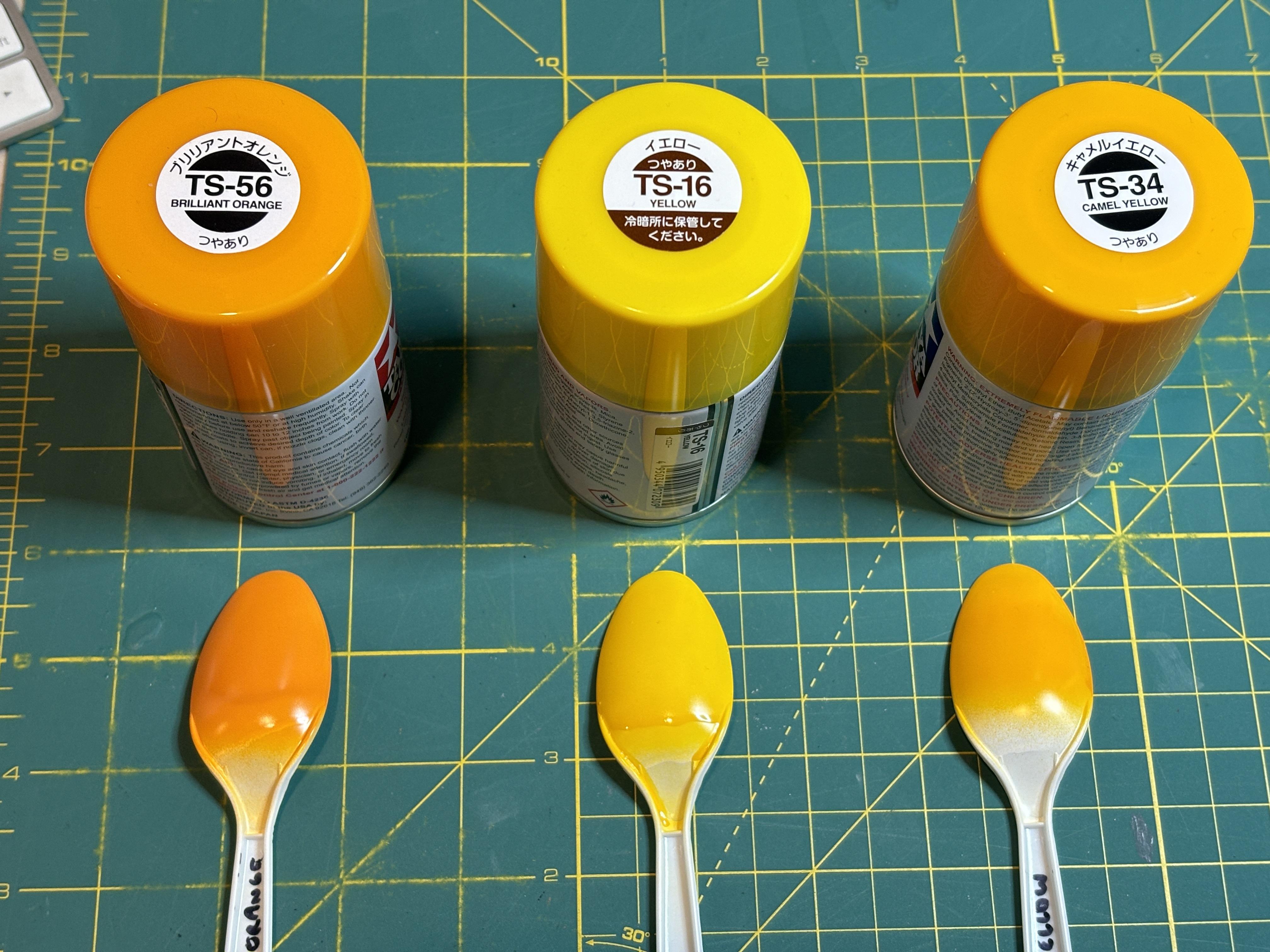

Now onto the paint. This is more or less the color I'm going for:

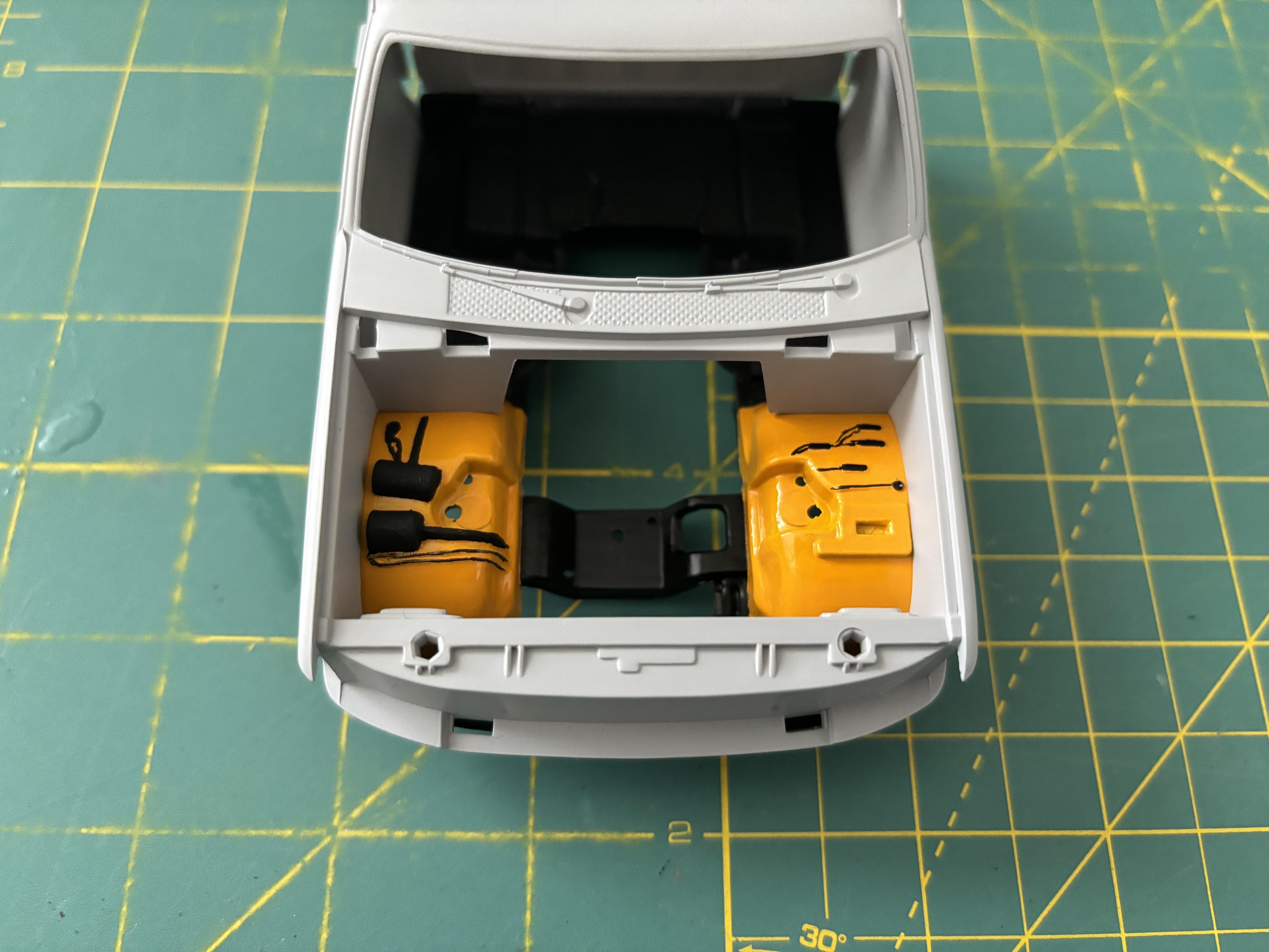

I did spoon tests of various Tamiya colors to see what I liked more. I'm going to proceed with the TS-34 Camel Yellow. It contains that mix of yellow and orange that I desire, as oppose to pure orange or yellow.
I started off by painting the engine bay with the Camel Yellow. I then detail painted various parts of it with Vallejo Black. I'm not a huge fan of the result, but some of these details should be obscured when the engine bay is done. It's my first time assembling an engine on a kit, so this has been a learning experience for me.

Excellent work on the front end! The headlight outlining especially really adds a ton of realism. Did you mask it or freehand it? It's a very clean job.
I did that freehand. It's very easy to do with a Sharpie. The trick is to run the side of the marker tip along the edges, not the tip itself.
