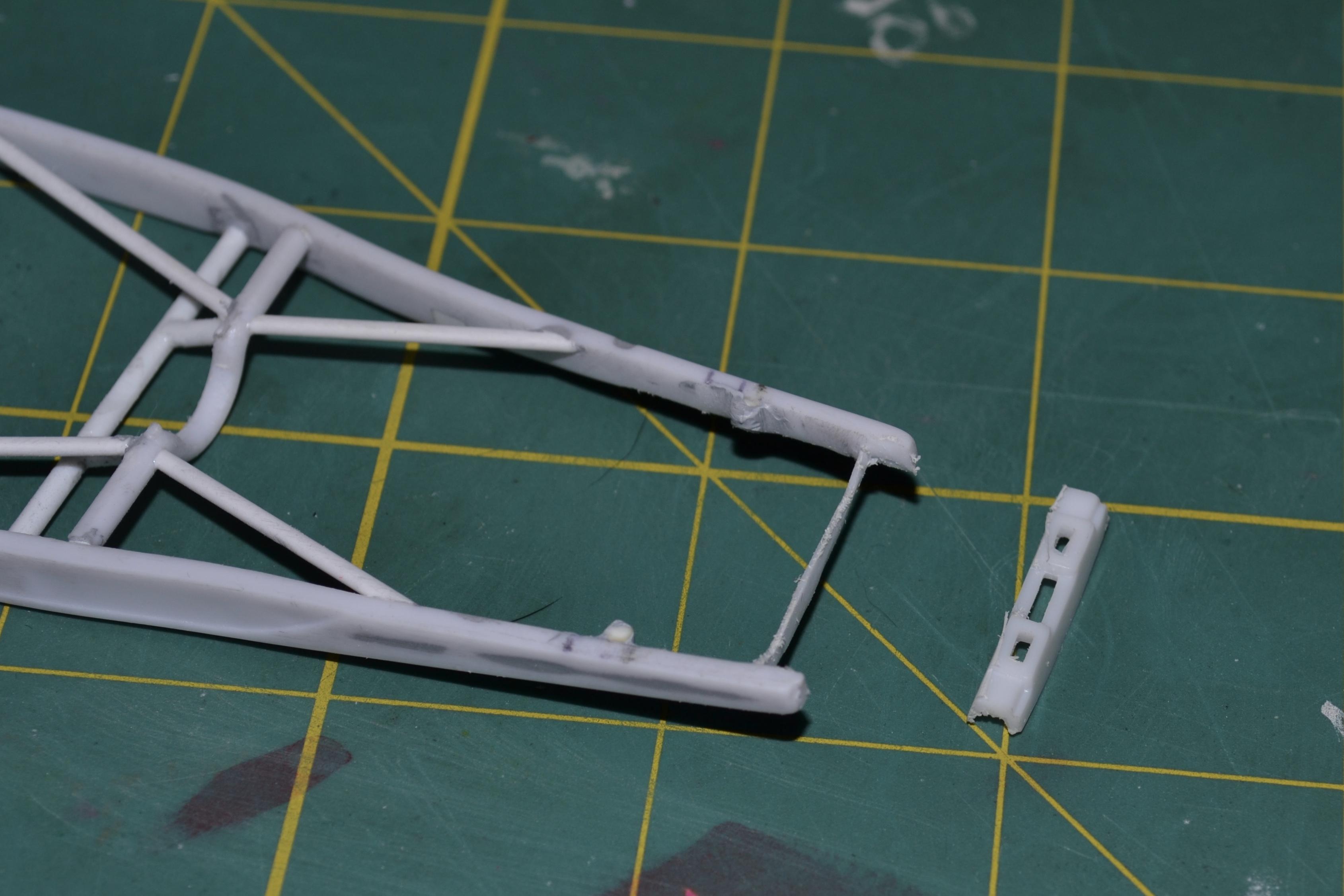

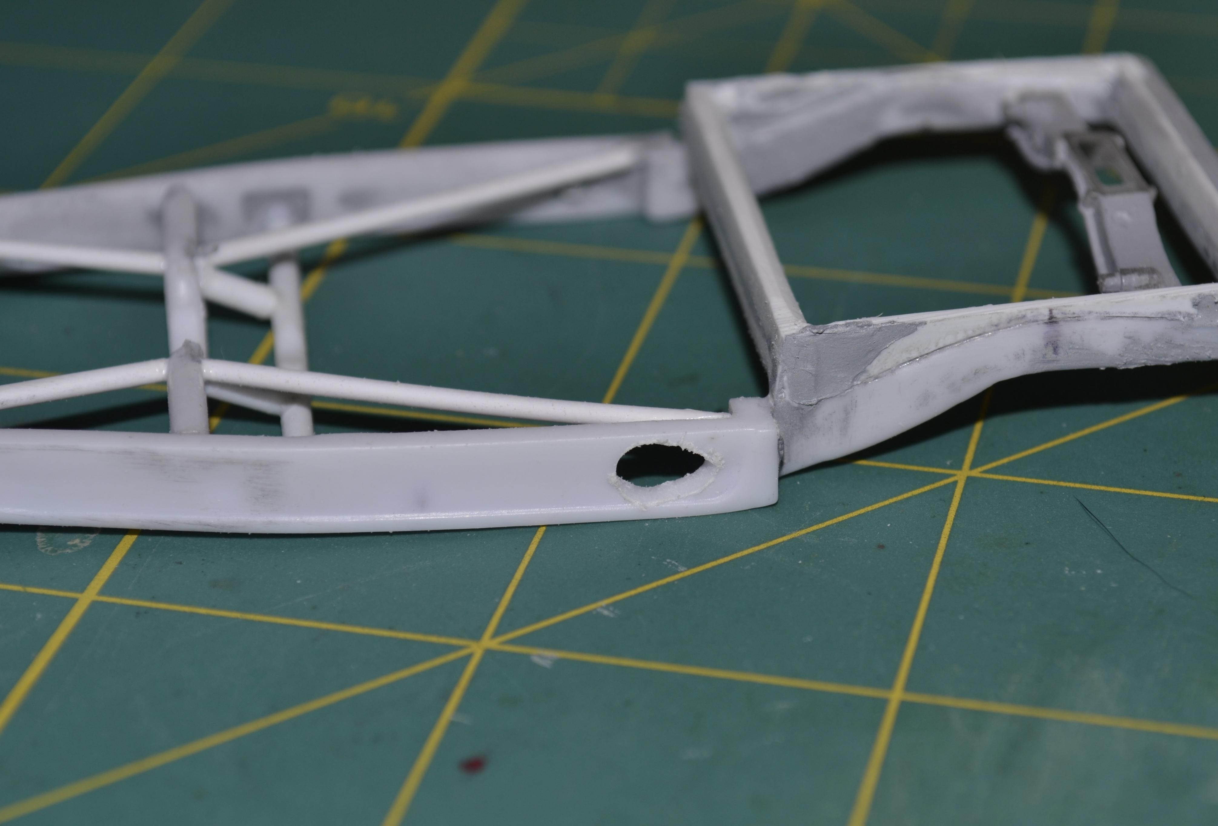

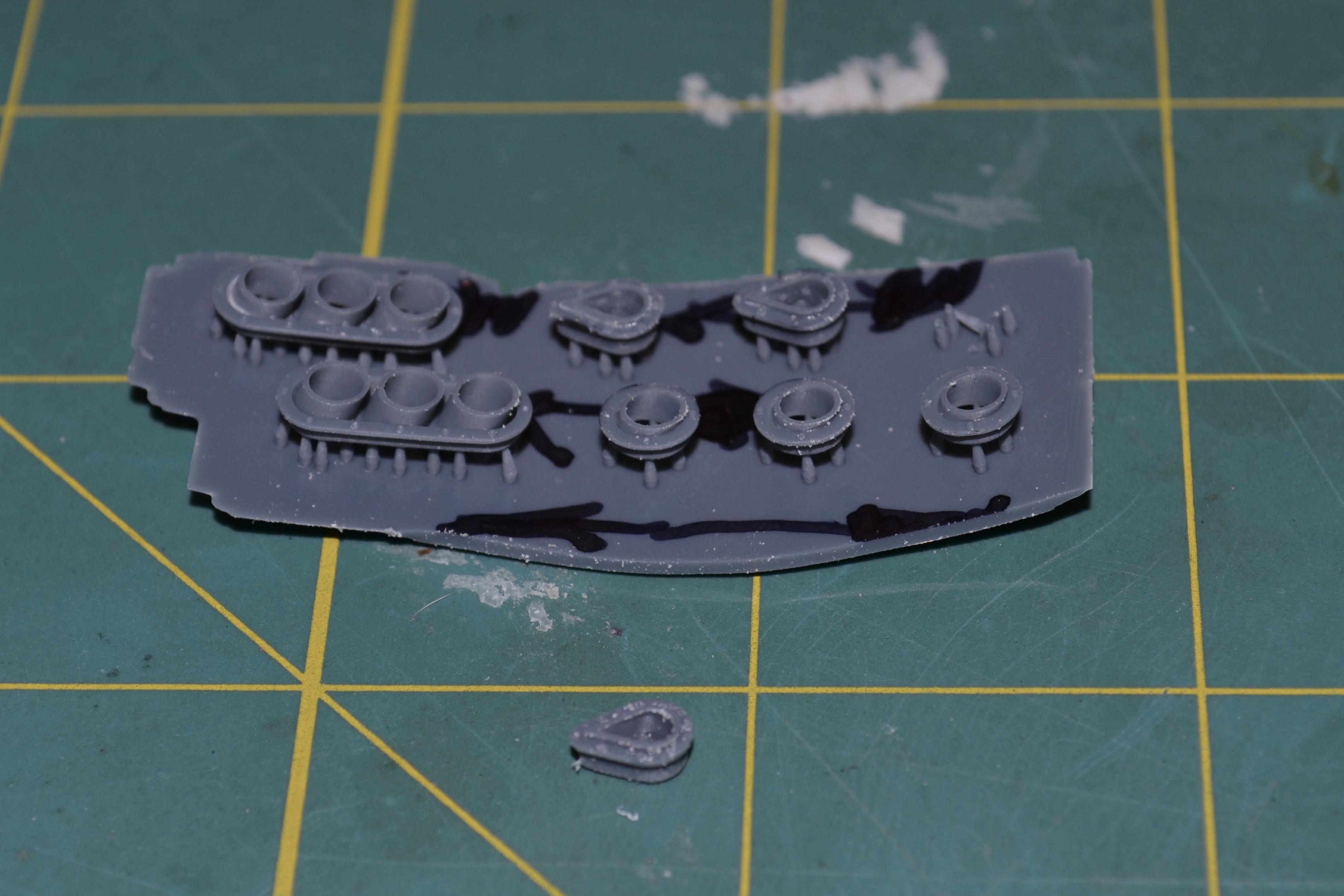

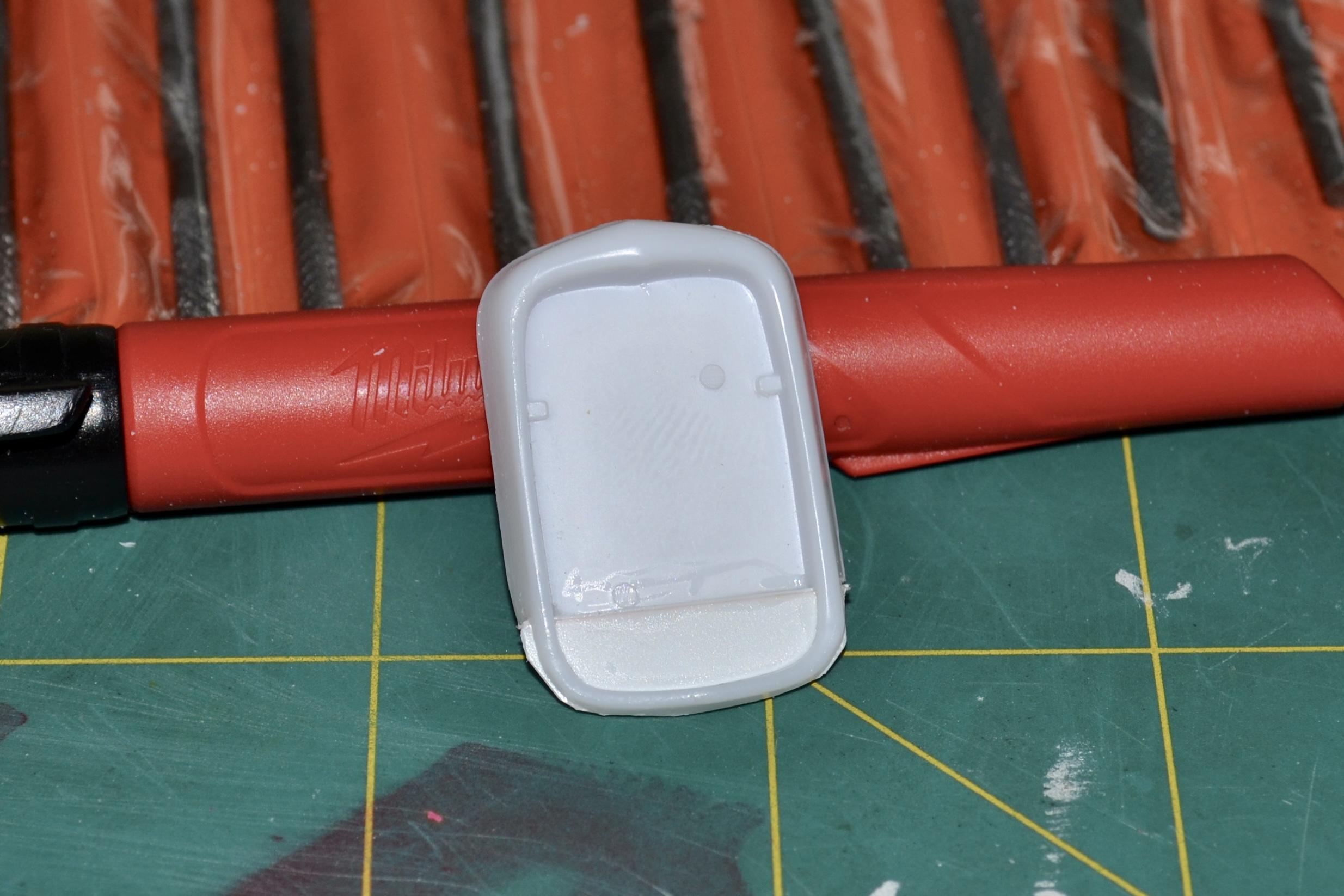

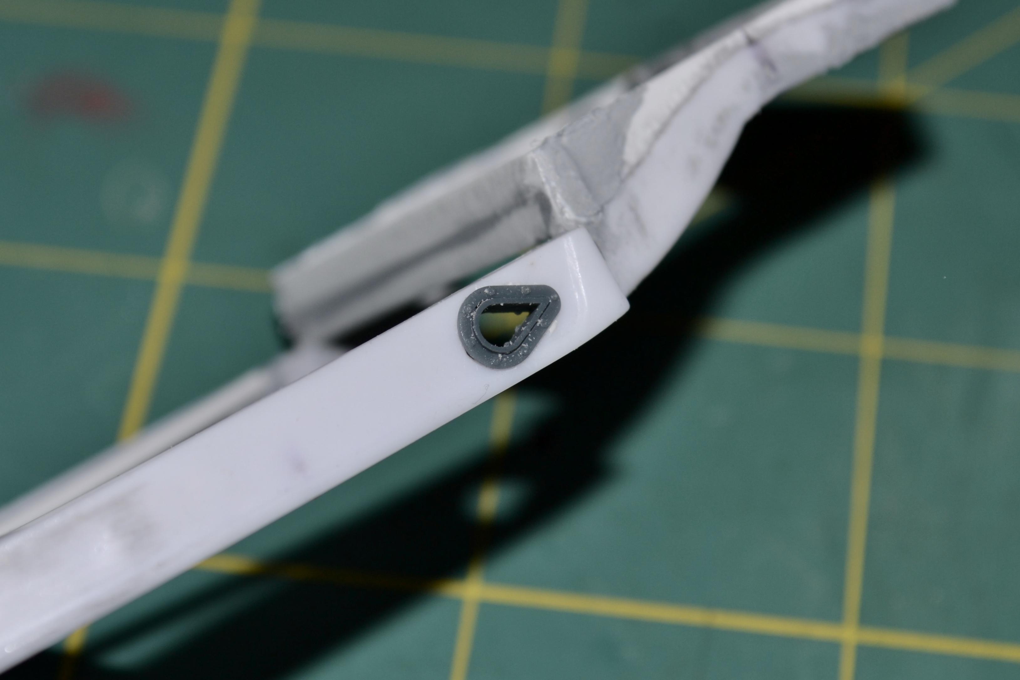

mrm Posted July 7, 2024 Author Posted July 7, 2024 1 hour ago, slusher said: Looking forward too them sir, I am liking your build! Well, while I resolve the issue (tomorrow) I guess I can upload some pics directly. Sorry for the size. The interior was ,made from some modified pieces from the '31 Coupe kit. Templates were made for custom inserts to be added. Next, the horns of the frame were cut off together with the front cross member, leaving just a thin vertical piece of it. Then the modified cross member from a '32 5 window as grafted, resulting in a slightly longer wheelsbase. Experimenting with my first ever 3D printer, I made some through frame exhaust tips. Shrinkage on waterbased resin is ridiculous. Parts were not affected. I cut an opening in the frame rails ahead of the rear wheels to accept the exhaust flange. I am very happy with the look. The '32 grille from the Rat Roaster is definitely too tall for the '30 firewall, so the back of it was cut down and then the grille shell was filled in with styrene. More to come... Thanks for looking and stay tuned. 3

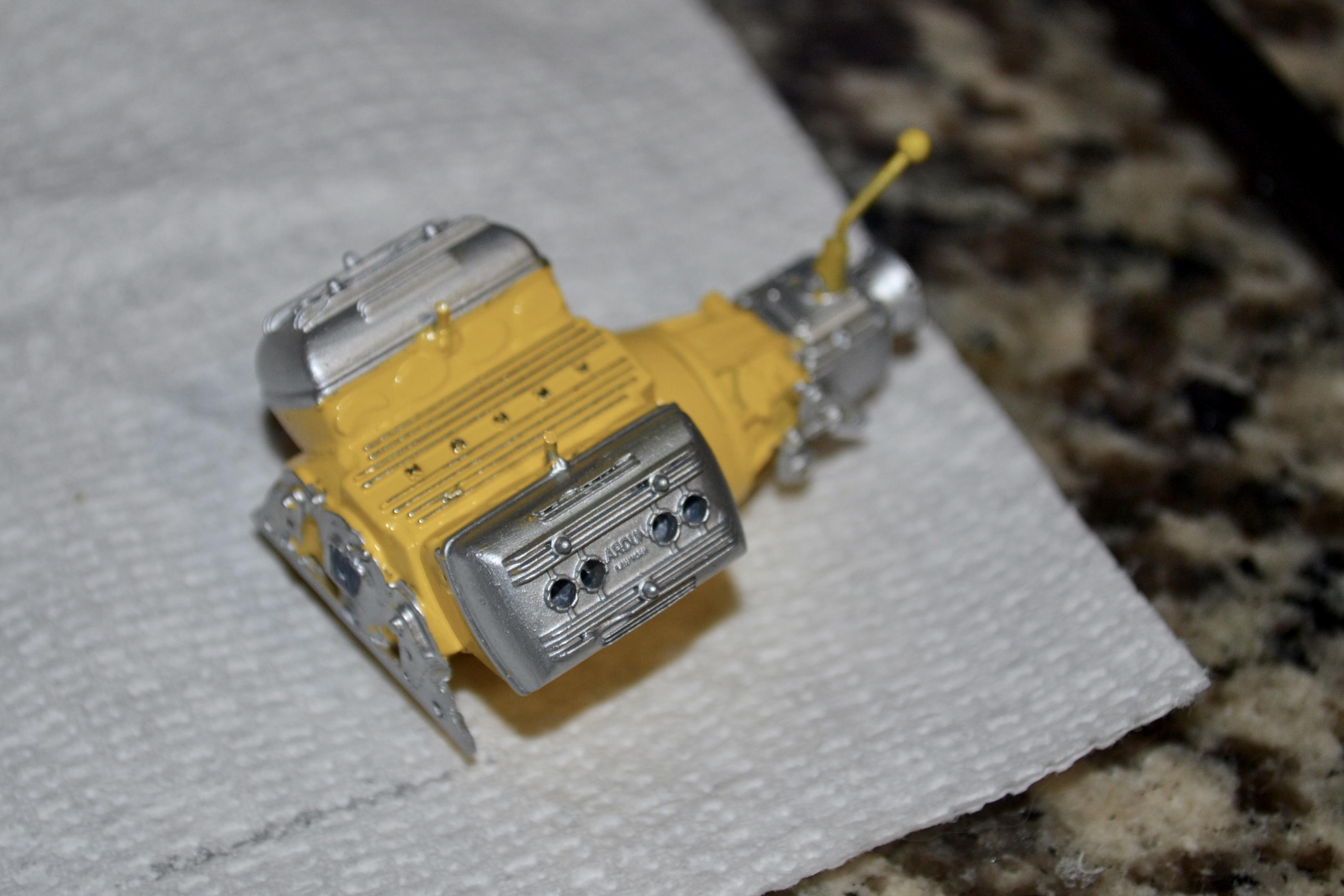

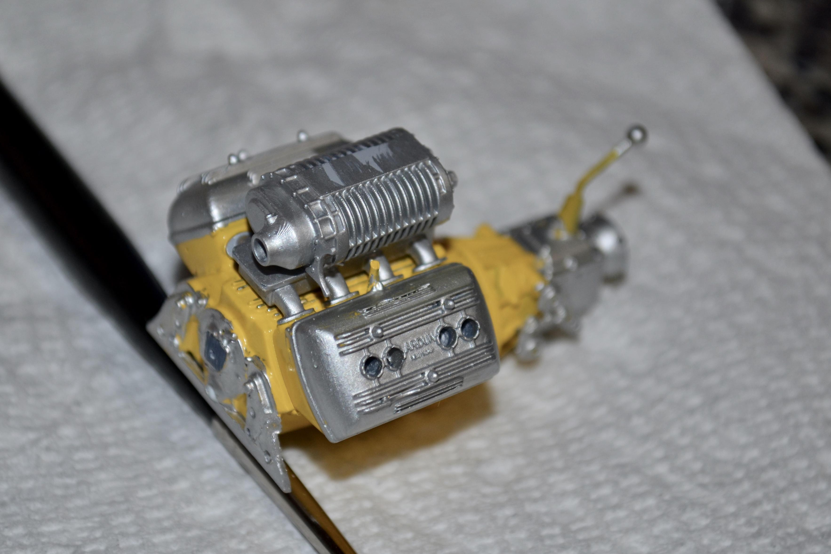

mrm Posted July 7, 2024 Author Posted July 7, 2024 The engine getting closer to be ready. The block was painted Tamiya yellow, while everything else is Model Master Aluminum non-buffing metalizer. 5
