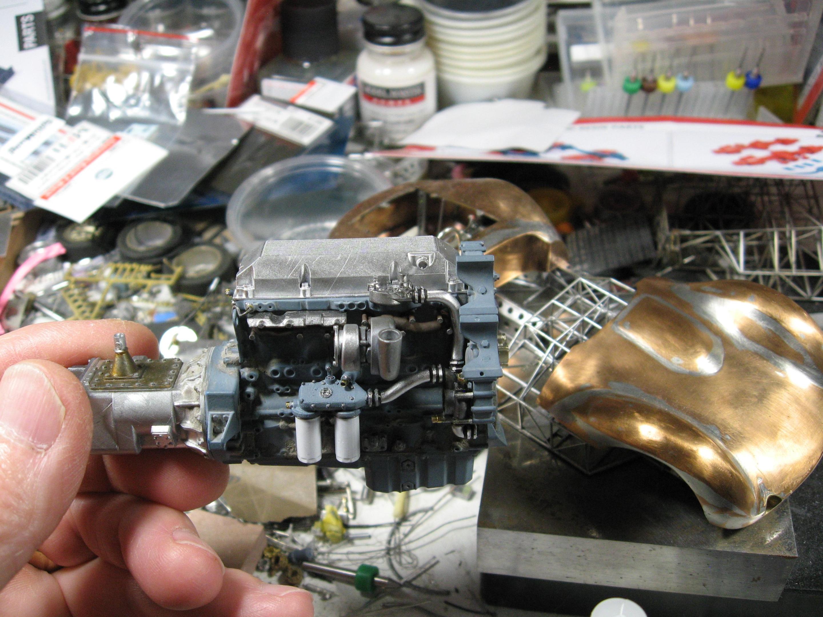

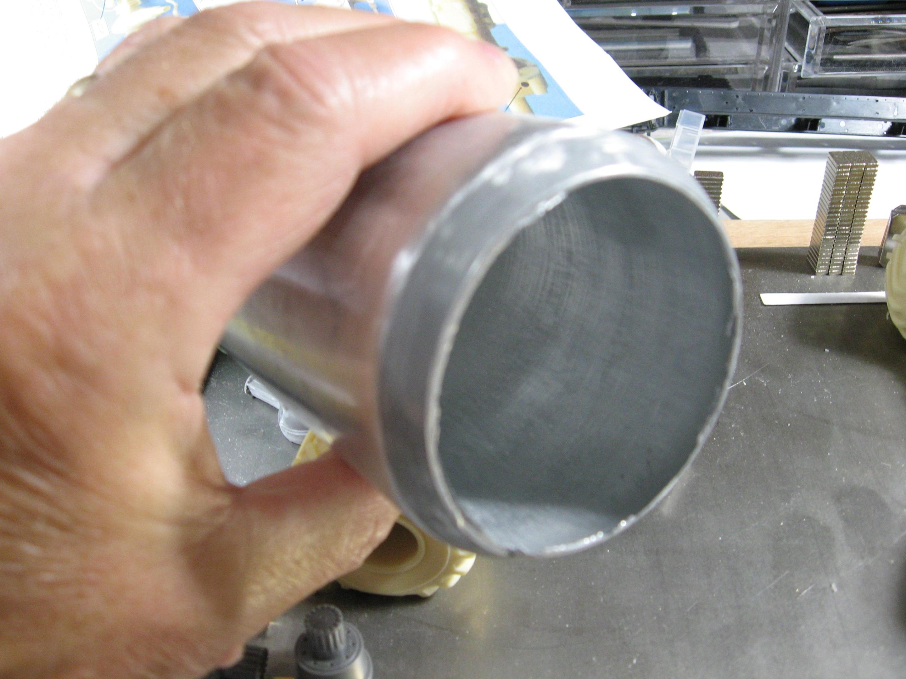

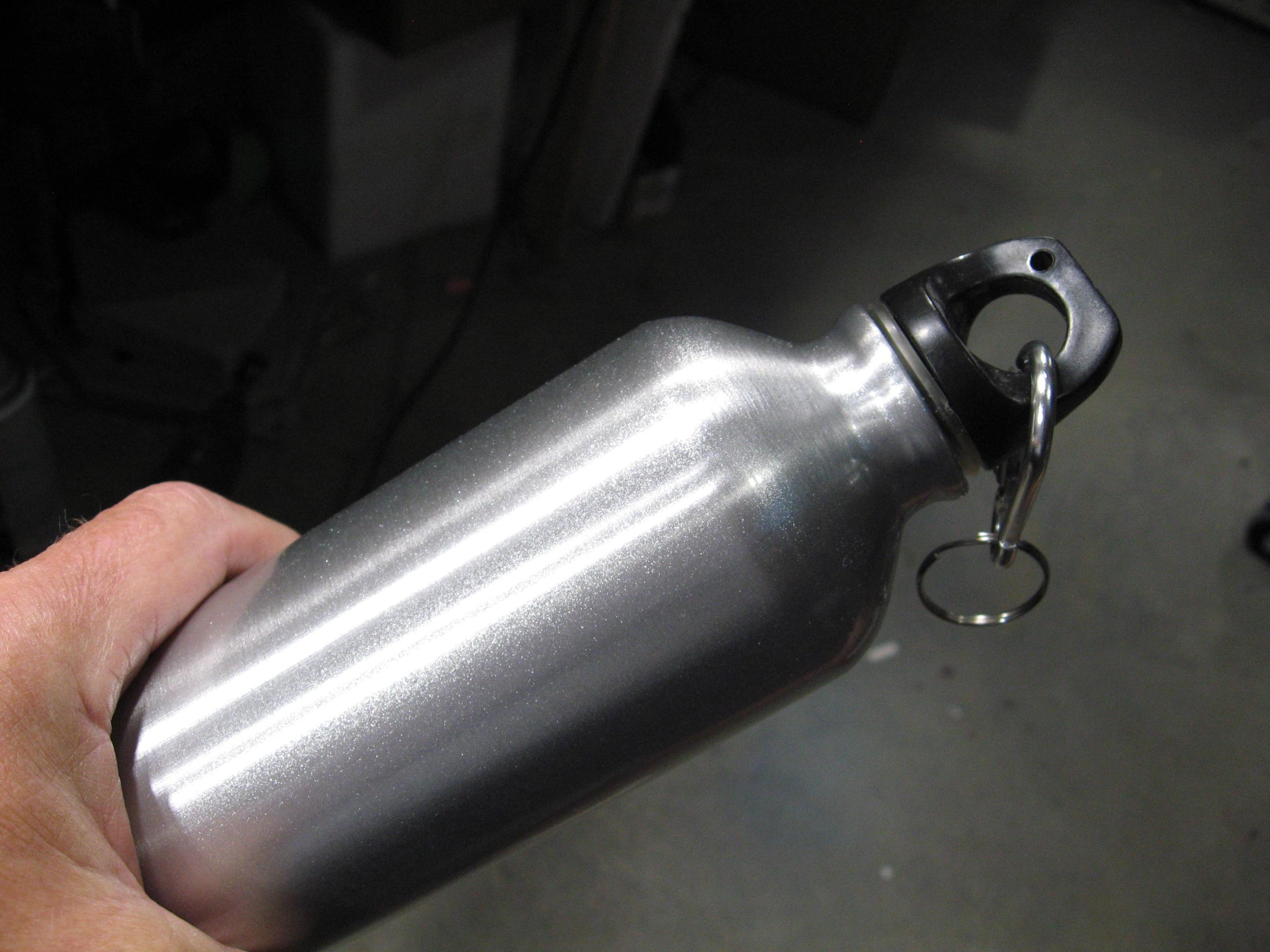

I am going to be doing a heavy duty single axle 4 x 4 with a 2500(???) gallon tank.   Started to gather goodies for this.  KFS for  the driven front axle , assorted valves and the floater tires and rims.  CTM for rear axle, hubs and assorted goodies.  Engine will come from the new release GPModels Detroit Diesel series 60 12.7   I will solder up a frame.  The tank will be a chopped up water bottle.
more to follow..
the engine will wind up somewhere between these two....
Edited by Randy D
  • Like 7

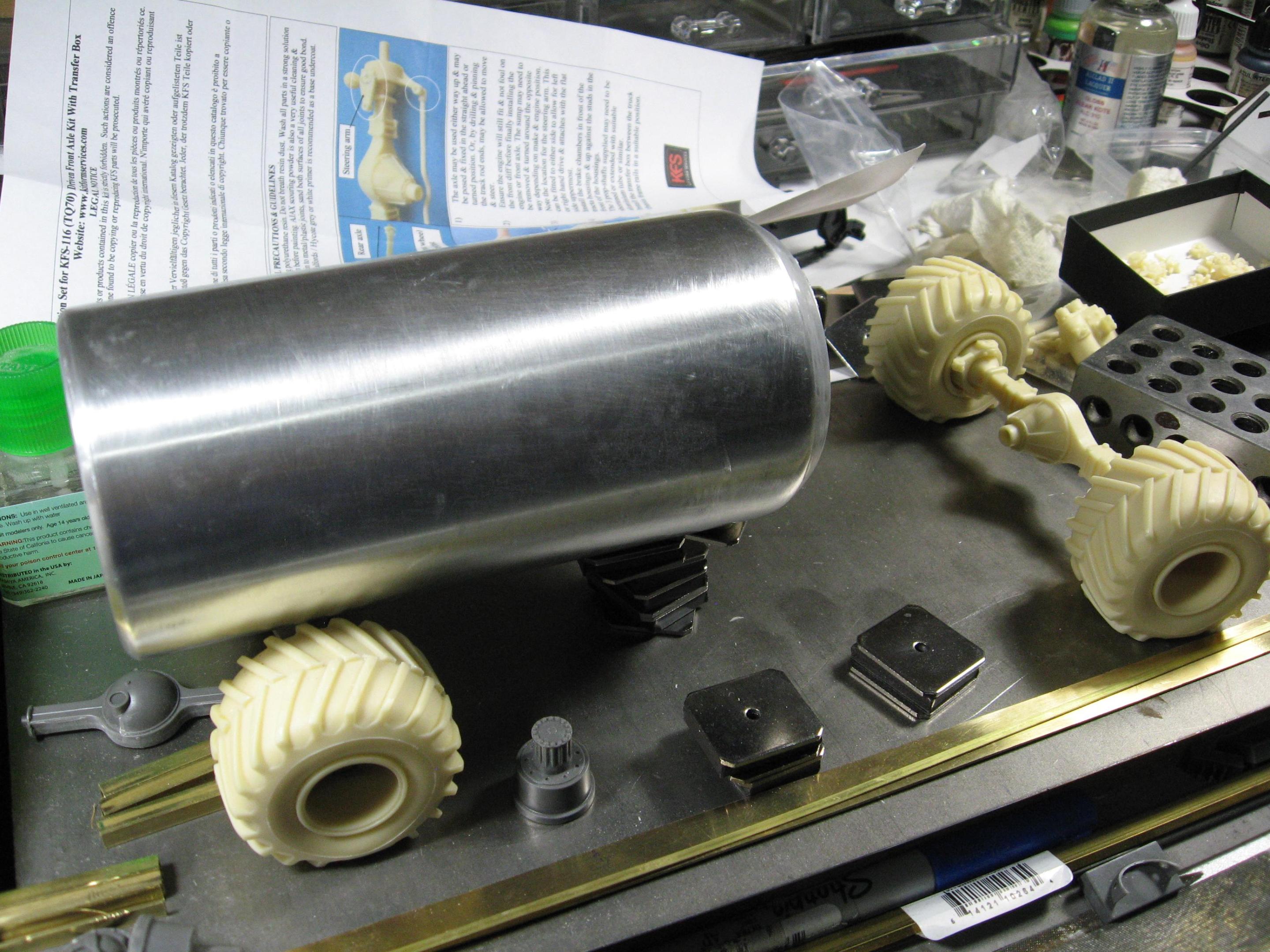

Mock up with tank...

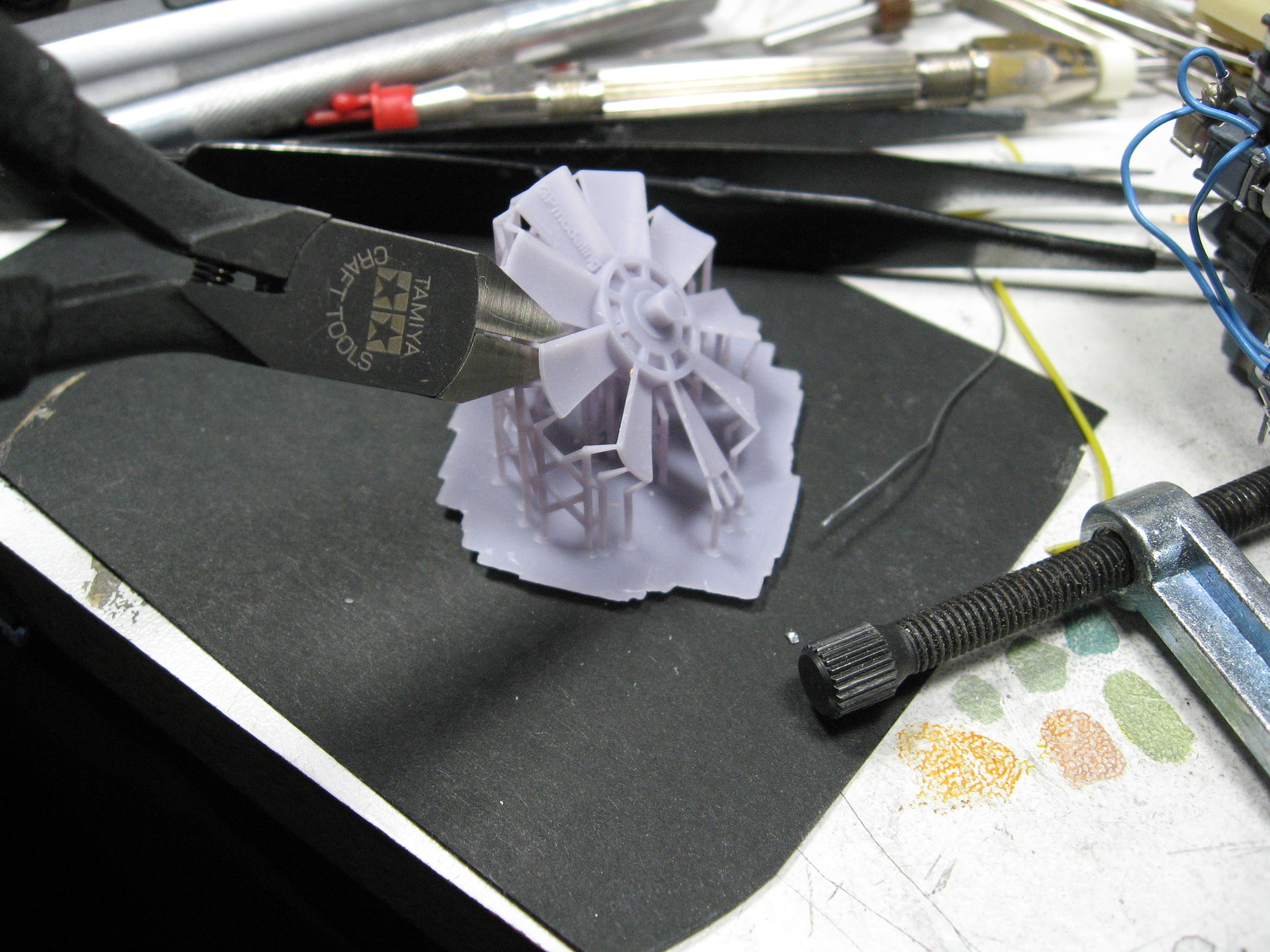

Starting the motor.  A 3d printed kit designed and printed by Claudio de Bellis.  It is beautifully detailed and even includes decals for all the labels and service tags.
You do have to be prepared for alot of this.....
but it is not too bad:)
lots of this...

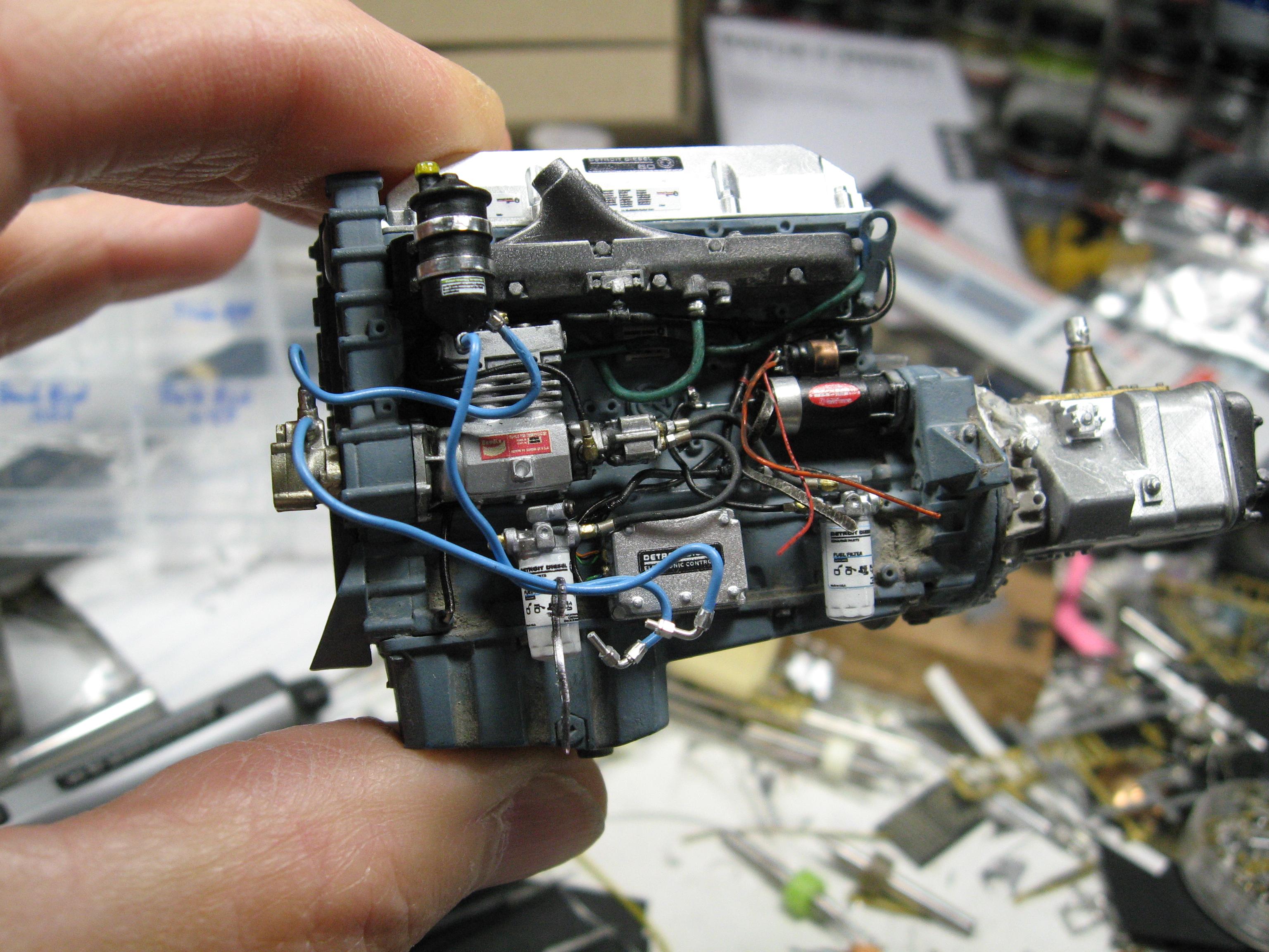

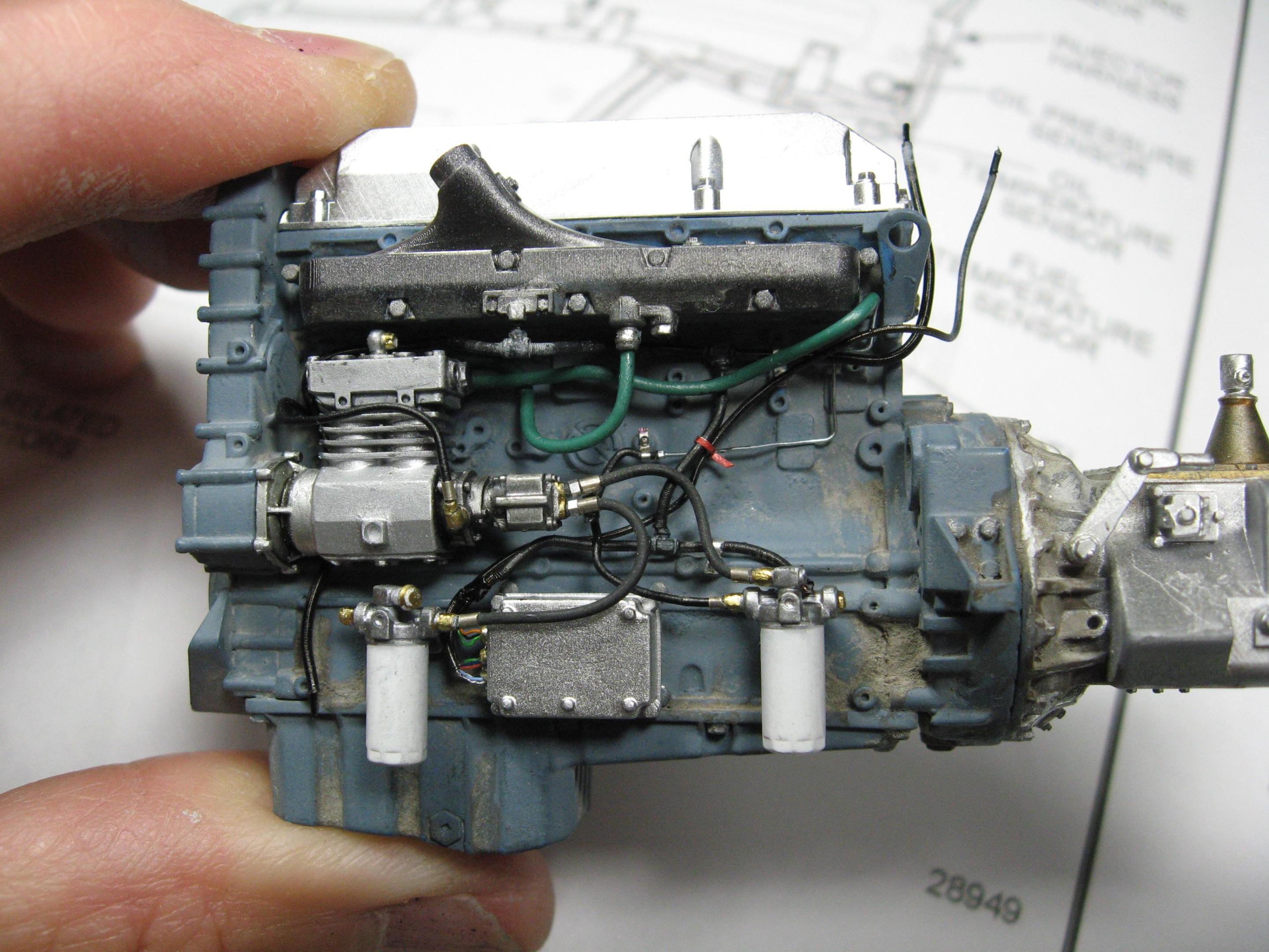

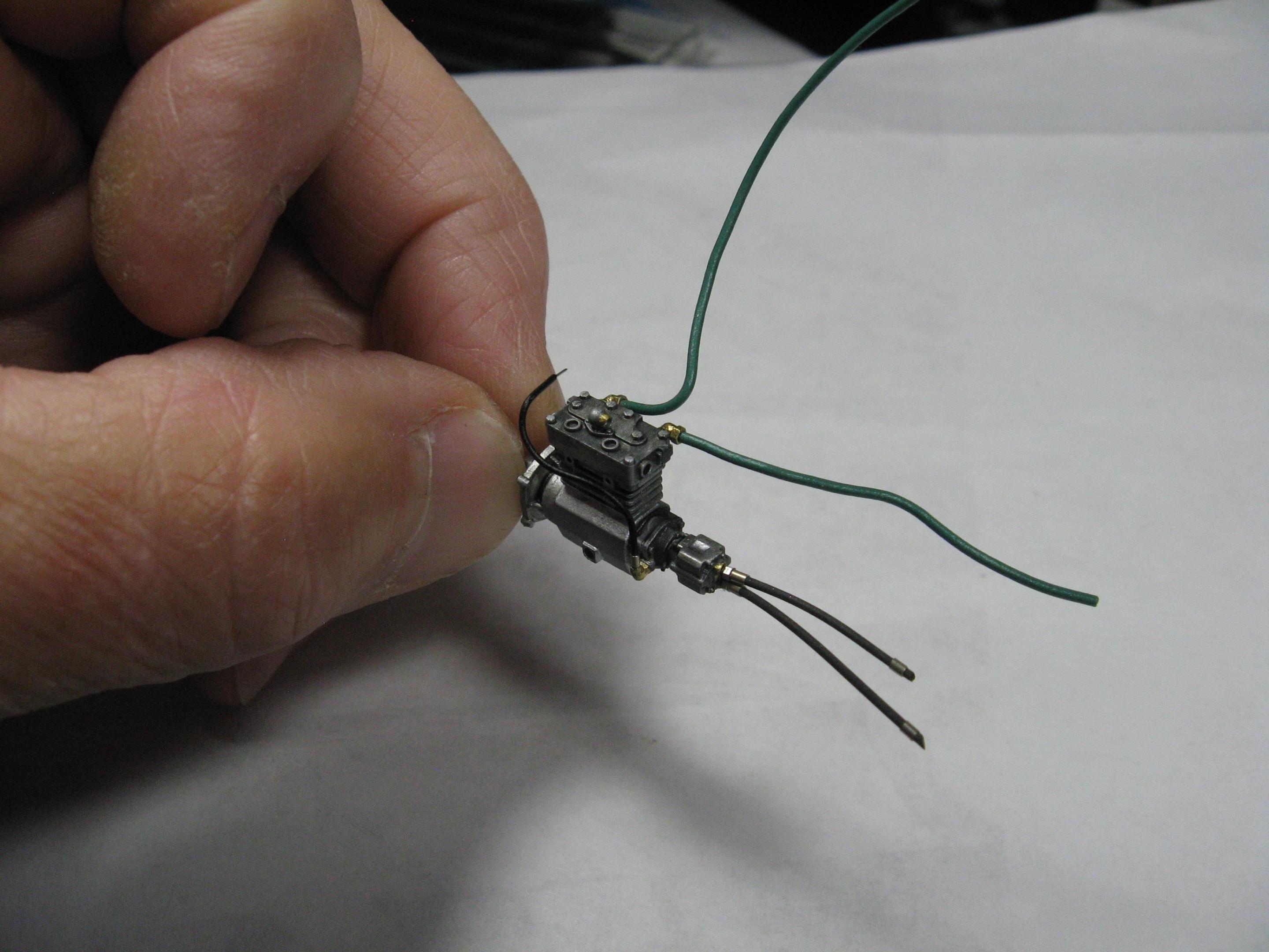

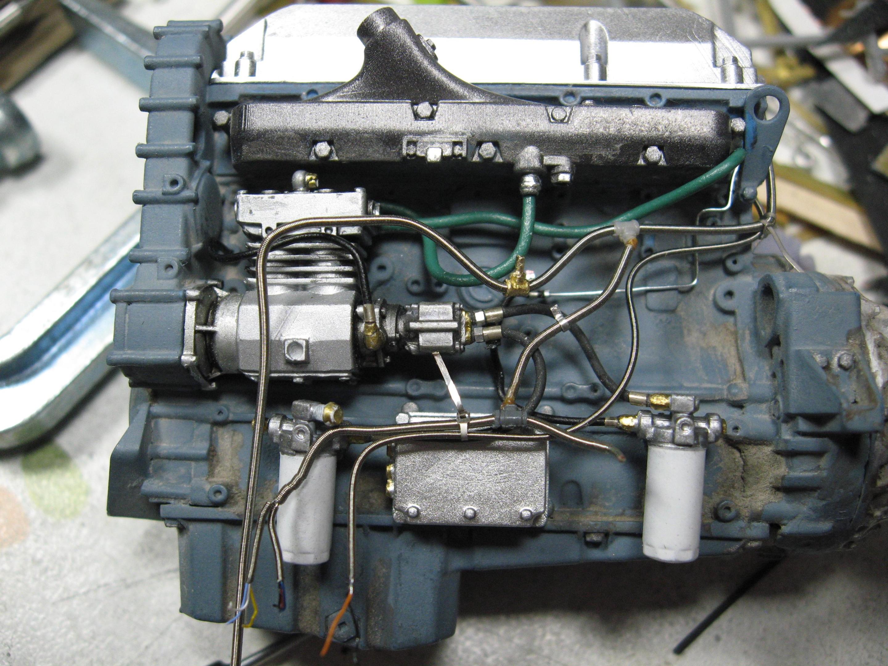

Compressor and primary and secondary fuel filters ...
That is all for now, thanks for looking in.

Watching this one intently for many reasons, including one, the unique subject matter - I see these rigs fairly often in my area, and two - the gp modeling series 60 - this will be the first one built up on the forum. It looks great! I bought two for myself. Also, very impressed with the water bottle idea!

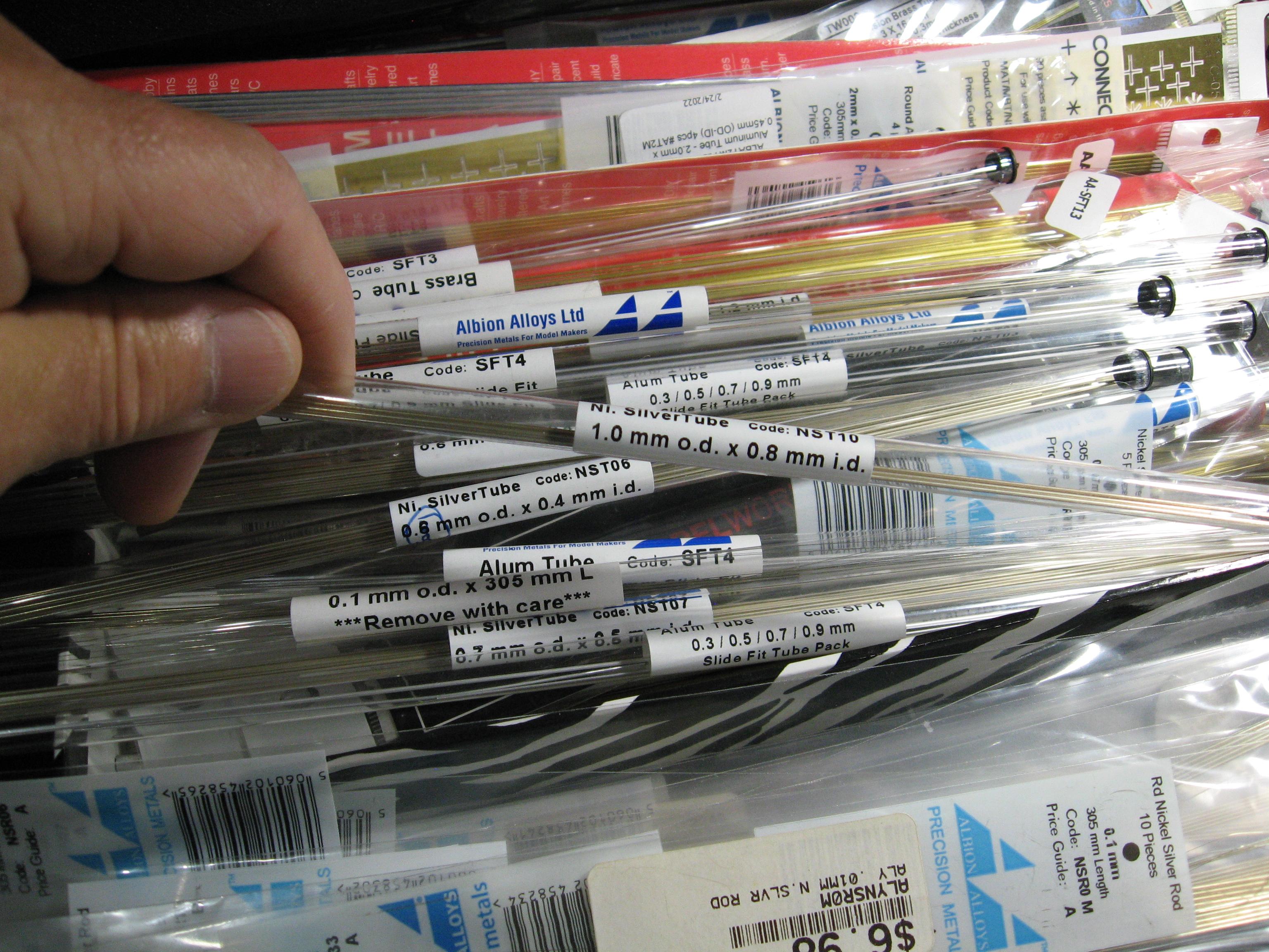

Randy...are the lines for the Compressor and primary/secondary fuel filters have crimped connectors?  How are they connected?

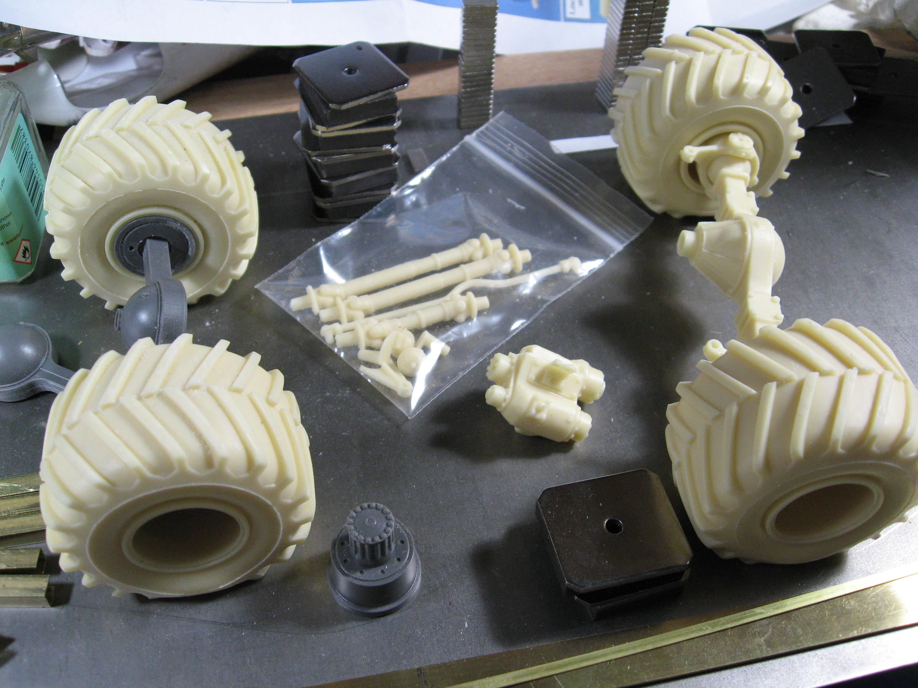

Brian, Thank you!  If I may ask, do you remember what tires you used.  These ones I have from KFS are the "weighted " style and while they are nice I would like to have more options????

Brian,  on the crimped connectors,  I use a slice of thin walled nickel silver tubing then slide it into the printed nut on the part.  Sometimes using a nut from RB Motion..

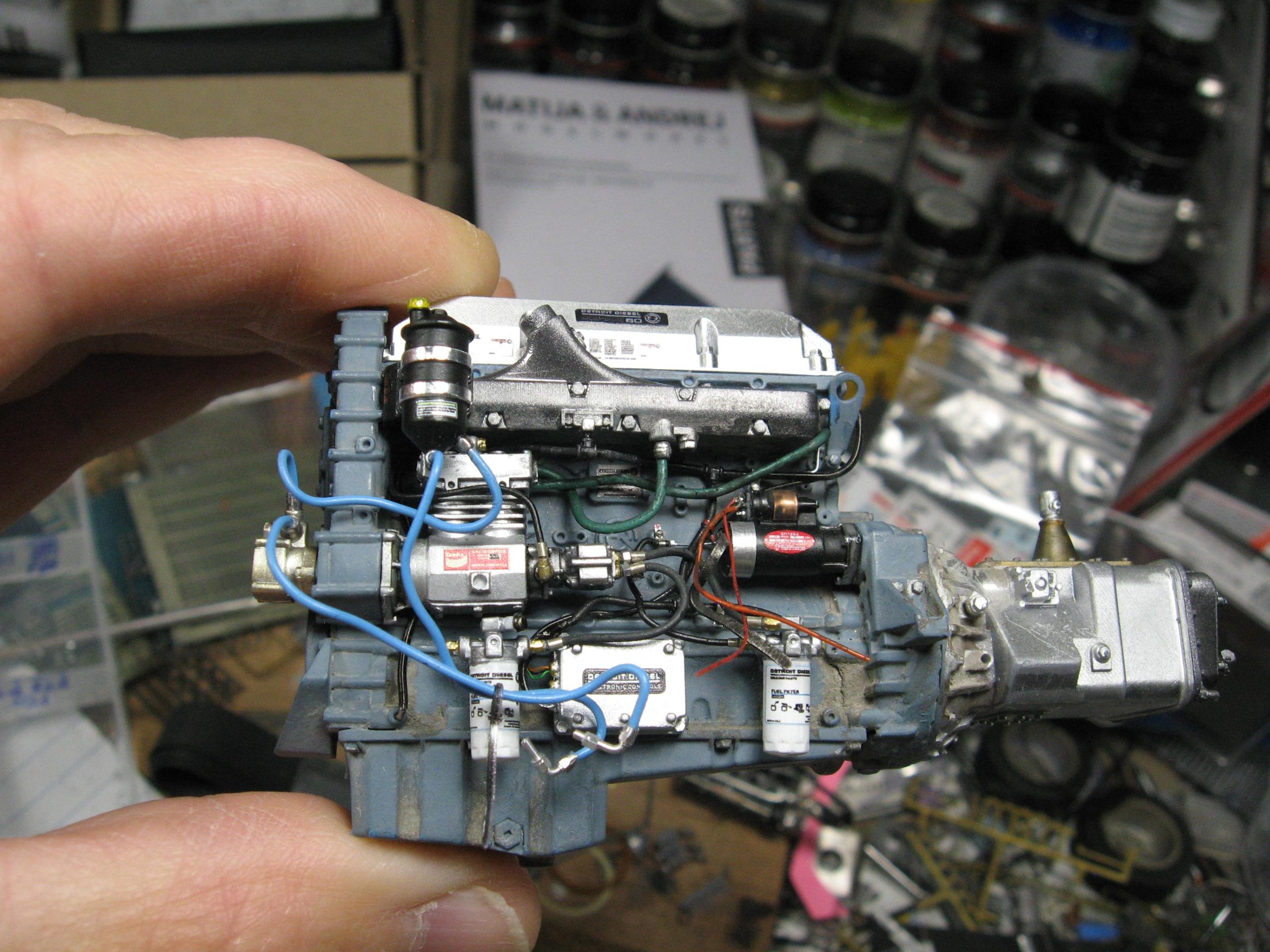

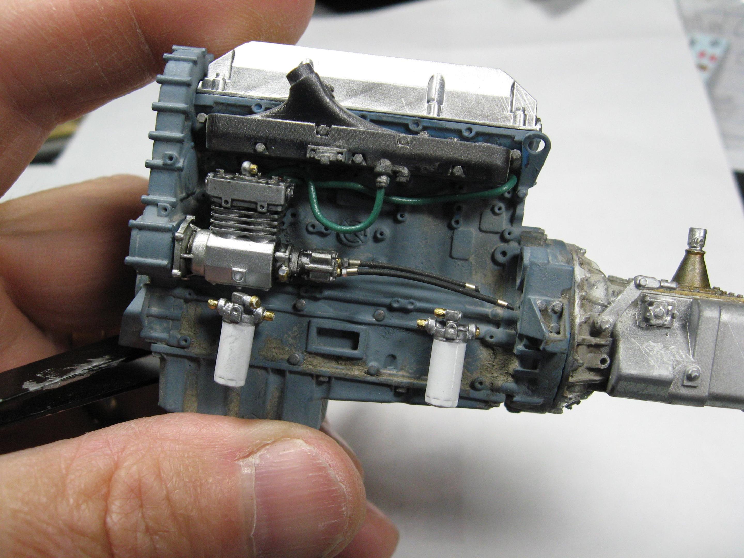

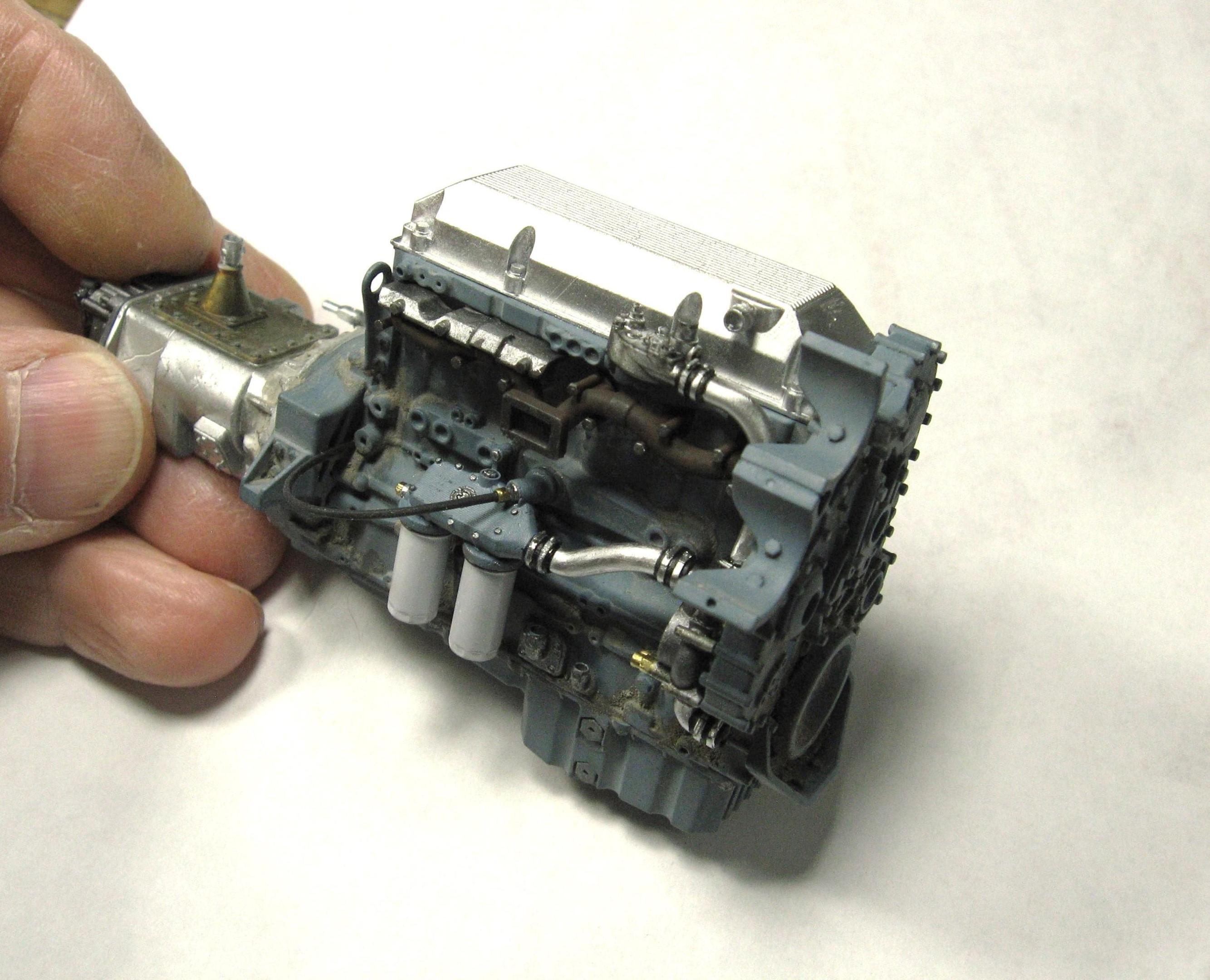

Next up on the motor is  adding some of the wiring harness for the ECM system....
more pics  following...
  • Like 3

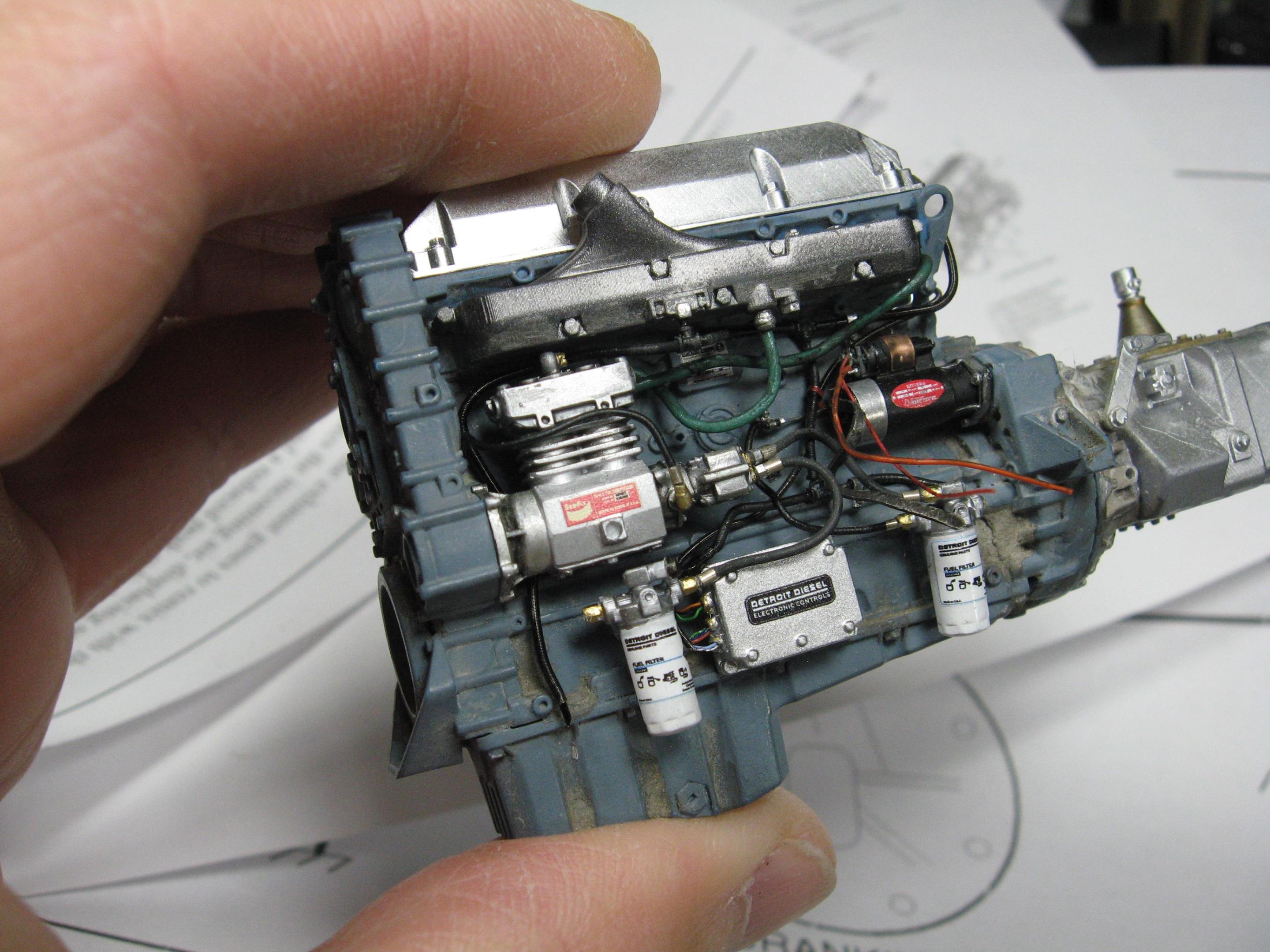

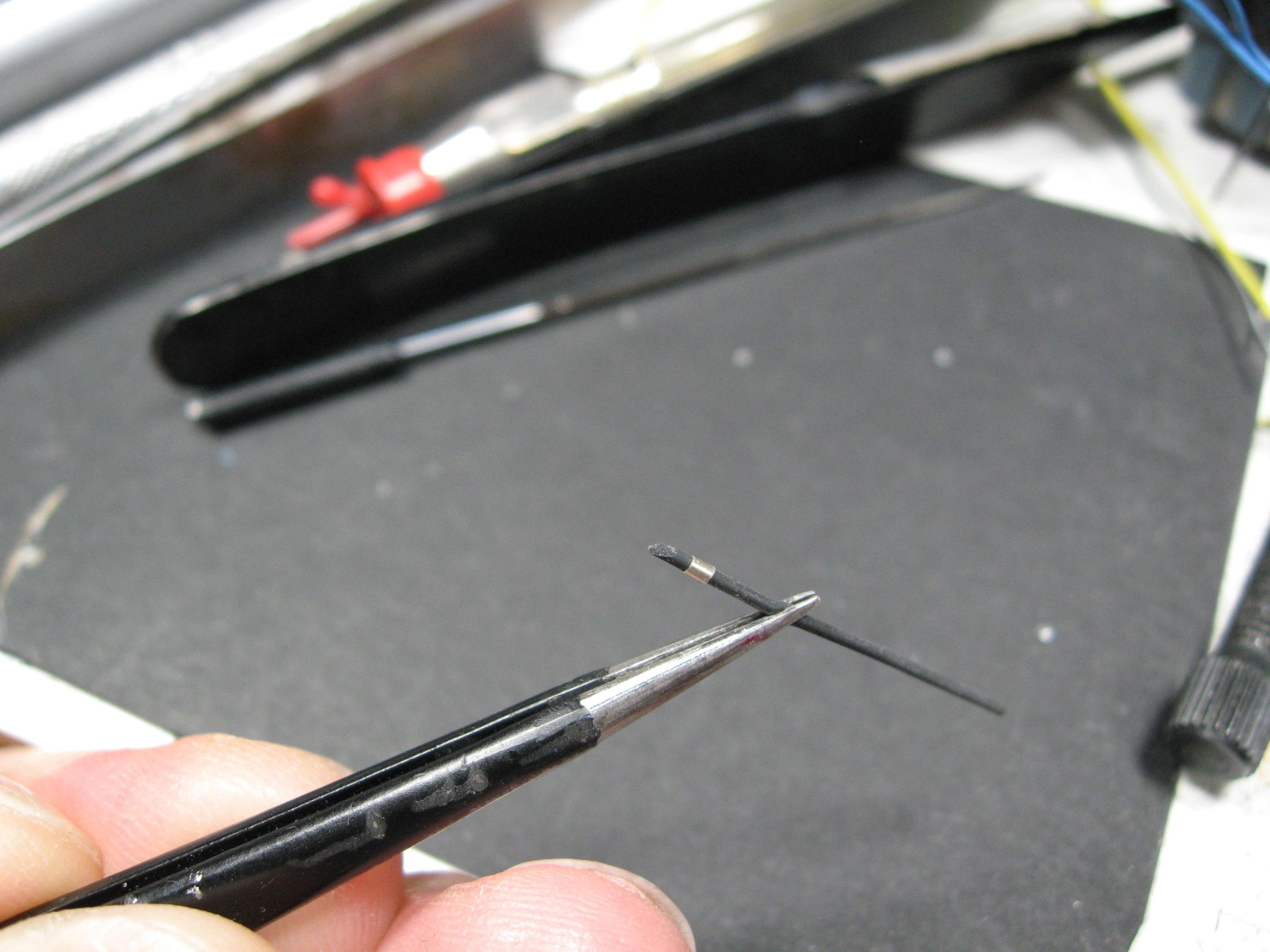

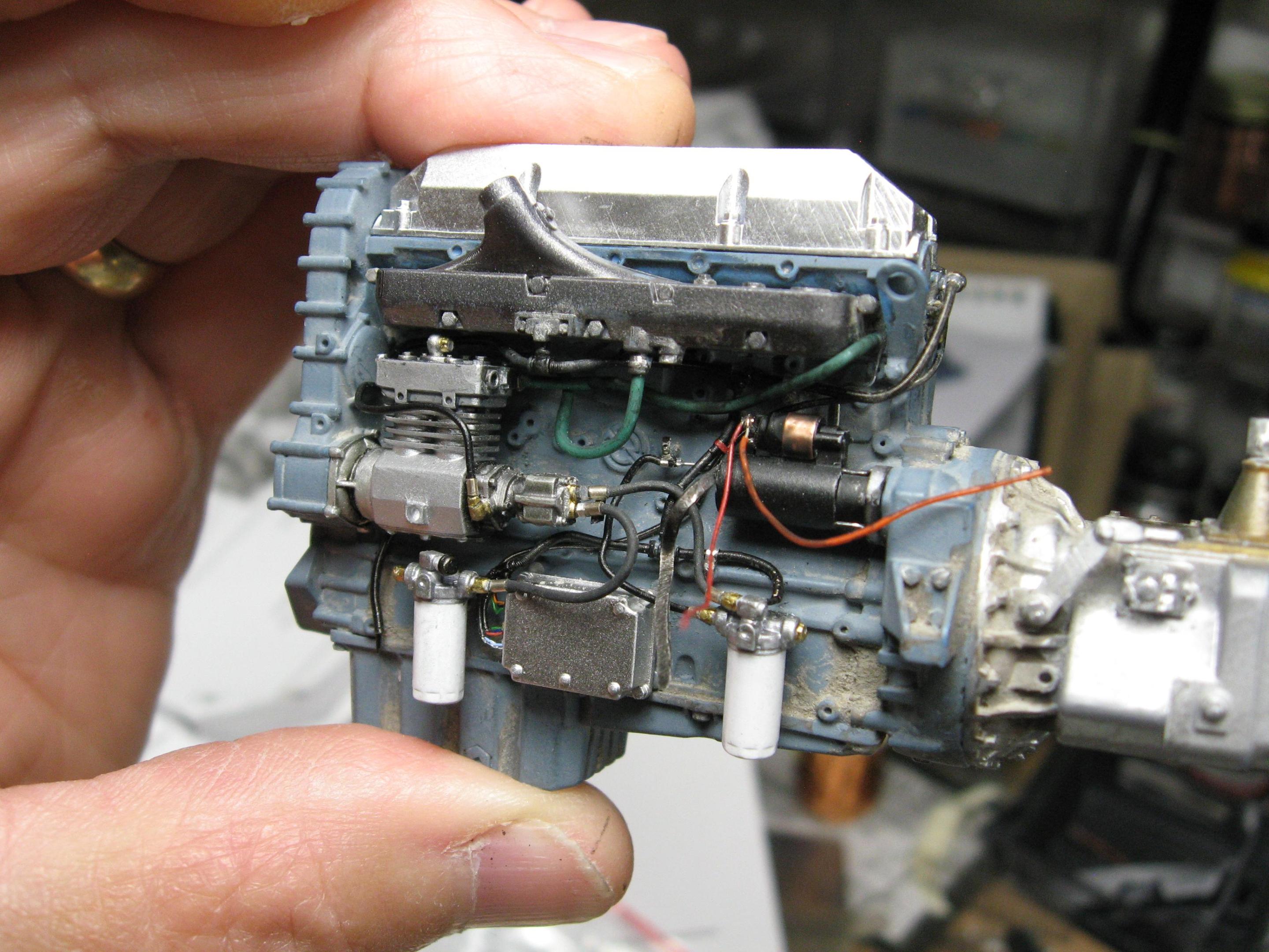

I am using some small springs to simulate all the corrugated sheathing that covers all the wires....
And I discovered that I should have done this part first before the compressor and fuel lines...IMG_5929.thumb.JPG.2a84bedd7edfa4c51545f5fc16e955cb.JPG

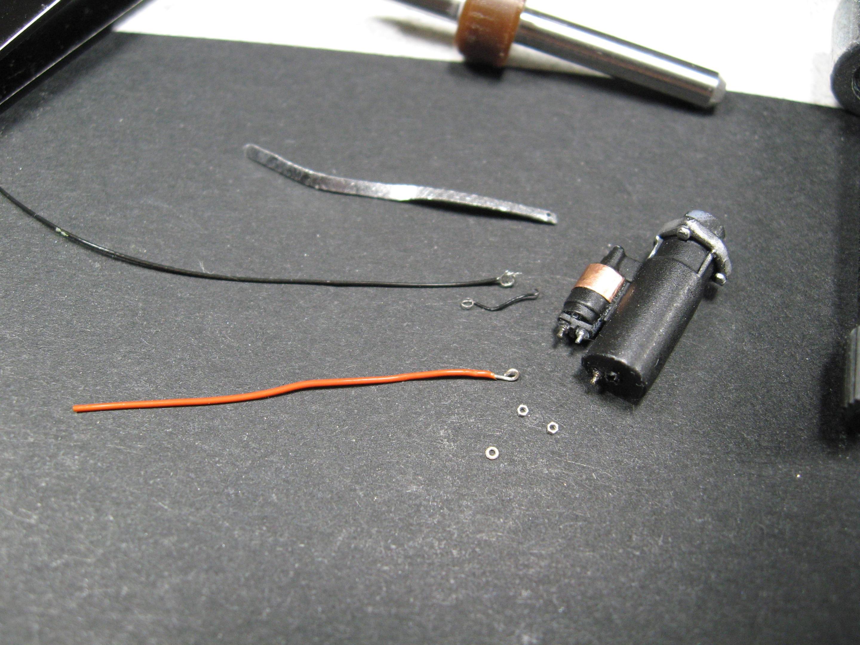

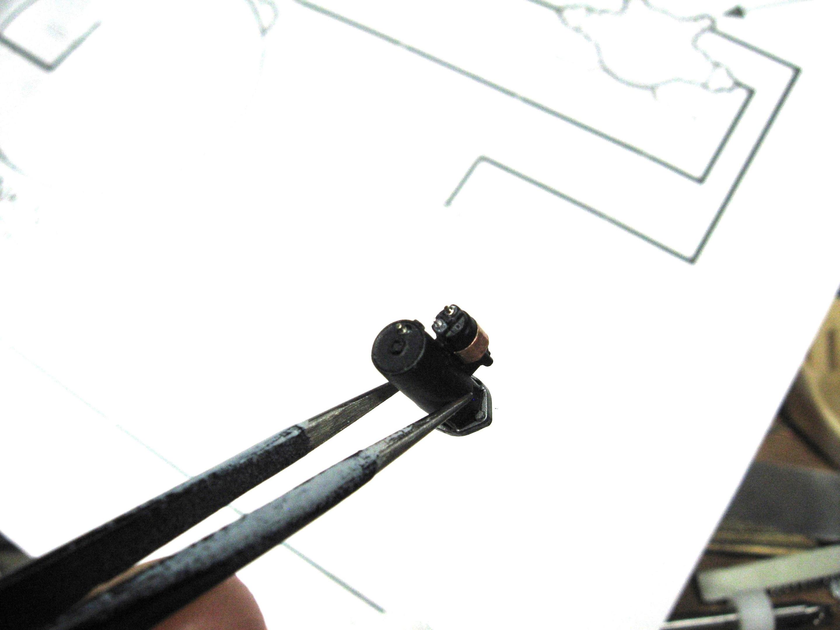

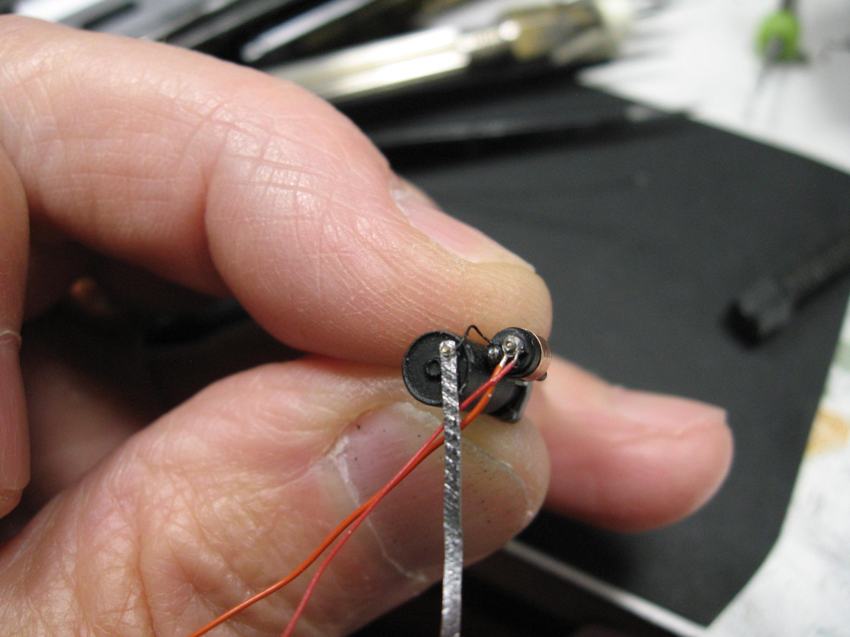

next up is the starter,  added small nuts and bolts so i could wire it up....IMG_5951.thumb.JPG.0f2768b5cfa0848bfad8f2eaad068075.JPG
On the Paystar without a bed I used KFS tires all the way around. It is a four wheel drive.
 The GMC with the spreader bed is two wheel drive. It has 66” monster truck tires on the rear that I made to look weighted and KFS tires on the front.
