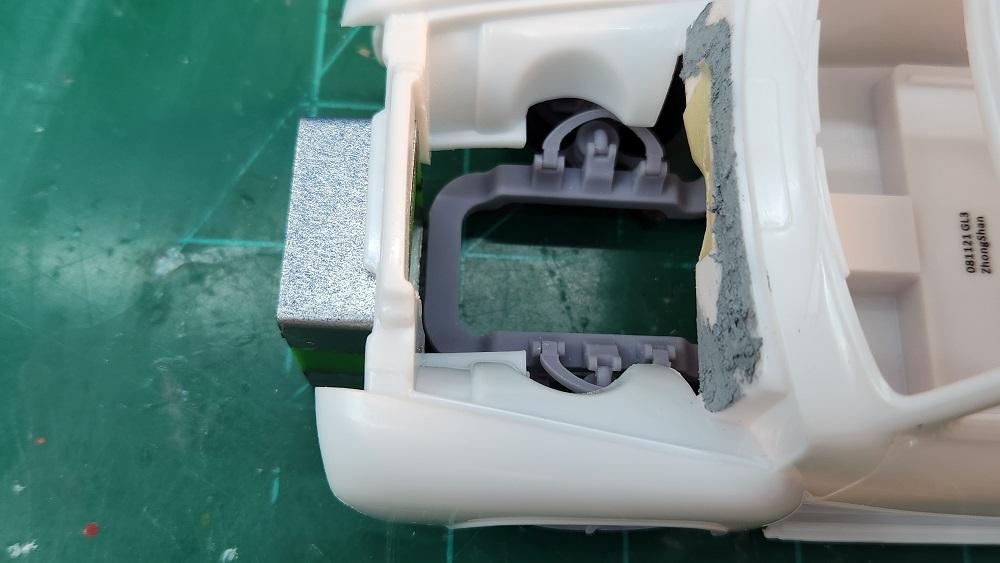

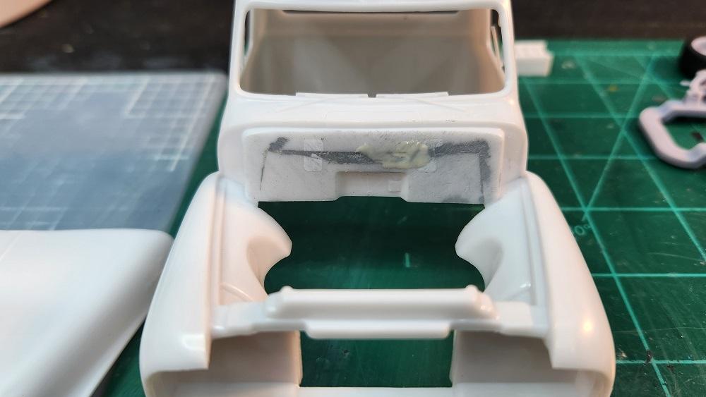

Zippi Posted August 3, 2024 Author Posted August 3, 2024 (edited) I got out in the garage about 7:00 this morning to try and beat the heat. I decided to fill in the firewall and not use the funky hinge that came in the kit. I think my Tamiya putty is starting to dry out in the tube. I have not gotten around to installing the rear axle just yet as I want to set the rear ride height as close to the front as possible. The front suspension is not adjustable but the rear has a small amount of play to work with. This is the first mock-up and there will be many, many more to get the ride height to where I'm happy with it. Edited August 3, 2024 by Zippi 2
Zippi Posted August 3, 2024 Author Posted August 3, 2024 54 minutes ago, slusher said: Bob are you going to build another firewall? No. I plugged and puttied the kit firewall. Once dry I'll sand it smooth. That's the plan anyway.

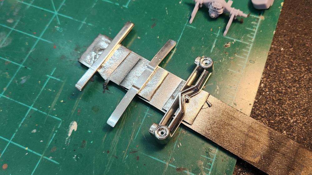

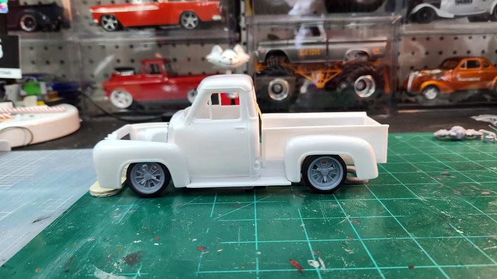

Zippi Posted August 3, 2024 Author Posted August 3, 2024 I think I'm getting close on getting my front and rear axles figured out. I used some 1/8" X .014 aluminum tube to get my proper width. I'll epoxy the aluminum tube to the wheels then to the front and rear suspension. I do need to cut a little off the rear axle tube support rods but no biggie. 3
SpikeSchumacher Posted August 3, 2024 Posted August 3, 2024 Hey Bob, that's looking good! You could also C-notch some clearance for the axle as well. Whichever would be easier I guess...?
Zippi Posted August 3, 2024 Author Posted August 3, 2024 1 minute ago, SpikeSchumacher said: Hey Bob, that's looking good! You could also C-notch some clearance for the axle as well. Whichever would be easier I guess...? I appreciate it Spike. That Iceman drop chassis already has a Hugh "C" notch. I need to adjust the rear axle support tubes for fore/aft, not up/down.

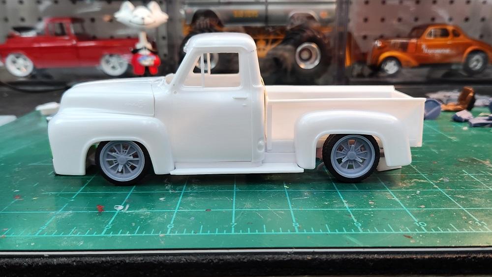

Zippi Posted August 4, 2024 Author Posted August 4, 2024 (edited) I just wasn't satisfied with the wheel base so I cut the chassis back apart and cut another 1/8" off. Now the "C" notch looks better coming through the bed opening and the wheels look positioned much better in the fender openings. I may need to cut out the front fender wells. Still a lot of clean up to do and I still haven't picked a color yet. I need to get on this as I need to get the 427 painted and assembled. I got the first sanding completed on the firewall. It's looking smooth but had a little hole. Picked up some Mr. Hobby White Putty at HL yesterday but this stuff takes 24 hrs to dry. This should be all the putty work. Next I'll hit it with some primer to see what I missed. Edited August 4, 2024 by Zippi 3

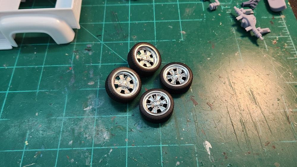

Zippi Posted August 7, 2024 Author Posted August 7, 2024 I decided to make my own fuel tank so I went on the hunt in my parts box and my old RC parts box. I came up with a moon tank and a plastic sleeve from the RC box. I think once I hit it with a little putty, sand it, then shoot it with some Molotow chrome it should look pretty good. I also got the tires mounted on the wheels. I'm still working on making that sun-visor since I can't find an after market one. It hasn't got the best of me just yet. 1
