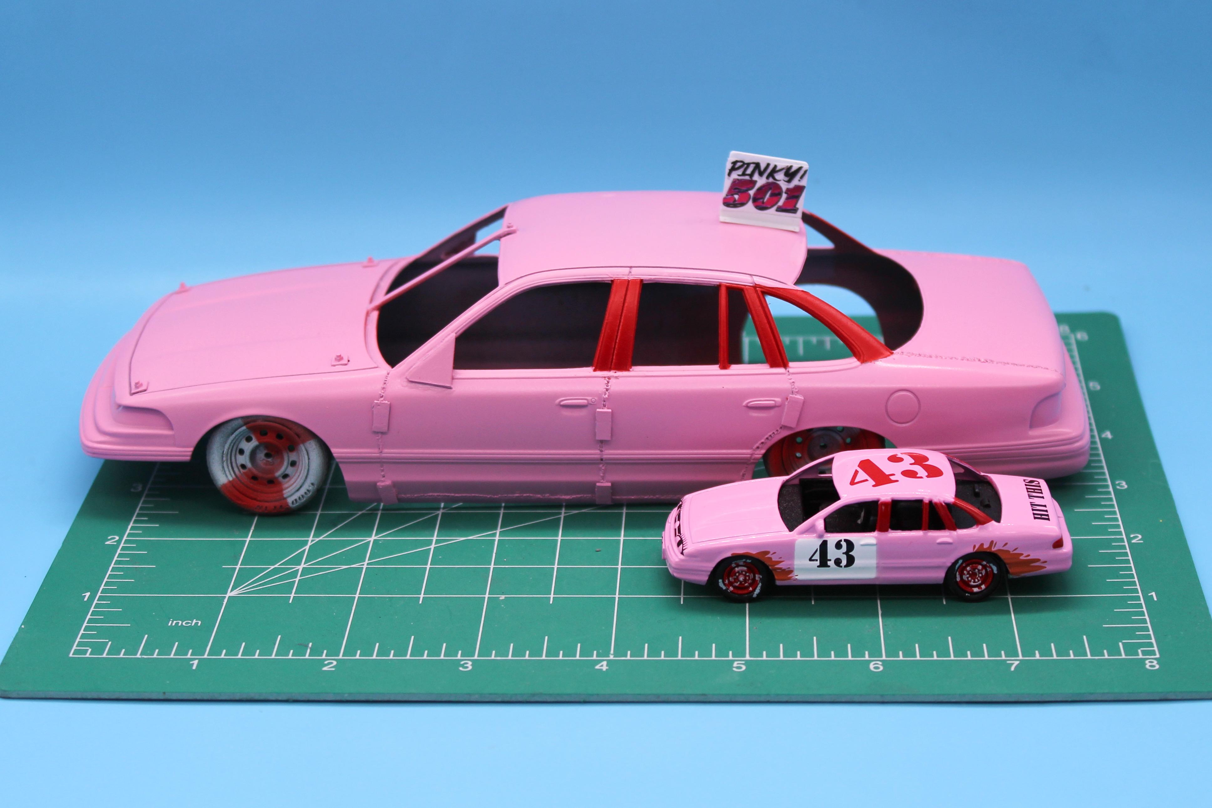

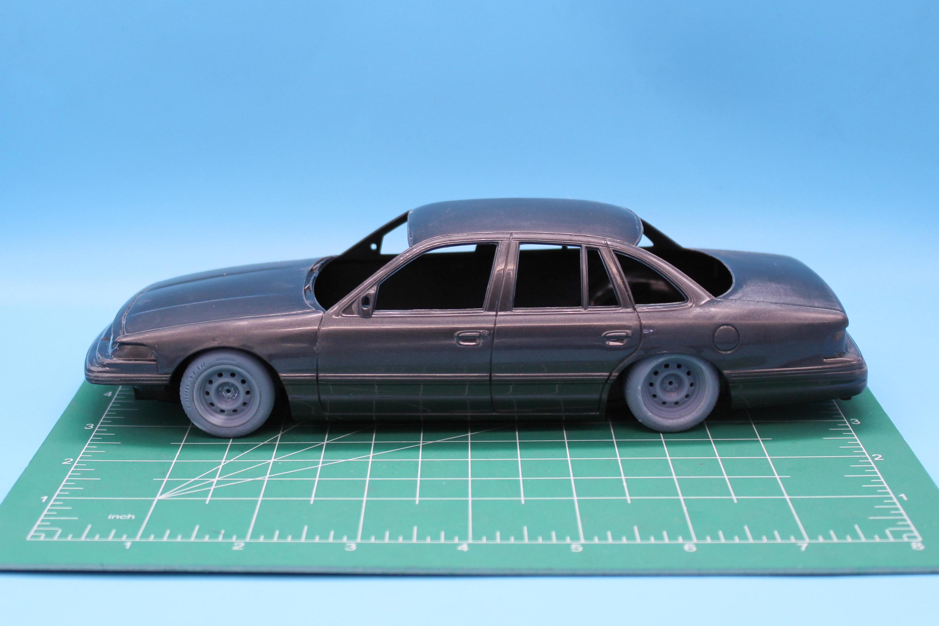

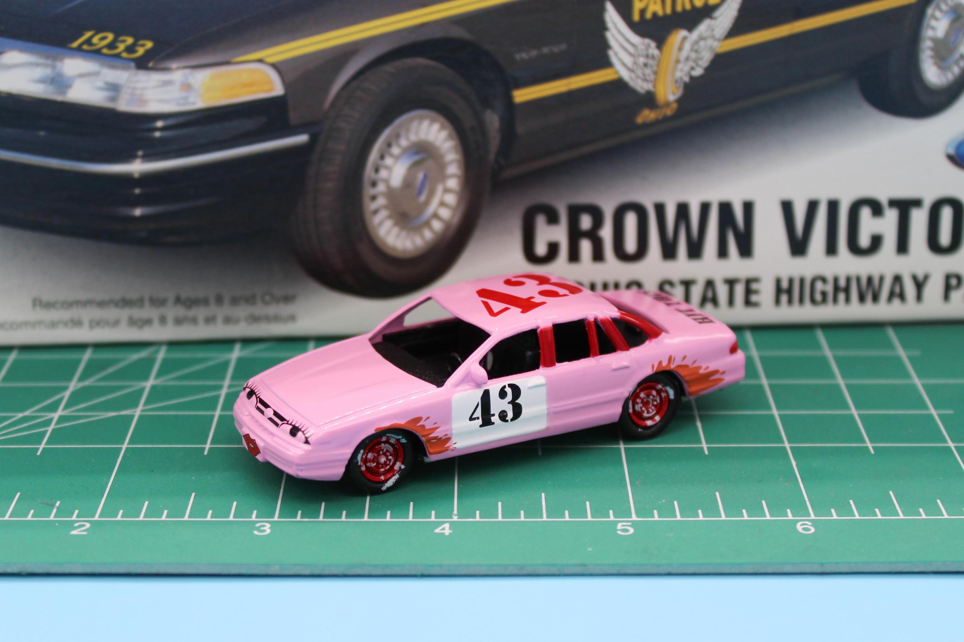

OldNYJim Posted September 2, 2024 Posted September 2, 2024 I went to the local county fair for the first time this summer (didn’t have county fairs in Brooklyn) and REALLY enjoyed the figure eight, oval racing and demo derby they ran. Came home inspired, and wanted to build something county-fair-ish. Then, the next weekend, was in Meijer and saw a little Johhny Lightning Crown Vic demo derby diecast, didn’t buy it, and then thought about it so much for the next three days that I had to go back and get it ? And then I picked up this on eBay for cheap: So I can build my take on the street-stock derby car I saw at the fair, with some inspiration from this little guy: Best I can tell, for the entry level oval / figure 8 / DD cars at my local event are REALLY close to having just come off the street…head and taillights removed, kick out the windshield and windows and…that’s about it. Some had the doors welded shut, some just ran stock seats and factory seatbelts, and some were a LITTLE better prepared, but still not really race-prepped at all. And that’s ABOUT where I’m going with mine - simple roll cage, bolt and weld all the panels shut and call it good for a day at the fairground. First step, because the kit has plastic hubcapped wheels, printing some ‘bare’ stock Crown Vic wheels, and a set of tires: And while the printer was running, printed a Recaro race seat - not a super-fancy fabricated aluminum one like a higher level class would likely require, but the sort of thing a racer might have in his shop already and could easily bolt in: And…that’s about as far as I got today: This kit doesn’t have an engine, so it’ll be strictly curbside, but getting the interior looking more like a stripped track-ready car is going to be a scratchbuilding challenge all of it’s own… Thanks for looking, more soon, soon as I’ve done more! 4

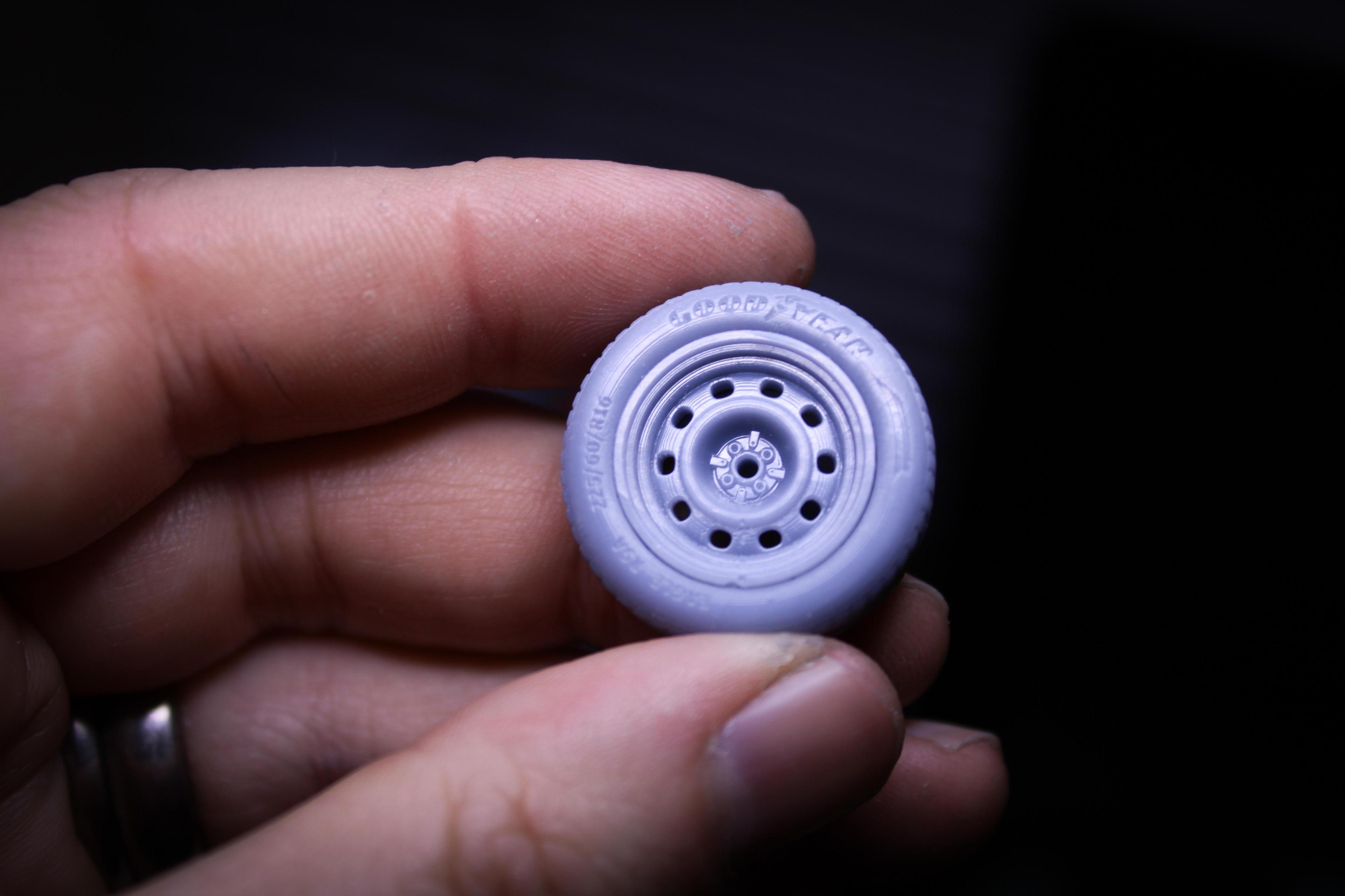

dwc43 Posted September 2, 2024 Posted September 2, 2024 That should be a fun build. I built one as a Tn State Trooper car. Did you notice you have 4 lug instead of 5 lug wheels. lol Sorry, just noticed it is all. I've seen some people chain the doors shut and I think some classes require chains run through the bumper so the wreckers can pick them up and move them quicker. Those cars with the header pipes through the hood always looked cool too. Not sure they were worth it though. Should be a fun build. 1

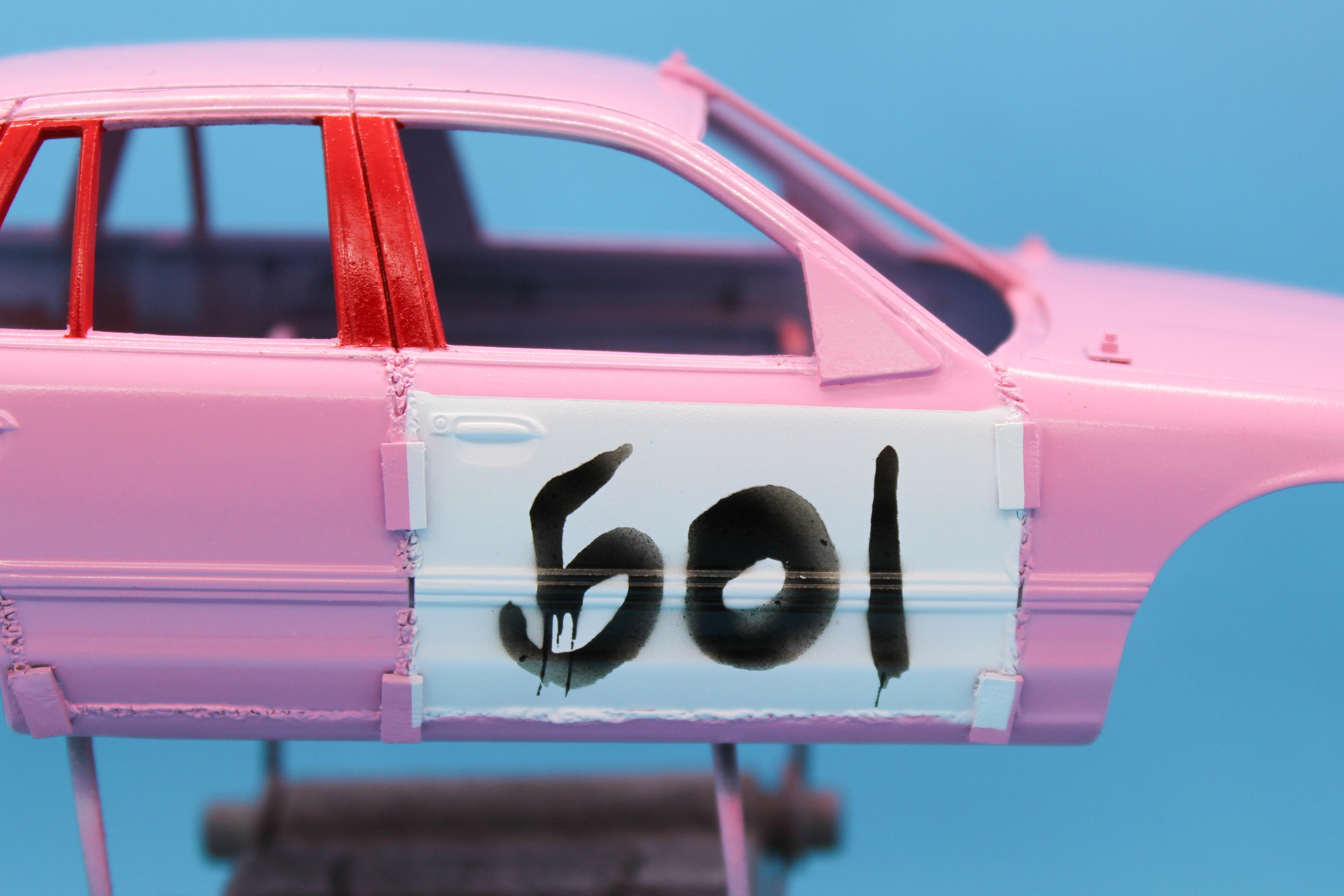

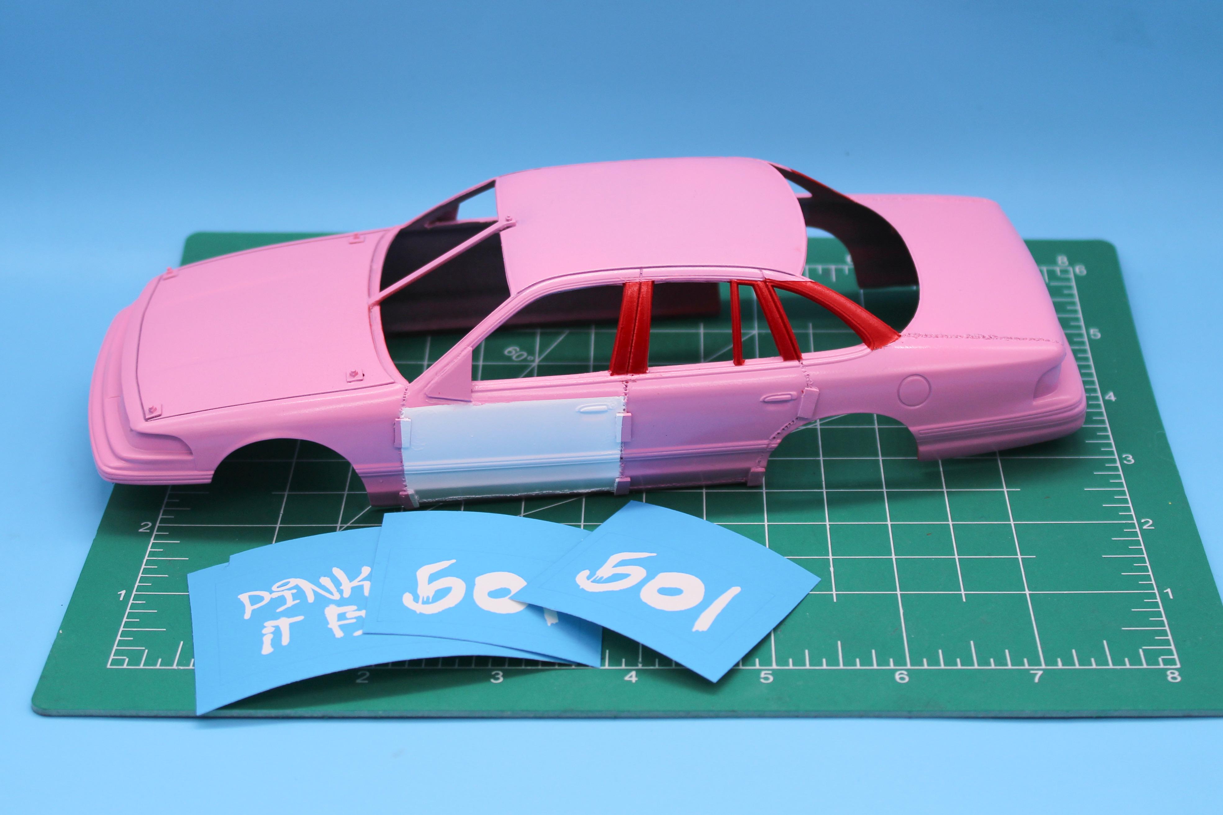

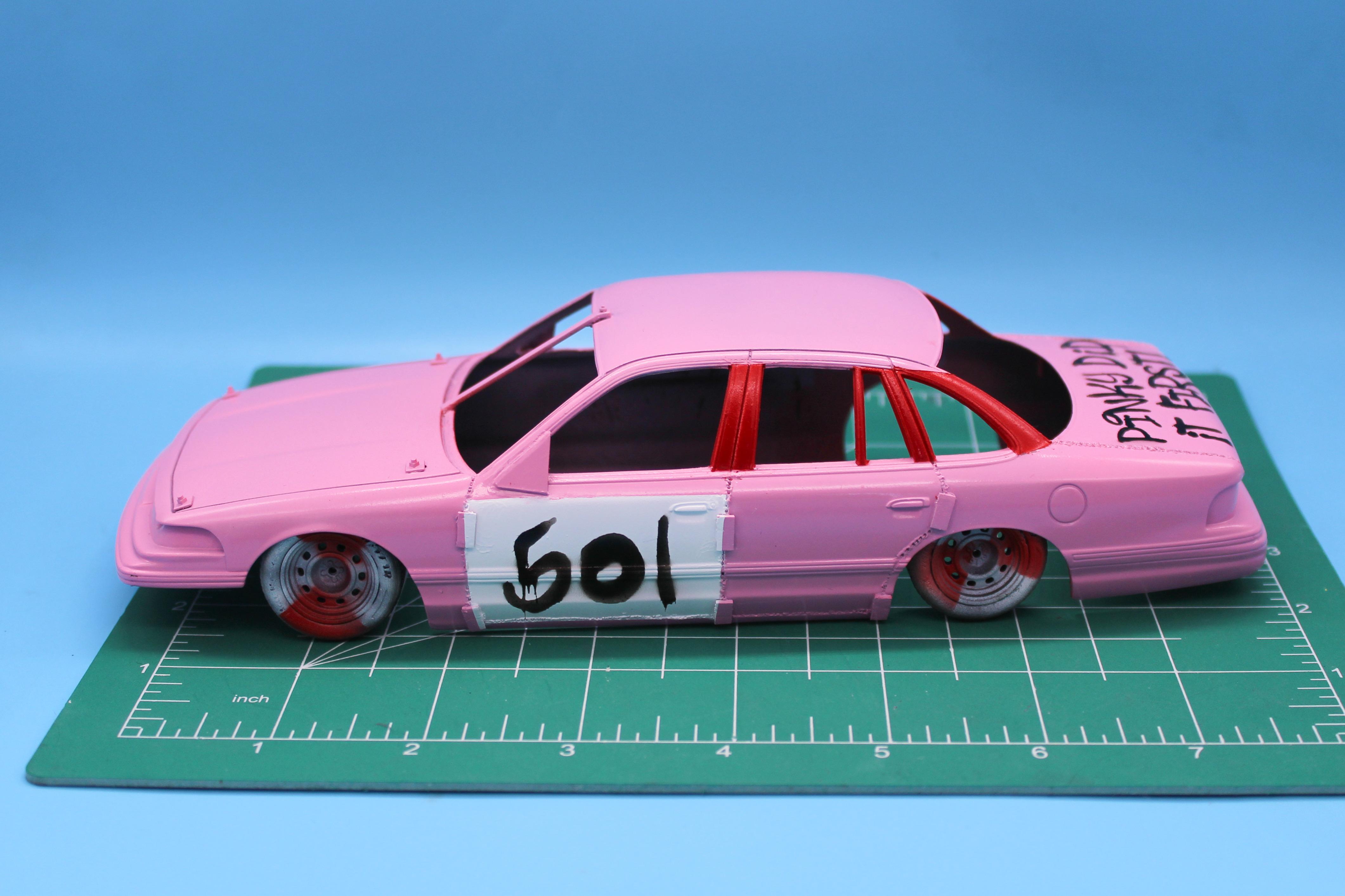

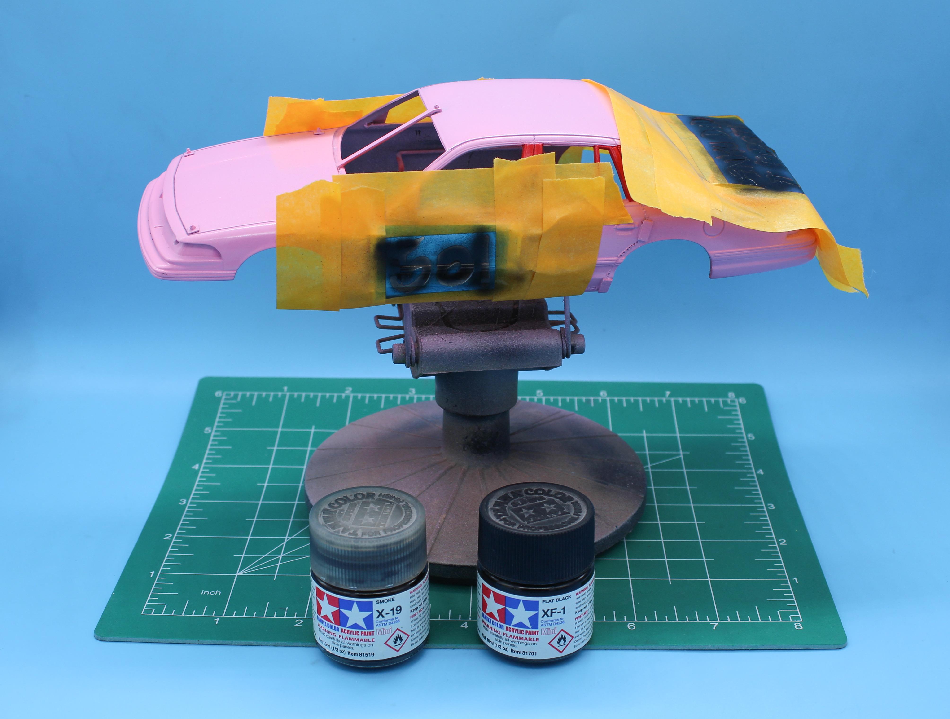

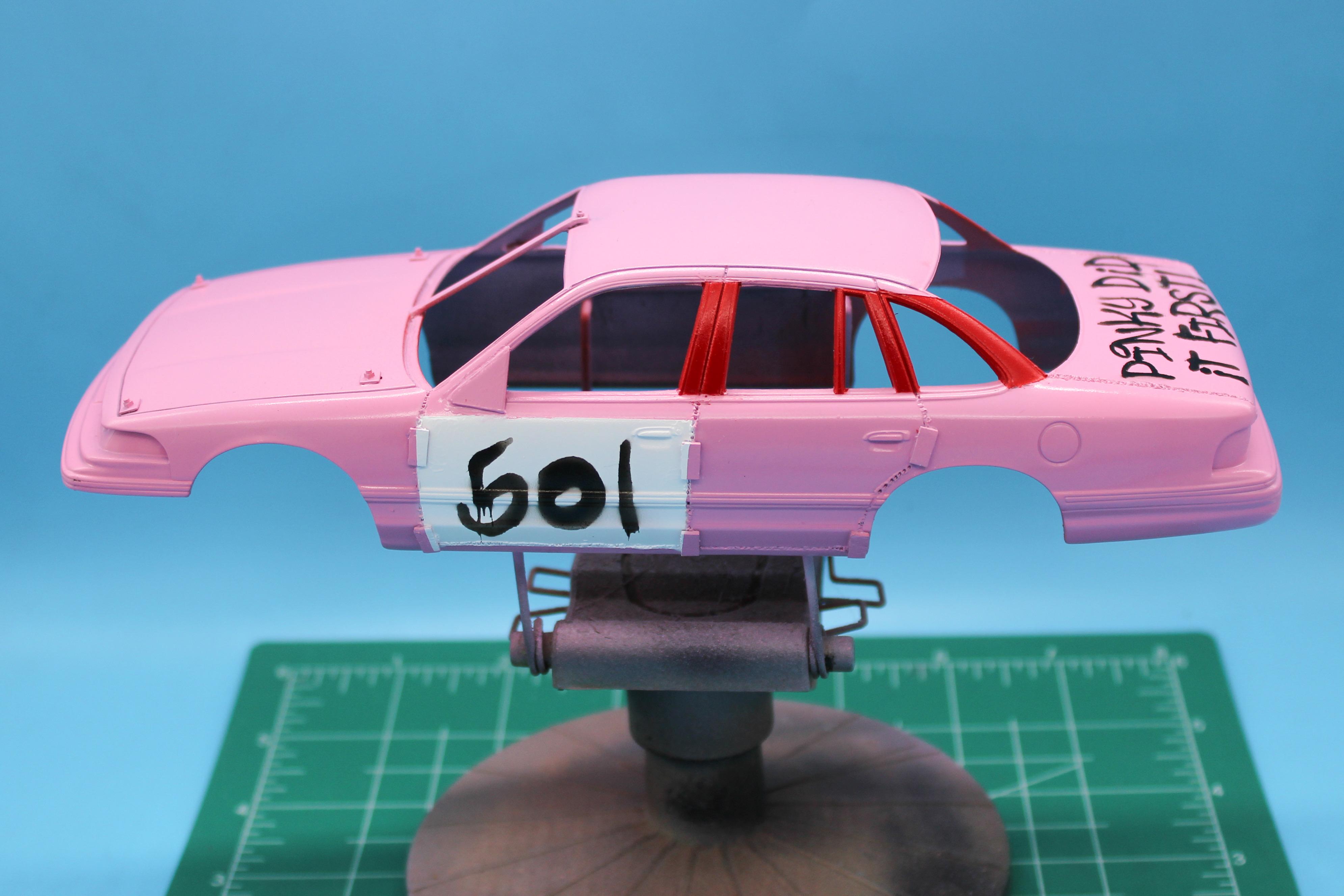

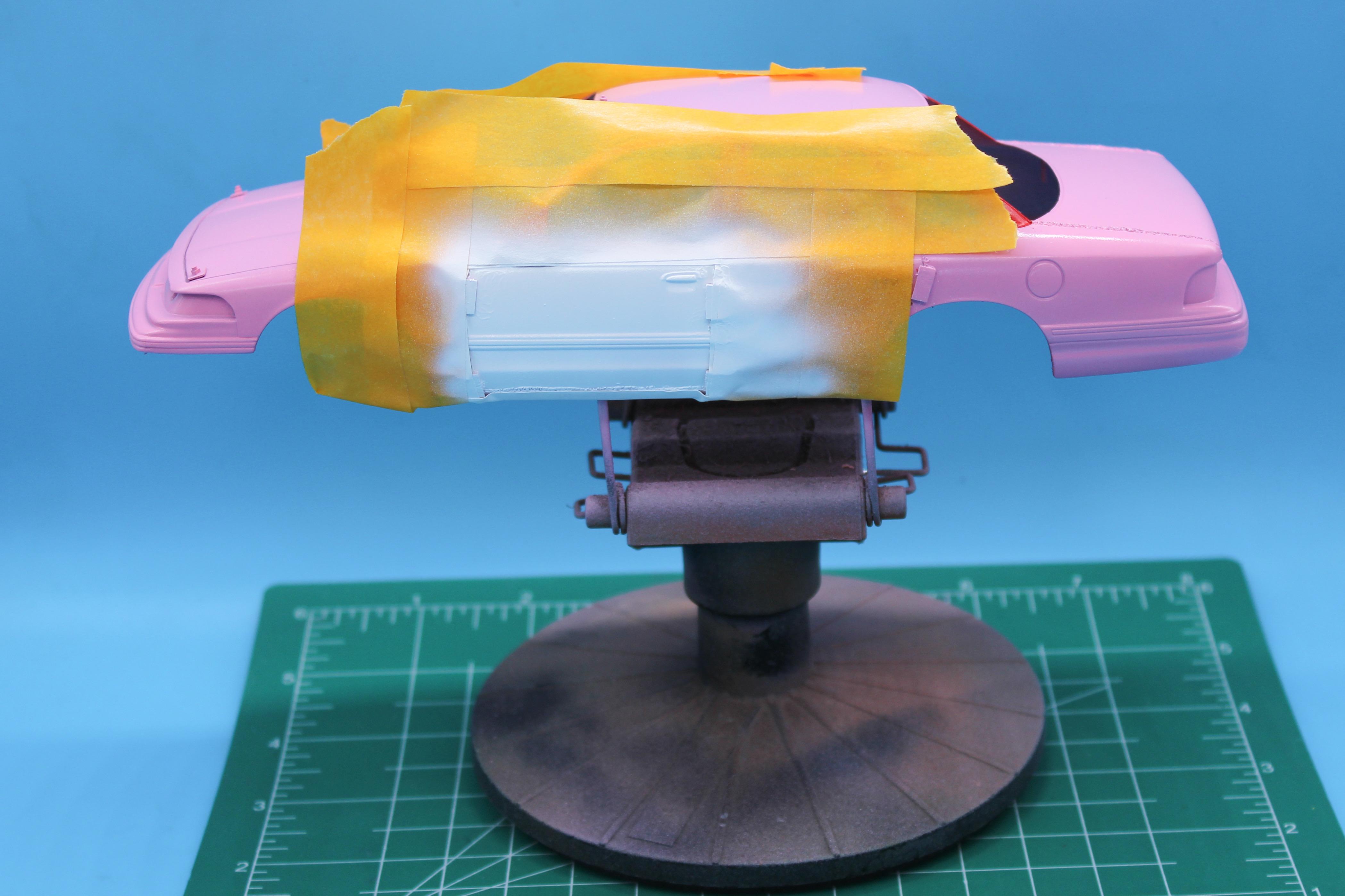

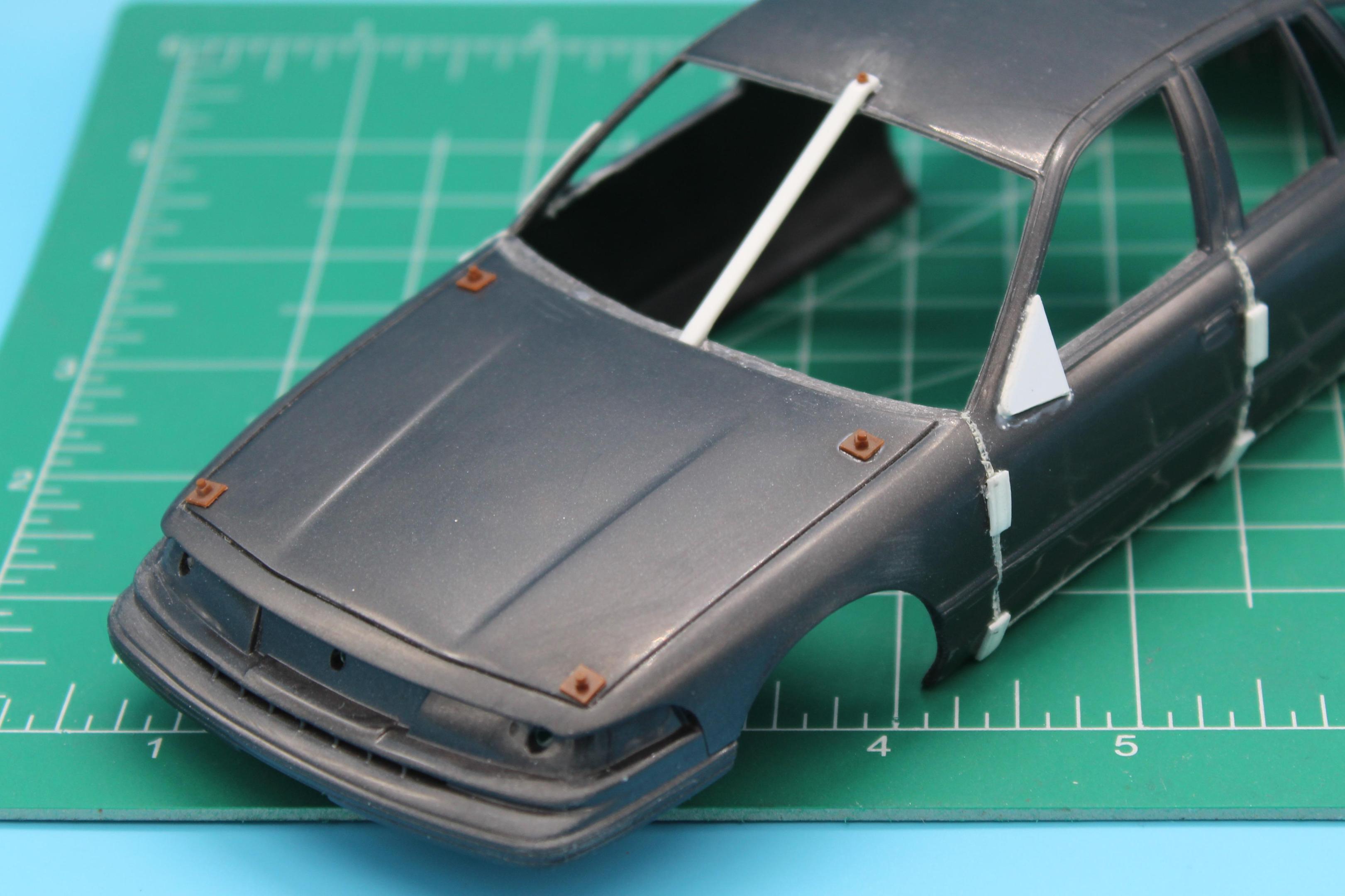

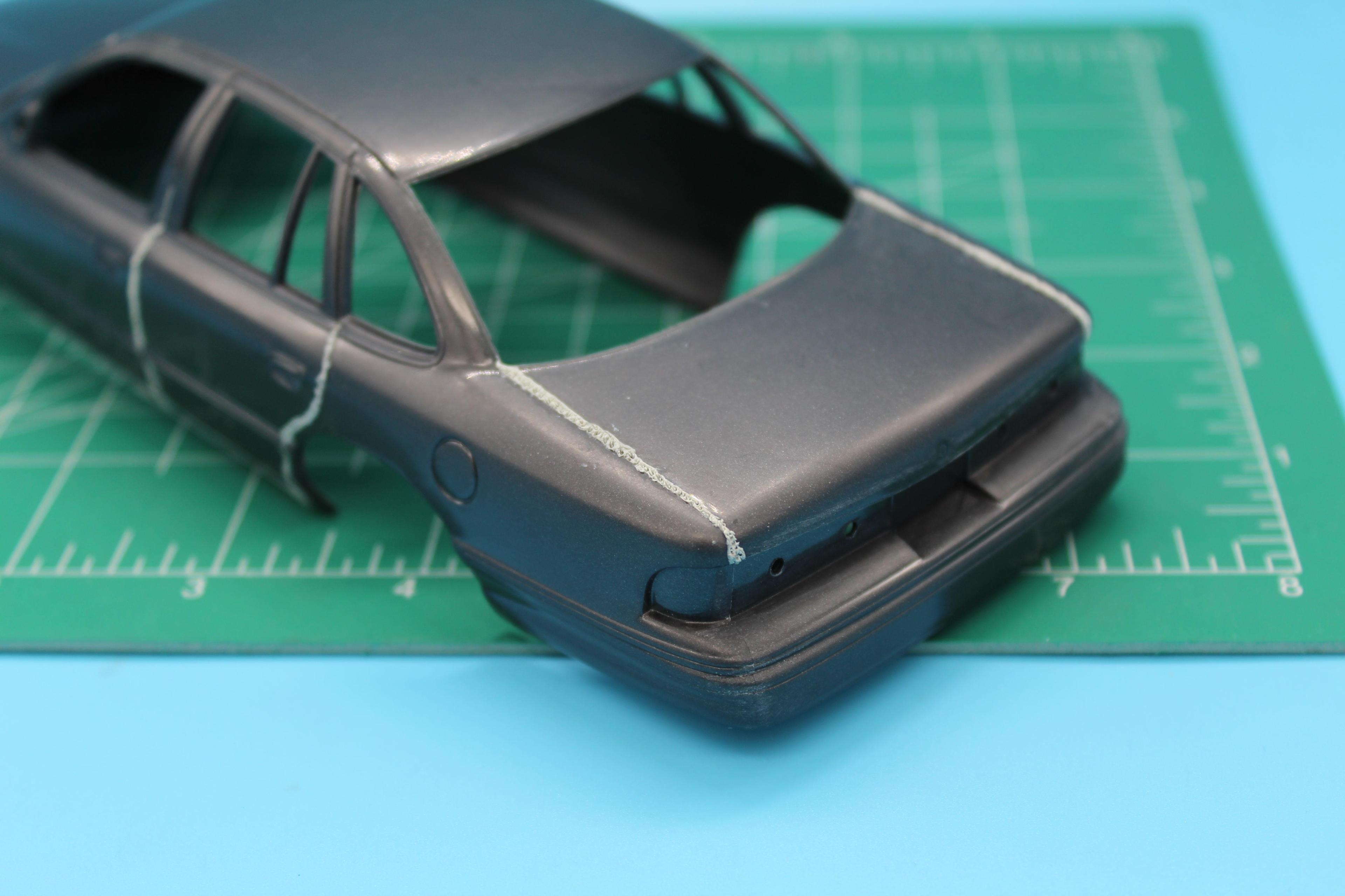

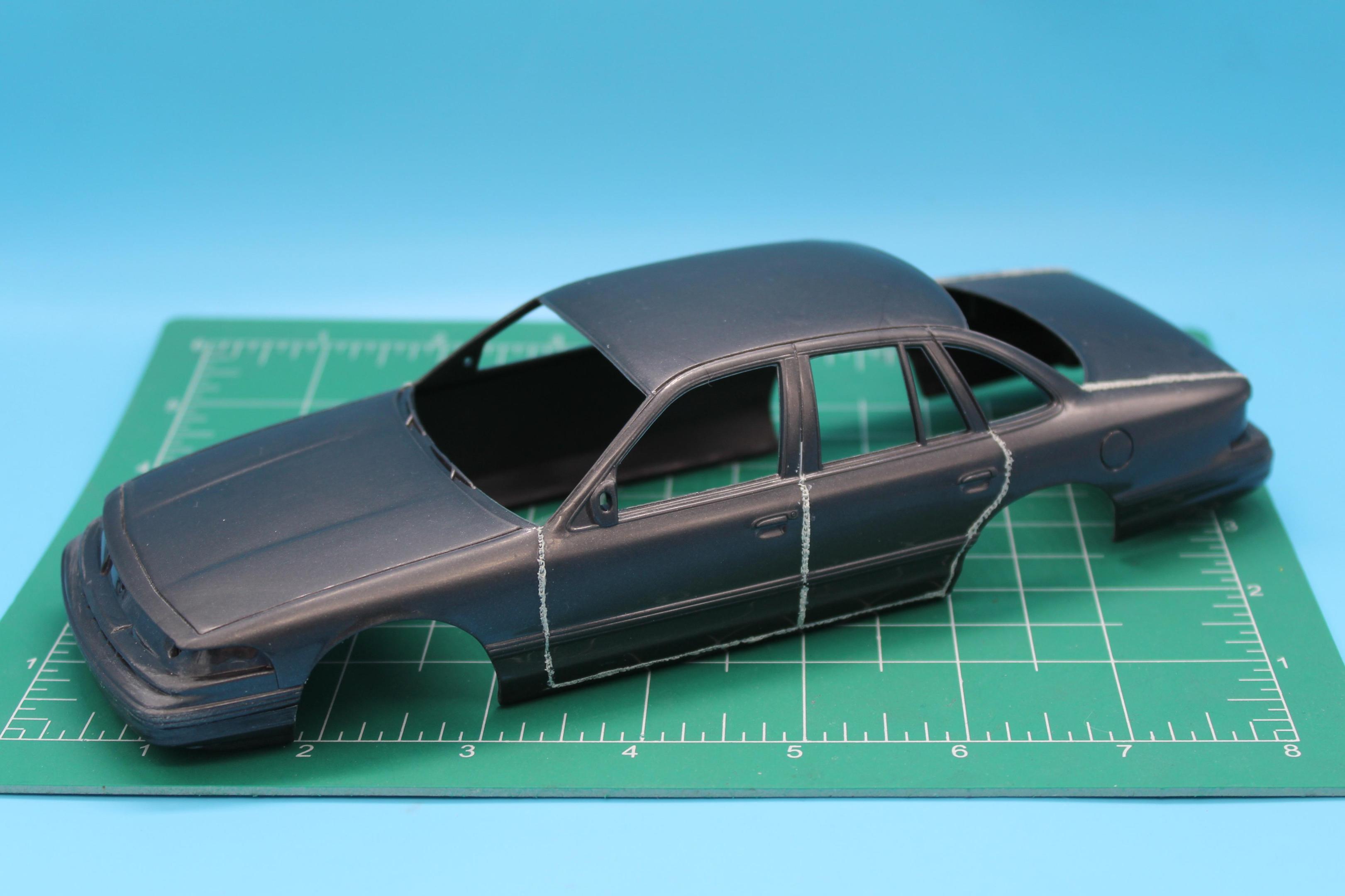

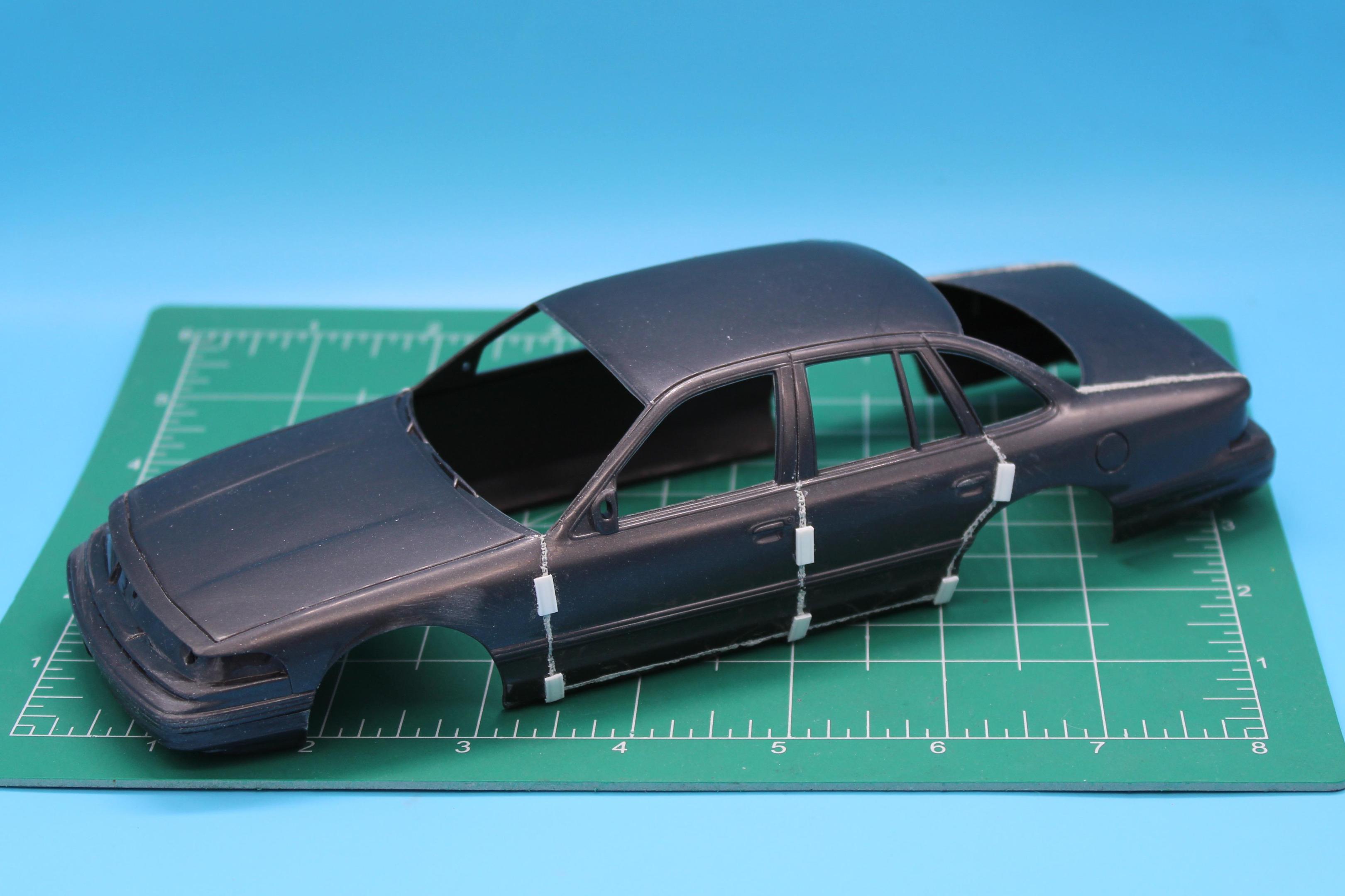

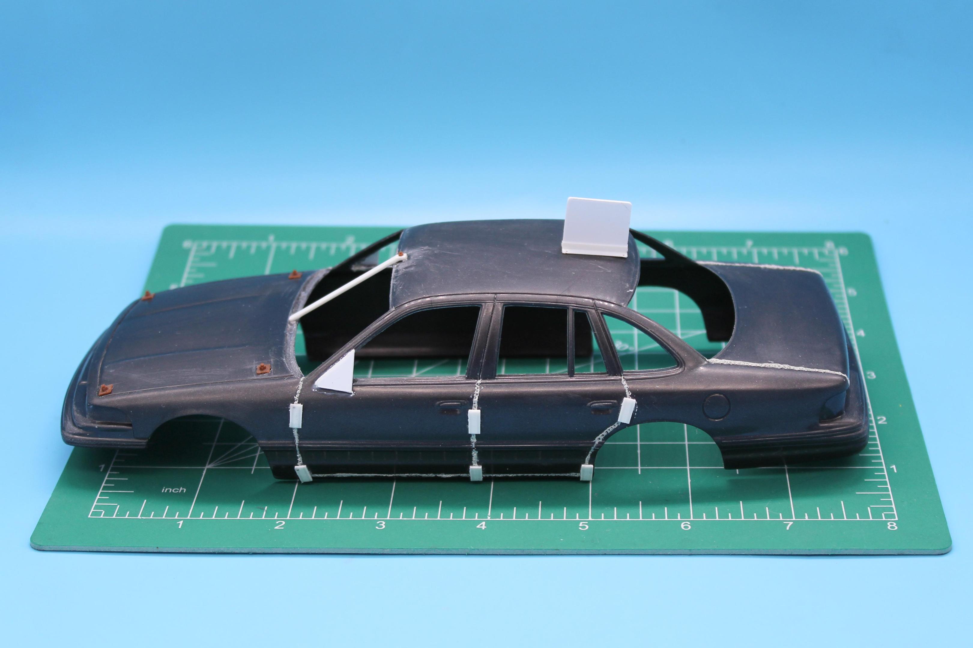

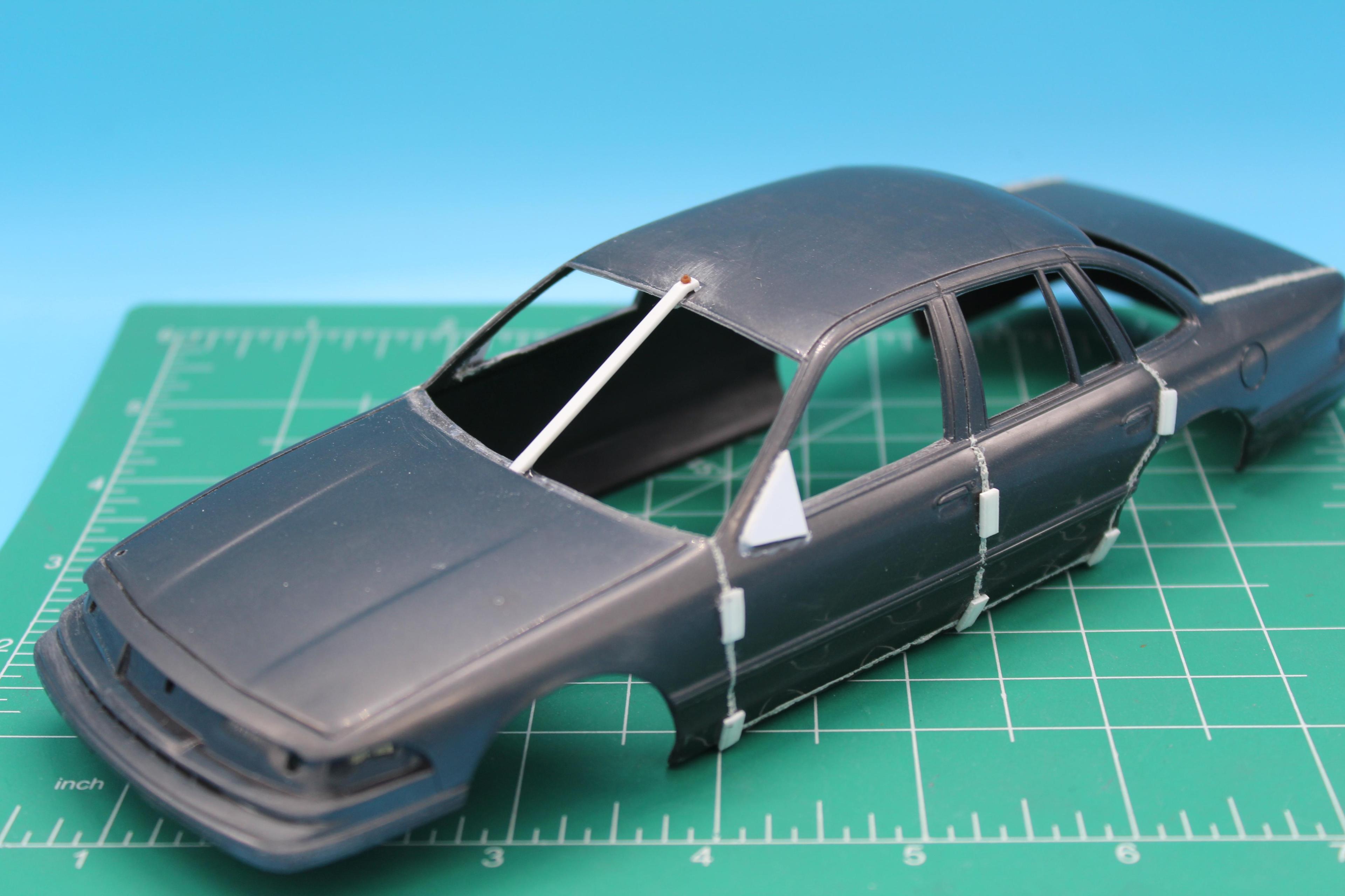

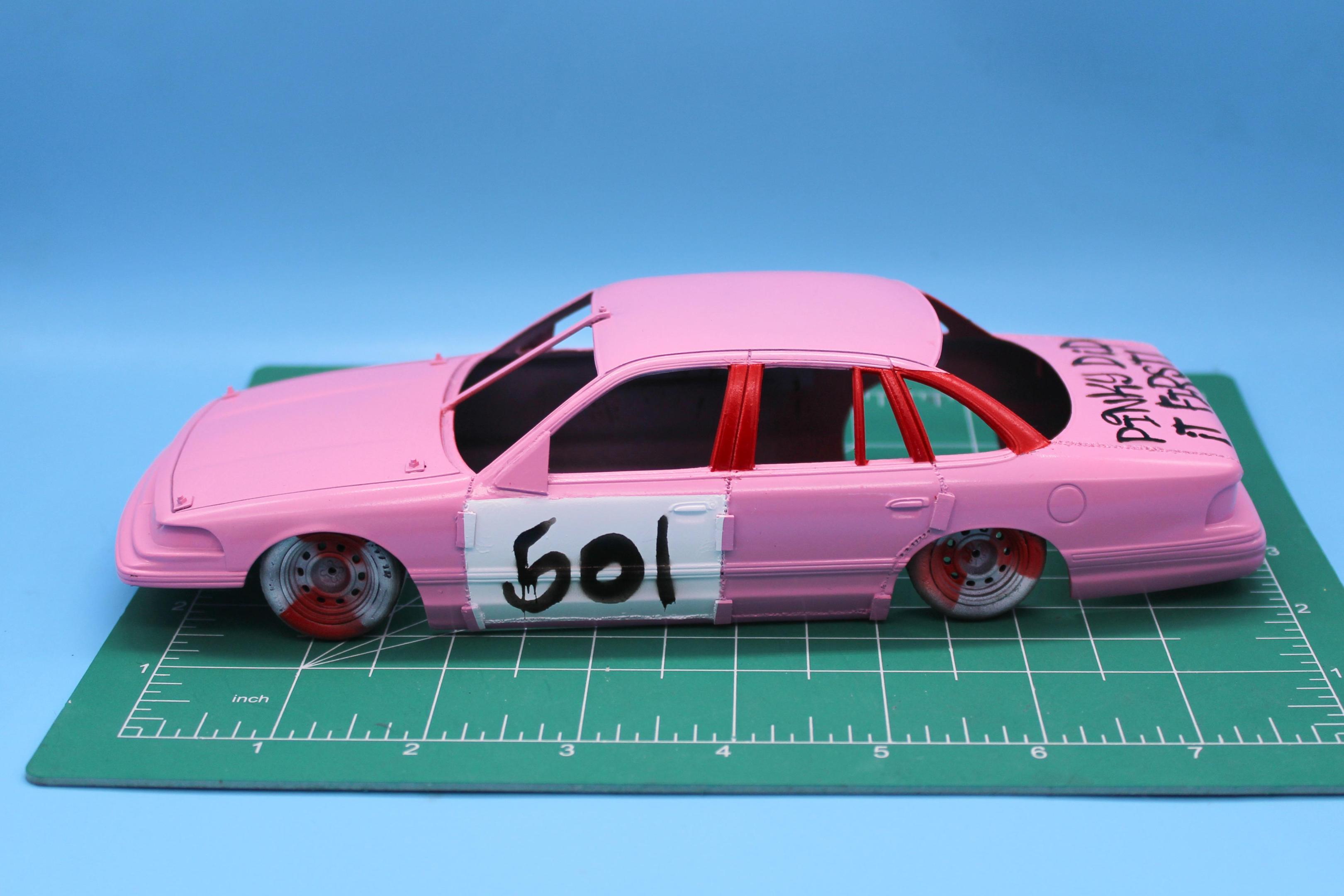

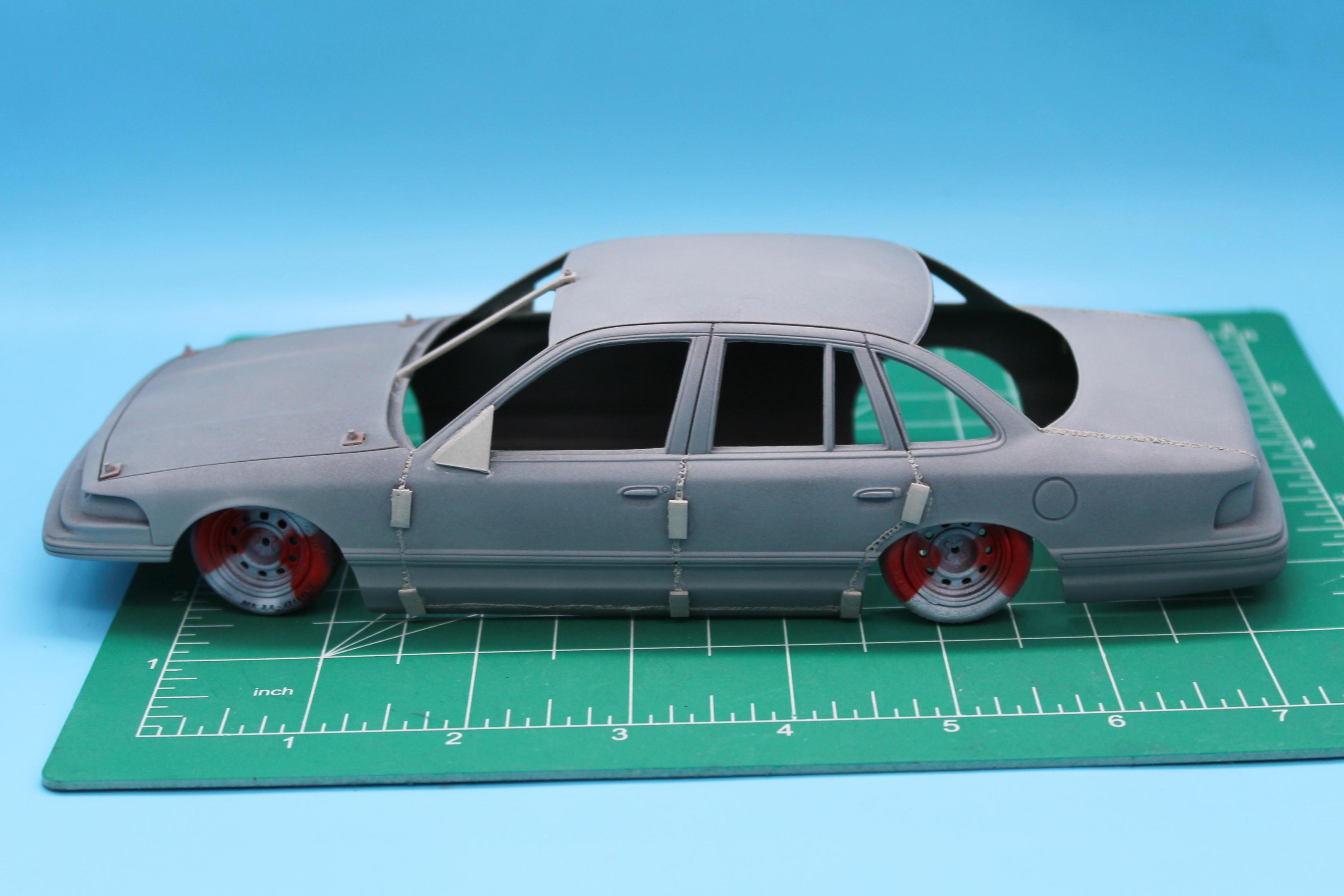

OldNYJim Posted September 3, 2024 Author Posted September 3, 2024 (edited) Ok, so today’s progress was body prep. I downloaded the local stock-class rules and used those as my guide and worked on de-niceifying this nice clean body… Local rules allow the doors to be welded up to the pillars, so I did that: Trunk lid can be welded too, so same deal there: I’m a little worried about these details disappearing under paint so they’re a little bolder and less small and crisp as they could’ve been - some good ol’ tractor welds ? Local rules also allow three 3” by 6” plates on each door, so I found some reference pics of a CV built to similar rules online and did what they did: You also HAVE to remove external mirrors, and can plate over where they were, so I added some nice heavy steel plates there, plus it’s a requirement to run either a chain or a steel bar from top to bottom of the front daylight opening - I tried a chain but it looked a little TOO agricultural for my poor Crown Vic, so I ended up with a bar: Rules also require a 12” x 18” number board on the roof, so I made one of those with some Plastruct sheet and angle: And you’re allowed four hood bolts with 4” square or round washers - I found these Titchy Train plastic bolts in my stash that worked PERFECT: I need to figure out the lights - I wanted to make some styrene fillers but the angles are a little tough to make some nice one-piece fillers in styrene, so I’m modifying the kit pieces to LOOK like I’ve filled them with plates. Added some Mr Putty Sprue Goo to the front headlamps and the clear red taillights so I can smooth them out tomorrow: Interesting how much red color leeched out of the taillights into the red putty - turned it pink! Thanks for looking, more soon, soon as I’ve done more! Edited September 3, 2024 by CabDriver 6
Shark Posted September 3, 2024 Posted September 3, 2024 Per your question about asphalt or dirt, I guess it could be either, but the tracks that run them within driving distance are paved. 1

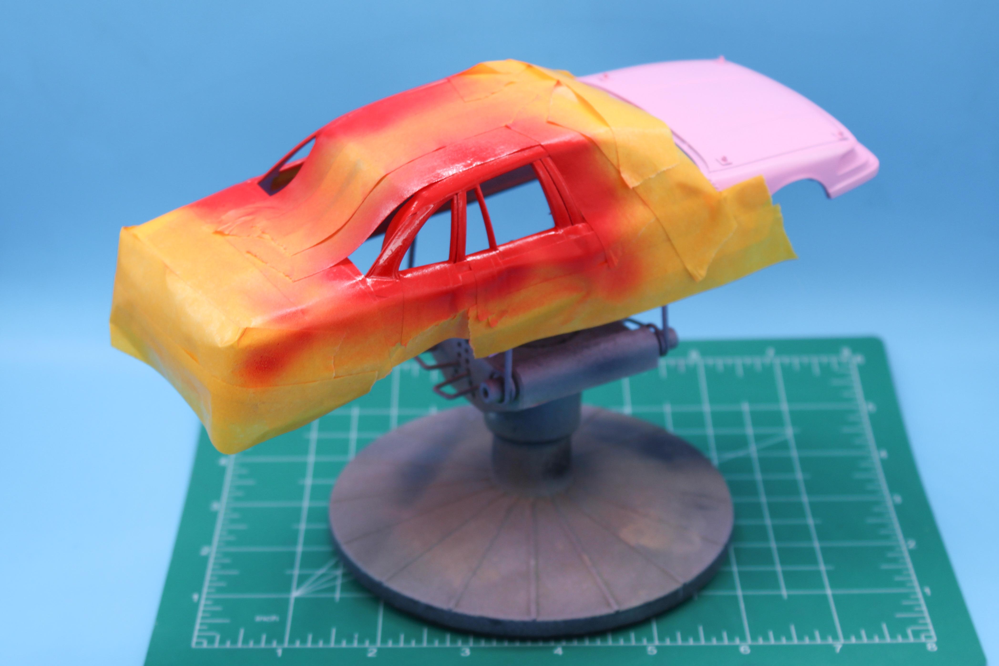

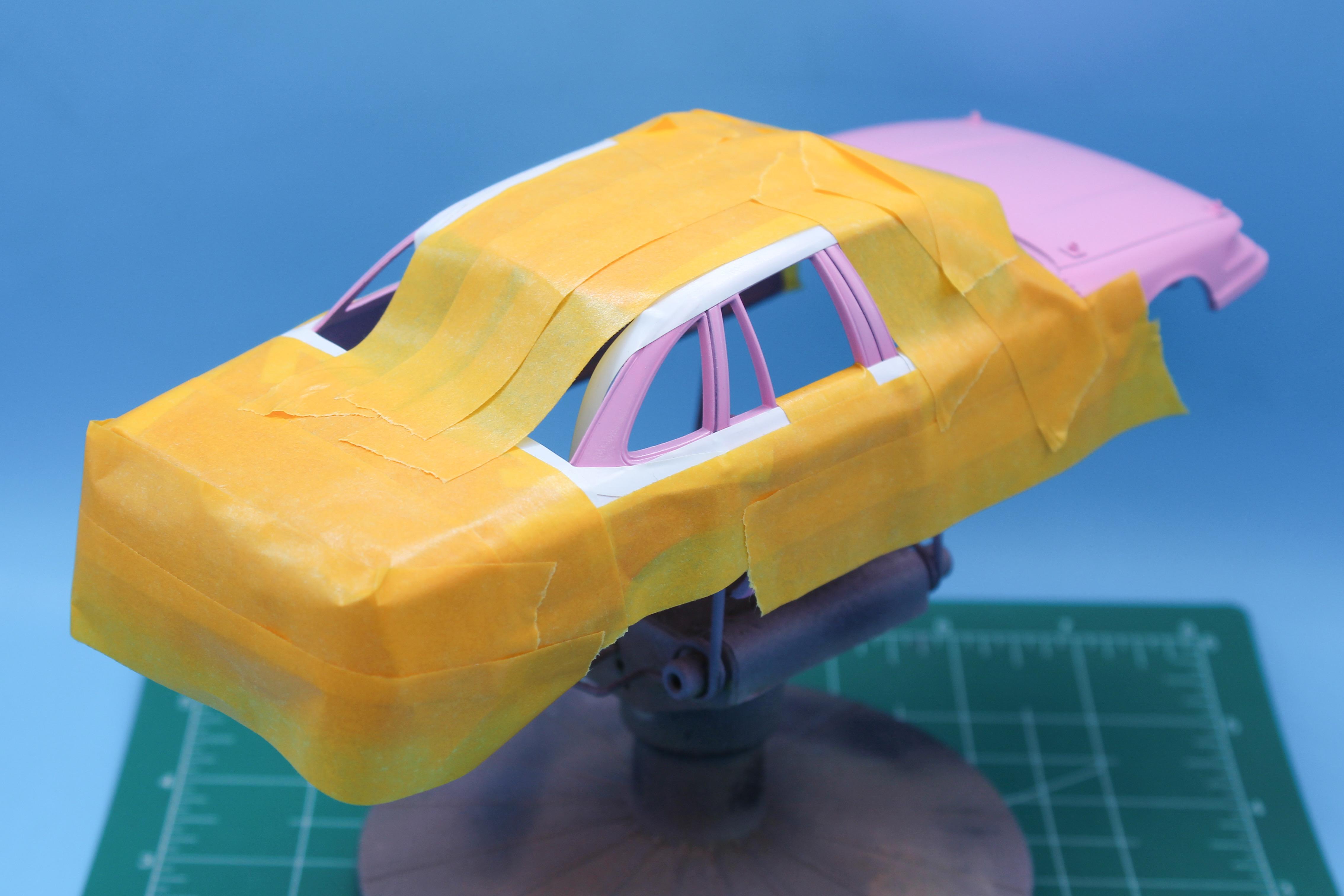

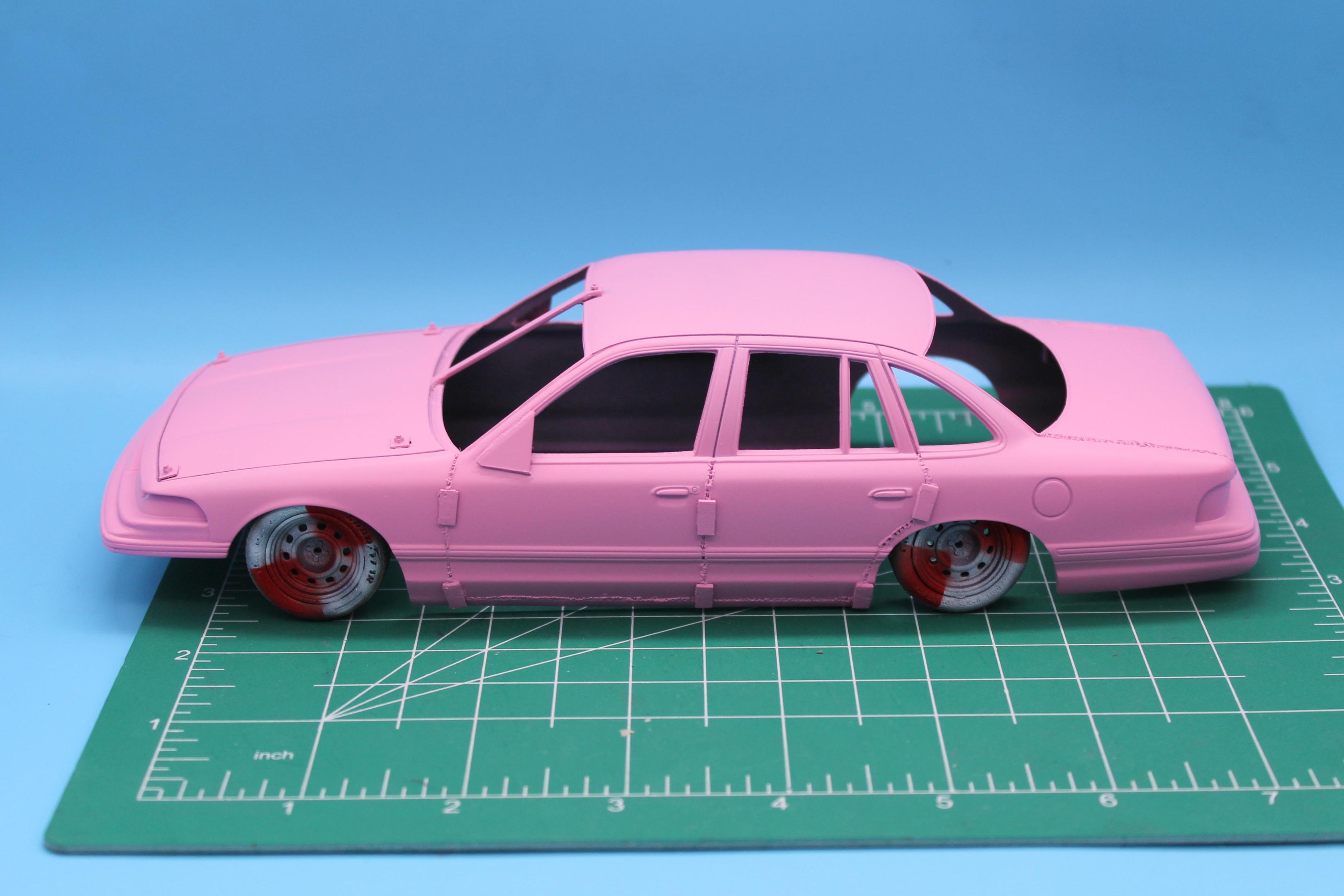

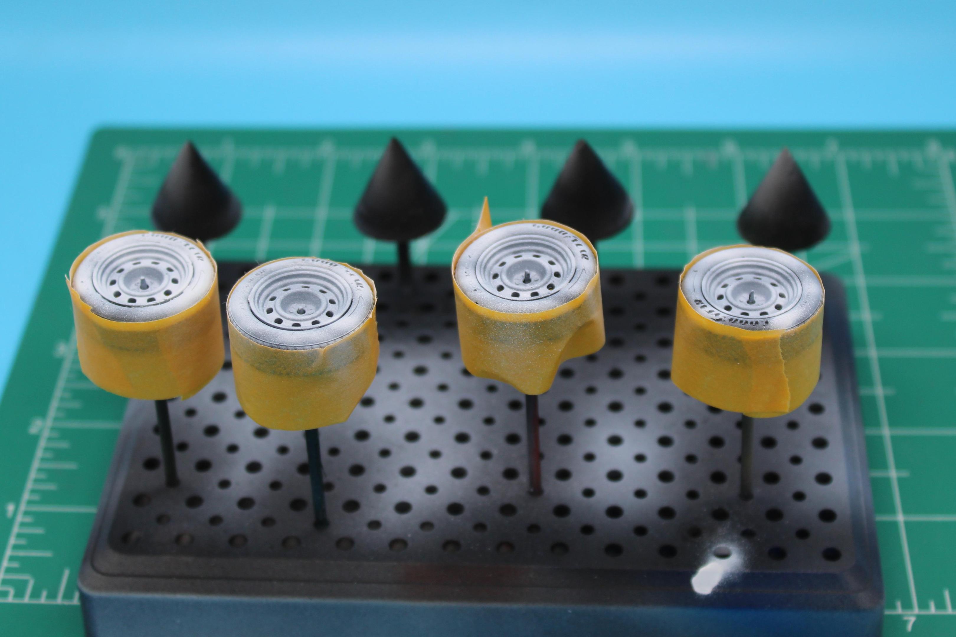

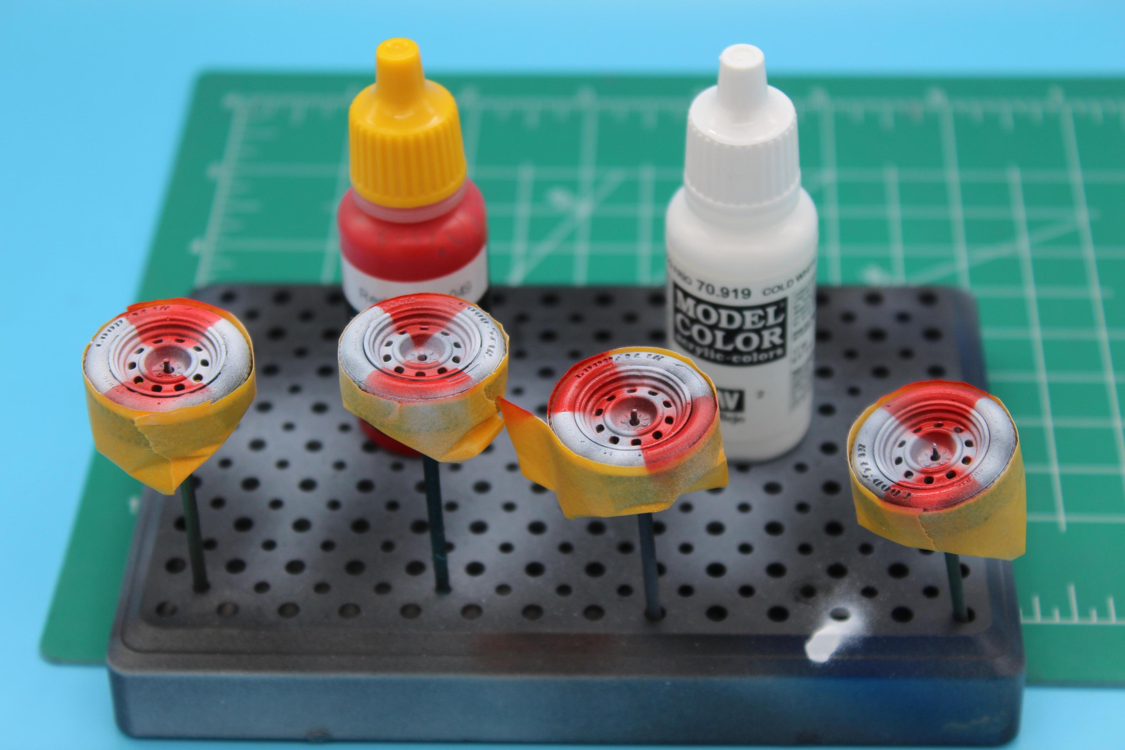

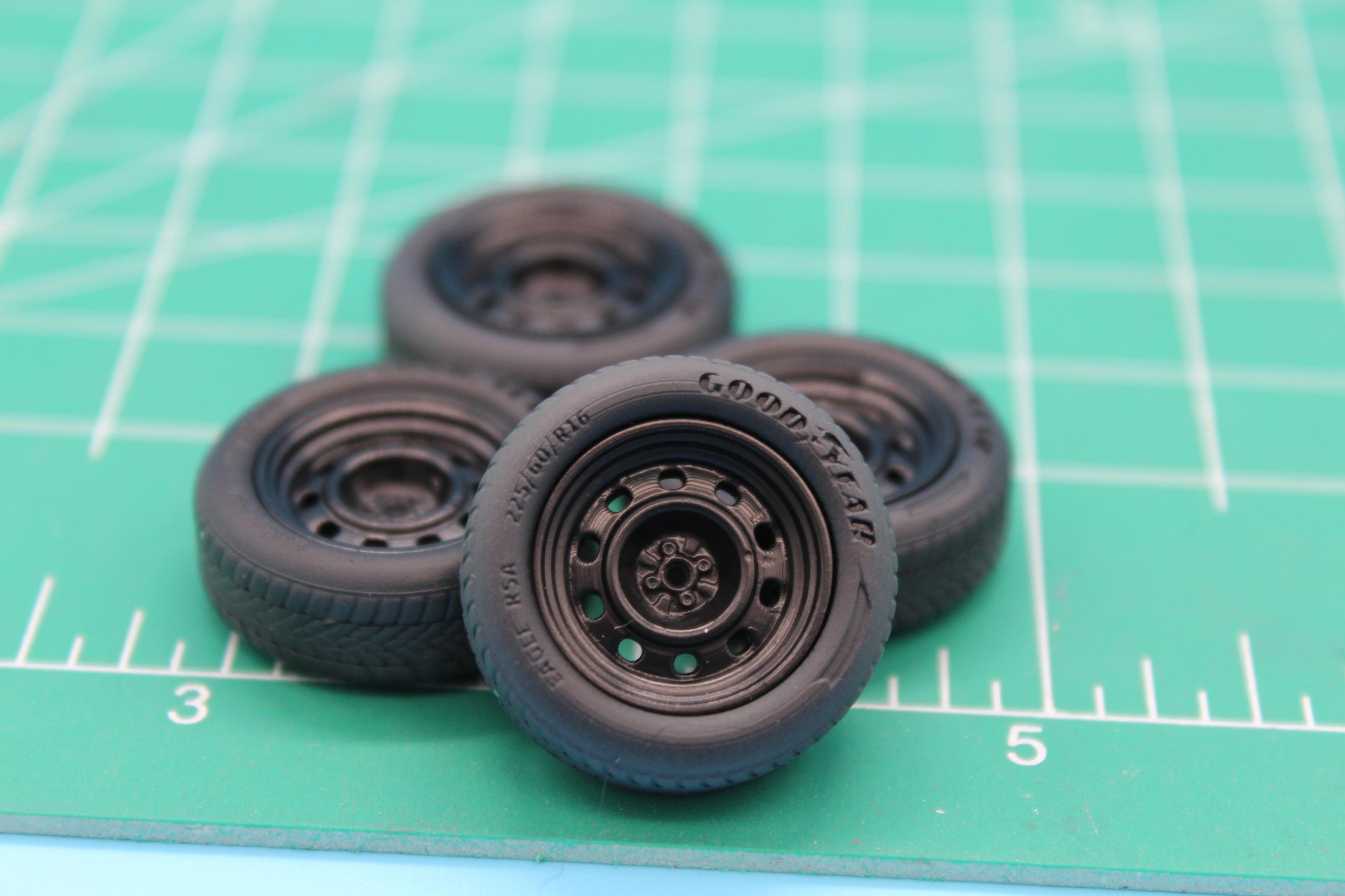

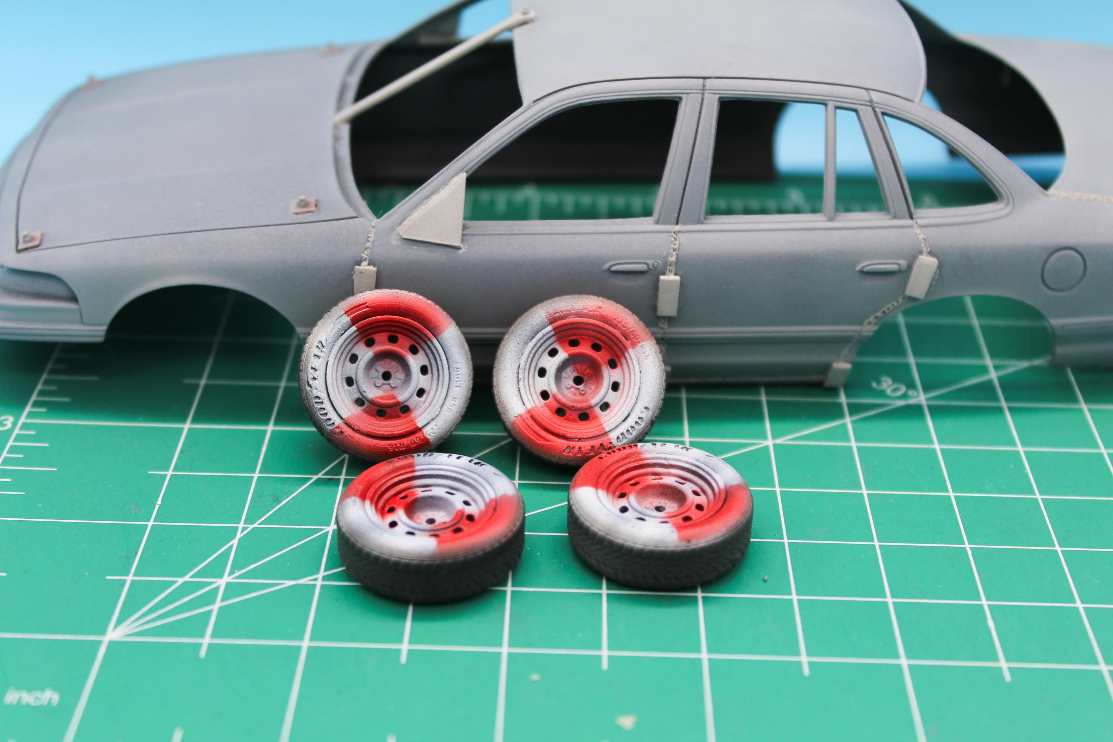

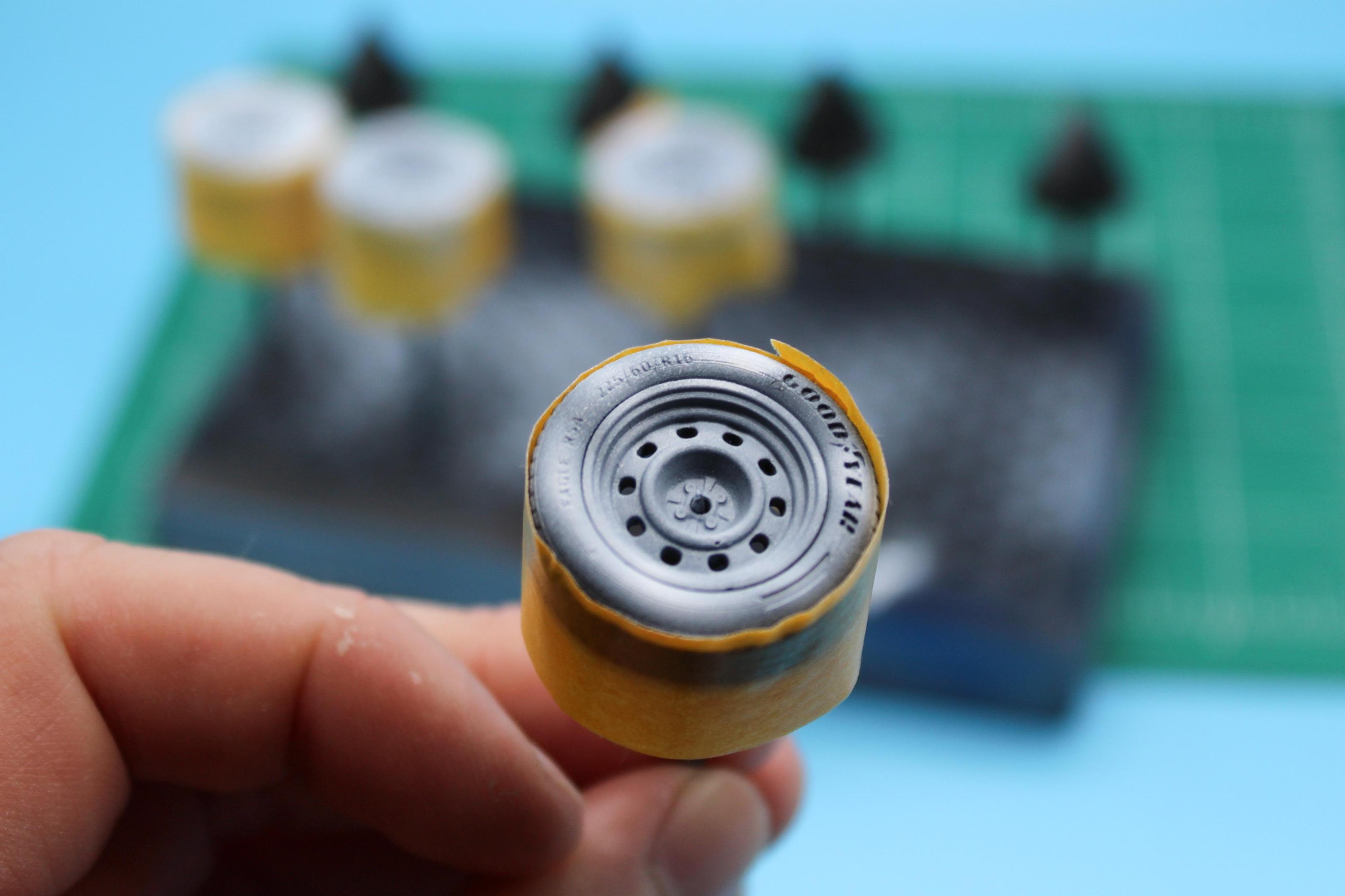

OldNYJim Posted September 4, 2024 Author Posted September 4, 2024 6 hours ago, Shark said: Per your question about asphalt or dirt, I guess it could be either, but the tracks that run them within driving distance are paved. My favorite! Both are cool tho… A little mini-project tonight…wheels and tires! Painted the stock Crown Vic wheels in stock Crown-Vic-wheel-semi-gloss-black: And I guess I could’ve left it at that, but you know how some demo derby guys really like painting their wheels and tires for some reason… Shot the outside faces with some Vallejo white - built it up in thin streaks to try and emulate them being rattle-canned and a little imperfect: Then, masked them and shot some Vallejo red; same deal, kinda patchy and imperfect… Then removed the masks, and blended the edges with some Tamiya Soot and a q-tip and gave them a light mist of dark brown and tan, just very lightly: Most fun I ever had painting some wheels and tires ? Started prepping the body for paint too - just shot a light coat of primer to make sure I didn’t miss any flaws that I didn’t put there on purpose…excited to get to the paint on this one! Need to start figuring out the interior next, that’ll be the biggest project on this build by FAR. Thanks for looking - more soon, soon as I’ve done more! 5

DJMar Posted September 4, 2024 Posted September 4, 2024 The wheel/tire painting is spot on! This is a really cool build. 1 1
TarheelRick Posted September 4, 2024 Posted September 4, 2024 Beginning to have that look of a Saturday-night free for all racer. Really like the way you are building this one. When they used to run this style car back at the end of last century they were called "Bombers" and consisted of early 70's Impalas, Galaxies, Bonnevilles, Oldsmobiles, and one guy had a Cadillac; normally the Chevies were the better running cars. Looking forward to more updates. 1

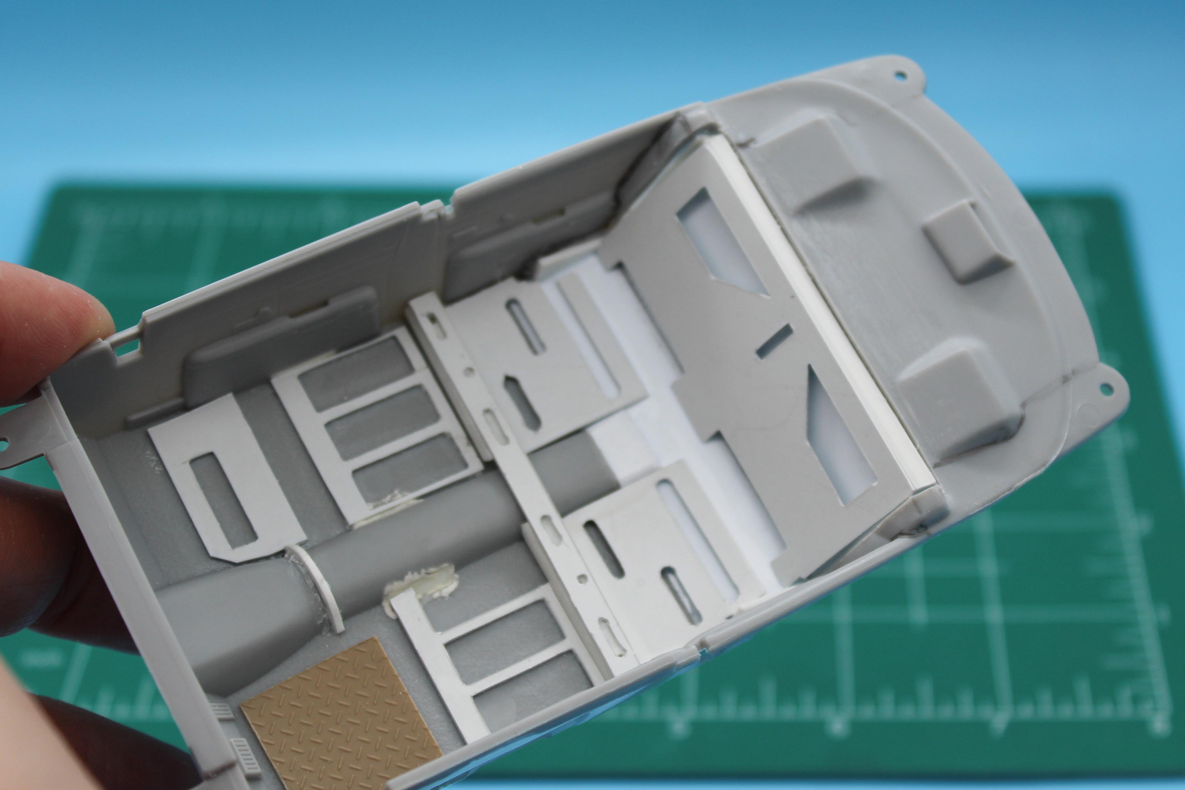

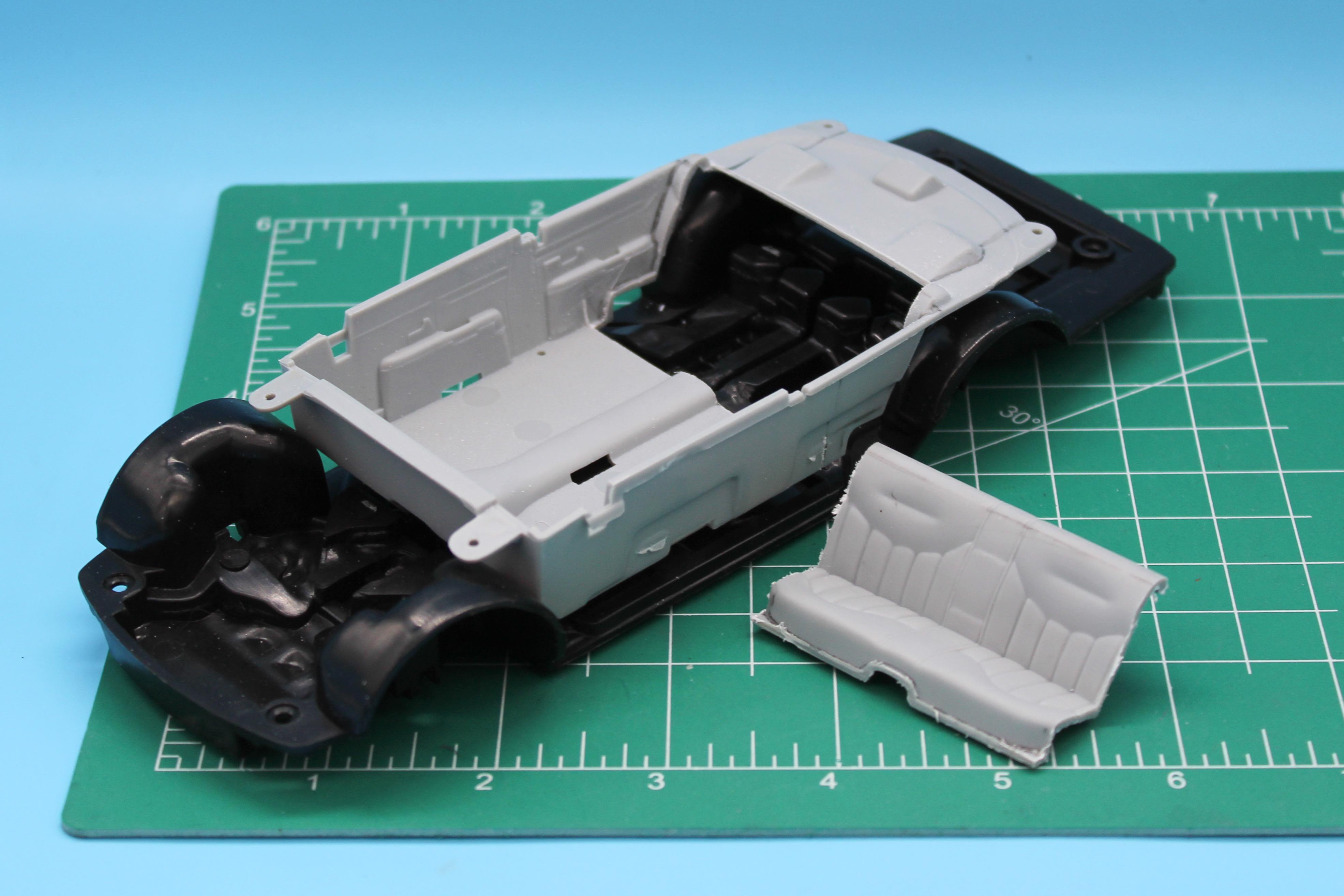

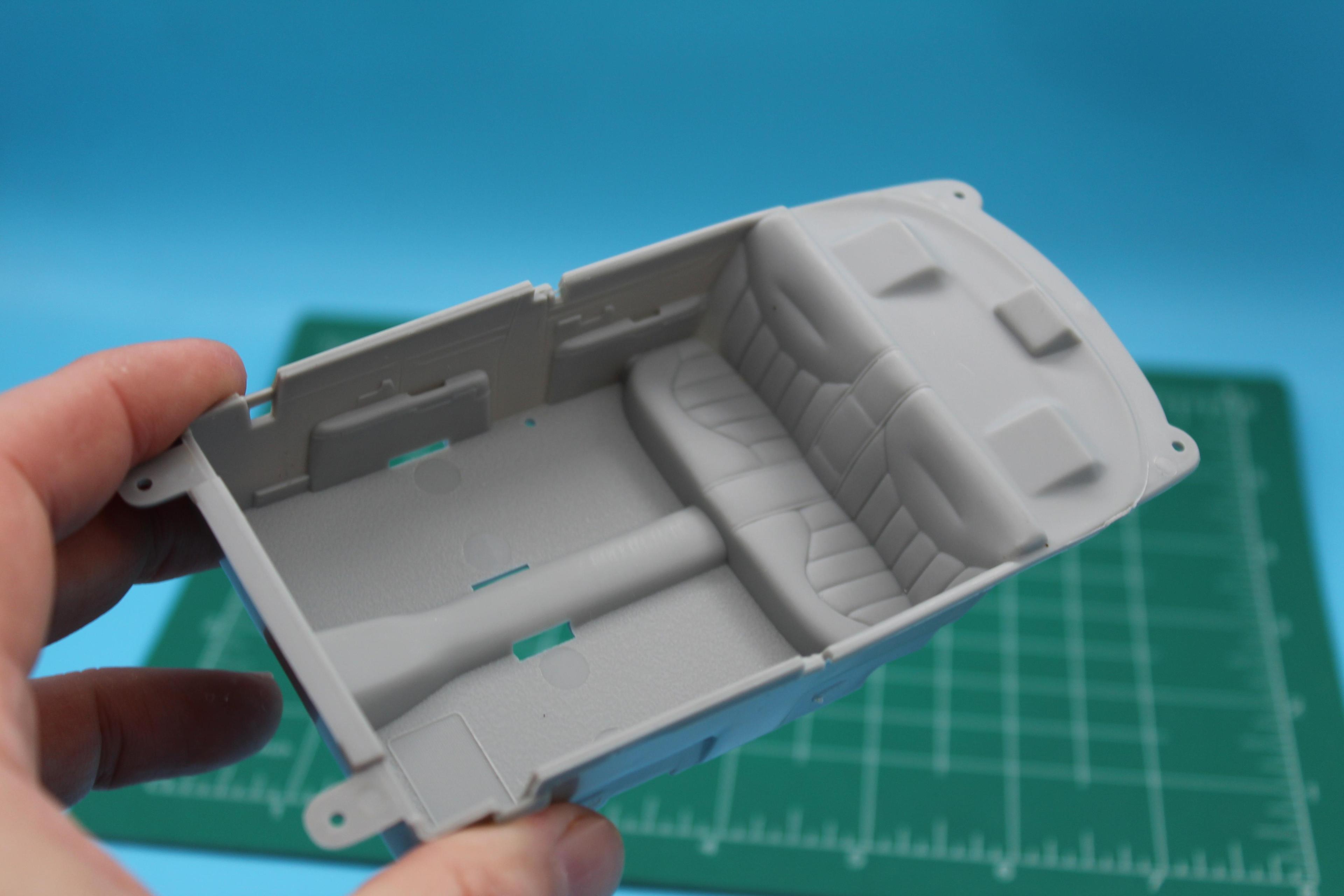

TarheelRick Posted September 5, 2024 Posted September 5, 2024 12 hours ago, CabDriver said: Next project will be figuring out the most painless way to get this back seat out of the interior tub Looks like no matter which way you approach it you are going to lose the package tray. I would suggest using s razor saw to carefully remove the package tray right along the edge of the seat back, and put it somewhere you will not lose it. Use a scribe or the back edge of a #11 x-acto and drag around the edges of the seat to remove it. Just a bit of filing/sanding and should be ready for the sheet metal filler pieces. 1

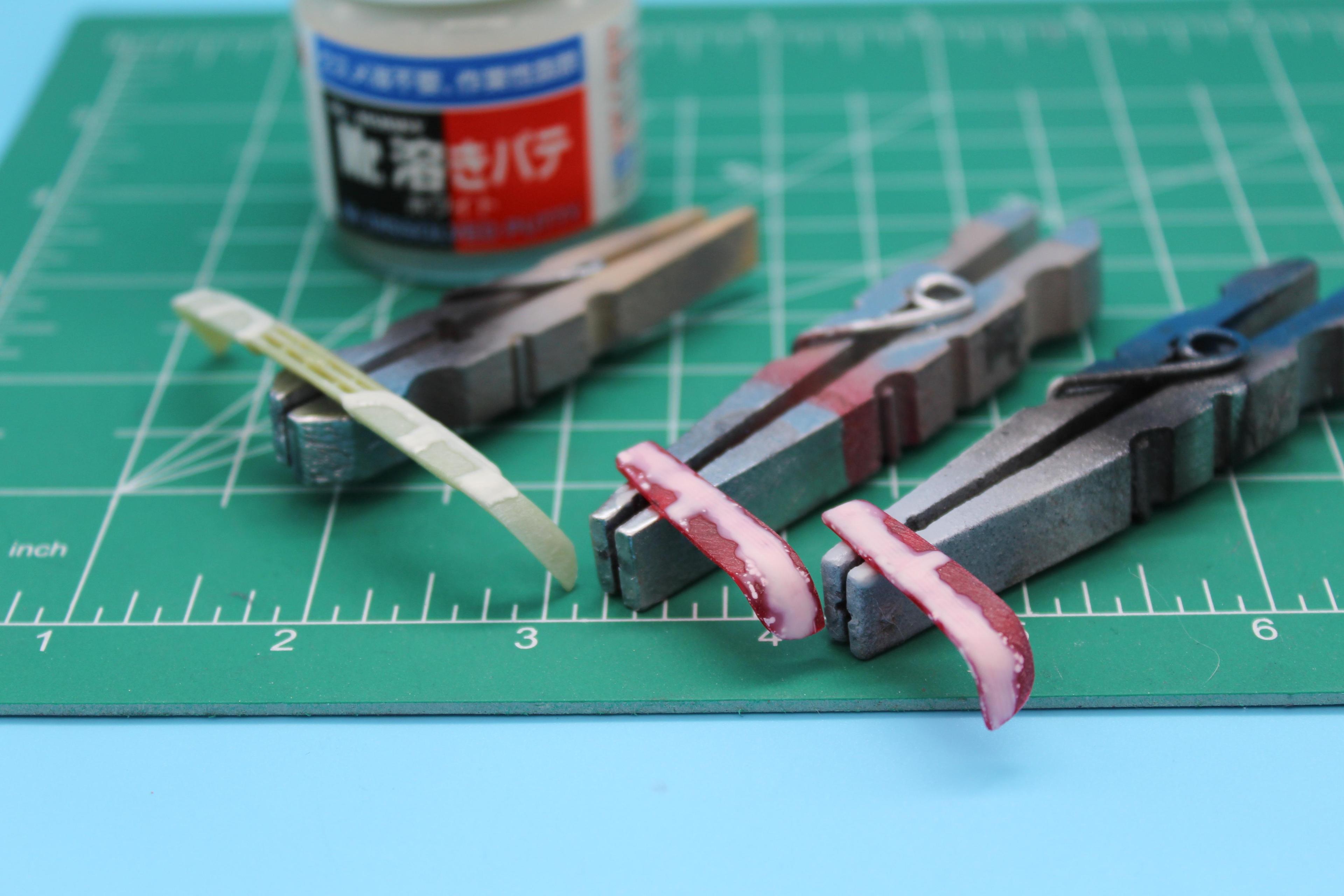

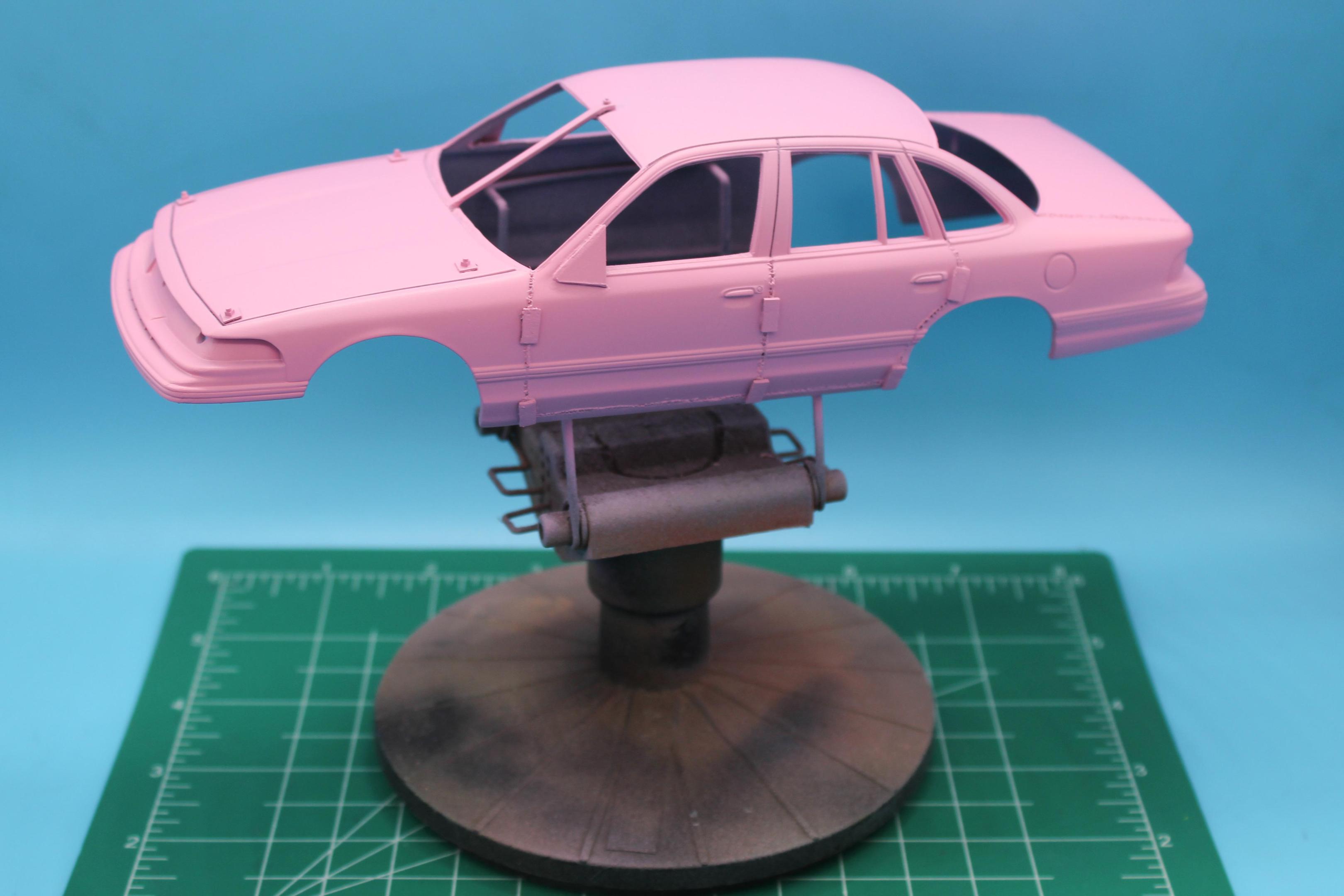

OldNYJim Posted September 8, 2024 Author Posted September 8, 2024 On 9/5/2024 at 11:14 AM, TarheelRick said: Looks like no matter which way you approach it you are going to lose the package tray. I would suggest using s razor saw to carefully remove the package tray right along the edge of the seat back, and put it somewhere you will not lose it. Use a scribe or the back edge of a #11 x-acto and drag around the edges of the seat to remove it. Just a bit of filing/sanding and should be ready for the sheet metal filler pieces. That about how I started doing it, yep! Good tips, thank you! I figured out a way to keep the parcel tray (and thus mounts to the body) intact and in place so it still assembles about the same, but more on that momentarily… On 9/5/2024 at 2:36 PM, Steve H said: HA!! “CabDriver” racing a taxi cab. That made me smile…. My one friend in Jersey always told me “you stay in the city too long you’ll end up a bum or a cab driver”…I never ended up either, but I’m in Indiana right now so maybe that’s why…. Thanks for the nice comments Steve! On 9/5/2024 at 7:18 PM, 89AKurt said: When the other model magazine had a contest, with decal sheet, I built a demo derby car and snagged a prize. You probably thought it will be easy, but now you *have to* fabricate body parts that you normally don't see. Nobody is going to say "that's wrong" either. Have fun! I’d love to see that build Kurt! I have that magazine here somewhere I’m sure - and the decal sheet somewhere in my archive! 2 hours ago, Chuckyg1 said: This is really cool, I'm enjoying it. Like all the research and mods you're doing. Can hardly wait to see more. Thank you!! This last few day‘s progress… Removed the rear seat, which took some careful slicing but allowed the parcel shelf to remain and thus let the tub snap into the body as intended: And then found some reference pictures of what a stripped-out Crown Vic looks like and made an approximation: I think stripping out the carpet would be a requirement a lot of places, for fire safety reasons, but my local track doesn’t require more than that so everything else is about stock…needs some cleanup and some more little details but then it’ll be ready for primer… In between doing that stuff I’ve been working on the body some…shamelessly copying the look of my inspiration: Then the doors - used Vallejo white for this because it covers great and I can get it easily from Hobby Lobby: Next up, I wanted to paint a representation of some rattle-canned numbers on the doors,plus the kind of inside-joke slogan that you often see painted on derby cars that only makes sense to the pit crew and two people in the grandstand… Masks were cut on my Silhouette plotter, because I’m not good enough to freehand in-scale spray painted numbers - but I did want to give the EFFECT of them being kinda patchy and poorly done - like someone used some cheapo dollar-store paint, didn’t shake it, didn’t think it through too well and wasn’t very good at applying it. Shot some Tamiya Smoke on the edges to make it look less opaque than it should’ve been, then shot Flat Black down the center of each number as fine as I could: What a mess…perfect! ? It’s starting to look like a derby car now! Next major job is the roll cage - more soon, soon as I’ve done more! Thanks for looking! 4

BK9300 Posted September 9, 2024 Posted September 9, 2024 Great work on the door numbers (great work on the whole car!) 1
