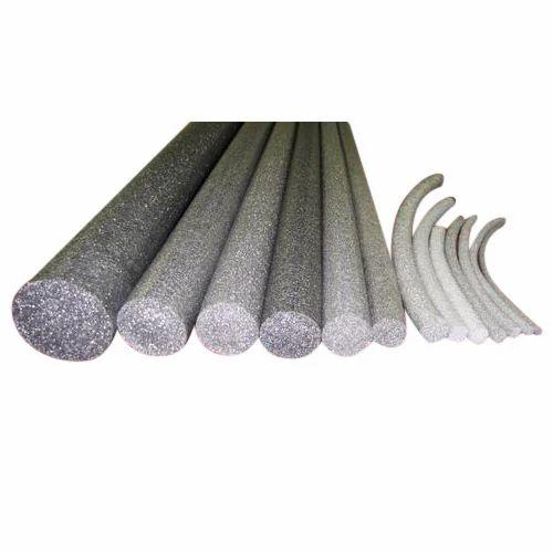

Rich Chernosky Posted September 26, 2024 Author Posted September 26, 2024 Progress report. Took a break from all the tiny nuts and bolts and deviated from the instructions. I actually like doing some of this stuff so it was a little bit of a refresher. Technical details under the pictures. This was a necessity. Filled the hollow tires with urethane foam. In this case Gorilla glue. Took a few applications and then had to be carved so the wheels fit. In the past I have had these tires cave in over a period of time. In one case they went entirely flat and cracked badly. That was on my Tamiya Ferrari 312T. Was lucky to find replacement tires for most of the bad ones. This is now standard procedure for all hollow rubber tires. The foam dries hard and the tires keep their shape. The hweels are painted Tamiya X-18 over gold. The semi black was just thin ebough for a little of the gold to poke through. Looks different than all black. Sprayed and detail painted all the brake and hub assemblies. These will get brake lines before going on the model. Now this was fun. Fabric covering came from the kit. Didn't follow the advice on the instructions and cut some of it too short. Luckily it pieces together seamlessly. Seatbelt fabric was from the kit but the hardware is PE from the Perfect Parts pack. Shoulder harness fastens to the chassis and will be installed when the seat goes in. Did a little on the brakes cylinder assembly. Will also get brake lines later. 1
peteski Posted September 26, 2024 Posted September 26, 2024 I stuff hollow rubber tires with foam backer rod from a hardware store. It comes in various diameters. Less messy than urethane foam, but still stiff enough for the tires to retain their shape. But I use it on regular width tires. I imagine with wide tires you would likely have to use 2 rods inserted side by side. 1
Rich Chernosky Posted September 26, 2024 Author Posted September 26, 2024 1 hour ago, peteski said: I stuff hollow rubber tires with foam backer rod from a hardware store. It comes in various diameters. Less messy than urethane foam, but still stiff enough for the tires to retain their shape. But I use it on regular width tires. I imagine with wide tires you would likely have to use 2 rods inserted side by side. Peter...that is a great tip. Yah...the urethane foam is a little messy. Only good thing about it, is it fills the interior to the exact shape.
