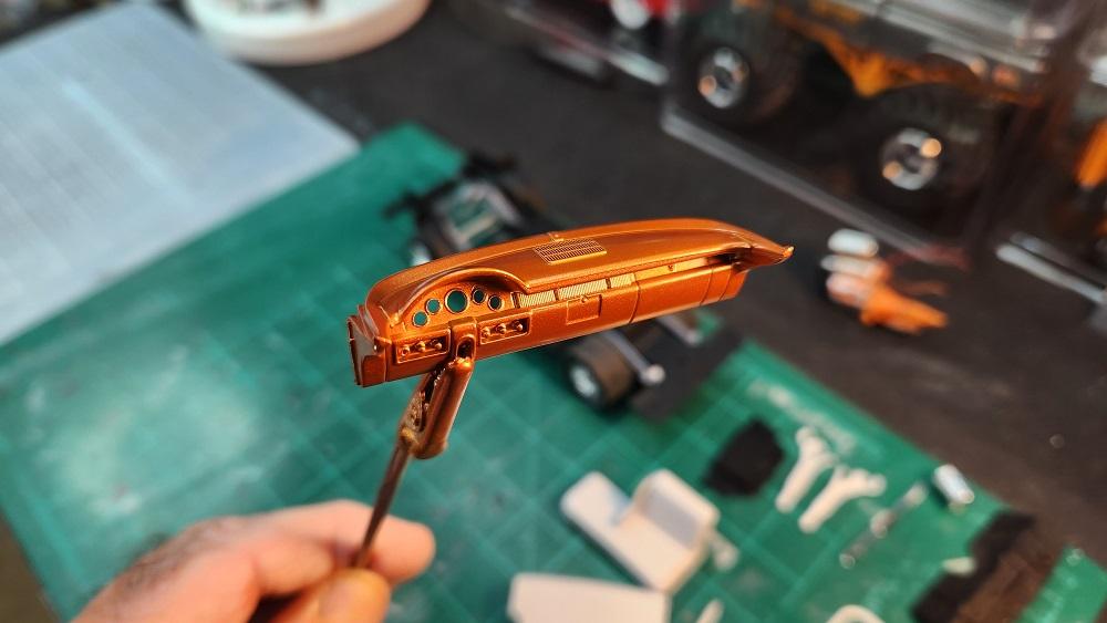

Zippi Posted October 16, 2024 Author Posted October 16, 2024 This morning the temperature in the garage was 67° and the humidity was a 34% so I got after it. I laid down 3 coats of the Tamiya TS-92 Metallic Orange over the TS-30 Silver Leaf and I got the candy effect I was going for. I think it looks pretty close to the cartoon pic I was trying to mimic. I'll let this cure out then I'll airbrush the Splash Paints 2K Urethane clear over the Metallic Orange. 1
ksnow Posted October 16, 2024 Posted October 16, 2024 That paint turned out very, very nice. Color looks spot on. Hopefully the clear goes on just as well. 1
Sledsel Posted October 16, 2024 Posted October 16, 2024 Wish I had seen this sooner cuz I'd have recommended you cut off the bottom of the front fenders and used the valance from the AMT kit. It is more correct than the Revell "thing" Lookin' good tho.
Zippi Posted October 16, 2024 Author Posted October 16, 2024 3 hours ago, ksnow said: That paint turned out very, very nice. Color looks spot on. Hopefully the clear goes on just as well. Thanks Kyle. The Spash Paints 2K clear hasn't failed me yet. ? 3 hours ago, Sledsel said: Wish I had seen this sooner cuz I'd have recommended you cut off the bottom of the front fenders and used the valance from the AMT kit. It is more correct than the Revell "thing" Lookin' good tho. Thanks man. I appreciate the info.

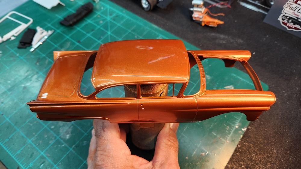

Zippi Posted October 17, 2024 Author Posted October 17, 2024 I had a chance this morning to get the 57 to the spray booth and shoot the 2K clear on before I headed out to cut the grass. Temperature was 63° with 37% humidity. It came out really nice so I'm a happy camper. 2

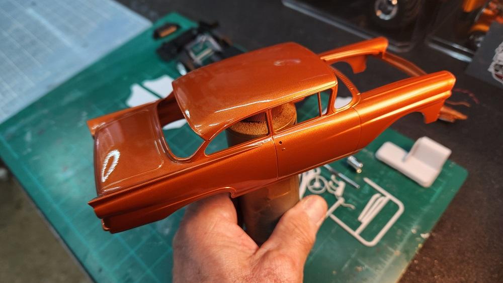

Zippi Posted October 18, 2024 Author Posted October 18, 2024 Well, it's been 24 hrs so I started taking a close look at the clear coat that I did yesterday and it's leveled out really nice. I knew I had issues with the hood but another coat of the clear late yesterday did the trick. Now I'm seeing a new issue with the hood. I know yesterday there was a hint of the slot on the hood where the emblem goes but this morning it looks much worse. Not sure what I'm going to do with this. 1

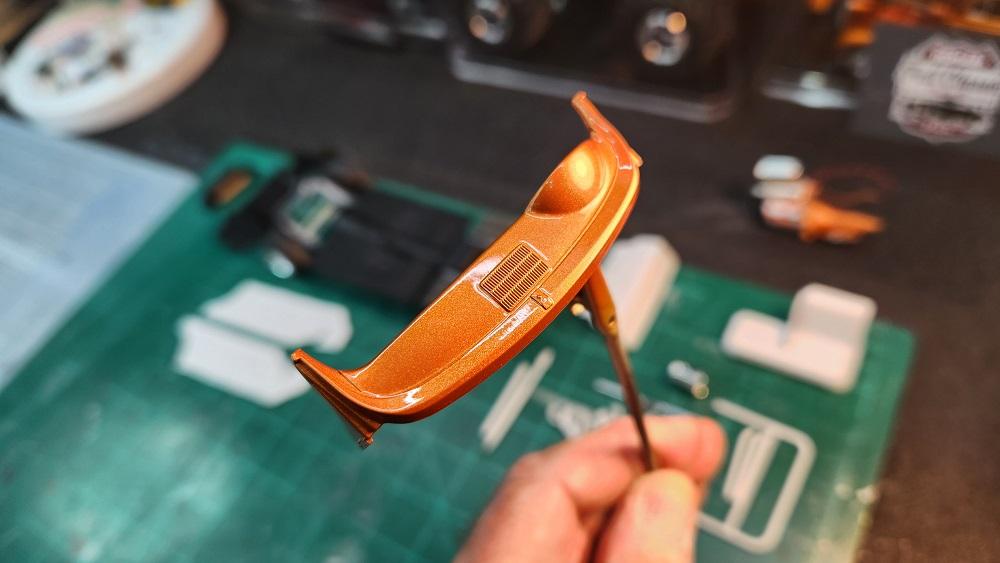

Zippi Posted October 21, 2024 Author Posted October 21, 2024 My goal this morning was to get the body polished out, bmf on front and rear glass trim, and get all the glass installed. I'm feeling pretty good on where I'm at on this build. 2
