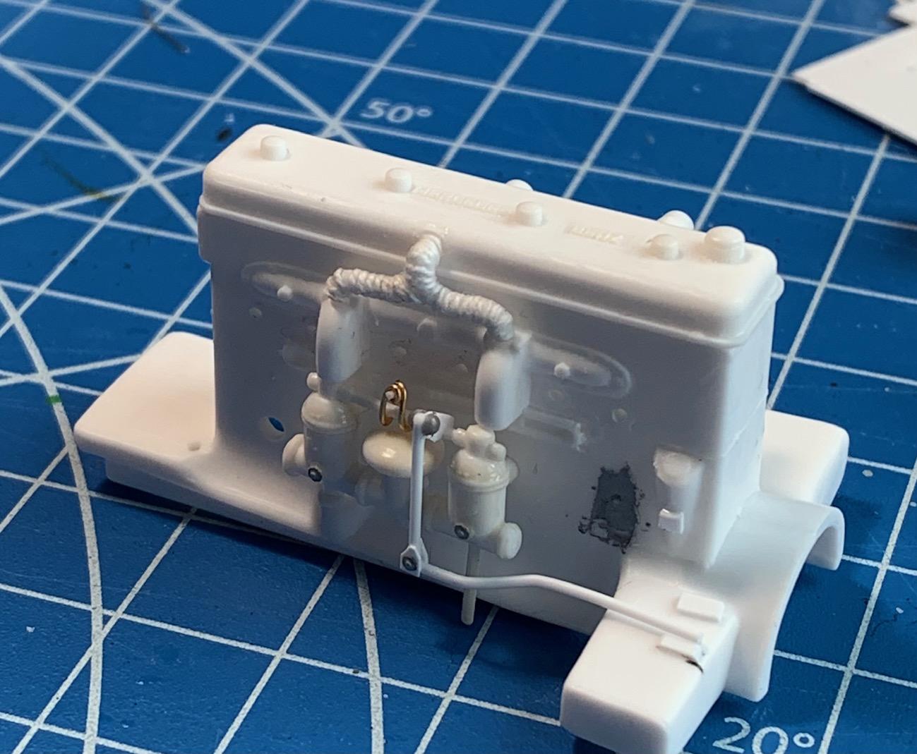

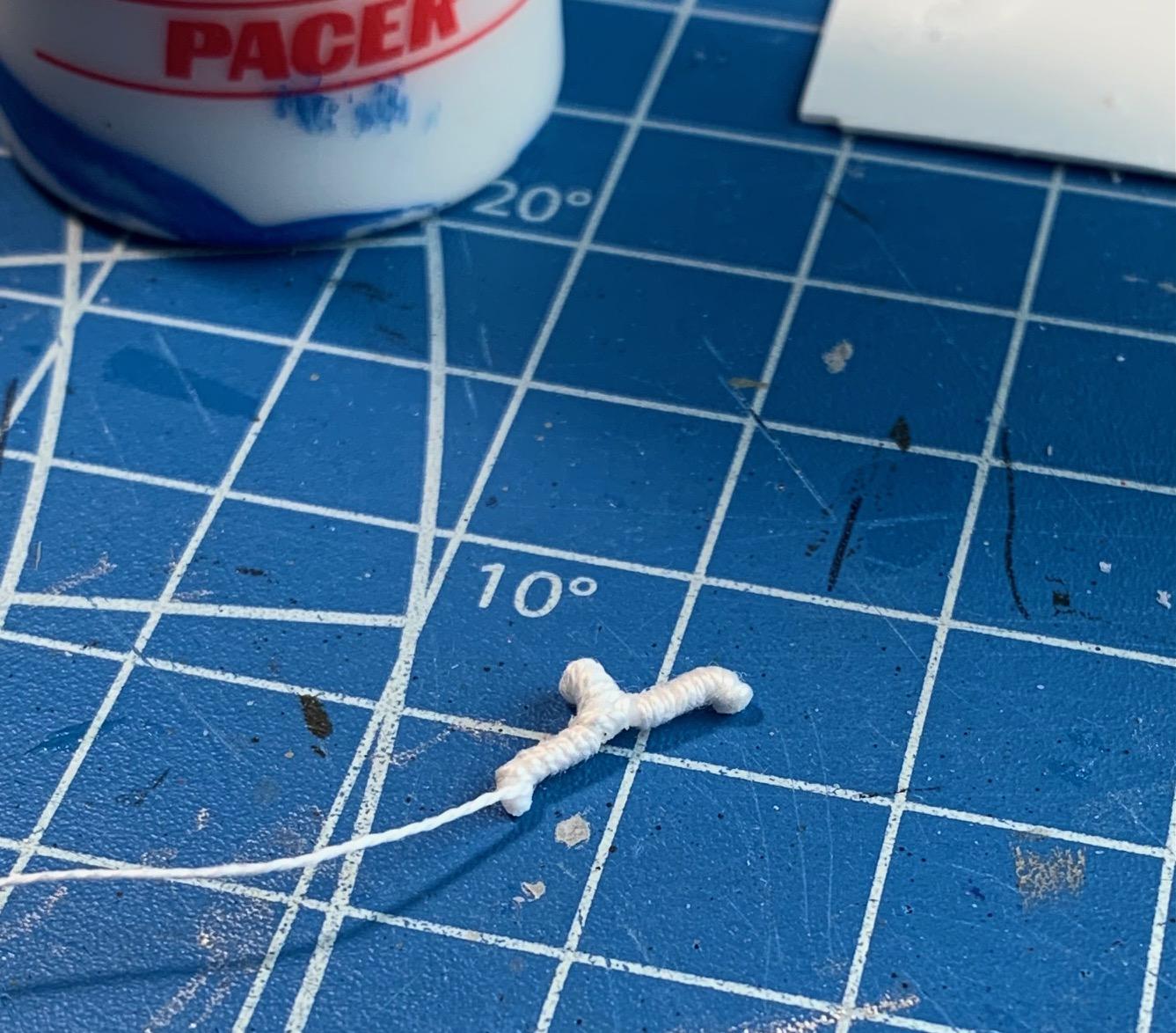

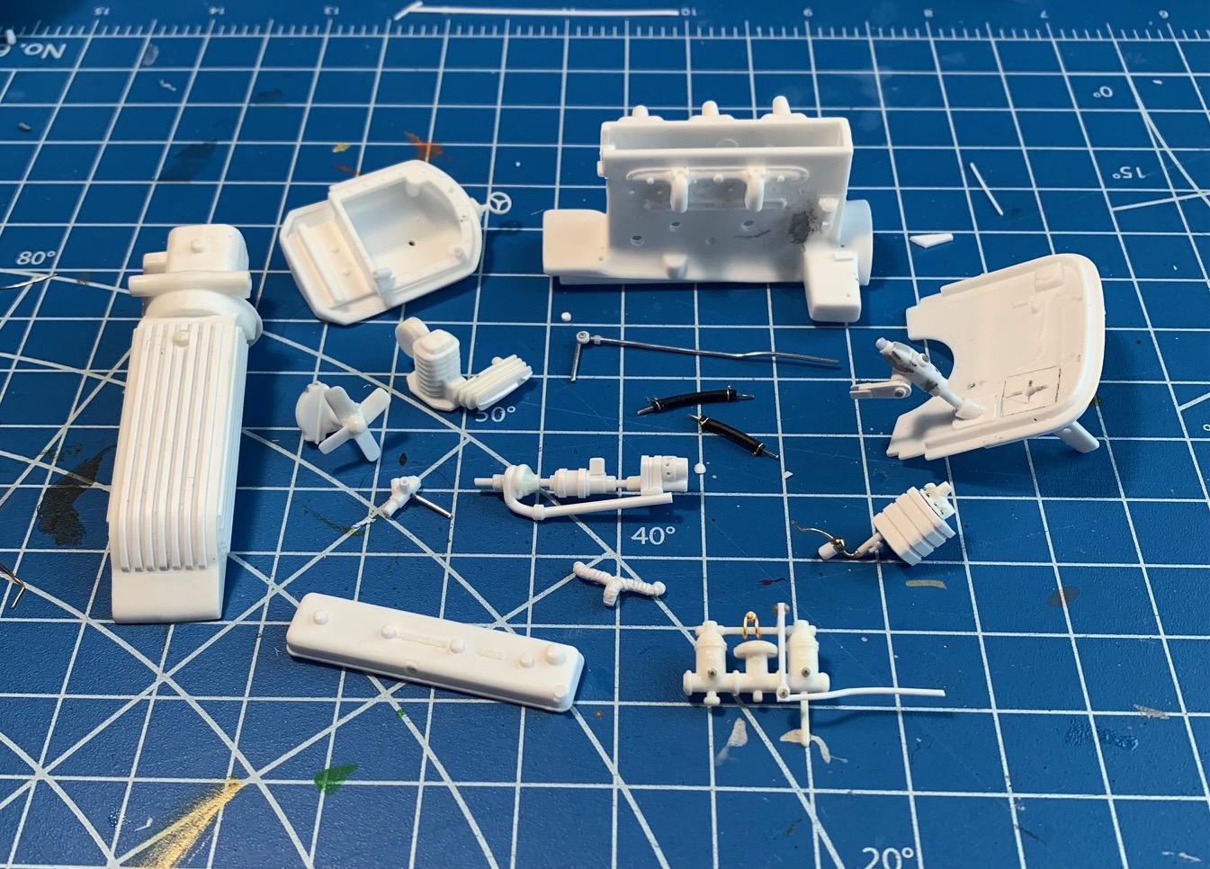

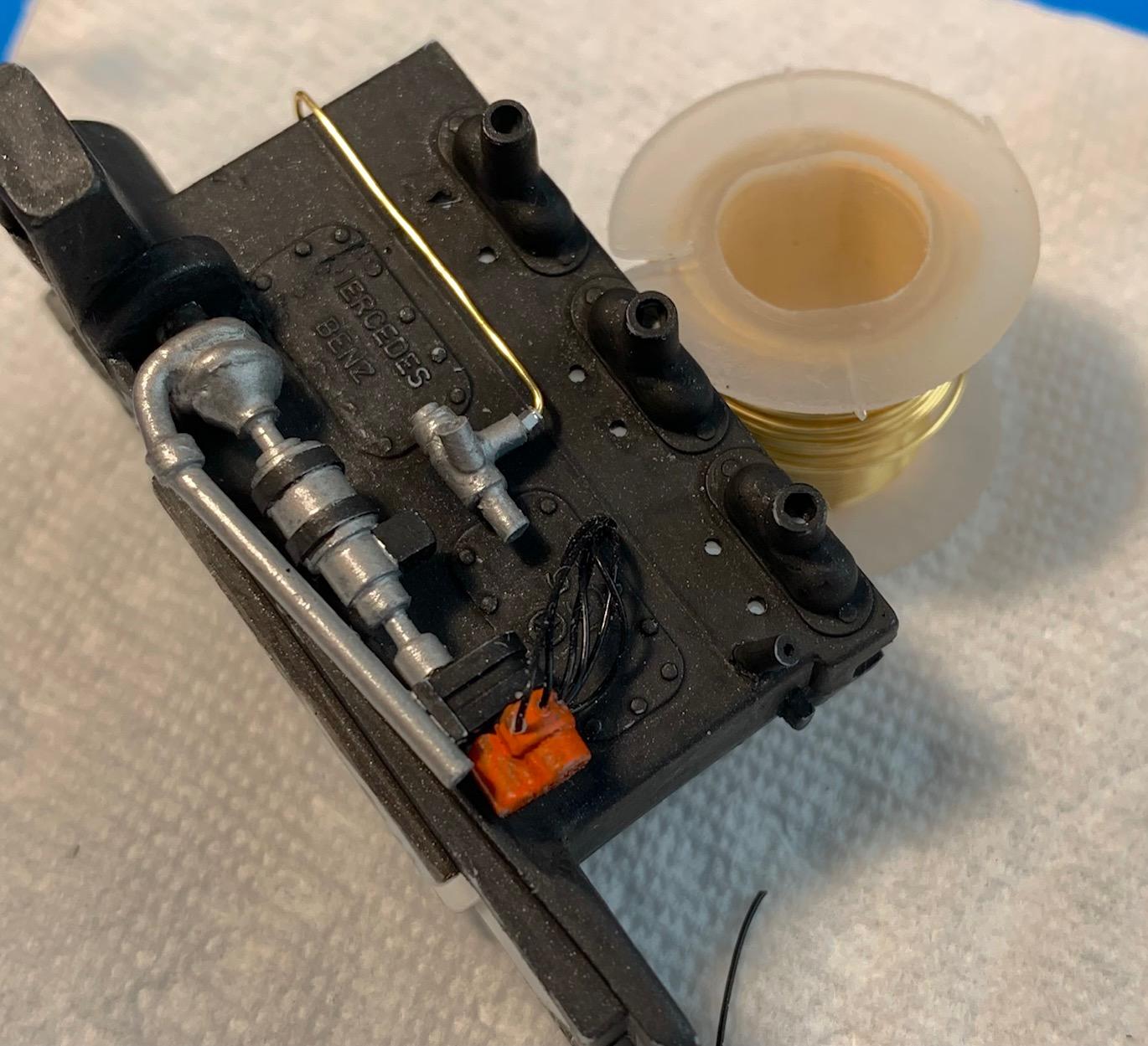

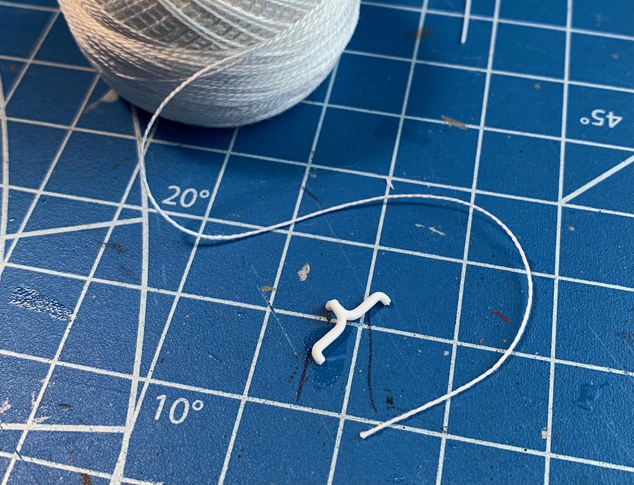

The last 3 engine component fabrication bits, other than the wiring and plumbing.
First the rad hoses made from rubber cord and 0.29mm wire fro clamps.
Second, the carb warmer coolant conduit with some sort of cotton rope insulation.
Finally, I decided to add the conduit with faucet style valve and what appears to be a filter case under the "oil tank"

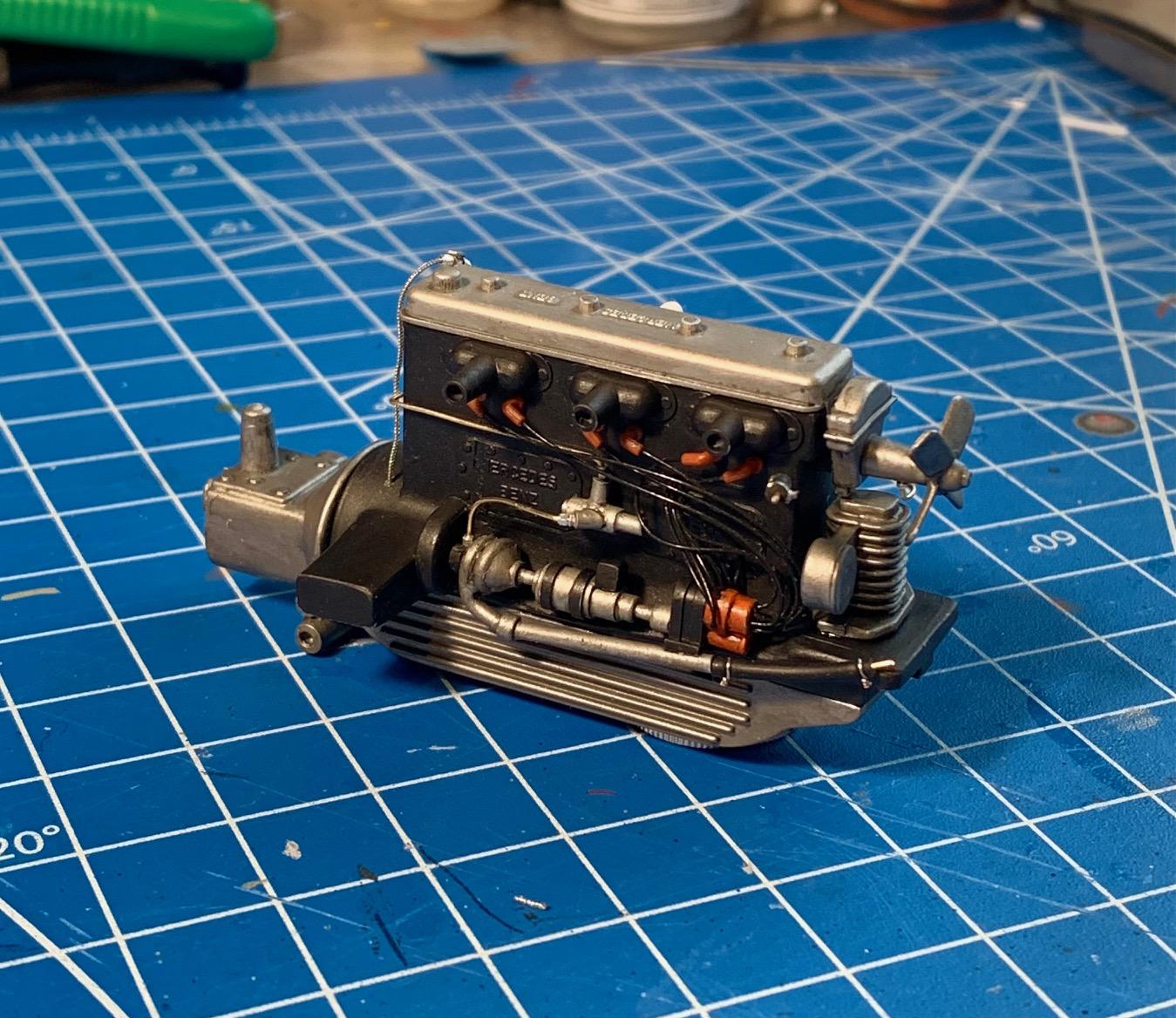

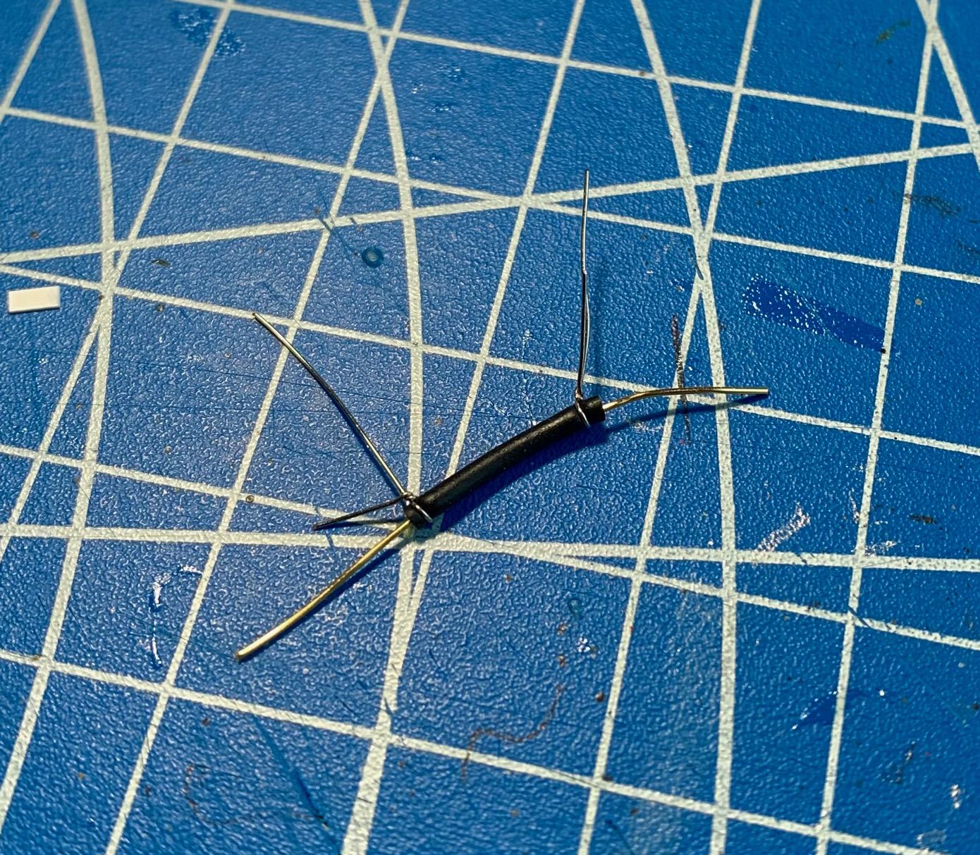

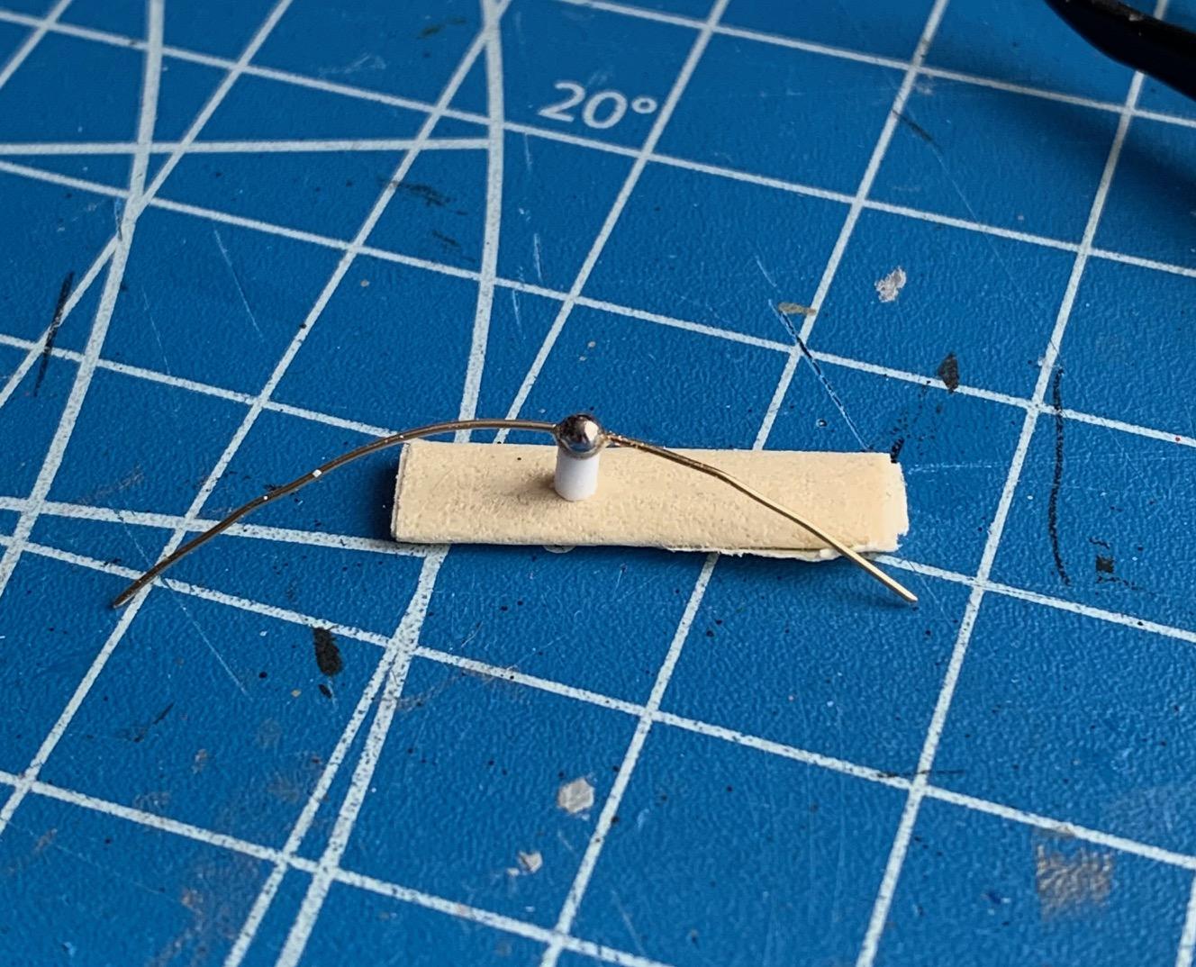

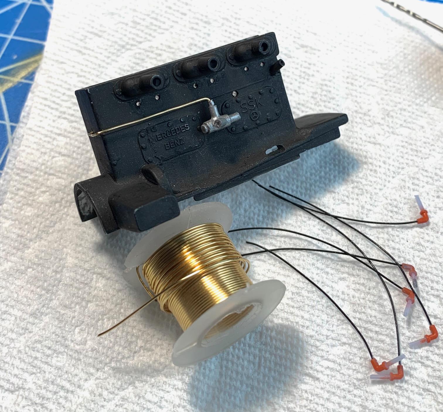

Components painted and dressing up & assembling the engine finally starts.
I have to work this in layers, with first the coolant pump greaser and one of it's lines,
Second, installing the coolant pump dynamo/magneto assembly and starting the ignition wiring.
The engine has 6 cylinders and a twin plug arrangement. The first set of wires from the magneto run to a conduit through the block and reach plugs to the left side plugs. The second series of 6 wires feed the plugs on the magneto side.

The rest of the engine has been assembled and some washes added to give it a bit of worn look. I am never comfortable doing engines so getting through this crucial phase of the build is a relief. I am pretty happy with the results.

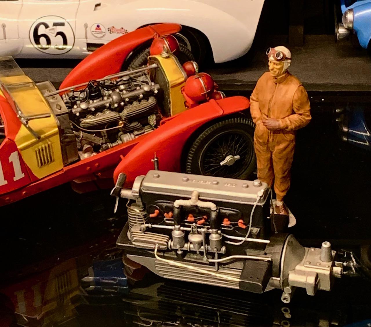

Its wild how real that engine looks. Looks like you found a real engine out of a full sized one and shrunk it to scale. Thats scratch building, painting and weathering at the highest degree when you can get that done. Amazing work.
It really looks like Tazio said those exact words with the look he has on his face. Like he's trying to say I accomplished more with less with that sly smile. Great comparison pic of the two engines.

I thought it would be fun to compare these two. The Alfa 8C2300 was the new car to beat and the SSK's career was winding down around 1931.

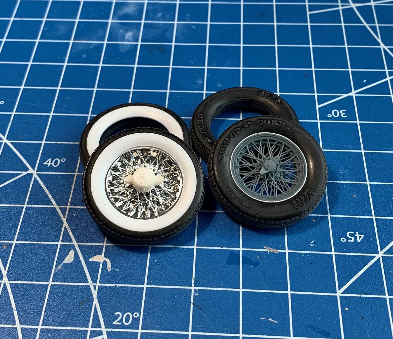

A lot of head scratching withe the assembly sequence as I am still pondering on the final body configuration I want to go with. While this is happening I finalized my wheel & tire solution, which must precede the body as I'll need a set tire location to locate the fenders properly.
I definitely wanted to upgrade from the cast wheels and got Jason Hupin to print wire wheels in 22 mm diameter. I did not ask him to design an exact reproduction of period wire wheels due to the limited business opportunity for him (who else but me will build this car?) so used an existing design we worked on previously and asked him to produce a 22mm version. Discerning eyes will spot what is not correct about these but I consider them to be "goodenuf" for my project. I am reusing the kit tires and massaging them as best I can. Of course no whitewalls for this customer. I had to add 0.25 mm thick bands around the rims to get a better fit. Then getting the chassis attachment sorted out and finally a bit of paint (that feels good)
