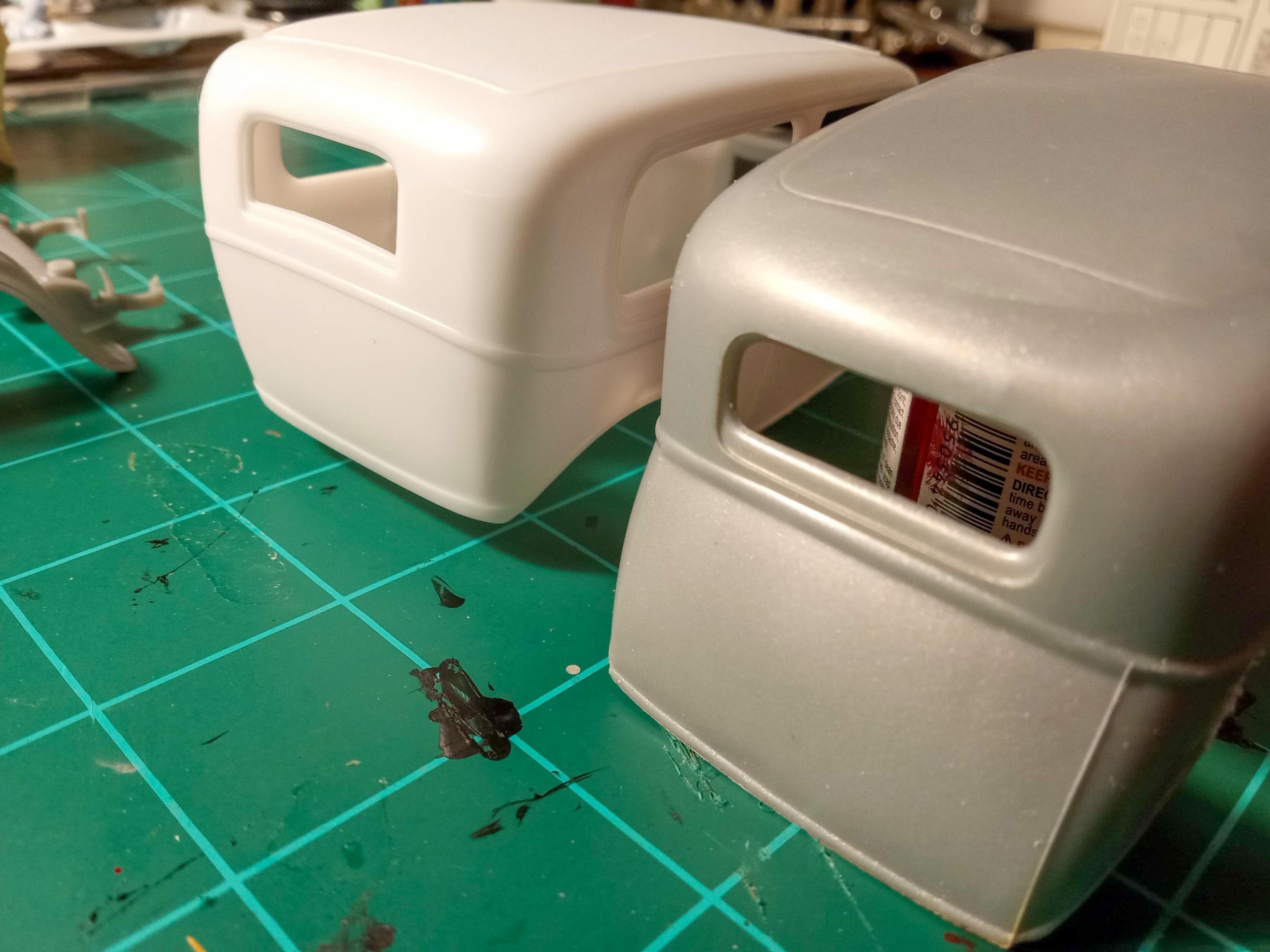

Here's my build thread on converting an AMT '32 Ford Vicky into a B-400. This is part of my quest to have one of every '32 body style my collection. The only models I'm aware of are the Franklin Mint Diecast and the Jimmy Flintstone Resin body. Both have their issues. I initially bought a Flintstone body for this conversion, but upon receiving it, it's easier to convert a styrene body. Not only are the quarter windows off in shape, the top is just rough as a cob no matter how you cut it. On the 1:1 car the top is flush with the body and the rear window (curtain light in Ford parlance) isn't even close to being correct. Having restored a 1:1 '31 Model A A-400 I'm familiar with this body style as lots of parts carried over into the '32 model year.

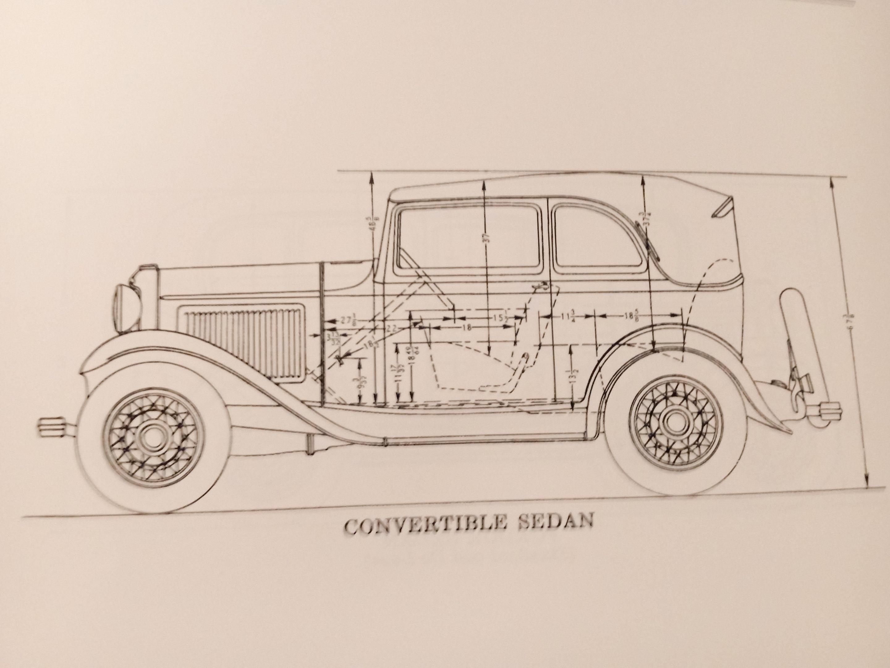

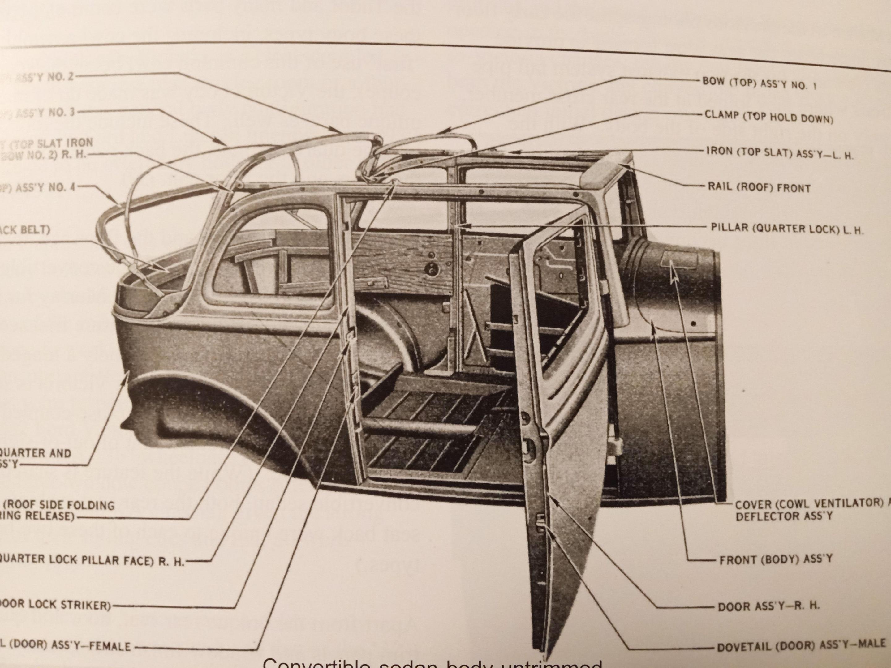

I dug around in my '32 literature collection and made a copy of the body in white drawing & side view and scaled it to 1/25. In addition to this drawing I also printed out some photos I saved online.

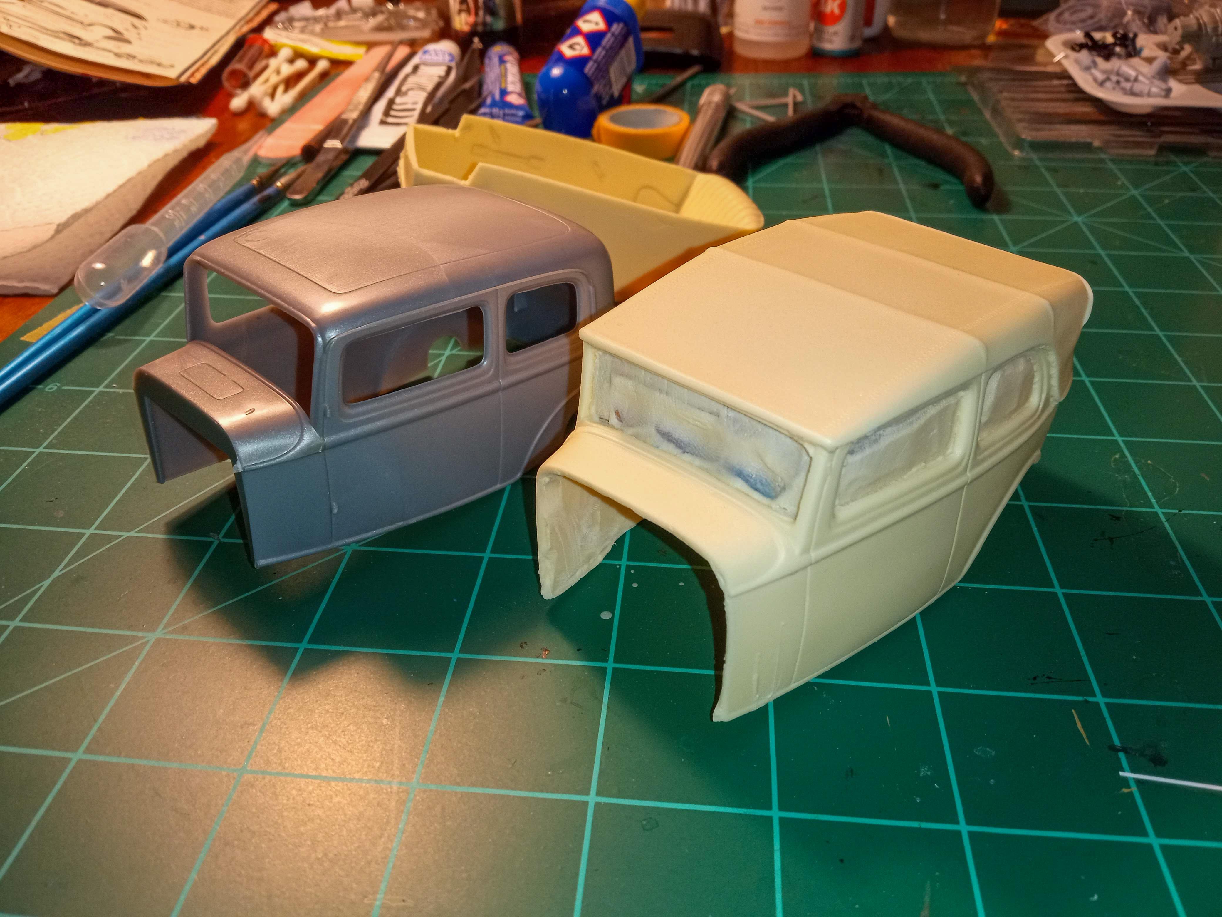

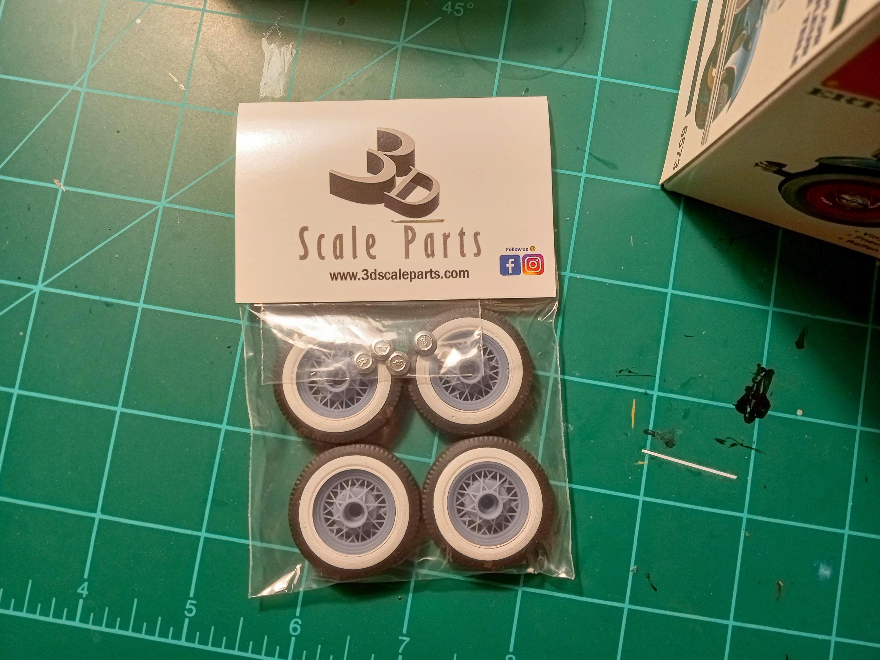

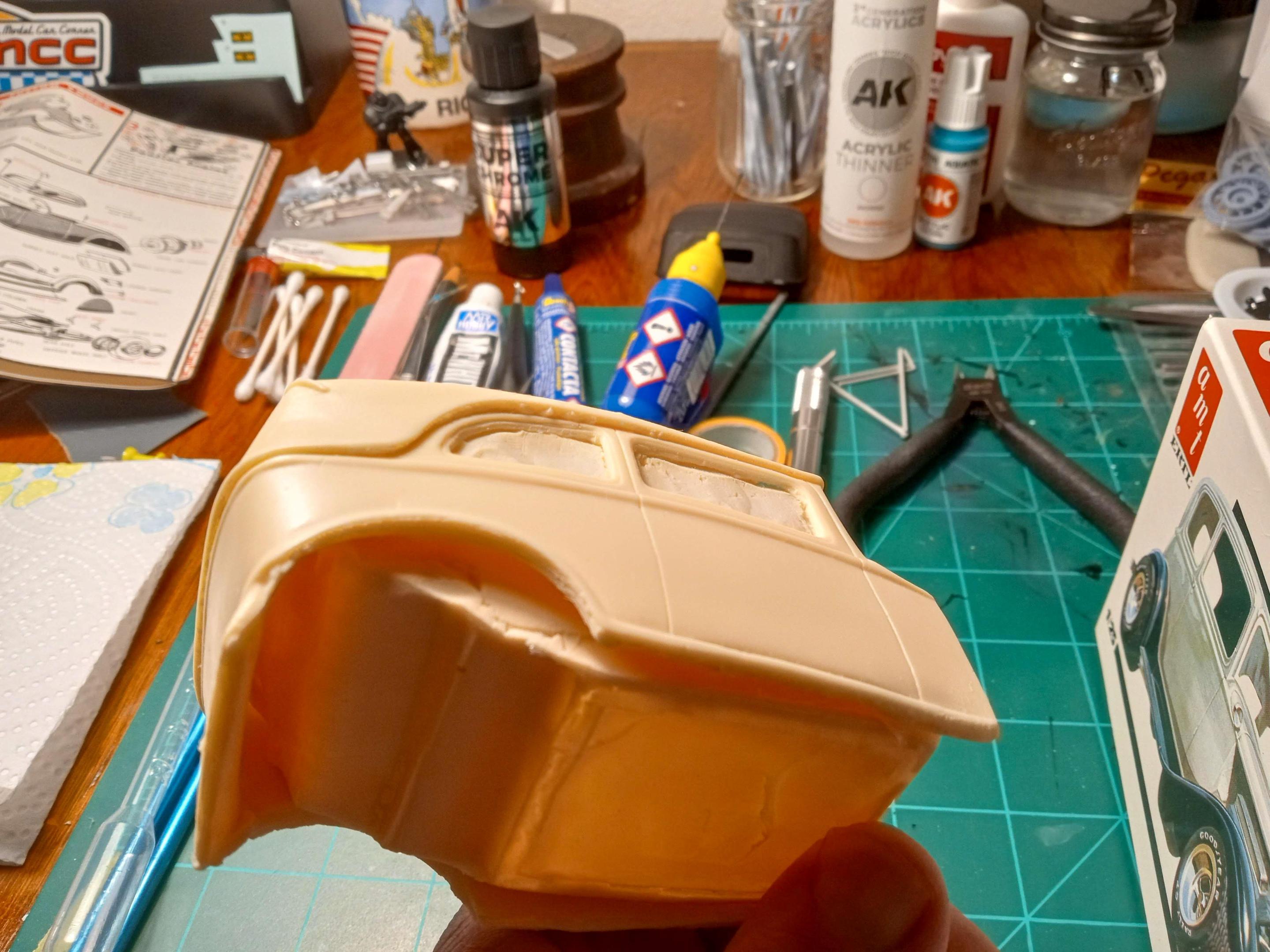

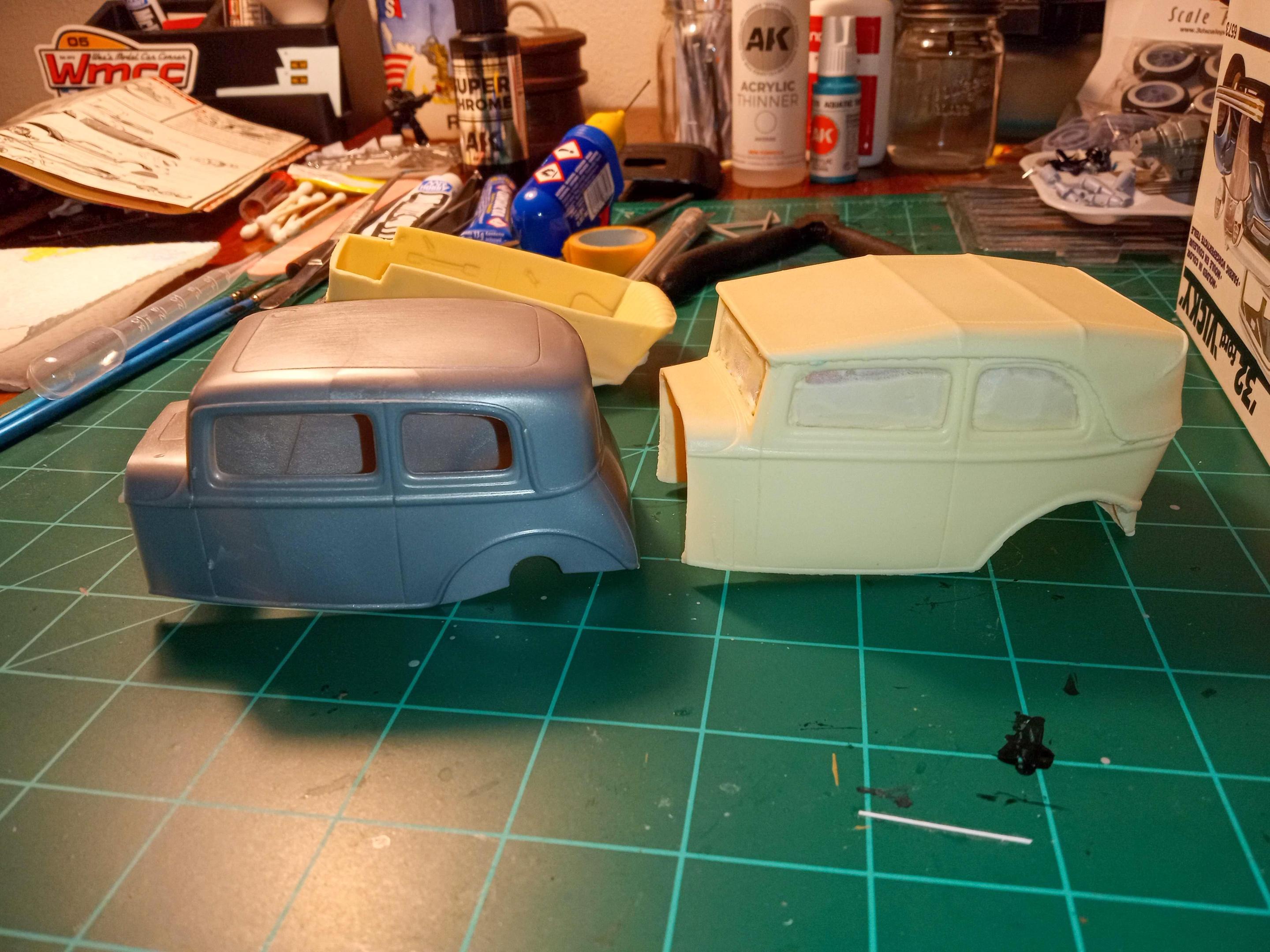

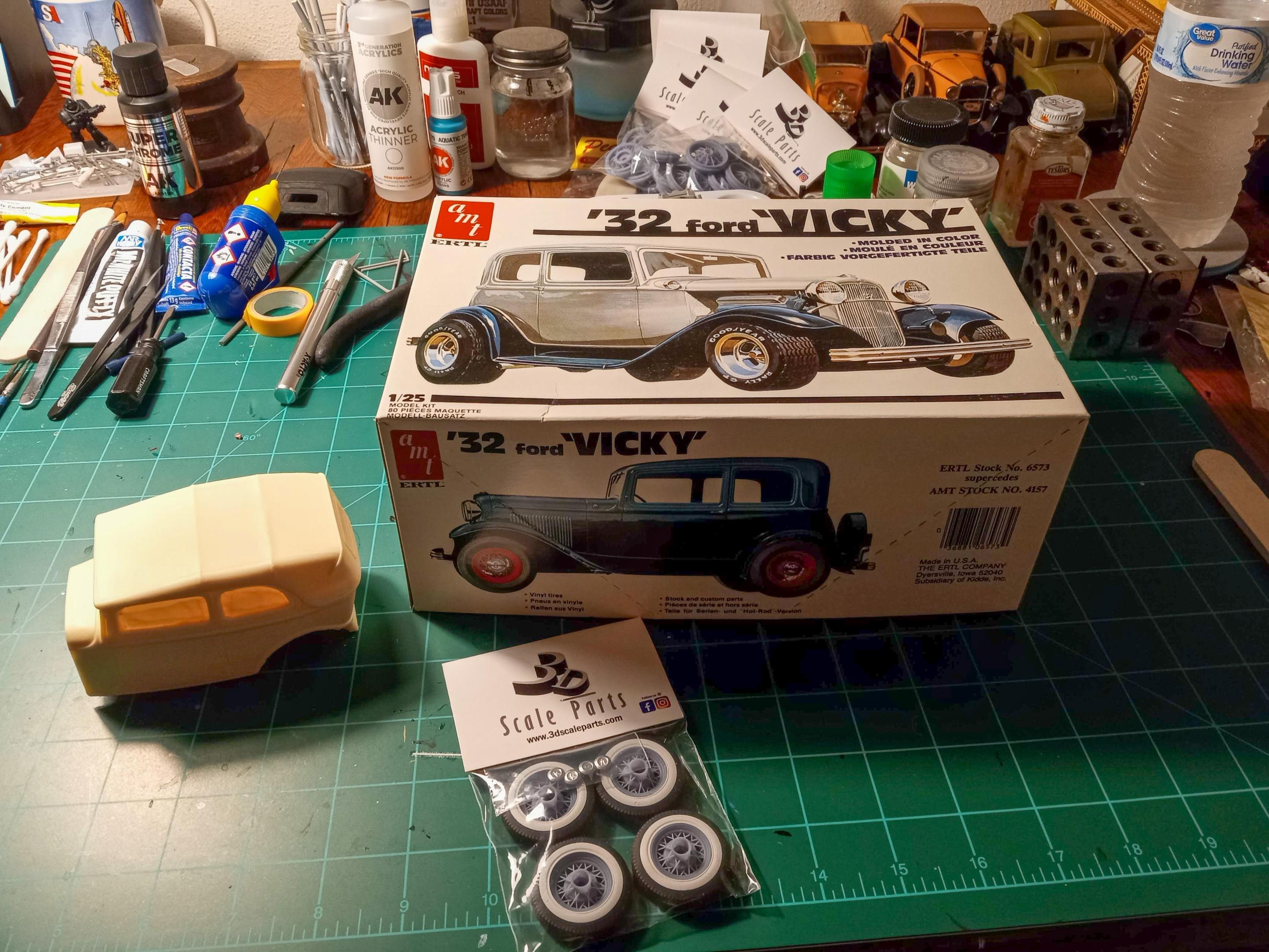

Here's what I'm starting with. This particular boxing of the kit is my favorite as it's the same one I bought as a kid in Kmart all those years ago. Nostalgia is a powerful thing. The aforementioned Jimmy Flintstone body, a set of '32 18" wheels from 3D Scale Parts-very nice parts! Also a donor body from Revell '32 Tudor kit. Not shown is the usual stash of Plastruct & Evergreen styrene we all have kicking around on our build desks. You can see the issues with the top and I also didn't like the curvature of the rear panel on the resin body.
  • Like 8

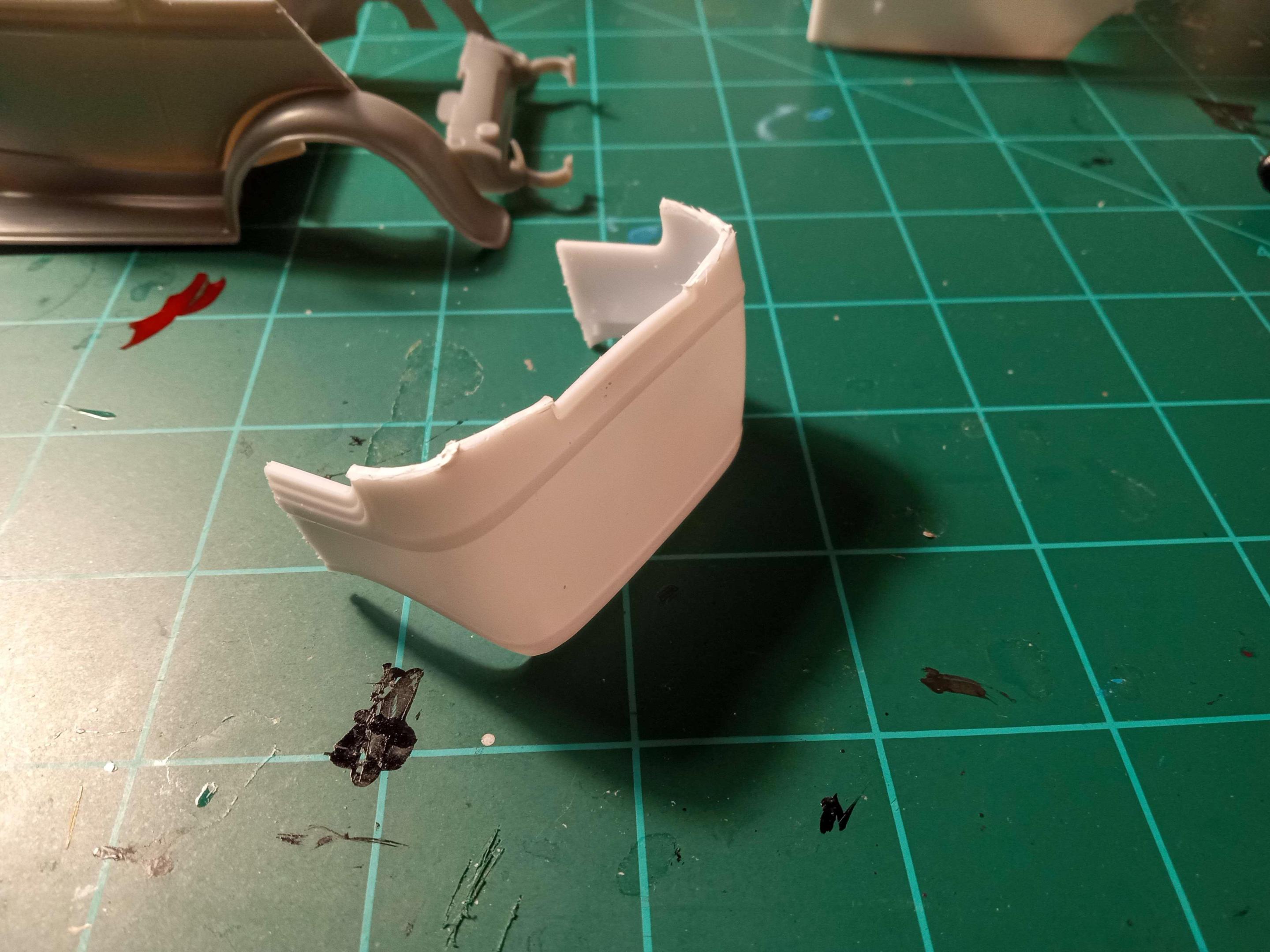

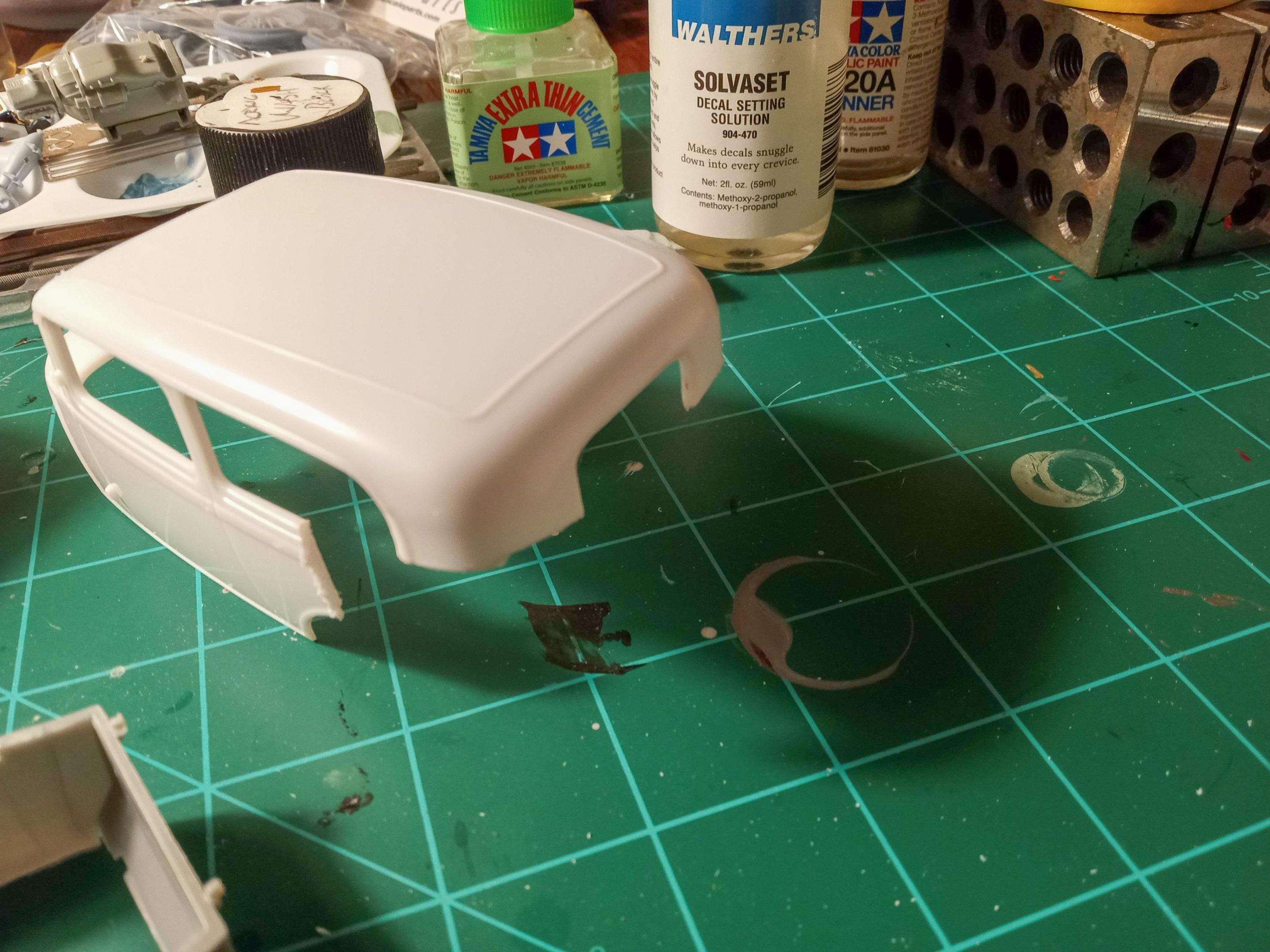

The Victoria has a bustle back where the B-400 has a curved back like the sedans. My plan is to use the rear of the sedan body on the Vicky body and scratch the quarter windows and rework the rear beltline as it's unique to the B-400.
  • Like 7

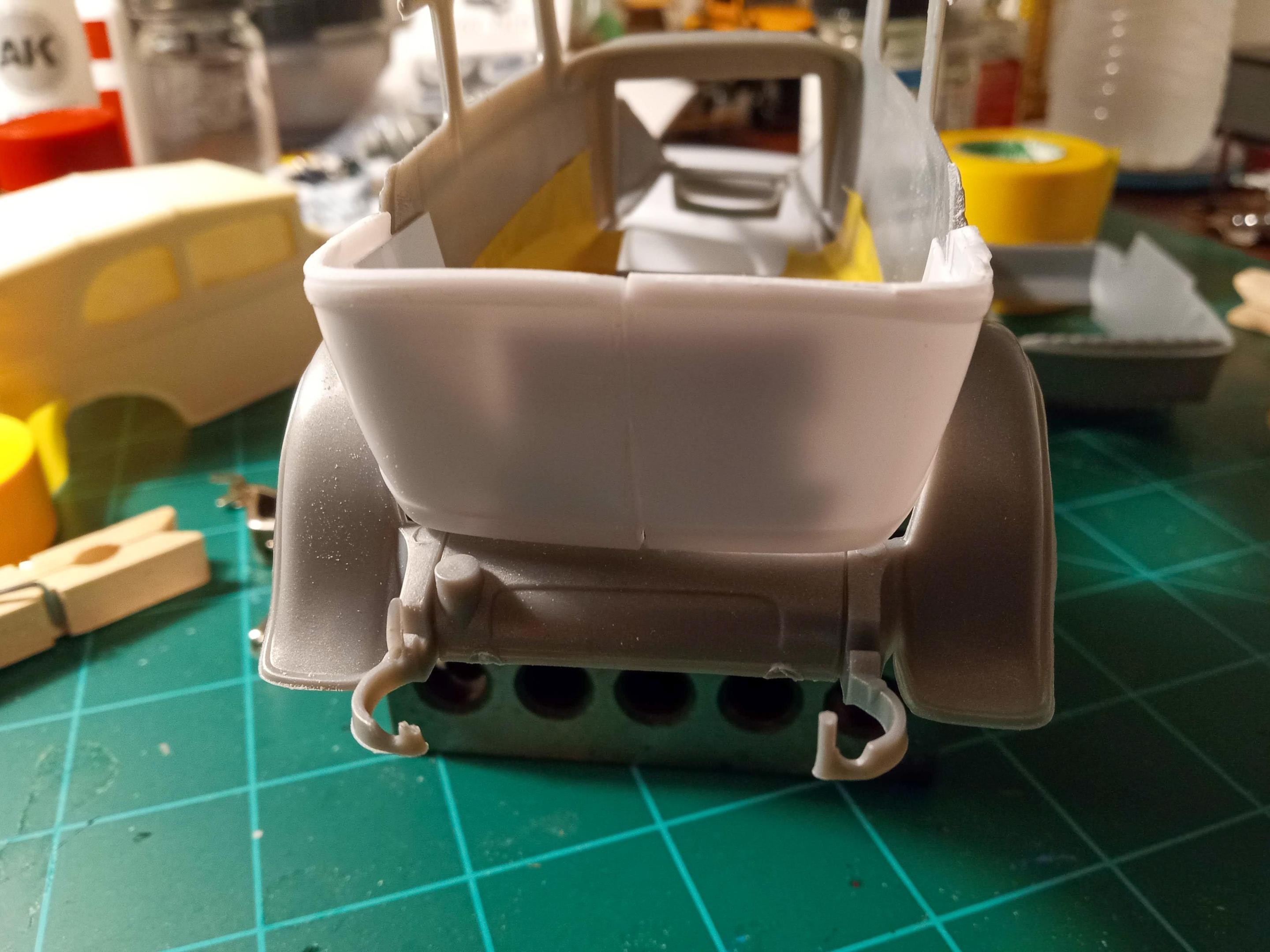

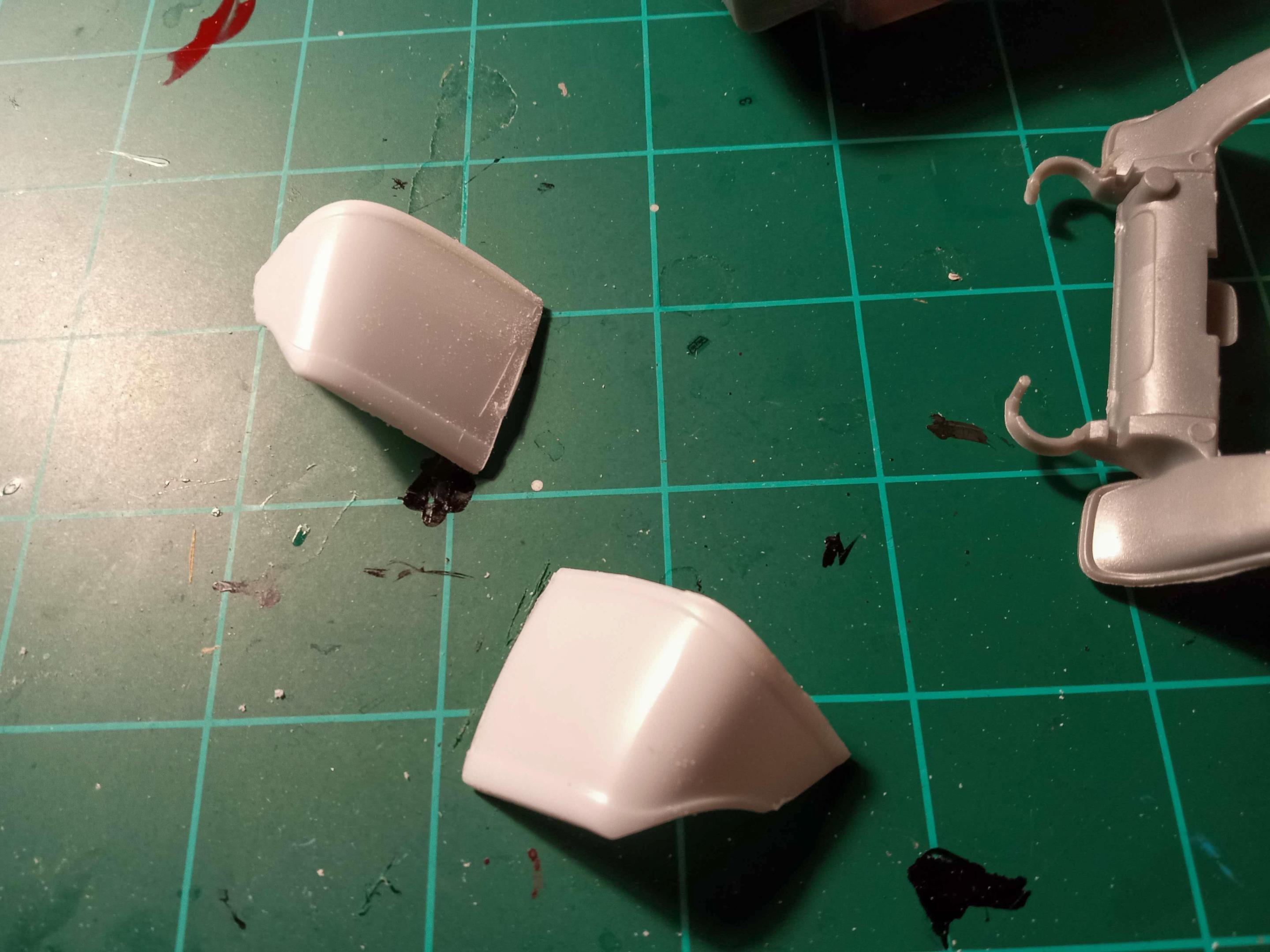

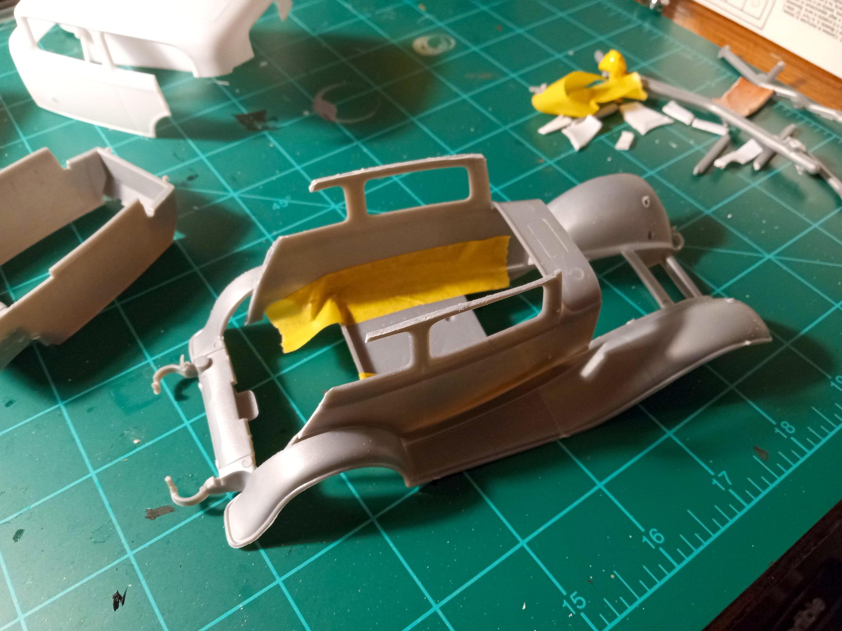

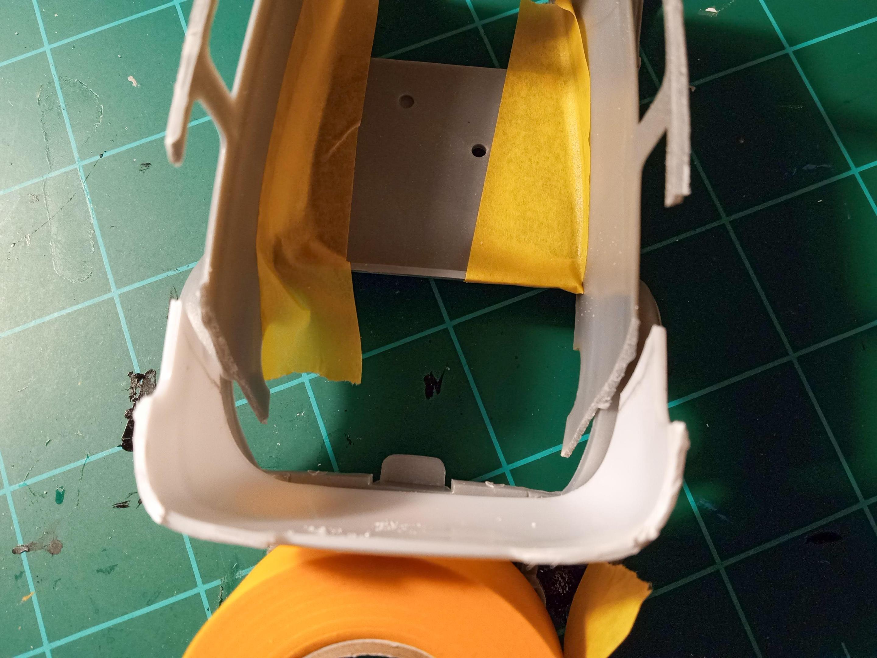

Started making some rough cuts. My trusty razor saw made short work of taking the top & bustle off the Victoria body & the rear section out of the Tudor body. You can see where the Tudor body section is wider than the Victoria body so I cut the Tudor section in half and sanded some off each side. IMG_20250119_212640542.thumb.jpg.58a469030c827c0702b5bb3d9246e3c5.jpgIMG_20250119_212635291.thumb.jpg.6b104cb71b8fdb98e9a30877a6ffe7dc.jpgIMG_20250119_210503915.thumb.jpg.bec7ebcb967e143973ad44c79e02b507.jpgIMG_20250119_211043992.thumb.jpg.0556eb45153f0b6823729e68e35188eb.jpgIMG_20250119_212621248.thumb.jpg.bdc620f01a677d9ae382966d4db59da4.jpg

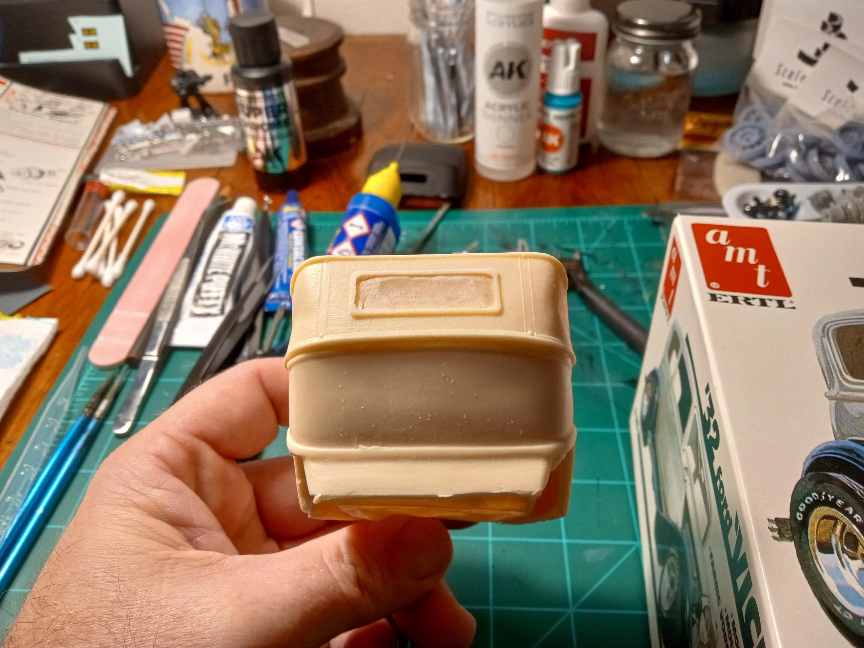

Some .020 styrene strip fishplated to the body where it meets the rear section & the Tudor half pieces. I went a bit overboard with the fishplate because I figure I'm going to be doing a lot of handling during the rest of the bodywork and didn't want any structural failure by skimping on materials!

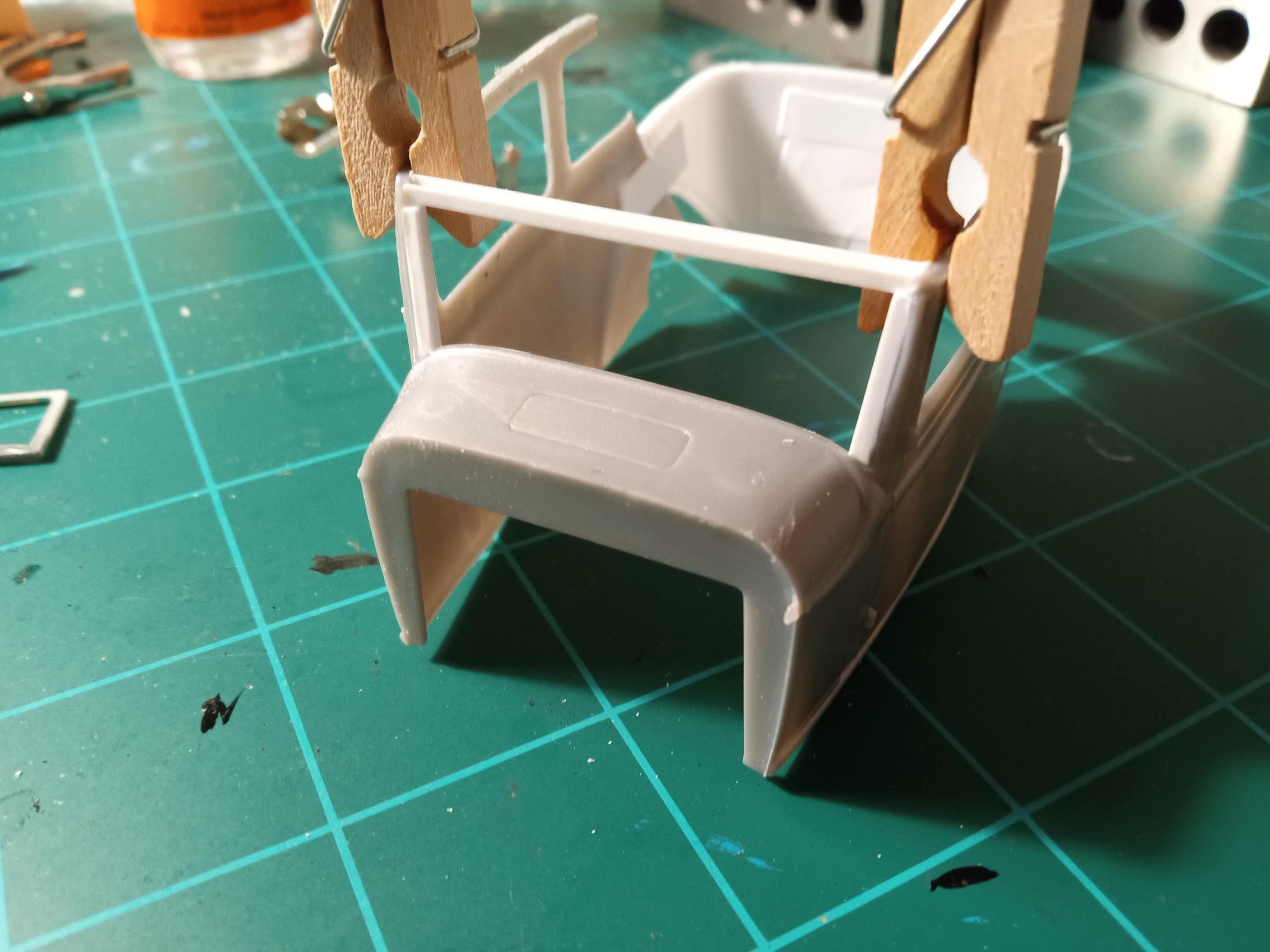

Tonight's work ends with reworking the windshield opening and making a header for the convertible top. Even though I plan on having the top down, this area is still visible and want to make it look right. The B-400 uses the same windshield & frame as the '32 Cabriolet and this windshield is not like any other '32 passenger car. It is more Model A like in design with it's square corners & tube hinge. The windshield pillars are different between the two body styles as well so I fitted some .040 square Evergreen into the pillars and laid a piece of Plastruct channel to serve as the basis for the header.
The kit windshield frame ain't gonna get it so I will scratch a new windshield frame to fit the corrected windshield opening.

Looks like an original '32 Body Parts List! I've got most of the Model A Body Parts & Parts Price Lists, but an original '32 has eluded me so far.

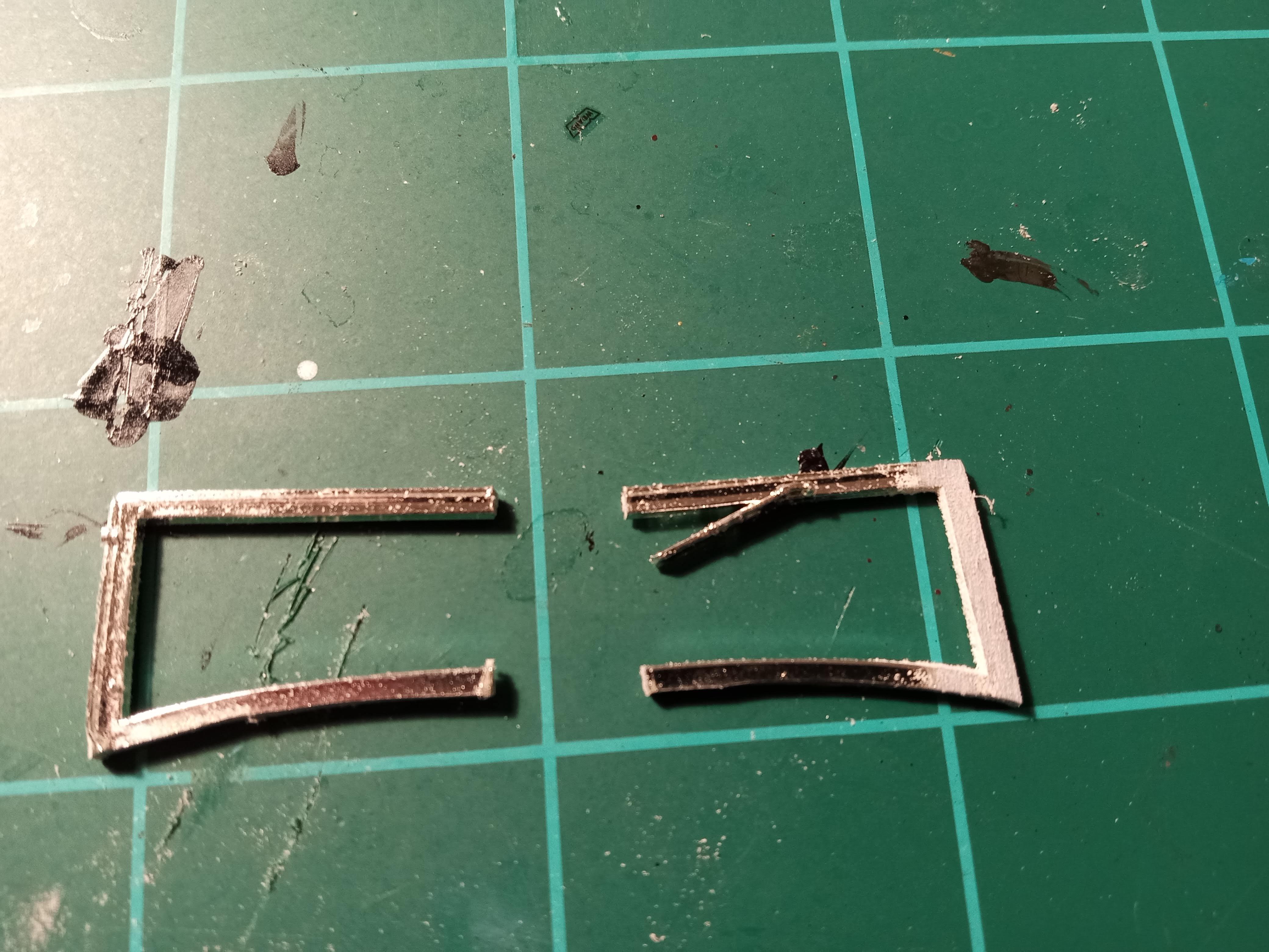

I thought how I wanted to go about the windshield. Finding a windshield frame in my junk box from the AMT '36 Ford kit that had a groove on the backside for the clear plastic made this an easy choice compared to building one from scratch. I started by sanding down the thickness, cut the frame into 4 pieces and sectioned each piece. I framed it up on a 123 block with magnets & set it aside for the glue to dry. I'll fine tune it after I let it set a day or two.
  • Like 1

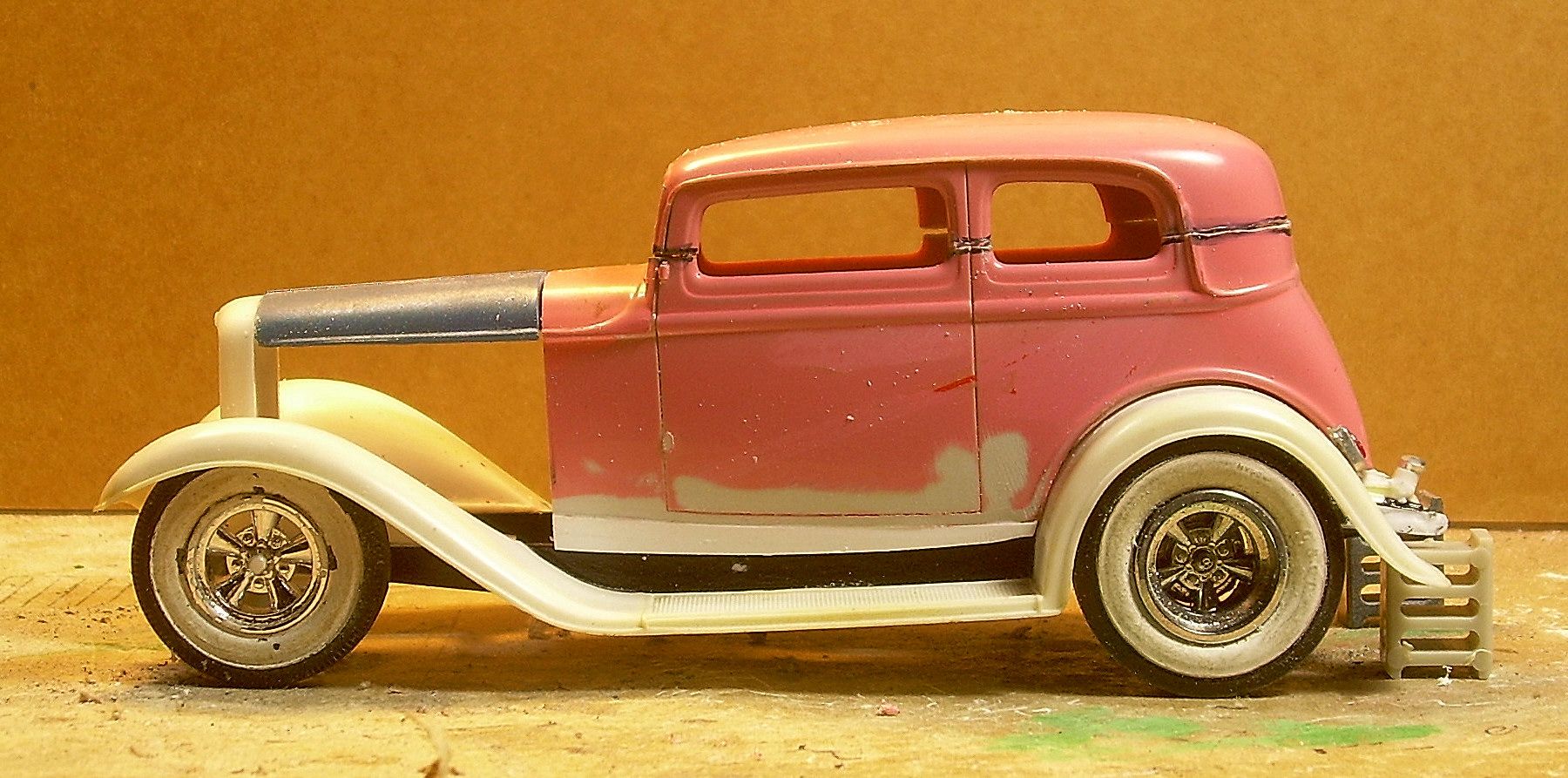

Since you're doing so much work, you might consider addressing the too-low cowl on the AMT body (all the AMT '32 kits share the same problem).
The correction isn't difficult, especially in light of how much other major work you're doing, and it makes a big difference in first impressions.
Below is the in-progress corrected AMT Vicky body on Revell fenders and rails:

7 hours ago, Ace-Garageguy said:
Lotsa work, looking good...
I thought something looked off with the cowl, figuring I'd cross the bridge when I got there. I plan to either scratch a new firewall or use one of the resin ones available as the kit firewall ain't gonna get it, it's not even close to being correct. My ideal plan is to drop the body over the firewall like you do the 1:1 car.
