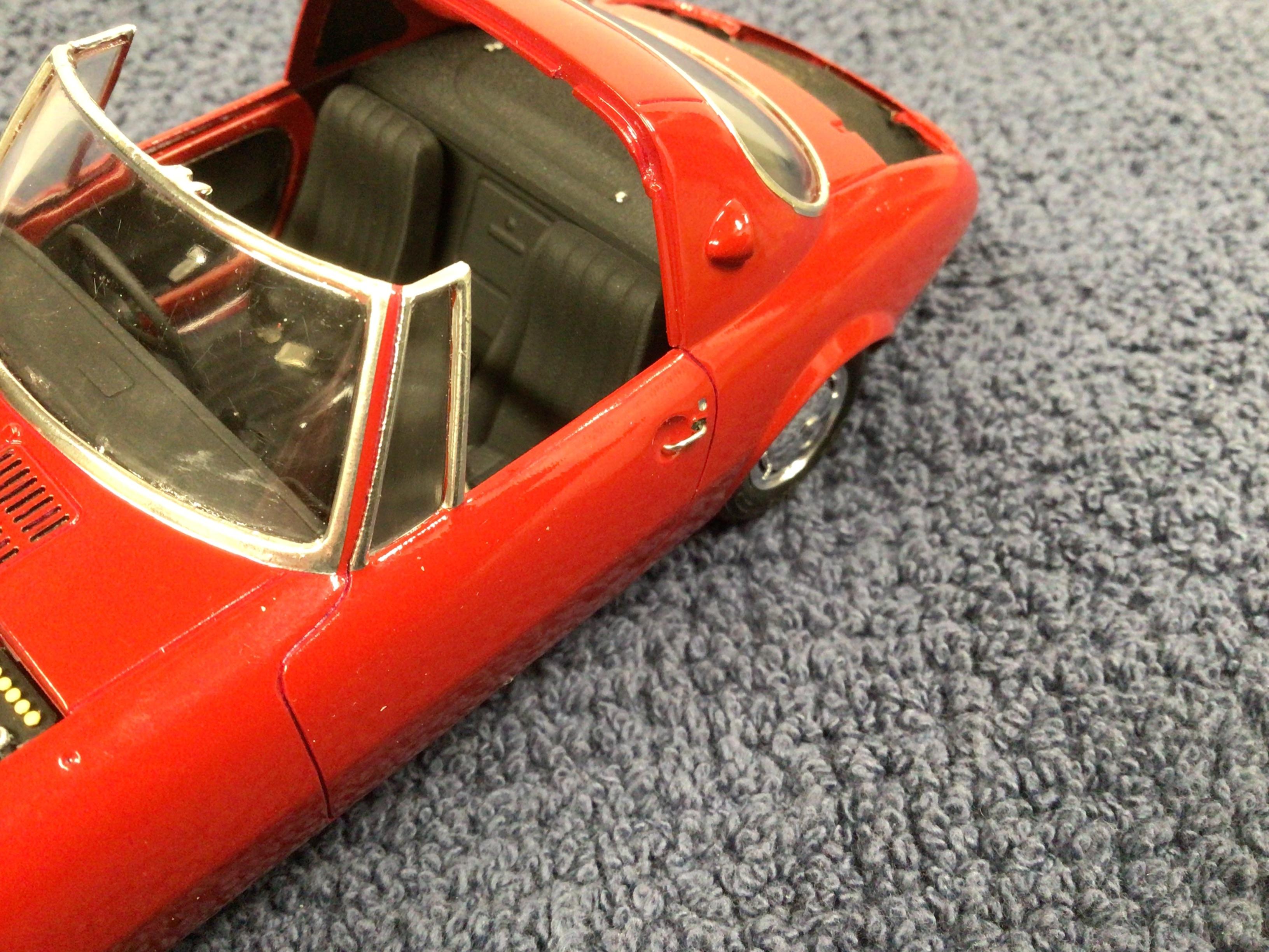

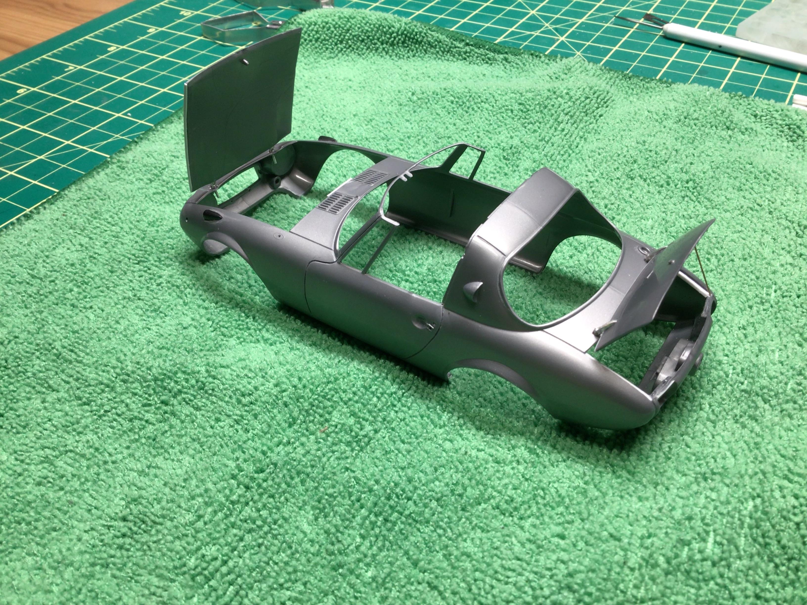

NOBLNG Posted March 29 Posted March 29 (edited) I picked this one up at the flea market for $15. It is a super tiny little vehicleโฆhere it is next to a Mazda MX-5. They are both 1/24 scale.๐ณ It was barely started thankfully so I was able to disassemble it fairly easily. I wasnโt intending to do a build thread so I donโt have a lot of progress picsโฆnot that thereโs much to seeโฆ.so fast forward, the 2cylinder flat, aircooled engine is done and the chassis is completed. The bumperettes have some wicked sink marks, so I stripped the chrome and puttied them up. Thanks for lookinโ. All comments welcome. ย ย Edited March 29 by NOBLNG 6

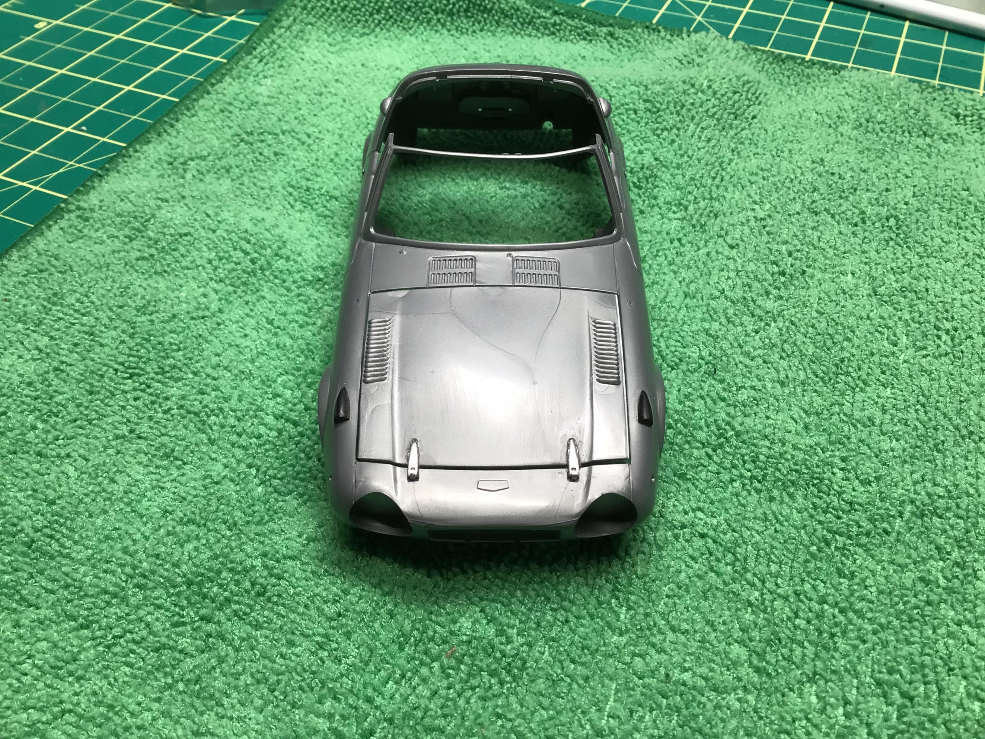

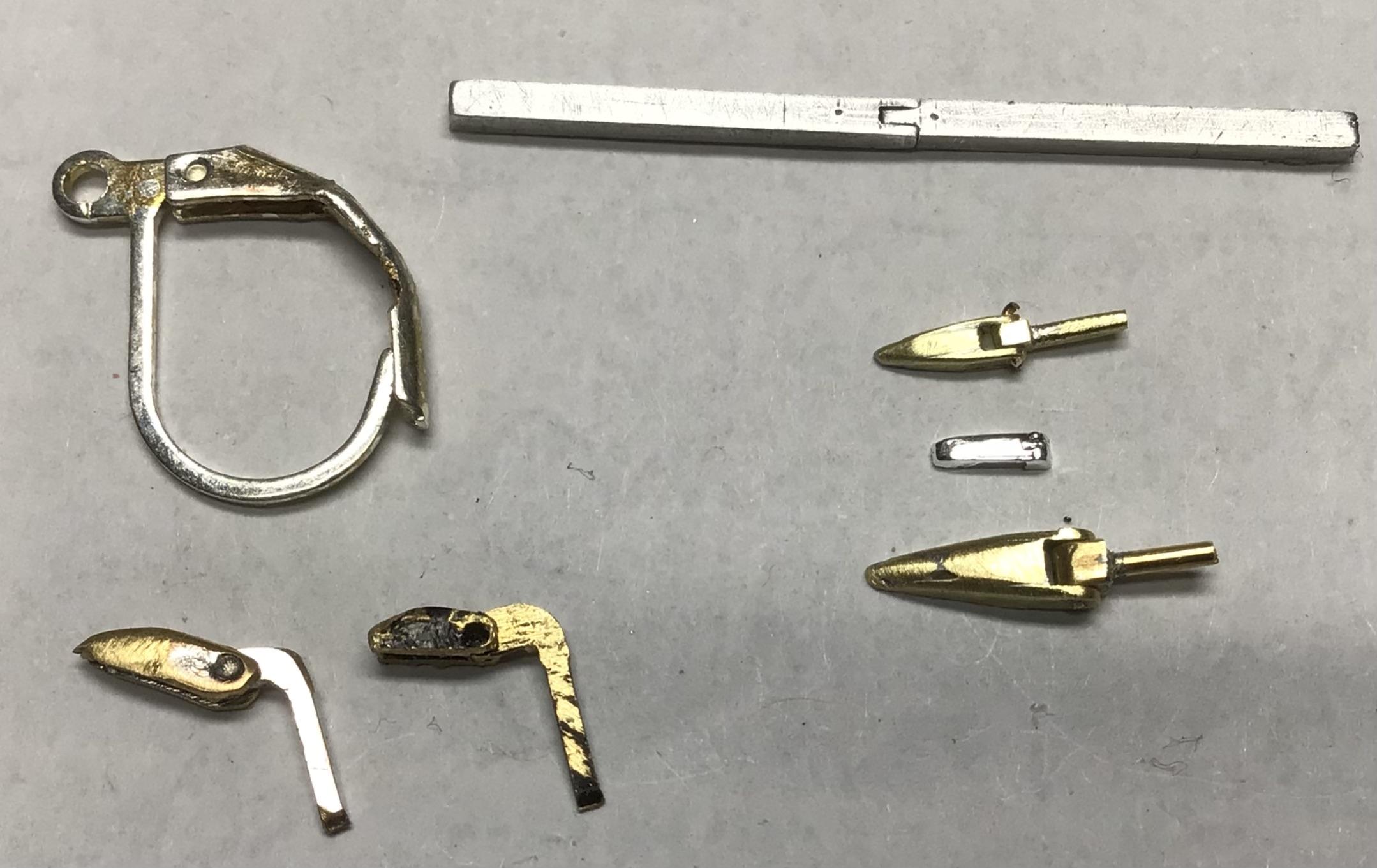

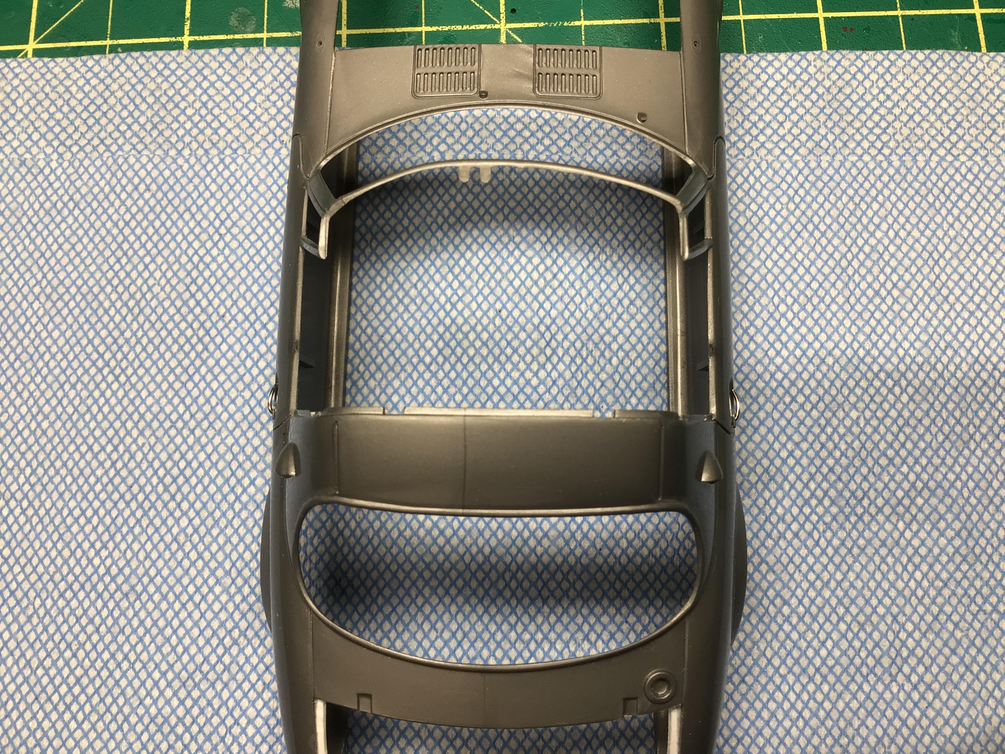

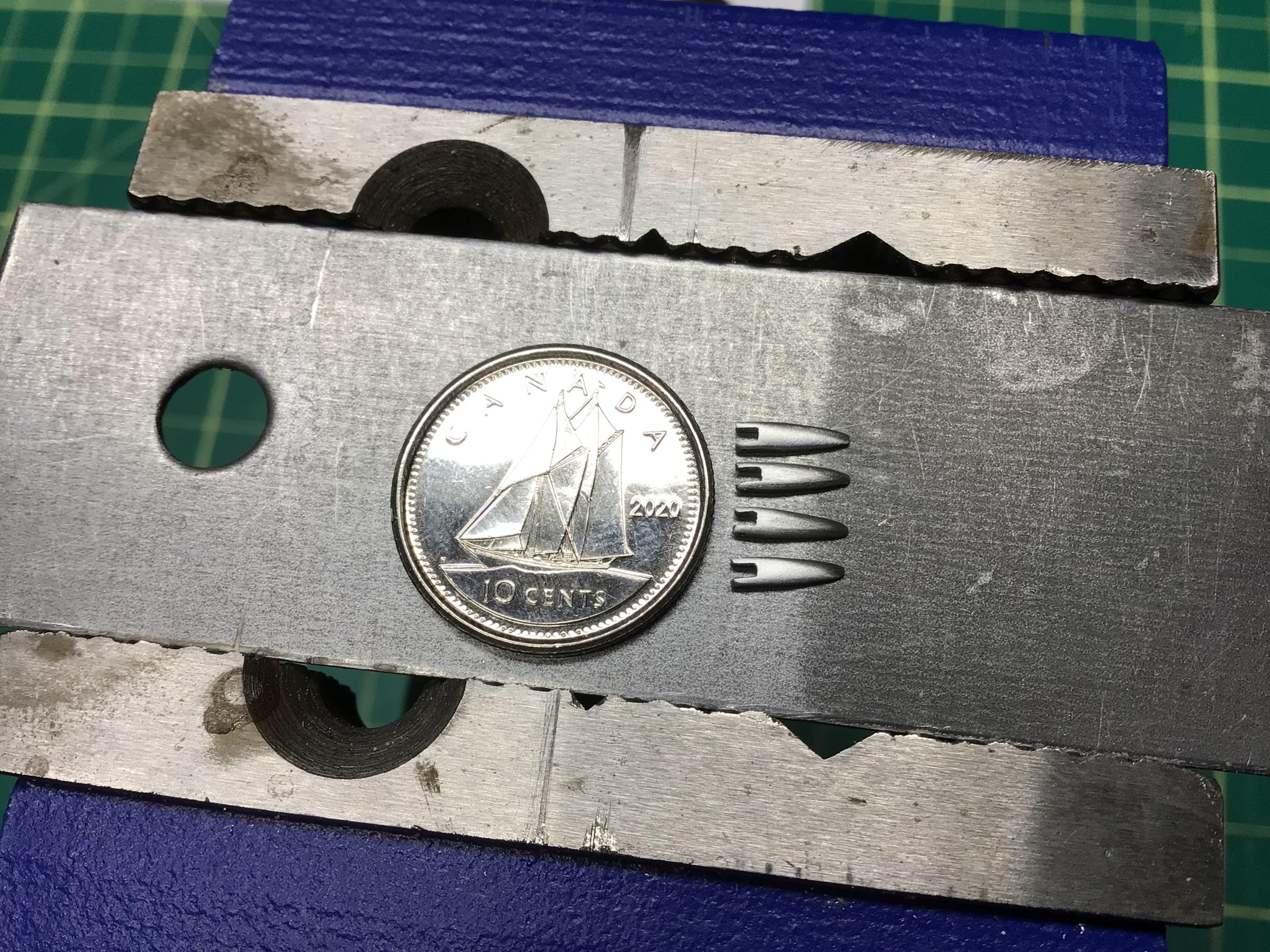

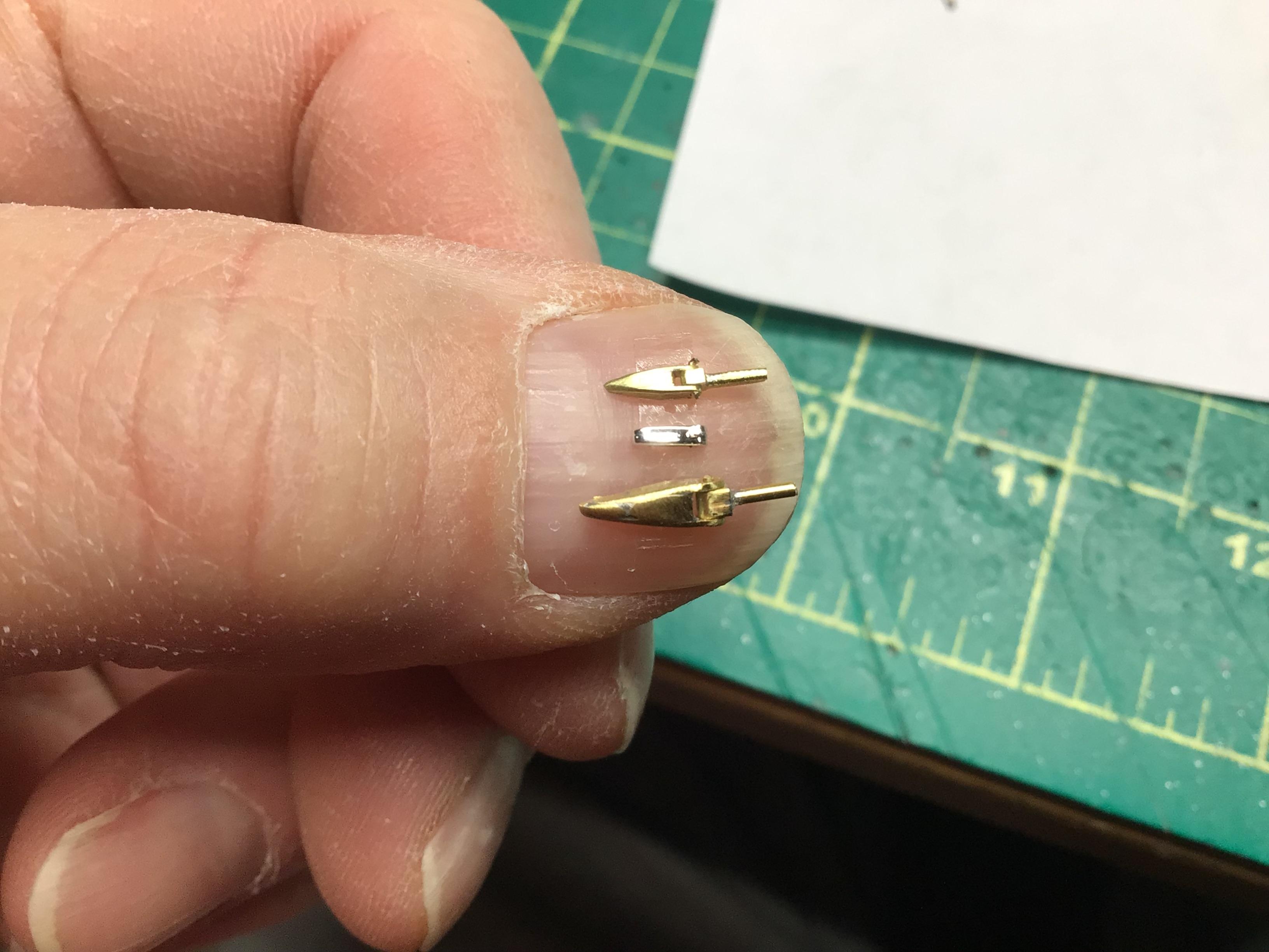

NOBLNG Posted March 29 Author Posted March 29 (edited) There is a spare tire included, and the trunk lid was only partially attached, so I cut it open and am currently obsessed with trying to make some operating hood hinges for it. I donโt like the one-piece exposed hinges that can only be attached to the hood and trunk lid. Iโve tried a number of different methods, but they are so tiny that itโs pretty difficult.๐ฌ I think I have it beat now, but I have to wait for more 0.016โ drill bits to arrive, cause Iโve snapped all of mine. I first tried using some ear ring parts from Michaels, then a couple of brass versions. This is where I lost of most of my bits.๐ Now I am working with some 0.04โx0.062โ aluminum bar. They will be a little larger than scale. But at least they will work. The little chrome thing between my brass ones is the kit piece.๐ณ ย They are delicate little things even on the 1:1. Edited April 3 by NOBLNG 6

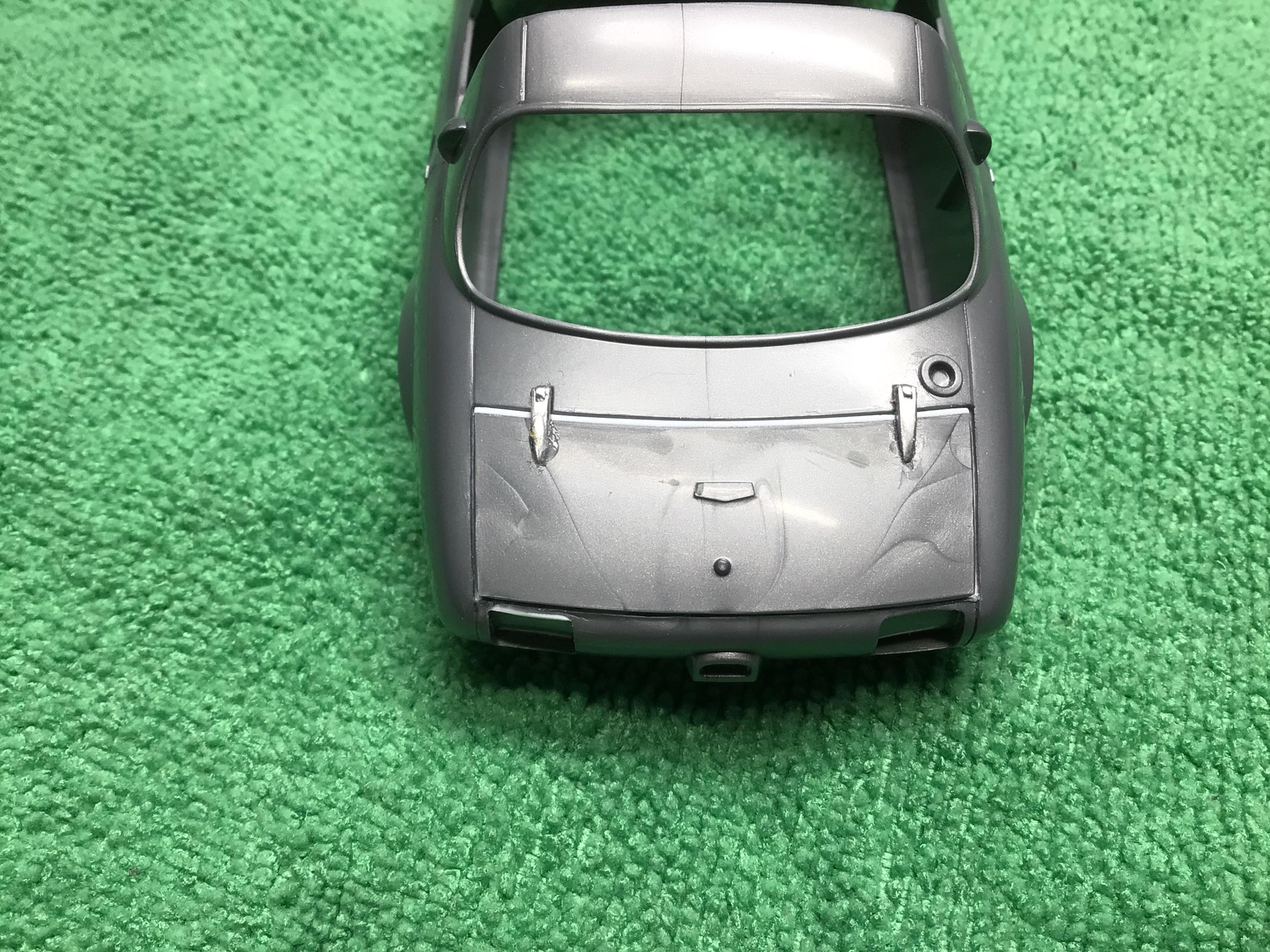

NOBLNG Posted April 1 Author Posted April 1 (edited) I had to add some 0.020โ Evergreen to the trunk lid to close the gap. And I had to fix the lip above the tail light that I broke while carving a ledge for the trunk lid to sit on. I scribed the door lines deeper. And I ground out the molded in door handles and replaced them with some 0.020โ craft wire, and drilled a divot for a door lock. ย ย Edited April 1 by NOBLNG 3

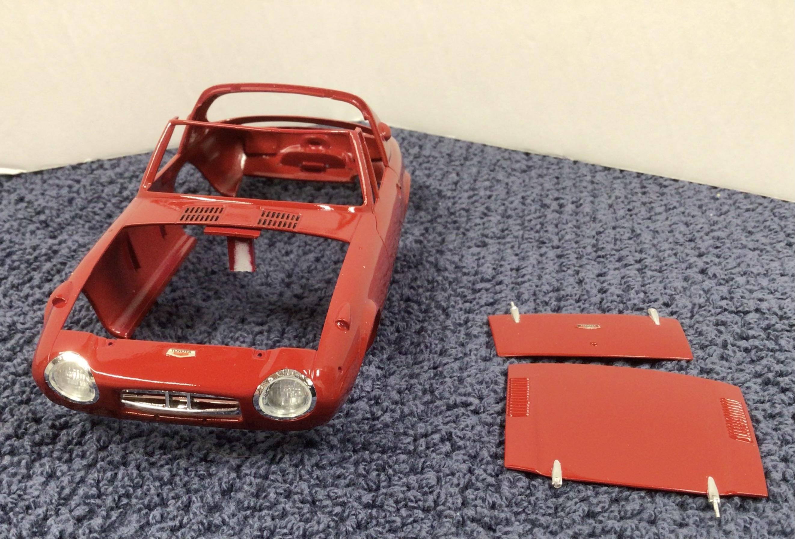

NOBLNG Posted April 5 Author Posted April 5 (edited) I didnโt like the kit hinges which I think are undersized for the recesses in the body and can only be glued to either the hood or the body. So I finally got some hinges made after trying a number of different approaches. The earring parts were just plain big and ugly! The brass ones could have worked, but it is harder to work with and drill than the aluminum that I eventually used. Plus, the brass would need to be painted or chromed whereas the aluminum can just be polished. Rather than post the entire process here, I put it in the Tips, Tricks and Tutorials section. Link here for anyone interested. https://www.modelcarsmag.com/forums/topic/199916-making-some-freaking-tiny-hinges/ I still need to clean up the excess glue. They are still removable with the hood and trunk for painting. Hopefully I can mask them or clean the paint off afterwards to have the polished aluminum look. They are a little out of scale, but I think they look better than what Fujimi gave us and I donโt have the ability or patience to make them completely accurate.๐คฏ Thanks for lookinโ.๐ Edited April 12 by NOBLNG 2

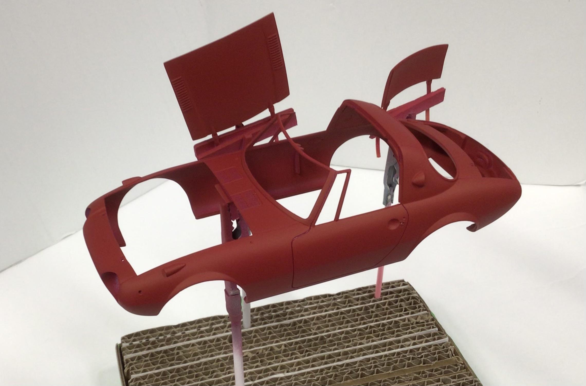

NOBLNG Posted April 9 Author Posted April 9 (edited) Thank you all guys!๐ I got a couple of blemishes on the body and around my hinge mounts fixed up well enough so got some primer on it the other day. Then yesterday I gave it a few coats of Vallejo red. I am heading out to the garage later this morning to shoot some clear on it. ย Edited April 9 by NOBLNG 2

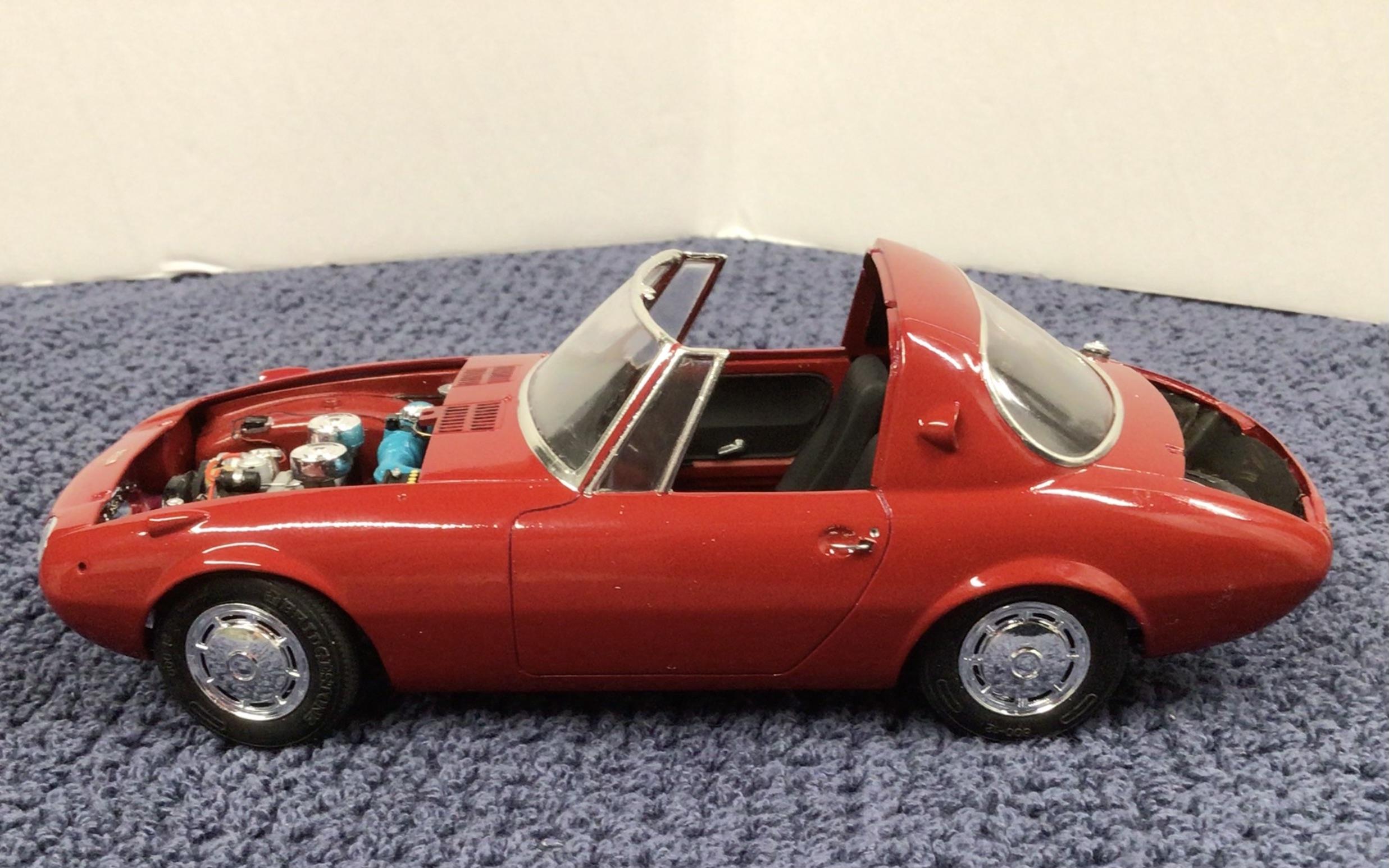

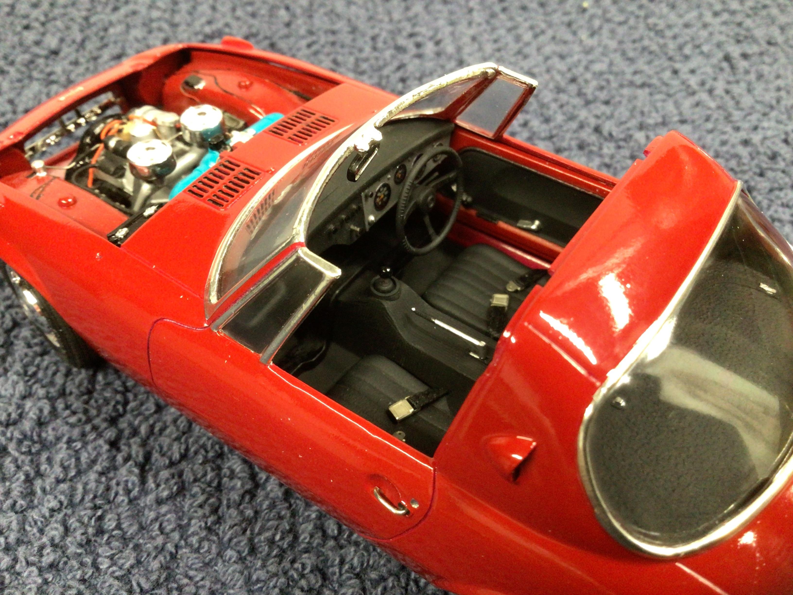

NOBLNG Posted April 11 Author Posted April 11 Amazing how a clear coat brightens up that red!๐ Behind the clear outer headlight covers Fujimi just gave us some flat chrome headlights. I had some spare clear headlight lenses so I glued them in over top of the chrome ones. I think they look a lot more realistic now. I gave ย the badge decals a few coats of microscale liquid decal film since the guage ones disintegrated on me and managed to get them on with minimal damage. 3

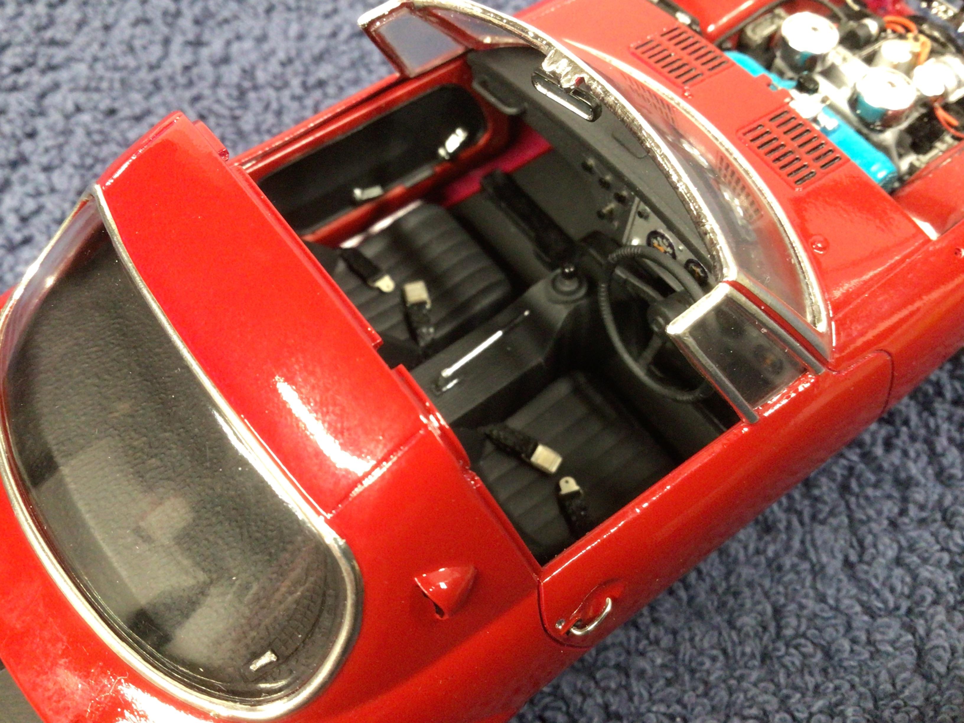

NOBLNG Posted April 11 Author Posted April 11 (edited) I got the foiling done and the body and chassis mated. I used some photo etch seat belts instead of the kit pieces. The wire door handles turned out better than I hoped.๐ ย Edited April 12 by NOBLNG 6
Belugawrx Posted April 11 Posted April 11 That looks great Greg! You've been a busy boy...is that a fully wired engine I see...?ย Lol 1
Steve H Posted April 12 Posted April 12 I agree with. Rice above ๐, youโve been busy!! Looking really good, and that clear did make a BIG difference. The wire door handles and hinges are very well done sir. 1
