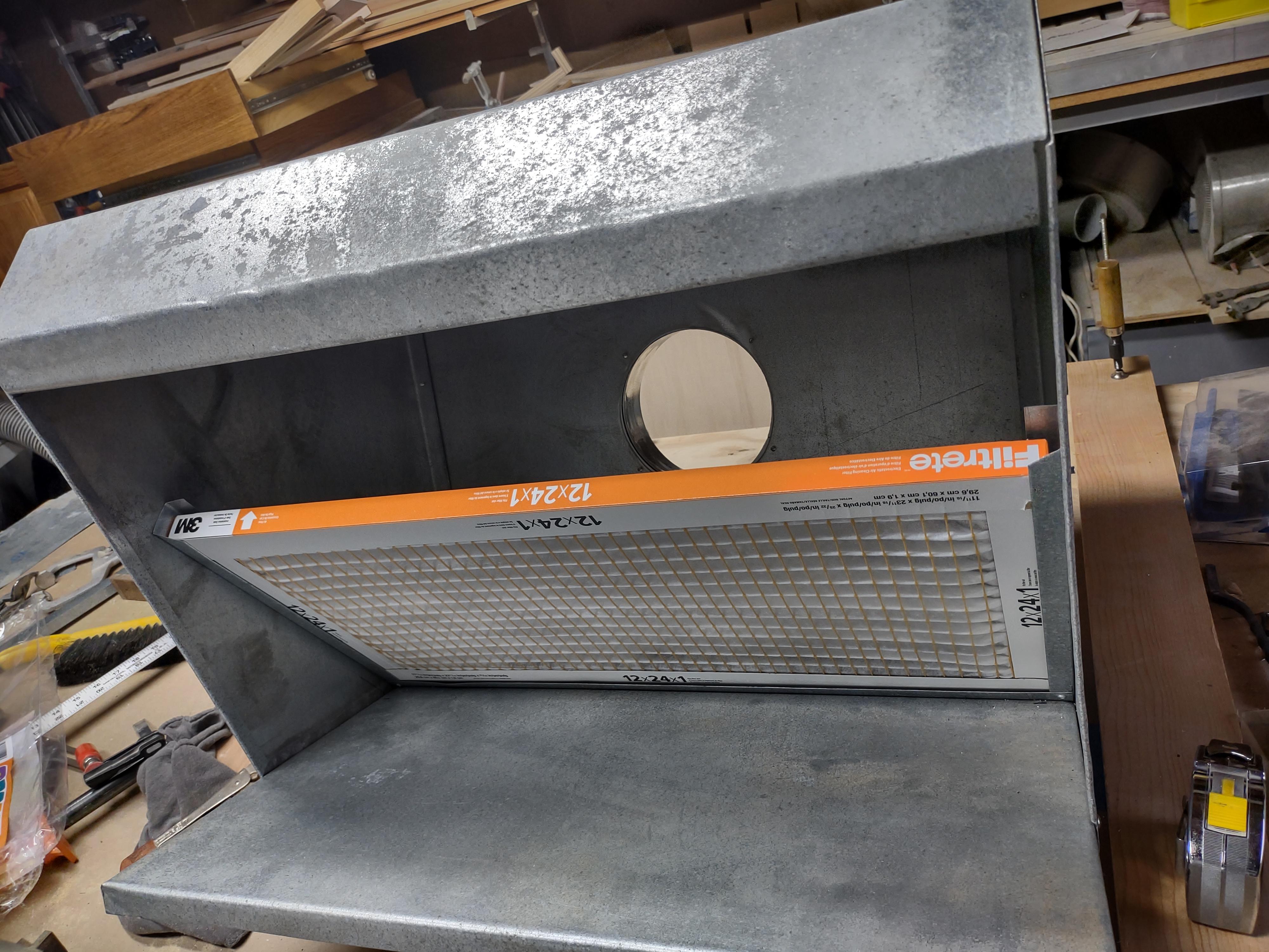

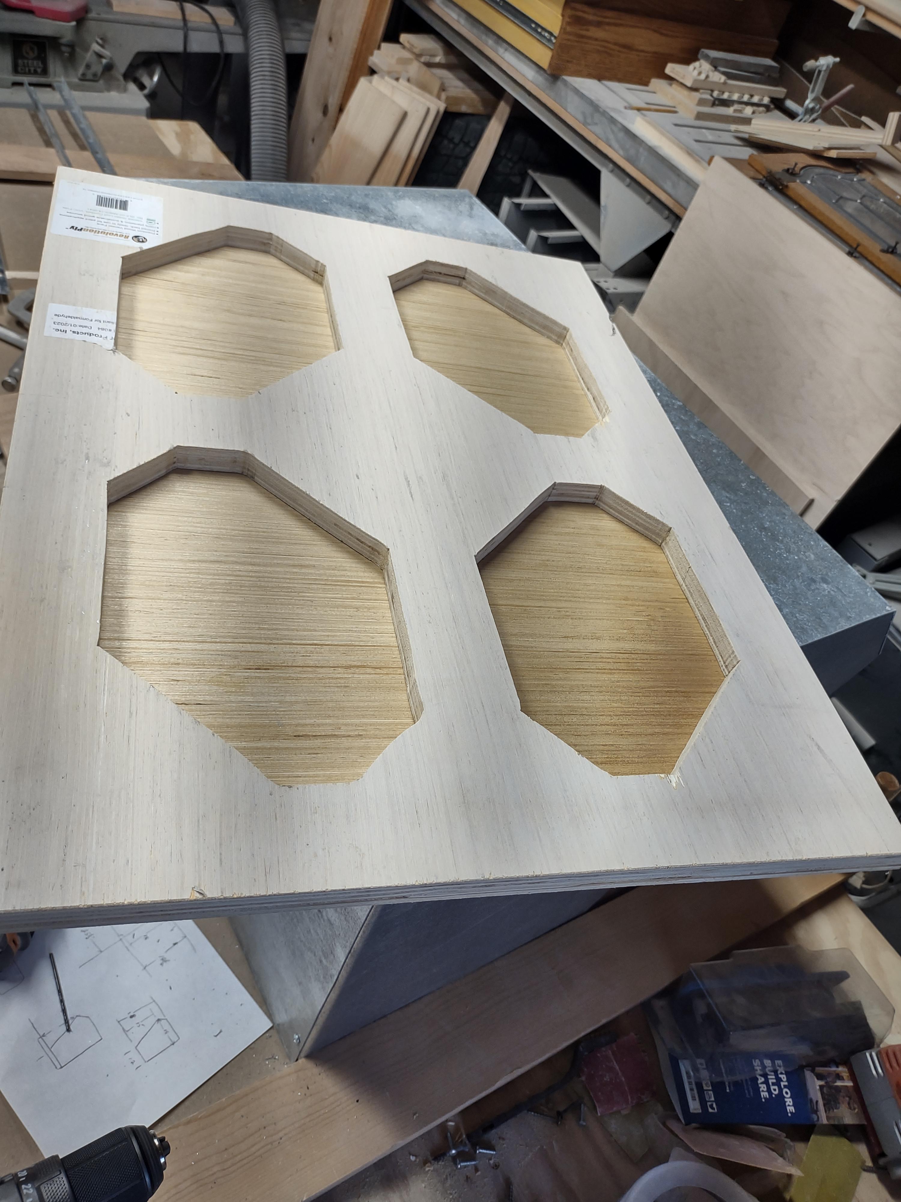

64SS350 Posted March 30 Posted March 30 Had this general plan for a long time, I have been slowly gathering materials to start. Oddly I have had the sheet metal for about 35 years! Who says saving things doesn't pay off?! Anyway, I started forming the sheet, first the base and today the sides. And yes, it will resemble a Pace brand. 5 2
64SS350 Posted March 30 Author Posted March 30 (edited) 18"x 24"x 18"high. This is the blower unit. It has a 6" inlet and a 4" outlet. Edited March 31 by 64SS350 3

64SS350 Posted April 6 Author Posted April 6 Cut out the base skeleton (not shown after excess removed) .... silicone and clamped it in place, cut the exhaust hole, and made channels for the filter. 3

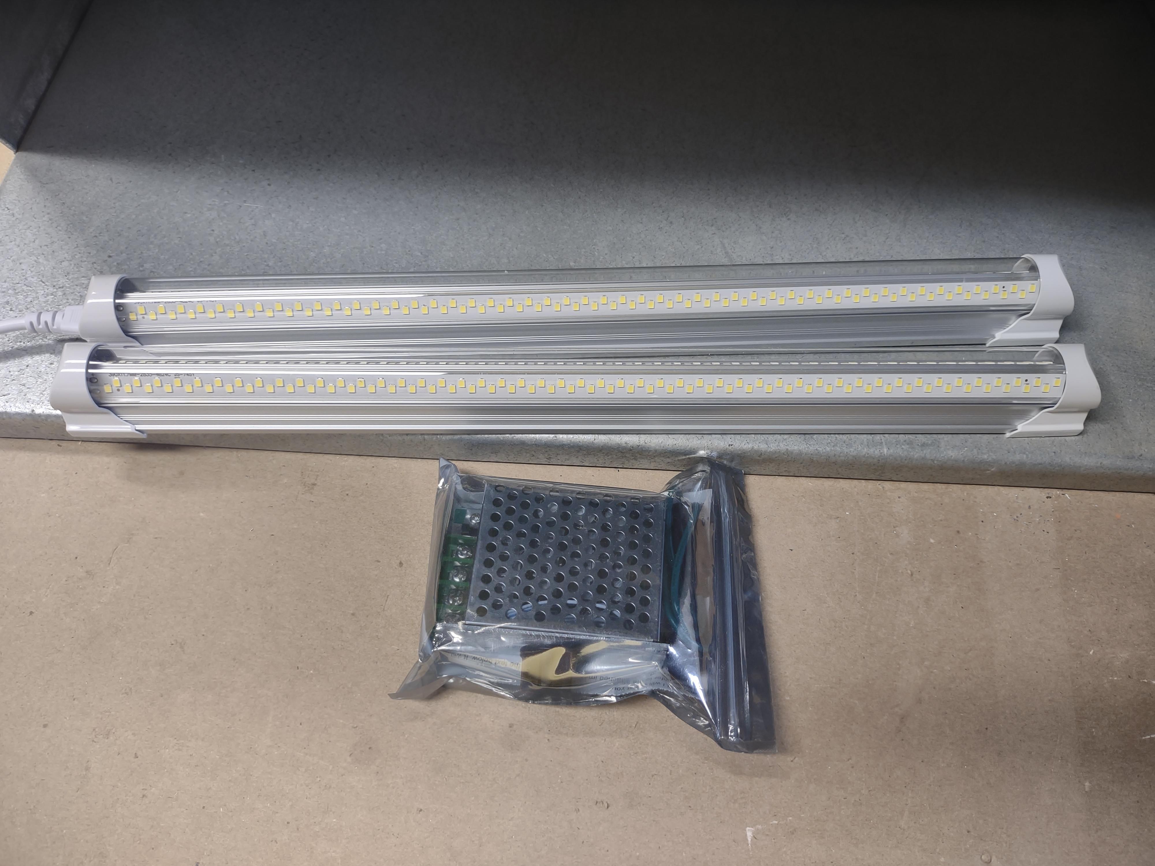

64SS350 Posted April 12 Author Posted April 12 12 hours ago, johnyrotten said: Nice work. What's the plan for lighting? I have some small tube lights from a unit I built before, or some type of LED. 1
