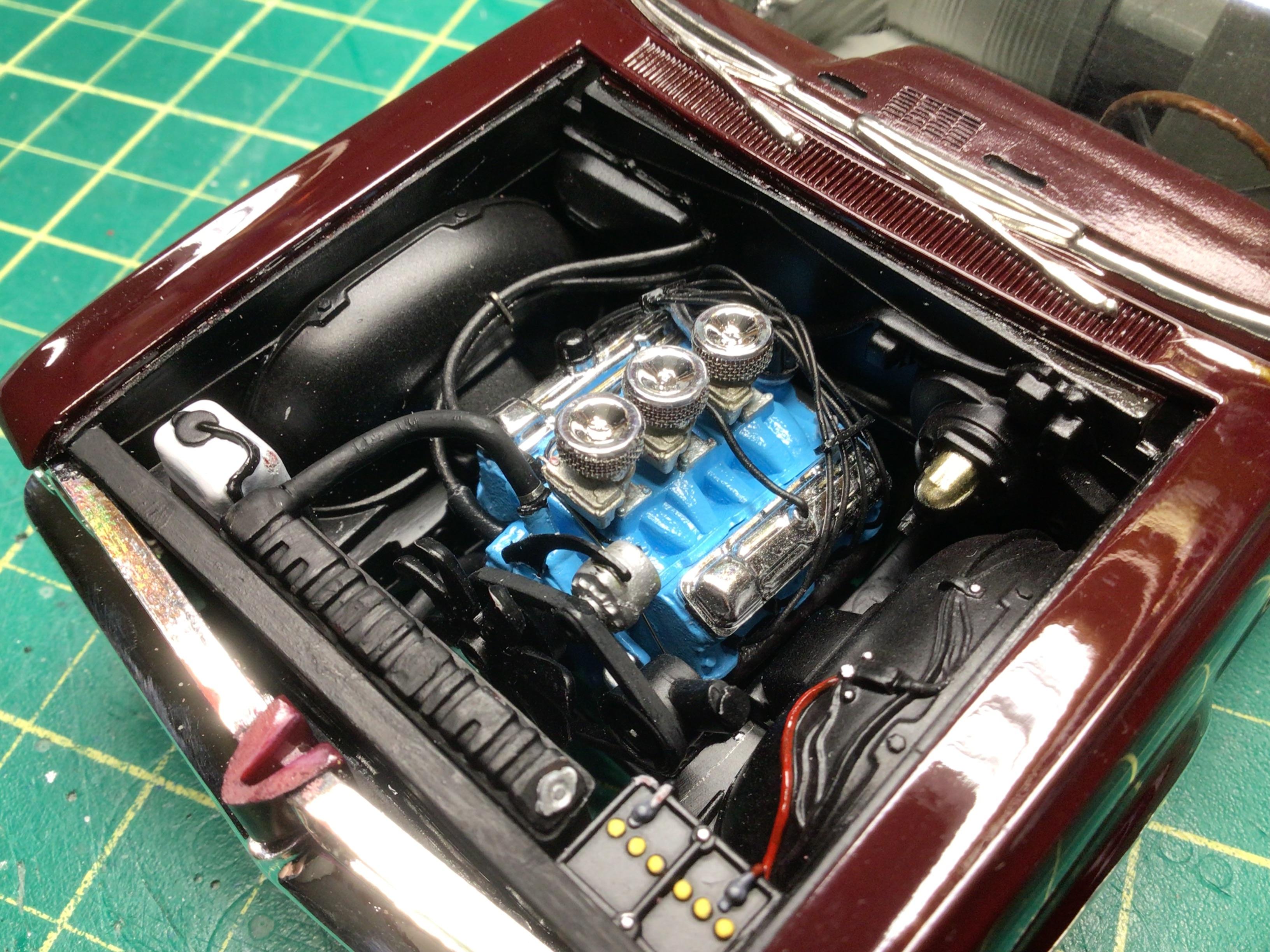

NOBLNG Posted April 3 Posted April 3 This is a 1/24 scale GTO. The plug wires are 30ga wire wrapping wire that measures 0.020” or 0.48” (1/2”approx.) in full scale. The heater hose is some unknown wire that measures 0.040” or 0.96” (1”approx.) in full scale. The plug wires are technically a tad big and the heater hose is probably very close for the common 5/8” or 3/4” hoses. I don’t think that either one looks obviously out of scale to the naked eye. A hair bigger or smaller is not going to matter unless you are entering serious contests or asking for advice on a forum.🙄 1 1

StevenGuthmiller Posted April 4 Posted April 4 On 4/3/2025 at 10:55 PM, NOBLNG said: This is a 1/24 scale GTO. The plug wires are 30ga wire wrapping wire that measures 0.020” or 0.48” (1/2”approx.) in full scale. The heater hose is some unknown wire that measures 0.040” or 0.96” (1”approx.) in full scale. The plug wires are technically a tad big and the heater hose is probably very close for the common 5/8” or 3/4” hoses. I don’t think that either one looks obviously out of scale to the naked eye. A hair bigger or smaller is not going to matter unless you are entering serious contests or asking for advice on a forum.🙄 Expand Looks good to me. Unfortunately, to Peteskis point, the majority of 1/25th scale models I see wired with 30 AWG don’t look right. I have a box of 30 in 6 different color, and it’s too big for plug wires. Works better for vacuum lines and battery cables. I suppose 30 gauge on a 1/24th would naturally look closer than on 1/25th. Steve 1

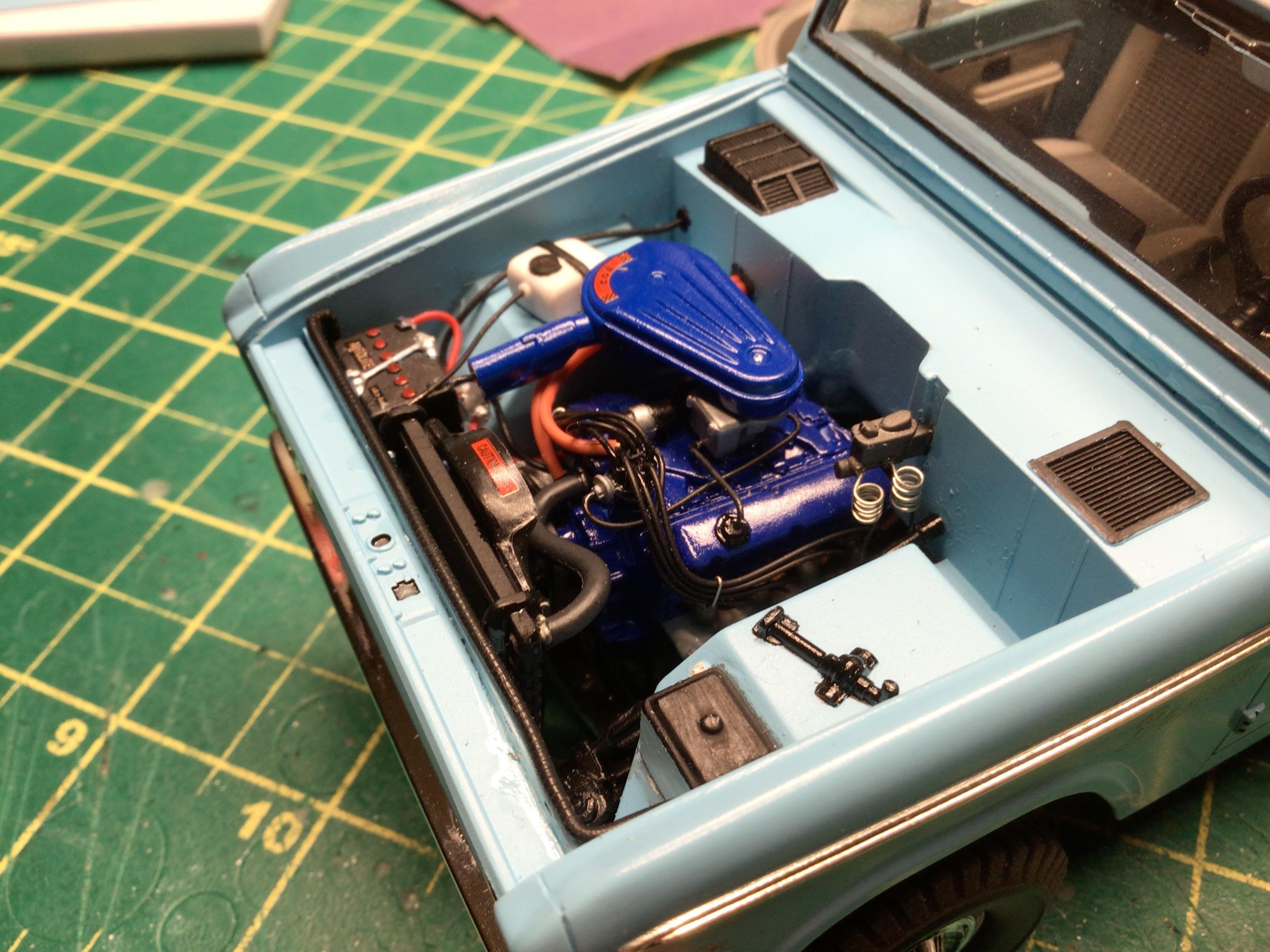

NOBLNG Posted April 4 Posted April 4 (edited) On 4/4/2025 at 2:07 AM, StevenGuthmiller said: Looks good to me. Unfortunately, to Peteskis point, the majority of 1/25th scale models I see wired with 30 AWG don’t look right. I have a box of 30 in 6 different color, and it’s too big for plug wires. Works better for vacuum lines and battery cables. I suppose 30 gauge on a 1/24th would naturally look closer than on 1/25th. Steve Expand I have used this particular brand (Jonard Tools made in USA) of wire on 1/25 models also and it still looks alright. As Pete said, the guage refers to the actual wire size. The outer diameter of the insulation can vary greatly. I also have some 30 gauge (China-something) that measures 0.025” o.d. and just looks a little too big for plug wires in my eye. And like you said, any 32 guage wire would likely look fine regardless of the insulation thickness. Here are the 0.020” wires on a 1/25 Bronco. Maybe a bit big but not glaringly so.🤷♂️ Edited April 4 by NOBLNG
