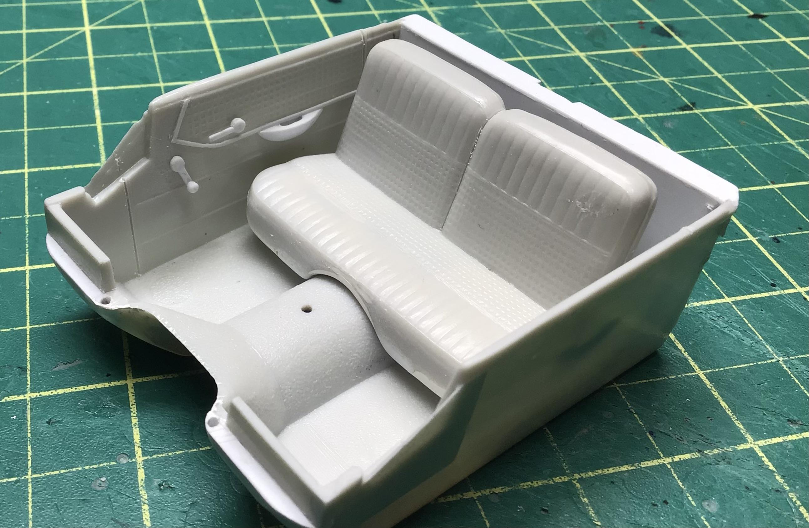

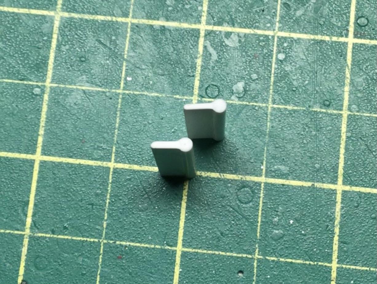

NOBLNG Posted May 5 Posted May 5 (edited) This is exactly the same process as the easy radiator cap idea. Only this time I used tamiya thin cement to “weld” a 0.16” wide strip of 0.040” Evergreen to a piece of 0.080” rod. Slice off a sliver and Voila! Add a tiny stub of 0.040” or 0.060” for a window crank. https://www.modelcarsmag.com/forums/topic/198003-easy-radiator-cap/#comment-2997190 It’s definitely better than what some kits are equipped with.🥴 Edited May 6 by NOBLNG 13 7

NOBLNG Posted May 9 Author Posted May 9 Use 0.030” for the handle part if you have it. It looks less clunky and a little more in scale than the 0.040”. 1 2

customline Posted Thursday at 12:44 AM Posted Thursday at 12:44 AM I made one today 😇. I used some .040 X .188 strip and grafted it to some .100 rod. I added a bit of 1/16" for the knob. Slicing it up can be somewhat challenging for a cranky old man but it's totally do-able, even for a space cadet. 😏 1
