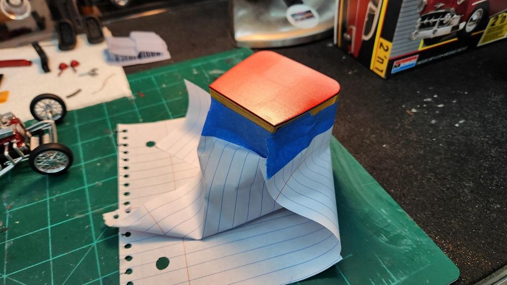

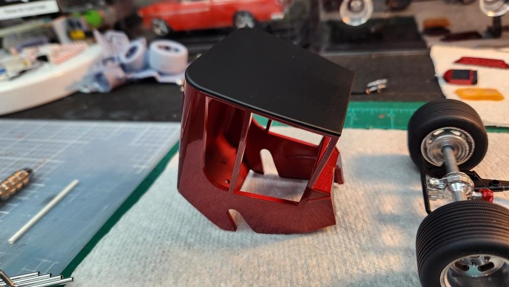

Zippi Posted Sunday at 01:38 PM Author Posted Sunday at 01:38 PM Well...this morning was the day to mask off the top and spray it Matt Black. I'm always a little Leary when it comes to masking anything off to paint. I always seem to get a little bleed under. All went well and I'm liking how it turned out. 4

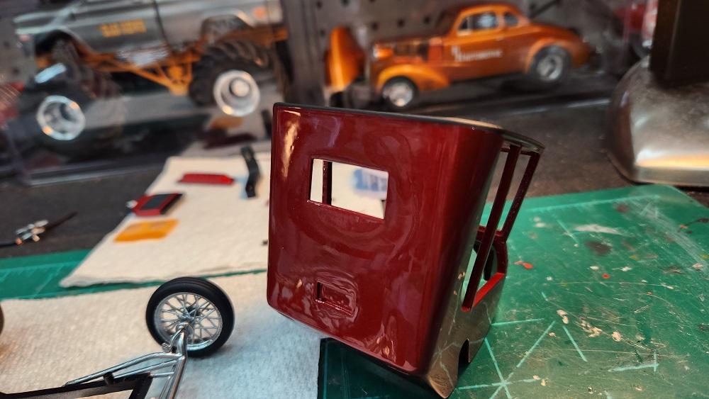

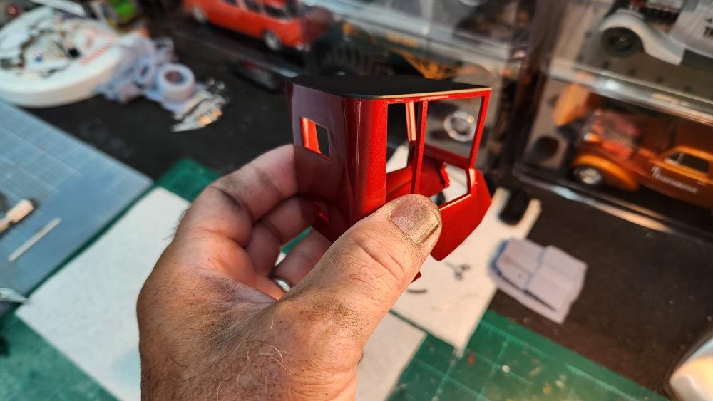

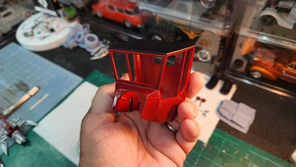

Zippi Posted Sunday at 02:31 PM Author Posted Sunday at 02:31 PM (edited) I'm starting to see the light at the end of the tunnel. Engine has been wired, top painted, and headlight buckets painted but still need to be foiled. Can't wait for that. Still have to cut the front and rear glass and the water pump has been pinned but still needs to be glued to the timing chain cover. Edited Sunday at 02:33 PM by Zippi 2
espo Posted Sunday at 03:45 PM Posted Sunday at 03:45 PM Great looking paint color and a very smooth finish.
Zippi Posted Sunday at 04:25 PM Author Posted Sunday at 04:25 PM 40 minutes ago, espo said: Great looking paint color and a very smooth finish. Thanks David.

iamsuperdan Posted Tuesday at 02:15 PM Posted Tuesday at 02:15 PM On 7/6/2025 at 7:38 AM, Zippi said: Well...this morning was the day to mask off the top and spray it Matt Black. I'm always a little Leary when it comes to masking anything off to paint. I always seem to get a little bleed under. All went well and I'm liking how it turned out. I had that issue a lot too. Here's what I do now. I spray my base colour, so in your example, the red. Then I mask, then I spray a thin coat of the base colour again. That way, if I get any bleed through, it's the base colour. Then I spray my second colour. Seems to be working so far.
Zippi Posted yesterday at 08:46 PM Author Posted yesterday at 08:46 PM On 7/8/2025 at 9:15 AM, iamsuperdan said: I had that issue a lot too. Here's what I do now. I spray my base colour, so in your example, the red. Then I mask, then I spray a thin coat of the base colour again. That way, if I get any bleed through, it's the base colour. Then I spray my second colour. Seems to be working so far. Thanks man. I appreciate the tip.
