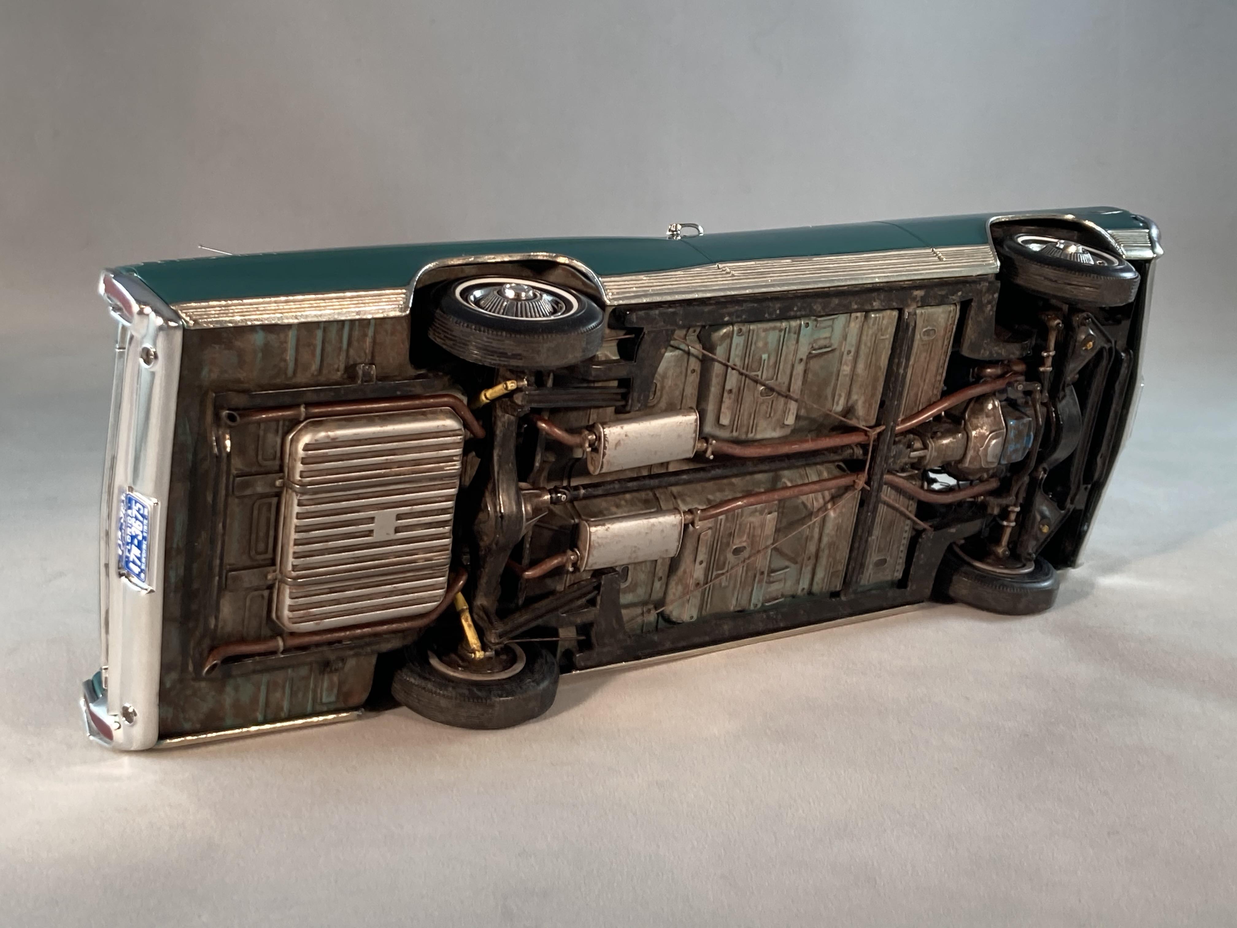

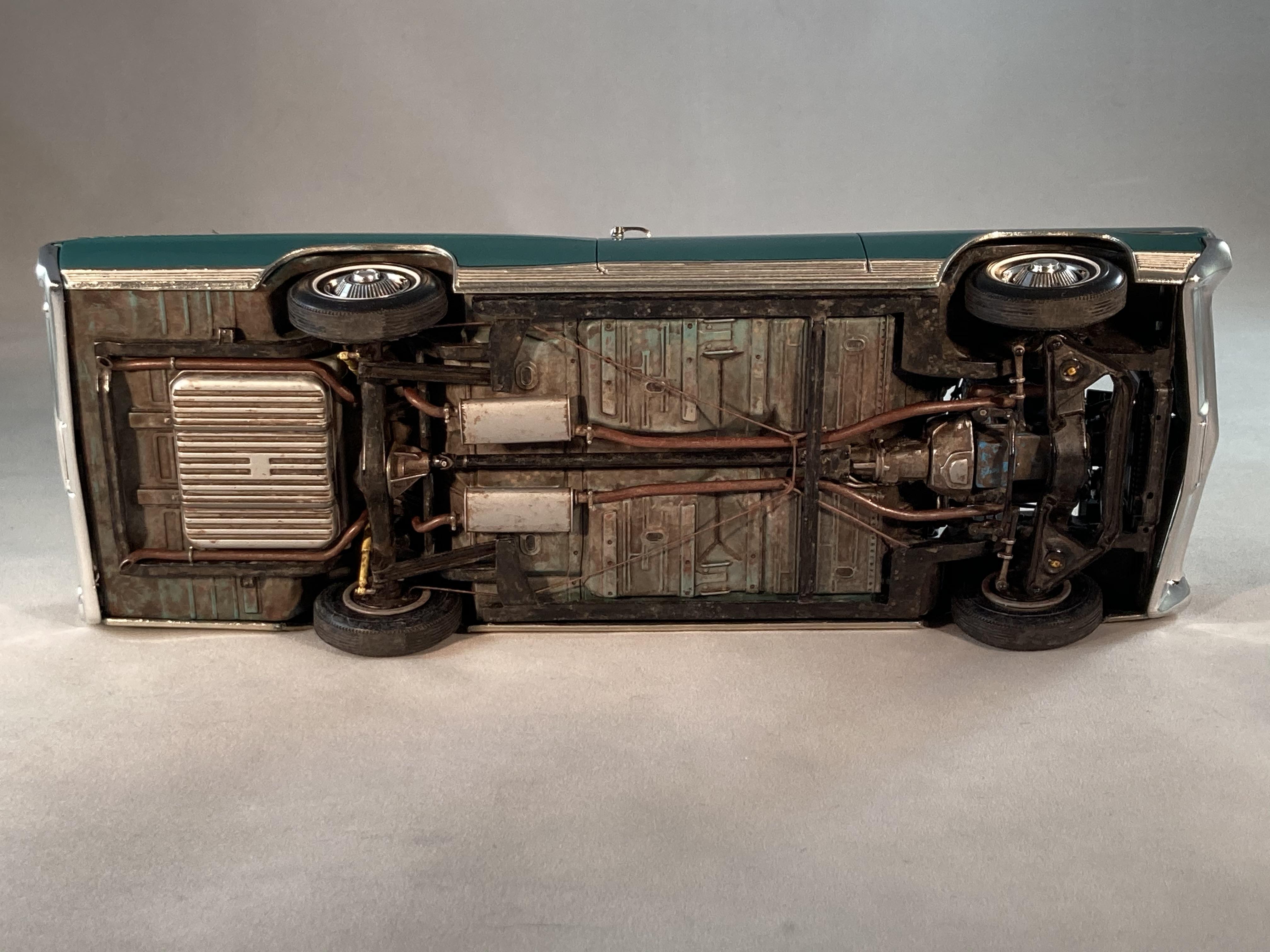

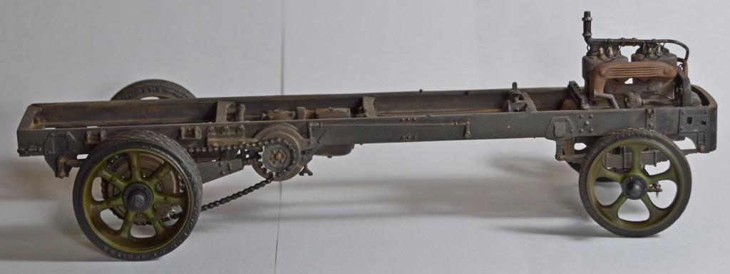

StevenGuthmiller Posted Wednesday at 02:56 AM Posted Wednesday at 02:56 AM Well, I’m certainly no expert on weathering. I’ve never weathered a military model, model railroad or diorama. I’ve only done some basic weathering on a few chassis and engines using nothing more than acrylic craft paints, but I’ve been pleased with the results, and I didn’t have to go out and buy a couple hundred dollars worth of materials that I may or may not ever use again. I did this chassis with 3 colors of cheapo acrylic craft paint that I probably paid less than $5.00 for. Steve 4

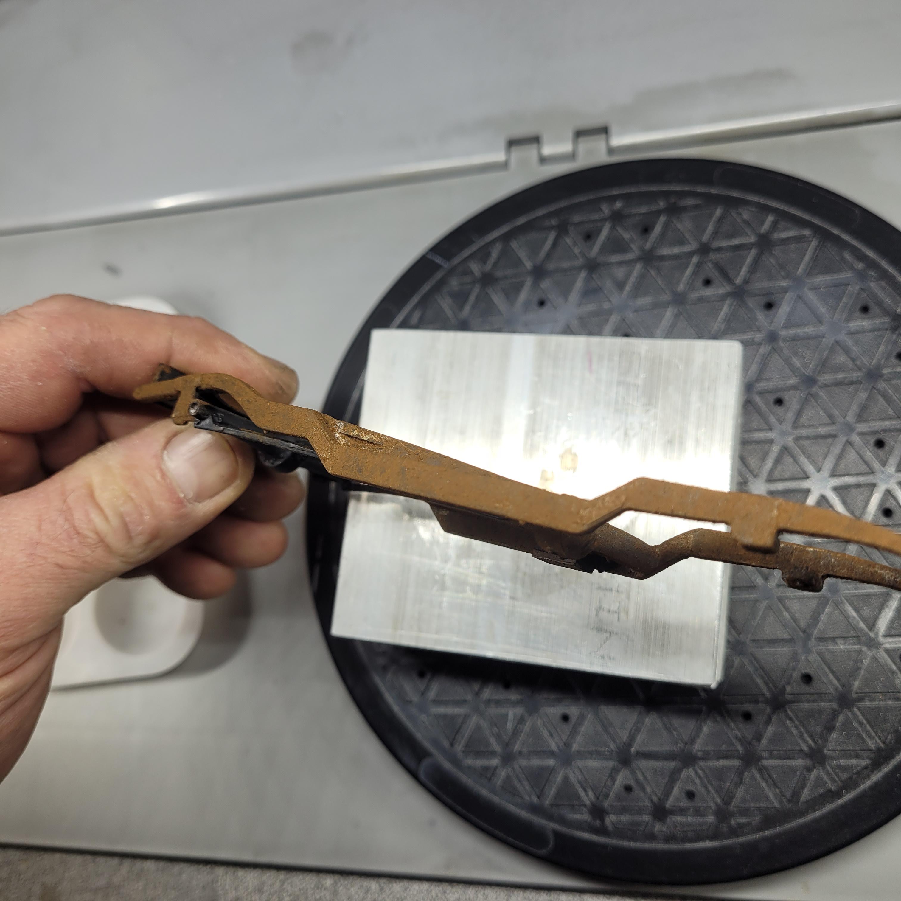

johnyrotten Posted Wednesday at 12:16 PM Posted Wednesday at 12:16 PM Craft paints work great for weathering, as do artist chalks. Washes,dry brushing and all the other techniques are all fun just to experiment with. This is actual rust ,ground fine and "glued" with createx 4030, before and after paint pictures 5
JerseeJerry55 Posted Wednesday at 12:17 PM Author Posted Wednesday at 12:17 PM 9 hours ago, StevenGuthmiller said: Well, I’m certainly no expert on weathering. I’ve never weathered a military model, model railroad or diorama. I’ve only done some basic weathering on a few chassis and engines using nothing more than acrylic craft paints, but I’ve been pleased with the results, and I didn’t have to go out and buy a couple hundred dollars worth of materials that I may or may not ever use again. I did this chassis with 3 colors of cheapo acrylic craft paint that I probably paid less than $5.00 for. Steve Wow that looks awesome Steve. That's what I am going after. I've got Acrylic crafts paint in Black, and a number of different shades of Brown. Also some other colors. Thanks for sharing the pics.

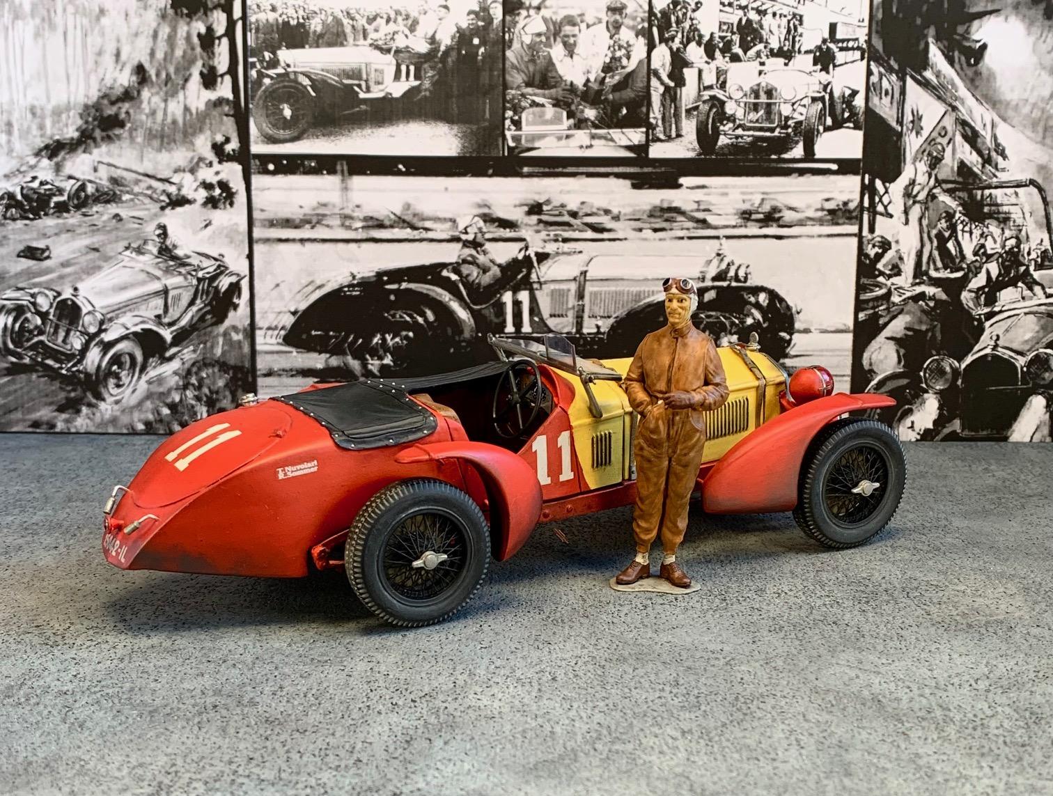

Pierre Rivard Posted Wednesday at 12:19 PM Posted Wednesday at 12:19 PM Hi Jerry, there are many methods for weathering and some of them spectacular but difficult to achieve. I am moderately skilled and I love weathering but keeping it simple is a must for me. I use Vallejo washes (rust and oiled earth colors), acrylic paints and Vallejo pigments (Light yellow ochre, dark steel) I find weathering works best over a non glossy finish so I first apply a flat clear. On the Alfa (and the figurine) I used an oiled earth wash and then dry brushed dark pigments in areas to show racing grime and the lighter pigments on the tires. On the rusty floor pan I started with a gray foundation, then dabbed rust colored acrylics with a small sponge, there a rust wash. The materials I use dry fast and are easy to use. 5
JerseeJerry55 Posted Wednesday at 12:21 PM Author Posted Wednesday at 12:21 PM 1 minute ago, johnyrotten said: Craft paints work great for weathering, as do artist chalks. Washes,dry brushing and all the other techniques are all fun just to experiment with. This is actual rust ,ground fine and "glued" with createx 4030, before and after paint pictures WOW I like that. I think for my intents and purposes the areas that I would really "muddy up the waters" on are engine (done), frame, under the fuel tanks, under the cab, exhaust pipes, stacks, mud flaps, the fifth wheel, and of course the wheels.
JerseeJerry55 Posted Wednesday at 12:26 PM Author Posted Wednesday at 12:26 PM 2 minutes ago, Pierre Rivard said: Hi Jerry, there are many methods for weathering and some of them spectacular but difficult to achieve. I am moderately skilled and I love weathering but keeping it simple is a must for me. I use Vallejo washes (rust and oiled earth colors), acrylic paints and Vallejo pigments (Light yellow ochre, dark steel) I find weathering works best over a non glossy finish so I first apply a flat clear. On the Alfa (and the figurine) I used an oiled earth wash and then dry brushed dark pigments in areas to show racing grime and the lighter pigments on the tires. On the rusty floor pan I started with a gray foundation, then dabbed rust colored acrylics with a small sponge, there a rust wash. The materials I use dry fast and are easy to use. Pierre very cool I like your techniques. Simple is probably always the best. I have been trying weathering for a few years on past projects (usually the Revell Snap Peterbilt 359 truck cab. Concentrating on the Caterpillar Engine with a black wash, and the frame. I stand my belief that grime has no conscience. It just goes, and flows where it wants. Thanks for sharing. 1

StevenGuthmiller Posted Wednesday at 05:28 PM Posted Wednesday at 05:28 PM 4 hours ago, mcs1056 said: OK. You can't leave us newbies hanging. What colors, and a litle technique guidance, please. I mixed my own colors from a few different basic colors of craft paint to emulate 3 basic layers of grunge that I was looking for. Oily brown: (just dark brown and black) Rust: (brown with a little red) Road grime: (this is purely subjective and can vary a lot by your particular region, but I just used a little light tan) I started by mixing the colors and then thinning them to a wash consistency. Then, beginning with the oily brown, I washed over the parts. While the paint was still wet, I lightly "rolled" over the parts with a Q-tip to create a mottled affect, and then after the wash had dried somewhat, I used lightly dampened Q-tips to "roll" over the parts again to remove some of the paint in some areas. The key is to remember that there is basically no right or wrong look. It's weathering and is supposed to look haphazard. After the oily brown, I continued in more of a dry brush fashion with the rust, (trying to focus more on areas where you might find light rust) and the road grime, (again, in areas most likely to exhibit it) By a dry brush fashion I mean by dipping the brush in the paint and then rolling the brush over a paper towel to wick away most of the paint leaving almost no paint on the brush, and then using a dabbing motion to "stipple" the paint onto the model. Then again, using dampened Q-tips to dab and roll on the surface to "mute" the sharpness of the stippled paint, (if that makes any sense. ) Finally, I did another "dry brush" application, (as described above with the rust and road grime) with the oily brown. I used these same techniques and materials on the engine, focusing more on the underside of the engine and leaving the top side a bit cleaner. Oddly enough, the craft paint does a pretty good job of mimicking texture as well when applied in layers. Steve 3 1
