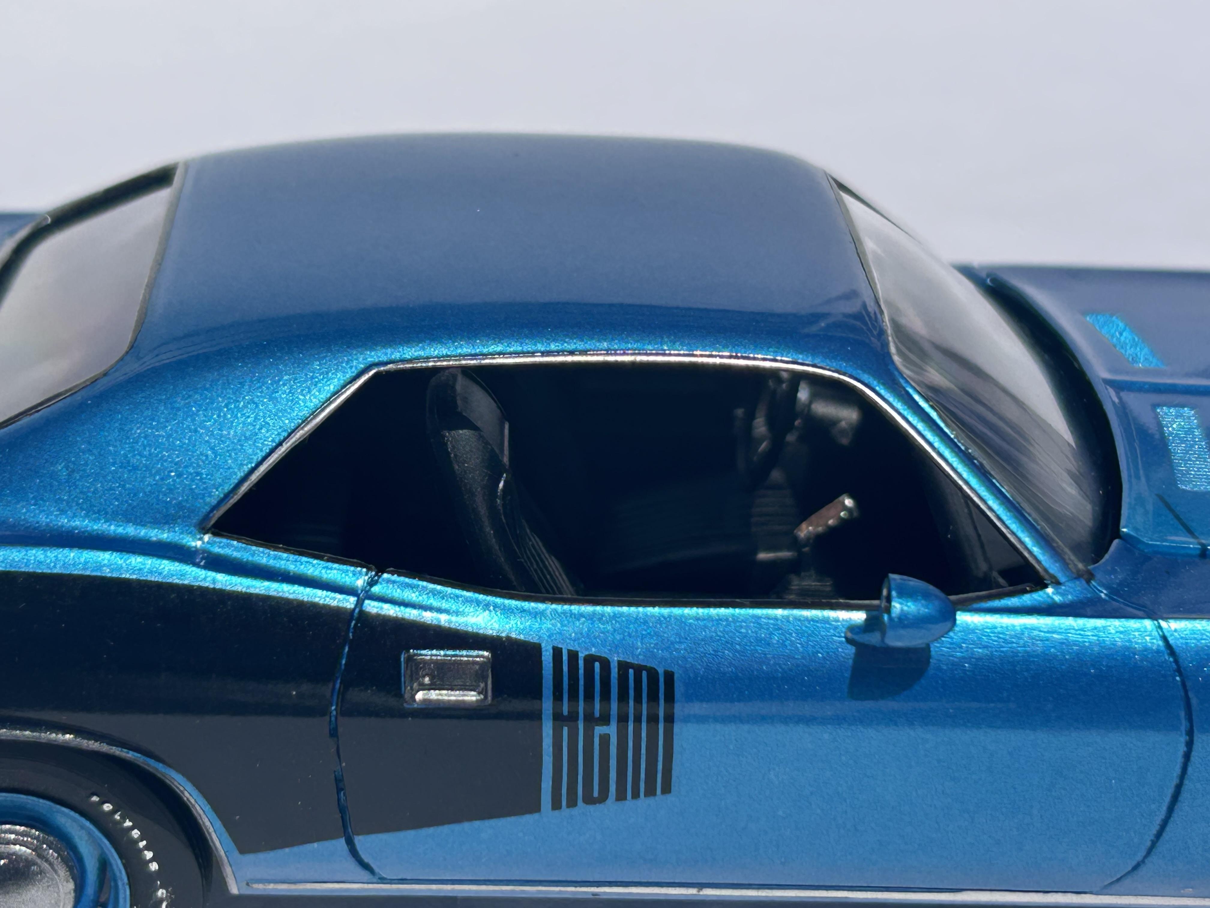

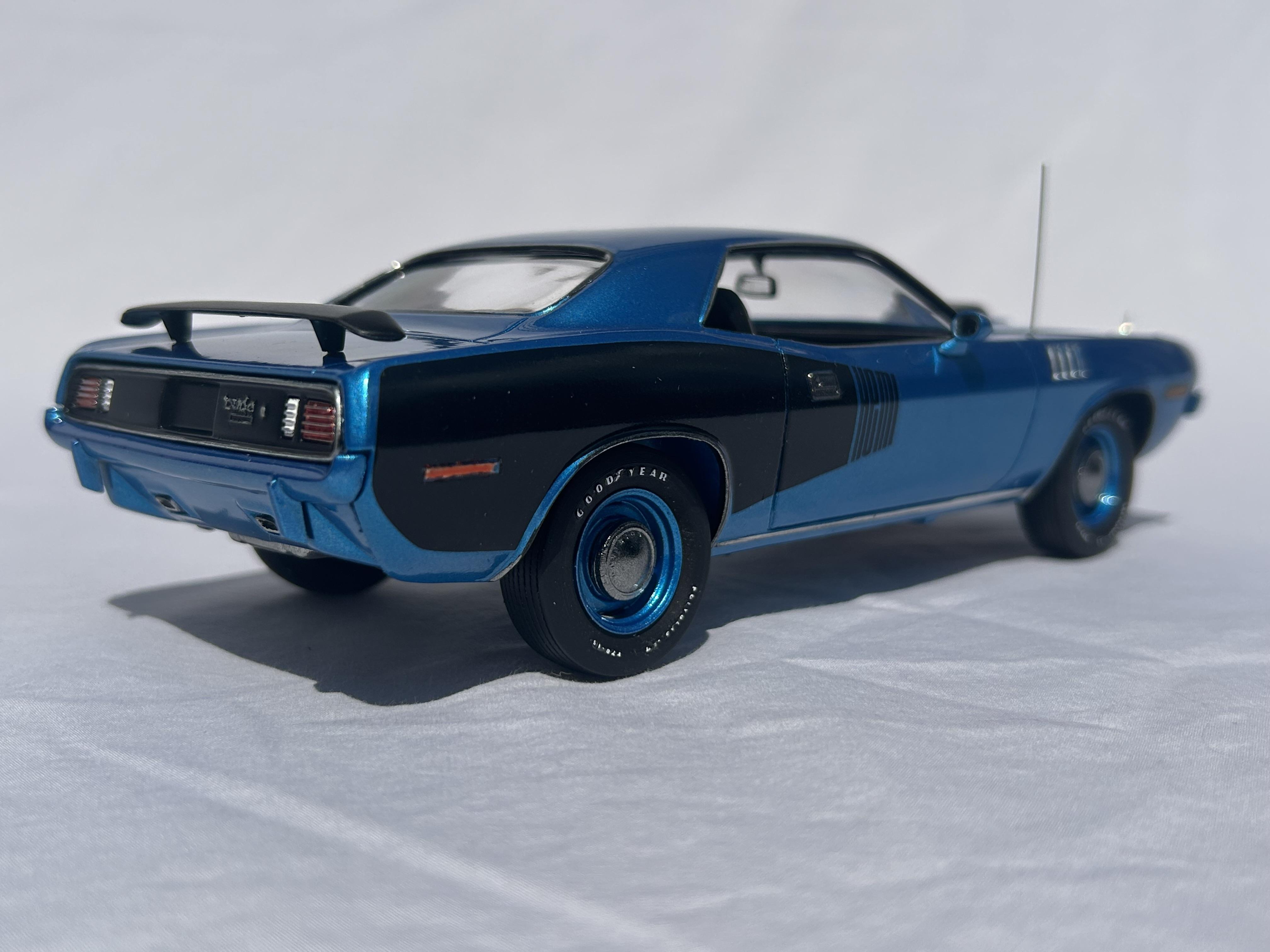

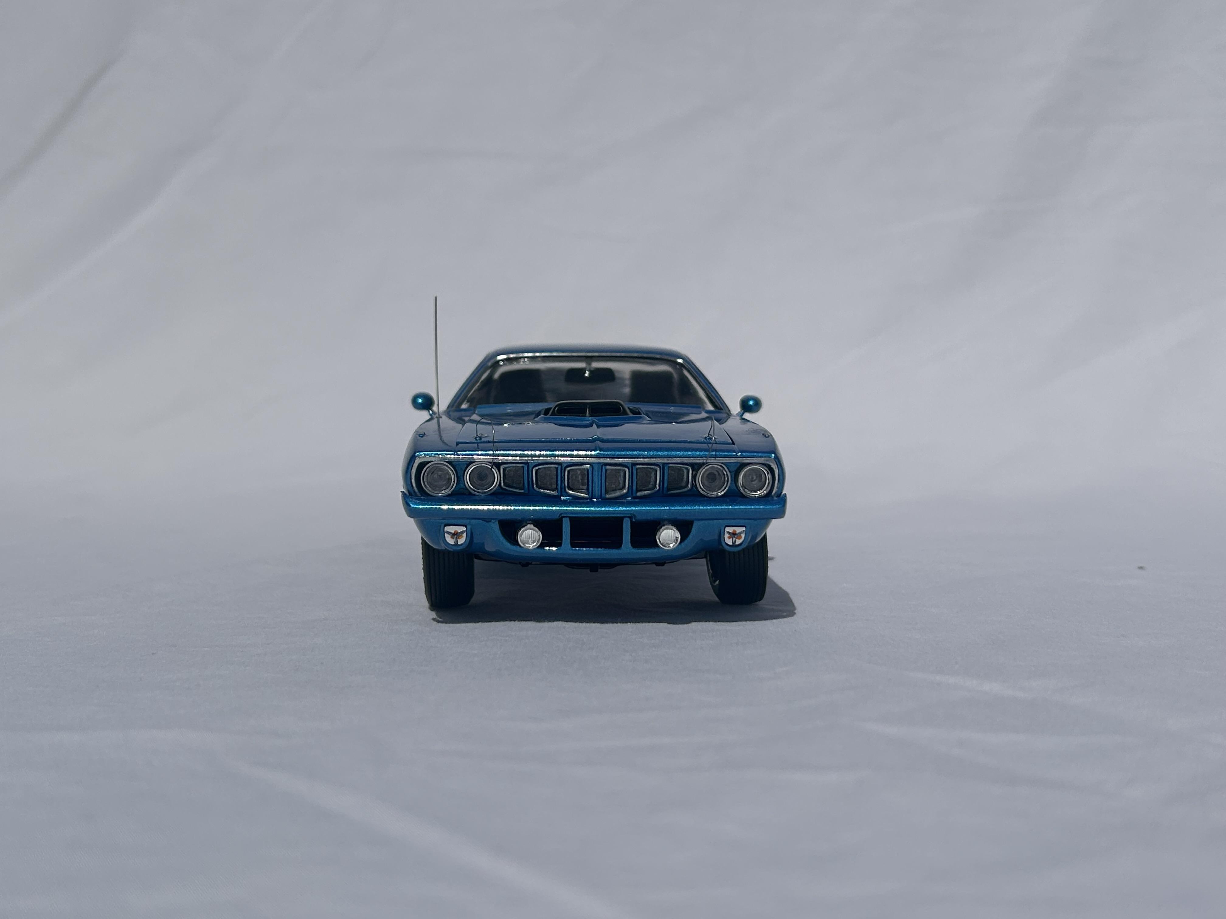

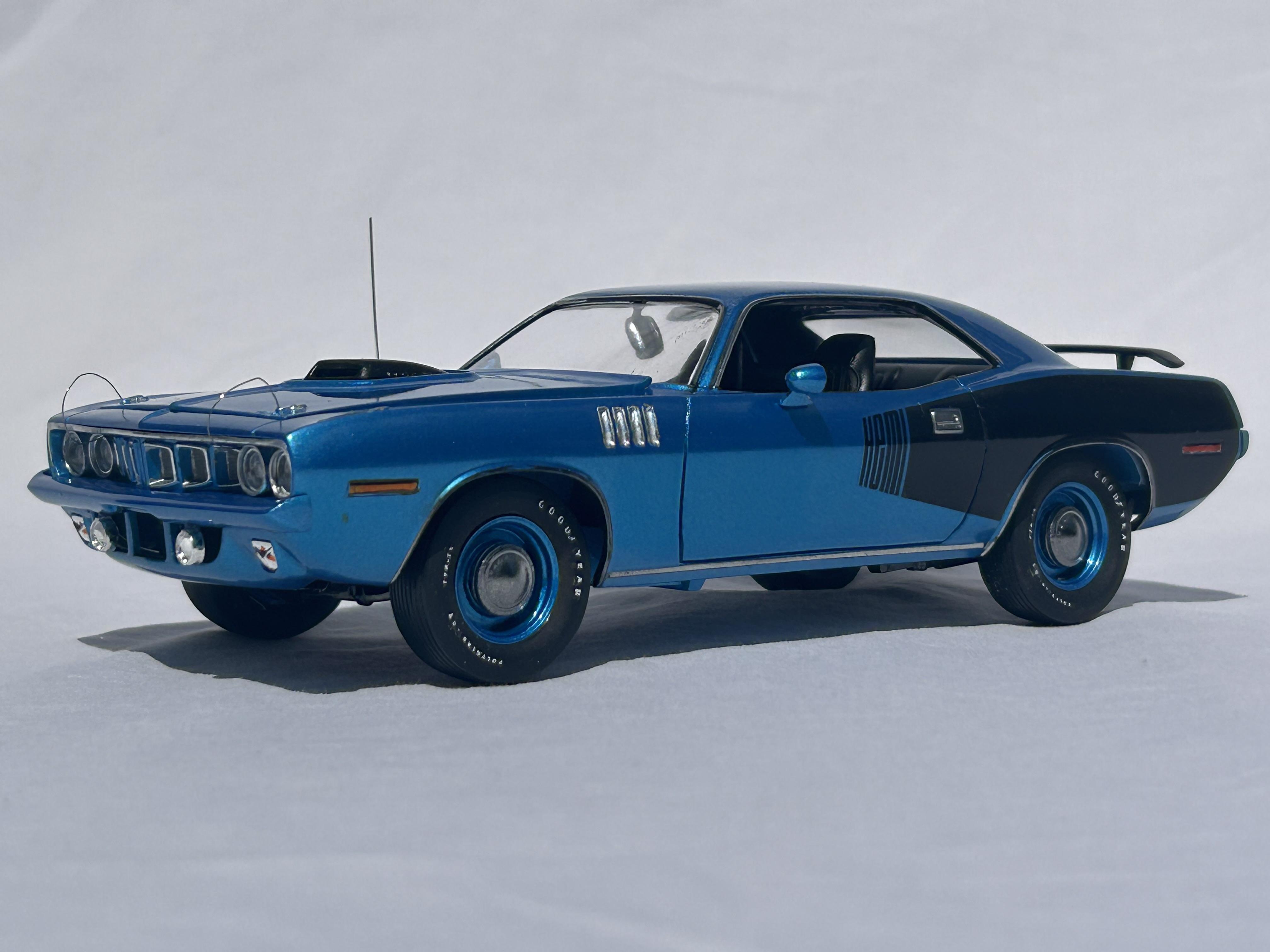

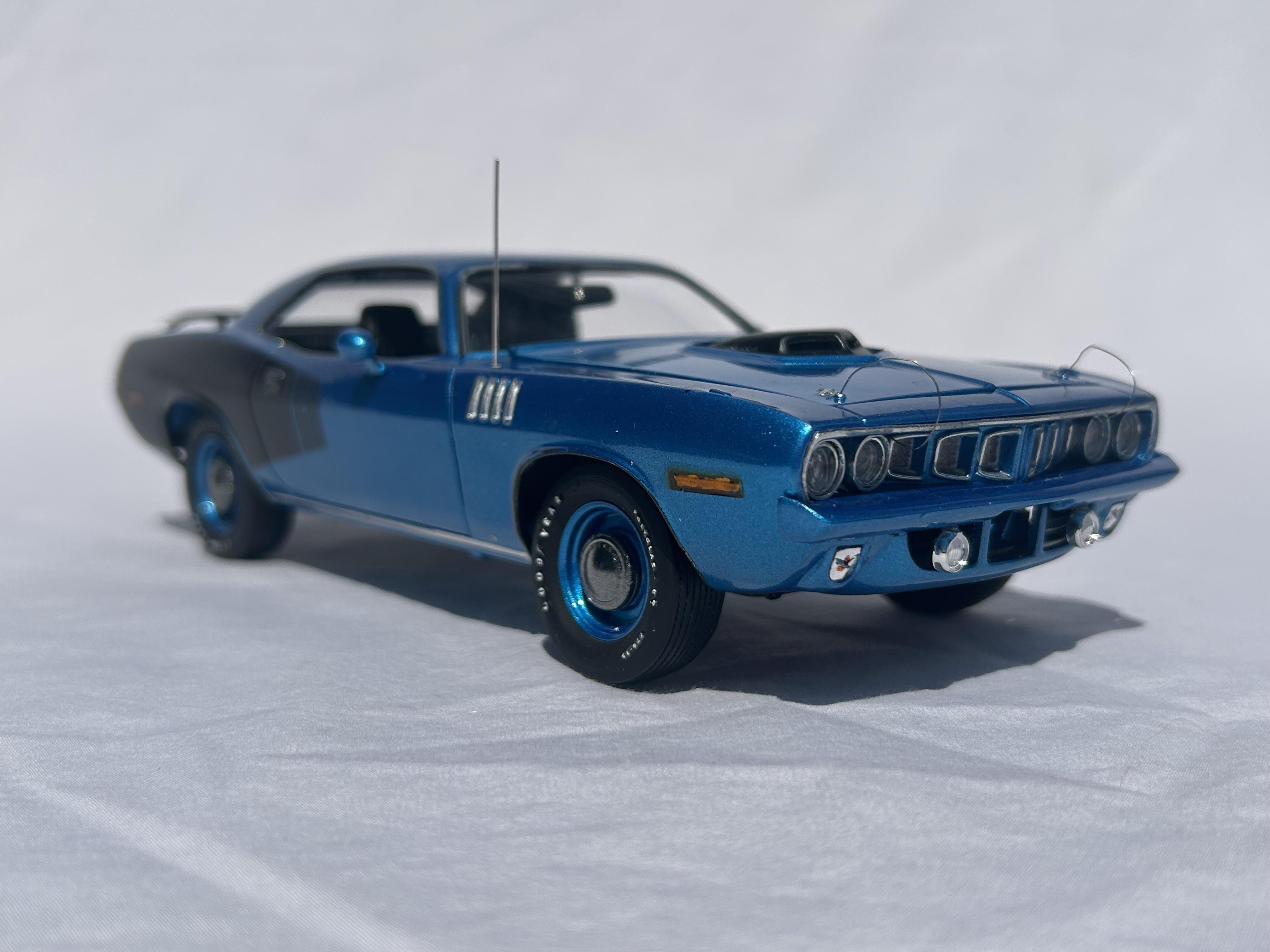

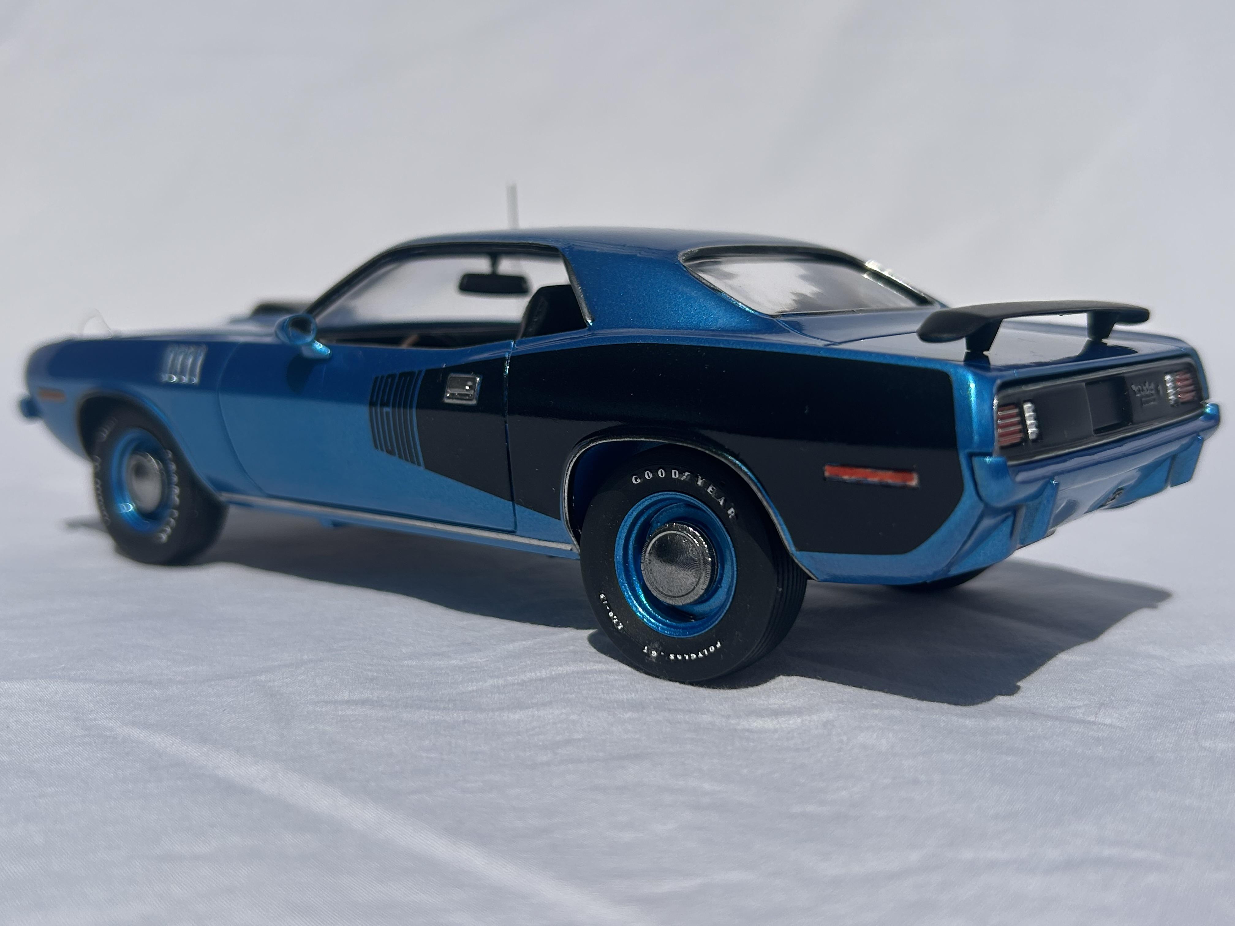

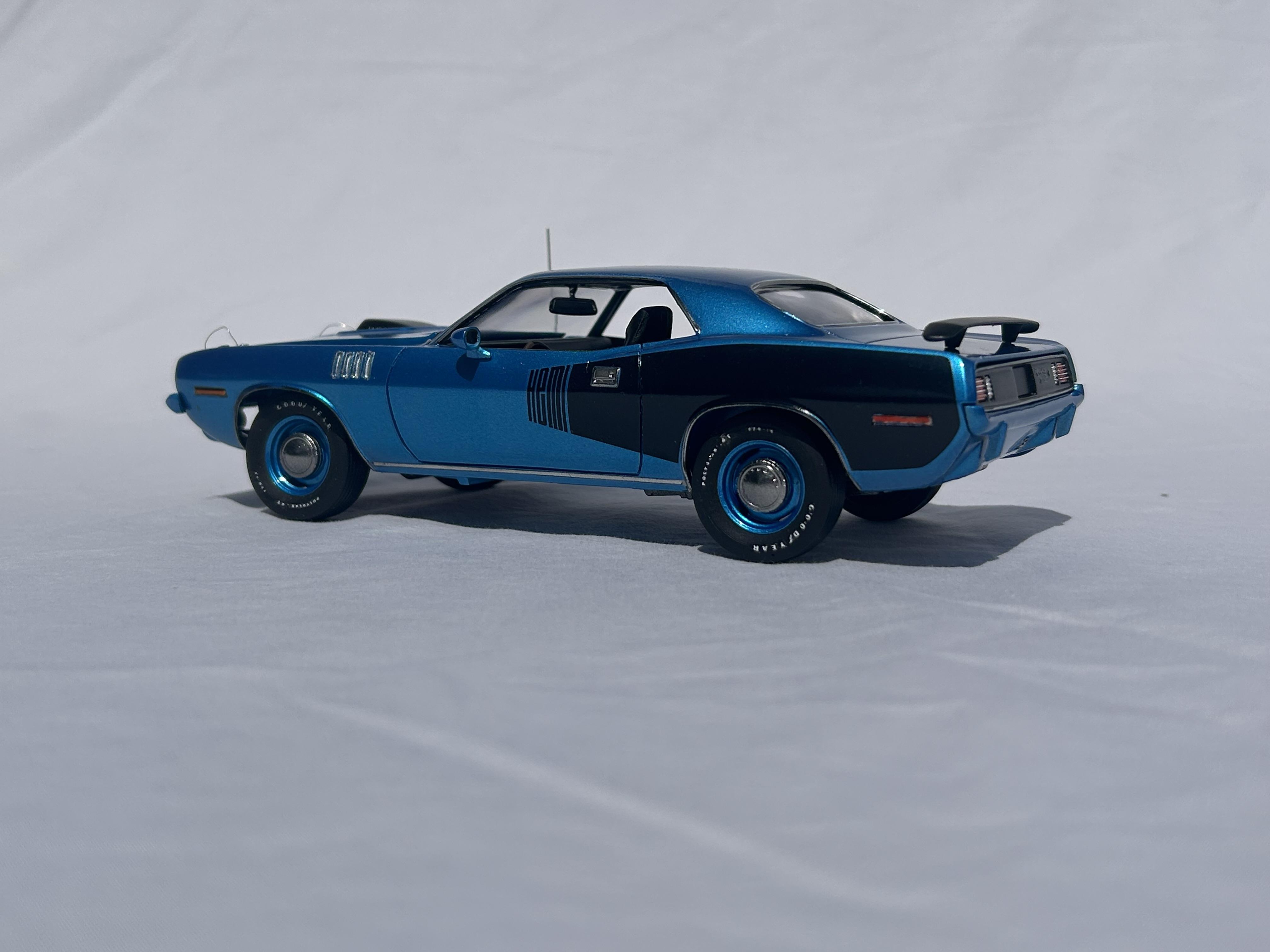

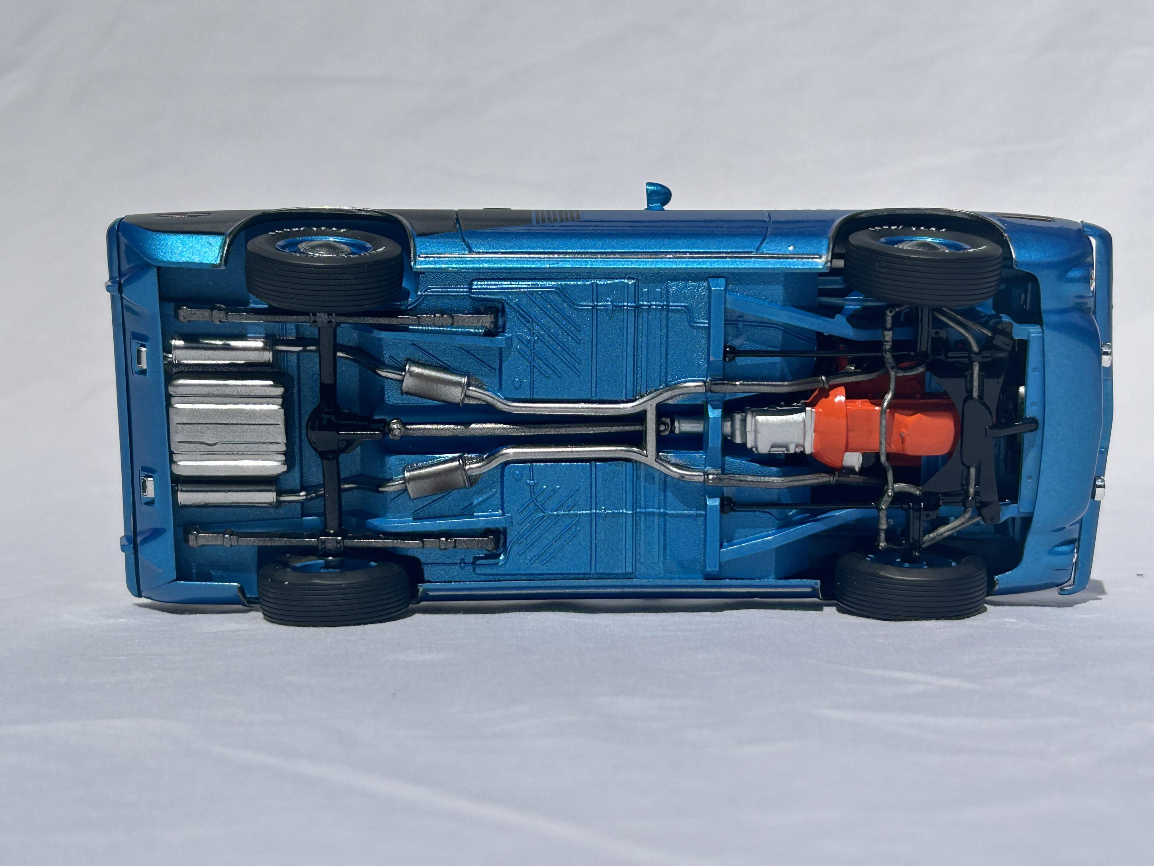

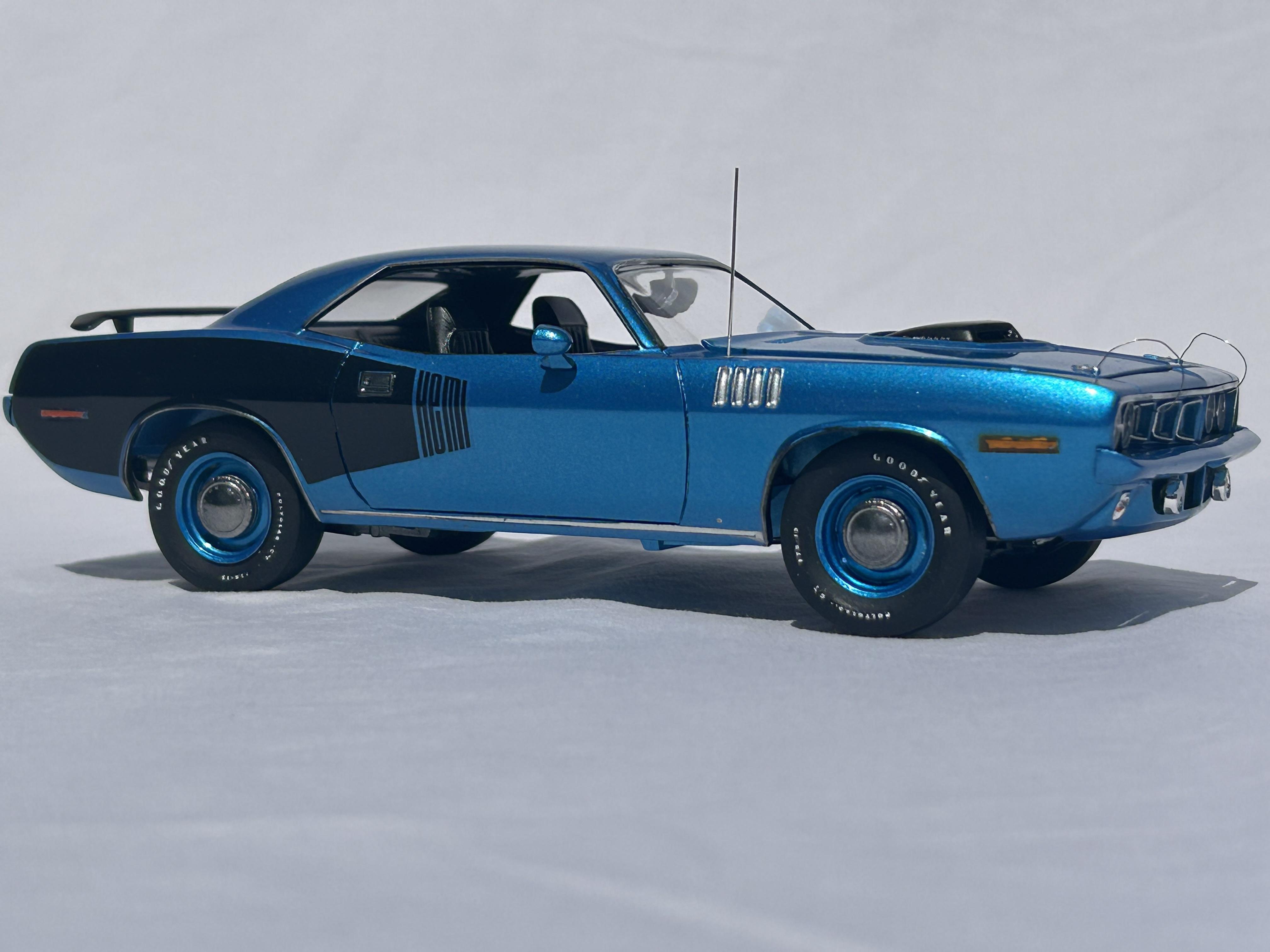

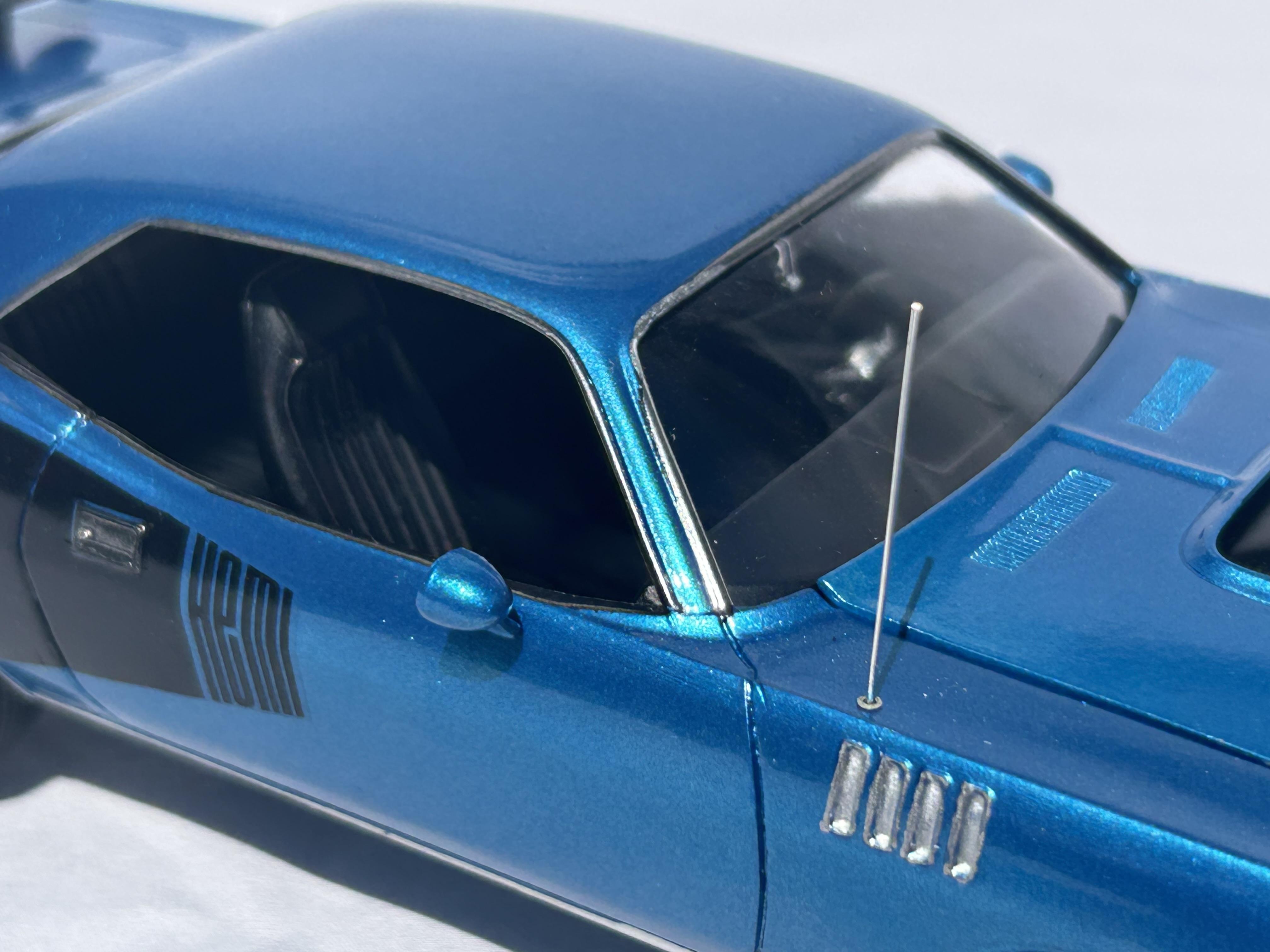

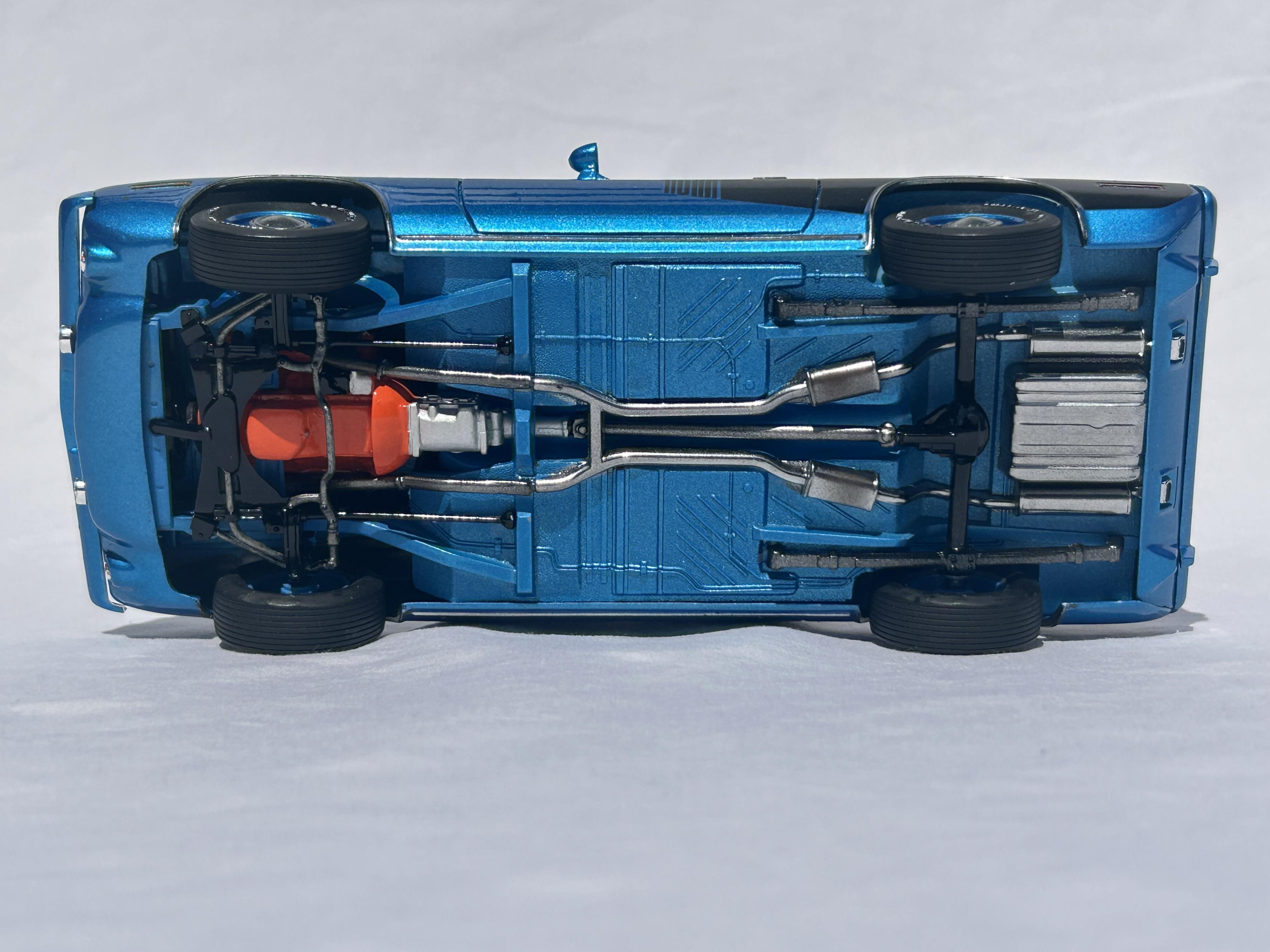

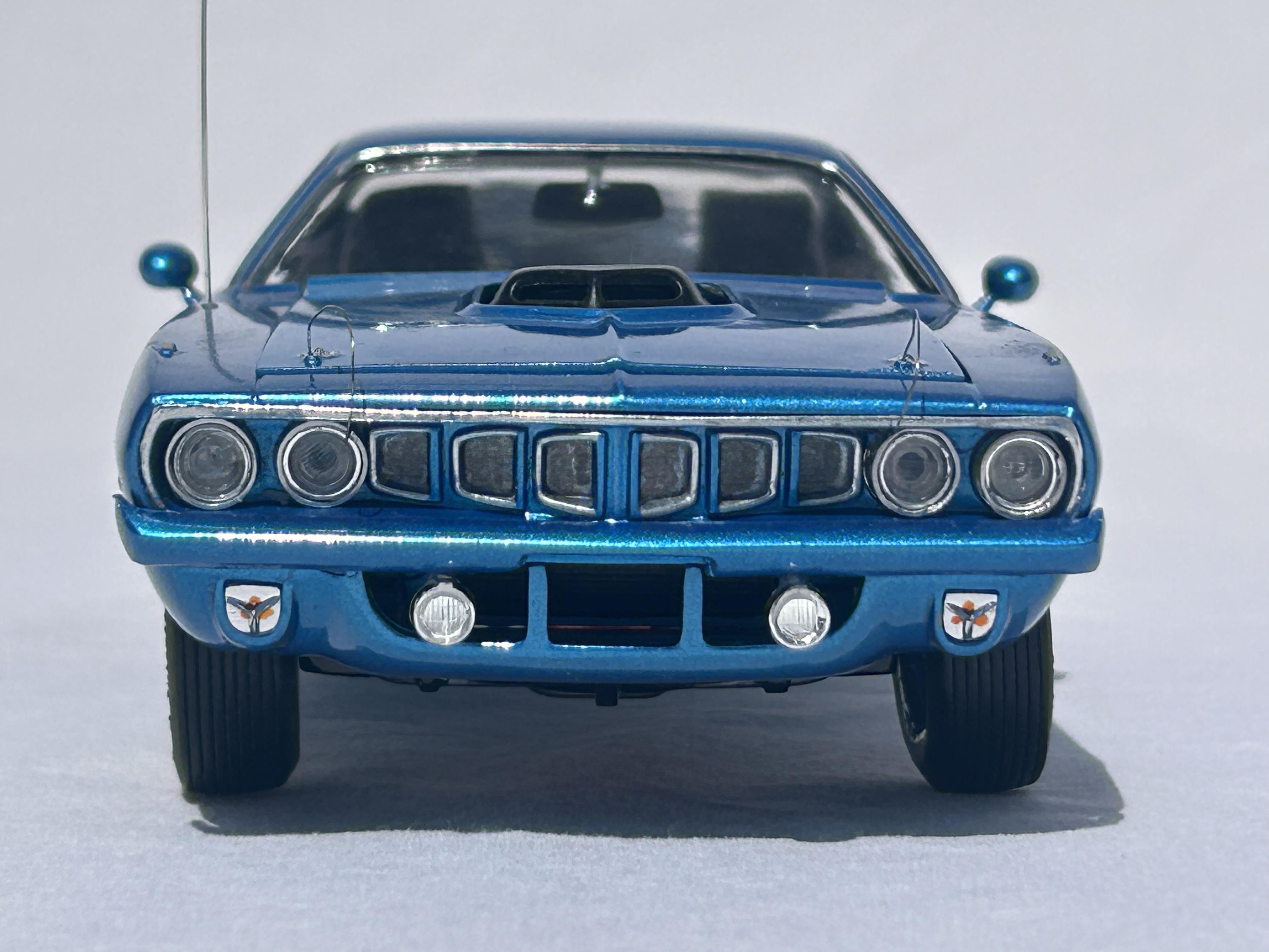

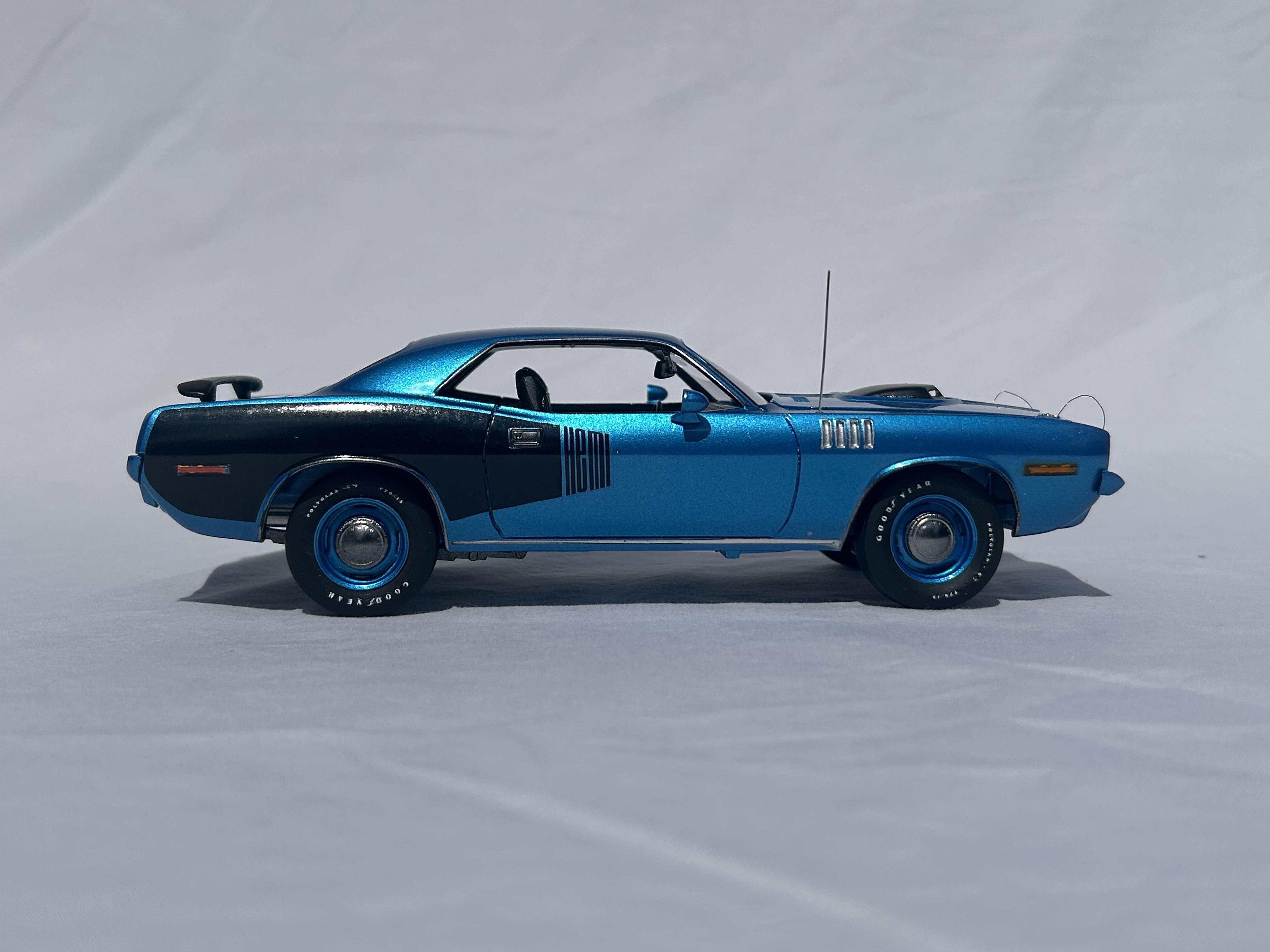

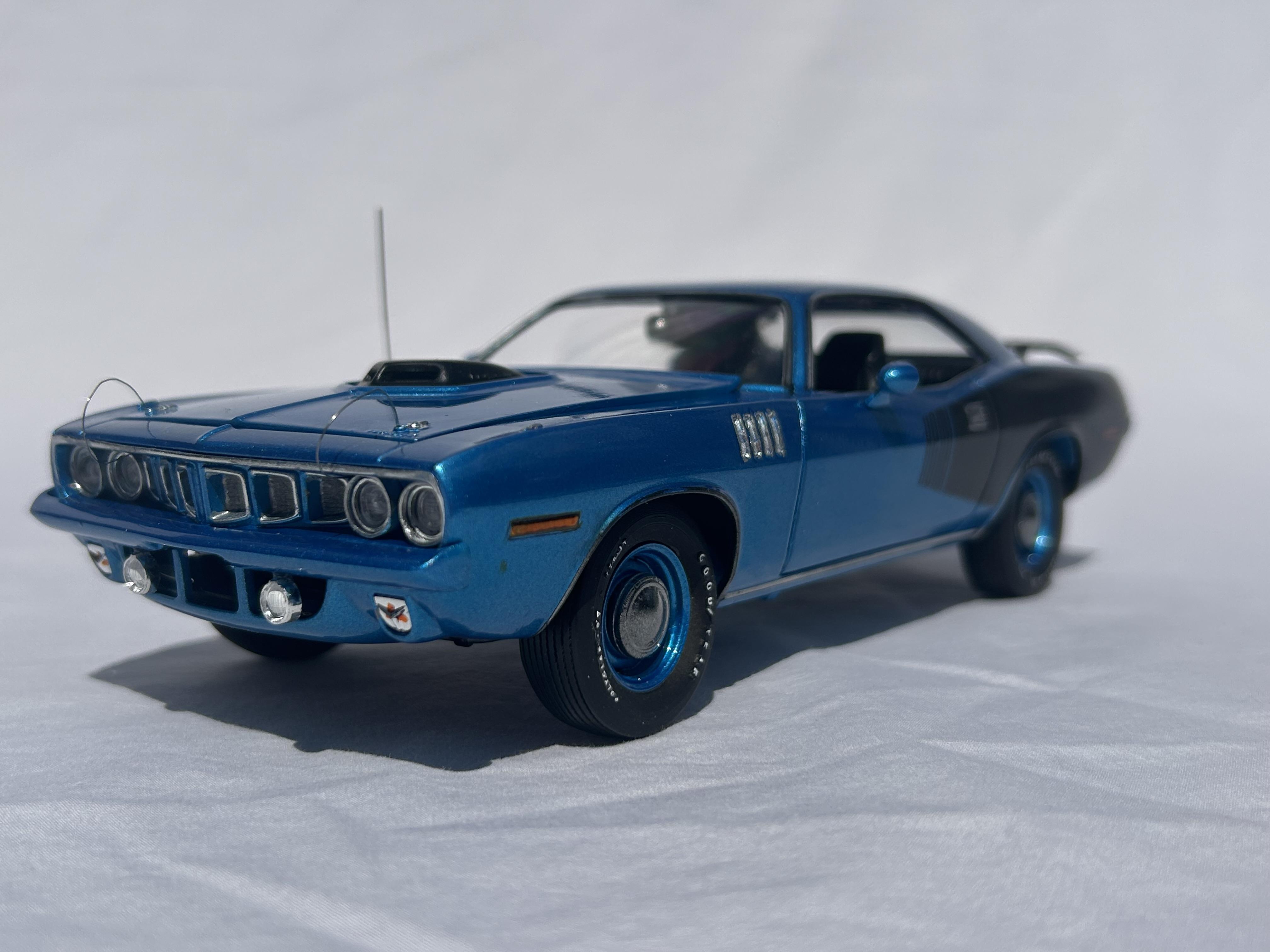

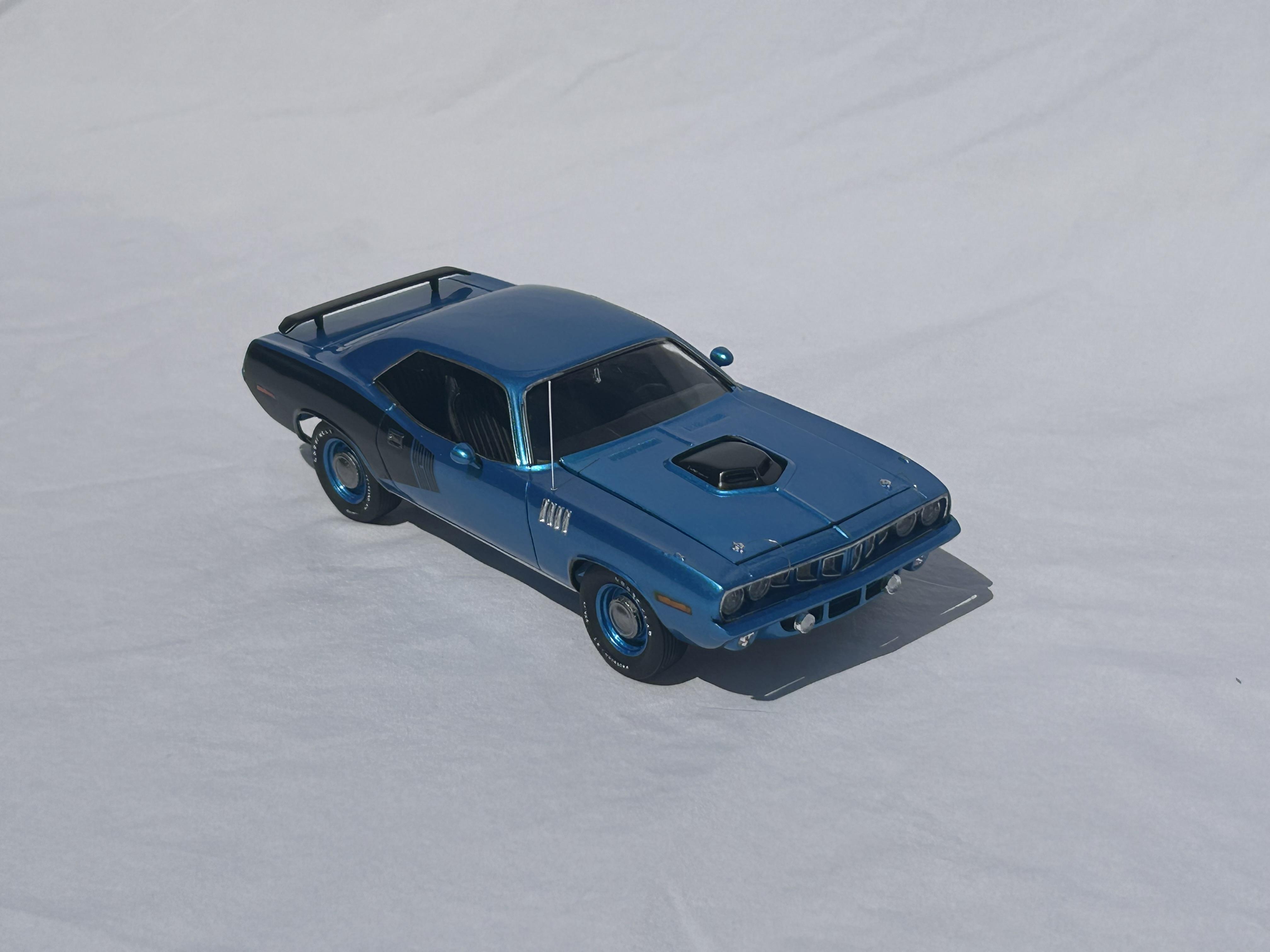

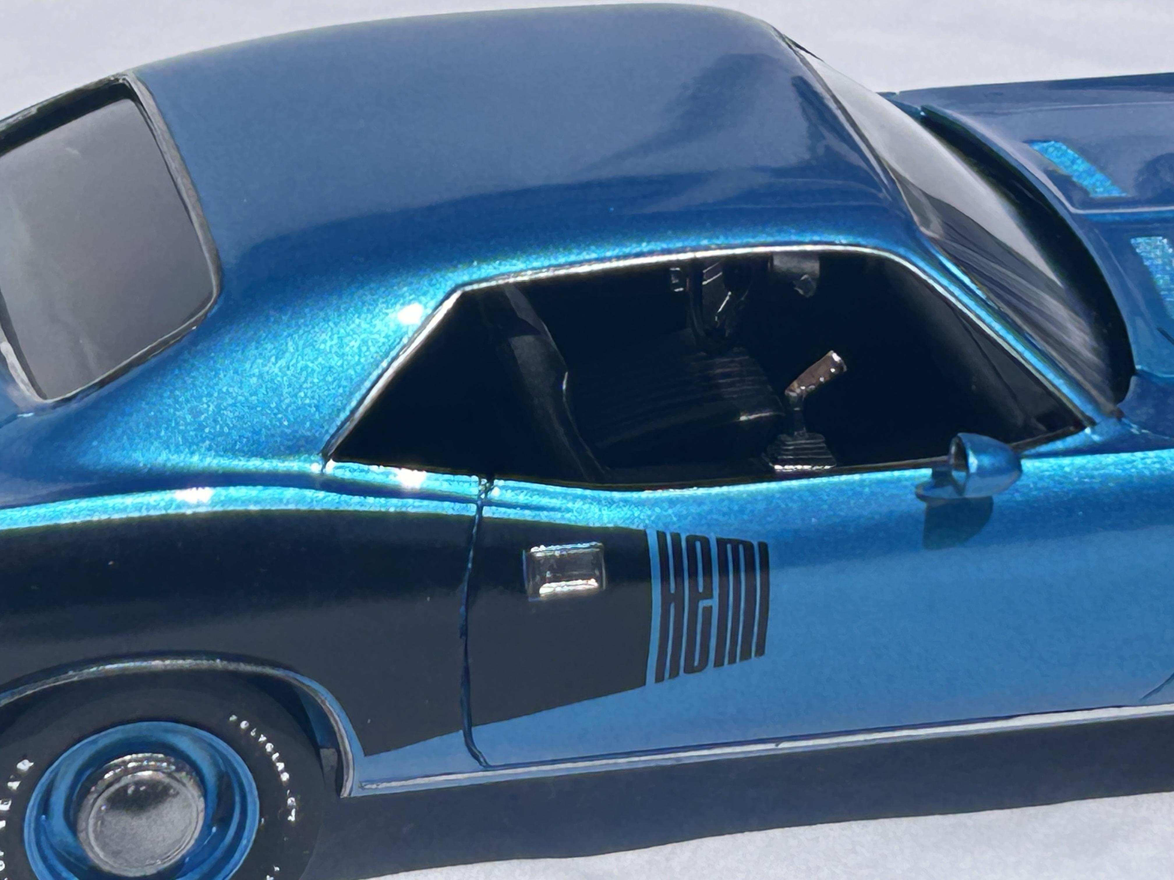

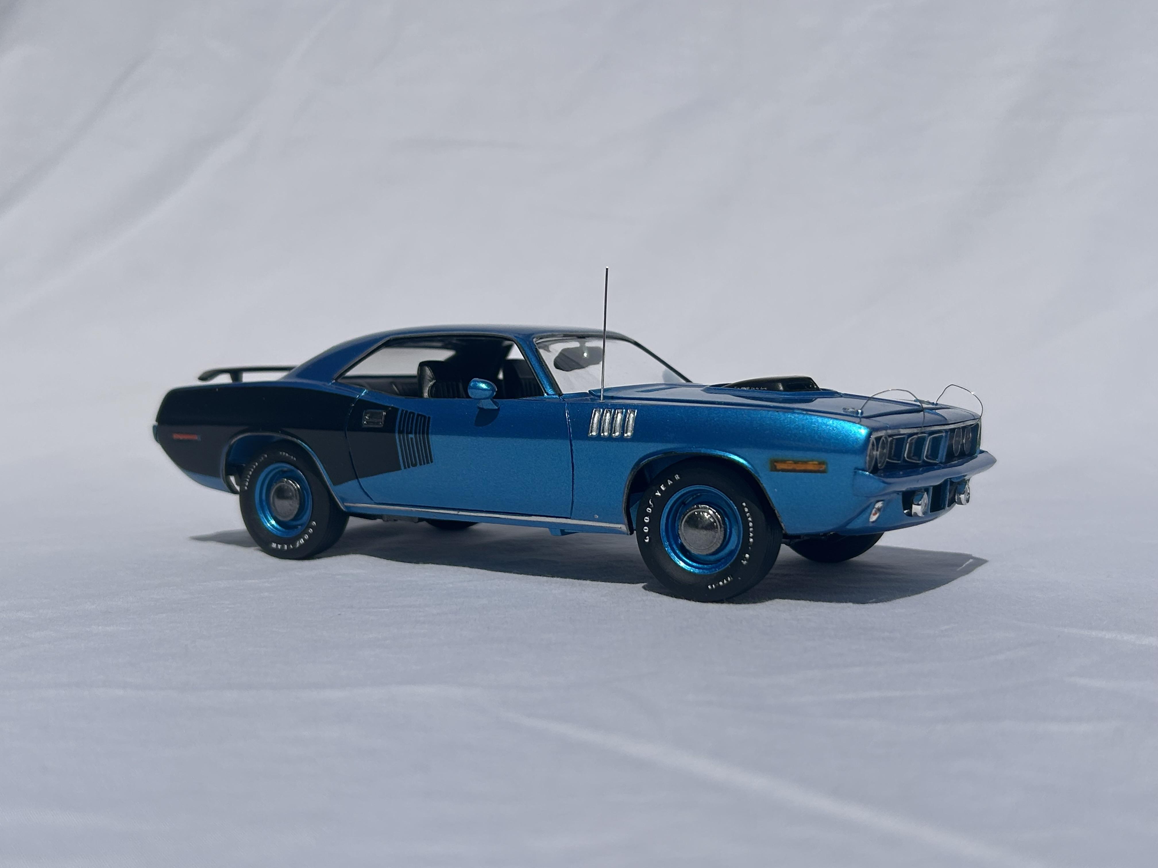

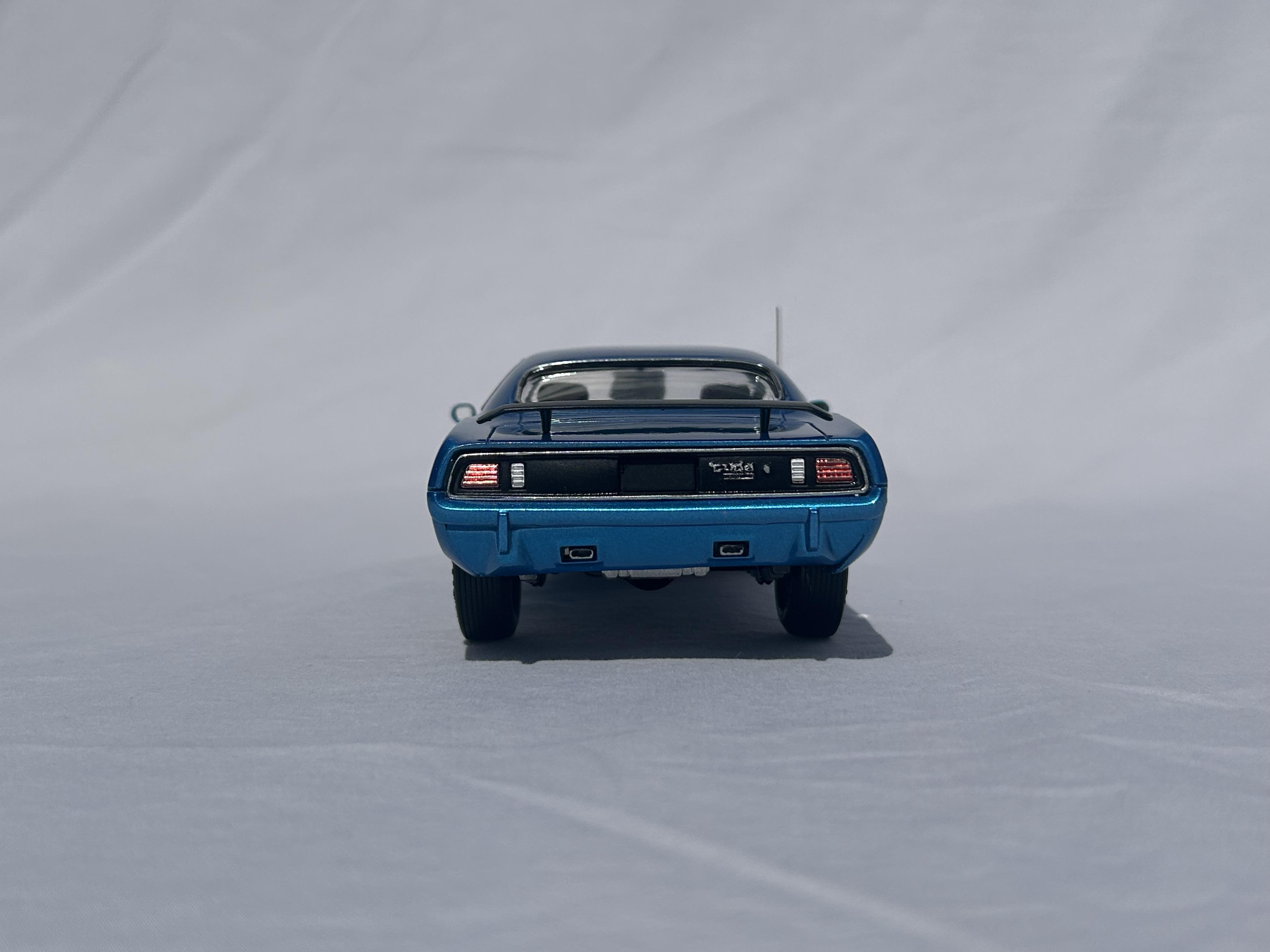

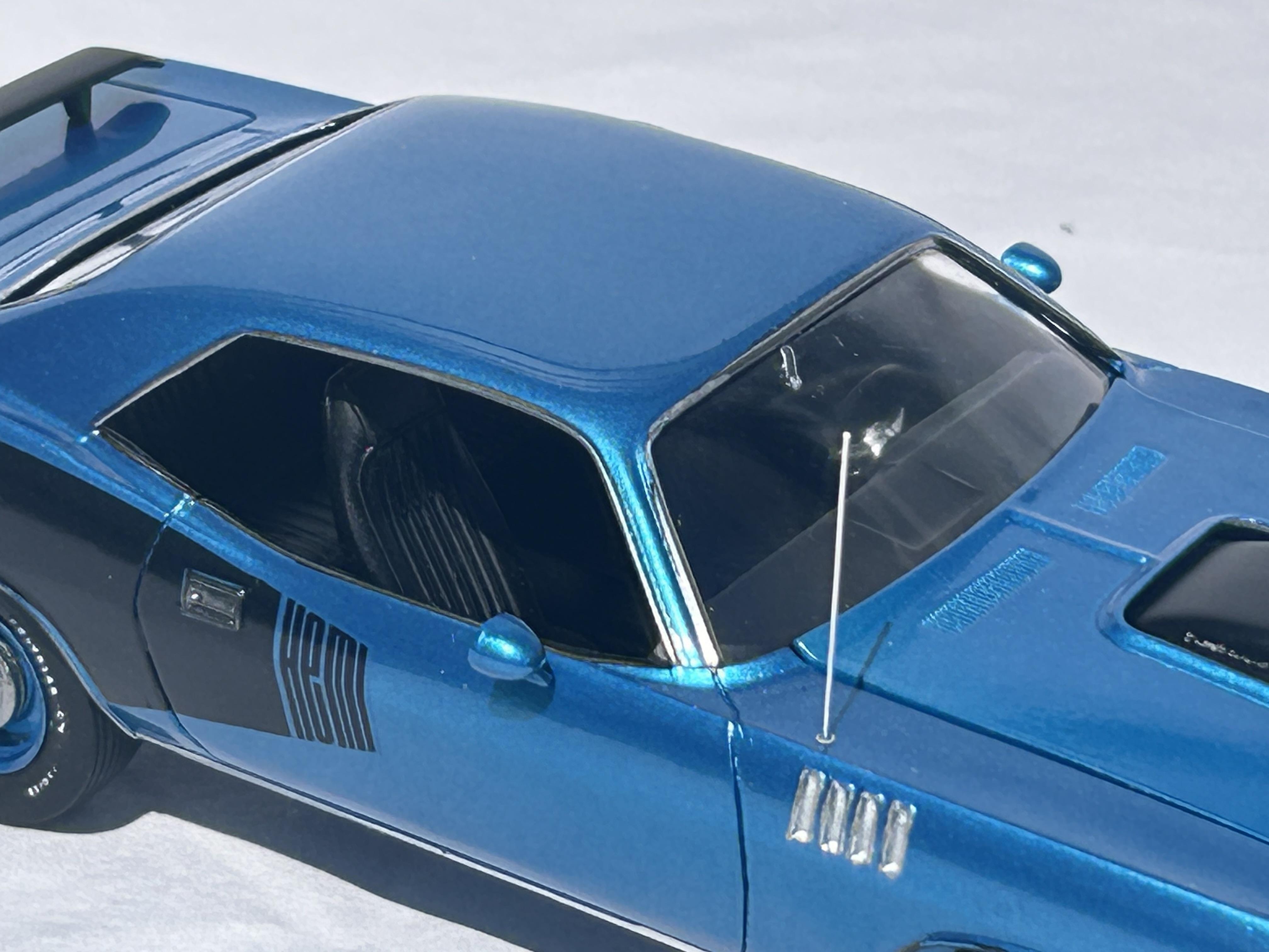

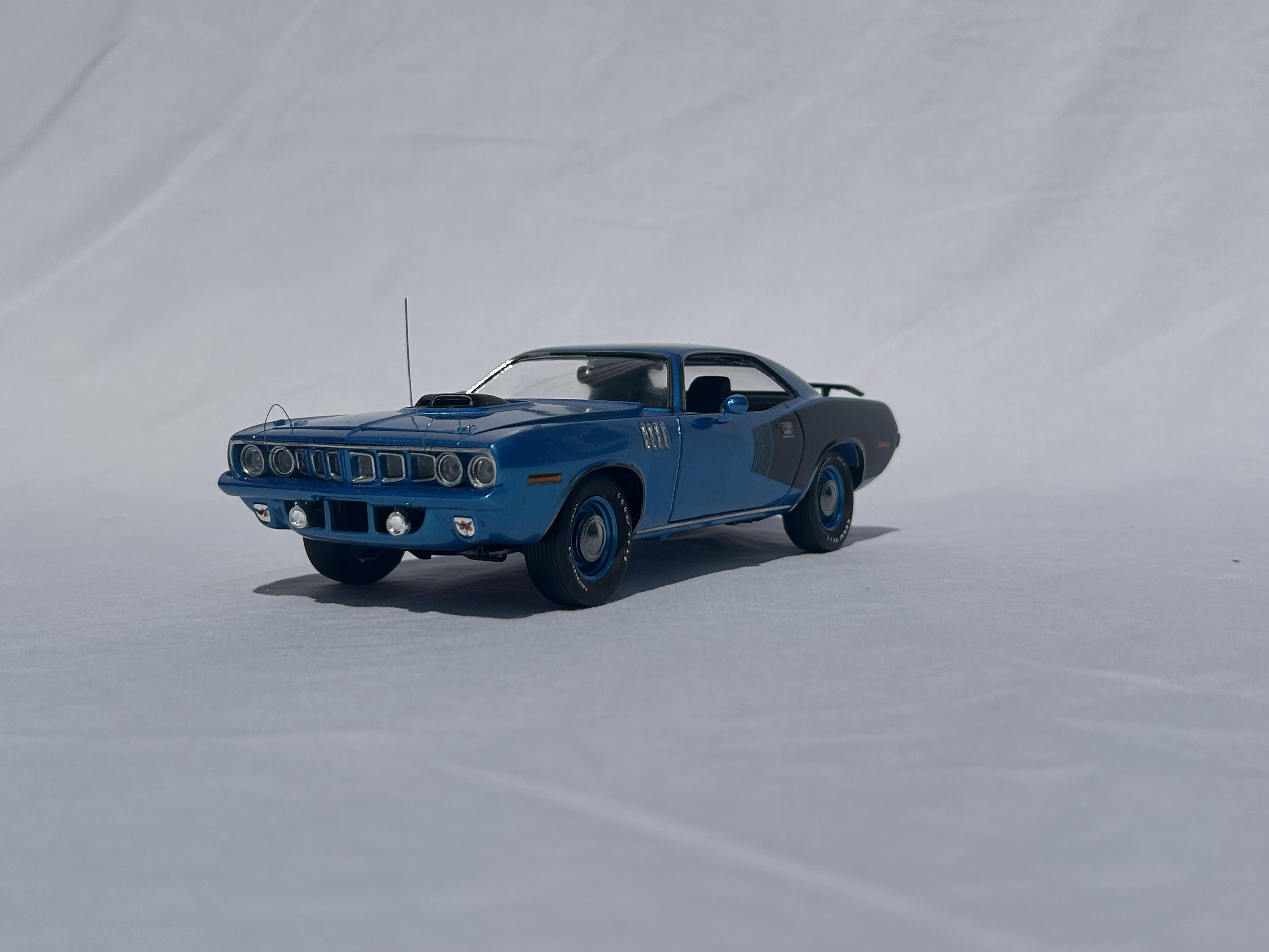

nickfzr61 Posted July 16 Posted July 16 (edited) Finished up my build of the Revell 71 Hemi Cuda. Built pretty much out of box except for the antenna. Hood pin straps, and headlight trim rings to close of the big gap between the headlights. Also added a transmission tunnel since it was missing. Just glued a piece of styrene and smoothed with putty. I molded in the joint lines for the lower front fenders and removed the cartoonish stalks on the fog lights. Also removed the front license plate bracket. I dowloaded and printed a set of steelies and Goodyear Polyglas GT tires and wheels for $3.50. Color is Dupli-Color BGM0533. It’s a GM color but I felt it mached B5 closest. I test shot Dupli-Color BCC0422 which is a Chrysler color that supposedly matches B5 but it was too dark. Also tried Tamiya TS-19 but that was also too dark. Cleared with Dupli-Color 1K Clear. Polished with Hasegawa Ceramic Compound then Coating Polymer. Chrome is Alclad Polished Aluminum. Hope you like it. Edited July 16 by nickfzr61 23
espo Posted July 16 Posted July 16 Beautiful smooth paint finish and this shade of Blue looks fantastic. Clean body trim and the side boards. like the chassis detailing.
ncbuckeye67 Posted July 17 Posted July 17 That's beautiful! Excellent detail work (I especially love the radio antenna) and color choice.

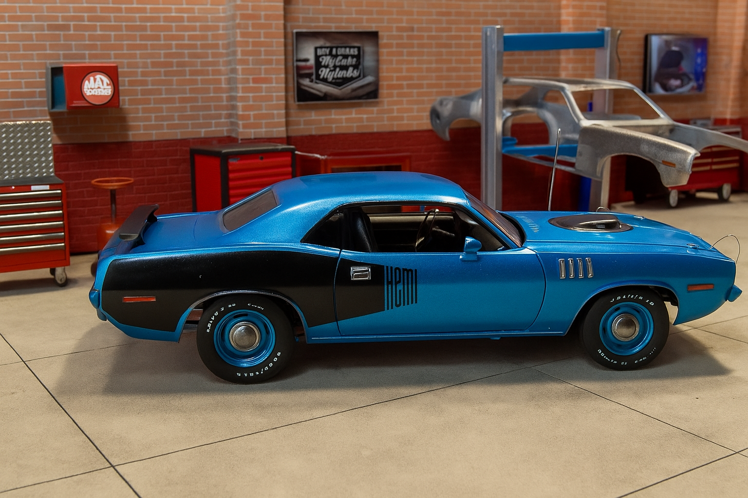

nickfzr61 Posted July 18 Author Posted July 18 (edited) Had it in the shop making sure it’s good before taking it out for a run. Edited July 18 by nickfzr61

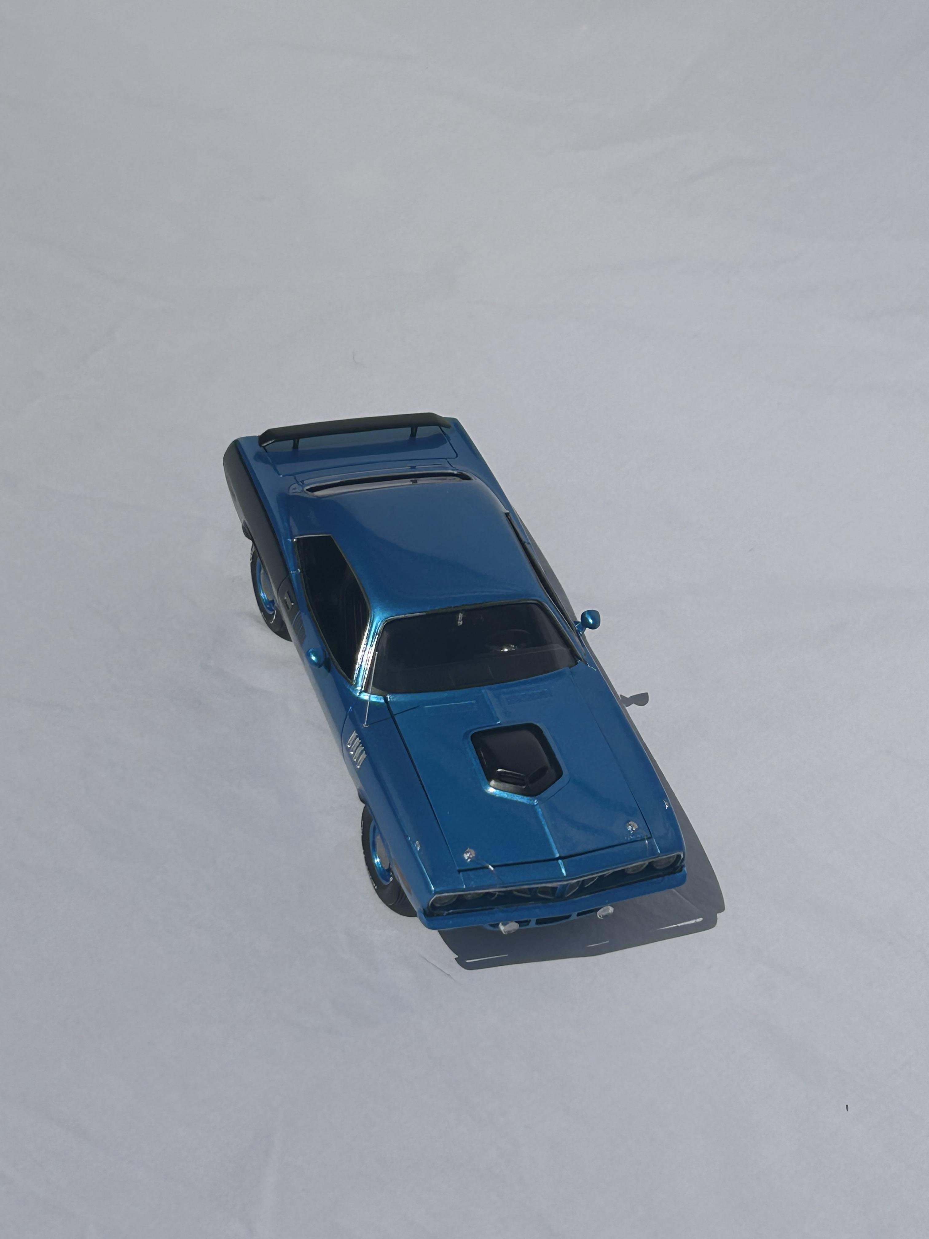

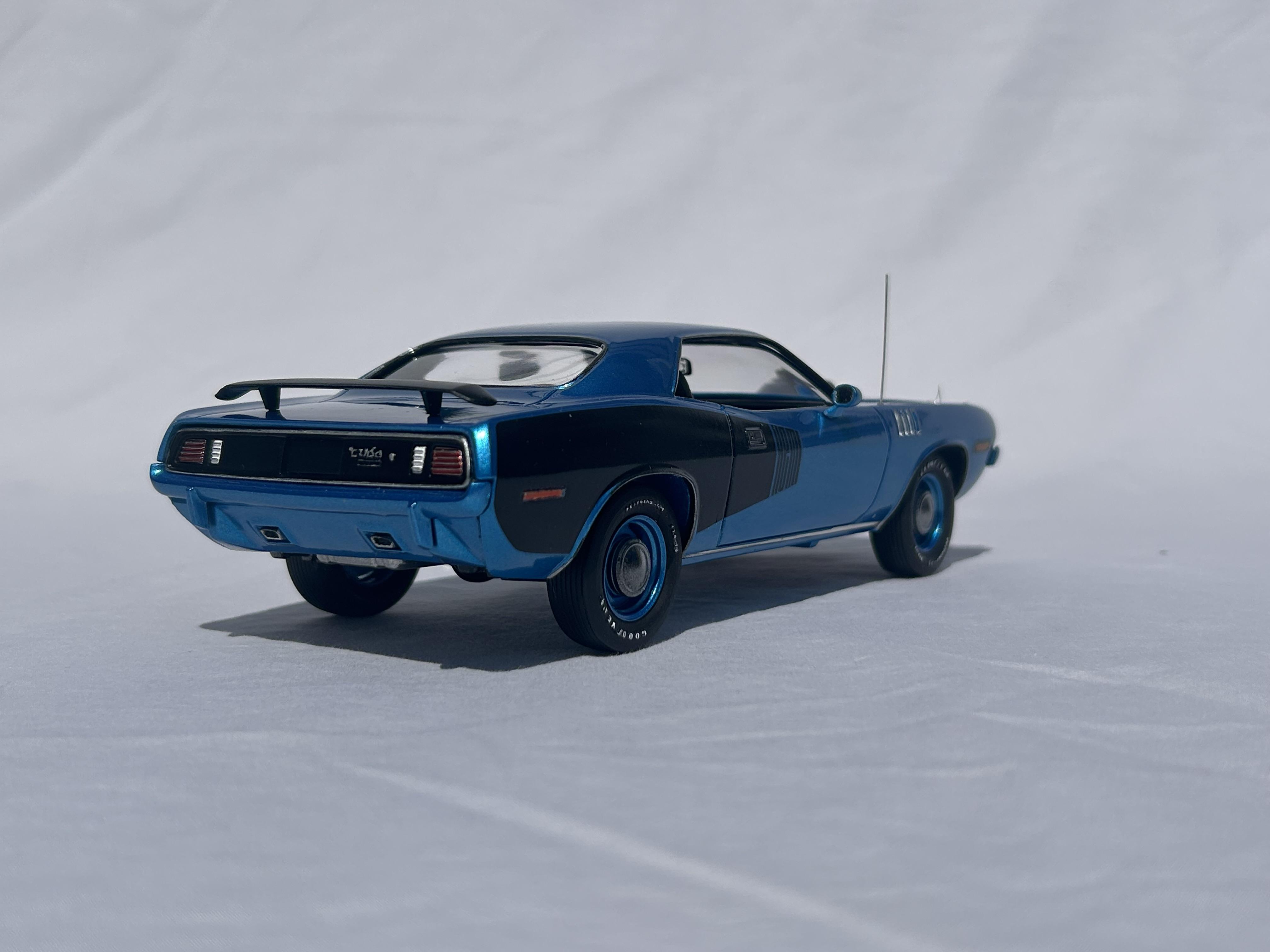

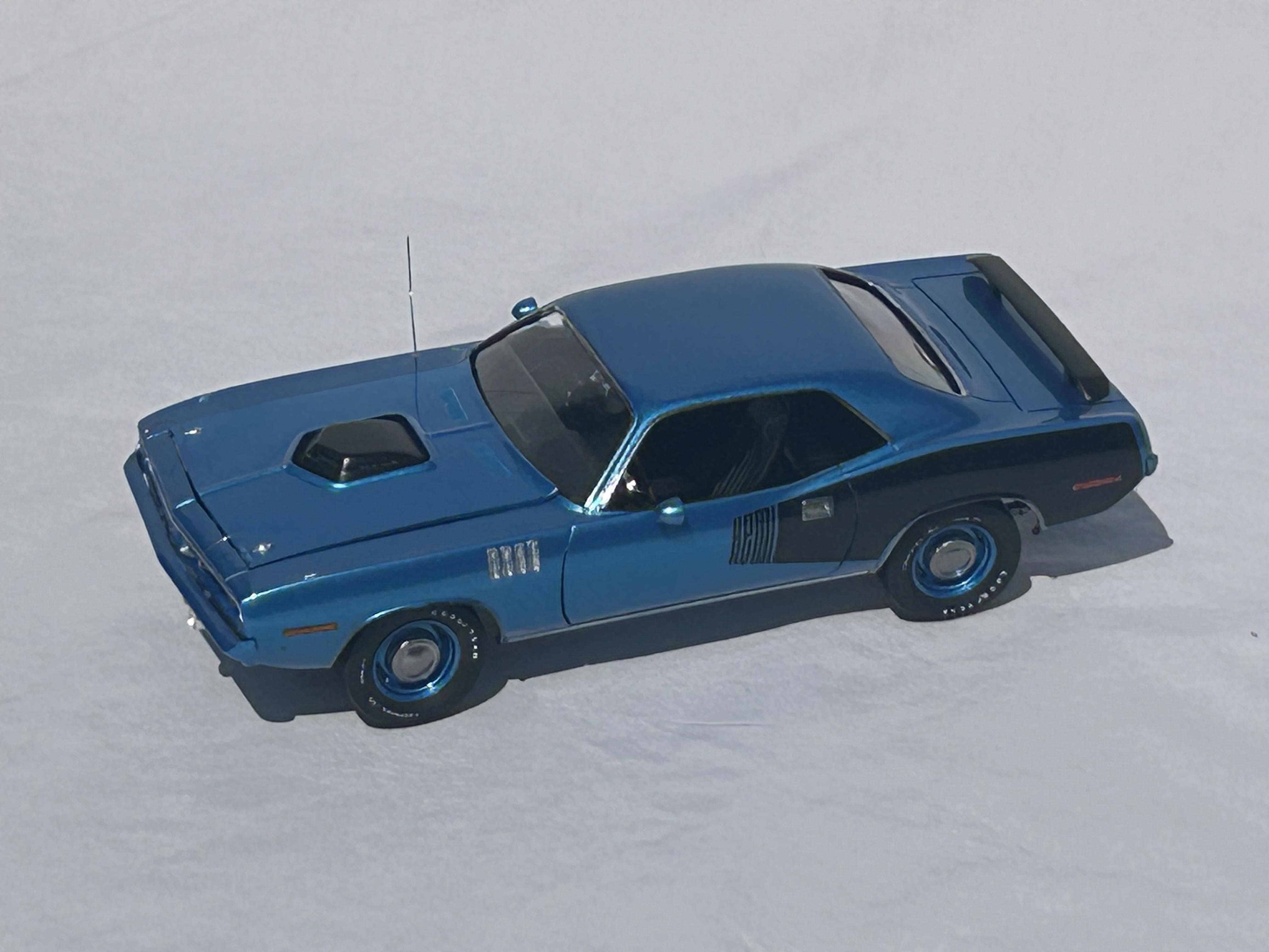

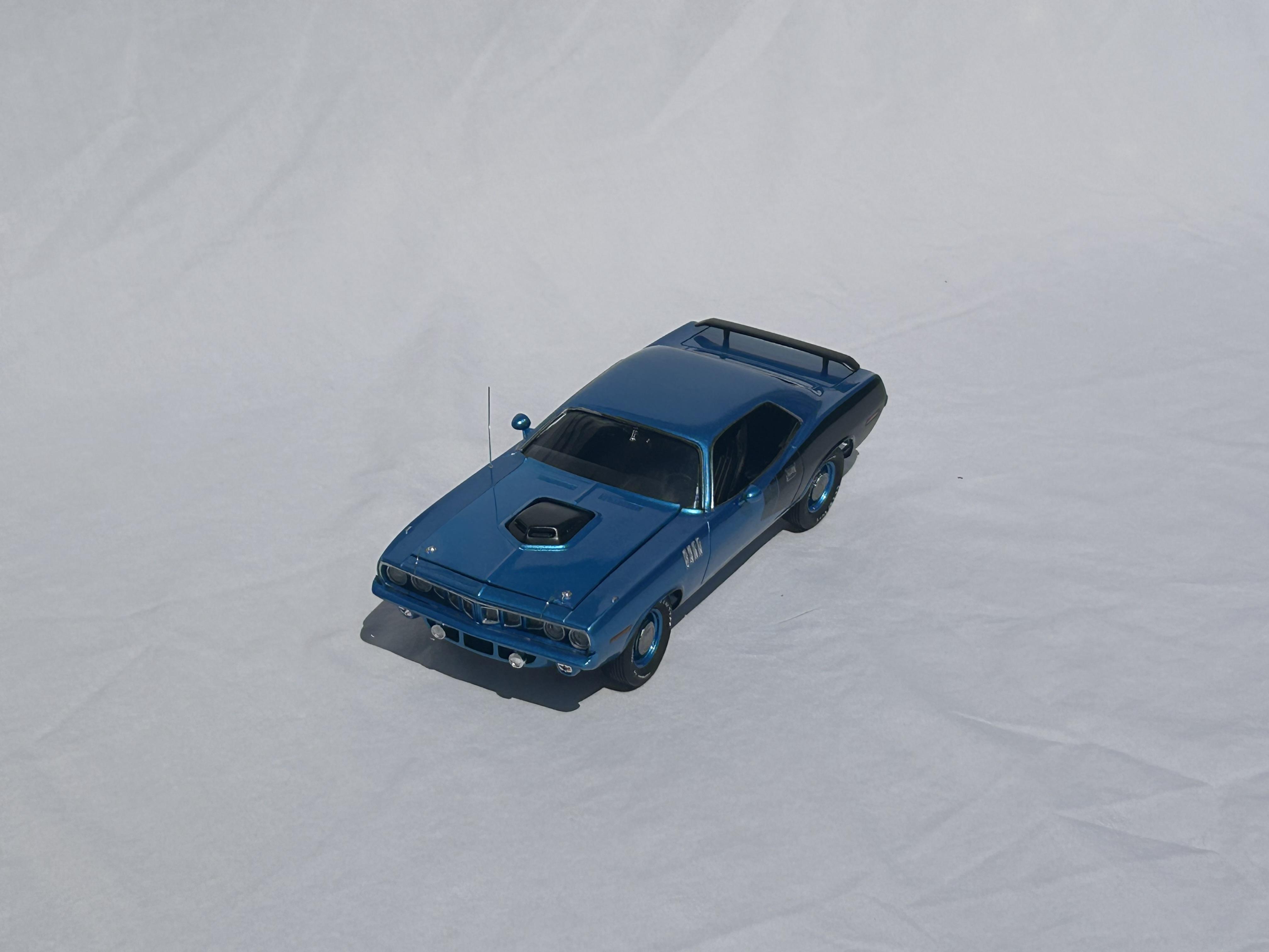

Bills72sj Posted July 19 Posted July 19 Beautiful model. I have a suggestion regarding your photography. You seem to have all the light sourced from above. You may wish to move it down and face it the same direction the camera faces. The side views are not well lit.
XYHARRY Posted July 19 Posted July 19 Nice 'cuda there Nick, your head light fix looks much better. This kit has alot of short comings in the detail department but you have done well to overcome them.
nickfzr61 Posted July 20 Author Posted July 20 20 hours ago, Bills72sj said: Beautiful model. I have a suggestion regarding your photography. You seem to have all the light sourced from above. You may wish to move it down and face it the same direction the camera faces. The side views are not well lit. Thanks for the advice. I guess I’d have to take the pictures earlier in the day since these were taken on my deck with my iphone and natural light. I would like to learn how to use indoor lighting with filters and an actual camera with the proper lenses someday.
Bills72sj Posted July 20 Posted July 20 4 hours ago, nickfzr61 said: Thanks for the advice. I guess I’d have to take the pictures earlier in the day since these were taken on my deck with my iphone and natural light. I would like to learn how to use indoor lighting with filters and an actual camera with the proper lenses someday. Today's cell phones take great pictures for the resolution needed to view them on a PC. I use a couple of clamp on halo lights to enhance the front lighting. They can be had from Amazon for less than $10. Great for modelers that need more light or directed light too.

Brutalform Posted July 21 Posted July 21 One superb Cuda. A job very well done. The paint looks amazing. Big improvement on those headlights.
drodg Posted July 21 Posted July 21 Great job on those front fenders actually Great job overall but I hate that about that kit and where the front pan and front fender joins. Anyhow great job.
