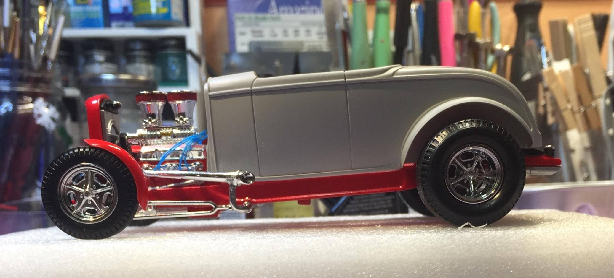

After much internal debate, fear, weeping, and denial, I came to the conclusion that I needed to bite the dam bullet (a wad cutter, thankfully) and rip the rear end out and cut those stupid air bags down. You talked me into it, Craig 😪
This could have gone south on me pretty quick but it must be my lucky day.
I drilled out the air bag posts from the top side and shaved a few mms off of them.
I drilled them for new posts and cleaned up the CA from the contact points.  I knew the wheels were not centered and that's what made my mind up.  Assembling the rear axle and radius arms without the wheels mounted is to do it blind. That's how I did it. 🥴  now I get to correct it!  The thing is, when the wheels are centered, the drive shaft is too long. I had to move it forward to center the wheels and everything should fit, right? Nope. That's why the big fat posts sticking out of the air bags.  They fit through the drilled out holes in the floor pan. So with the wheels on, the axle in place, the body in place, I centered the wheels. I then removed the body (very carefully ) and dropped the CA on the posts and kicked it.
And this is what she looks like now. 👇
The radius of the fender and that of the tire are equidistant throughout the curve. That's a win.  It's not a heck of a lot lower but it's much better to my eye. I will still darken the wells.  The big victim in all this is the drive shift.
Thank for helping. You know who you are 😉

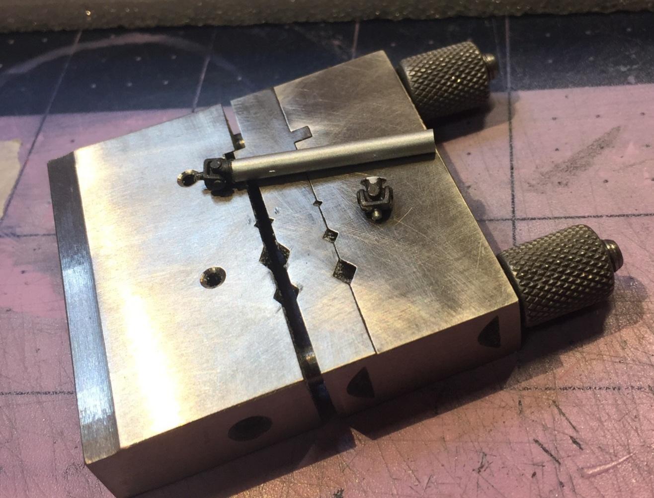

It definitely looks better with the wheels centered under the fenders.👍 What is that device that the driveshaft is sitting on?
The device is a mini-vise I got from  Micro-Mark many moons ago. It helps to cut a square end on small stuff like the driveshaft.

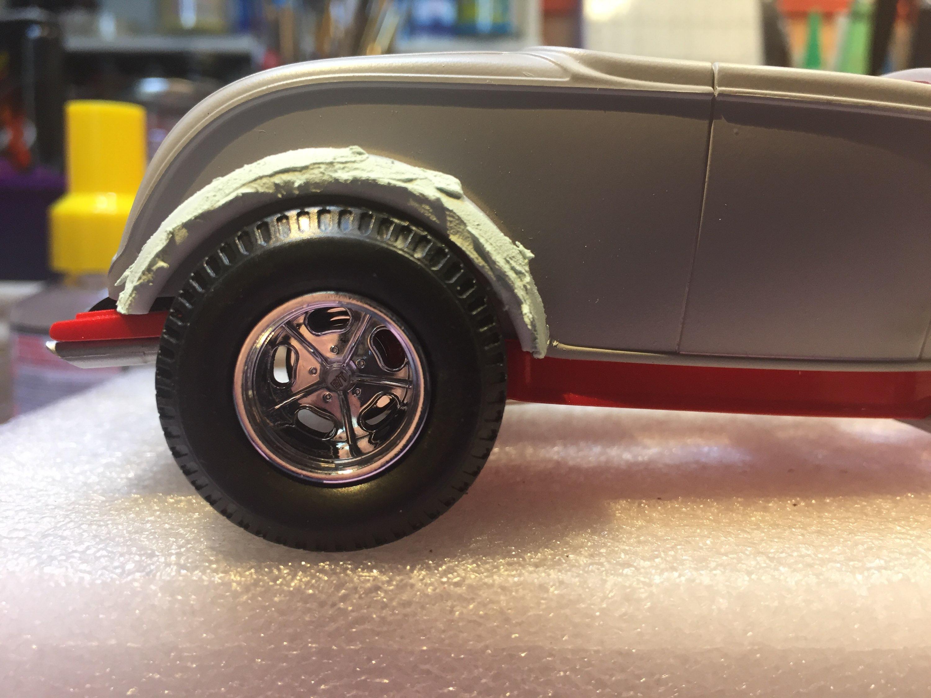

WDYT about adding styrene rod to the rear fenders to create a rolled-over lip. This would reduce the radius evenly and shrink that unsightly void over the tire? 😏
Definitely need to fill some of that gap up somehow. I think that would help a lot.

I stopped  by the body shop for a bit of custom work.
It's a little awkward to hold cold-curled 5/64 rod while gluing and kicking but I managed to do so without my fingers becoming part of the fender.
Bondo time!
My cheese grater 👇
The inside needs some love too. Just some quick work with sanding drums to eliminate the roll-under and make it look like a normal fender. IMG_8474.jpg.31c47ac7eed13ee949ec18ada2e2ac4c.jpgIMG_8475.jpg.94070f961df1dc9623c2aac0049a0fbd.jpg
This should make everyone happier now. 😉
