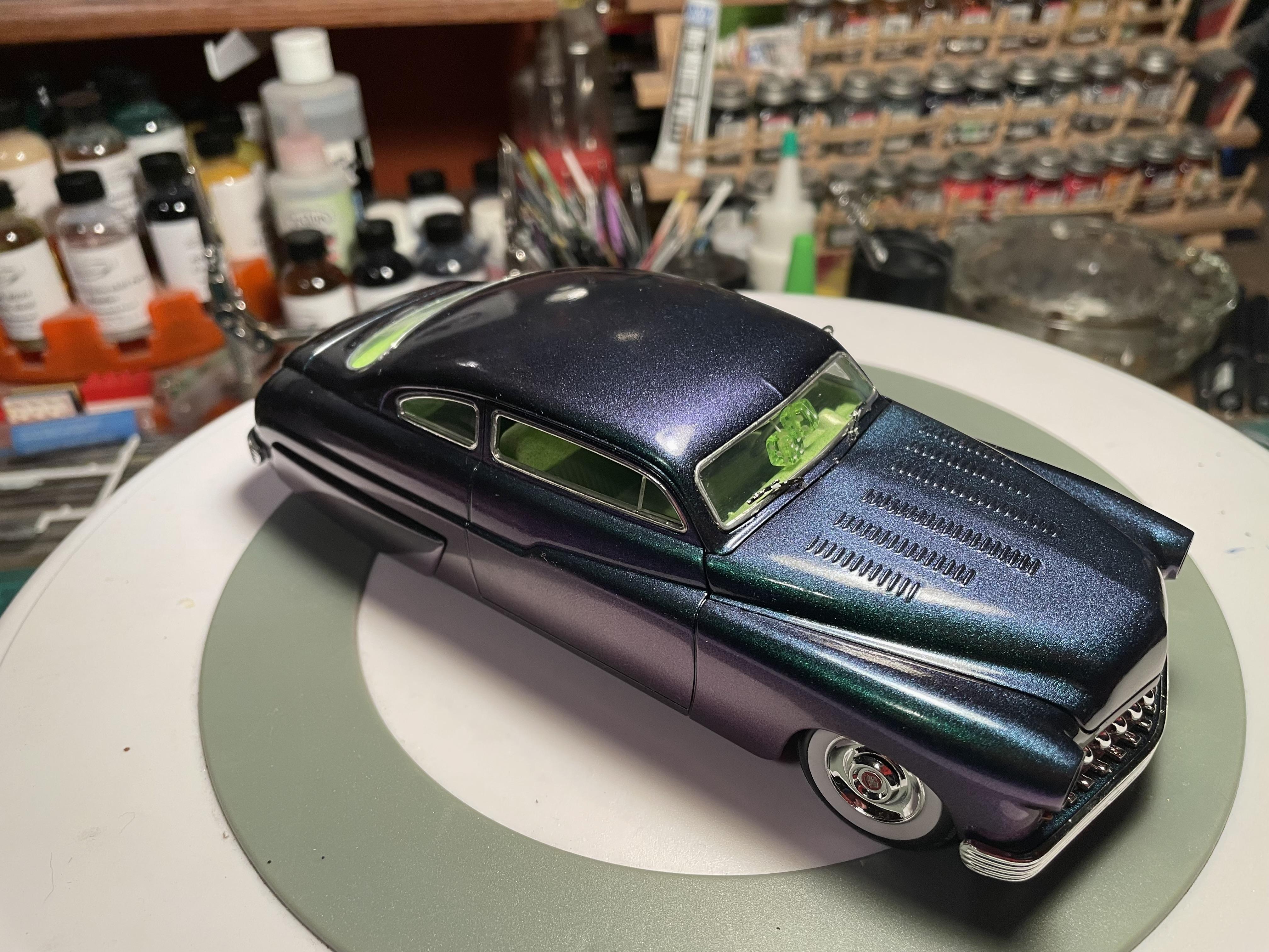

Cool Hand Posted August 5 Posted August 5 (edited) What paint manufacturer will you be using ?? But yeah what Janice stated, gloss black base. And take your time and slowly build up the colour shift with multiple light coats. It can take me anywhere from 6-8 coats to get full even coverage. You dont want breaks in the pearl with the black showing through. Always do a test spoon before painting the body. I usually dial in and get a feel for how the paint lays down and how many coats for full even coverage. Once comfortable and confident move straight onto the body. All of these have SMS paints colour shift. Edited August 6 by Cool Hand 4

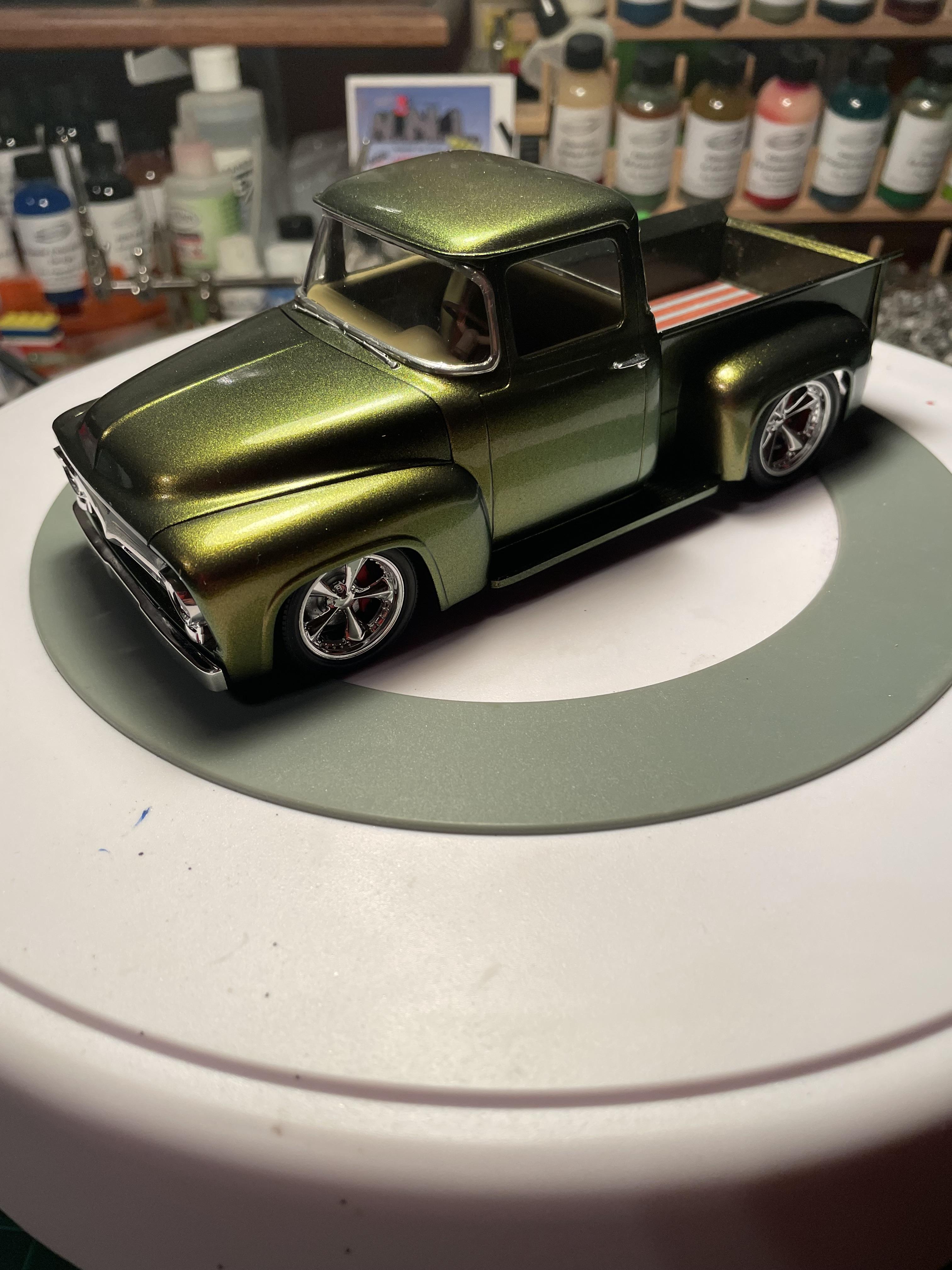

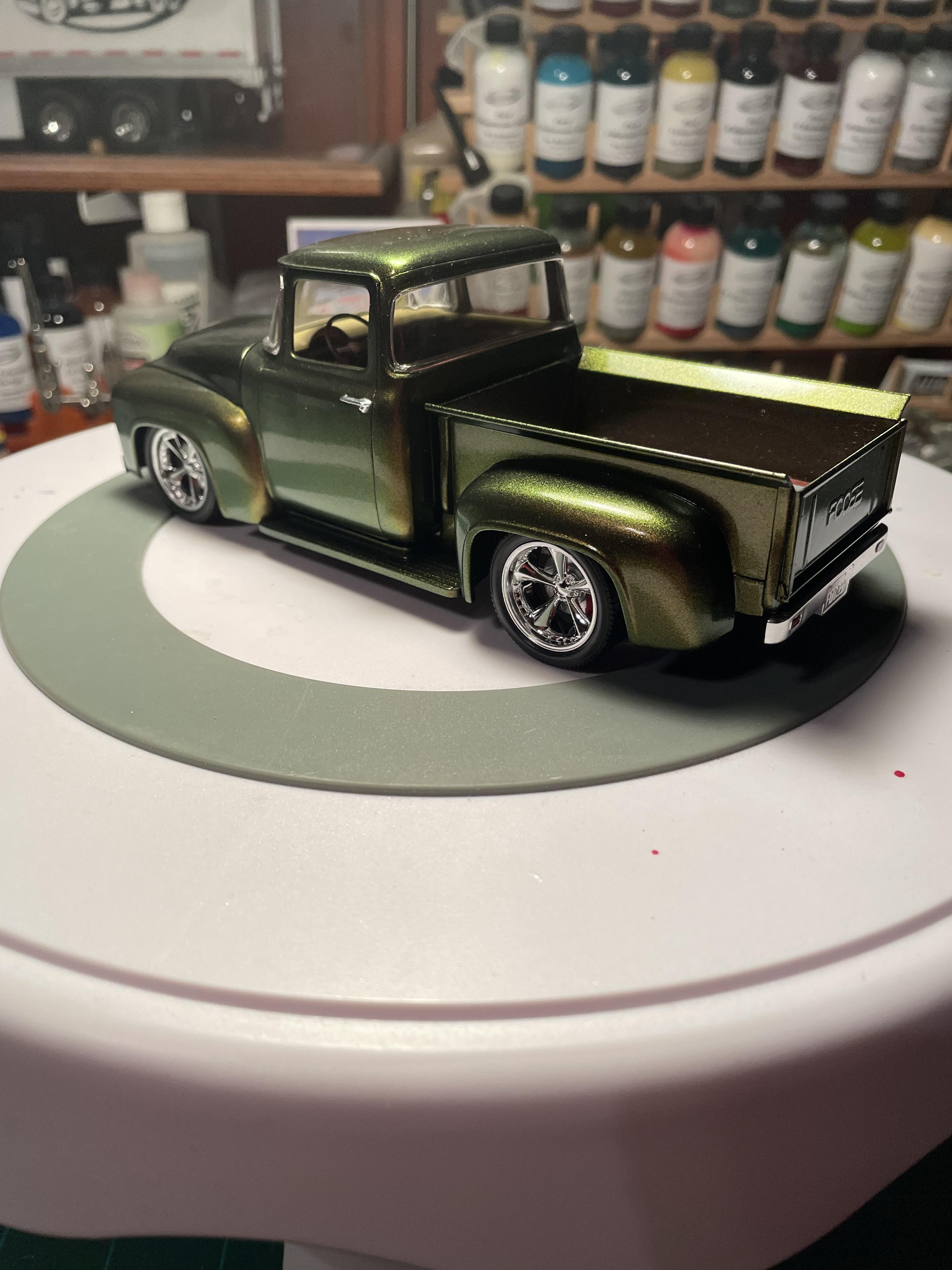

Leica007 Posted August 5 Posted August 5 Here's some photos of my color shift paint jobs on 53 P/U and 55 Panel using Rustoleum spray can, before I started using an airbrush (2018). I don't remember using primer. The p/u was molded in white and the panel was black. Have you tried decanting to use in your airbrush? I think I used only 2 coats (maybe 3) and got these results. Hope this helps, looking forward to seeing how your's comes out.

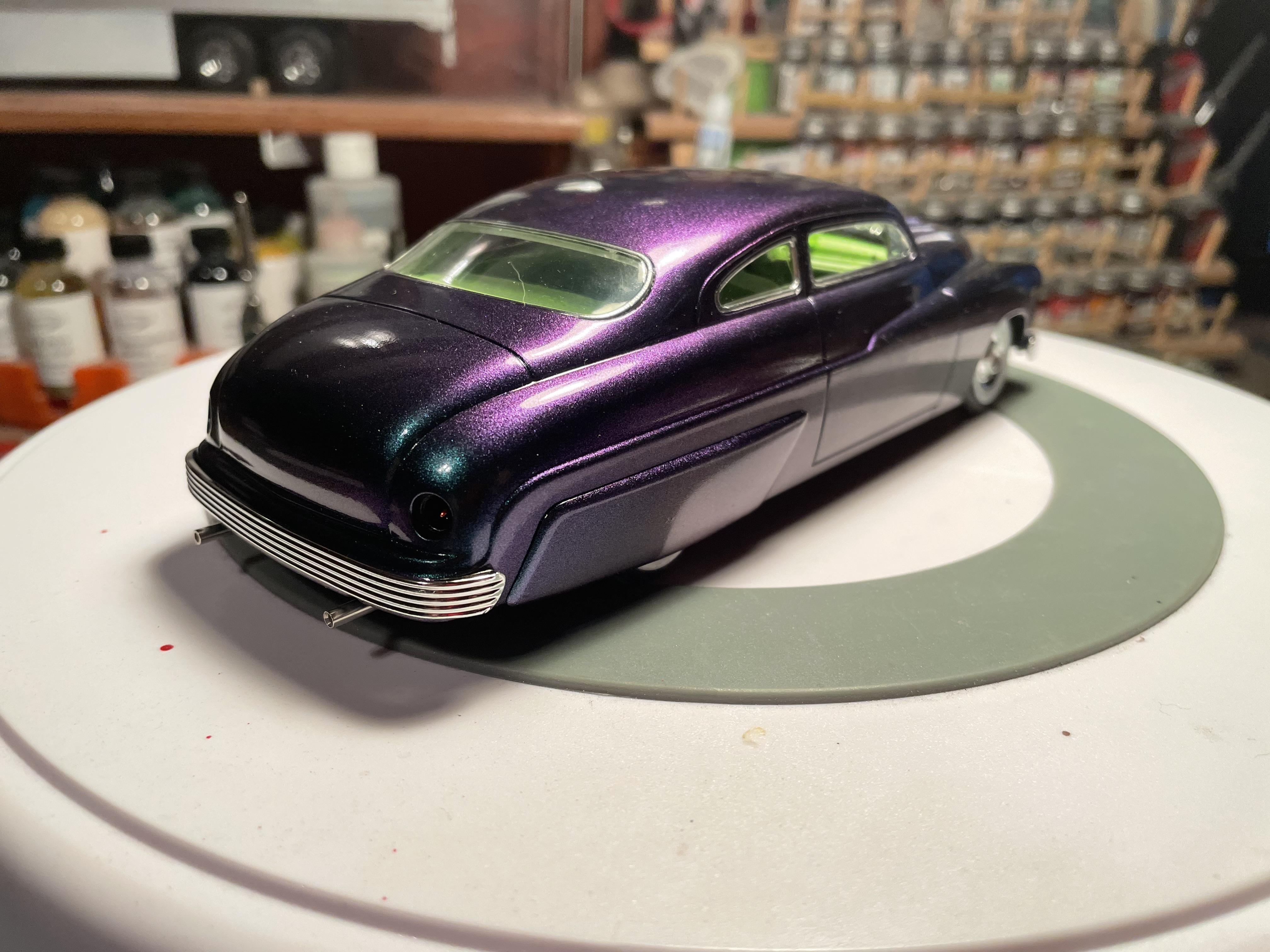

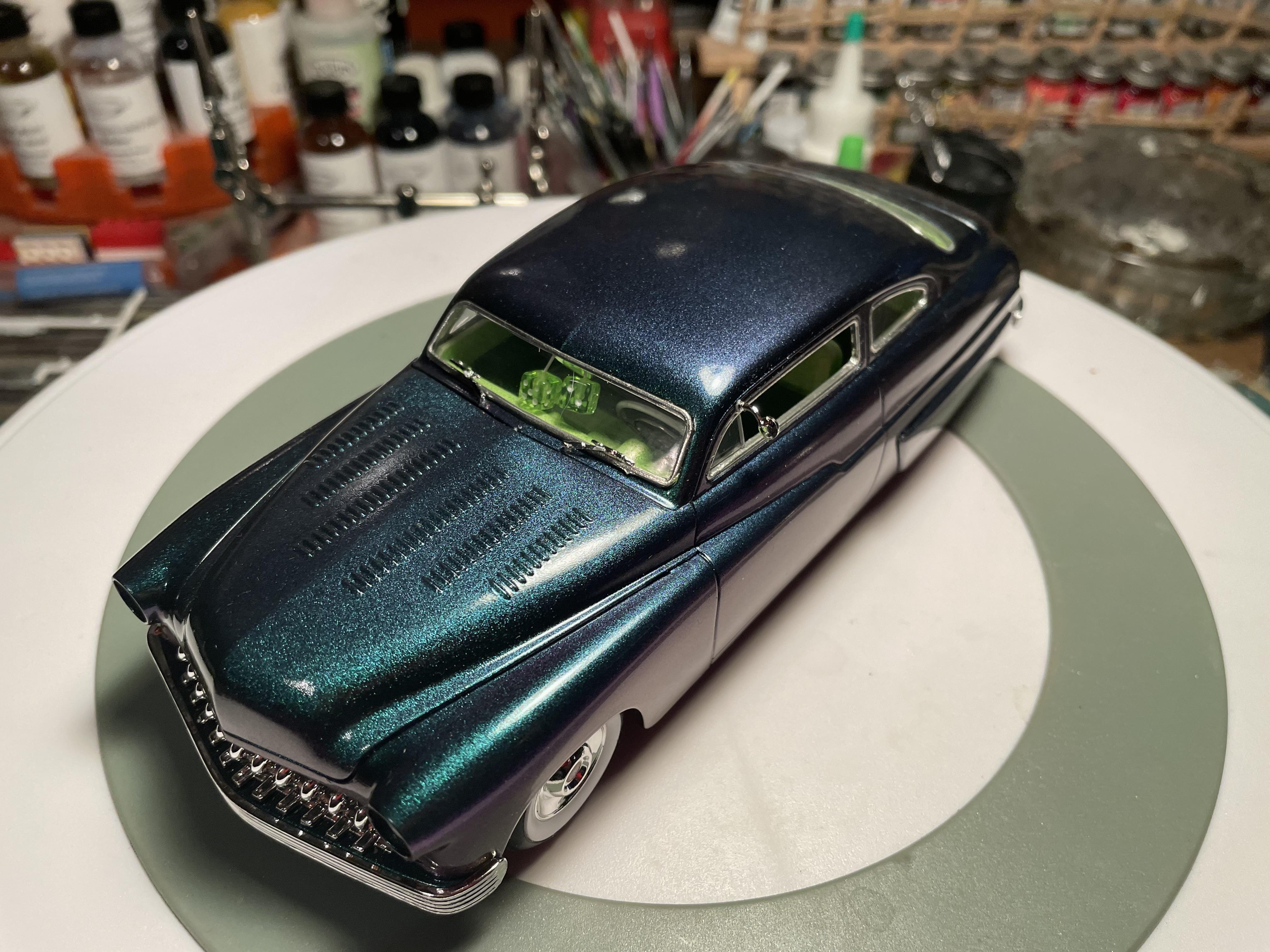

Cool Hand Posted August 6 Posted August 6 37 minutes ago, Mike 1017 said: I will be using ScaleFinishes Vertigo Hyper Vertigo Blue, Purple, Teal. Midnight Black Base Coat This one was blue, purple, bright aqua over a gloss black base. 2

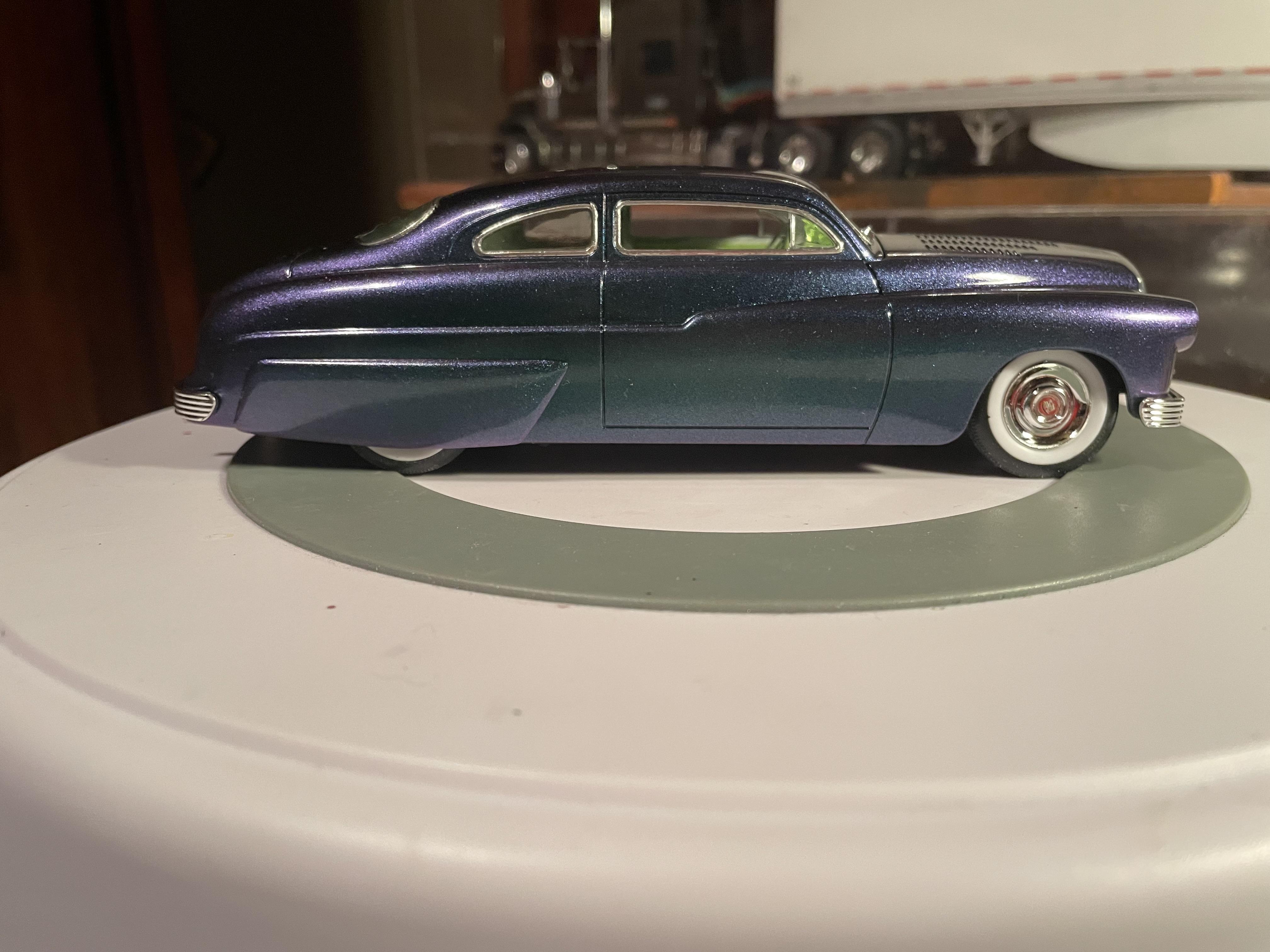

tbill Posted Tuesday at 01:13 AM Posted Tuesday at 01:13 AM These are scale finishes color shift paints over a semi gloss black
