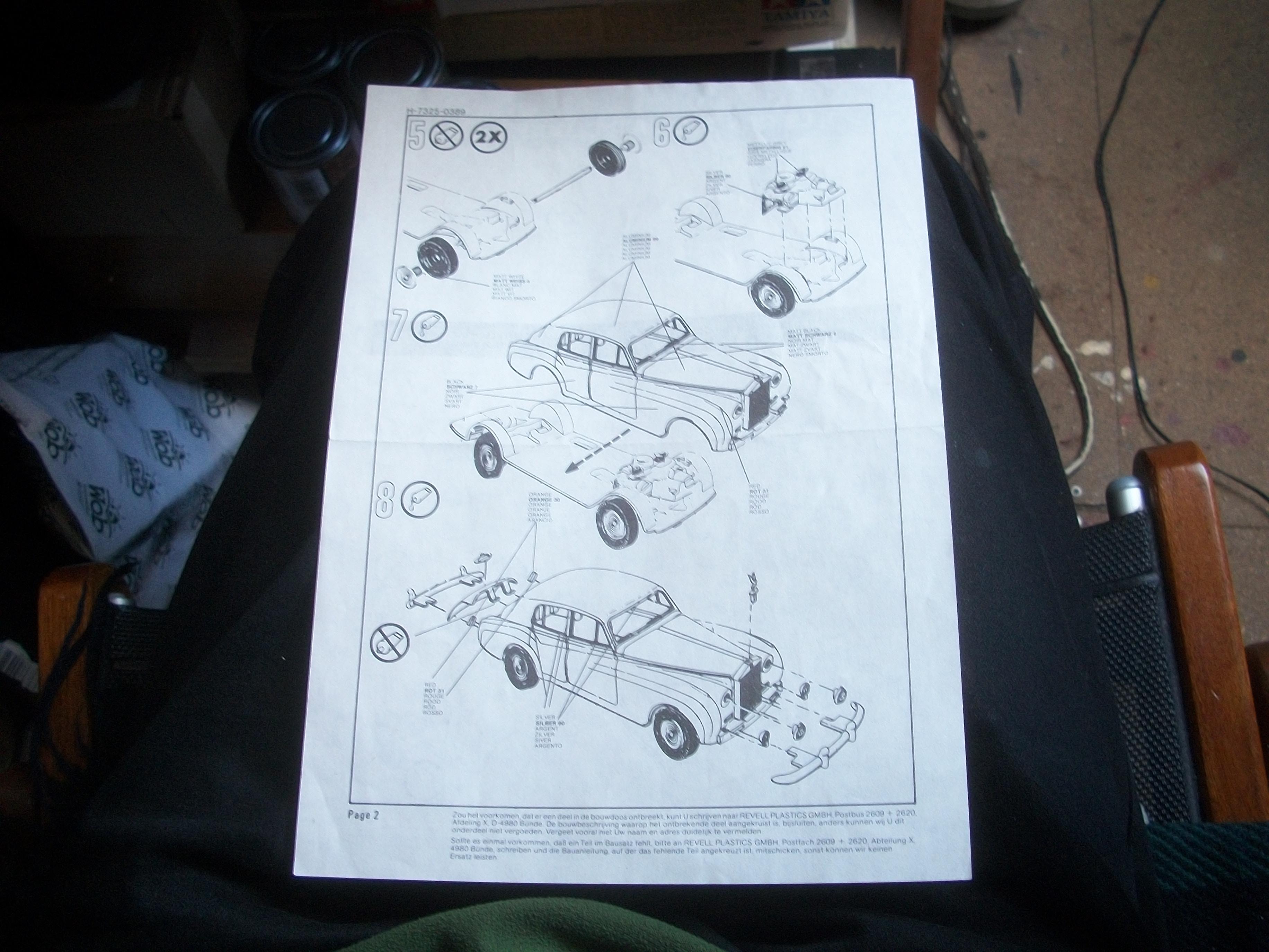

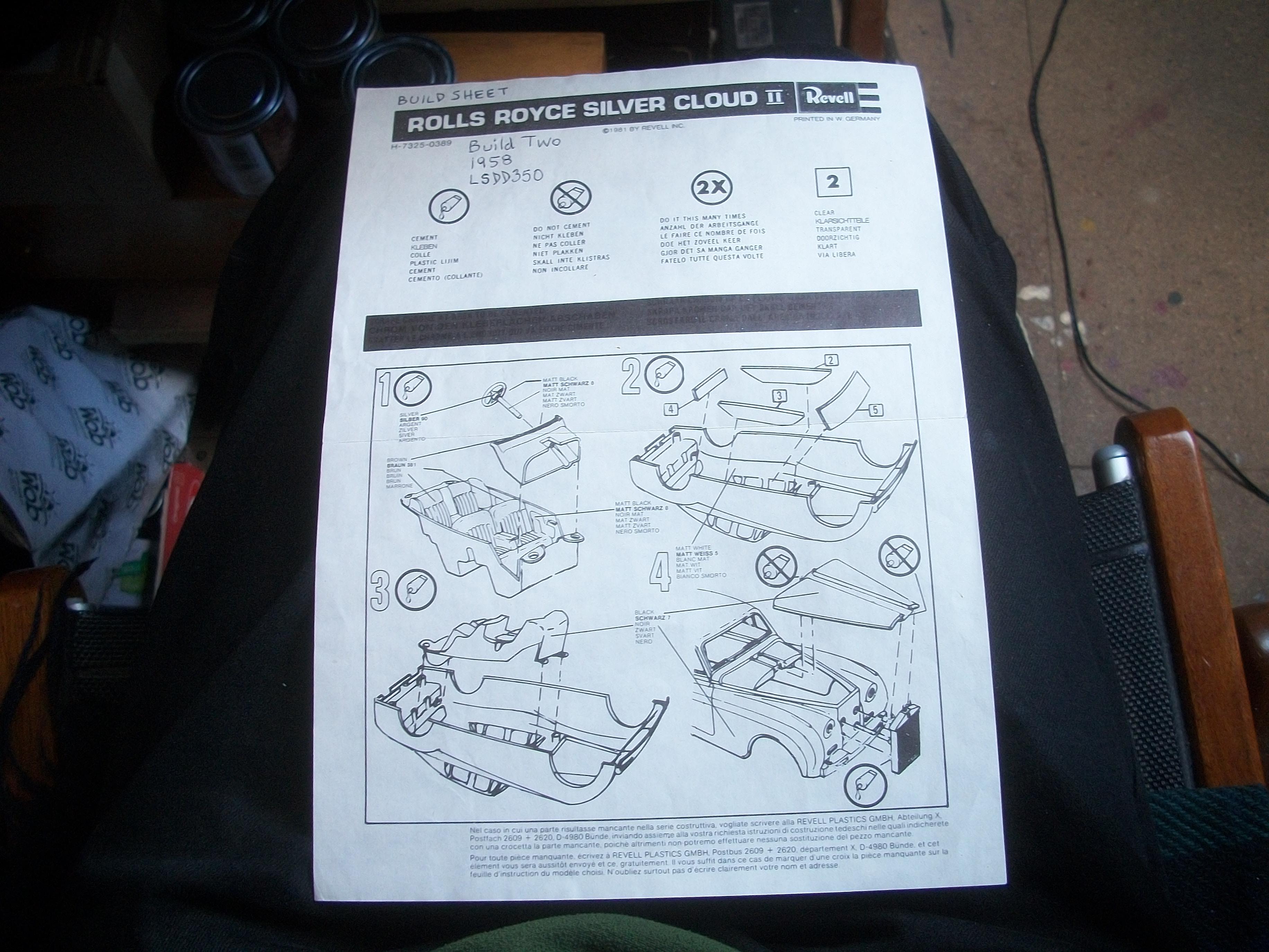

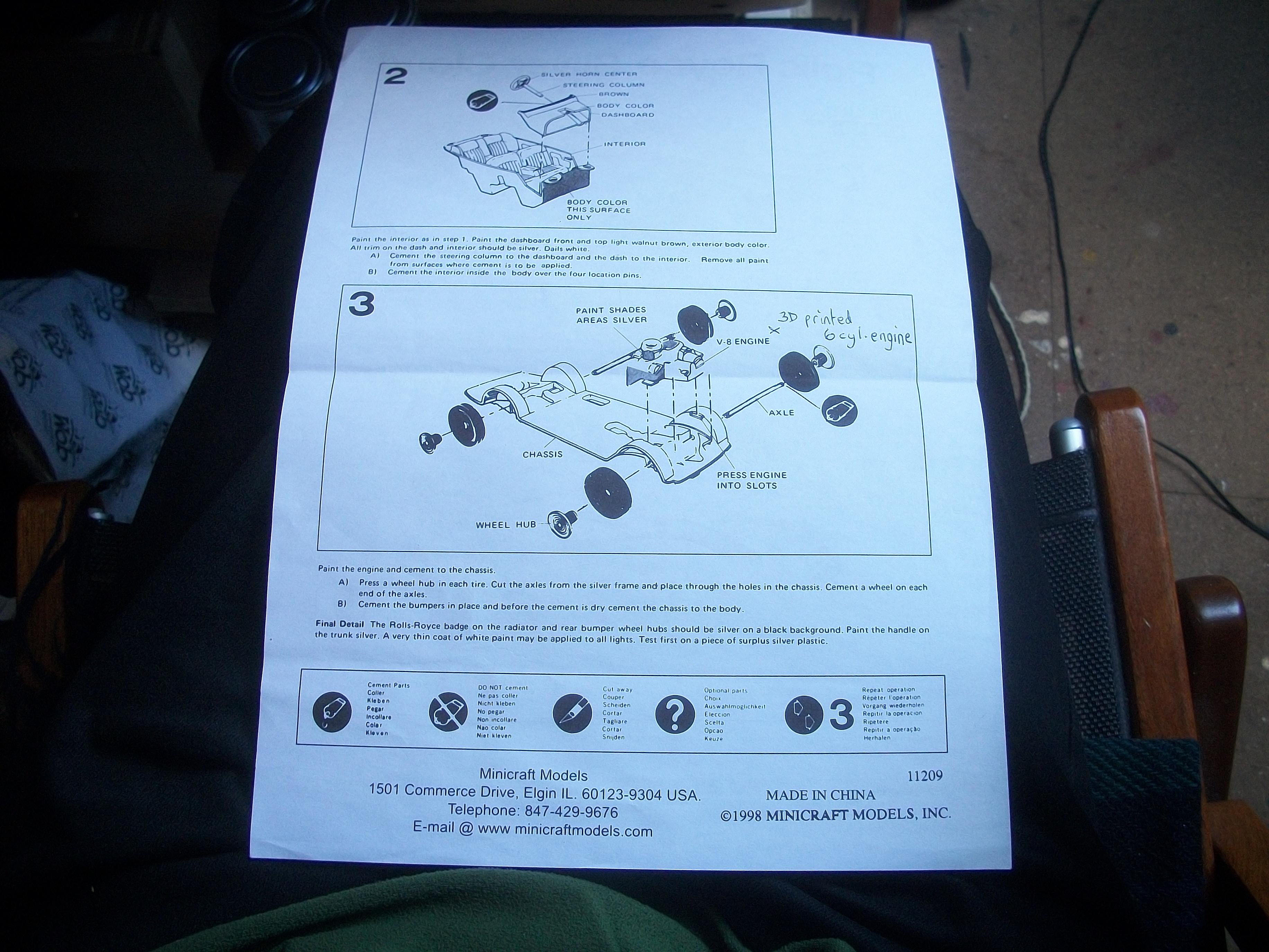

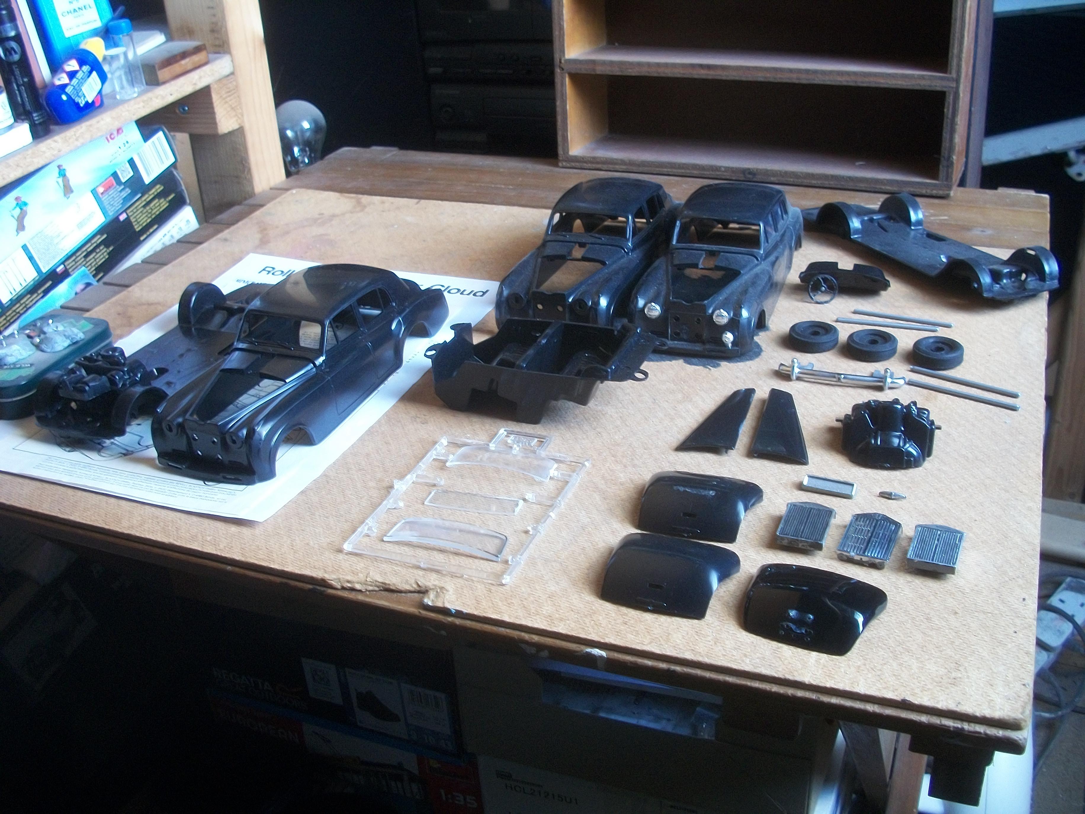

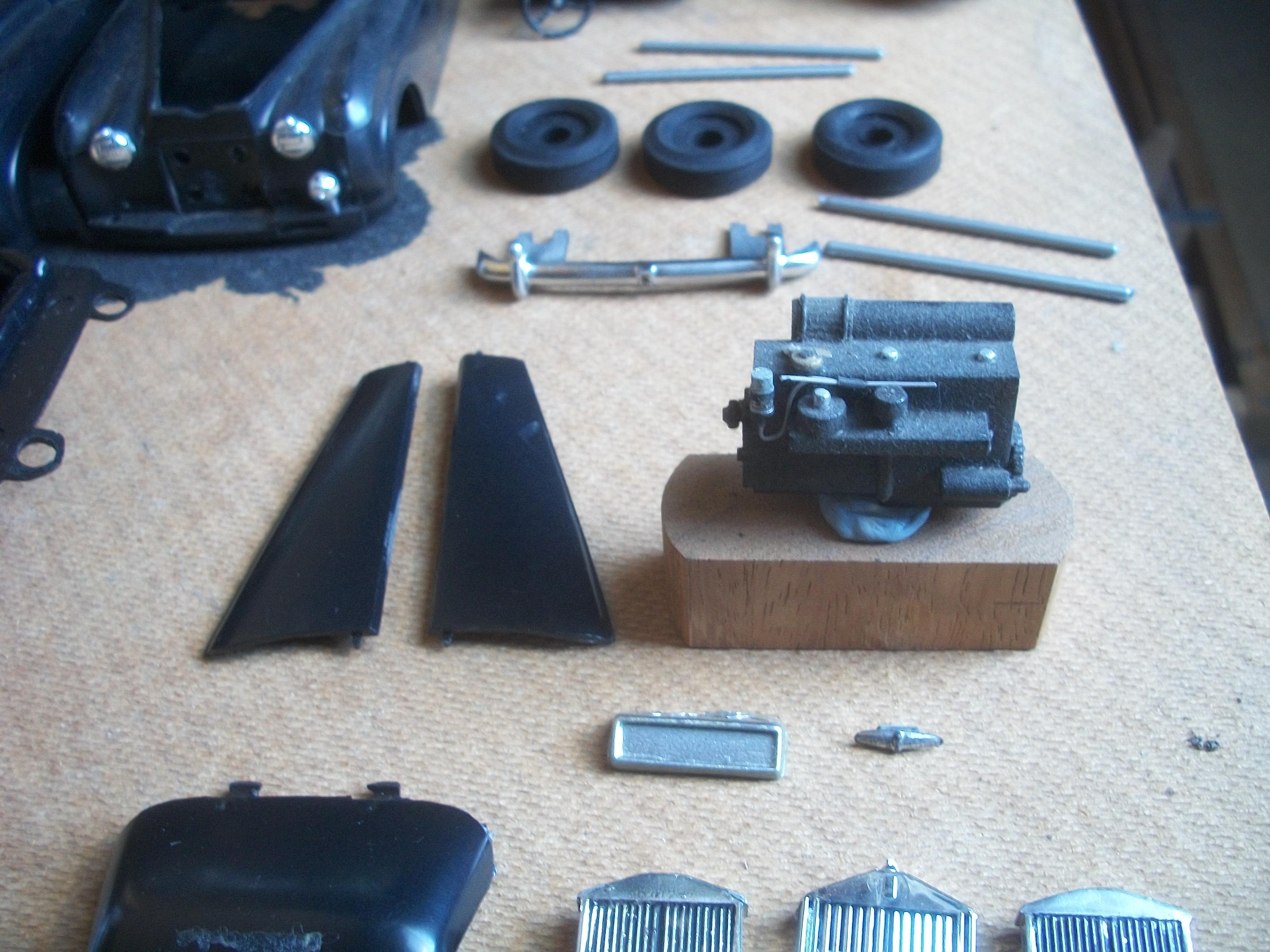

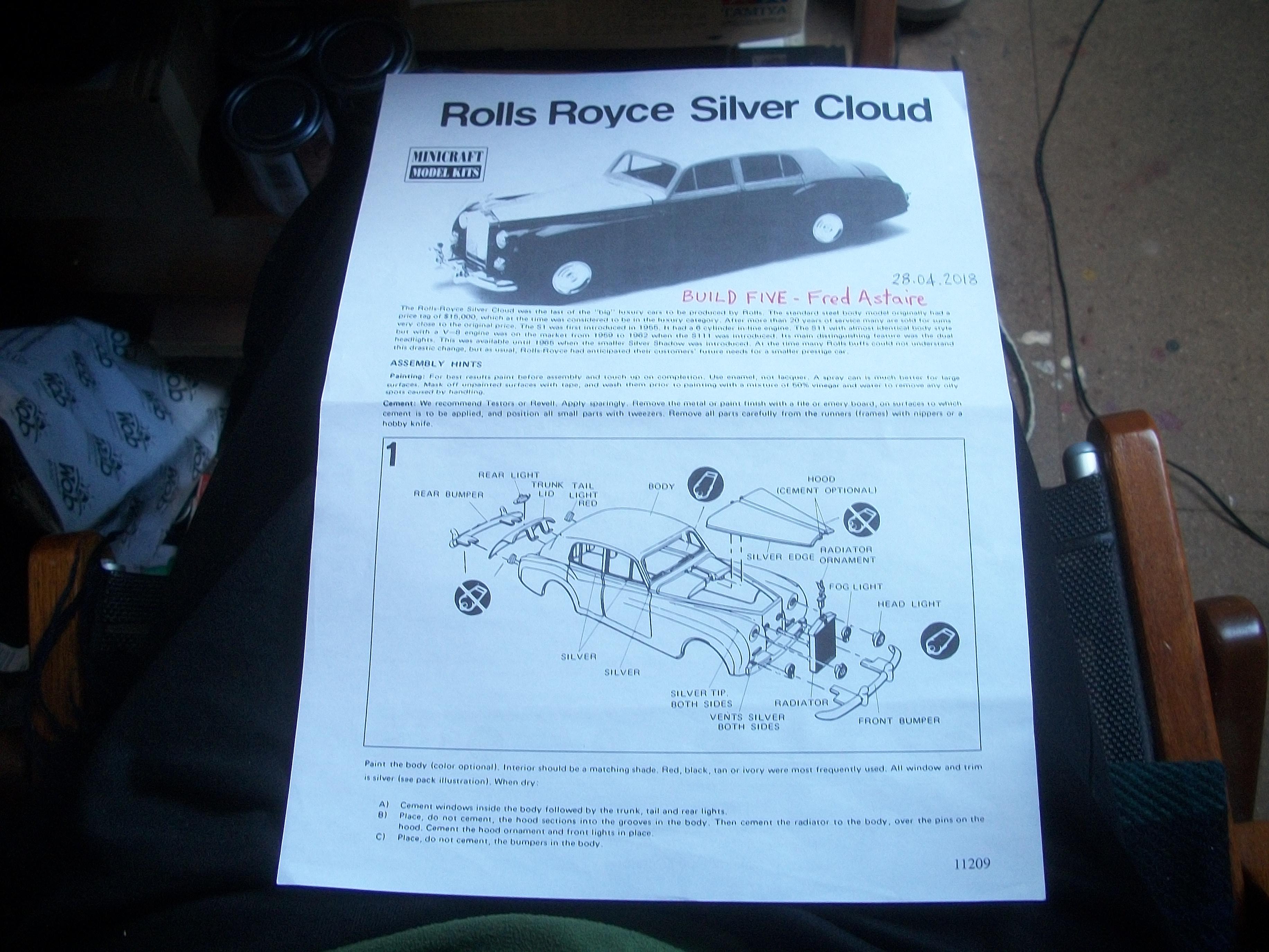

Anglia105E Posted Friday at 10:19 PM Author Posted Friday at 10:19 PM This evening I sat down at the table and conducted a feasibility study, to determine if I have the necessary parts to build this car . . . Here are some photos that show the instruction sheets for both Revell and Minicraft, as well as the parts that I have managed to find so far. What I don't seem to have is 5 wheels and 2 tyres, also one front bumper and one fog lamp. Otherwise it is all there . . . I checked on Ebay, and there are no Silver Cloud kits listed in 1:24 scale, apart from several Hubley kits in France which are quite expensive, with high shipping costs to the UK . . . There is one more box in the loft that I need to look in tomorrow, which should contain some further Rolls-Royce parts. David

Brizio Posted Sunday at 01:17 AM Posted Sunday at 01:17 AM That's sad news. But you have a good spirity and will find a way to keep building! This hobby expose you to a lot of chemical, even some that we thingk ara "safe" like CA glue, could make reaction down the line. In the instruction I saw 3D printed 6 cyl engine, 3D printed parts are safe for your situation? After cured, but I'm not sure before. Can you use Pledge, if so it is a good sealing after paint job is completed. Maybe also you can get one color decals sheet and cover the body of the car, instead of painting it.
Anglia105E Posted Sunday at 11:40 AM Author Posted Sunday at 11:40 AM 10 hours ago, Brizio said: That's sad news. But you have a good spirity and will find a way to keep building! This hobby expose you to a lot of chemical, even some that we thingk ara "safe" like CA glue, could make reaction down the line. In the instruction I saw 3D printed 6 cyl engine, 3D printed parts are safe for your situation? After cured, but I'm not sure before. Can you use Pledge, if so it is a good sealing after paint job is completed. Maybe also you can get one color decals sheet and cover the body of the car, instead of painting it. Thank you Fabrizio . . . The Rolls-Royce straight 6 cylinder engine was 3D printed by Shapeways in Holland around 3 years ago now, and at that time I primer painted the engine, as well as fully painting the engine also . . . This engine has been sitting on my shelf in the loft workshop for more than 2 years, so I the part should be safe to handle now ! You are right in saying that super glue ( CA ) is harmful to someone like me who has a lung infection, so this is why I am attempting to use PVA for the assembly of this plastic model car. As other members have pointed out, the PVA may not work with plastic properly . . . Again, if possible I will not be using paint on the bodywork of this car, unless I can use Vallejo acrylics brushed on . . . Thanks for reading my topic Fabrizio, David

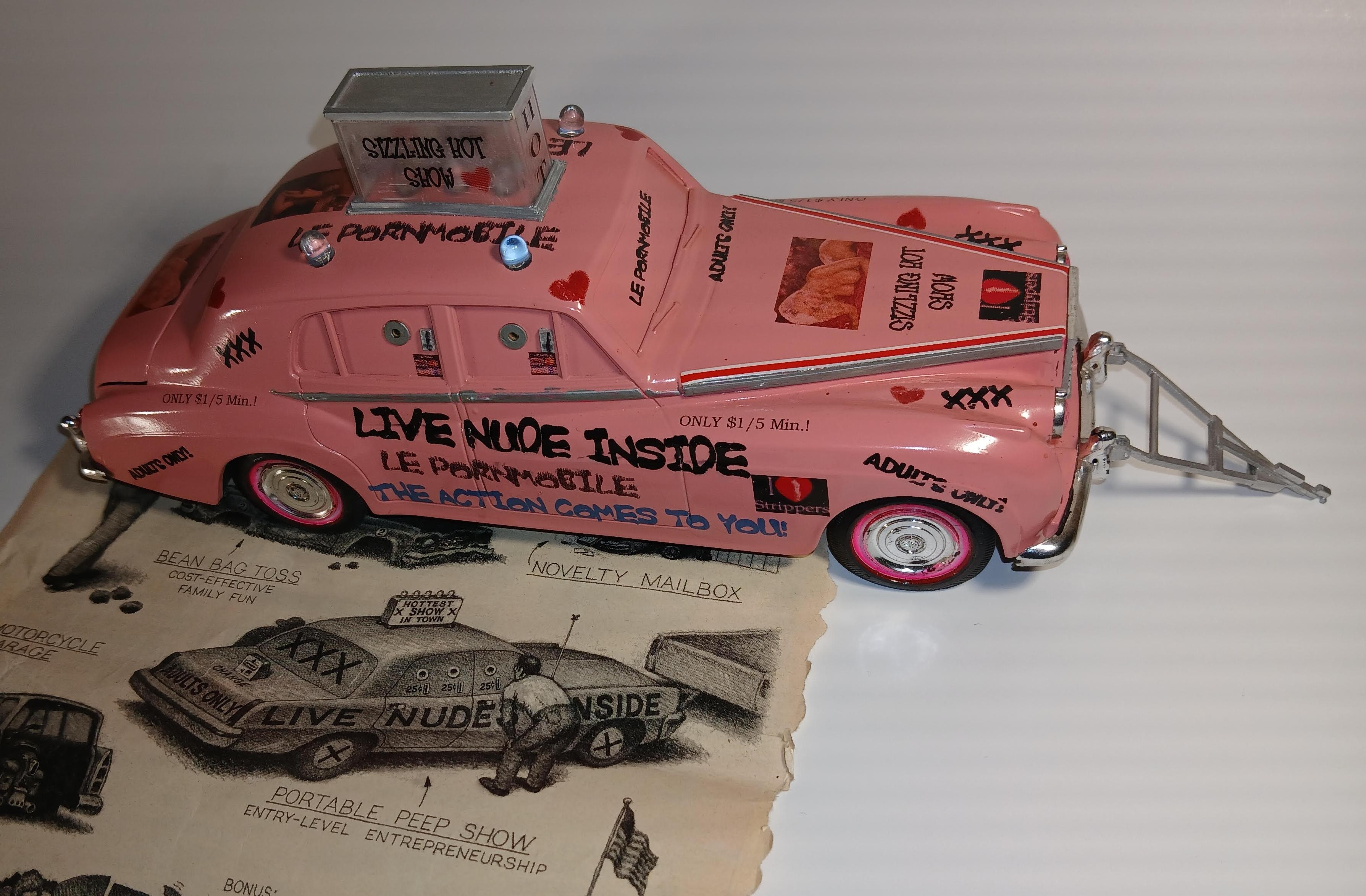

Big Messer Posted yesterday at 04:47 AM Posted yesterday at 04:47 AM (edited) Many moons ago I did one of this, but the Hubley version. Same kit but lower quality... if that is possible. Got it a a messed up build with missing parts. And had a Car and Driver page of cartoons. So I made this. I made all decals in an ALPS printed that, for my eternal regret, sold. It has blinking LEDs and the sign is lighted. Edited yesterday at 04:53 AM by Big Messer Added notes
